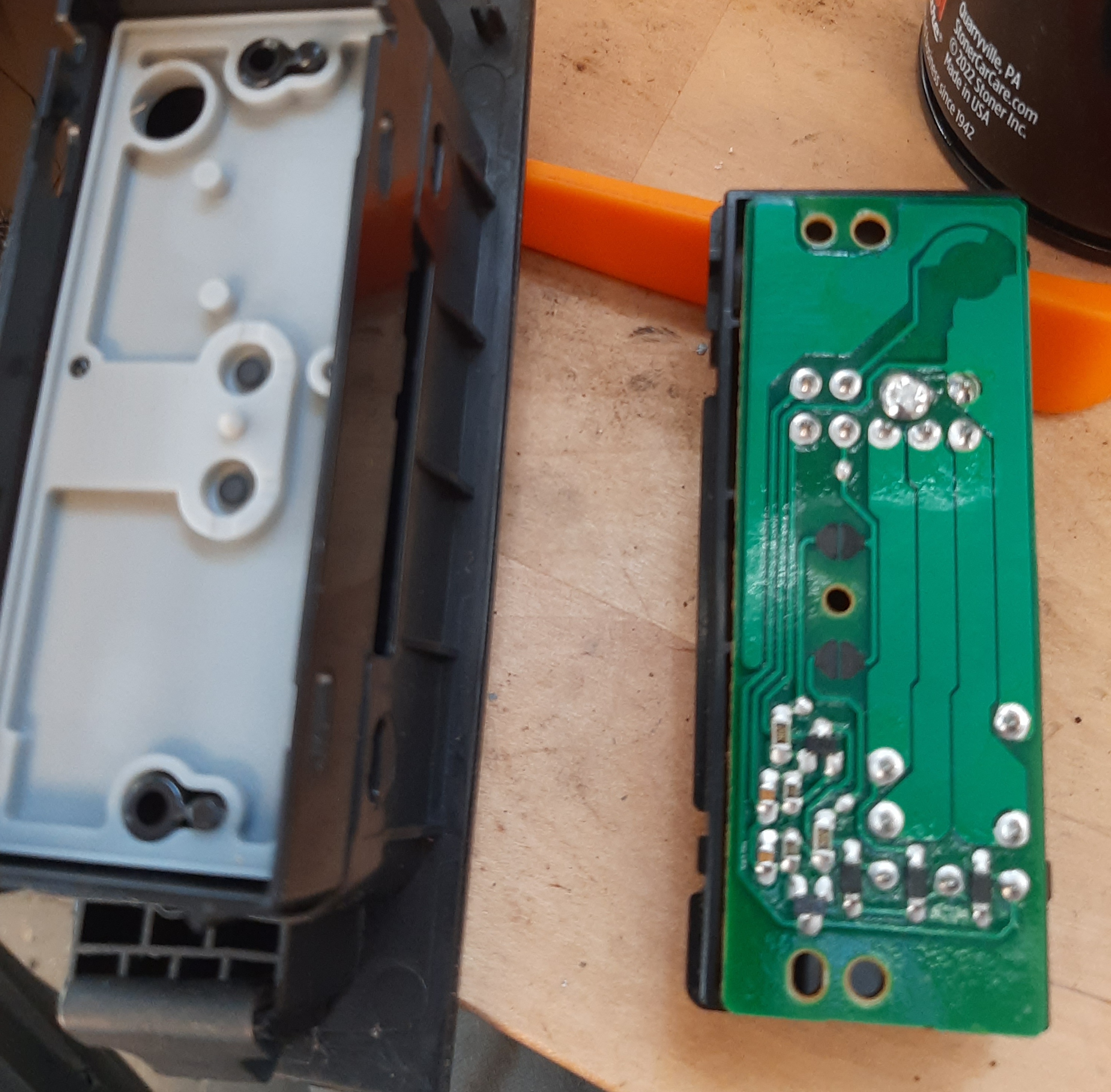

Here's a pic of the switch circuit board, what you'll be doing is soldering a jumper between tow of the pins of the connector. The pins are conveniently right across from each other.
Simply solder a wire between the two pins as shown below, and that is all you need to do to modify the circuit board:
Now when the vehicle is on and the lockout disengaged, the rear window switch lights will illuminate. If you're using regular incandescent bulbs that's all you need to do and you can simply reassemble everything and install it back in the car. If you're using LED replacements like me you'll have a couple options, I chose the harder one of course.
