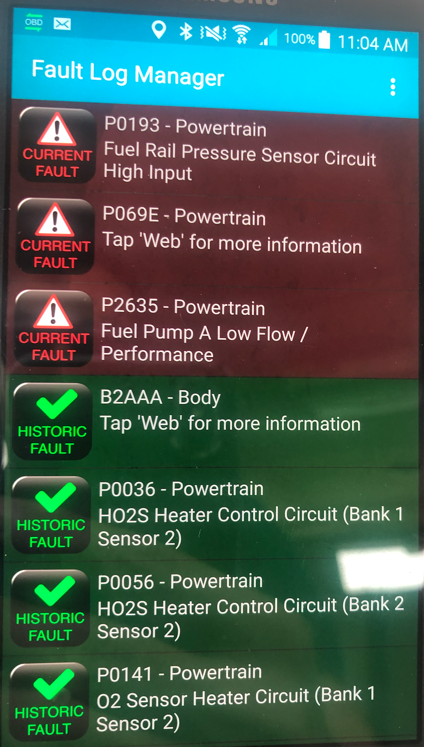

Hi guys, wondering if anyone can help me diagnose this fuel problem.
Symptoms: Rough idle / stops accelerating and backfires frequently
I've been driving it like this for 2 weeks, it only stalled once, but the above symptoms are always there.
Pulling these codes:
P0193 - Fuel Rail Pressure Sensor Circuit High Input
P2635 - Fuel pump low flow / performance (BUT fuel pressure is 95psi, double the usual)
P069E - malfunction with the fuel pump control module
I don't understand how the fuel system can be running lean, while the fuel pressure is double its usual psi.
Do I have a bad fuel sensor? Fuel system control module? Or a pump that over performs when its dying?
Anyone had this happen to them?
