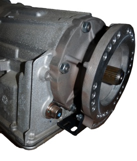

So Novak's adapter is only 3 1/4" deep. Seems like I could bolt up a 1/2" flange right to it with the correct pilot and bolt circle and be golden. I talked to Novak Friday and they would sell just the adapter shown in this pic.

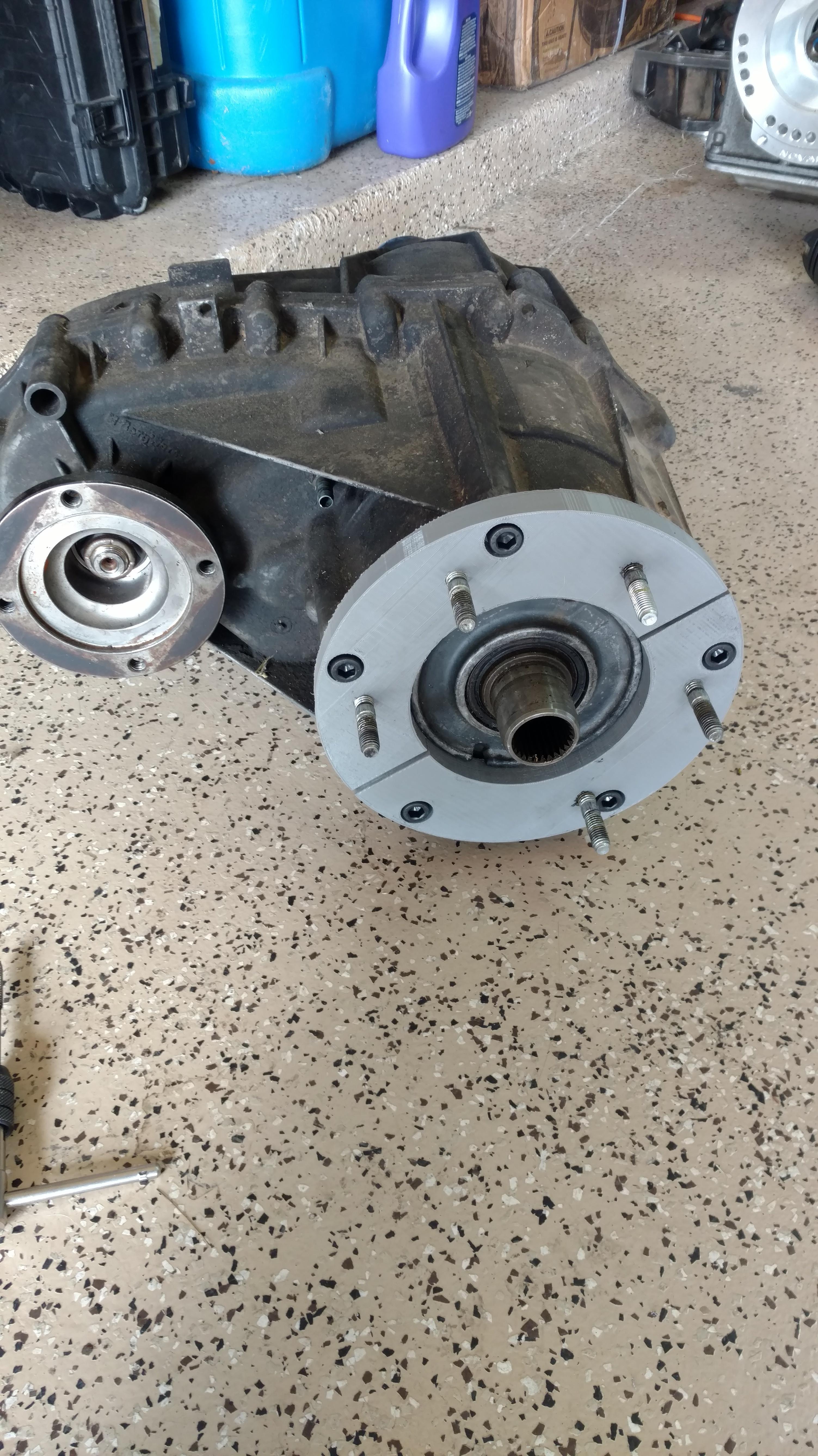

I'll try to update this in chronological order as its been a while since I've updated. Been real busy with life and am back trying to get this project completed. From the earlier posts, I got a friend to 3d print me a prototype adapter flange. His printer platen wasn't big enough to do in one piece so you can see its split in two halves. This is it bolted to the transfer case.

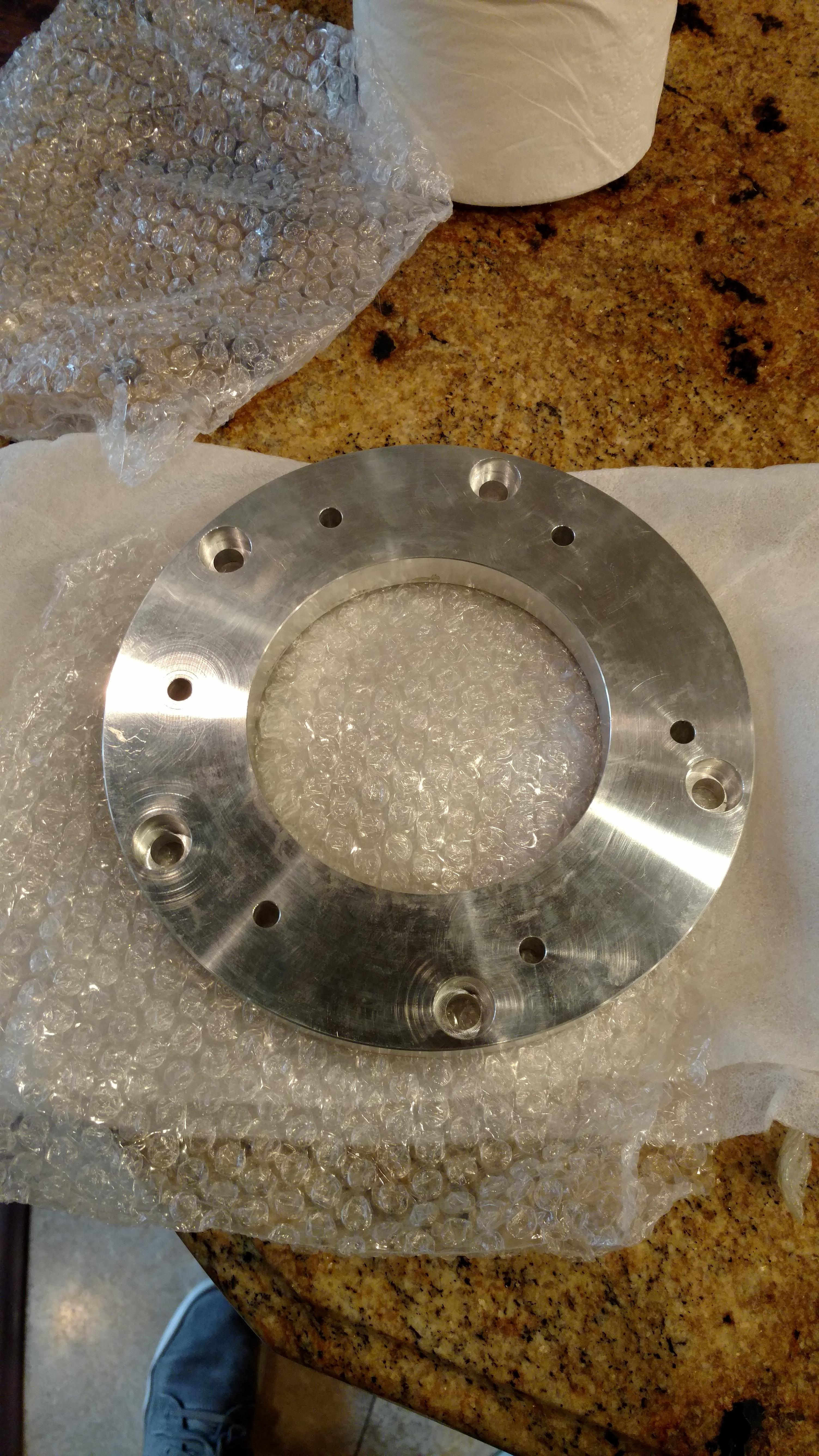

I ended up finding an orientation to get six studs in instead of the five. This adapter bolts to the transfer case with M10x25 socket head screws and you just move the transfer case studs to the flange. I kept enough material on the flange where they are counter sunk so you have to shave the bolts head by 1mm to clear flush. Here is the finished flange. I had the same friend make me a solid model file and I sent it of to Xometry. Cost was less that $250 for the flange and a centering ring
And bolted up with one of the studs installed. Note the second piece to this is a centering ring. This will keep everything centered when bolted up. It was much simpler to machine these to parts separate than to try and make a complex assembly as one piece.

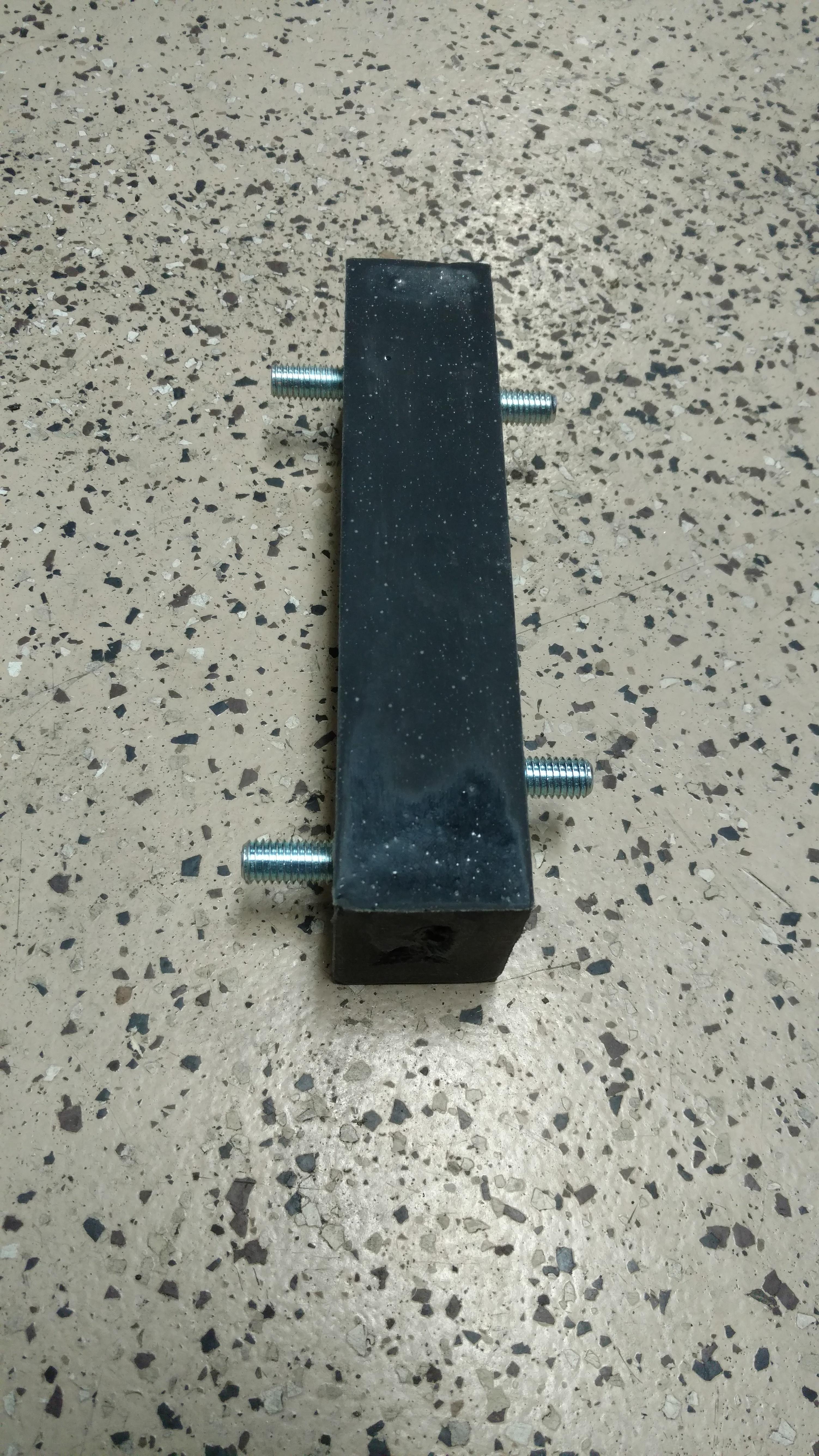

For the isolation mount, I first had tried and assembly with a stack of generic urethane disks. My original foot was bolted to the part of the novak flange specifically made for that purpose but there were two things I didn't like about it. First it interfered with the lower two bolts so the transfer case was only held on with four bolts to the adapter. Second, I didn't like how secure the through bolt ended up and because of the bolt placement, made it very difficult to access. So I decided to just pour a monoblock urethane mount.
I made a mold out of wood and mounted the bolt assemblies in it. The stack from inner to outer is bolt, fender washer, nut, fender washer, flange, nut. The innermost fender washer is clamped into place by the nut which will help secure anything from rotating during tightening, and secondly the fender washer will give a nice big surface area to spread any tension force through the mount. In addition, the way this is stacked, when the mount is bolted to the flange, the end nut will be clamping against the fender washer and nut resulting in only bolt tension and no preload tension trying to pull the bolt out of the mount just due to being bolted in.

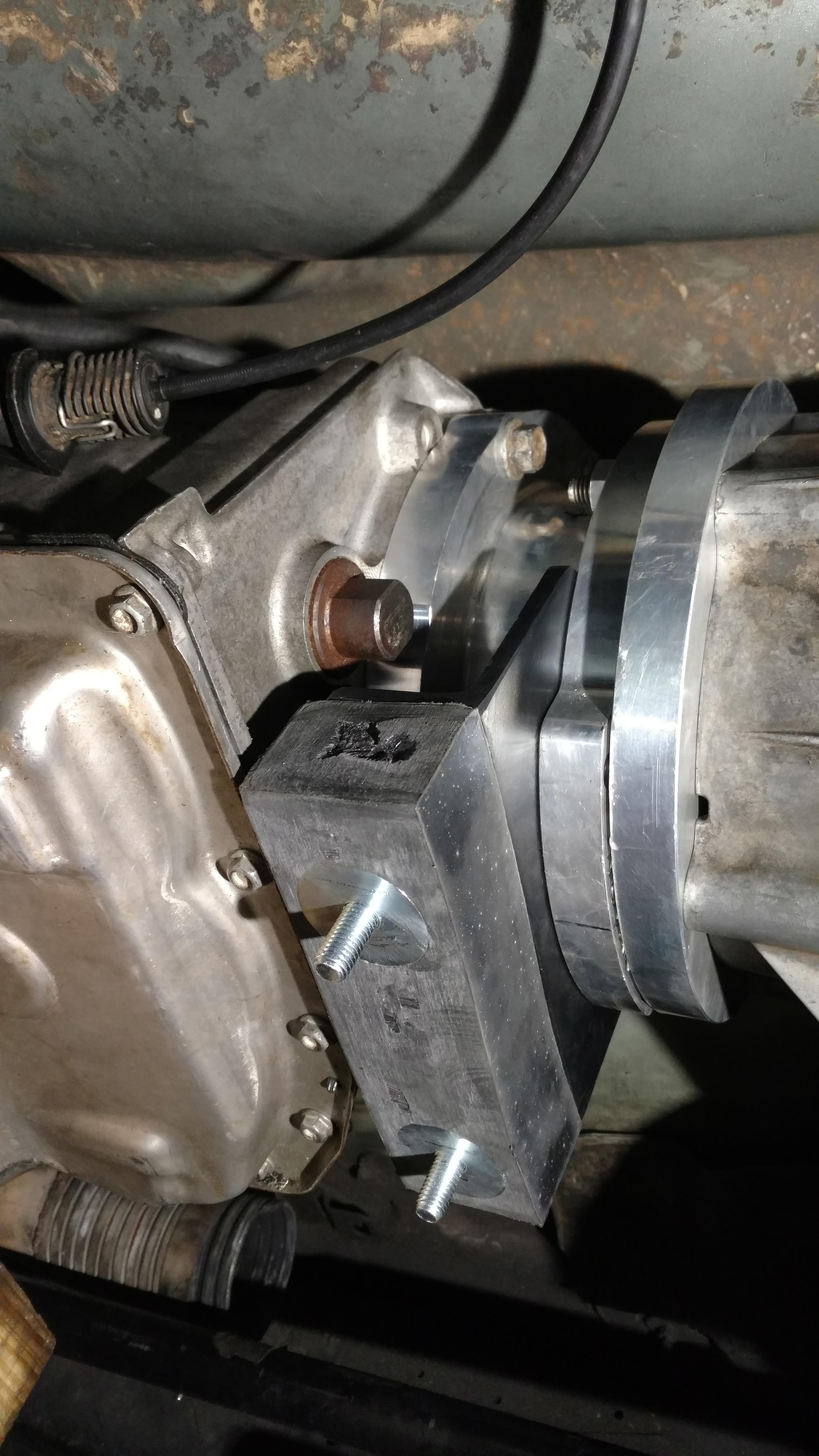

And here is everything bolted up

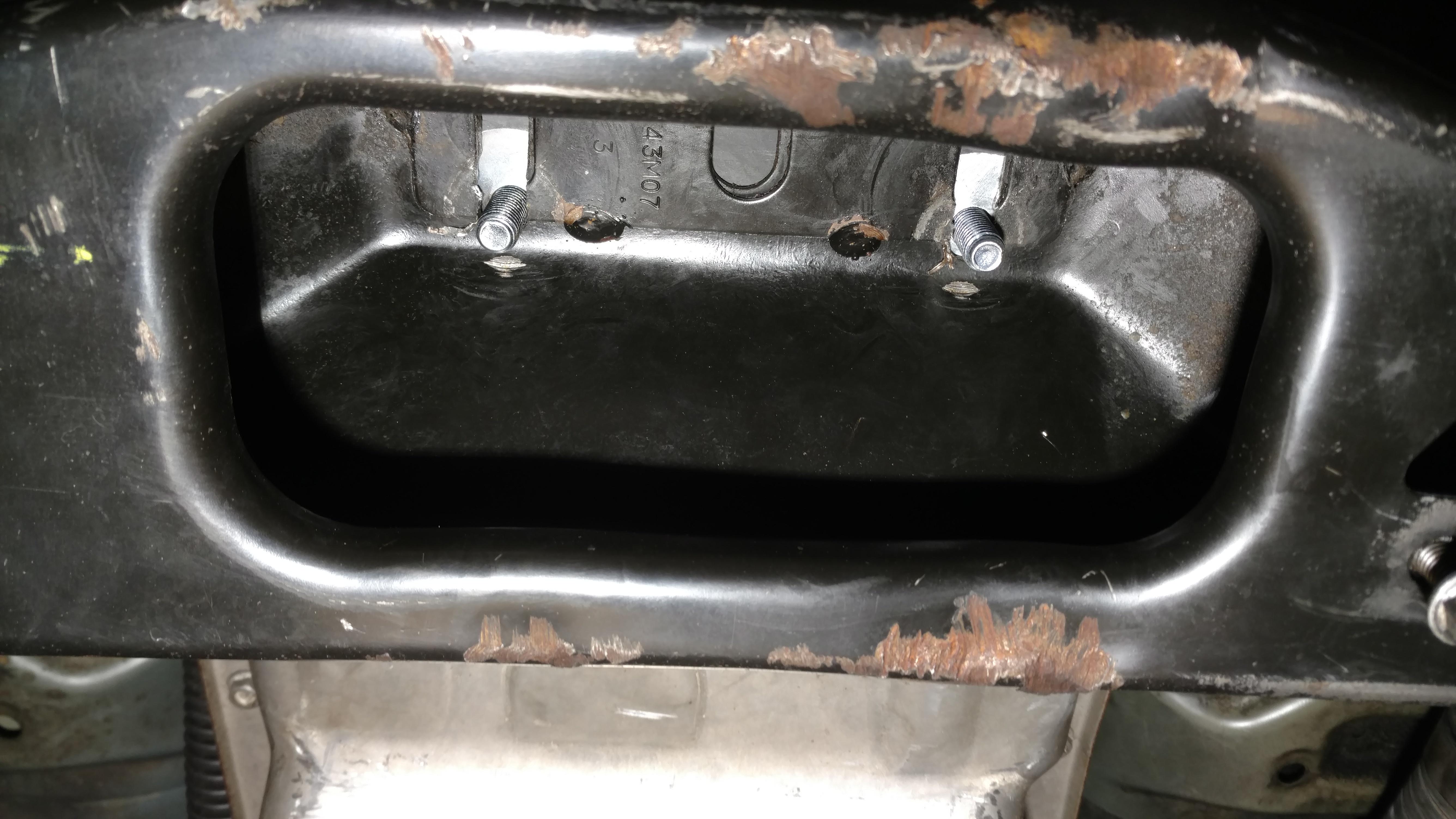

This moved the bolts slightly forward in the crossmember so i had to extended the slots forward about a half inch.
