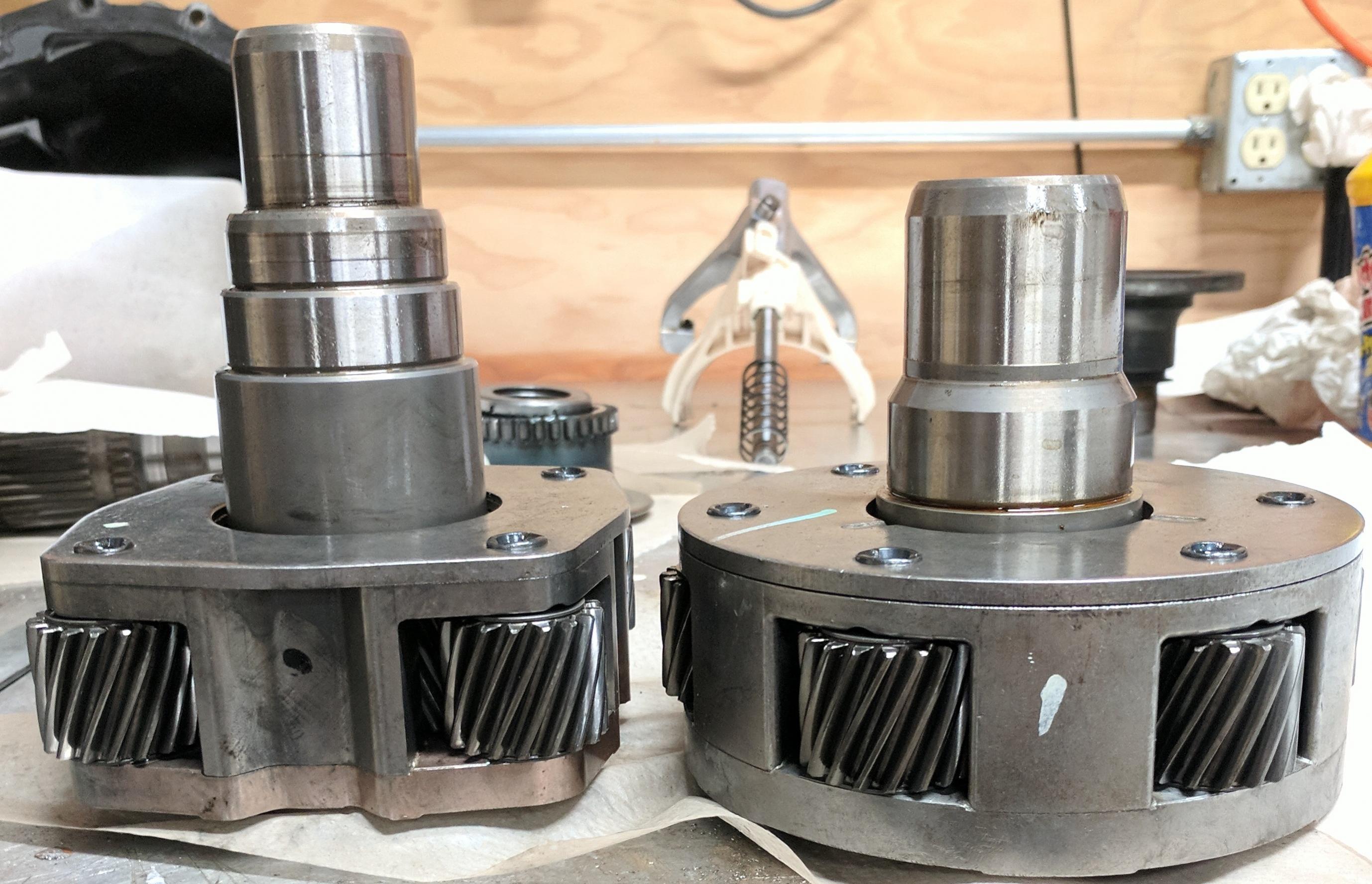

Well I figured this would be useful info for others so they do not waste the time or money... We finally found a 2008 H2 transfercase 32 spline input shaft and planetary assembly to try and swap into a base H3 transfercase. The 27 spline H3 input/ planetary is on the left and the H2 32 spline planetary is on the right. The H3 is only a 4 pinion assembly an the H2 is a 6 pinion assembly. The H2 6 pinion planetary perfectly fits into the H3 case and has the correct mesh gears but the 32 spline input is WAY to short and does not get close to reaching the seal. Unlike New Process transfercases where you can swap just the input shaft into different planetaries the ones in both H3/H2 are pressed and riveted together.
So long story short is its not possible to swap the input shafts in a stock H3 case. I even looked at trying to find other brand inputs that might have same gear cut but no other transfercase out there has as long as an input as an H3.
