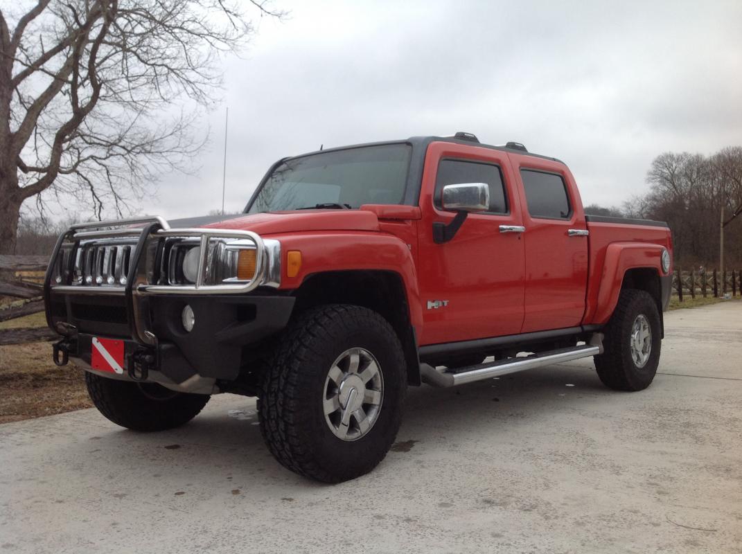

I'm thinking about getting 295 75 16 Toyo Open Country AT2s. Tread depot has them for around $800 free shipping no tax.. for 4 tires.
They are 33.4 inches so a little bigger than my factory Bridgestone 285s.
I recently contacted a guy that has the exact tires I'm thinking about getting... He said that they have great tread life and don't rub at all.
here is a pic of his H3t with the tires I'm talking about.
I asked him to take some better pics.

Well, here's the finished product. I ended up going with the Toyo Open Country AT2's in 295/75r16. I cannot say how impressed I am.
After:
7kO7TDKYgDfcfd7mbZXCpJl7XDI7Tdj6b-eYOFXdf42JkDfEgWC5CMRJKN7HPEeaRiMCtblGFPHsb6AvZNxy5DtN_tEmoNC-wzqhgf30wr00XaMmEj_vzPqGPOJ_8kFE0EVI14yUIx7jcCYQxUKYOc3cUcvSmhX7HHn-CBUWRvx2PBbM4OaNIf2YJJ9q17cSnIeMRw47s8aKfVpeqgFcdiJQuwBFZv_gKMnlIj42BbDpUFNc1JIsmxXTi6Iivp4ZzfQ9YpepkYhHc2EHOjYpvblhIu4mNfMHrb6ebLxxgFH3lk3U5UrGAUXia5vR7EVYX_Y8YXFamcGES4xWEXtzzFcIbQcofRH_Q2JGqrPpYQriByyX5A2aFNSZxhV6NIiIHN36MbmtNWlUeRo5dsJhGsGLZXFRsNK2kmWVPtm67h1LdXqBhTQ5jRqEnoeAmadfjmhkWhStXDHO6LkBDbngSjdVpxZBFvu4z_WwE_pAyYUQealqcbn6tWiGMjn84yaoupPRGbVRtWw6ZcTpOnwADJIWnPUowO2x8CKHiwPO3yu1CoV4MoPW5v6g7HDl0pwRcE2A=w1287-h965-no
hAJWMoonmVm61qLHY0gcvtUfll7kmbdIP4BeUMZsaJeKoUyly4T3umhr3RpYdqKEq32oyHtmMrGHU71mvJAaFcsO0El1lkEyHljFk-_Qv42wAEqdPholUayvFHa8SXdrup-2DPJgFm2O0lBiYiELCm2Vx1RbrGD-xMZ_5u_rVHEenXXpEzAxZL7bV1dvaiD2ge2FbTq3df6KJ9GSY9uziOz2xiqKIMbBk6IAxkZk5u8sgs2YKS5V9rxtNQU5lp3MtdY4XK3M6fO6npkAA4CL5F4j6t4Sk0e2MlOPHdhfTxq7uEfXAWzaH7TZJEzY6w-wcS2kAvwNIlPcYz5UmxruLrQKo8CK17vuTAysZePcTPVKbohbo2FVI97ObXExXHMcfuewg9AdOr-oGomGuu_vXrlPb_Q_fEb7dZJinUvvbEvyLGBugZLuclG5DHbP7Qxx4ah1M7hmf3zLFSq2gFae4YSHKWub1UZXq04tbpUXDSqpbCgOgYL1xE7fAjk7HBiieK9EK8kgmnpyDyzNkIzs2Un5BSkiTJWs5tSFXEspDgR1OaRM_ZPZPFXCnIUMnRcySPzv=w1287-h965-no
BDM-BFoYZ1USdktSXog9aDKfjj-wHzDzxmEWdQbK-fq9xs6b5uBn9X8sWVghTJetlu5Xa3TioT5in_5i6HFczXFNxXA-gZMwmM56B99am3sQkpmCyeEEYzJnda2fF8ro68uImjCGFpcYMU68_l4OAbw8E9jMfeWcSpSvHSiywkWK0pRz6baZswn7T19m3Z60j4dNLabXmwE8YRjinVmrintRIA9erOnZ656tWZpBi1WC6-5Lm8BaFk_KE0K3WkhDg6Phyt27YYqnqE2tXSVTp-QAJcR7V0UIYZ_KBRfaoCOESMpWaJZ5eSSSUW_kxsTRzv4sSDVMkbPegq4vSzICFXhPLv64yCP7nxg3qdq8NqJi5kHsRPdsaYDY_QfDl58sNBLKNiqhoqr2qupHrInsVePilX2DcPeG6fL92dhwWT1Pm9qwap8R4f5aqdIGNLQIYS5sNW0sAJV_-aWOtlvuBy06Mj3o-6a87LfjjvWzFX7t1xXyXmitljbfounzP73i0Tal4g-3y2OUIhi3rSBfaRZoiW6_FPQ6AXL6WaUF3U6KqrQeWHuh1L09pv099_njHkPs=w1287-h965-no
Before:
G5CuCLZFnEmErm95VB738M21gn_oZdaLOJ6P7rRC5PpQ7DyQjgJIiOxg8n1XOVz49CzL96Uyxi7RtEuTmUzYebTzdEXHoSxROVxzn_Zh6GtlnRKdHwgR5zwAvW1JFMgsVAP1RwSZFoylqoqAQL7UHjFSSS3FyNSj2Zm3-L1N6ILTupQZd89md7NT_KMUpTsw_De9X-G0erPVt37LErCWauMd1zwrfLJuXsEc6tkPvblqcA-YYxgGBGh0Y5dNf_Ony9akzleu-LTayW8qTzBZvRoR_9w8YZc-AHhOXV1zplNDkOkYetgnmNMHnfccUKUpI1l3-ti0HPAyeAFQIl-9vj2Yh7JccifH2r8rwm9qJGiACnKtNV4ZiOrmpgNL3UQXuPHmZhdVz_hkDtHMSVcmFaYywBcDGxARMTNwZlfOwNABoh3RqlmdMOeyOfNAi6xM26ClXvR1wv-xFqq1mGmrAV8xbNVFpQCWdLBZ9Qkq64f4ITjqMG3WOhdYZUPxUK-FabsXIEa-7eu79z-PAlm6CdP8PuB2kTQSpuaq7xa26hf5pXnJtWlD8J0S9B3ZarfxG2j8=w1287-h965-no
