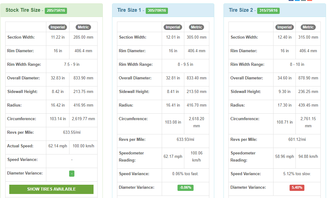

I found a tire size calculator on www.1010tires.com and plugged in the three tires for comparison. Looks like the 305 is slightly wider by approx. 3/4" than the 285. I'll need to get under my rig with the wheels at full lock and measure how much space I have. Assuming I have 1" or more I think the 305's will work. Thanks for everyone's input.
