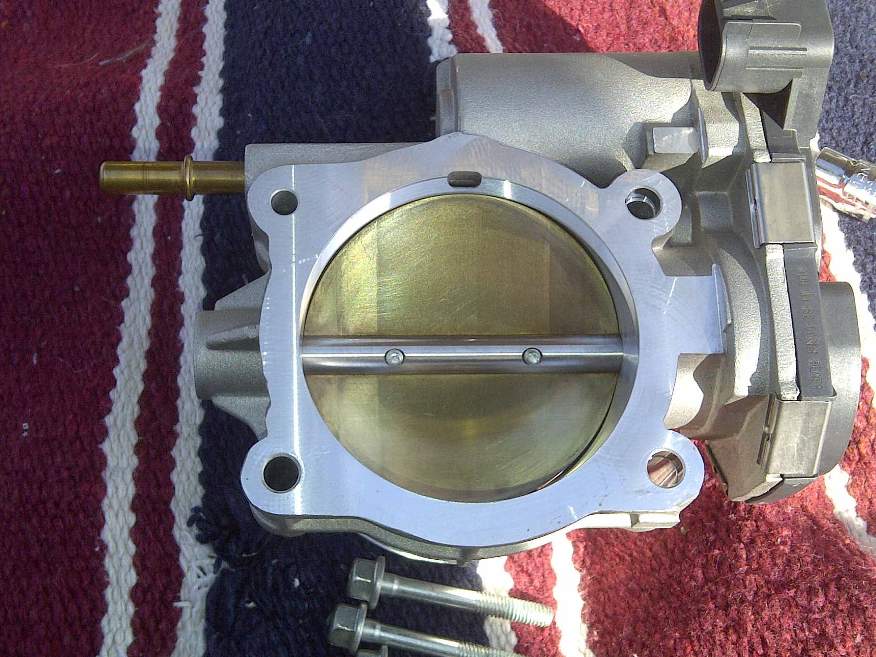

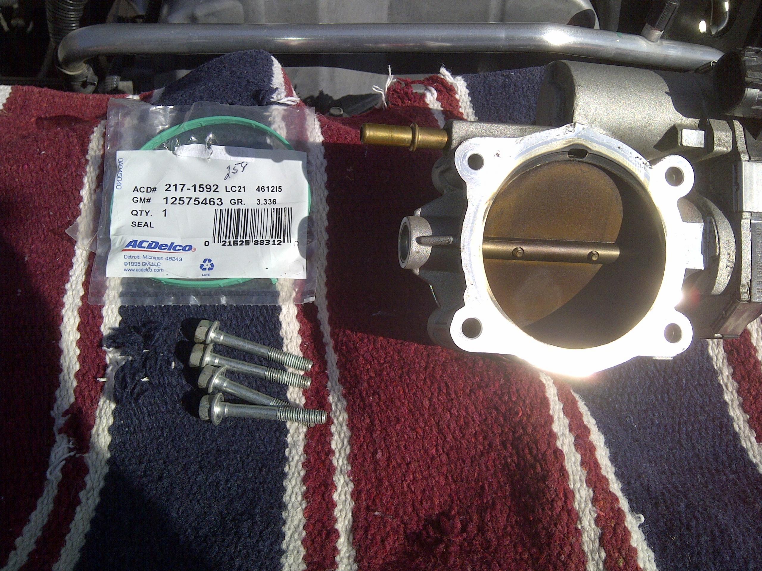

I've changed the plugs yesterday with new AC's. Verified the gaps @ 0.040. There was nothing unusual about the plugs I removed; looked like normal wear on a 70K set of plugs. I cleaned up the throttle body. It looked clean on the air box side, but it was coated with black carbon on the intake side. All cleaned up. I started the engine up for the heck of it, and I was getting TRAC FAIL, STAB SYS FAIL, or something like that and the engine starts running rough. My HF code reader can't detect any codes though. I tried using my Autotap program on the truck but it looks like V2.0.1 won't work on a vehicle this new. I'm going to plan on replacing the PS pump to get that job out of the way. This truck may have to stay in the garage for a while. It will be easier to sort out the problems on my old K1500 at this point.

That's one of the hassles about our trucks; everything is electronic and inter-connected. I disconnect the air cleaner on my '98 Firebird to spray carb cleaner down the throat of the throttle body and no big deal. The throttle body is still cable controlled on that engine and disconnecting the MAF doesn't have a big effect. On my 3T that is obviously very different. When I started the engine two days ago after changing the plugs I forgot the MAF was still disconnected. I should've realized that would have a bigger effect than the same for my Firebird, for instance.

I think all the work I did to my truck cured the problems. It was c-c-cold drive from north Santa Barbara county to LA last night. My truck was flawless and just "Hummed" right along...
Santa Maria Valley-20130216-00092.jpgSanta Maria Valley-20130217-00093.jpgSanta Maria Valley-20130217-00097.jpg
This was a 70.5K maintenance procedure. I was kind of lulled to complacency for a while. I was forced to pay attention to added maintenance routines besides standard oil changes, etc.
