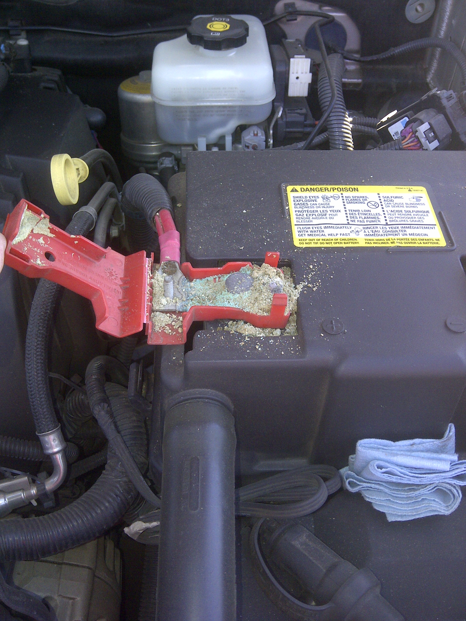

OK, battery seems to be dead. Terminals were all covered in that wonderful white stuff. Took off the terminals, cleaned, etc. and now charging.

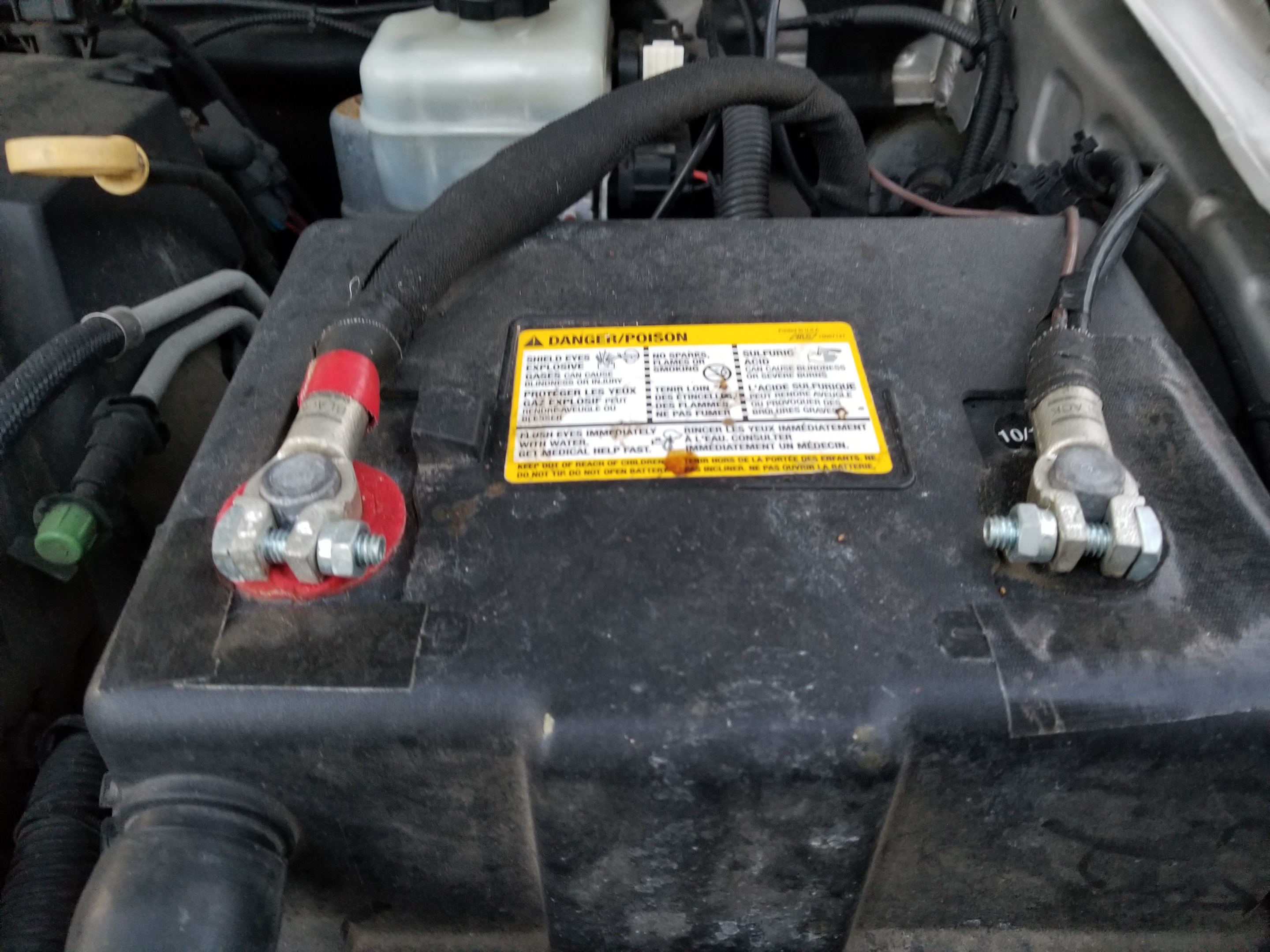

The dude-meister who owned my H3 previously put on some real crappy universal batt cables which were awful. They weren't even clamped snug. Wires frayed all over the place. I installed some nice clamps, soldered the wires in. A propane torch with Mapp gas will work. First ya 'tin' the leads then solder them into the cable-ends. They look nice and work fantastic. Plus you can add accessory wires and extra grounds while yer at it. I think this is what I bought (below). They have a nice zinc plating that didn't burn off when I soldered them. 3yrs later in WI winters they still look great, not corroded at all.

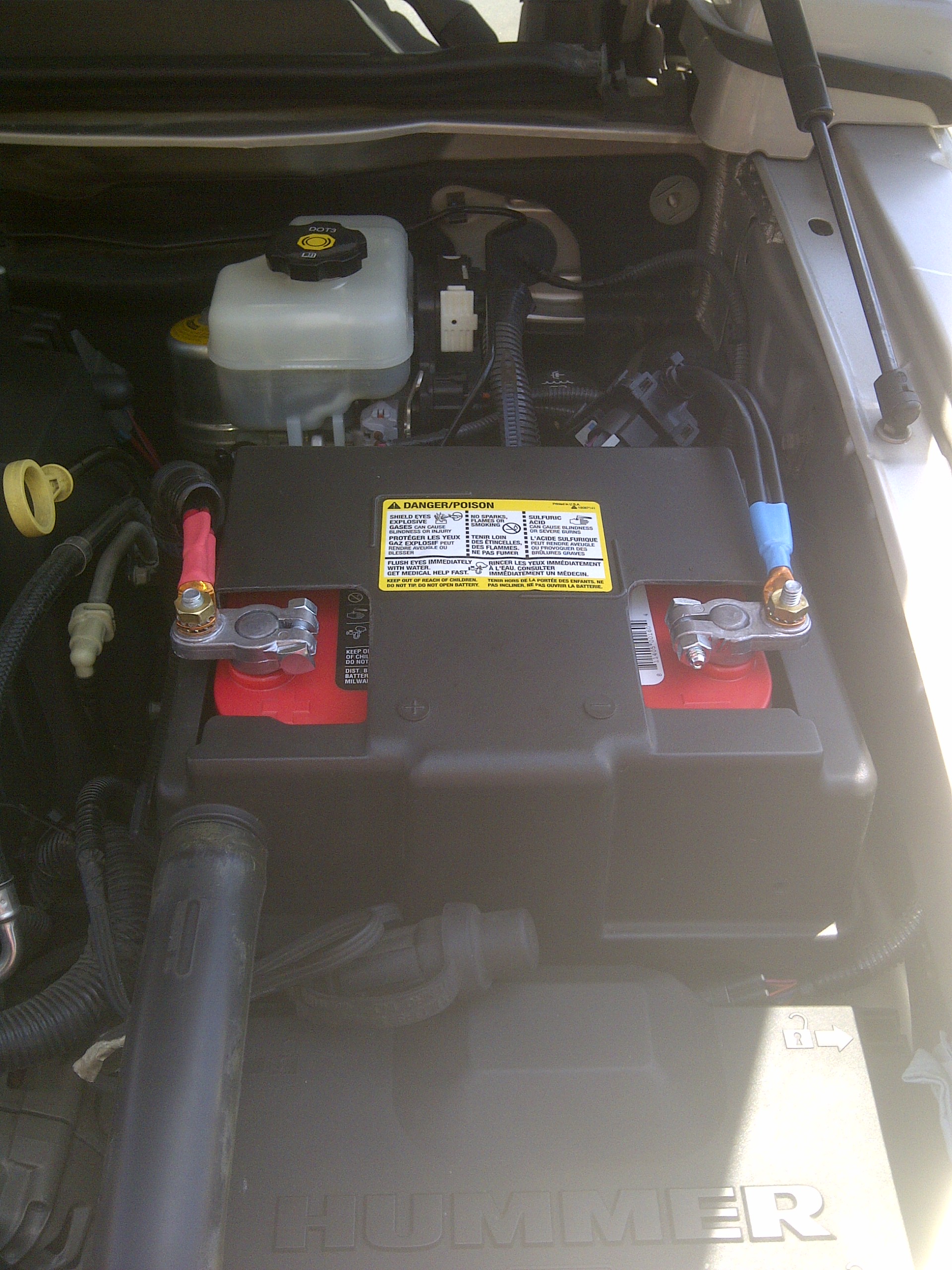

IMG-20140713-00718.jpgIMG-20140718-00719.jpgHere's an example of what I did on my 3T. I found terminals at an electrical supply store and I cut off the stock ends and crimped copper terminals with compound jaw pliers like used to crimp terminals on coax cable. The pliers worked well on those copper terminals on the battery cables. H3 battery cables are expensive so crimping terminals like I did was cost effective.

Those turned out really great! Looks 'pro'. The neat part is you can add more accessory connectors if you need to. Nice job.
Here's how I tackled mine. Solder the wires in the terminals per the reply (above). What you can't see is I applied urethane to the back of the terminals under the tape ..to make them waterproof. Hey, it looks like they slightly redesigned the battery box on the 3T (or later H3s). I never figured out what the purpose of the vented battery box is. Keep the battery from getting hot?? ...Or just look cool :thumbs:

Mine look the top one, but not as much powder.
Cleaned them off with a steel brush, while not perfect, it took the charge which has lasted as I write.
The OEM terminals, I've known this forever, have always caused issues. Been dealing with ABS, etc. issues for a few years after I had a pro install a new head unit.
So, terminals will definitely be changed, but looking into what is best, not show car stuff. Many have recommended stingers, but I do not see a way to get jump cables on'em, so still looking for something that will be the highest grade and something I can install without making more problems for myself.
