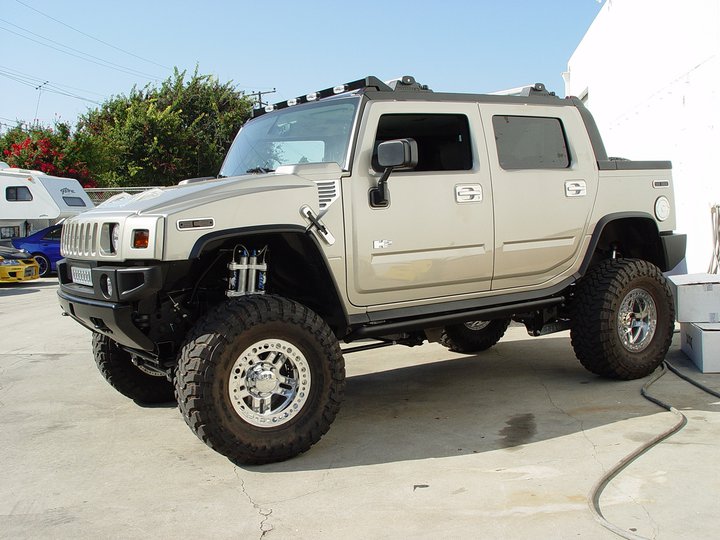

If I was ever going to do an H2 build it would either be all out like the SAS Dana 80's that someone has done on here or a Bulletproof setup like this:
This entire truck just looks great!
