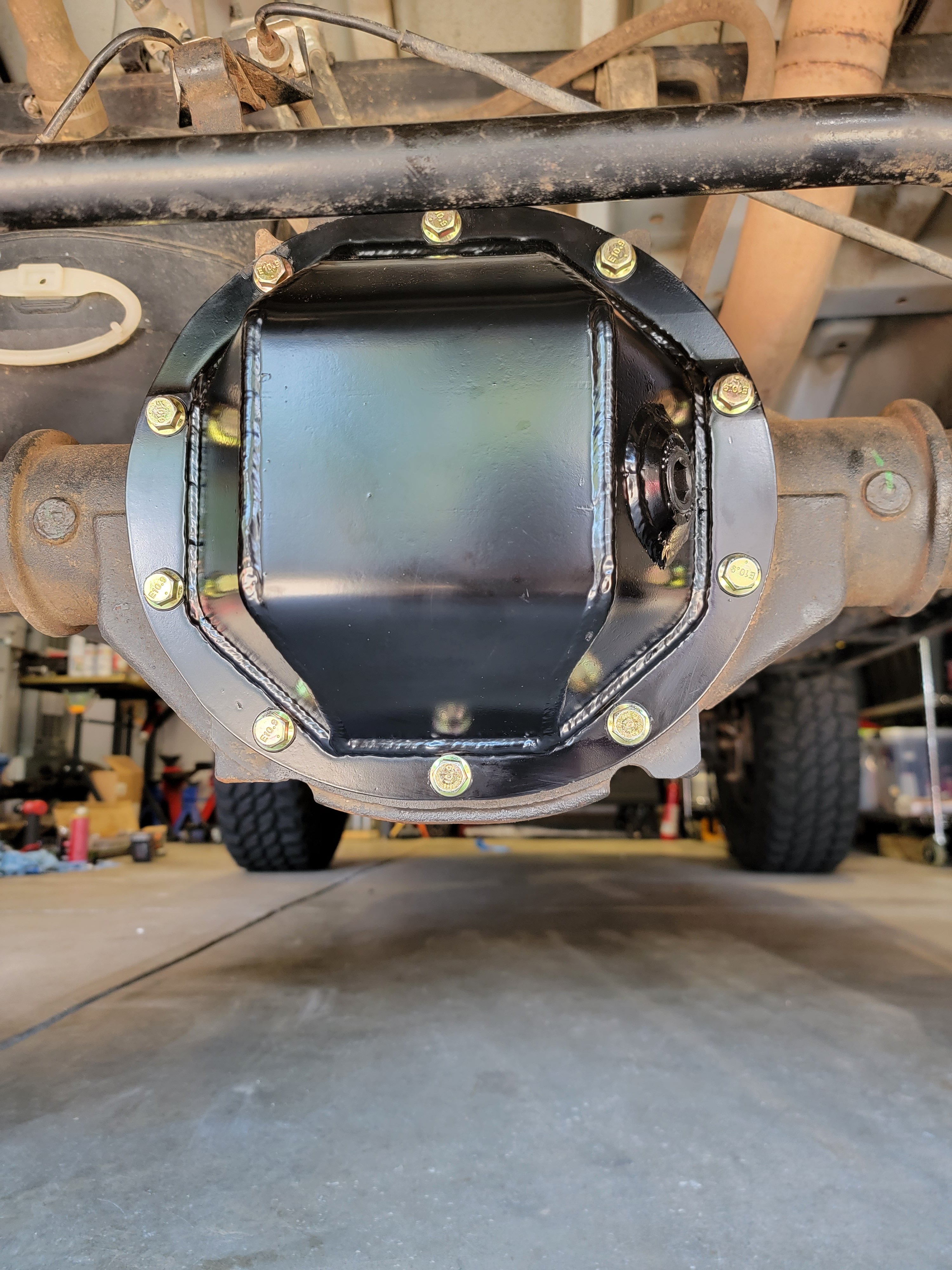

I dented my oem rear diff cover in moab a smidge, so i figured it was good insurance to get an aftermarket heavy duty cover. I got this one from 999offroad.
The website has it with a drain plug. I had them make it without the drain plug since we already have one, plus one less thing to mess up.

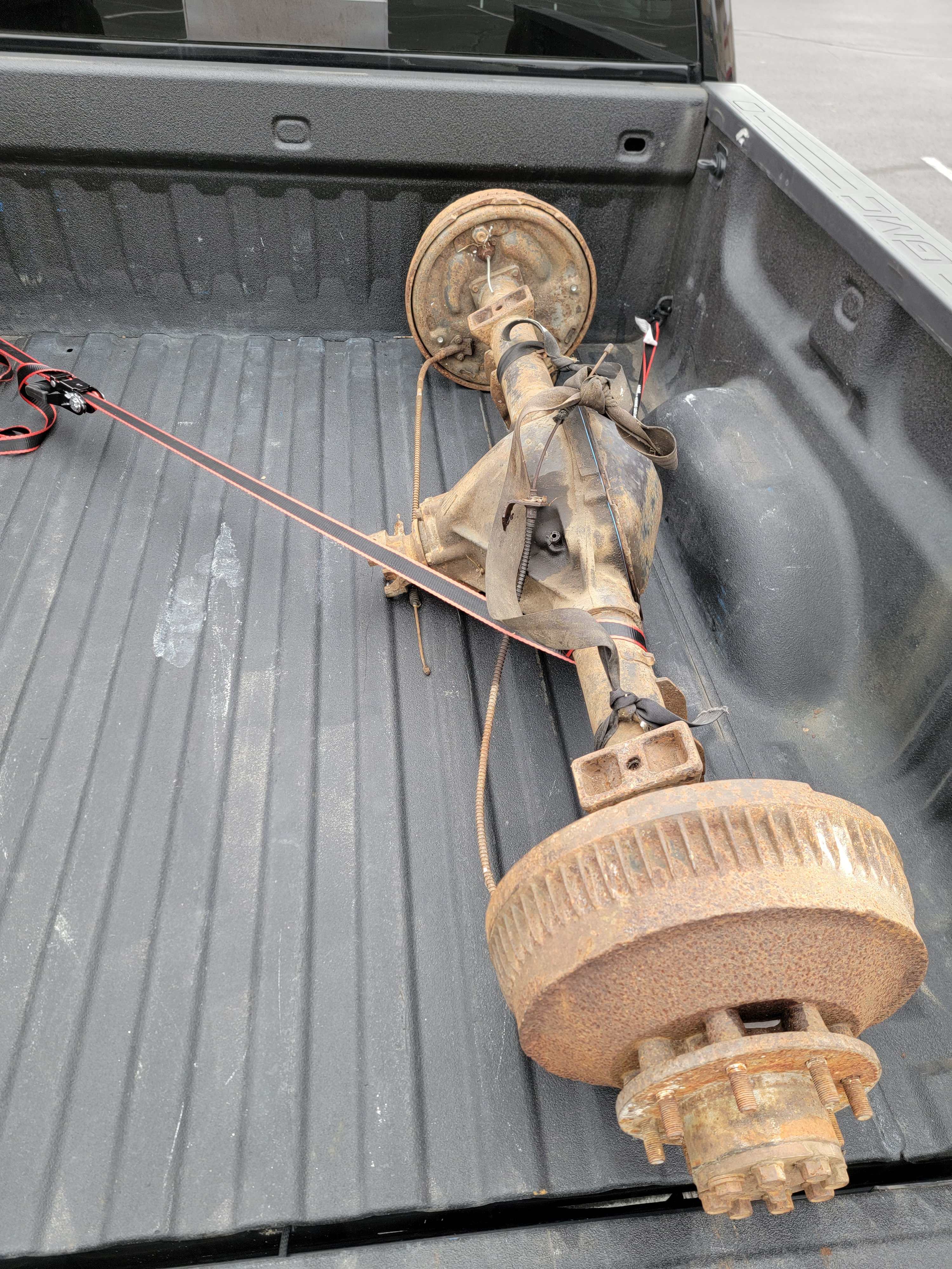

Haven't done much with the h3 since moab. Replacement some stripped out spindle studs and went wheeling at AOAA.
Outside of that I did snag a 14b full float rear axle to compliment the dana 60 front. I'll begin working on swapping the axles in the late spring.
