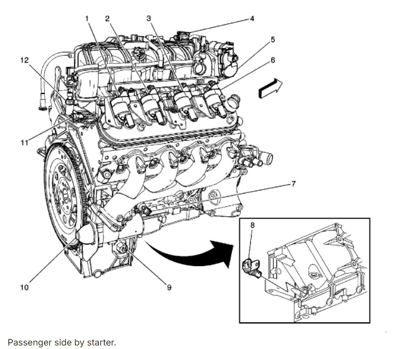

HI! My truck is an 2010 H3T Alpha - Does anyone know of a diagram showing the location of the Crankshaft Position Sensor on the 5.3L? Or the location of the part I need to check/change?

Thank you! Yes, I watched that video, took some still pics from the video, but when I crawled under my 5.3, it looks different underneath, this video may be a 3.7. Thanks so much for the suggestion.
if you end up needing to replace it down the road, you do have to pull the starter to get the sensor out. I learned that the hard way.
