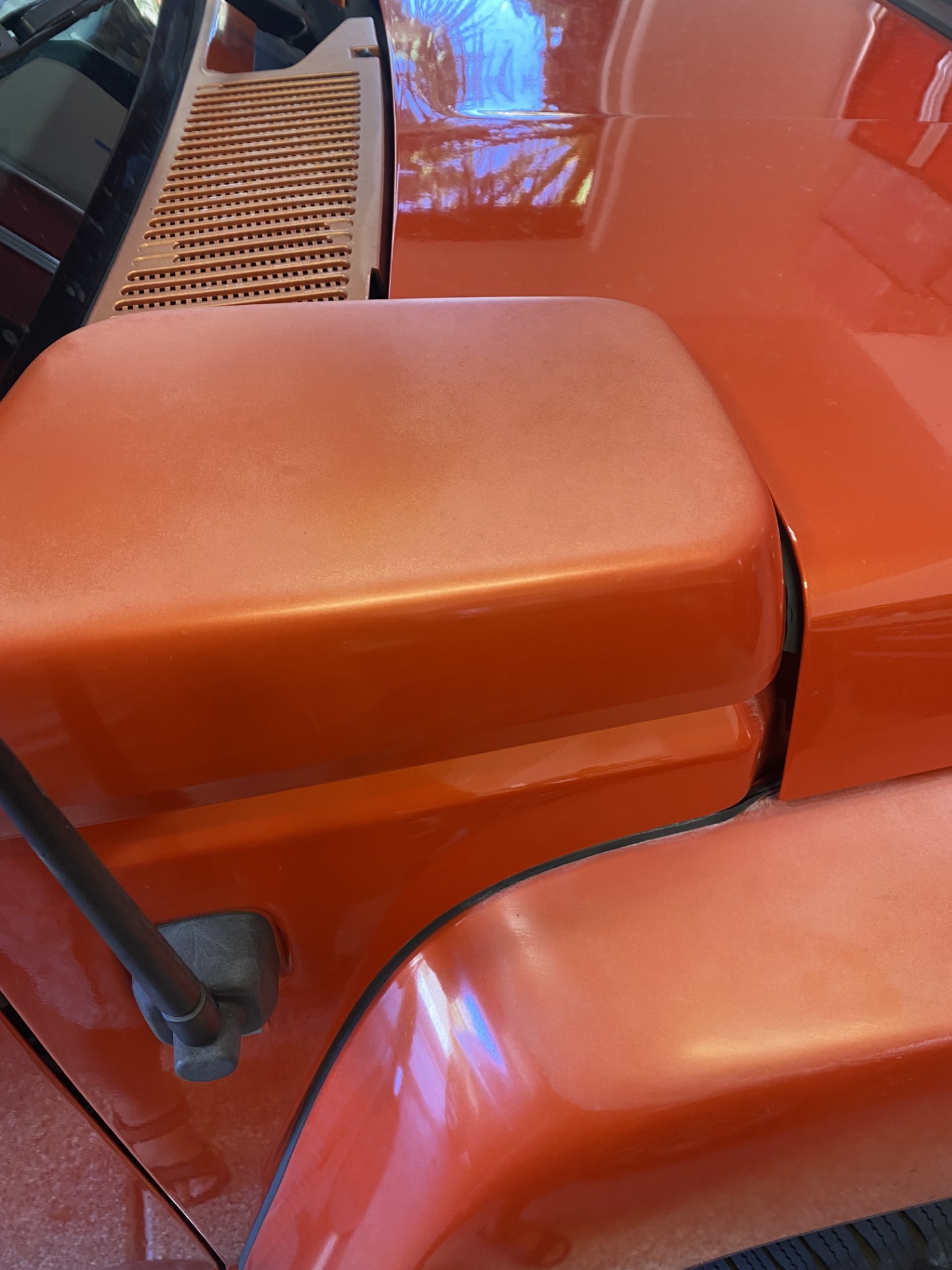

Just updated to a newer H3, a 2008 Alpha. It is orange, but the plastic parts (fenders, air ducts) are very faded on the flat surfaces. Question is, if I paint these myself, do I take it down to the plastic and start from there; or just prep the faded paint and spray over that? Had a paint shop estimate the work at $2300, so thought I might try it myself and see how it turns out. Looking for some experienced responders. Thanks!

Sand enough to remove the clear coat is all you need to do. I've done a couple trucks with Raptor but never paint, will be nice to see your results.

I don't know, no experience here, but these faded surfaces don't appear to have any clear coat left. Can there still be clear coat over this faded paint, and if so, how do I know?

If it were me, I’d give these panels a good cleaning and use a light grit 3M scotchbrite (grey) to prep the shiny areas for clear, lightly getting the “faded” areas but not too much. A wipe down afterwards with a wax and grease remover will initially show you close to what it would look like sprayed with clear. Use a good adhesion promoter before spraying the clear.

All good input, much thanks! Four fenders = four potential test areas. I have a spray can of the correct paint, as well as base coat and clear coat. I'll give it a try and post results here.
