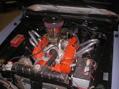

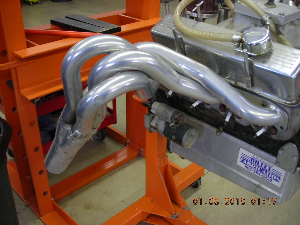

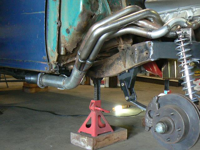

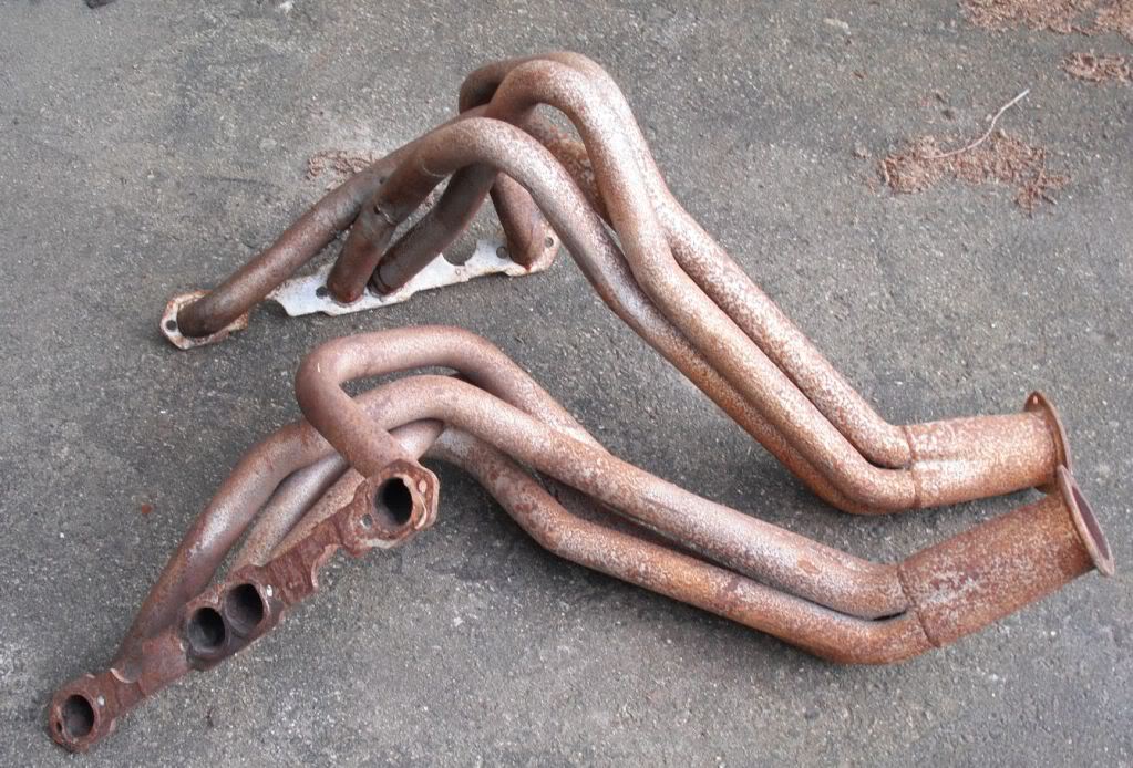

Have you considered some fender-well type headers? Ones like the old Chevy II's and 55-57 Chevys ran? These would route the exhaust over the top of the frame rails and dump behind the inner fenders and in front of the firewall. You don't see them much on 4x4s but, it looks like your FJ could really take advantage of the extra space. You would gain so much space underneath if you could get the exhaust out of there...the 3-link would be no problem. I Googled some pics to show what I'm talking about...
You can find these at swap meets, and I even think Jegs sells a generic fenderwell header. Whatever you get would probably need some modification but, at least you would have good starting point. Just throwin it out there. Great looking project so far.
