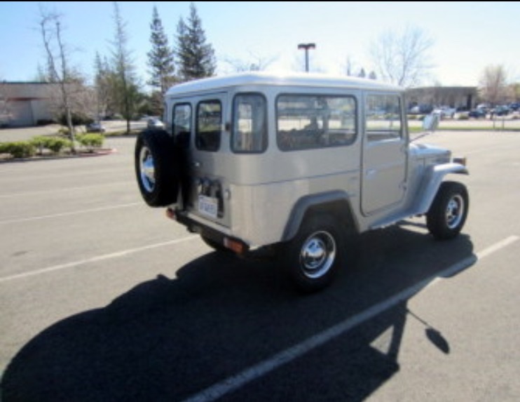

Check it out SBG :woot:
76 FJ40

nice, a good clean example
interesting, the marks for the high-steer arms are stock on the knuckle
