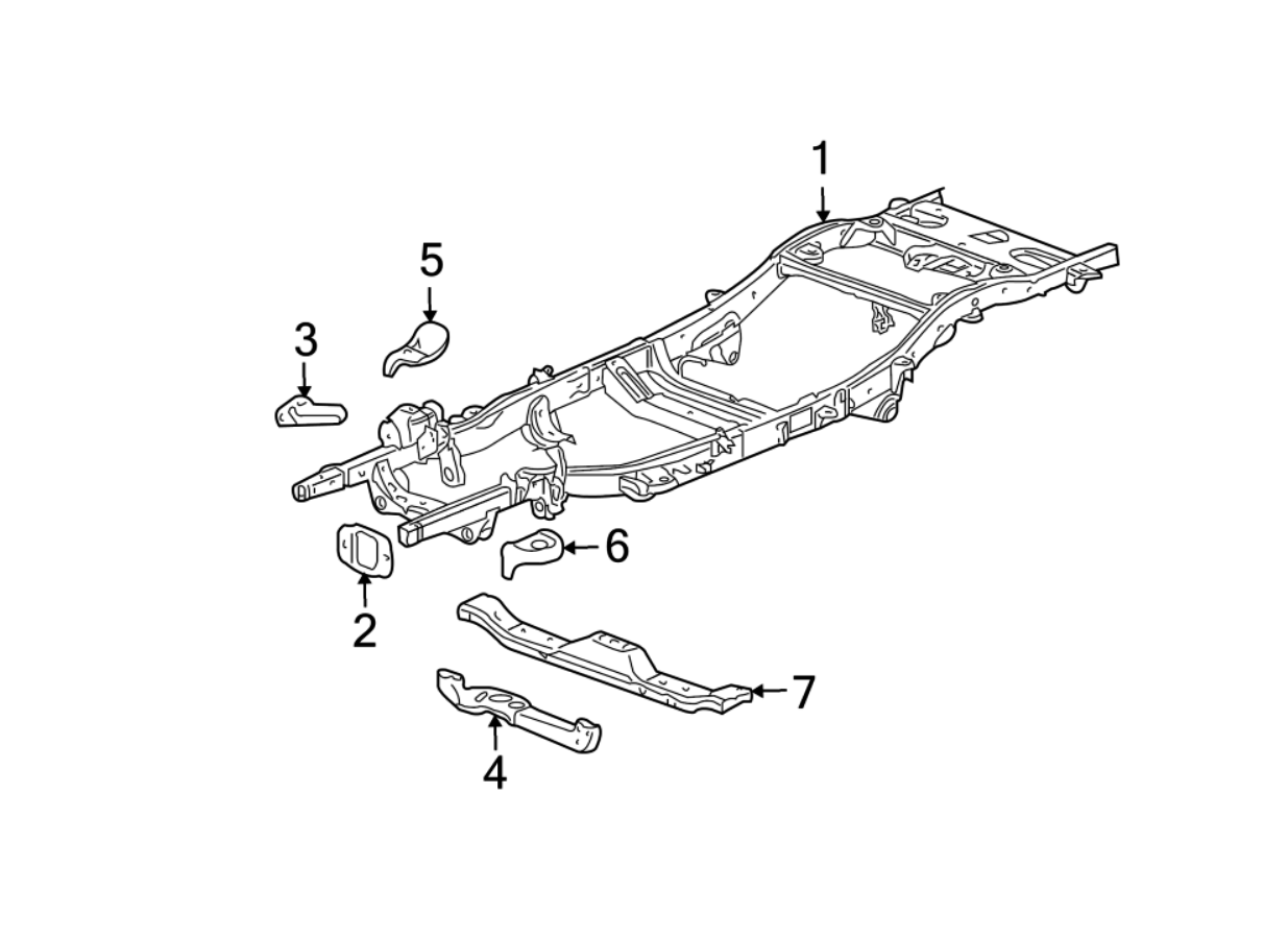

Looking at the GM parts listings, there were 5 different frames for the Hummer H3,
#19256809 - 2006-2007 3.5 & 3.7
#19210038 - 2008 3.7 - all
#19210039 - 2008 - 2010 Alpha
#25841058 - 2009 - 2010 Alpha
#25841059 - 2009 - 2010 - 3.7 all
The replaceable frame components fit all the frames, so the differences must be in the motor mount support locations and possibly the transmission cross member mounting location. It is interesting that they list two updated frame part #'s for 2009 - 2010, 1 for Alpha, and 1 for the I-5, and yet Pt#19210039 is good for all Alpha's 2008 - 2010.
Most likely there is something unique about the 2009-2010 frames that support the H3T version.

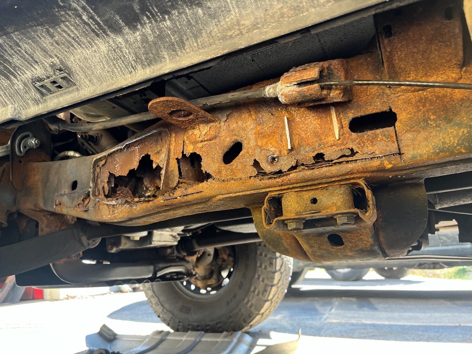

I purchased a body mount bracket from Summit Racing for $100. Here's a picture of the rot behind the old bracket.

Sbc350's comment "Your welder should be able to fabricate a perch for the body mount. Pretty straight forward." is a good assessment. However, you must have something to actually weld-to! My experience with patching H3 frames is that you just keep blowing holes thru rotten metal every time you try to weld-on a patch. You end up going further up the frame to find solid metal that can accept a weld, and sometimes you simply run out of real estate. All the rotten frames I have seen, seem to be consistently rotten. That is...they are rotten everywhere.
Swapping a frame is a huge ordeal but, I know a local guy here in Indiana that is doing it right now. He has access to a four-post lift, and he sent me some photos of the body suspended up in the air. Roll the old rotten chassis out from under it...roll the new rust-free one in. Sit the body back down. Simple right? Haha...wishful thinking! Like most projects...you always end up finding more work than originally planned for. His intentions were just to replace the frame but, the donor frame is from a 5-cyl and the rotten frame is from an Alpha. Because of this drivetrain difference, he also has to swap out the exhaust system, motor mounts, and axles (due to the difference in gearing). I personally like the idea of using the 4.56 axles already in place under the rust free 5-cyl. chassis. But, that would mean giving up the cast-iron front diff under the Alpha...so that's a judgment call on which he thinks is more important (gearing or housing strength).
