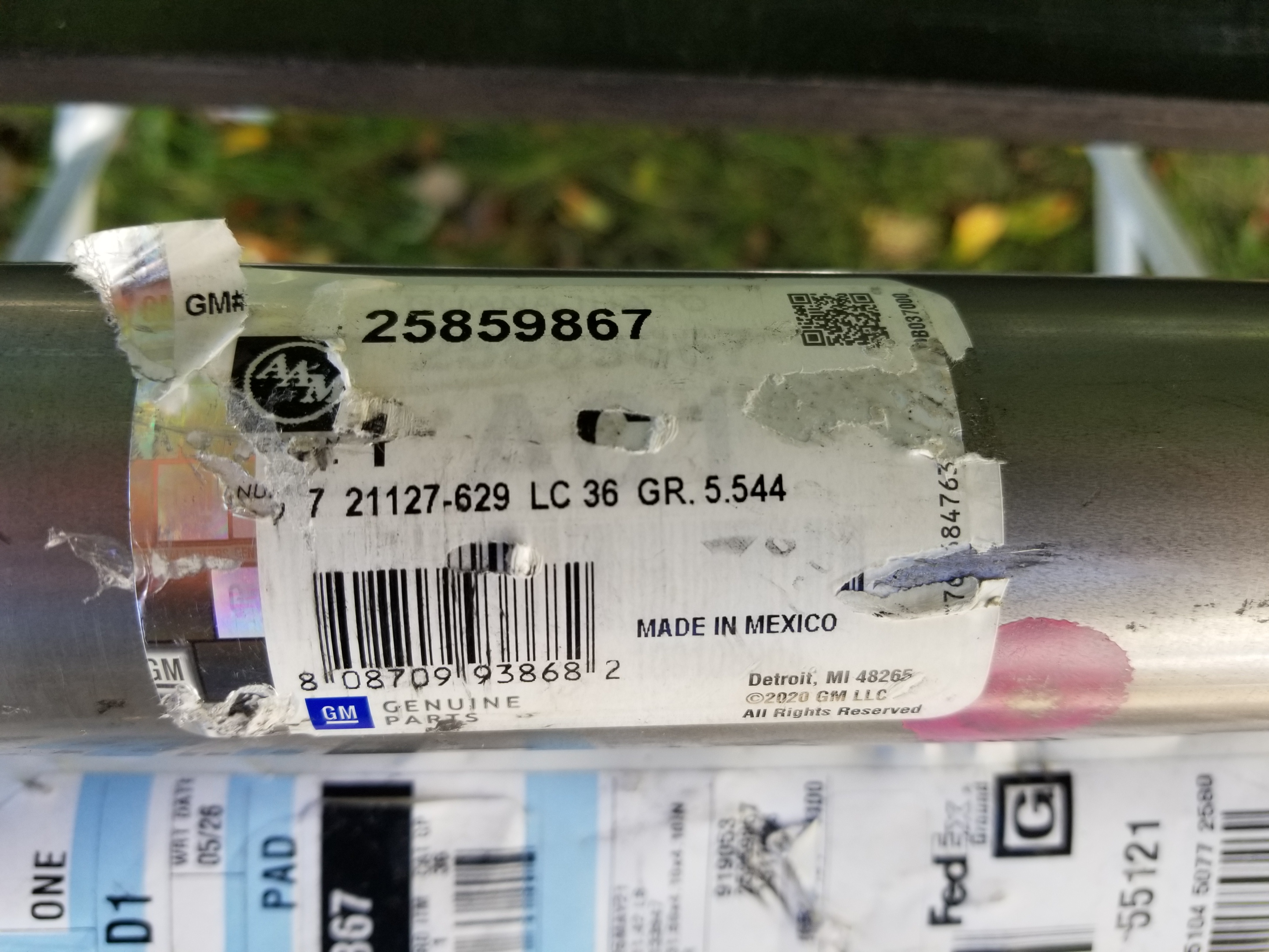

If I had to guess, they'd be made by AAM. American Axle & Manufacturing. They do a lot of OEM for different mfgrs. I know for sure my GM replacement F driveshaft had an AAM sticker under the Delco sticker. I suspect the front axle bearing/hubs were AAM's too. But I don't have any proof of those.
