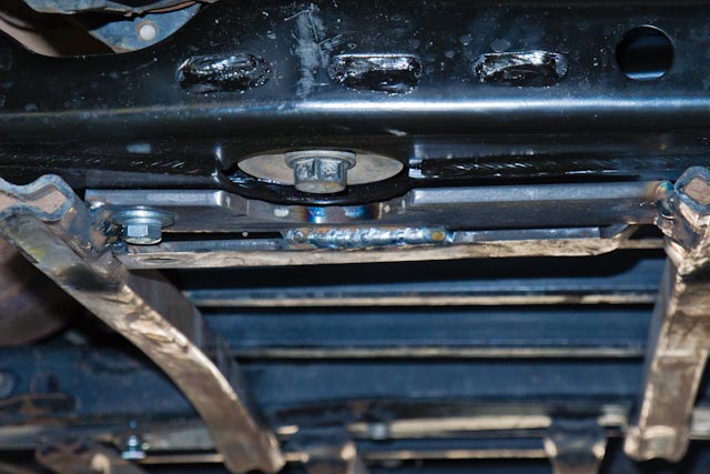

Somewhat related is the missing UCP tab on the new crossmember. Evidently they changed the UCP design at some point so that it mounts directly to the crossmember. Easy fix is to weld a plate into old style UCP. I can upload photos if anyone is interested.
Yes, please & thank you.
AZtraveler
33
Here you go. We made a plate and welded it into the front UCP opening - then drilled in line with a threaded mounting hole in the diff crossmember. IMHO it's a better solution than the tab on old crossmembers. (In the interest of full disclosure I got the idea from another forum sometime back ;~))
That's a great, easy way to secure the original version UCP to the new version crossmember. A lot better and stronger than the tab on the original version crossmember. Thanks for the post.
f5, don't you get a clunking sound from it not being secured and tightened down when hitting bumps or ruts in the road? If not, why not - did you clamp it down some other way - because that bolt on that tab was loose on mine and the "unknown clunk" was driving me nuts but went away after I tightened it.

F, don't you get a clunking sound from it not being secured and tightened down when hitting bumps or ruts in the road? If not, why not - did you clamp it down some other way - because that bolt on that tab was loose on mine and the "unknown clunk" was driving me nuts but went away after I tightened it.
No clunking. All the tech did when he replaced it was to bolt the two skids together where the tab used to be. We even did Top of the World and that trail has quite a few ledges and if there was a way to get a clunk out of it, that would be a trail to do it on. And I'll add, I slammed down on that skid a few times with no problems.
Only clank I have is the rear left, and it has been there long before the cross member was replaced.
