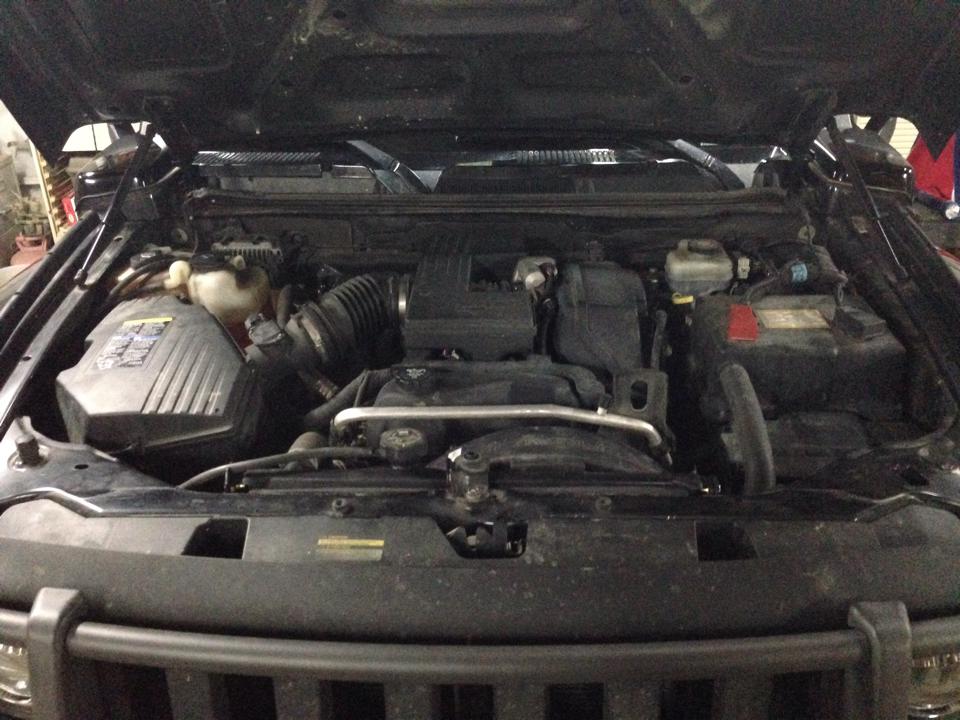

The grill has two sections. To remove the assembly, it's four bolts (two in front, need a ratchet with a longer extension, two on the back) and two nuts, all 10 mm. Then its plastic snaps on the ends into the fenders. Just give a firm tug straight back. The two nuts and two bolts on the back are easily visible when you open the hood and look at the back side of the grill.

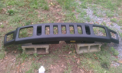

Plasti-dipped
took grille off, put 4 coats on

Looks good, is this recently or ?
That was the first time i did it, ive done it over since then but it looks the same as that now but dirty. i need to find a better way to clean this stuff
