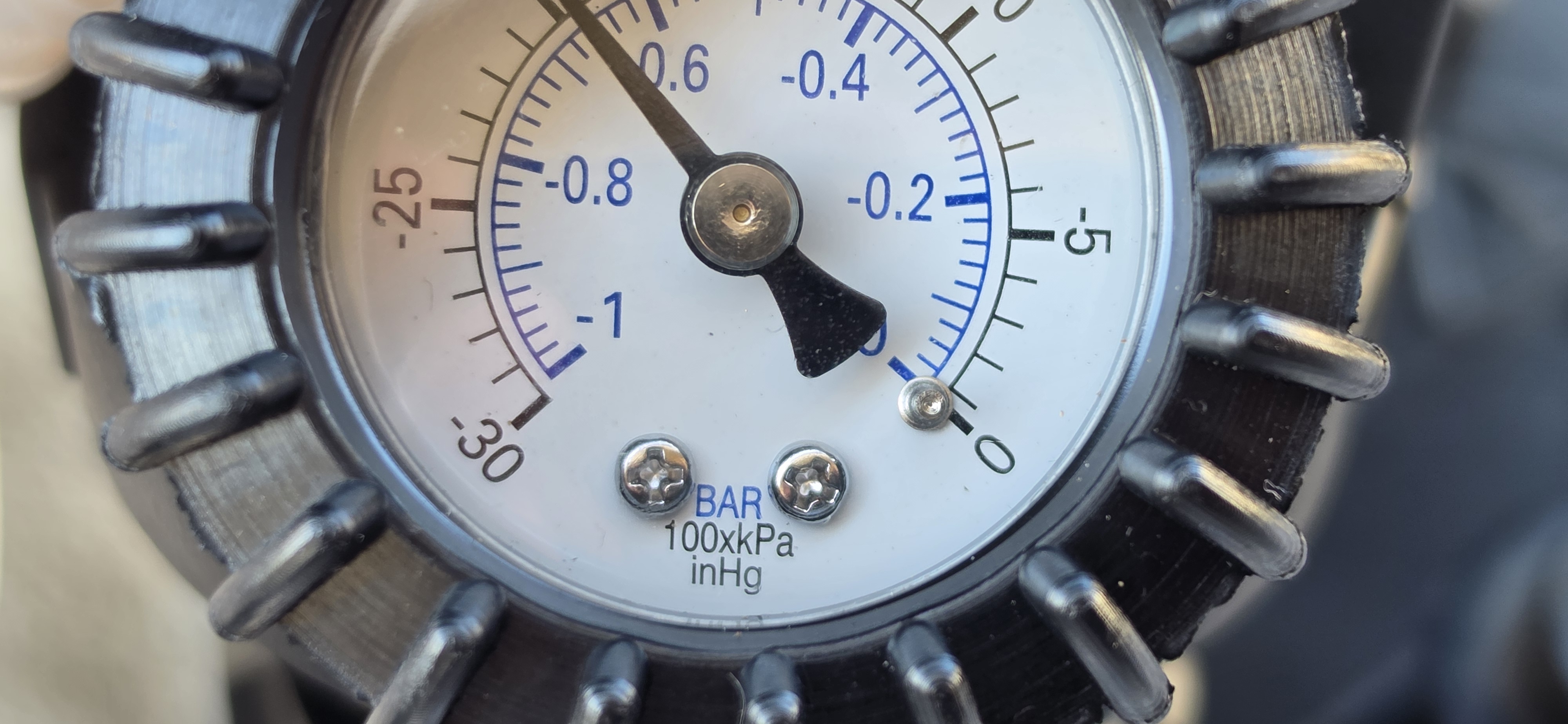

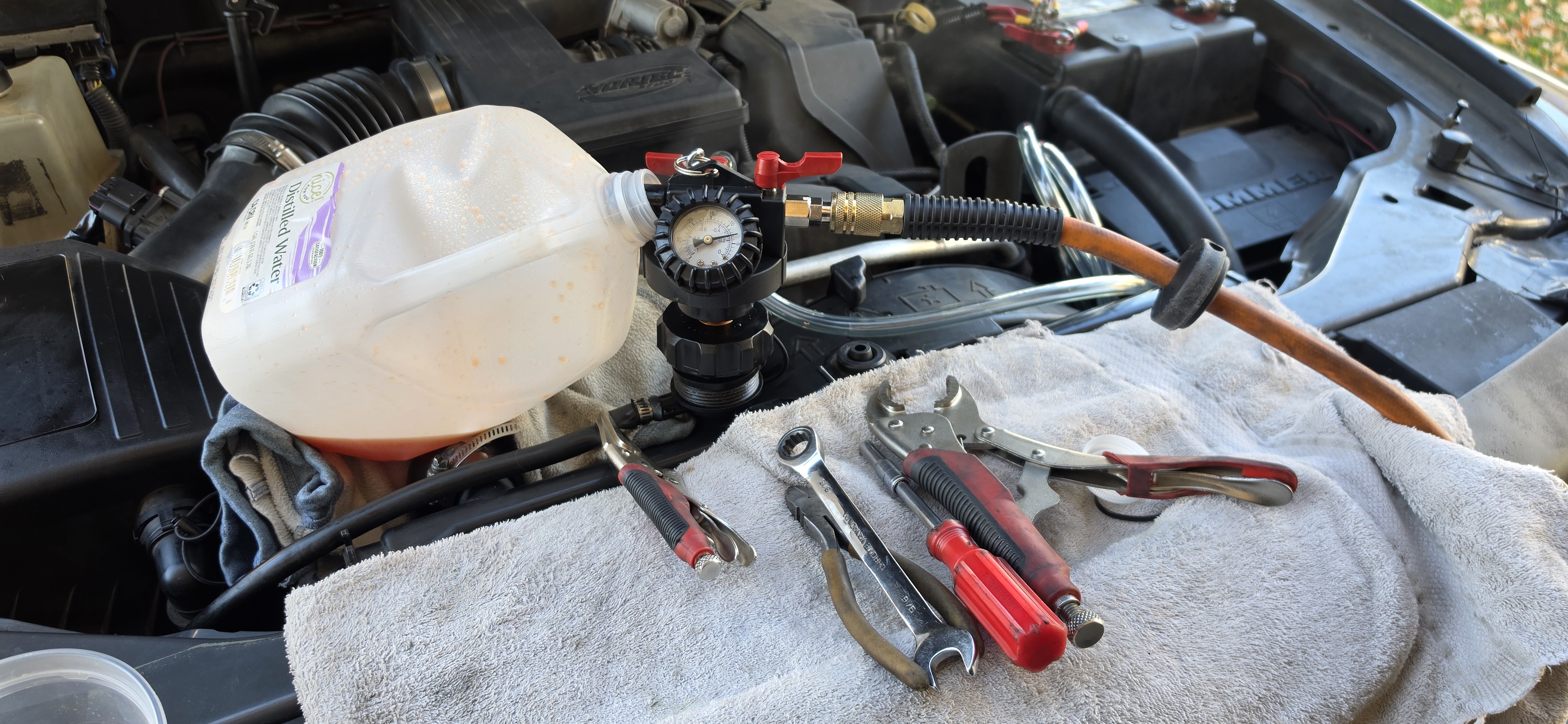

I've tried to burp the system using the radiator cap off method, the lifting the front end method, and now the coolant system pressure test/fill kit method with the venturi assembly. The message still keeps coming up on the dash. When I used the vacuum method, I got the vacuum down to 20 inHg with the compressor connected and running and the lever open on the vacuum assembly. When I closed the compressor lever, it dropped to 10 or so. When I open the coolant line to allow the vacuum to draw coolant in, I have been able to get it to draw in 1/2 gallon before vacuum returns to normal. I like in Denver so high altitude and thin air.
