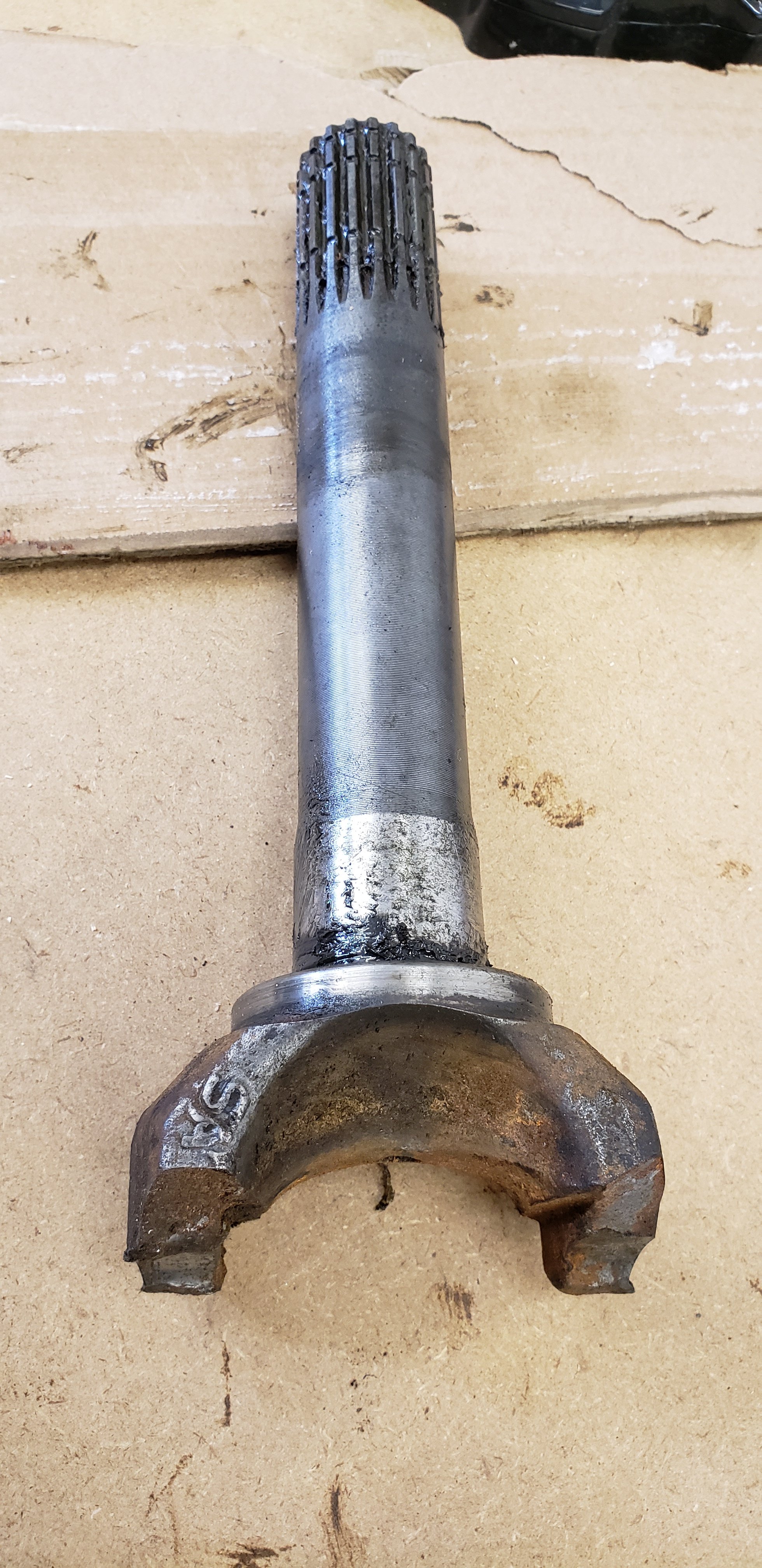

during the first week of covid lockdown I took the family out for a quick spin to the carwash and heard a loud pop from the front end. Turned out to be a outer front axle. Turns out the axle already had chrome moly shafts and joints in it, but whatever vehicle it had come from must have had some power because the other axle shaft was also already twisted. I replace both, thanks to some help from the previous owner and 4speedfunk for parts/advice.

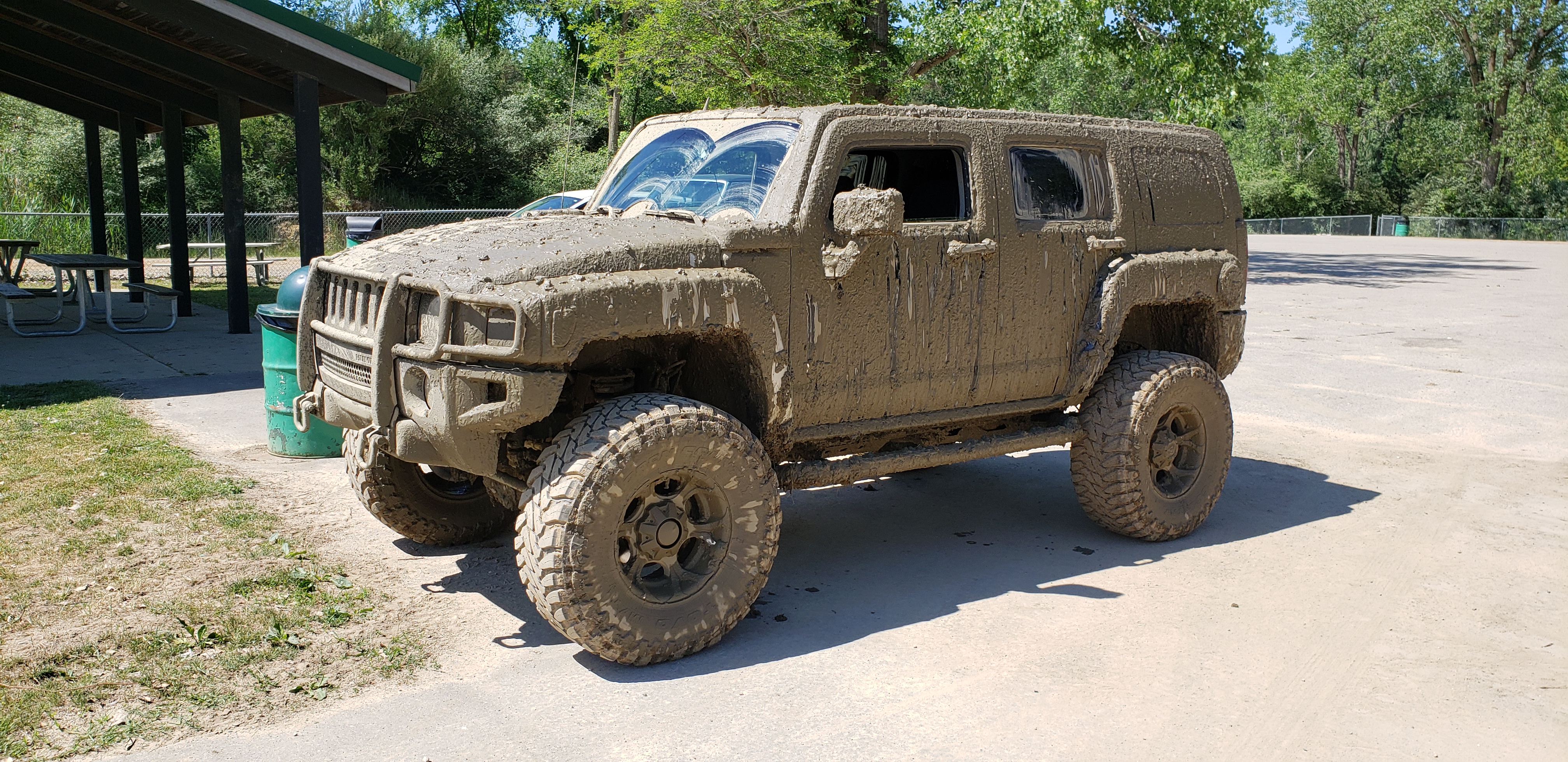

Mounds offroad park, stayed out of the mud until the very end and then it involved 20 minutes of wheel spinning to get out. Took days to clean

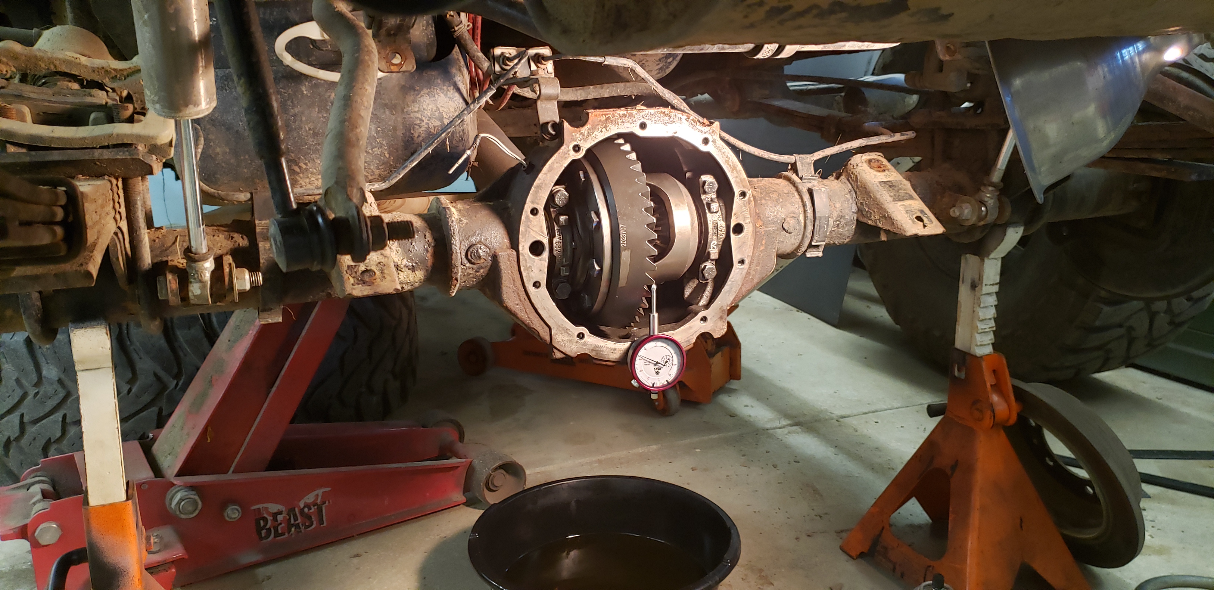

Oem locker install

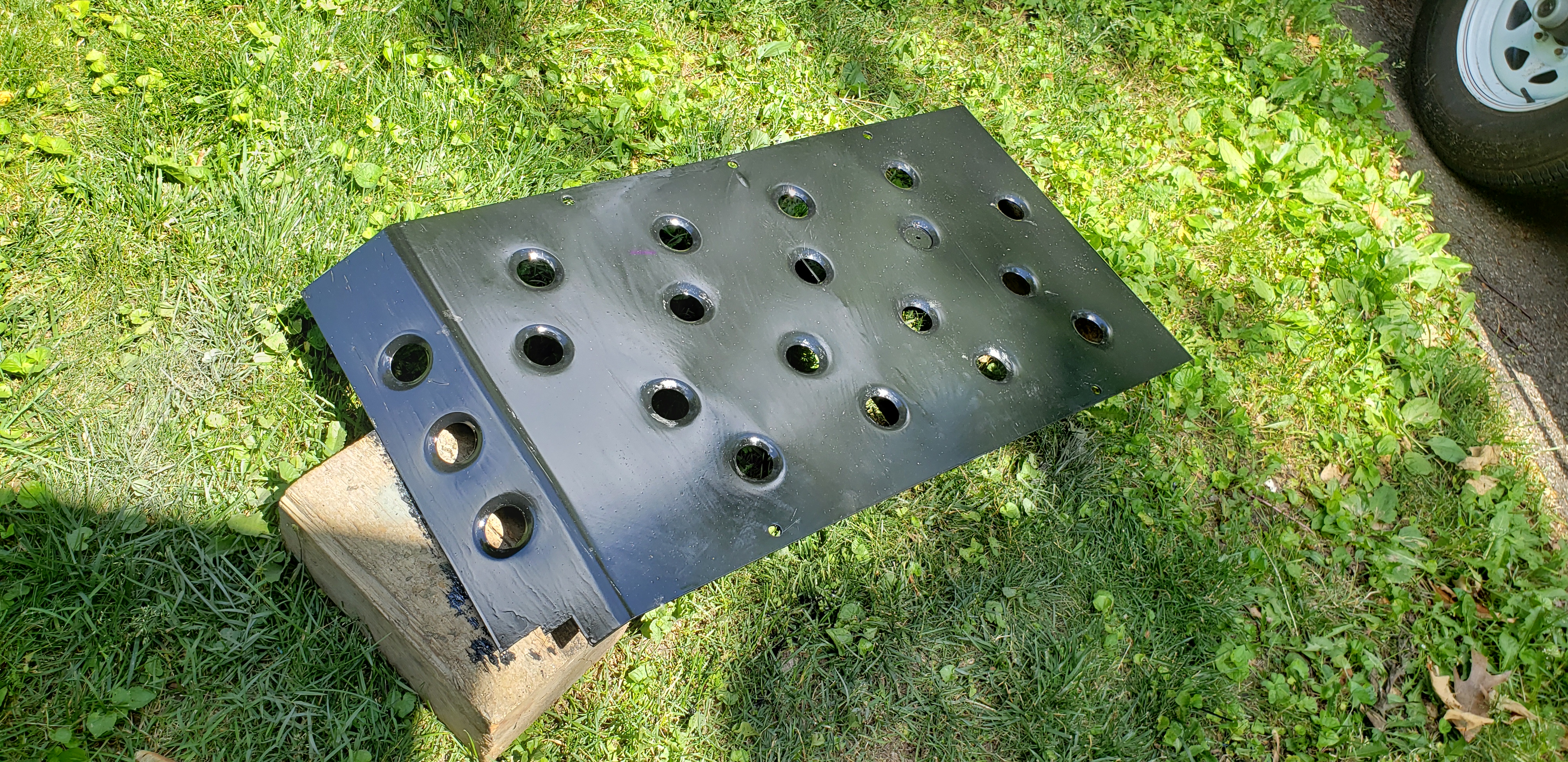

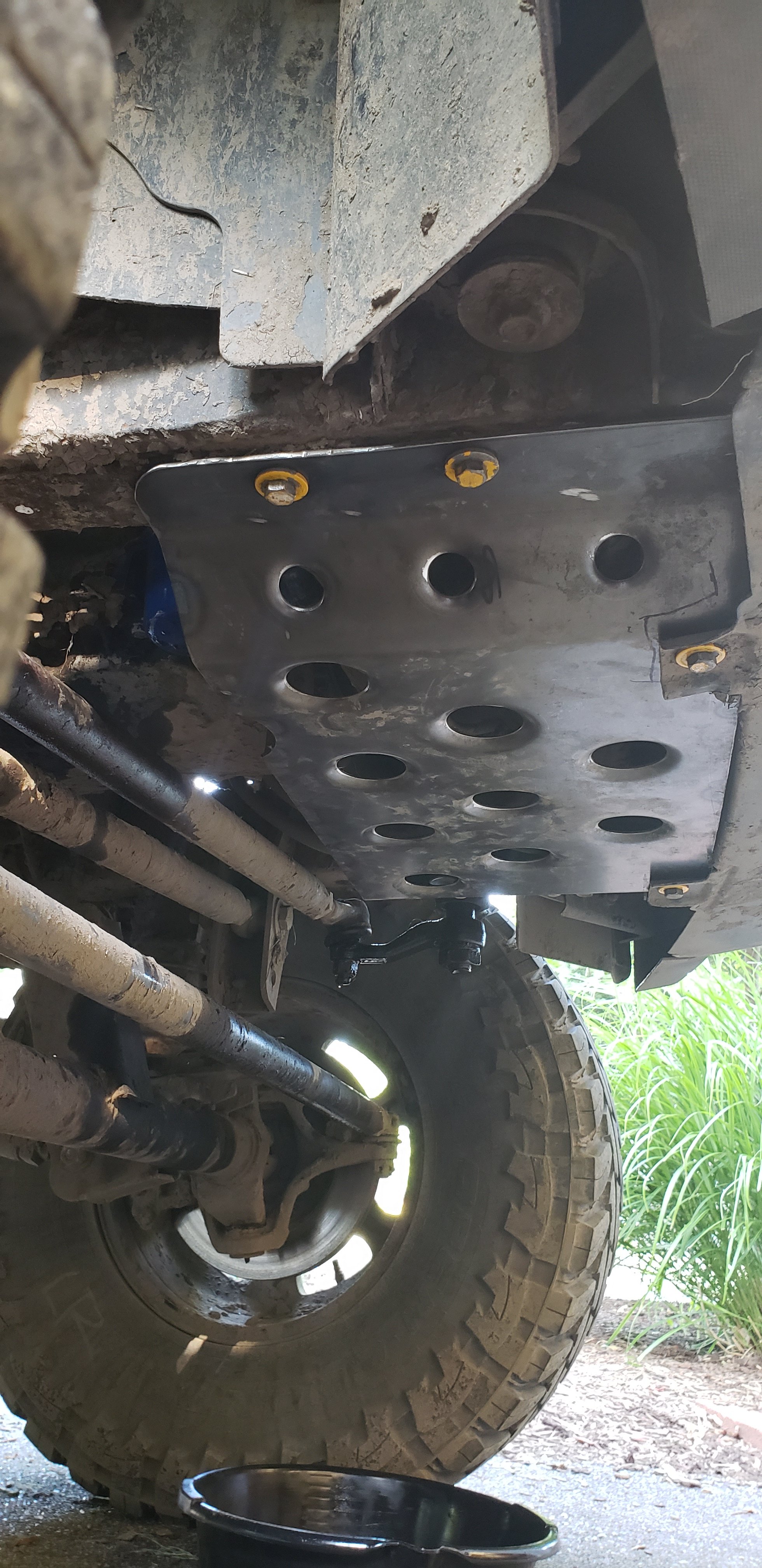

Tcase skid

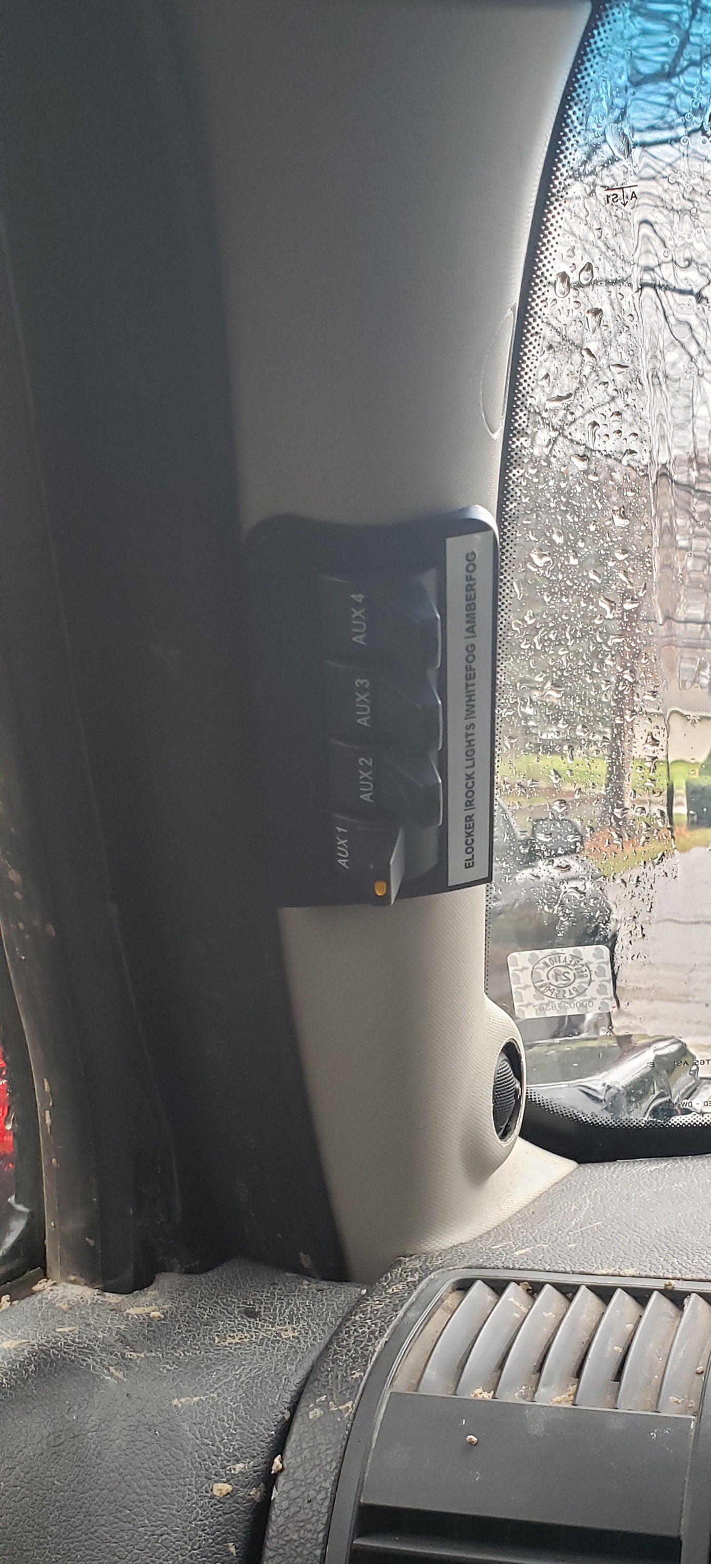

Added some switches for the lights and locker. I like oem style switches and these ford upfitter switches fit the bill. They route to an aftermarket relay/fuse box under the hood. 20201125_203815.jpg

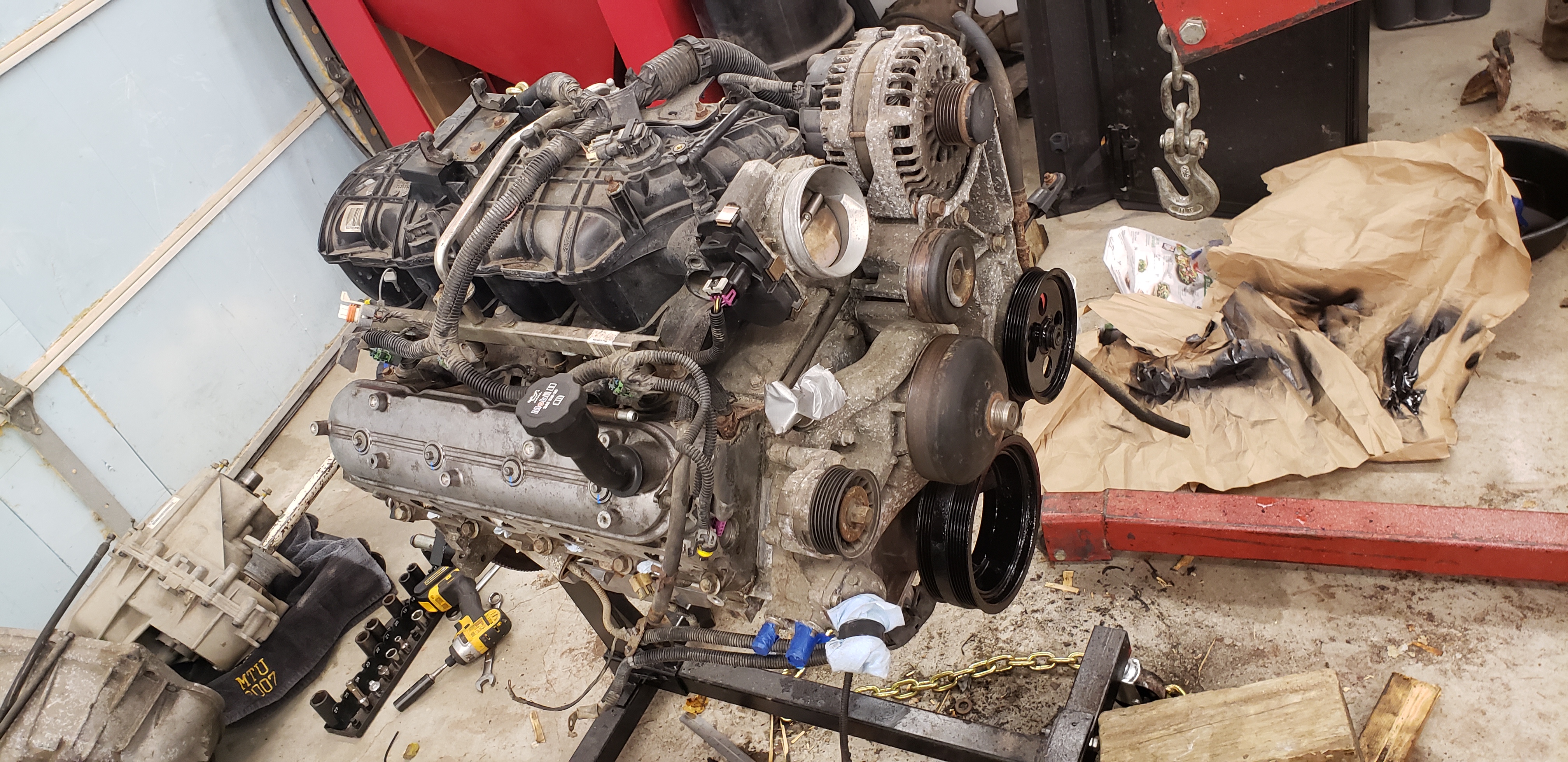

Engine swap is next and I will probably need some help from those of you that have done it already. I picked up a dropout ls2/4l70 from a 2007 trailblazer ss.20201108_061759.jpg

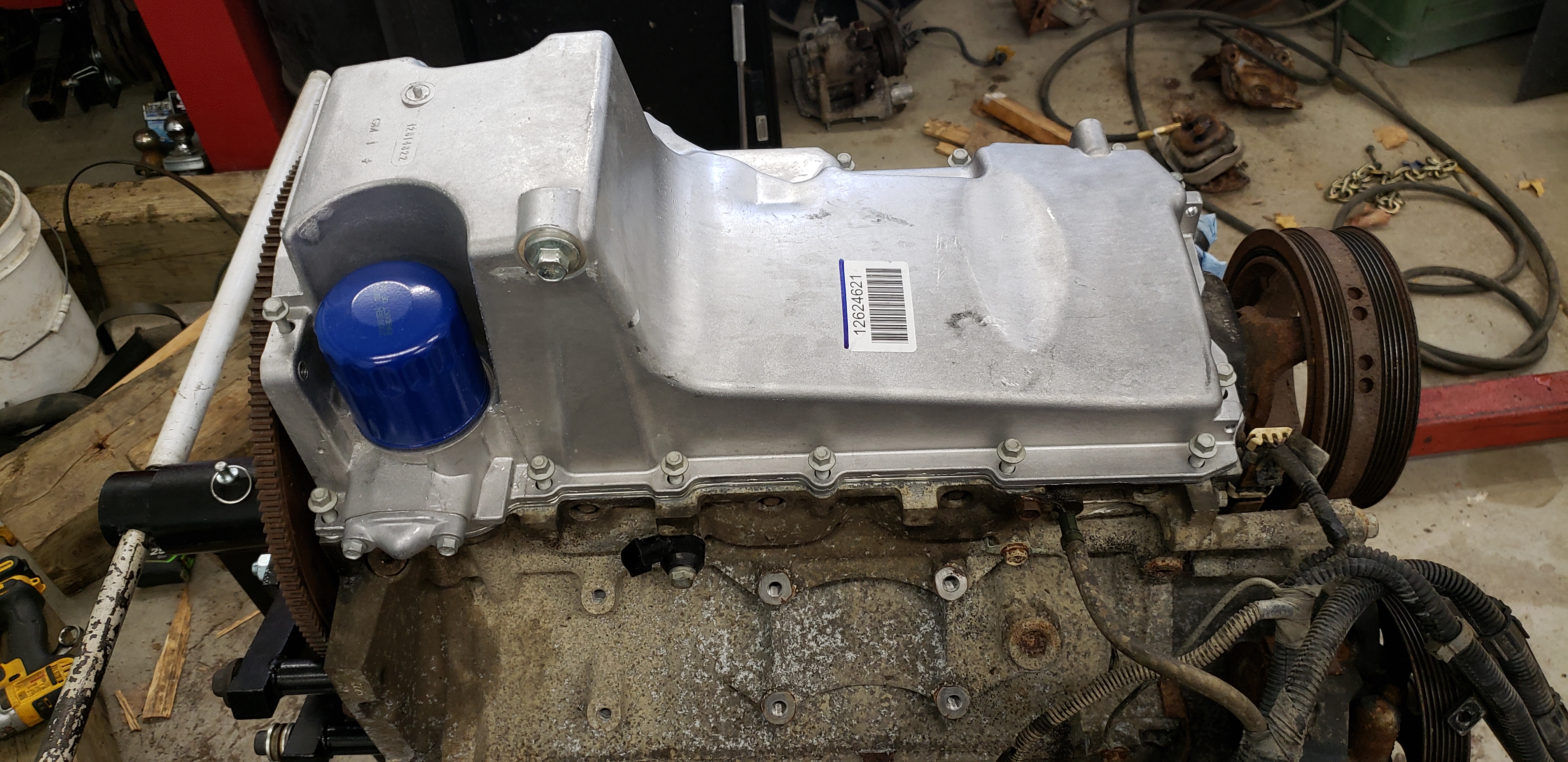

Installed an h3 alpha oil pan, pickup, windage tray, dipstick and dipstick tube.

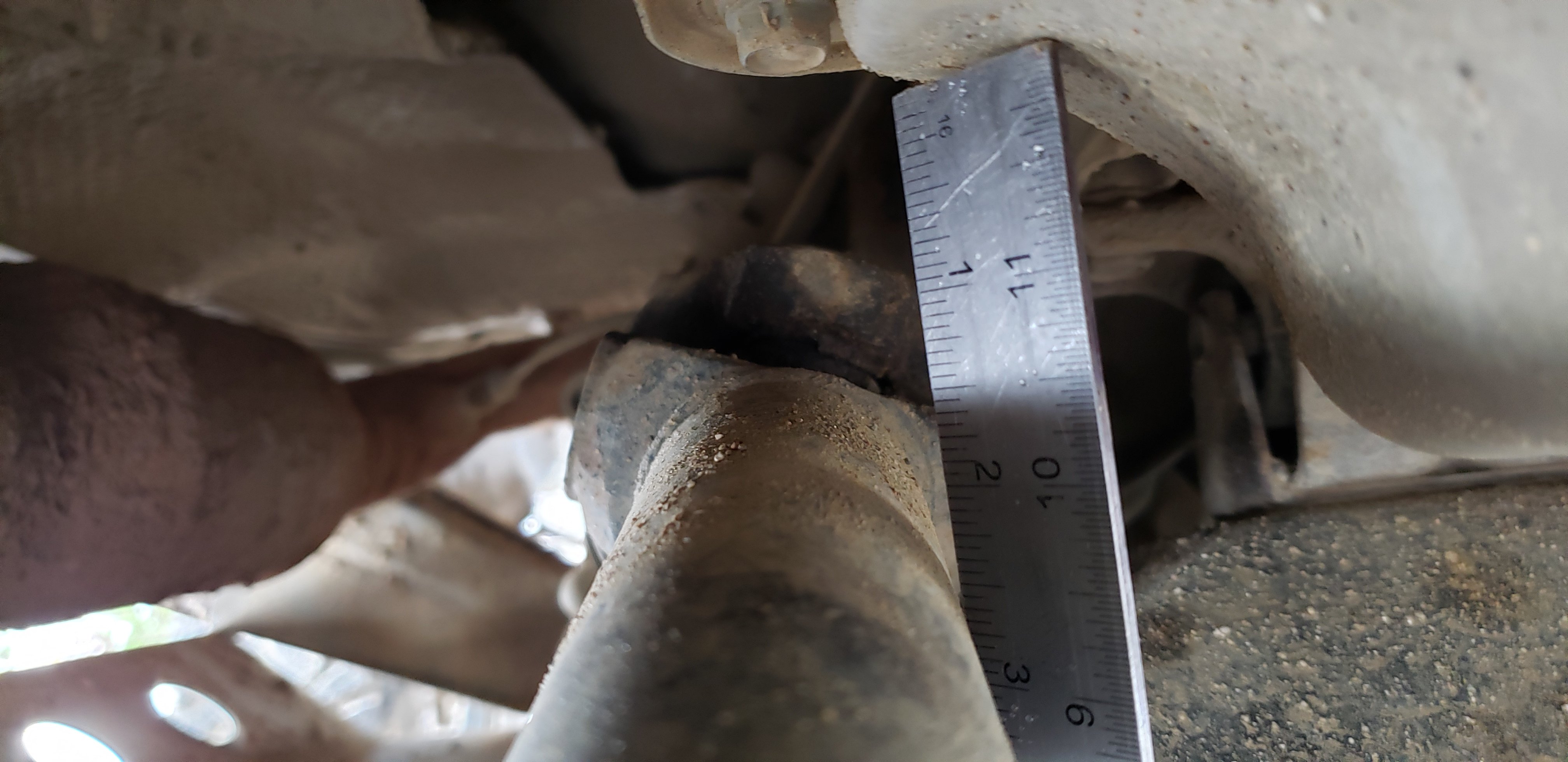

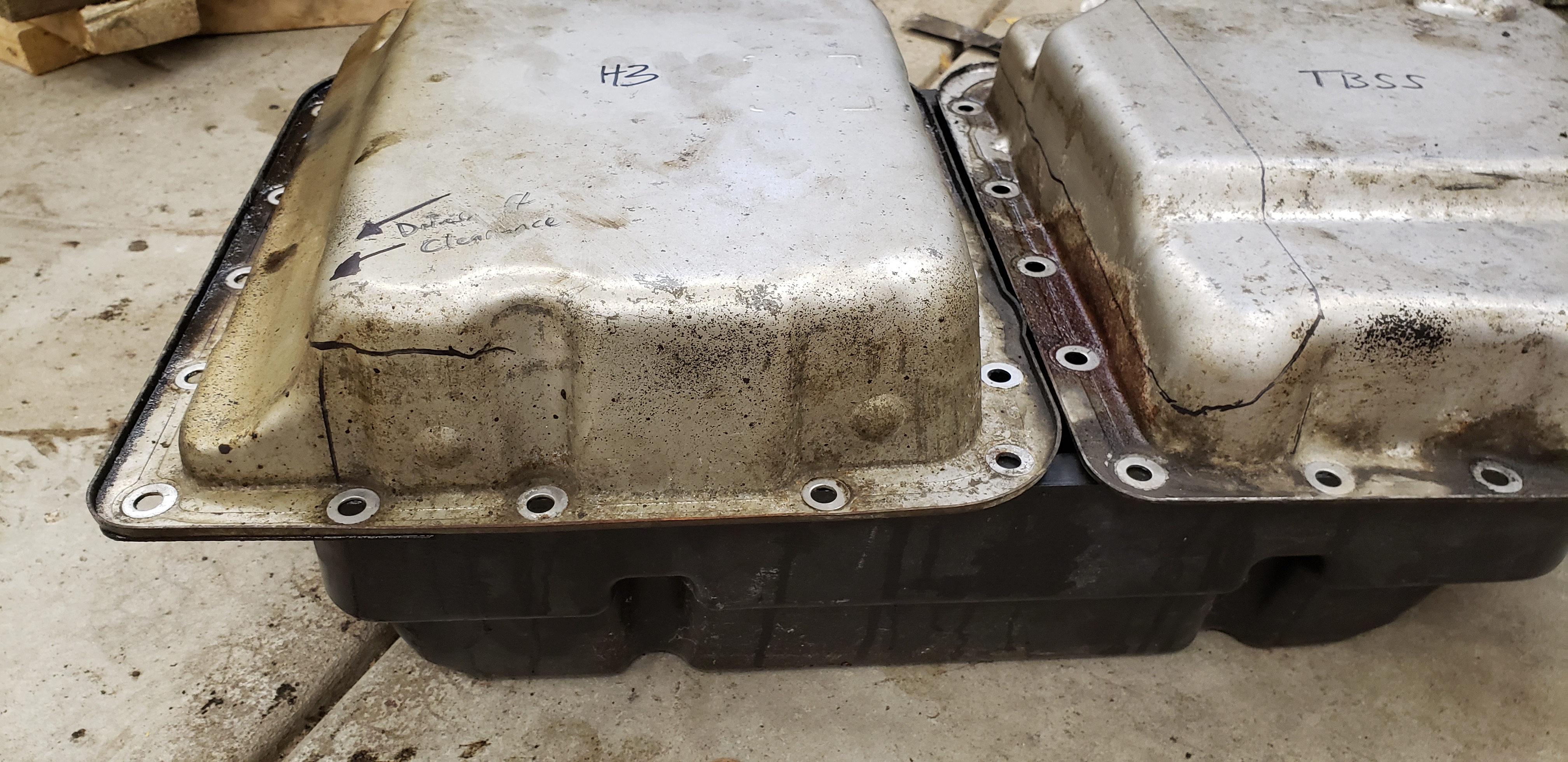

Trans..would like to keep the 4l70 and trying to figure out if i can dent the pan near the driveshaft (i have more clearance than stock due to the sas) or exactly what I need to replace in the bottom end to run the h3 specific pan.20201122_140823.jpg20201122_133612.jpg20201122_133753.jpg

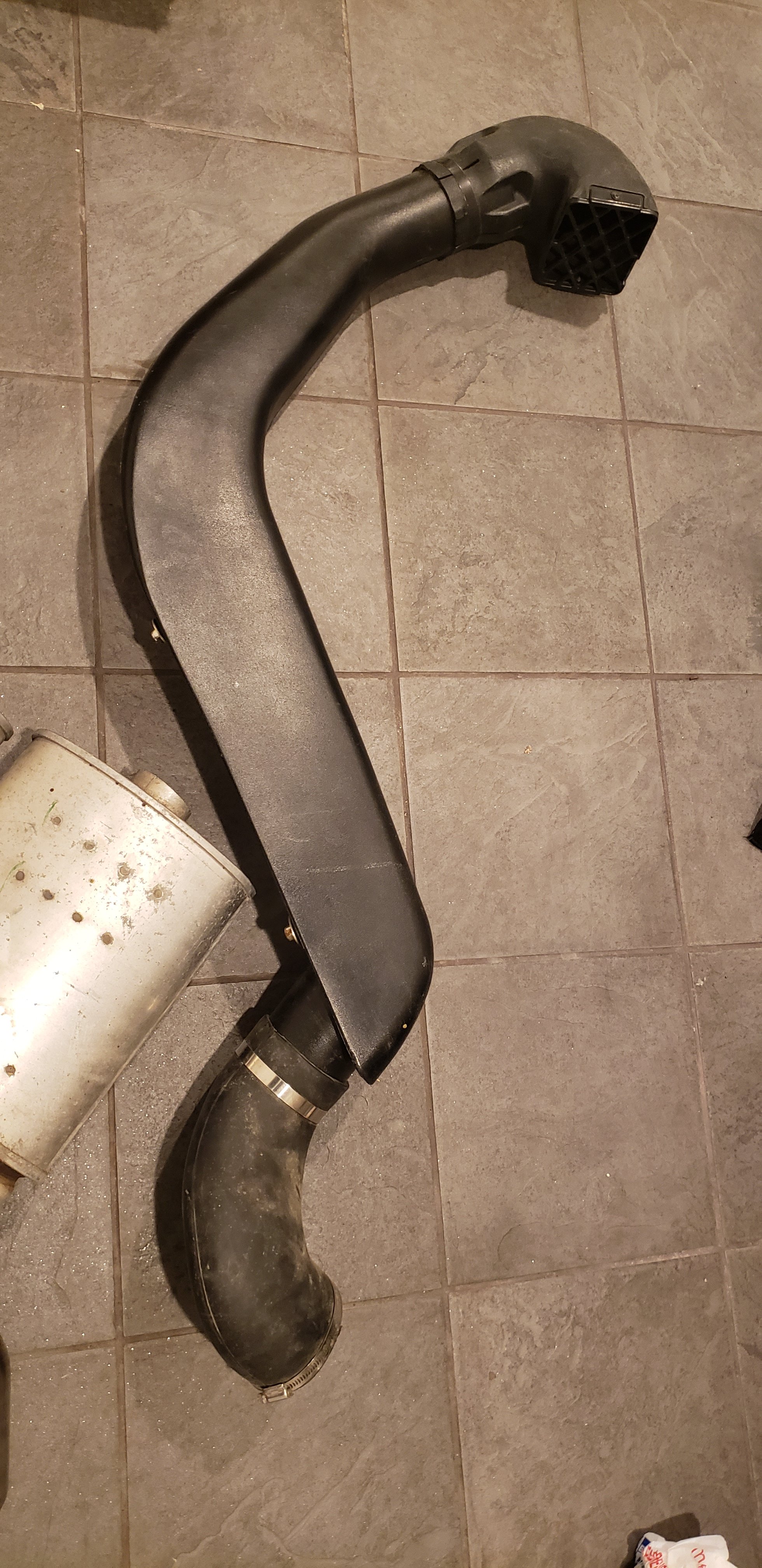

Came across a cheap used snorkle, not sure i am going to use it but I have it just in case20201123_204619.jpg

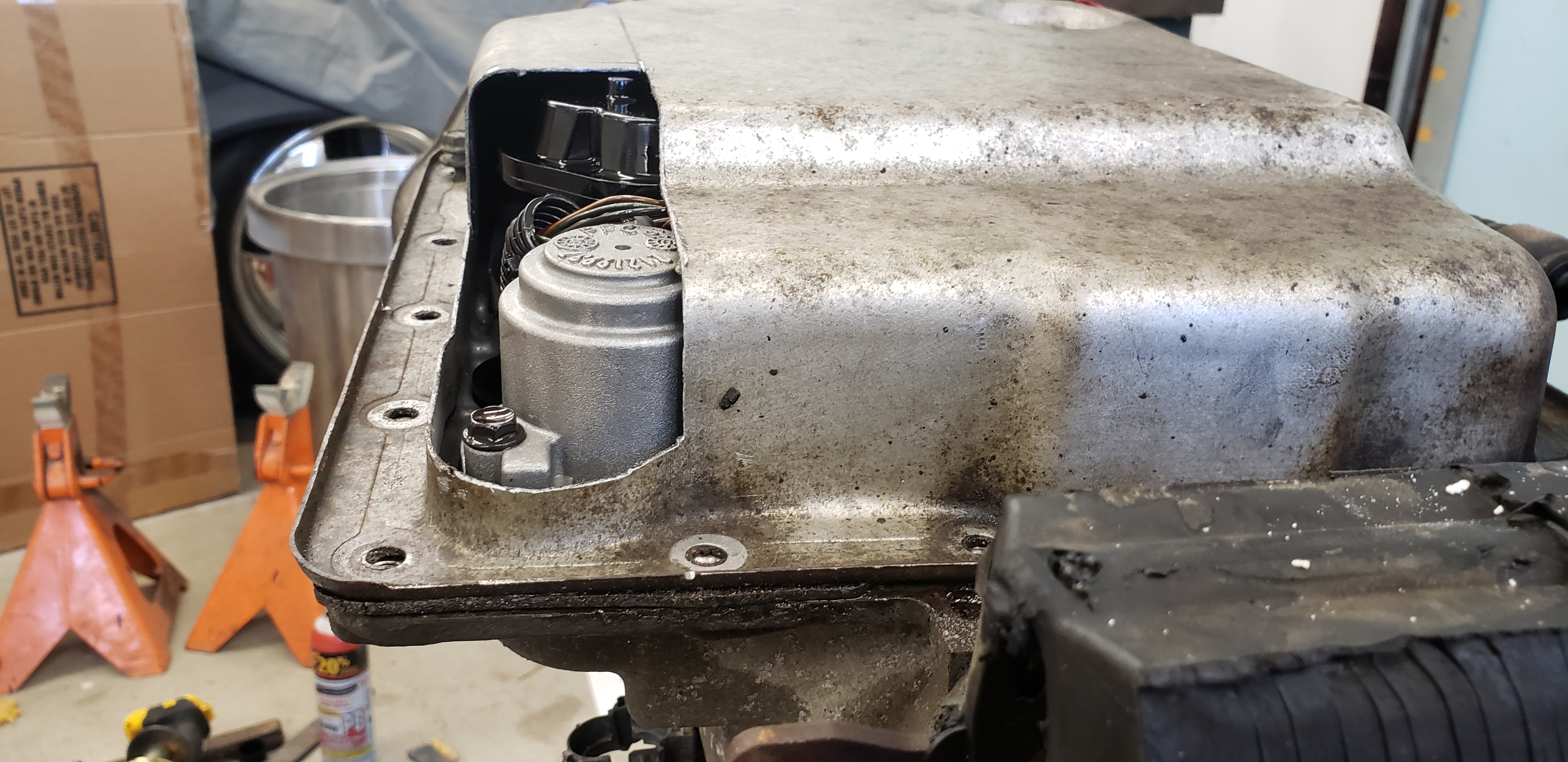

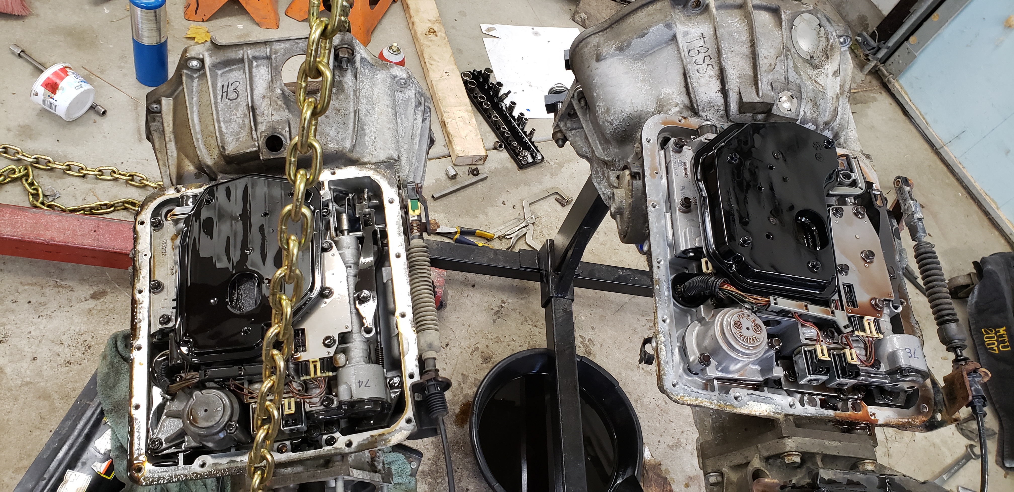

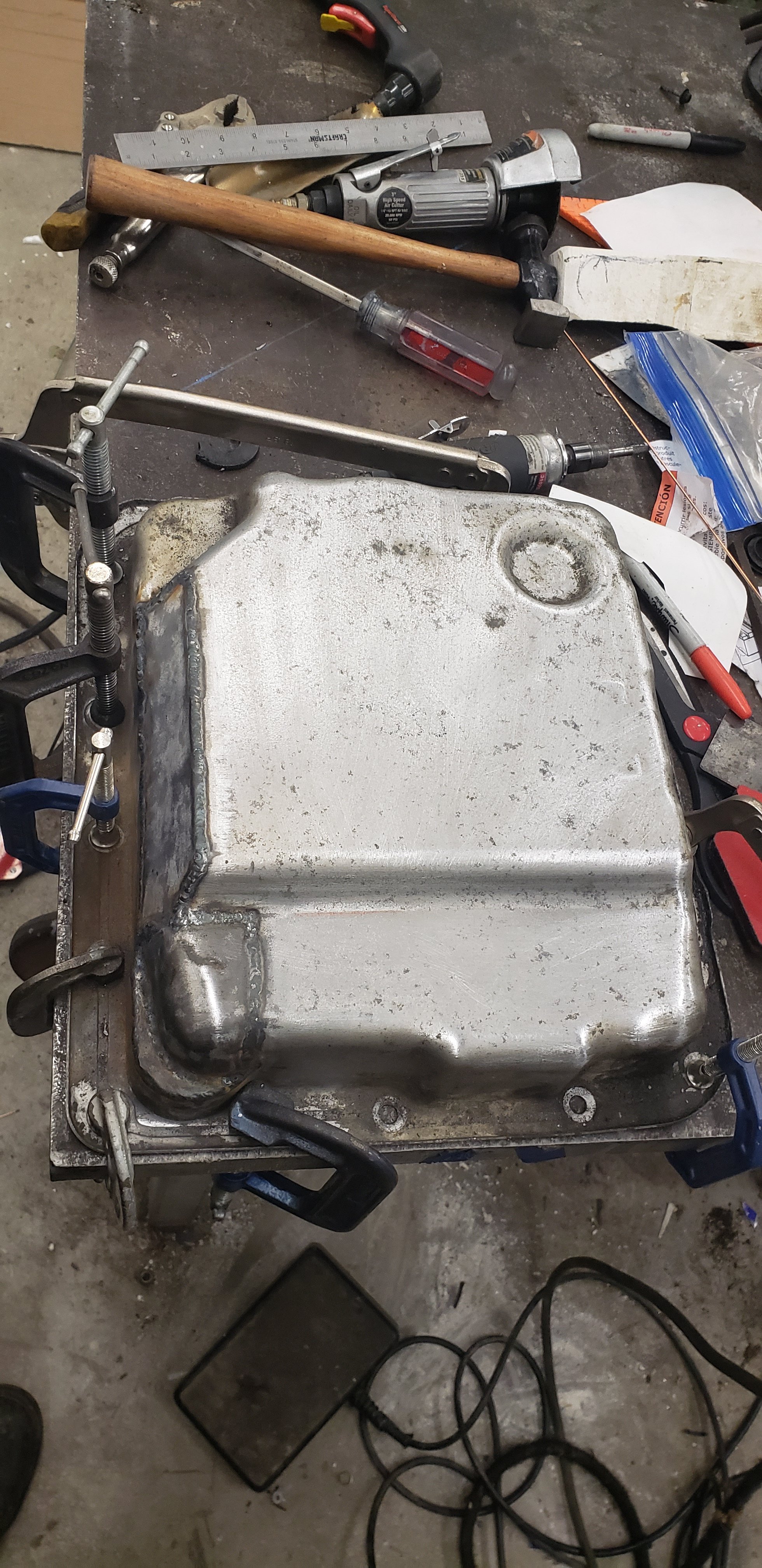

I made a mold of the tbss 4l70e trans pan to check clearance to the h3 driveshaft. It was close but I decided to play it safe and clearance as much as I could from the stock pan without modifying the internals. I ended up running the h3 specific filter but otherwise stock 4l70e parts. Still crossing my fingers it won't have any clearance issues but it will be hard to tell for sure until I get it all installed.

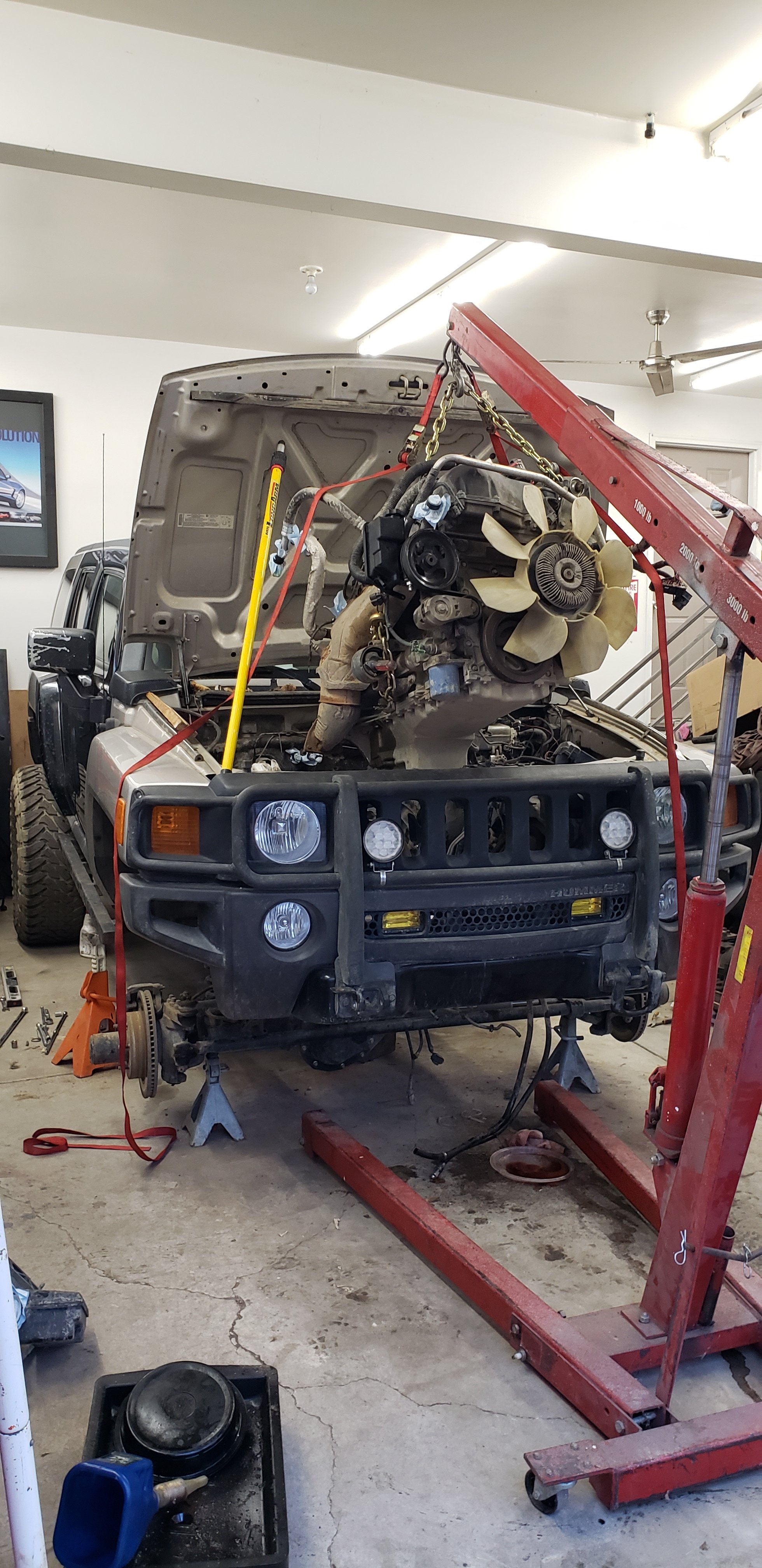

After some sketchy moments the old engine and trans are out. I need to fix some odd rust spots on the inside of the frame and clean up some welds before installing the new powertrain.
Manifolds, hptuners, h3 fan, cooling hoses, fluids are all in the mail.

Also one of the lower h3 alpha oil pan bolt holes do not align with the trailblazer/fullsize truck bellhousing. Reading up on some of the ls conversion forums, many people run without the lower bolts so I might just run with it. Otherwise I have to pull everything back out and swap in a alpha specific bellhousing.

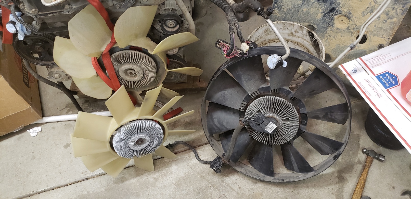

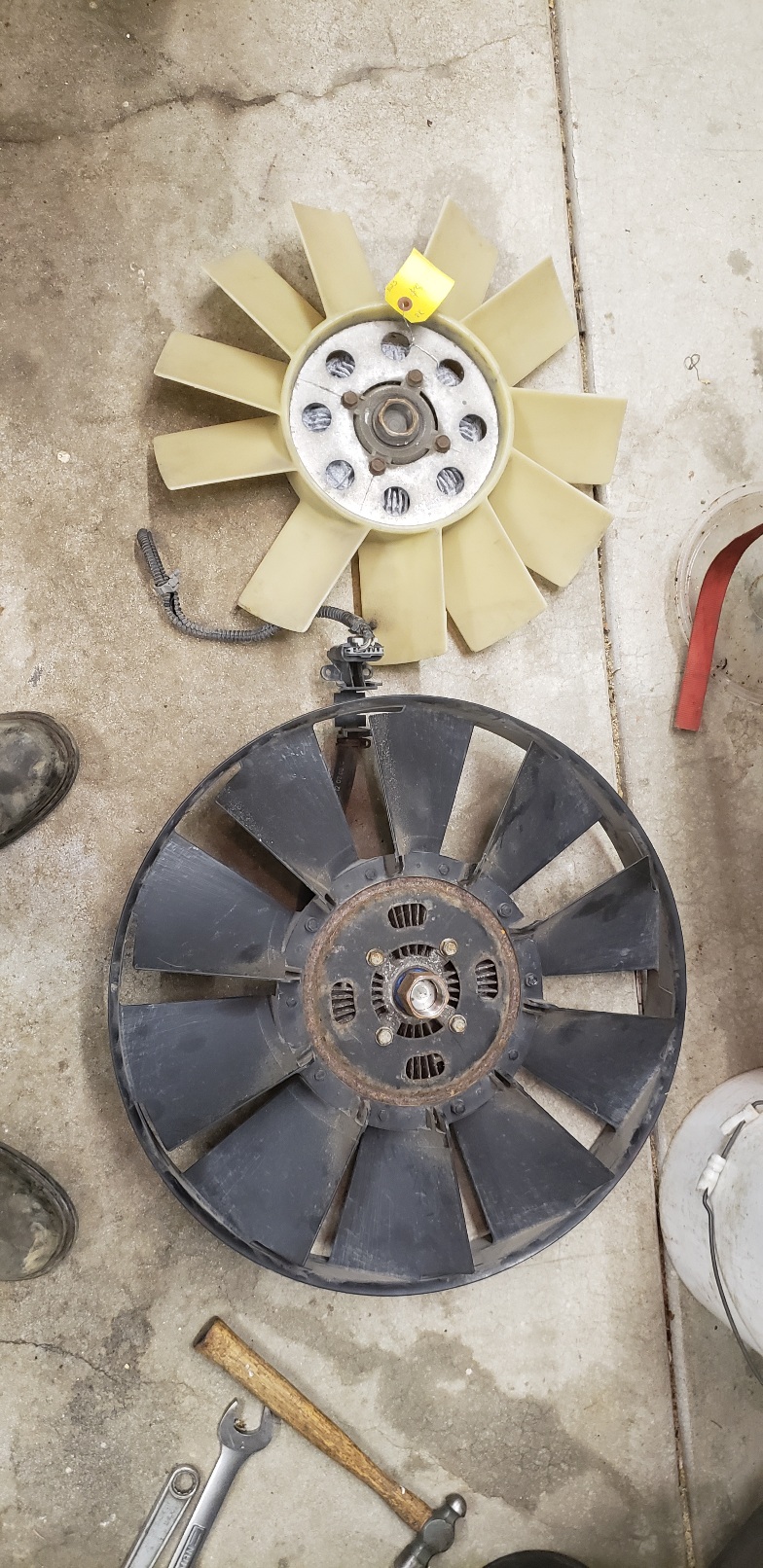

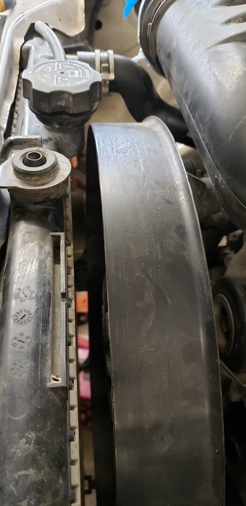

Alpha fan and clutch came in. Similar diameter as the stock i5 fan. Also shown is the trailblazer fan. Ideally I am going to use the alpha clutch which mounts the fan close to the engine and the larger diameter trailblazer fan.

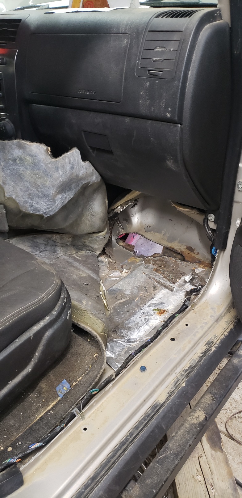

A small rust spot in the floor got larger and larger as I tried to find solid metal to patch to. I also fixed two other holes in the frame that I could only access while the engine and trans were out.
Good heck, that is a huge hole. Water had to have been getting in there for quite a while to do that.
As for the trailblazer fan, that is interesting. does it fit in the opening of the Alpha fan shroud? Seems like it'd pull a lot more air with the attached cowling or whatever it's called on the fan blade tips. I know that doing that increases the efficiency of a fan by a fair bit as it stops air from being able to slip over the tips of the blades. If you can get me a measurement of the diameter of that I want to check some clearances. You might end up running into an issue with the air intake, it's a pretty tight clearance stock.
Looking at those pictures of the fans I never realized how much smaller the V8 fan looks compared to the I5 fan. Wonder if they only did that for clearance issues. Get me the diameter of the stock Alpha fan and the Trailblazer fan and I will verify clearances.
The intake tubing comes in the way on the alpha. I found out the hard way when trying to put a mechanical fan on a car intake for my LS, no way its happening (car intake sits a few inches down)

I don't have an oem alpha fan shroud to verify but I doubt the trailblazer fan would fit in it even on the alpha clutch. It seems to still clear the tbss induction tube and radiator cap but just barely. If I have to move the engine forward a little it might not work. I also haven't verified if the trans cooler lines will clear on the bottom. Lower radiator hose is close.

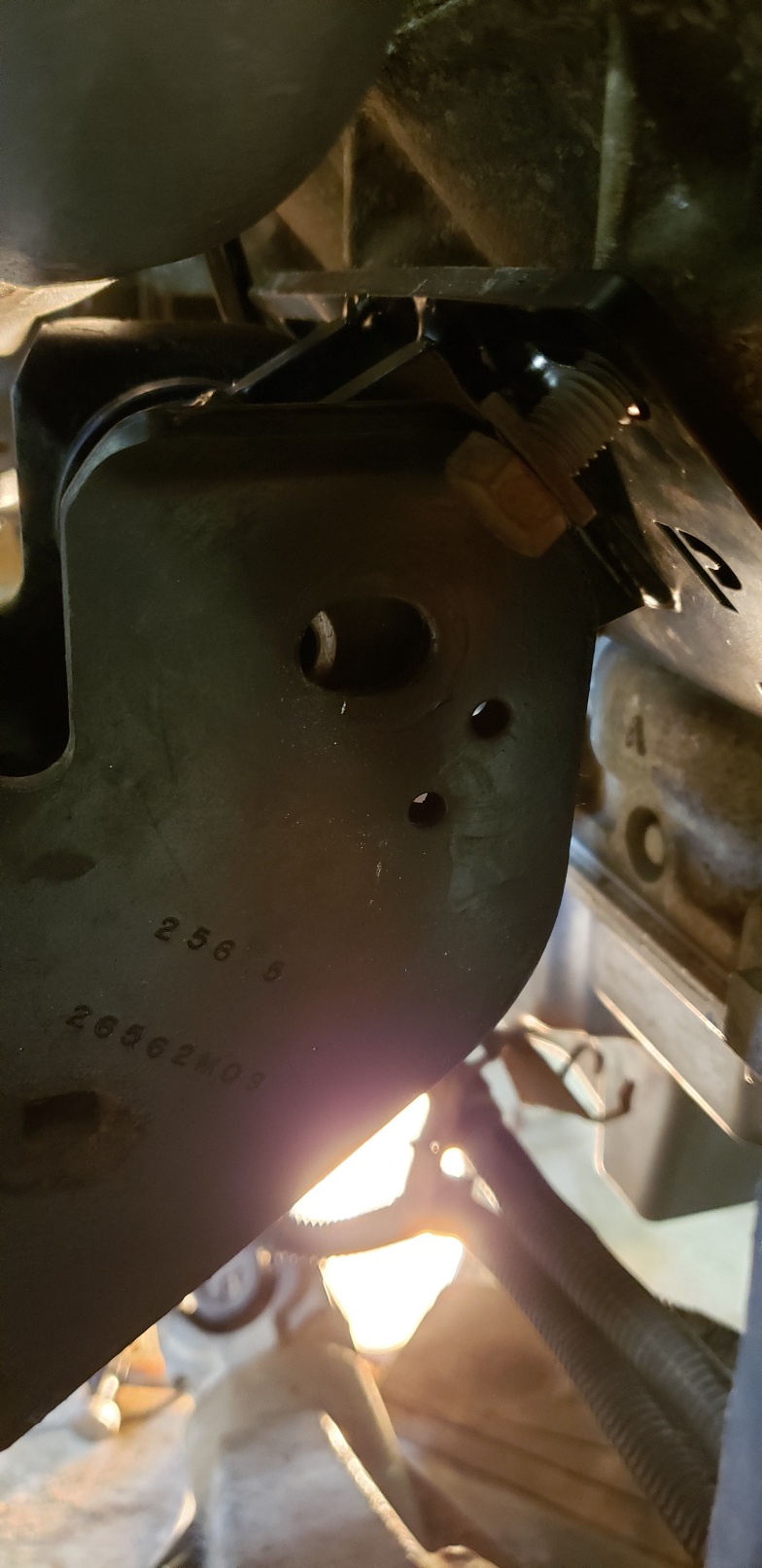

After two days of struggling I haven't been able to get the current performance mounts to line up. I emailed them and they said they have only seen this a few times in the past 10 years. I am guessing my frame rails might be tweaked from the sas and missing cross members. There isn't a way to get up in there to slot the holes when the engine is installed so it will be coming back out. This will give me an opportunity to update to the alpha bellhousing so that is on order (I was pleasantly surprised to see it was only $67 new). Also the exhaust manifolds contact
the factory engine mounts so i can trim those up and clean them up too with the engine out of the way. One step forward, two steps back.
