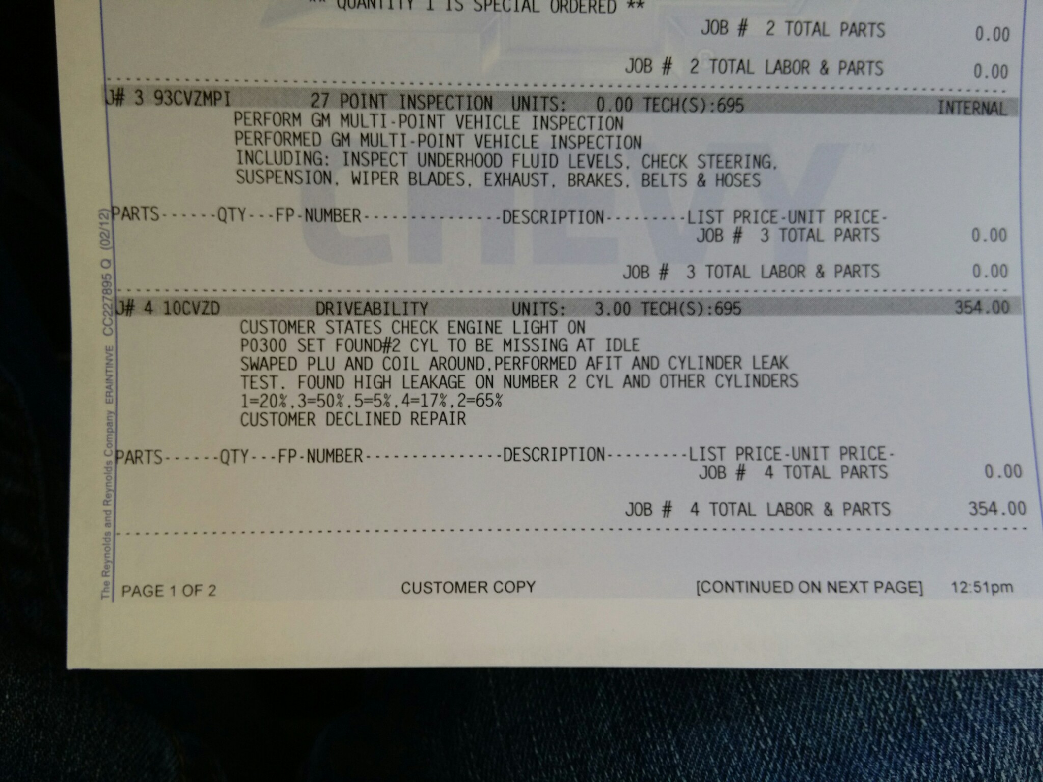

The dealership said they might be able to help me out, the current estimate is $2,600. I am kinda pissed that GM said I had to go to the dealership to get it checked out before they would even deal with me. I paid $350 to have it troubleshot and GM said I am not in warranty and they cannot help. I don't understand why I had to pay the dealership $350 for GM to figure that out? Currently sitting at 87,000 miles. GM hasn't been a big help so far:
I brought up the PIP and said it was a factory defect - No dice.
Brought up that Colorado had there warranty extended to 100,000 miles because of the head - No dice.
My numbers for the #3 cylinder match the report, I think I lost #2 between my initial leak down test and now. It looks like I might be doing the replacement myself.
