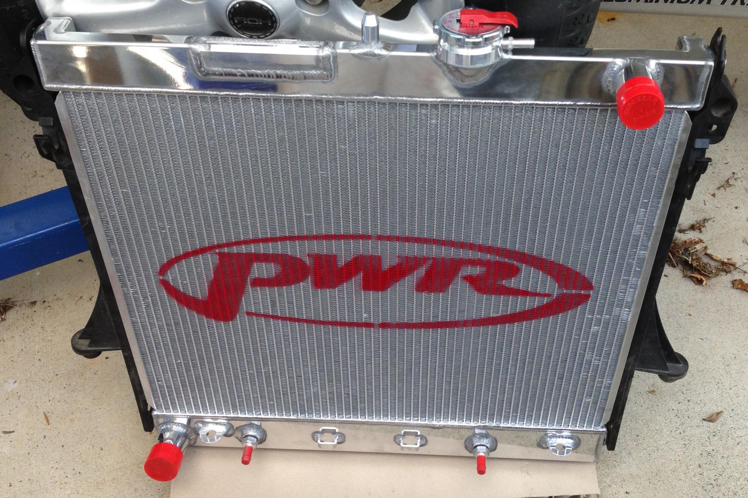

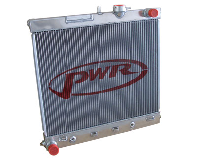

Well I have been a bit nervous lately seeing coolant residue around the cap that I would normally put down to a leaky cap, but noticing all the radiator failures lately decided to pull the pin & go to a full aluminum one for peace of mind. I contacted Ron Davis Racing & they have one in stock for a H3 Automatic at $940 but add the shipping to Australia (& possibility of damage in shipping) I decided to try look around for a local solution. I asked around my Motorsport friends and they recommended Paul Weel Racing. They have a motorsport technical factory around 50 miles south of where I live & they manufacture parts for all forms of racing (F1, NASCAR, V8 Supercar, DTM, WRC, DAKAR, etc.) and they also do factory replacement parts including H3 Radiator http://www.pwr.com.au/portfolio/hummer-car-radiators (Picture below - Not cheap though Pricing for the radiator is $1186 plus gst, including the intank auto trans cooler part number PWR5976-3 (the -3 is for auto) with the manual $89 cheaper) but with these guys making parts for the like of Red Bull Racing etc. I figured it was worth it. With their use in NASCAR/INDY/GRANDAM I see they also make these available in the USA out of North Carolina. Details below: PWR USA Inc

Ok they said my PWR Radiator is on the production line now, should be ready next week. Are these a DIY fit or should I book it into a garage to fit it ??

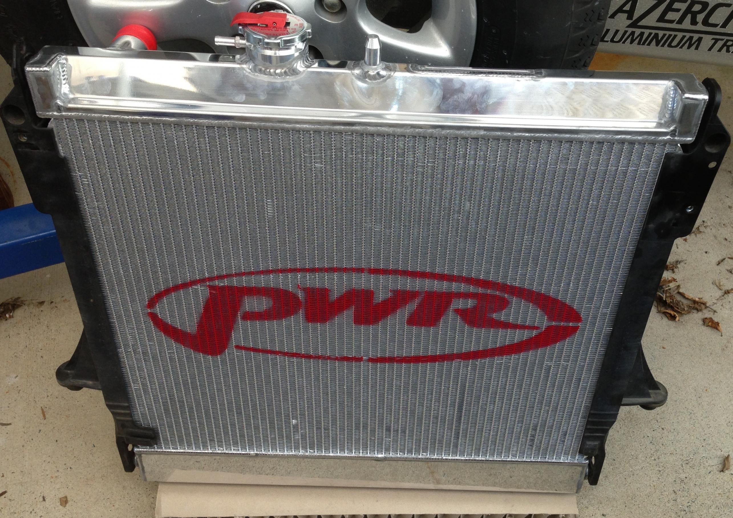

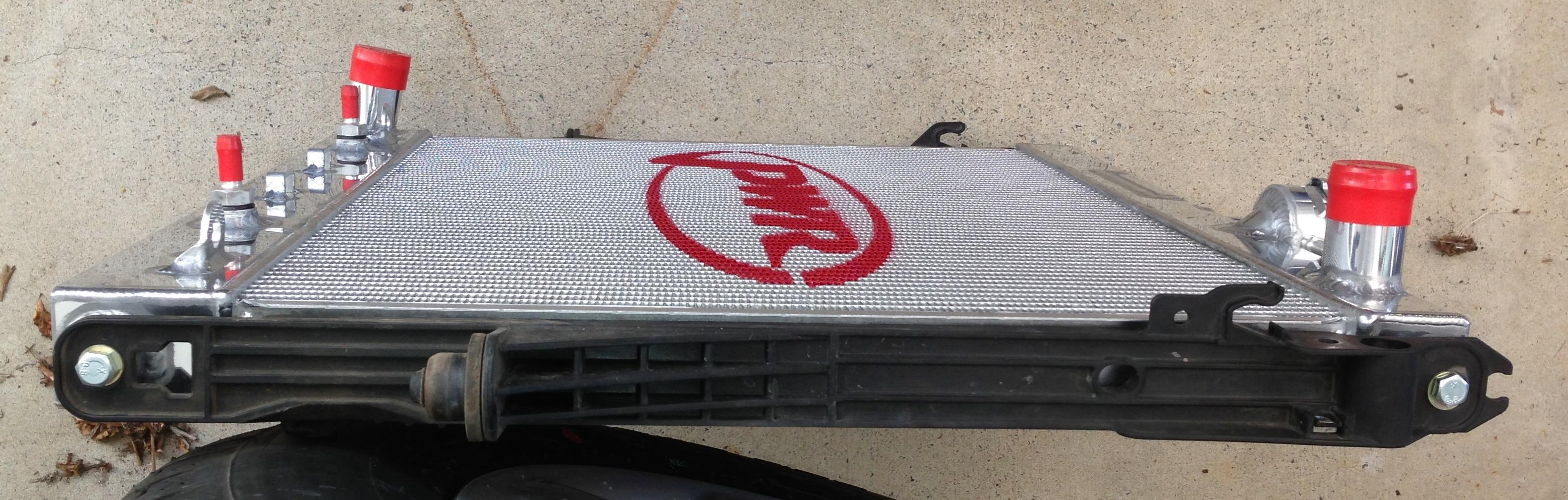

PWR Radiator arrived this week Lug Bottom.jpgLug Mount.jpgMount Front.jpgMount Rear.jpgRear.jpg You have to take the side mounts off the OEM radiator & I had to get 2 more bolts (M8 1.25 x 20mm) as the bottom uses the bolt mount rather than the lug mount

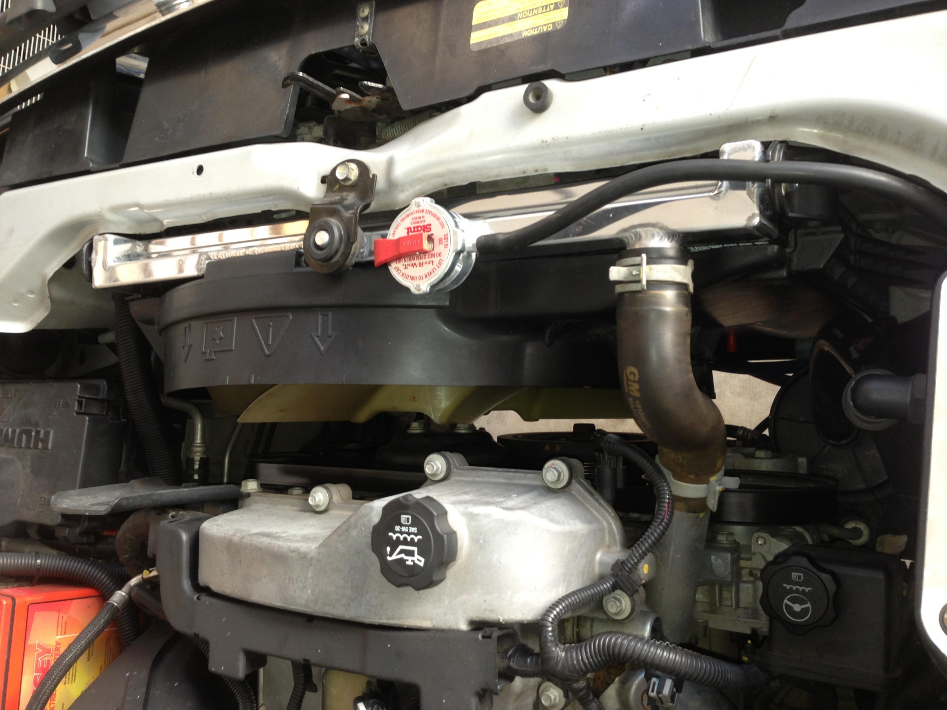

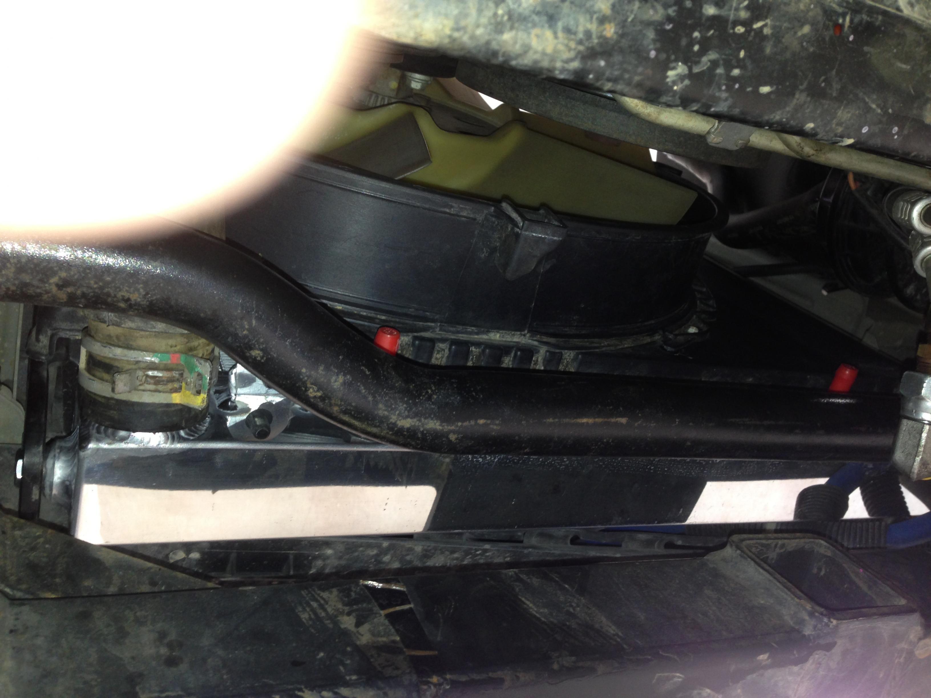

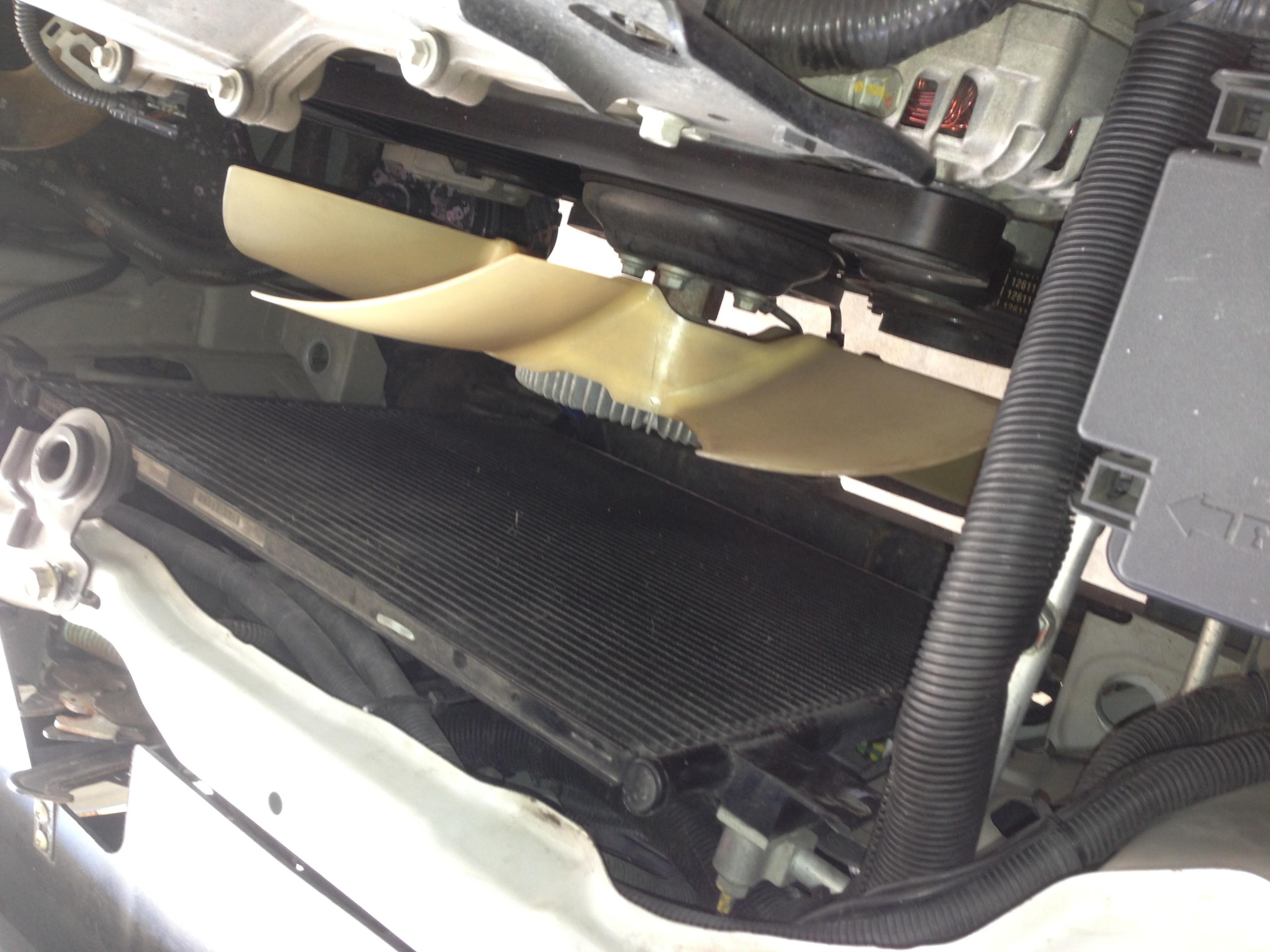

Here are some shots fitting (note manual says to remove fan but you can remove replace without taking the fan out as the bottom fan shroud rotates to the top) Condenser.jpgEngine.jpgRHS.jpgUnder Shroud 2.jpgFinal Top rear.jpgFitted Top.jpg

Just posted the fitted pictures above. Install went well, only inconvenience was the condenser to radiator bolts because of the mods/accessories I had fitted.

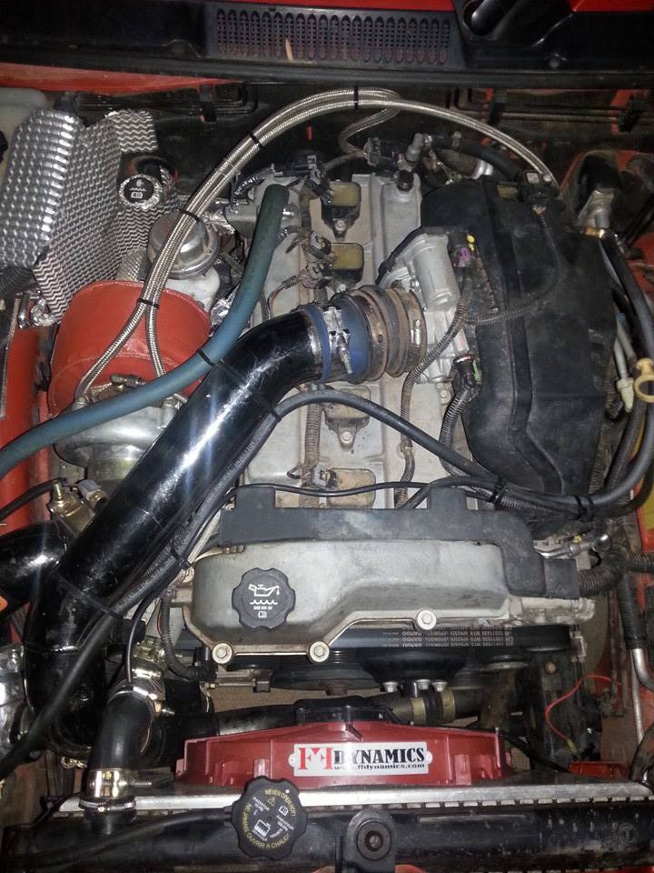

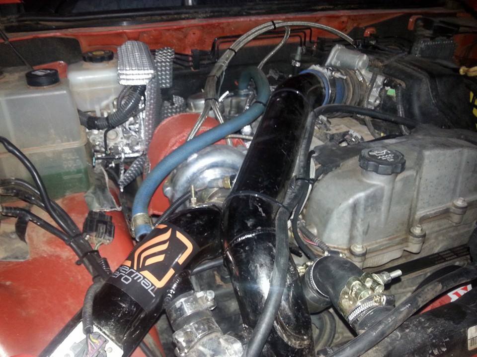

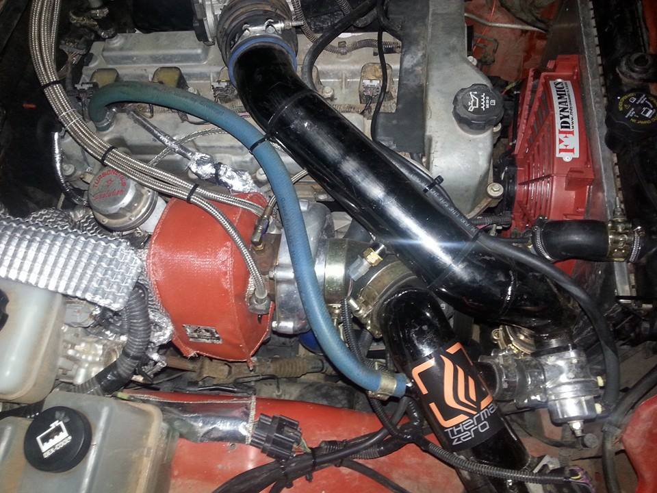

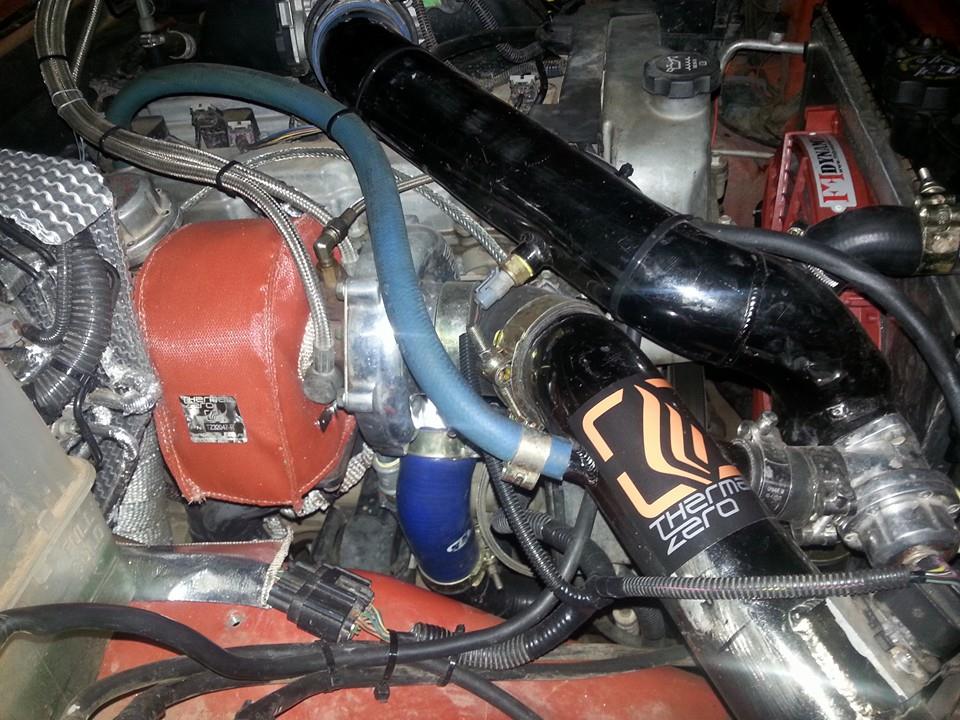

Good to read I have fitted a turbo kit to my hummer H3 but the temp is getting u to 3/4. did this PRW radiator cool your 4x4 well as im thinking of buying one. ???
kustomone
3
Australia
pics of turbo kit
