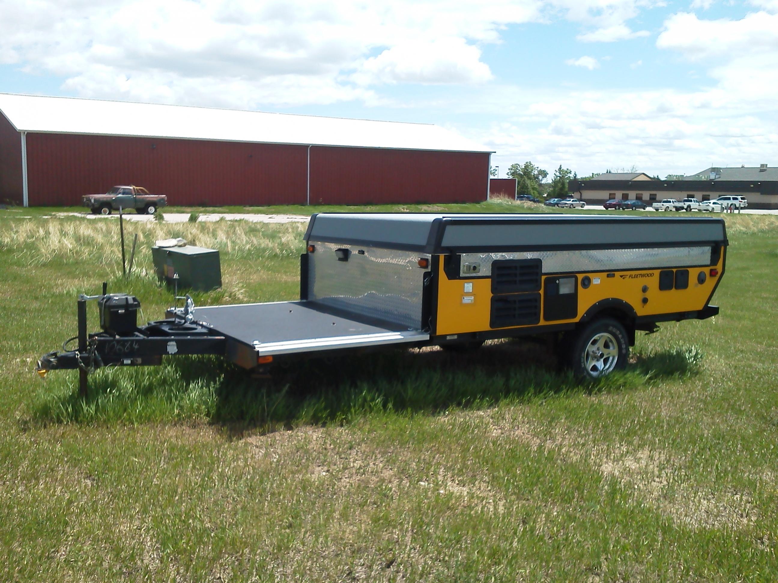

Basic Camping production Trailer.
Long Term Plans:
Lift kit
37" Tires
Heavy Duty Generator
Repaint to Black with orange accents
IFS style setup
Control wheel steer from the driver seat
LED lighting
Waterproof everything
Skid Plates
Front, Rear, side body protection like HummerDan Style
More ideas to come!

Is that one you have now? That looks pretty cool! Some bigger tires and it will look much different!
Yes, that is our current "offroad camper". Again its just a regular production model. But hopefully when I am done, it will be what I want:)

HHI; I wouldn't spend too much effort trying to make a silk purse. You're trailer is too long for rough trails. Bigger wheels will help increase ground clearance, but they won't make it shorter.
Sent from my Galaxy Nexus using Tapatalk 2
To each his own, I am not trying to makea silk purse, but an off road ready trailer. Length does not essentialy matter as long as it is setup well for the trail. I am sure H3T owners should know:wink: Plus, I will be buying a military trailer soon now to make it offroad ready, or make a custom built trailer:)

To each his own, I am not trying to makea silk purse, but an off road ready trailer. Length does not essentialy matter as long as it is setup well for the trail. I am sure H3T owners should know. Plus, I will be buying a military trailer soon now to make it offroad ready, or make a custom built trailer.
Olan; I'm sorry if you feel I insulted your trailer. That wasn't my intent. I was just commenting on the reality of the geometry. There is a reason that all the off road trailers on the market are short. They work better off road.
The length of the trailer limits your approach and departure angles and the combined vehicle break-over angle. Long trailers tend to draw the tongue crossing obstacles, although the track and back-up well. You can certainly make you're trailer more capable by adding the lift and bigger wheels as you described, but there is a limit to what can be accomplished with such a long trailer. Eventually you get to the point where increasing the height makes it too unstable side to side because you're increasing the center of gravity height without increasing the width. If you're planning to only take it down moderate trails and use it as a base camp it will do OK. Just as long as you're not planning to do the Rubicon trail or something extreme with it.
As an H3T driver, I'm acutely aware of the limitations due to the length of my vehicle. The break-over angle and the turning radius are very limiting. However, the benefit is I have more cargo space and better stability on steep grades.
I’d suggest doing some research. Here is a thread on long off road trailer considerations :link:.
Don't apologize, I dont feel you insulted me or my trailer. I do know the limitations of a long trailer, but it does fit my needs, and that is what the use is for right? I don't plan to take it on anything "too hardcore", but just as an expedition trailer. The custom trailer I am thinking about building would be for more of the extreme use. Thanks for the link and I will do a read-up. :)
