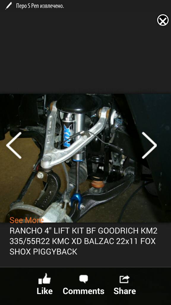

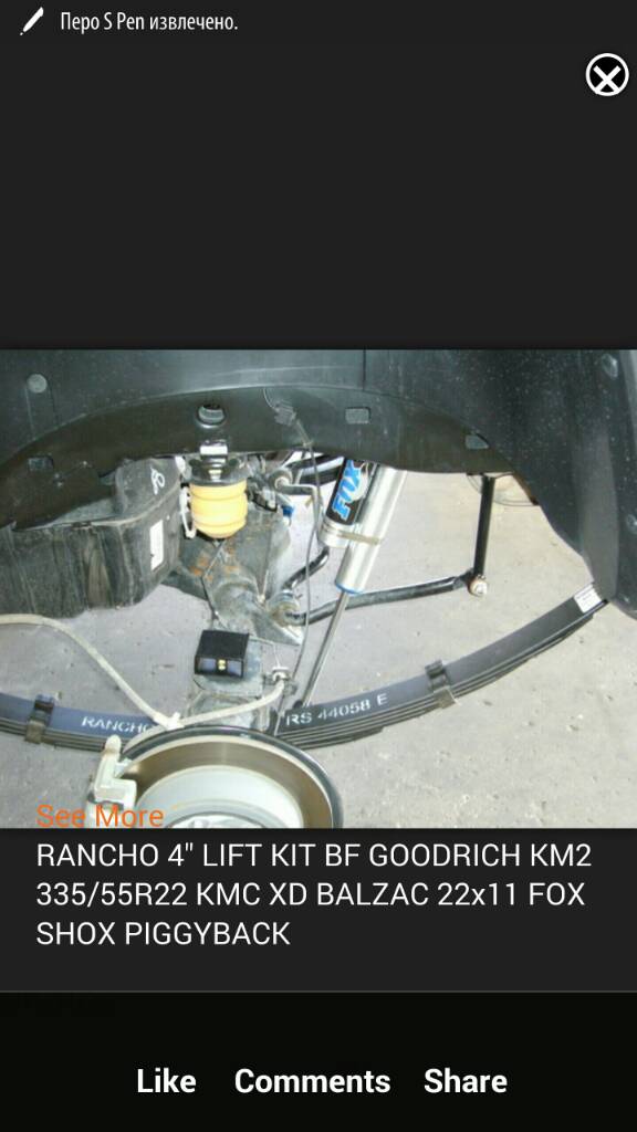

I have asked many times, but i did not get answer yet. So - here is my question: i have rancho lift kit installed with 4 inch lift. What kind of shocks i need to install on my rig to get real reliable suspension. I see fox shock with external reserviour and they are installed with rancho kit. I dont know number of that shocks. Does anybody can help me with bilstein shocks or fox shocks that can be used with rancho kit ?

As i understand you have posted front shocks part number.. i am dumb.. sorry. I need shocks with external reserviour like i see on that pictures. Can you post numbers once again like this:
Front shocks compatible with rancho lift: XXXXXXXXX
Rear shock compatible with rancho lift: XXXXXXXXX
Sorry..
View attachment 21887View attachment 21888
This are bilstein 5160 series with reservoir for the front.

This are 7100 series with reservoir for the rear.
https://m.summitracing.com/parts/bsn-ak7112sb06

Near 700$... i hope they are not so bad as rancho 9000
If you shop around u can get them for as low as $135/65 each one. And if you do either order from that seller or you can always call summit racing equipment and they will price match as well you will qualify for their free shipping which is a good thing. Bilstein is in the middle ground when it cime to price and quality...you will spend more money with fox...and way more with king shocks.
