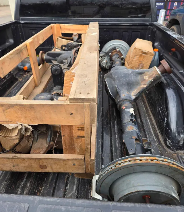

Well update time. I got a D60 and a D44 for $4300. they do apparently use ram 1500 brakes from what I've read, theres not much info on these axles. I do really like how the brakes are on my h3, probably the most solid and firm brakes I've ever used but maybe thats all down to how you adjust them.
I am also doing a engine swap with the axle swap. Just pulled my 6.2 out of its donor and will probably get the entire block redone

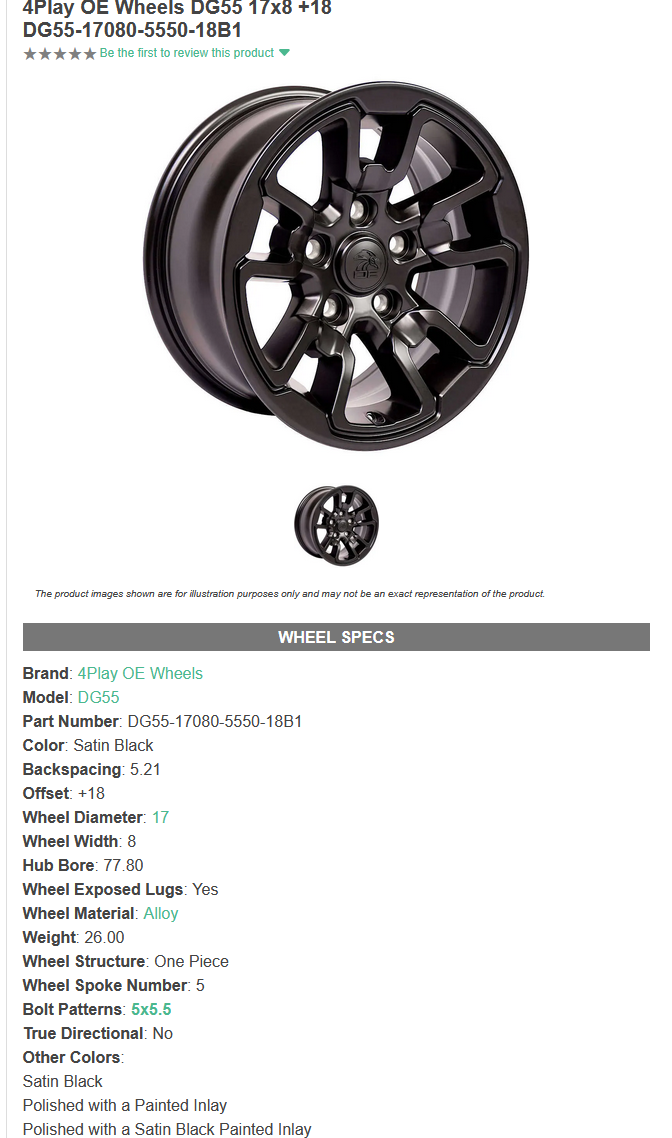

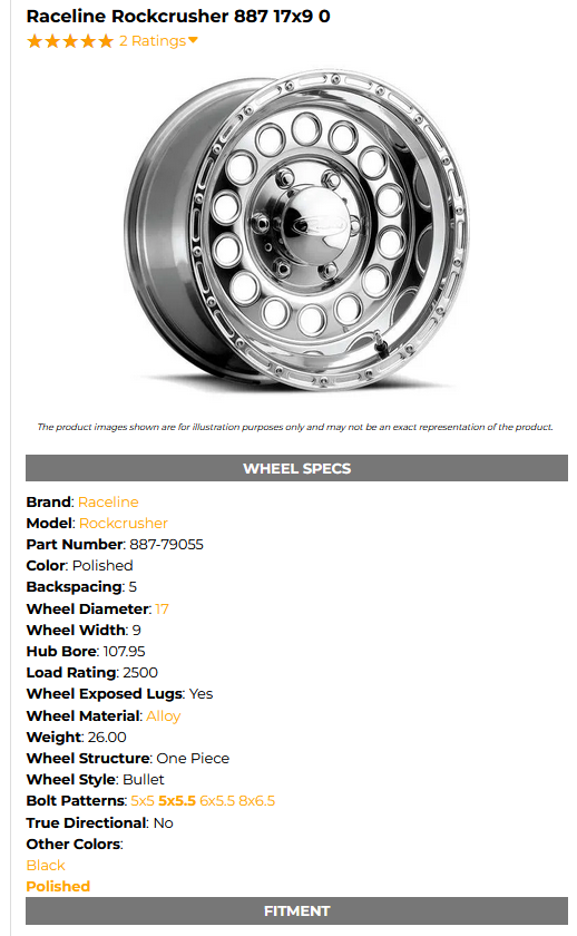

I could run wheels that do have a 18mm offset which would bring it down to 75.7" but man those wheels are UGLY and heavy, I'm pretty picky on wheel options and I've only found one other set which look much better, I'm also not sure what kind of backspacing I need, jeep people run about 4.7" maximum on 35's but I'm not a jeep so I don't know
The polished one is what I have selected so far, not a fan of it being 9" wide or the hub bore(can be fixed) but I'm pretty picky. The black one I might consider, I don't think it looks anywhere as good and the brand name does not scream reliable to me

I think you should get the axles under the truck, centered, and then measure for wheels. I only say this as there is a lot of crap you gotta stuff in there and a wheel that is that "sucked in" might have some rubbing issues.
469
X2, figure out how the axles will sit before committing to a wheel.
I’d grab some cheapos for moving it around/fabricating. Then when you’re confident you know where it’s all going to end up, commit to a set of wheels.
