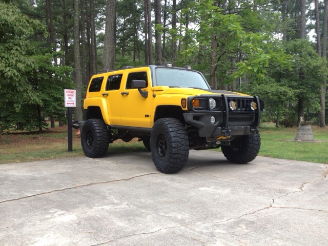

Just got my h3 back today. Mounted 37x13.50 mud grapplers on it. I went with the rancho lift and the daystar 1 inch body. I'm now on the fence about a PCM tune but was wondering what options I have for a new front diff to get better gears to help turn the tires. I'm not interested in a SAS just a bigger front diff just wondering my options and what gears would be recommended. If I get a new front diff will the PCM tune be for nothing? just wondering if I should save my money now and go with the bigger diff and skip the tune or if they will both help.
Never posted pics so not sure how they'll come out what's pictured is 06 hummer h3 lux with 4 inch rancho lift 1 inch daystar body lift 37x13.50r17 nitto mud grapplers rims are pro comp 7036 17x9 and lastly Fox shocks on all 4 corners.

It rides great so far much smoother than with my t bars cranked. Only driven it for a day so time will tell

I Like It Very Much. What rims are You running ?!!
