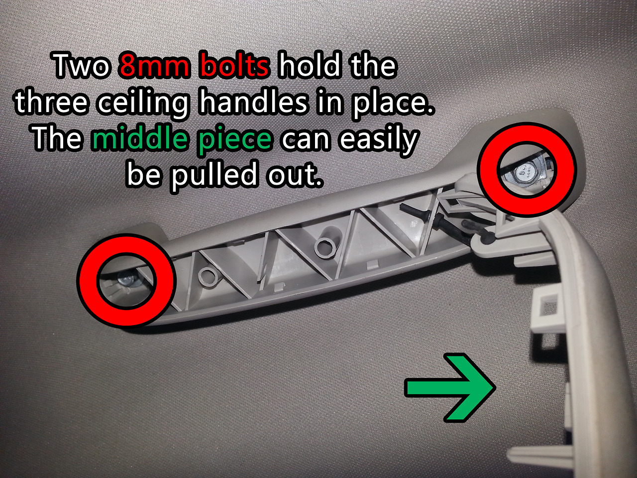

Step 1 - Removing the Sun Visors and Ceiling Handles
This is pretty straight forward, use a T-15 star bit to remove the 3 screws that hold the visor in place and 1 screw that holds the visor clip. The clip can be a bit troublesome because there is a small metal piece that holds the front of the visor clip to the headliner. Either leave it attached as is, or pull the visor clip off and save the metal piece. Undo the center piece on the ceiling handles to access two 8mm bolts. Remove the all six 8mm bolts from the three ceiling handles. There is a plastic for both the visors and handles that lies between the headliner and metal roof. Be sure to keep track of them for later.

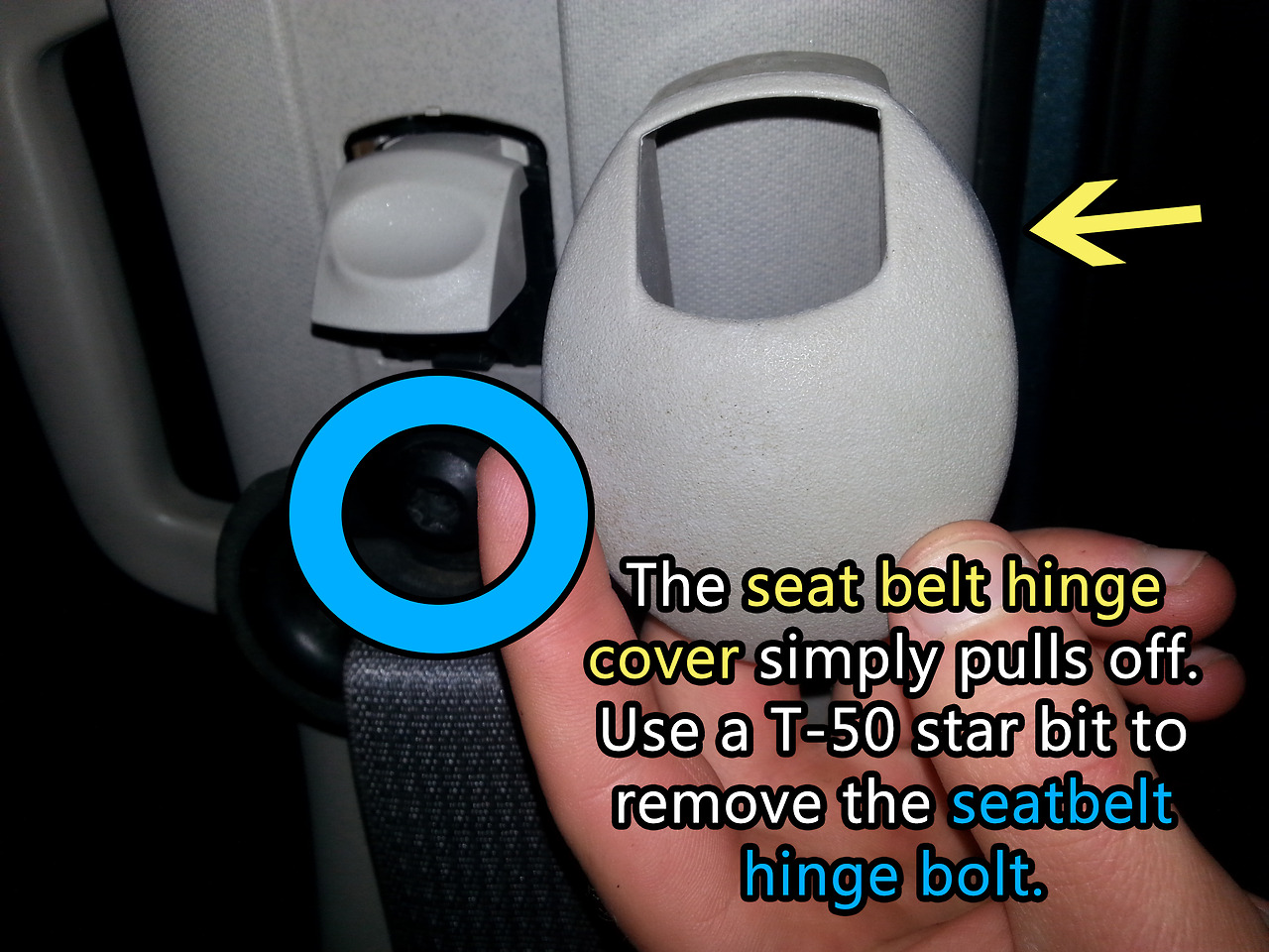

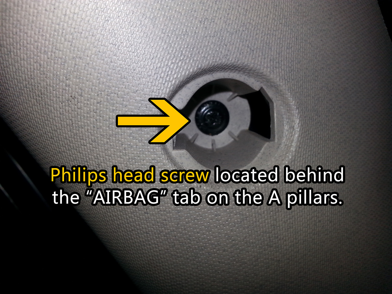

Step 2 - Removing the Garnish Moldings
Remove the "Airbag" tabs on both A pillars and C pillars to access and remove the phillips head screw. Remove the seat belt hinge covers to access the bolt that hold it to the pillar (B and C). Use a T-50 star bit to remove the bolt and seat belt hinge. The rest is a little elbow grease to pry the moldings off. The moldings are secured tightly for a reason, so don't be afraid to use a little extra muscle. Removing the weather stripping around the doors is also recommended because it tends to hold the pieces in place and allows for a better grip.

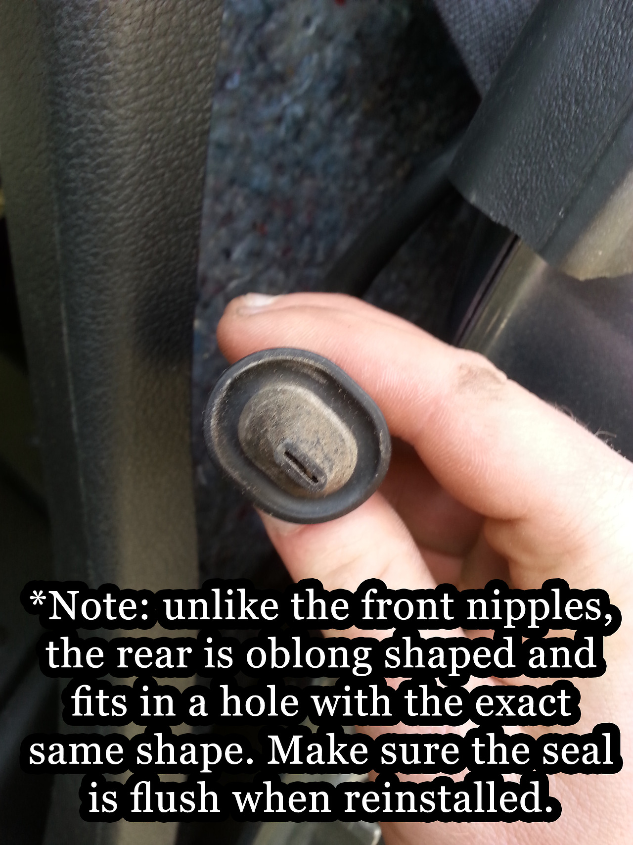

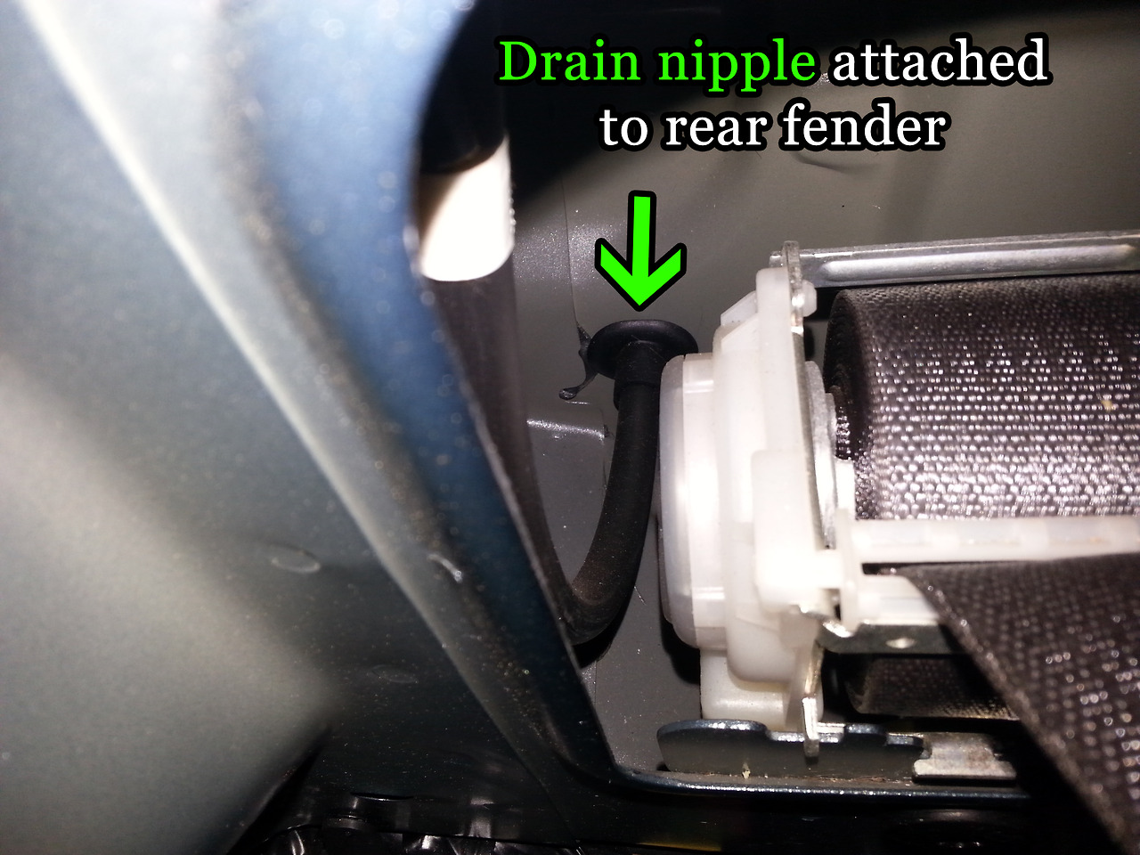

Step 4 - Drain Tube Removal and Cleaning
The drain tubes run from the end of the sunroof assembly, down the C pillars, and exit just behind the rear passenger assembly. You can either remove the nipple that attaches to the fender or the entire tube. The nipples are oblong shaped and fit specifically to the exit hole compared to the circular front drain tube nipples. After cleaning the nipple/tube, make sure the seal is flush against the fender when reinstalling.
