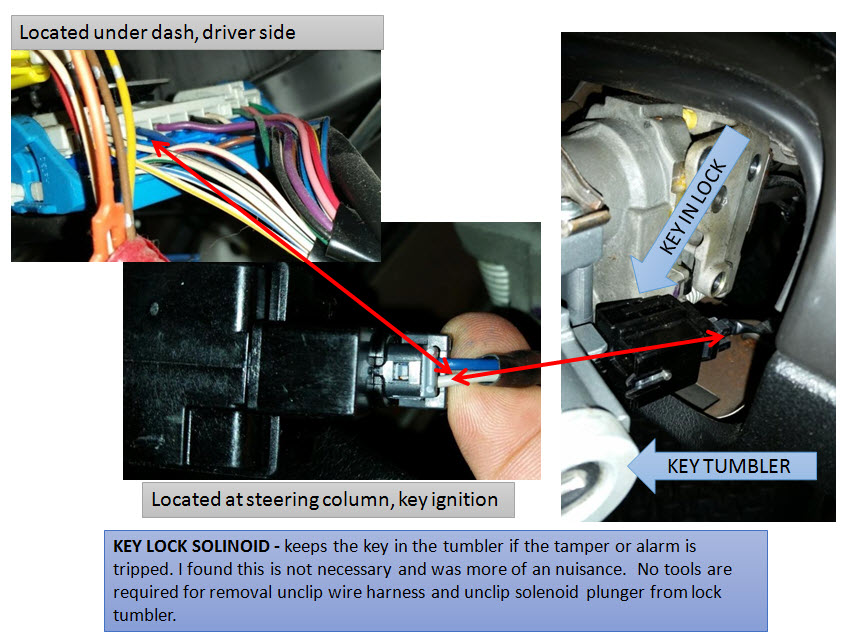

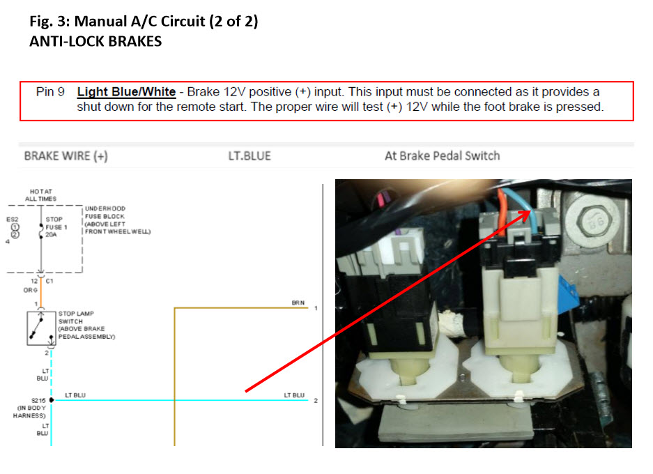

I’m new to this forum, well new as a contributor. Being a 2007 H3 owner of the same vehicle for ten years I have frequented this site and appreciate all the tips people have offered. I feel I’m somewhat indebted and should contribute to ‘H4O HUMMER’ for the amount of information I have pulled from the postings. Most recently, I installed a remote starter and was amazed on how little information there is out there for the DYI. A LOT of the information is misleading or simply incorrect also read that H3-Hummers are on the “do not install” list for some remotes, which challenged me even more. Even though I was successful with this install, I would be embarrassed to disclose how many hours of online research and testing I spent. There is one member at this forum that provided some information, which is correct, but for me I would have liked to see more specific detail. For my first posting I will be providing images, instructions and schematics on how to perform this install. EVERYTHING you will need to know, eliminating all guesswork!
