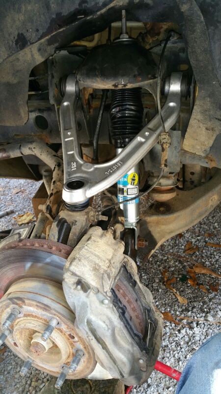

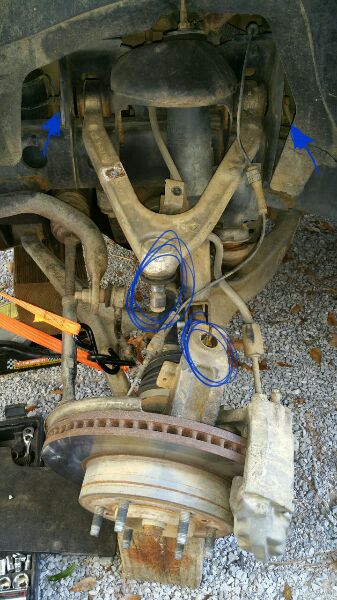

First off I will say this is something that if you are handy, you should be able to tackle. Took about 2 hrs for the drivers side then about 1 hr for the passenger side. Passenger side isn't any easier just figured out how to do it. This first picture is just showing the big screws that can be difficult to take off. I will say this is pretty straight forward just removing some bolts and swapping out parts. You can do this without removing brake lines. 2nd photo is after the fact. Bilsteins look pretty good. Ride is a lot smoother and these are the shocks with the extra 2 inches because I did the torsion bar lift in the front.

Sorry if this is a stupid question... but why do people replace the upper control arm? Do the joints wear out and you have to just replace the whole thing or what?
The upper ball joint isnt removable so you have to replace the whole thing instead of just the ball joint. Kinda a pita
