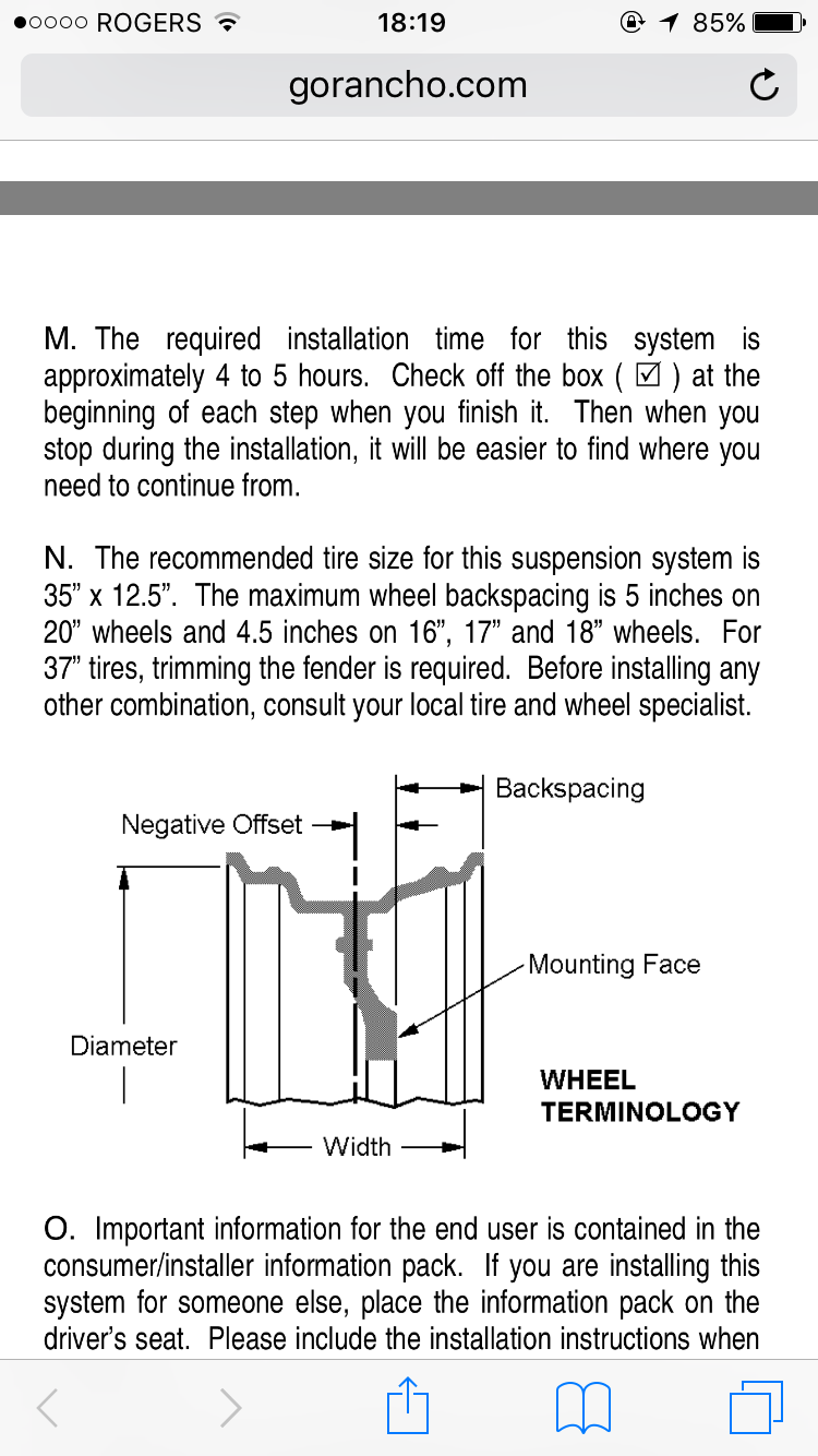

What is the wheel patter on the 2006 h3 I'm also trying to fig out what back spacing and other suff do I need when installing the ranco 4inch front and 3 inch rear lift kit on my h3 I'm trying to fig out some rims that will work with that set up
Ben
52
Winnipeg
I'm using stock rims with Motorsport 1.75 inch wheel spacer
4,244
Bolt pattern is 6 on 5-1/2" (or 6 on 139.7mm). I have run 35"x12.50" and also 37"x13.50"...both BFG Mud Terrain KM2s.
