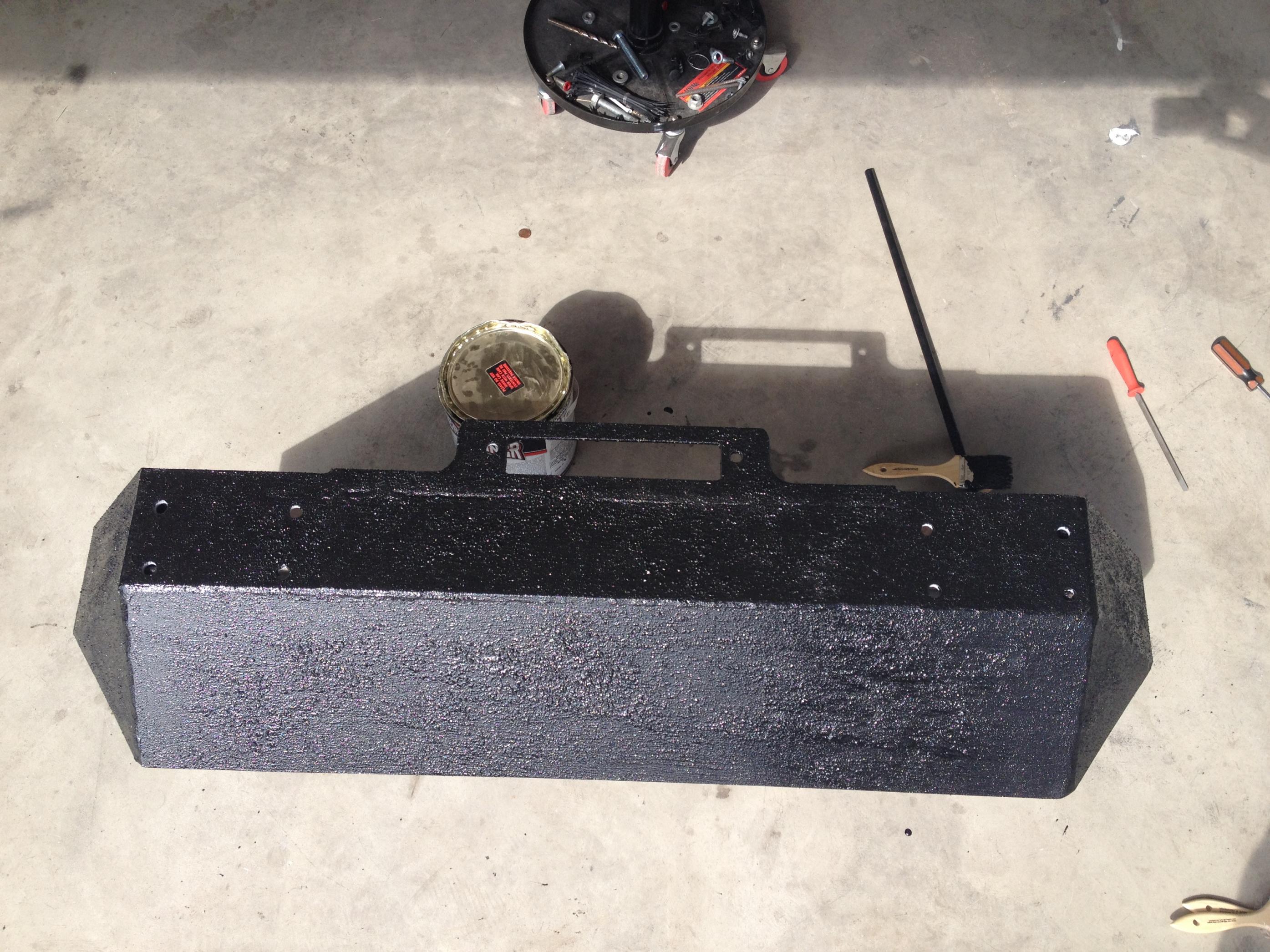

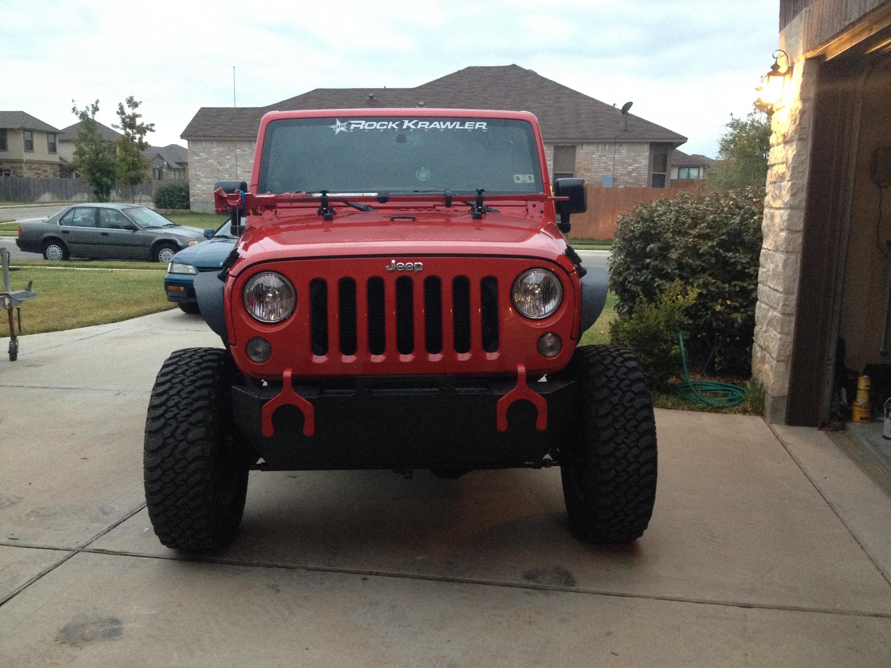

FINISHED THE BUMPER!! Fru and I did some hanging out this weekend. He probably spent a solid 5 hours cutting and welding on Friday. Saturday I woke up and spent the better part of an hour grinding down welds, then another 5 hours or so sanding / priming / coating / painting to finish it up. Bumper is coated with black Herculiner, OEM Rubicon tow hooks painted with Chrysler color matched Flame Red paint with black accents on the bolts. The lines were intended to be minimal with the skid plate maximizing approach, the sides remaining somewhat stubby to also maximize approach angles while still having a slight angle to add protection for the grill so brush and such will follow the lines of the bumper to the tires / metal fenders while hopefully missing the painted grill altogether. Below is the start to finish progression (added Rock Krawler windshield banner too):
