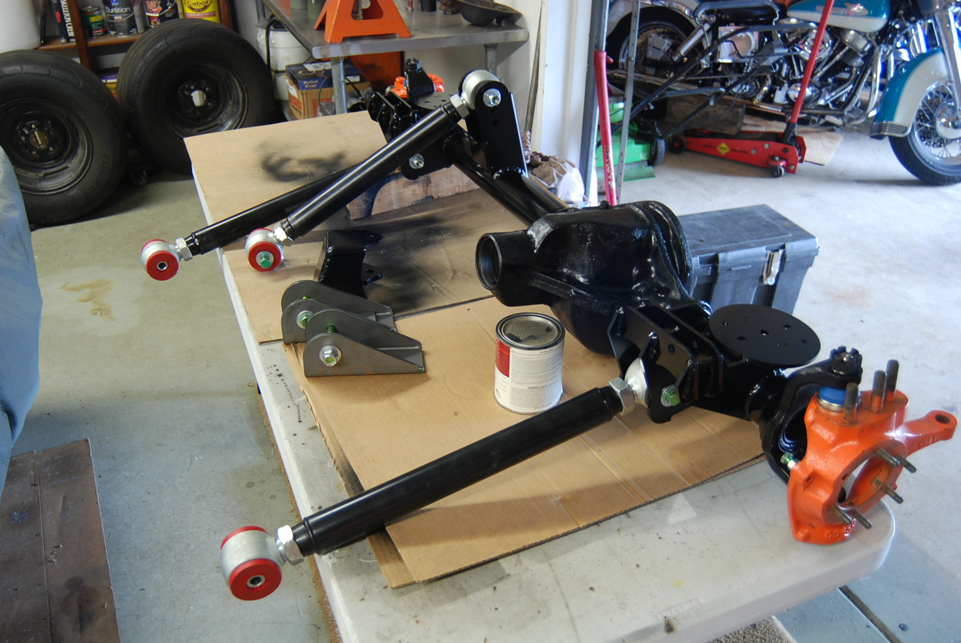

tell me more about this SAS gear.........
you know what would be radical? a kit with everything you need and directions and stuff... I have never set up a link suspension before........
i am excite
06H3...Yes, for 2.75" tubes? Sitting here on a shelf with your name on em.
The Solid Axle stuff has been in my hip pocket for some time now. The parts I came up with are not top secret...and several people already have some or all of these parts, and are currently embarking on their own SA-journeys. Its difficult to put together a single "kit" to please everyone. I currently know of ten solid-axle H3's, and every one of them is different! So I plan to break the parts out into smaller sub-kits that address each particular part of the swap. That will give the builder the option to go off in more hard-core directions if he wants. Someday H3's will be cheap enough to be worthy of building a trail-bomber but, right now I need mine to be fully functional and all-purpose and that's why I chose the parts I did. My main focus has been on the Dana 44, 3-link, coil-spring rig and that's what all my SAS parts are designed to fit. Its "mild" by off-road standards but I feel its the best compromise between: budget, parts availability, ride-quality, and performance.

I'm interested in this - I plan on a triangulated 4 link suspension with heim joints (I'm relocating the gas tank).... from your description, the brackets you're building sound like what I'm looking for (especially the coil-over bits)

that's a ladder bar suspension - ladder bars have lots of trouble flexing (as do parallel 4 links)
I did misspeak a bit... I'll put johnny joints in all the contact points with a triangulated 4 bar.
On the 4-link rear...I doubt if I have anything that would help you. You might want get a kit from one of the fab shops. Ballistic, Ruff Stuff, WFO, Barnes, etc....most of them offer generic 4-link rear kits. Also check with Dana60...he just finished a similar build on his H3. I'm actually a supporter of the rear leaf setup...does everything its supposed to...its simple, cheap and best of all...its already there!
On the front...I've not been able to fit a traditional 4-link in the space available.
As far as the radius arm (actually a 2-link) idea...it would certainly work but why? Its the same amount of cuttin & choppin to install a true 3 or 4-link so I question why one would opt for radius arms. They're fine for lifted rigs with minimal travel but, they don't belong on flexy off-road suspensions where you can see 10" to 14" of travel. The problem with radius arms is that the axle housing rotates as it travels up and down. Therefore your pinion and caster angles vary all over the place. IMO...if you're going to this much trouble to build a suspension from scratch, forget the radius arm design.
