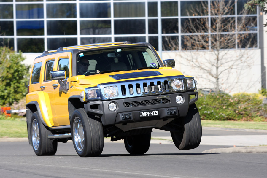

Heck I think at times some people might burn more than an eighth off on the trails when spinning their front wheels on slick rock.:giggle:
10,672
It was the REAR tire!

Might be the only picture, but I can remember a few H3s burning rubber on Hell's Revenge's Top of the World fin; with their front tires. They will remain nameless, but one was from CO, the other from TX.:shame:
