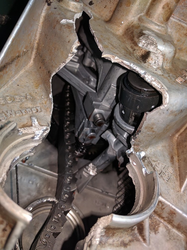

Driving down the freeway... I hear a rumbling, then a CRACK! And BOOM! ...goes the transfer case.
Got this 4 years ago new from @Zach... don't know if it's under warranty or not, but I have a spare unassembled in the garage.
9,506
I am transferring over my post from facebook for knowledge on the forum...

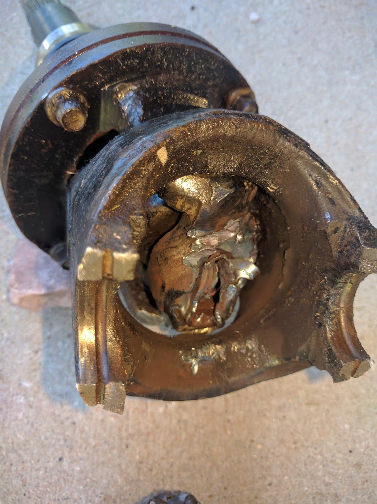

The old custom driveshafts were a custom cast piece from China that adapted the h3 front driveshaft flange to a late 80s chevy driveshaft. These driveshafts were clunky but it was ok since they had locking hubs so they never saw highway speeds. Highway
speeds is what kills those drivelines, not wheeling at slow speeds. Cj from THORparts never had issues with the old style driveshaft but some customers did, including me. We spent some time talking about it and he came up with an adapter that will adapt our whacky H3 front driveshaft flange to a standard jeep flange. These front driveshafts that they adapt to are meant for highway speed. ZJs, XJs, and TJs all spin the front driveline at freeway speeds. So he made the adapter and I was the first one to run it, still no vibrations, no issues. Adapter with a TJ, XJ driveline 10 years from now you will still be running the same driveline with no issues.
I know you were running one of the old style custom front driveshafts and I had nothing but vibrations from them. Vibrations kill chain driven aluminum t cases. Pick up one of the adapters and you will stop having issues.

before you toss your old case, can you check and see if a couple (or one) item managed to survive the carnage. IIRC, the lower gear on the chain and the chain were toast in a 4:1 case I still have.... of course, no one makes those parts, but I keep hoping they survive one of these so I can fix my old case.....

Totally. I have a full TCase sitting in my garage in pieces... so I'll take the best parts from both TCases to rebuild one. It'll be a few weeks before I get to it more than likely, but there's no way I'm just tossing it. Those tcase parts are pricey!!!! And it wasn't the transfer case that was the cause, it was the drive shaft.

So the replacement driveshaft from Tatton is only $250. [For reference: Curtis Tatton, West Valley City, Utah , Phone 801 685 0056] --> I paid $500 for my driveshaft originally and then a few hundred more to rebuild it. This is the one recommended by Chris Paul and CJ and lasts forever supposedly... it's a 1310 hack & tap driveshaft using the THORparts adapter.
BIG THANKS to CJ @ ThorParts for the adapter that showed up today-- I'm going to have this thing back on the rocks in no time! :)
