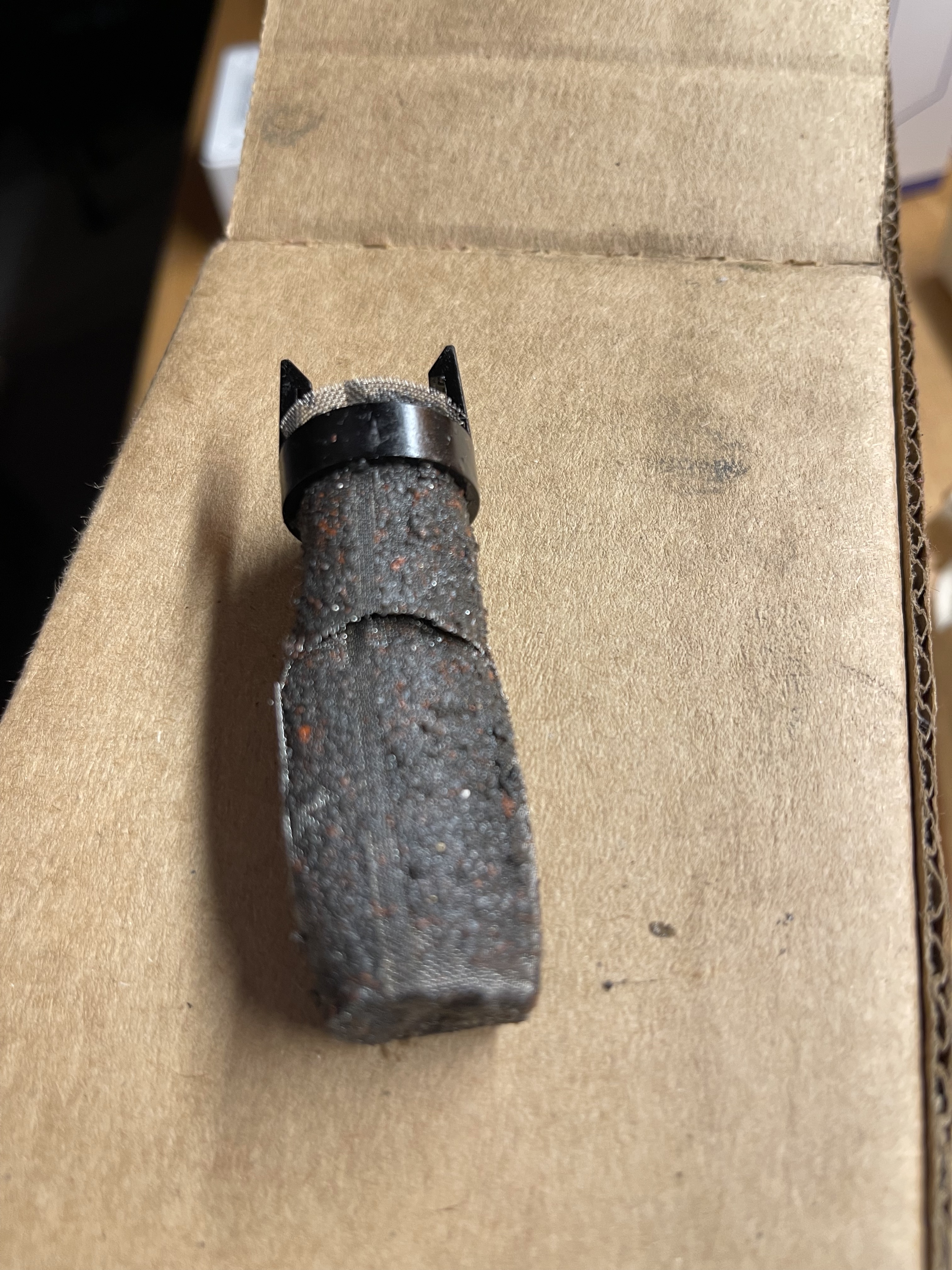

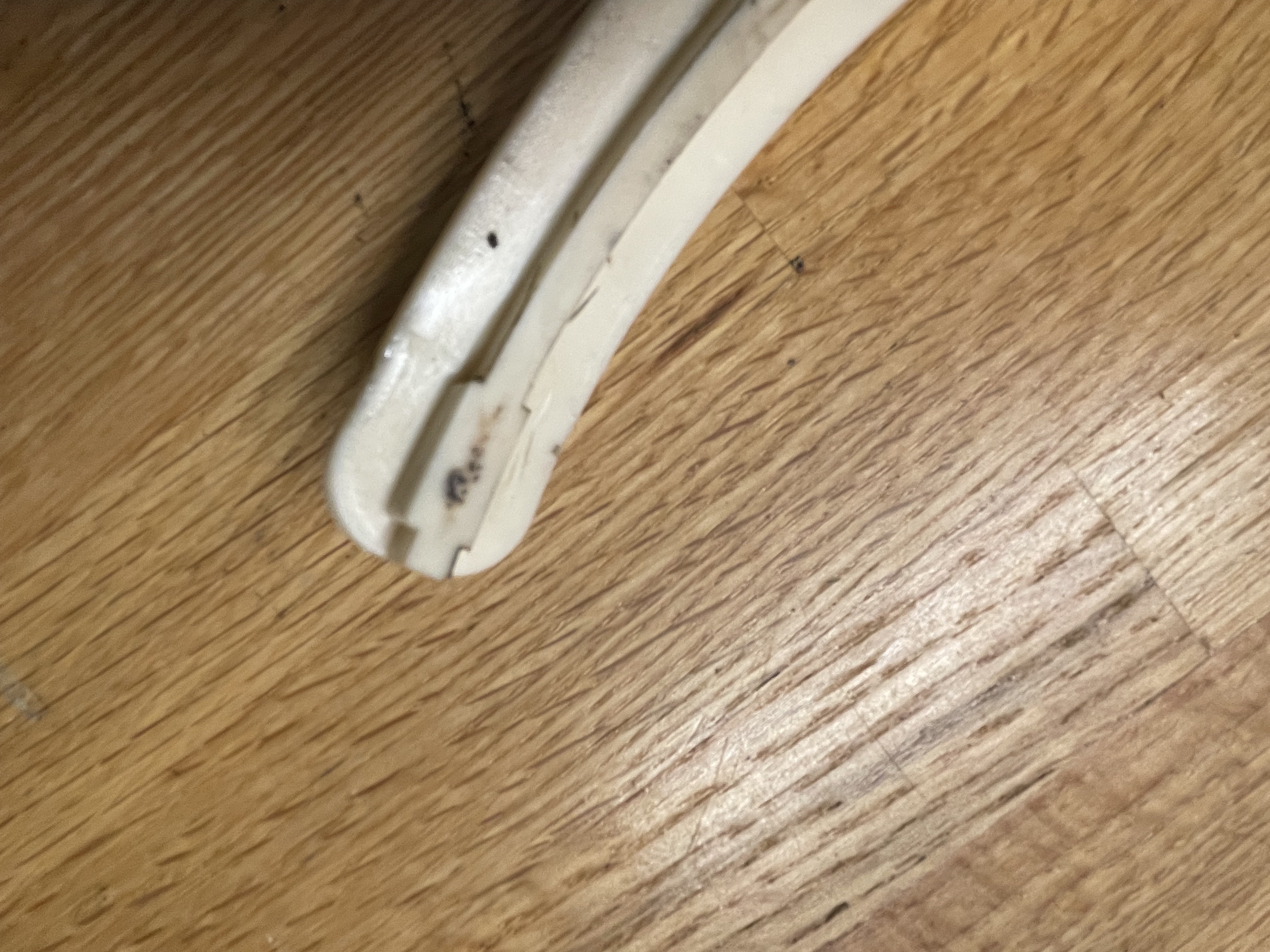

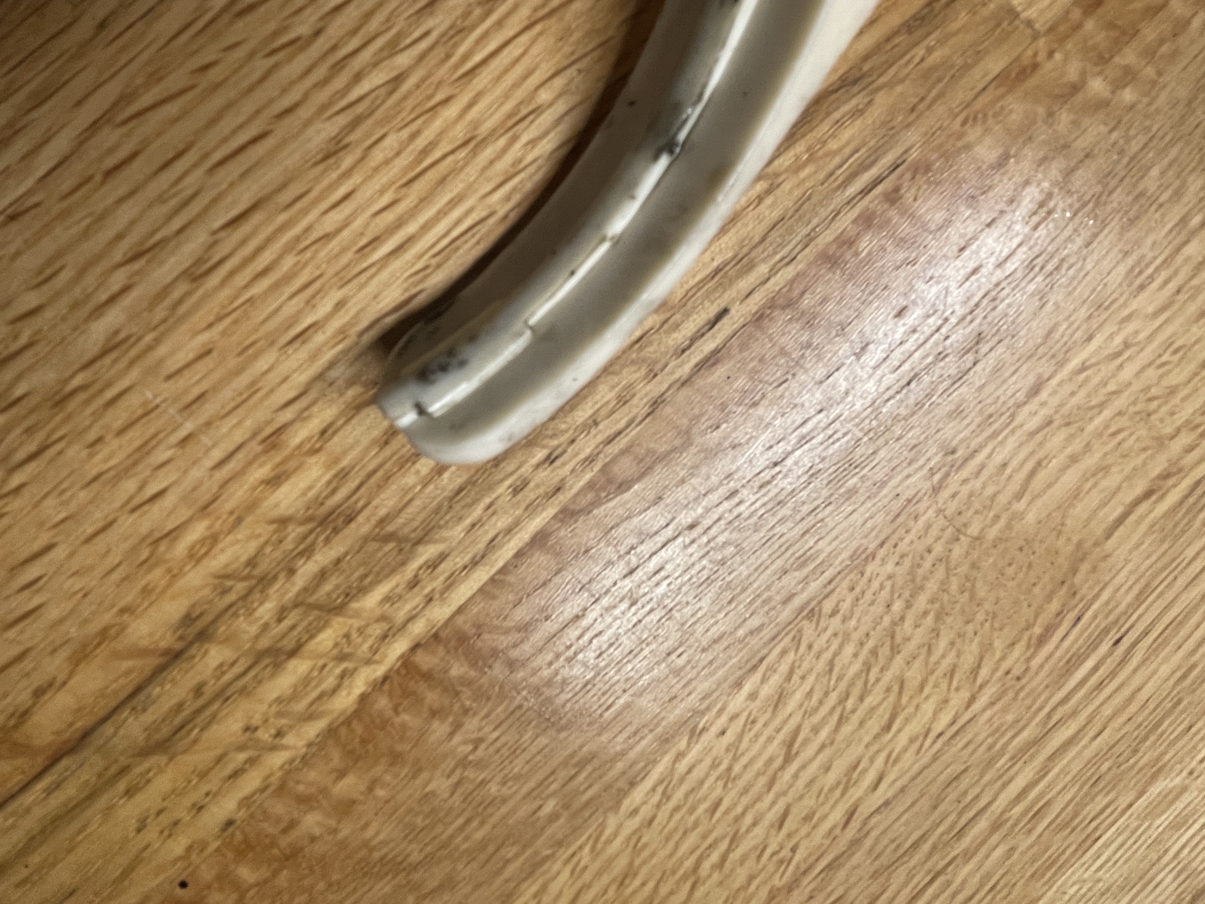

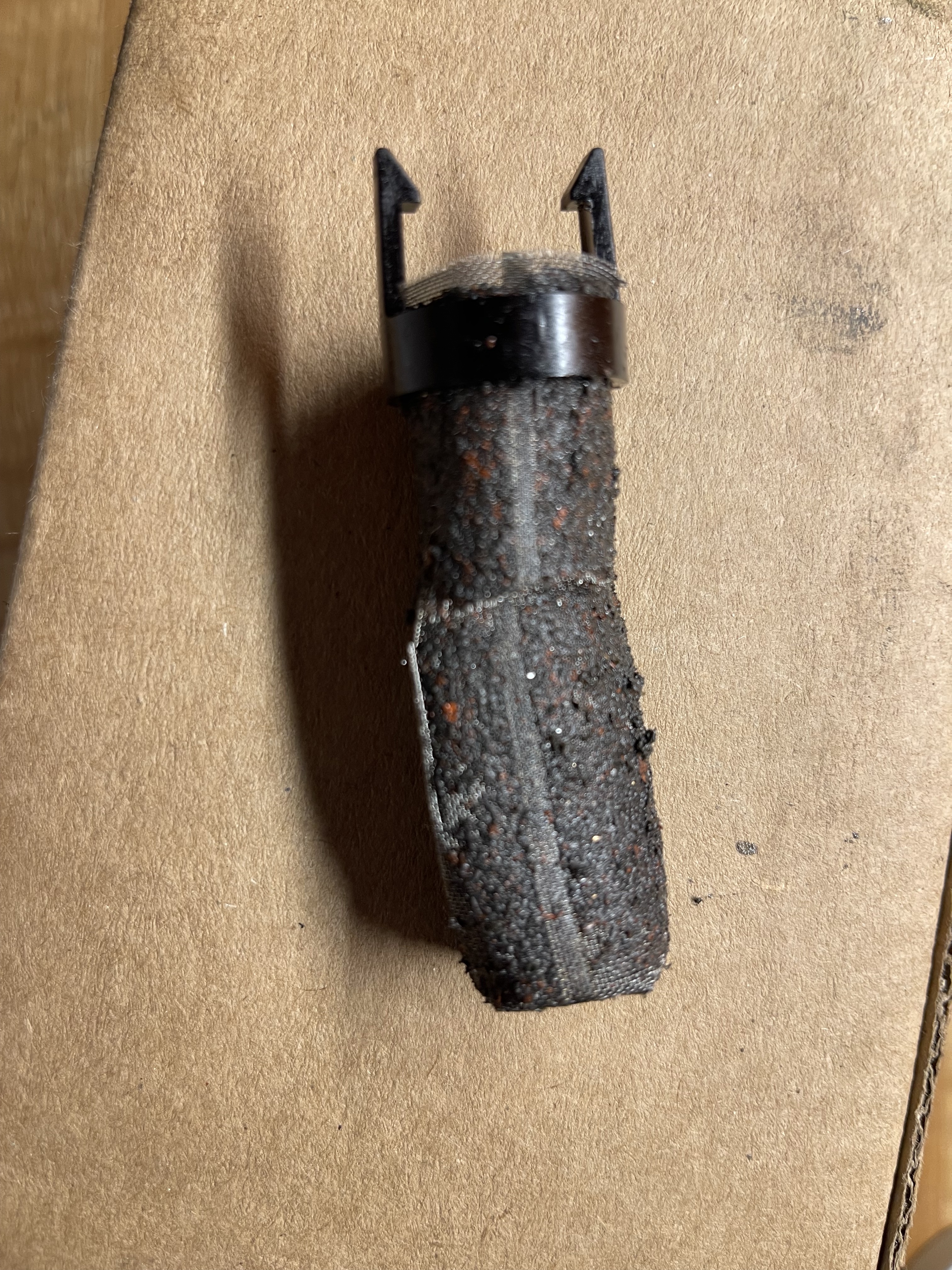

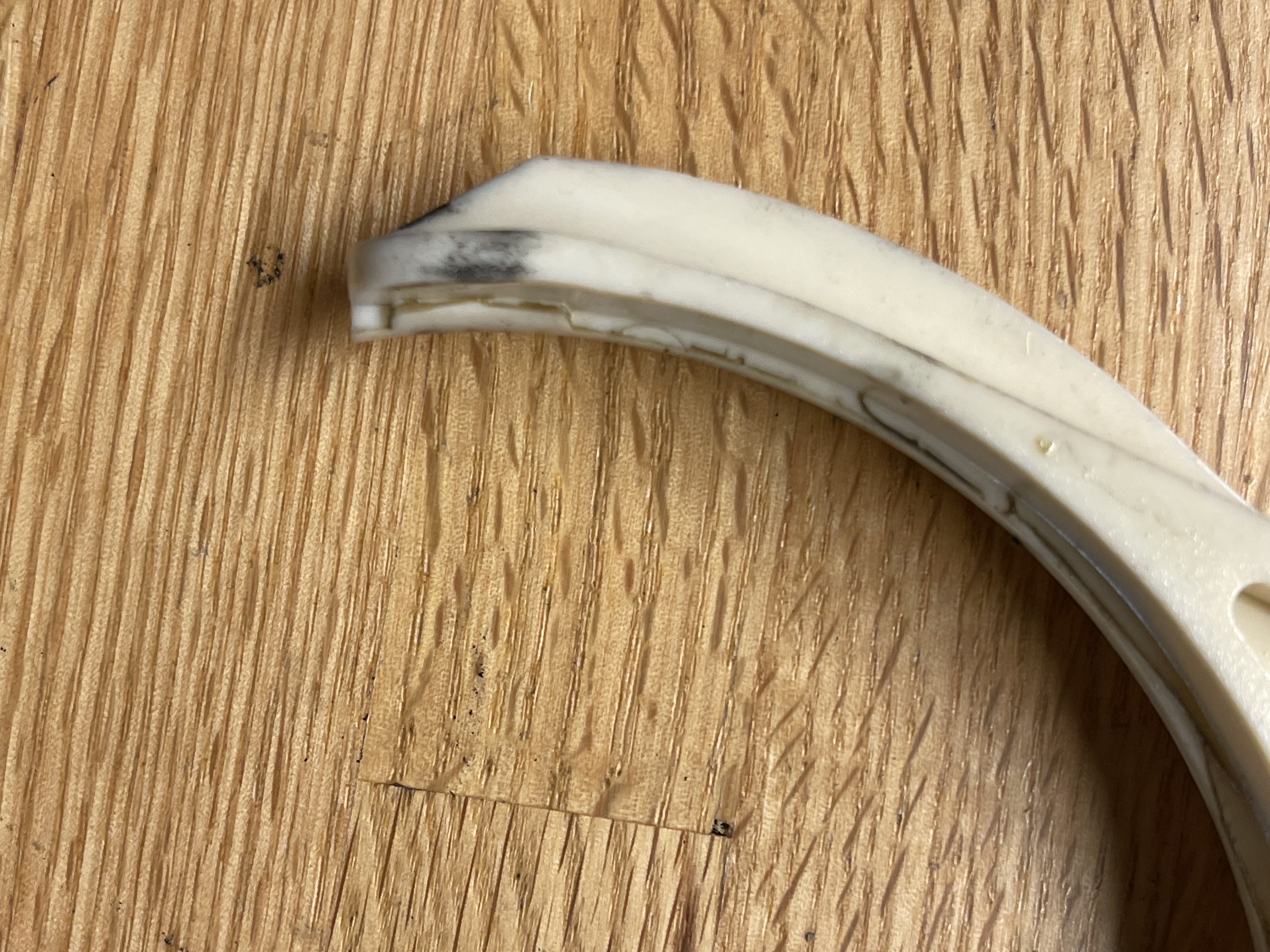

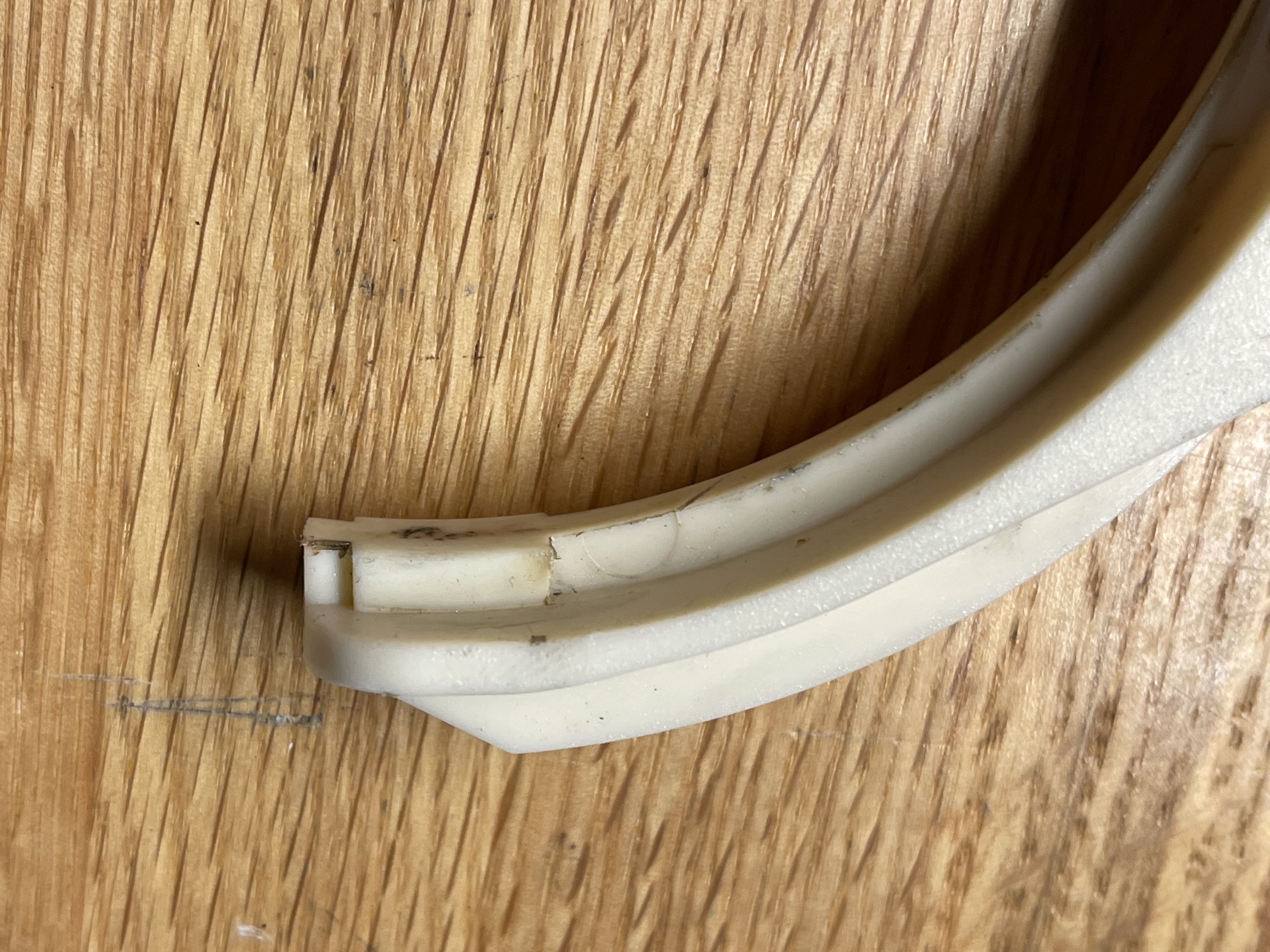

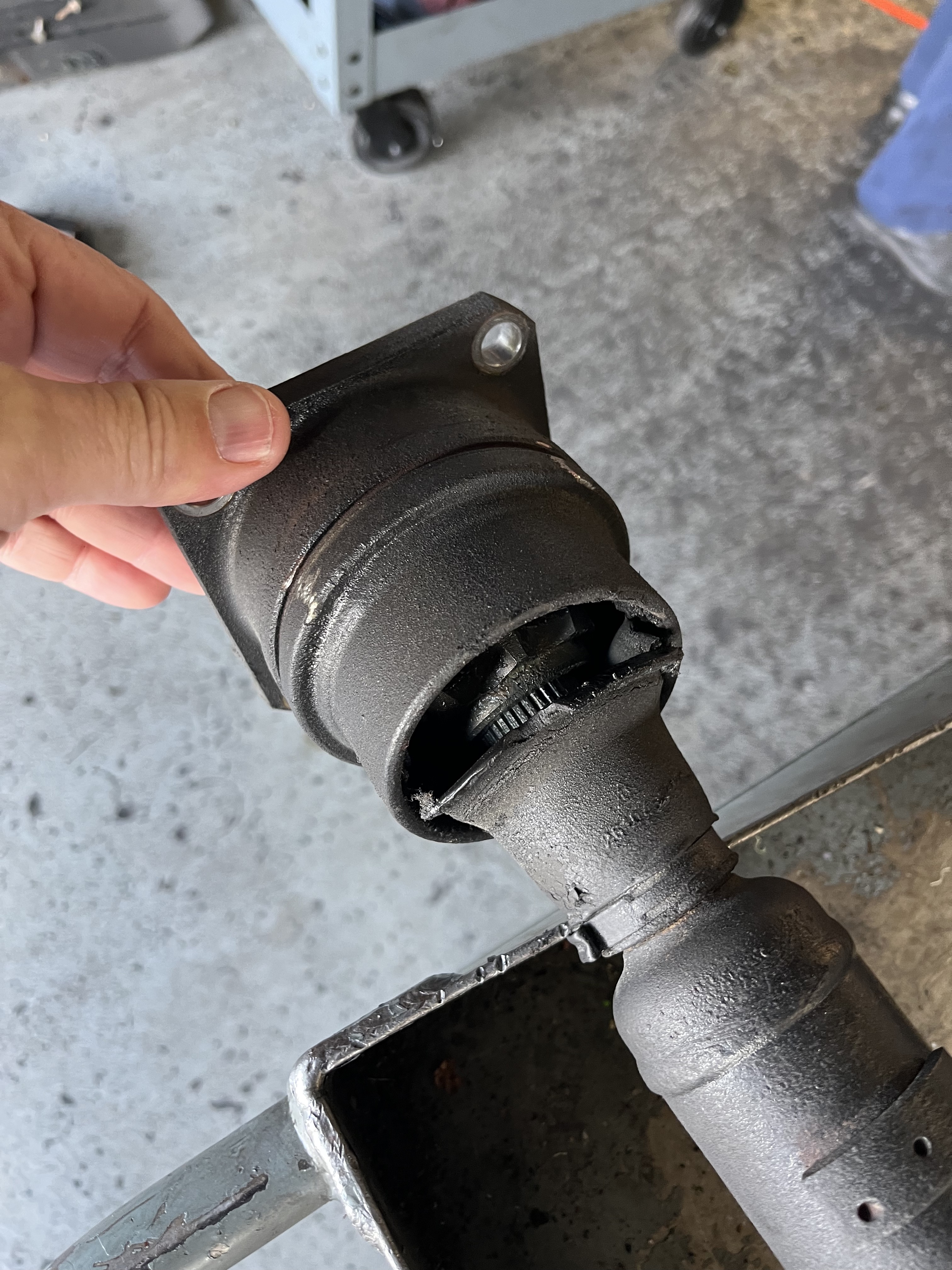

New owner of a H3 2007 with 185k miles here and want to share my transfer case experience. So when making a sharp turn usually to park in the drive way the car would not move and I had to back up the car and go back and forth several times to park the car. The car was driving very sluggish and heavy and sometimes I heard a load metal on metal clunk noise when making a sharp turn. I had this problem on-off and sometimes was able to make a sharp turn without problem. Took my car to four different mechanic shops (including a GM dealer) and each of them found something broken and changed it but did not solve the problem. I ended up doing google search and reading the Hummer forums about other H3 owner's experience and found out about the TC plastic shift fork. I took my car to a transmission shop in Mission Viejo and ask them to open and inspect the transfer case (and agreed to pay $400 just to open the TC). Turned out that the jaws of the plastic shift fork are worn and the TC is locked in 4hi/low. There was a lot of debris in the transfer case and the TC oil pump filter was torn which was replaced. The shift fork was replaced by a GM metal fork. The drive shaft was also changed. The improvement in driving is very noticeable. The sharp turns are now without problem and the car seems to drive faster and easier. I think I have been driving for weeks in 4hi/low lock because of the shift fork malfunction.

Well it's a GM safe / spend cash job..... well known. I replaced mine with the aluminium one and changed the filter like few of us did. Never had issues. But that used drive shaft has nothing to do with it
