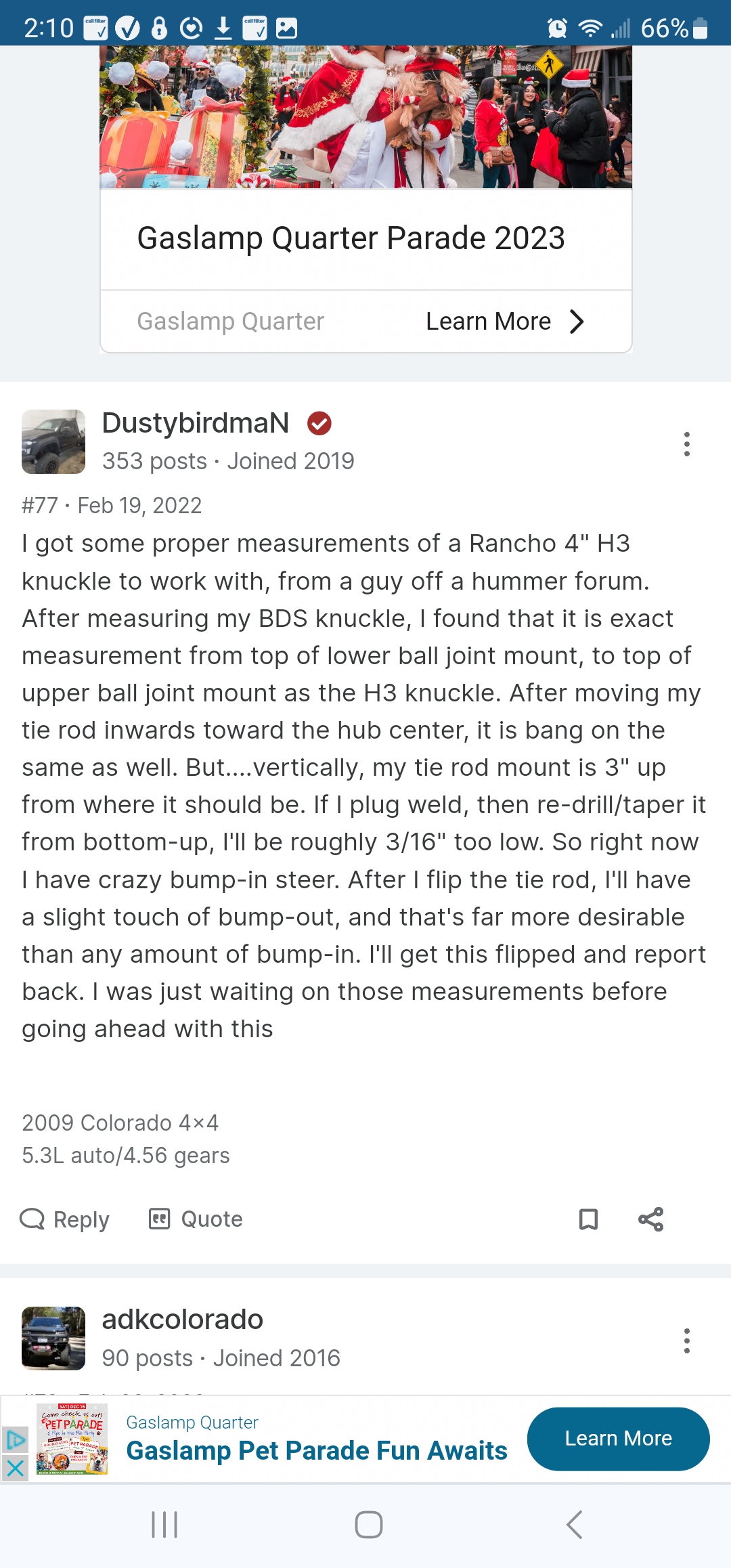

I see guys on the gmt355 groups using the h3 arms with cv axles in conjunction with the Colorado lift kits to achieve a longer travel and more lift. I winder why anyone hasn't test fit some Colorado lifts onto these.

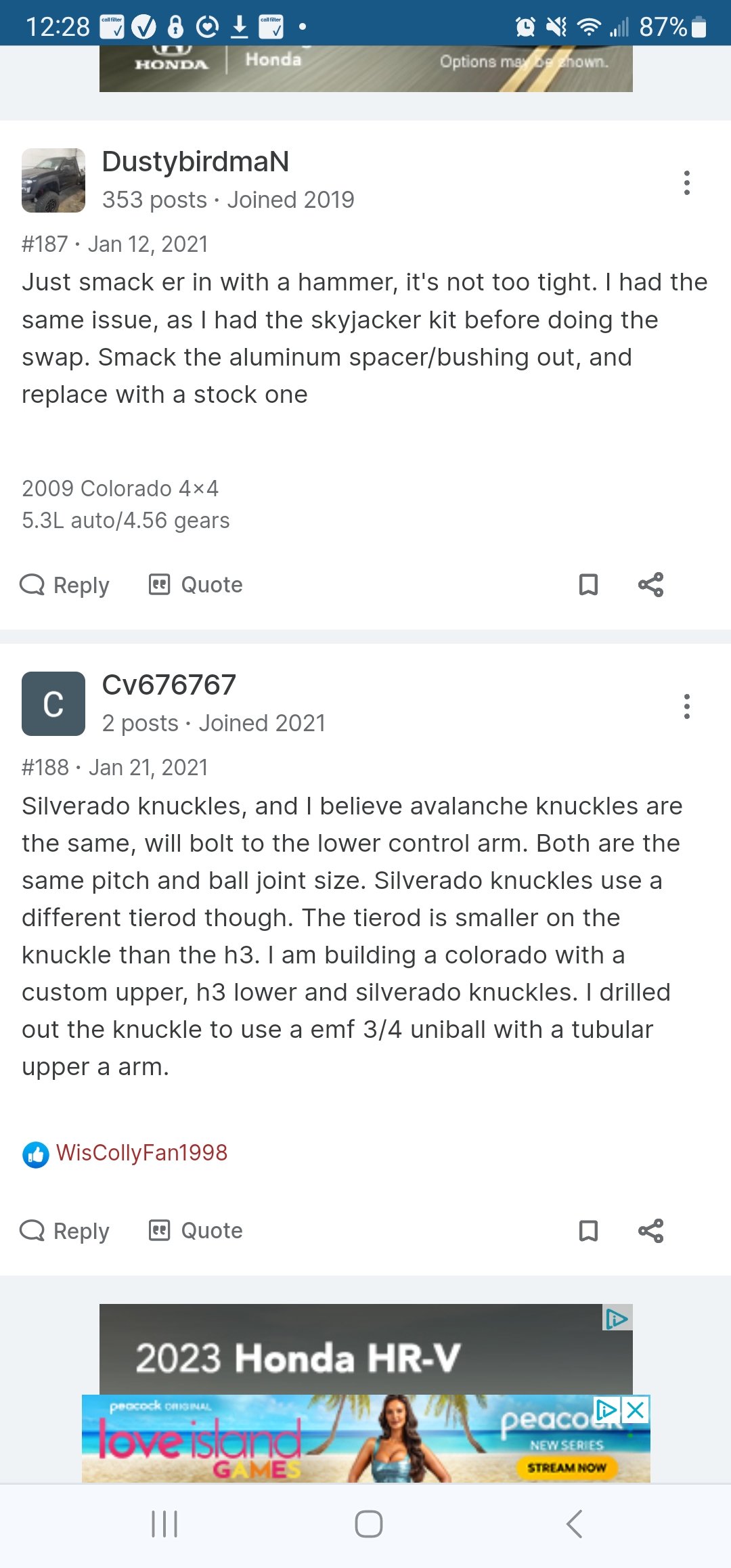

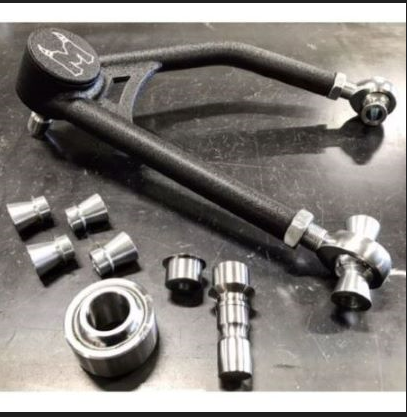

These guys use Michigan metal works uca with silverado knuckles and h3 lca and h3 cv axles. I bet something like this would fit. Soon as I get a h3 I am going to test this

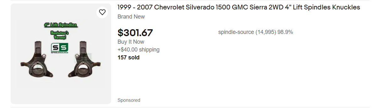

I wonder what this setup would net for lift? The Silverado knuckles could be junkyard sourced, just leaves the Michigan metal works UCA's. However the ZR2 telescoping CV axles are also intriguing.

Check out the guy who deleted the torsion bars and ran silverado coilovers. He has a thread on there too.
The Colorado knuckles from the lift will not work with the cv axles on the h3. That's why he used the silverado with mmw uca. Mmw will make custom knuckles aswell. But the junkyard silverado knuckles are budget friendly.

You could use these 4" Silverado lift knuckles then correct? Like these? Have Michigan build the UCA's to match the upper ball setup LCA's should work with the H3's ball setup correct?
The Michigan Metal Works adjustable UCA arms look pretty sweet.
