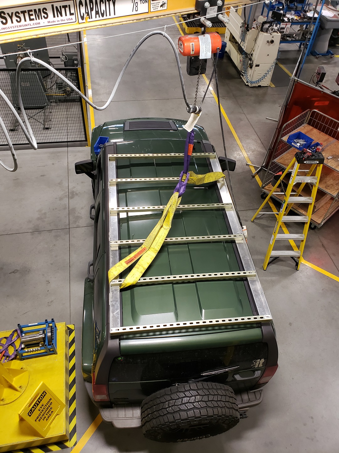

Just finished my D.I.Y. roof rack for a D.I.Y. roof top tent I'm going to be making.1.jpg2.jpg7.jpg10.jpg

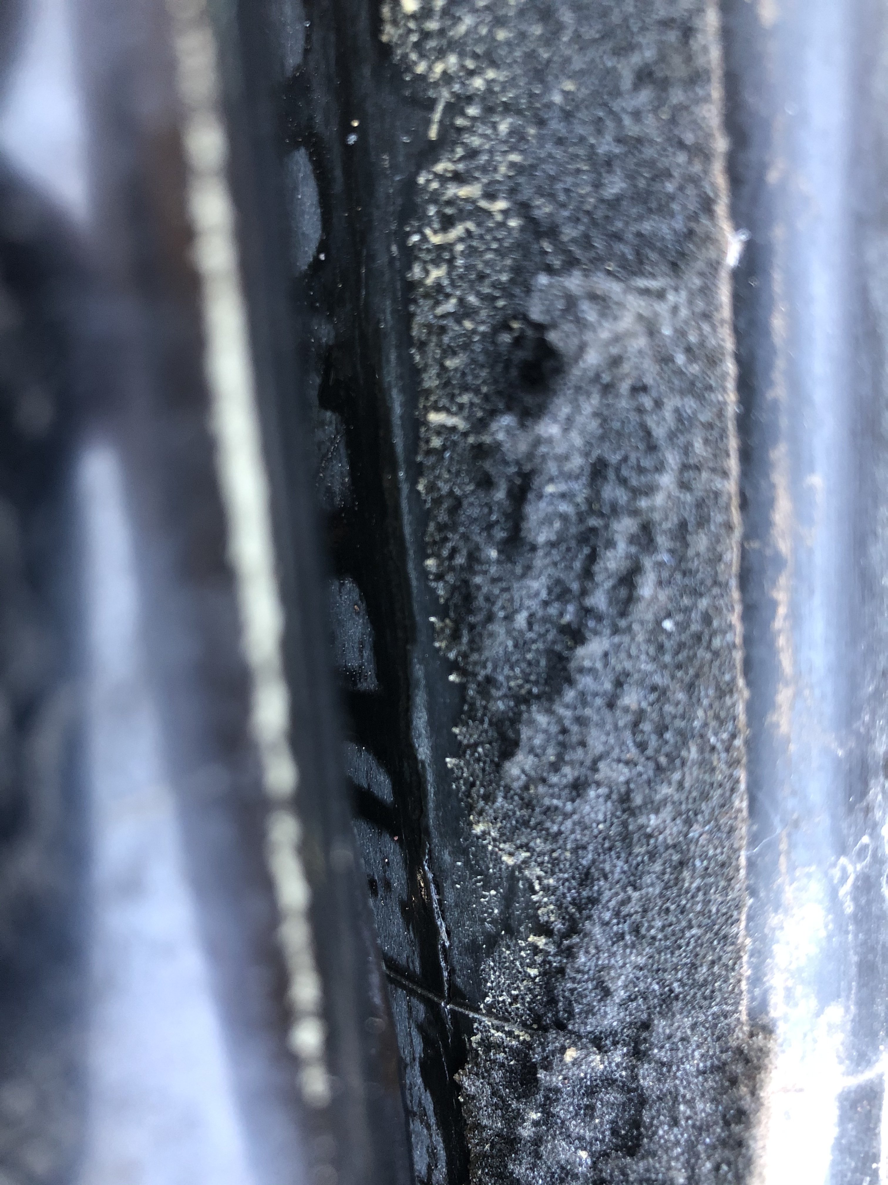

So I'm having this feeling that my roof leak is coming from the roof rack rails. Any recommended fix for this other than going up there and tightening down whatever bolts exist? Should I be siliconing certain parts?
You need to unbolt the roof rails to access the area below it. I cant recall who, but one member went through this to solve his leak issues and he had alot of issues to solve. Sealant may be enough depending on how bad the rails are
It could be the roof rails where they bolt into the roof, or even the pinch weld itself. I discovered the sealant used during manufacture to seal up the seam was disintegrating and the sheet metal was starting to rust underneath it. Still need to fix the other side. I cleaned off all the old stuff and rust, primed it, then coated it with RV roof sealant and painted over it.

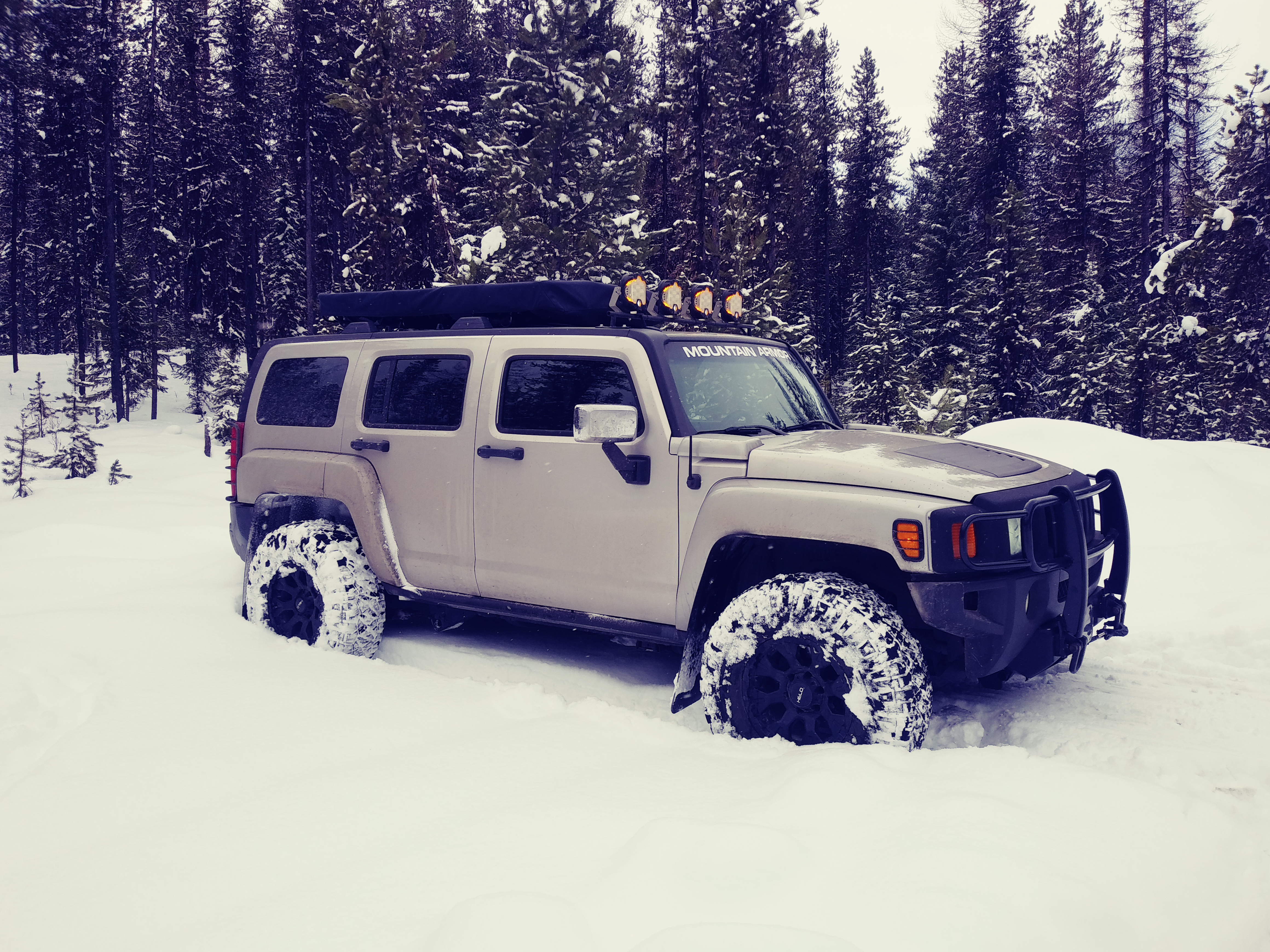

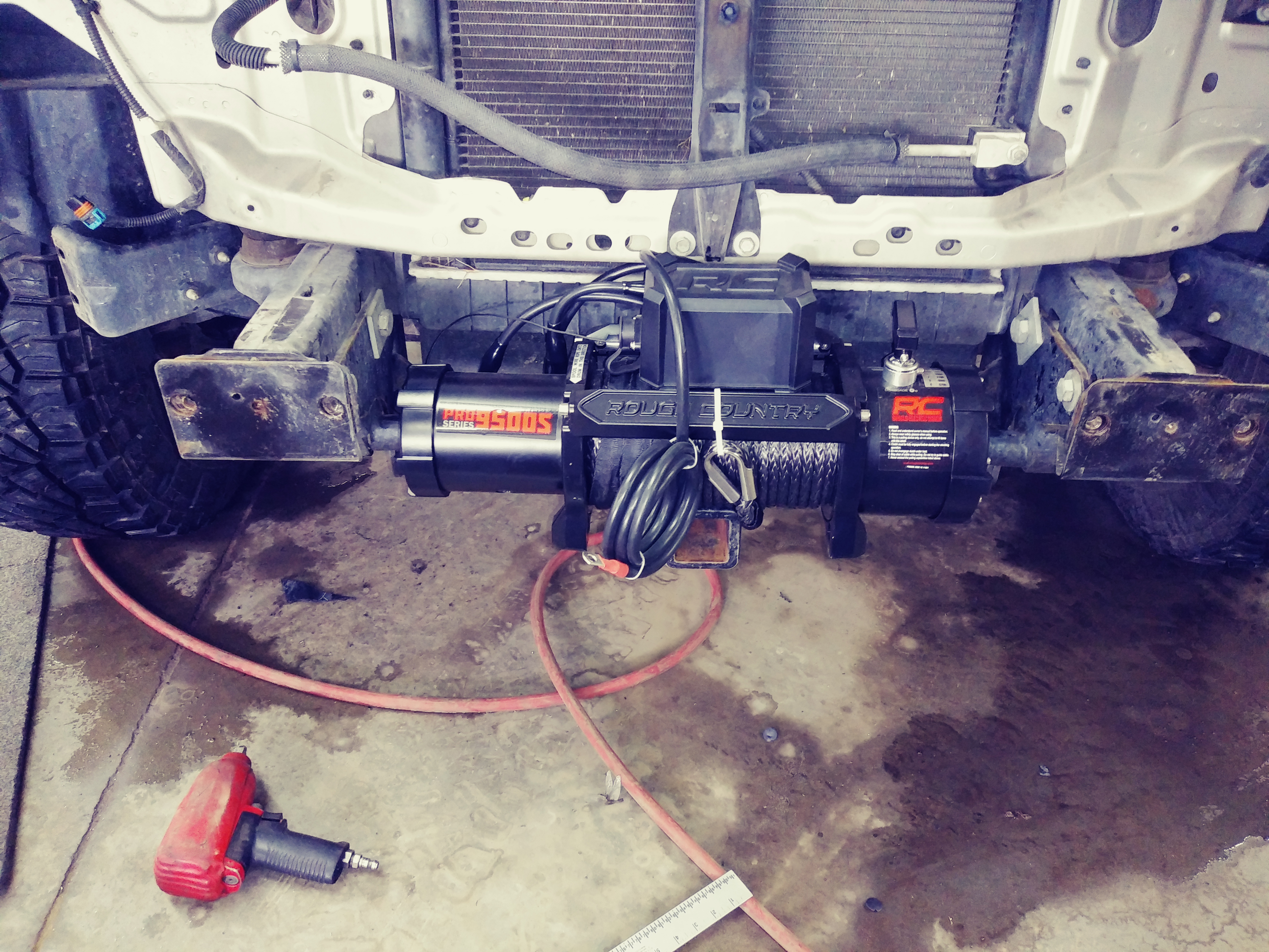

After two years of searching for the Alpha I was looking for, finally found one 3 weeks ago and have been working non-stop to get my off road build done on it. I now own 2 H3's, wife took my 07 I bought new. When the weather warms up a bit here, I will do a build video, I've been trying to take more pics as I work to give everyone some ideas on unique stuff I've done. The slant back conversion on the 07 H3 will still happen but got pushed back a bit. Picture stock, winch mount I made this last weekend, and playing in some snow Sunday.
Im assuming that I need to drop the headliner to see the pinch weld?
Nope, you take the roof rail mounting channels and the plastic trim off. The channel is held on with torx bolts, it all comes off pretty easily. The pinch weld is right below that and is covered with a urethane sealant. On my truck the sealant was breaking down and letting water underneath. It wasn't leaking into the cabin but it was causing the sheet metal to start rusting. I have heard of others though that it did end up leaking into the cabin. Another source of leaks there is the body nuts themselves that the channel bolts to. To fix that just use some blue loctite or some thread sealant compound (not tape) to seal up the interface between the bolt threads and the nut threads. Could also use some silicone sealant as well.
Here's the post in my build thread about this issue: https://www.hummer4x4offroad.com/fo...-s-Alpha-build?p=236160&viewfull=1#post236160
