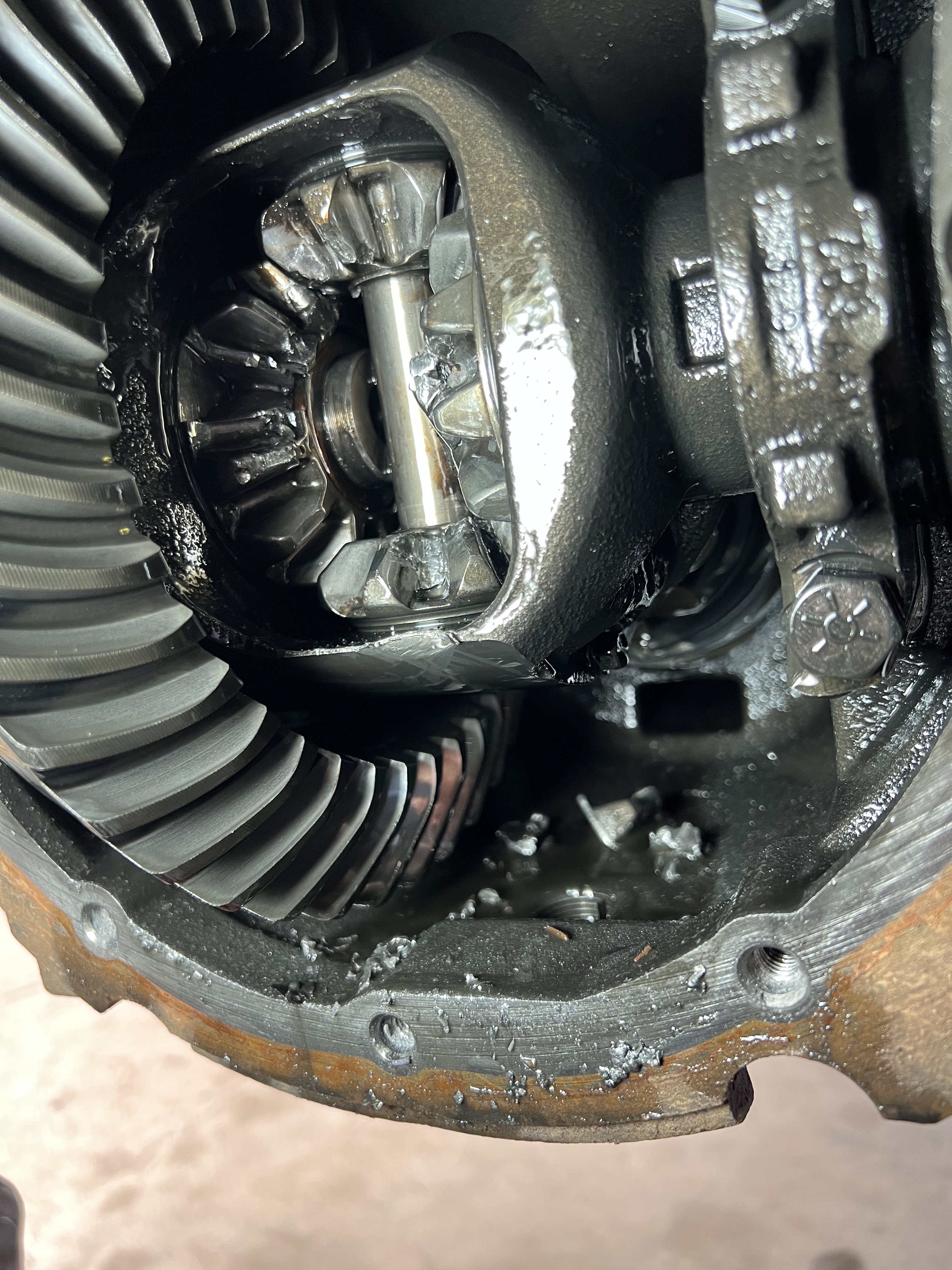

Trucks coming along great. Hit a small snag this week as the Lincoln locker failed. Had a good run and it took a beating. Lookin into swapping in a 14 bolt prior to moab.

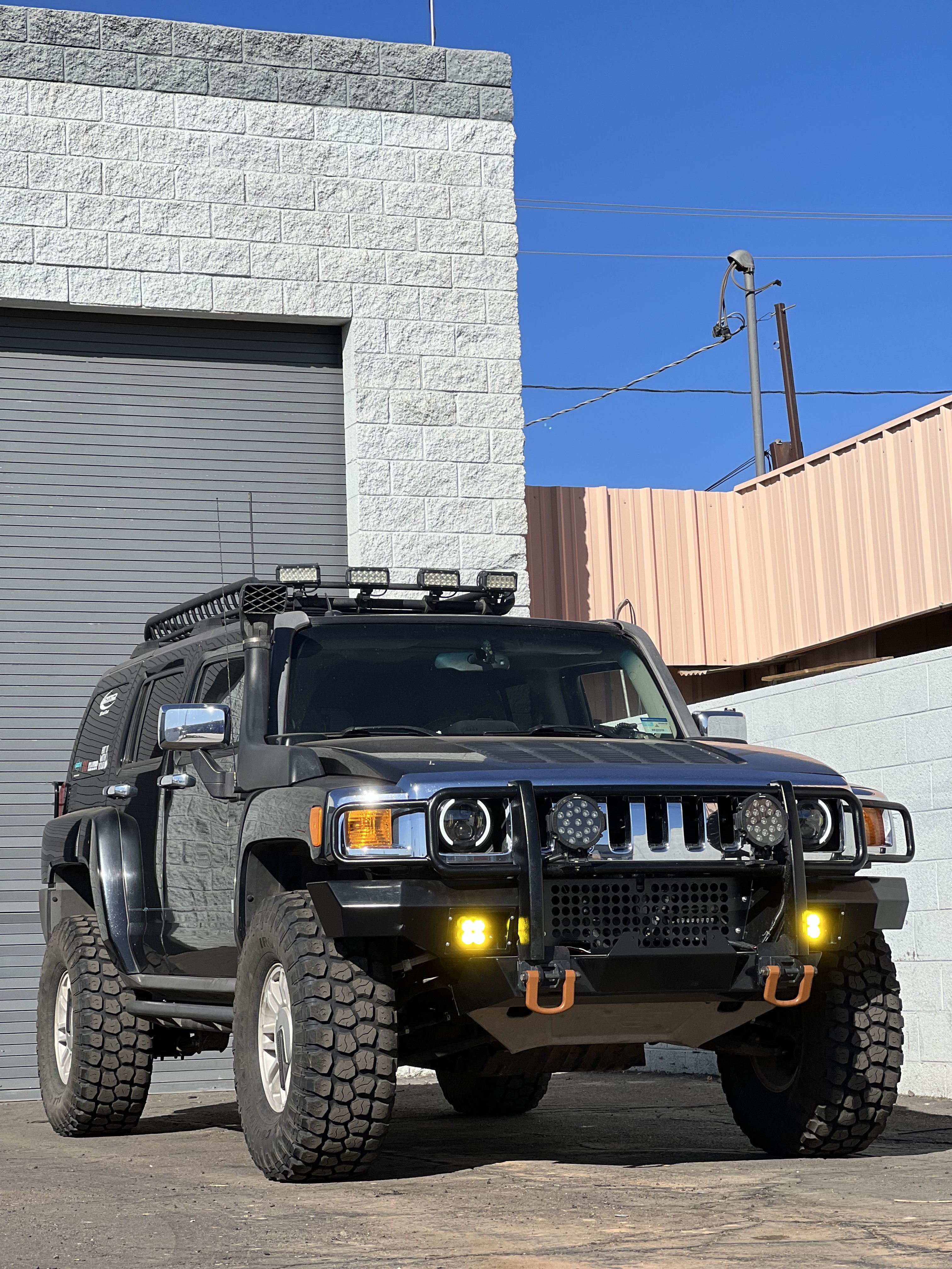

H3T Alpha Brush Guard --- Installed
Bought a new brush guard a few months ago and finally got around to installing it.
Had to drill new mounting holes up since I have the 1" body lift in addition to the Rancho lift.
Love it, and compliments the newly painted body-matched grill rather well.

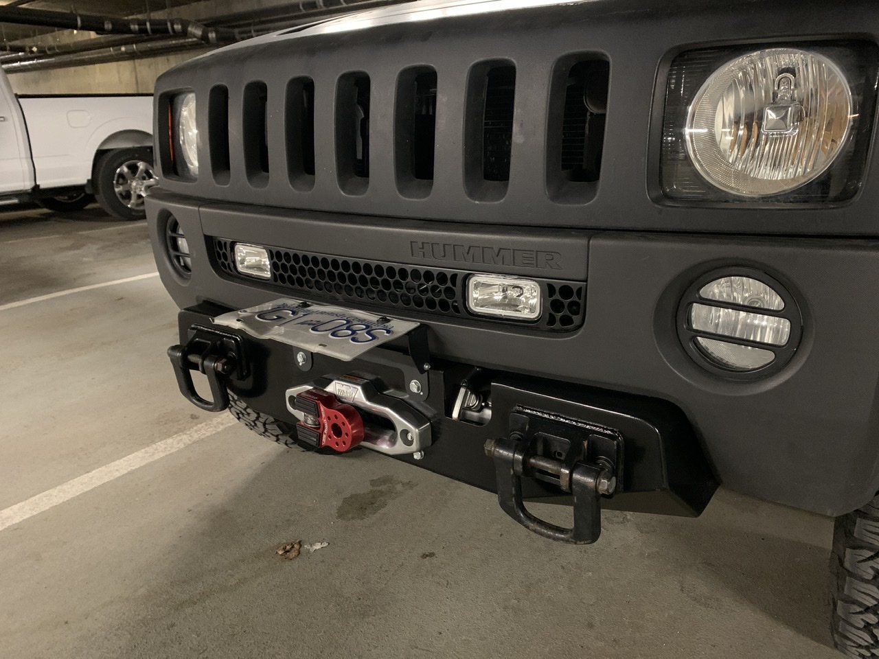

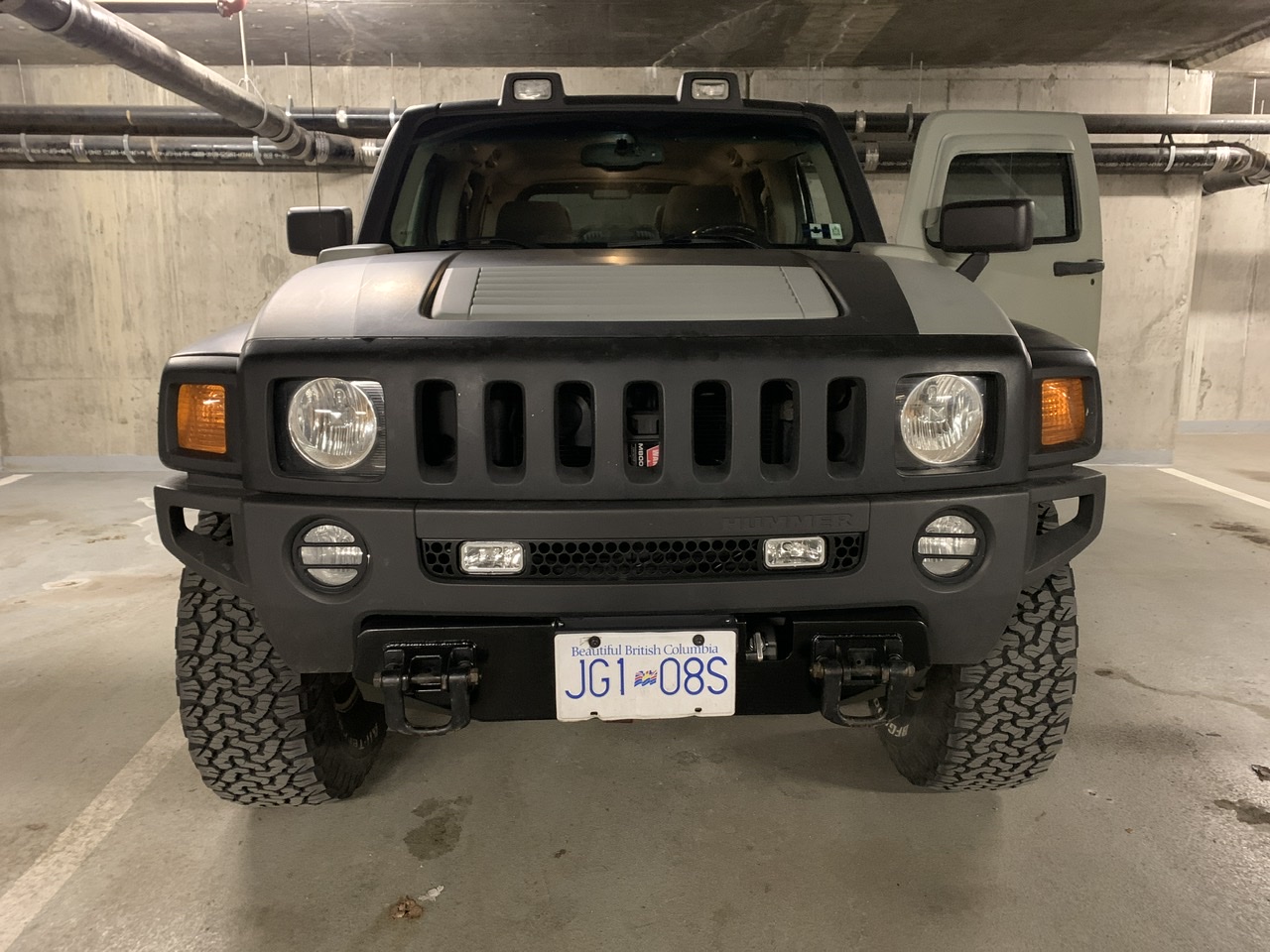

I found a never-installed defelice winch bumper, got a Warn M8000 for it, and installed some grill lights after plastidipping out the chrome. No more switch blanks!
