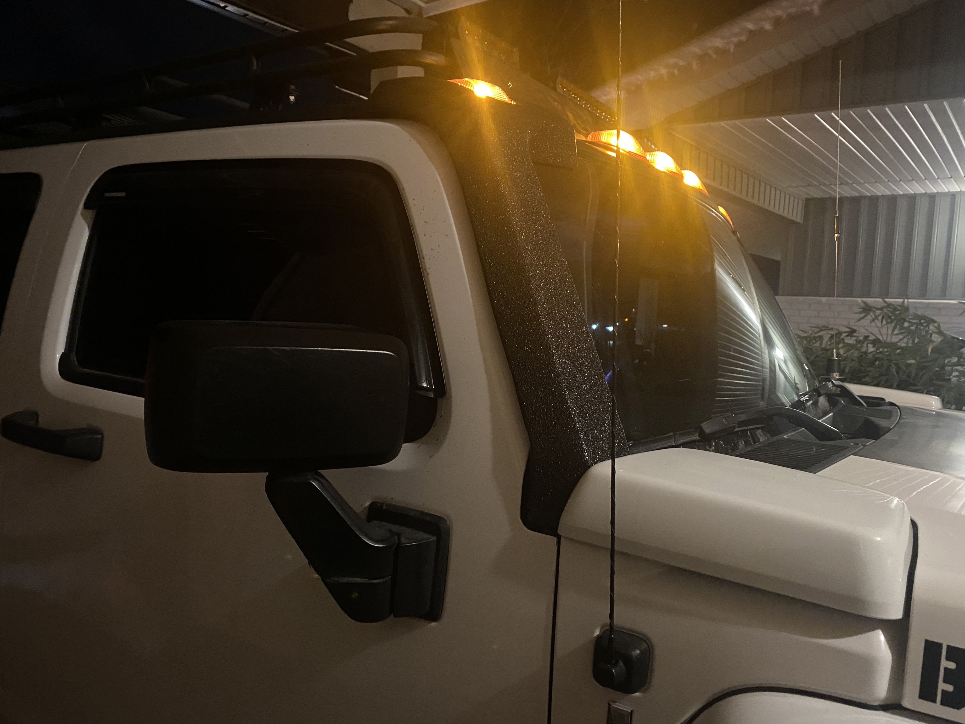

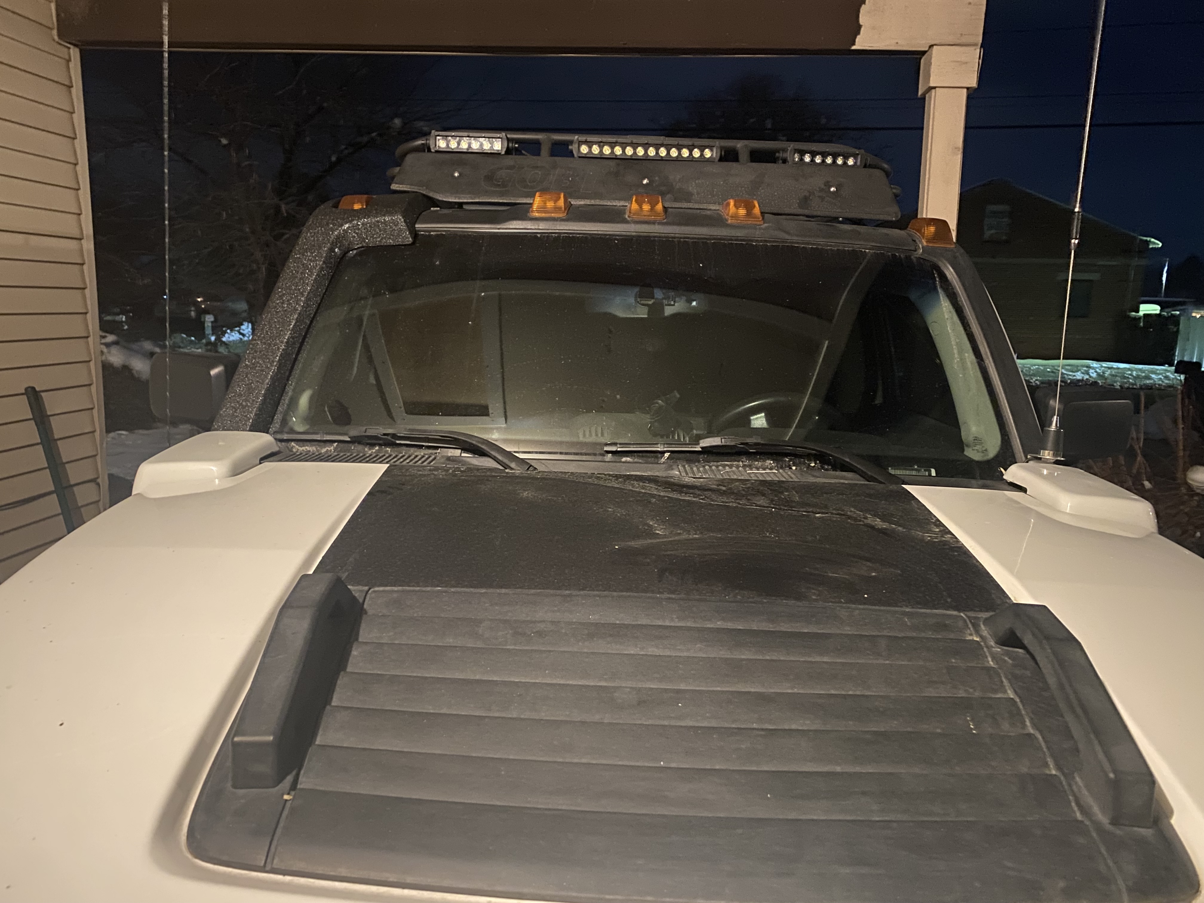

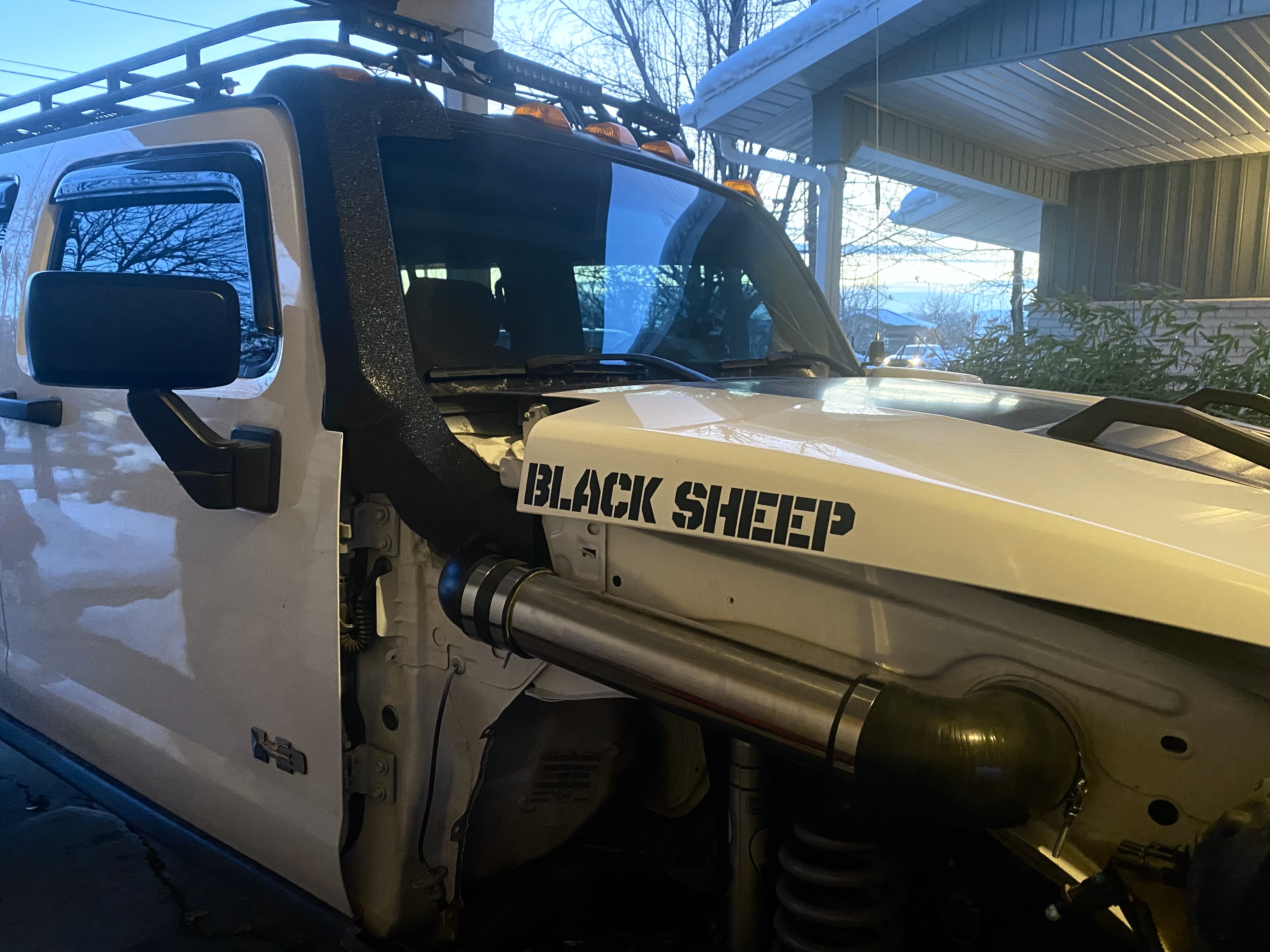

Yesterday, I was able to finish the A-pillar snorkel similar to ones I've seen for FJs that replaces the A-pillar trim. I originally wanted to finish it in a textured black powder coat to better match the factory trim but being my first aluminum project, I felt there were too many imperfections that would show up, so I opted for Rhino-liner instead. A bit more texture than I'd like but I'm overall happy with the end result. I don't plan on scuba diving with it or anything, but I do some water fording and water marks confirmed I have come close to pulling water in the intake. A bit of peace of mind.

Bad ass idea, my snorkel stops under that plastic cover, never took it up. That is a real good job done man 👍👍👍👍👍👍👍👍👍
I fixed it with a metal clamp and just cut a little out under the right plastic cover to let the air get better in. Well never was that deep under water till now ;)

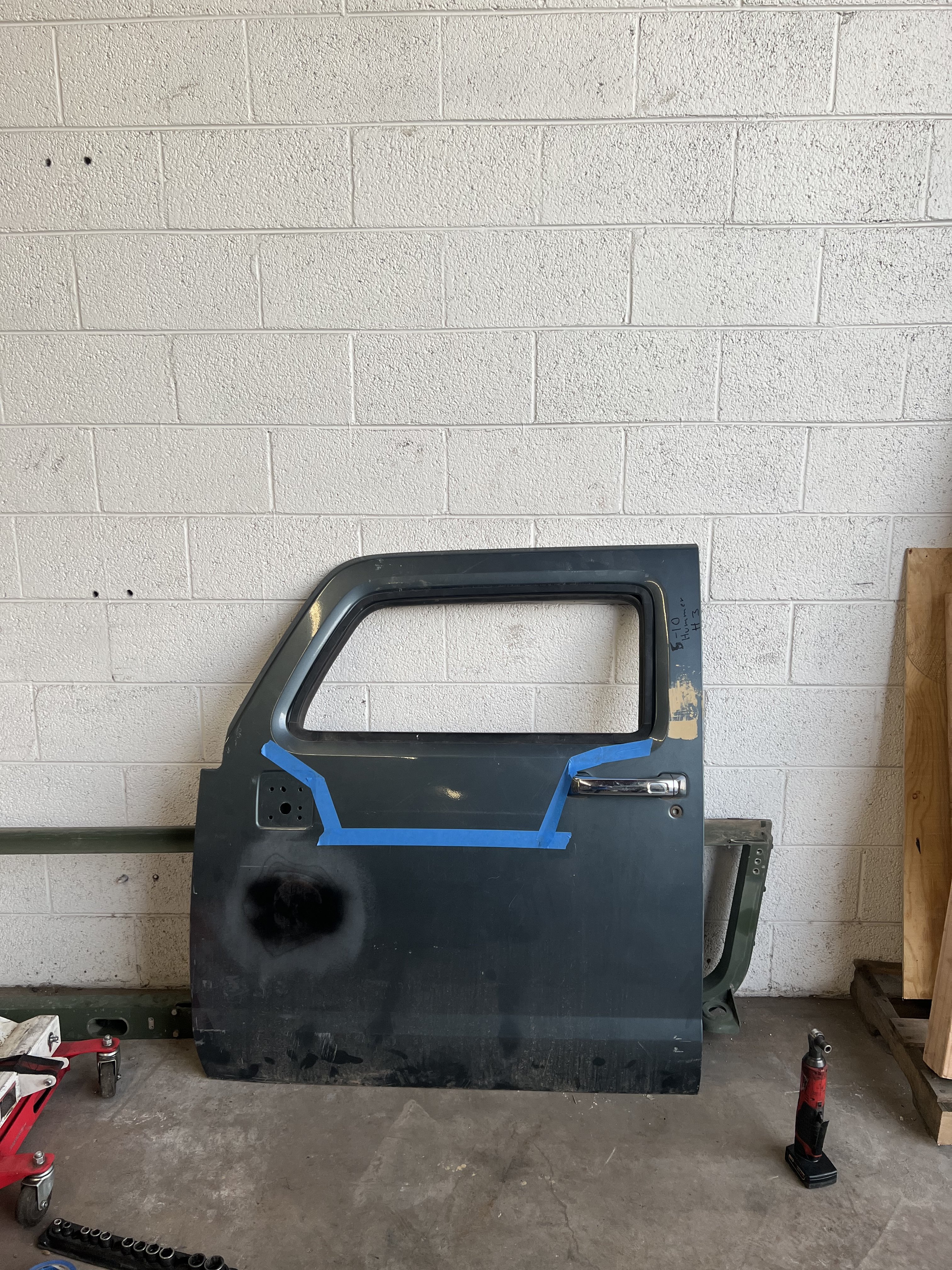

After searching for a cheap, decent door for a year. Finally got a door to chop into a half door.
Awesome, how do you plan on cutting the door?
I always thought it would be nice to retain the factory side mirror/mount as this would also hide the hinges up front
487
Planning on this cut. I want to keep the outer frame + Mirror + Exterior door handle. The area that will be removed is above the tape line. It’ll be that or less.
I’ll be picking up a beat up door card as well to cut so it’s a complete trail door. It’ll retain window controls, mirror adj, and door locks. As a bonus, a monsoon speaker
Good luck! I am interested in seeing how it turns out!
The area marked out is basically what I had in mind as well, except I was wanting to see if I could use the H1 style door handles and re-locate it just a little lower than the stock position so that the flat part could extend further back for more elbow room

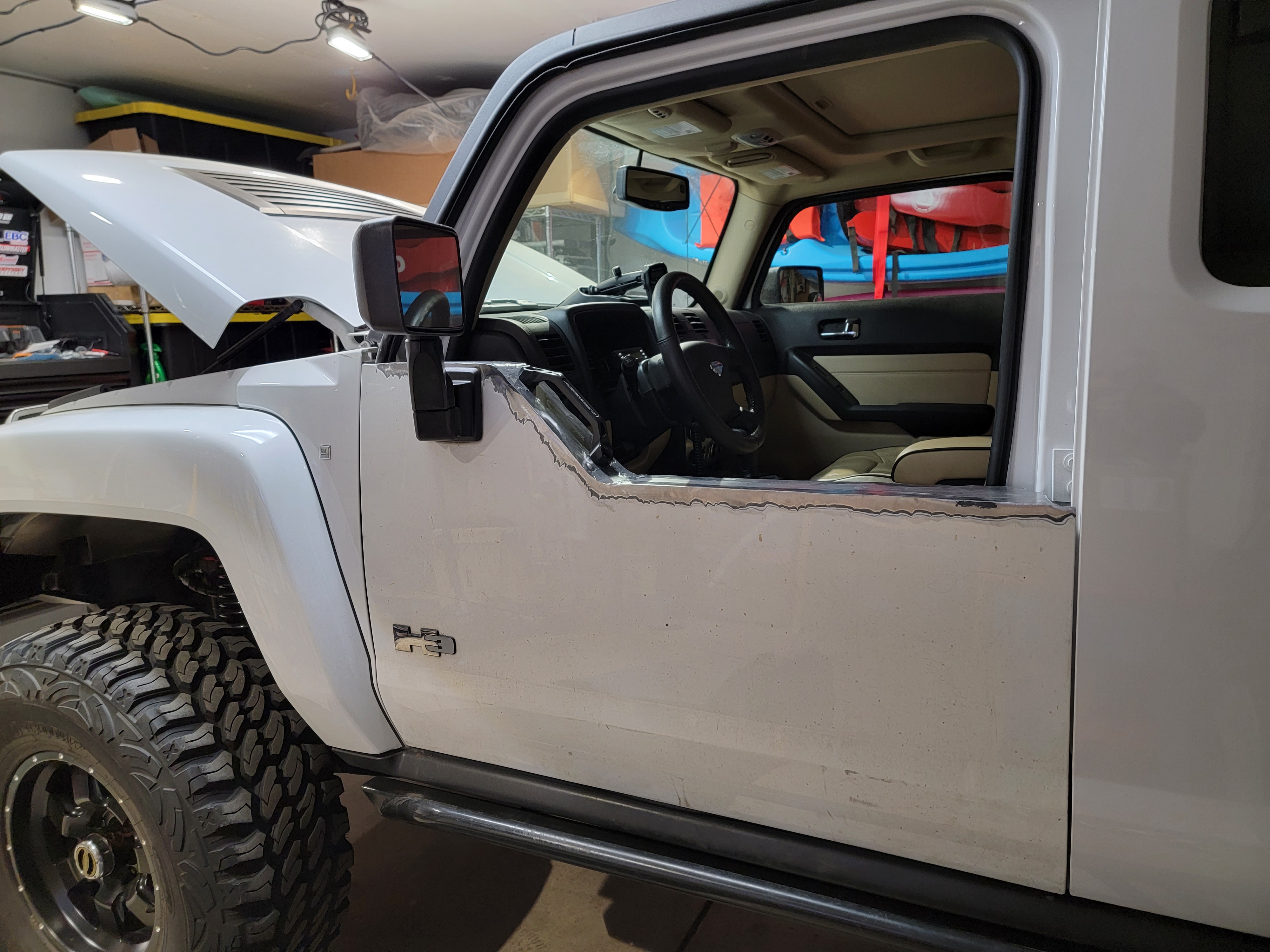

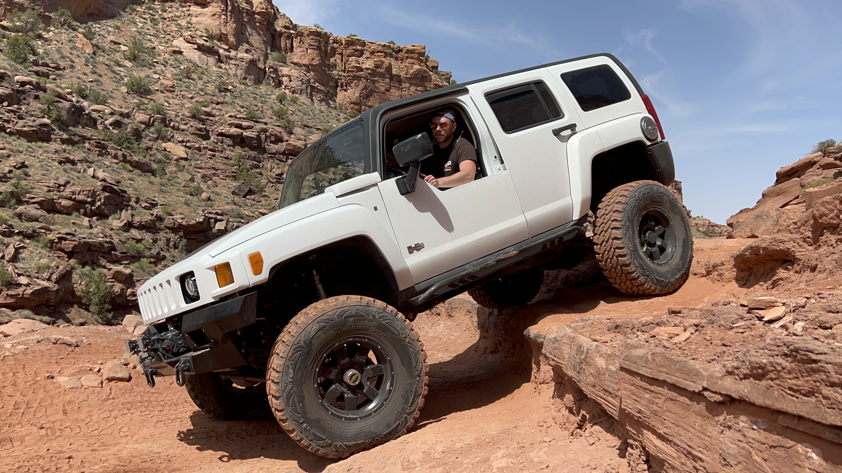

Ramrod,
That's more or less what I did. I haven't added a paddle style exterior handle yet, but that is in the plan. I found out the hardway that you need to keep the harness and switches plugged in, otherwise the other windows and locks don't work haha

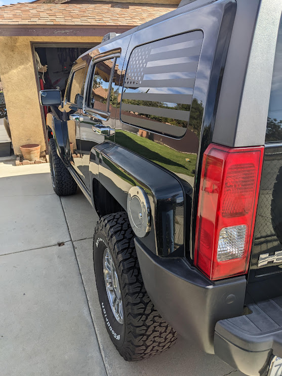

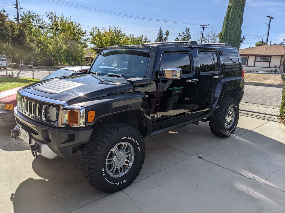

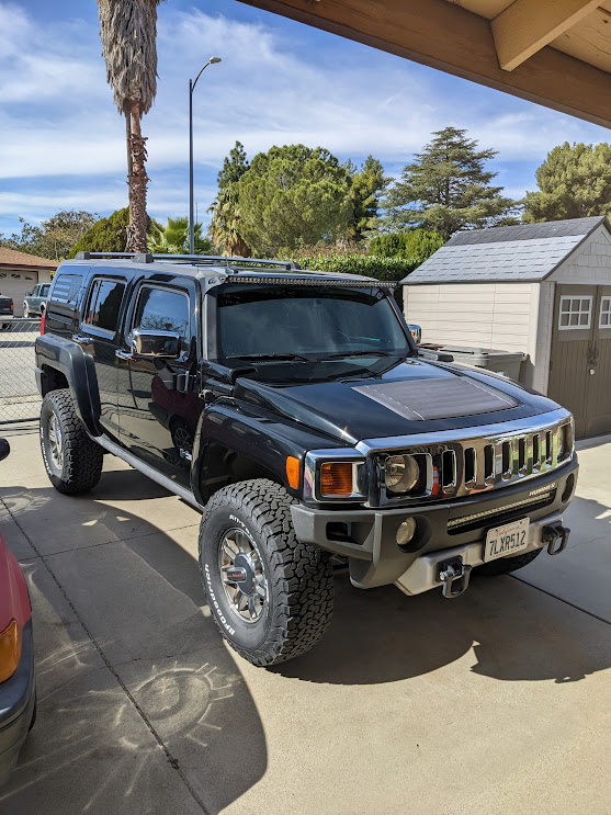

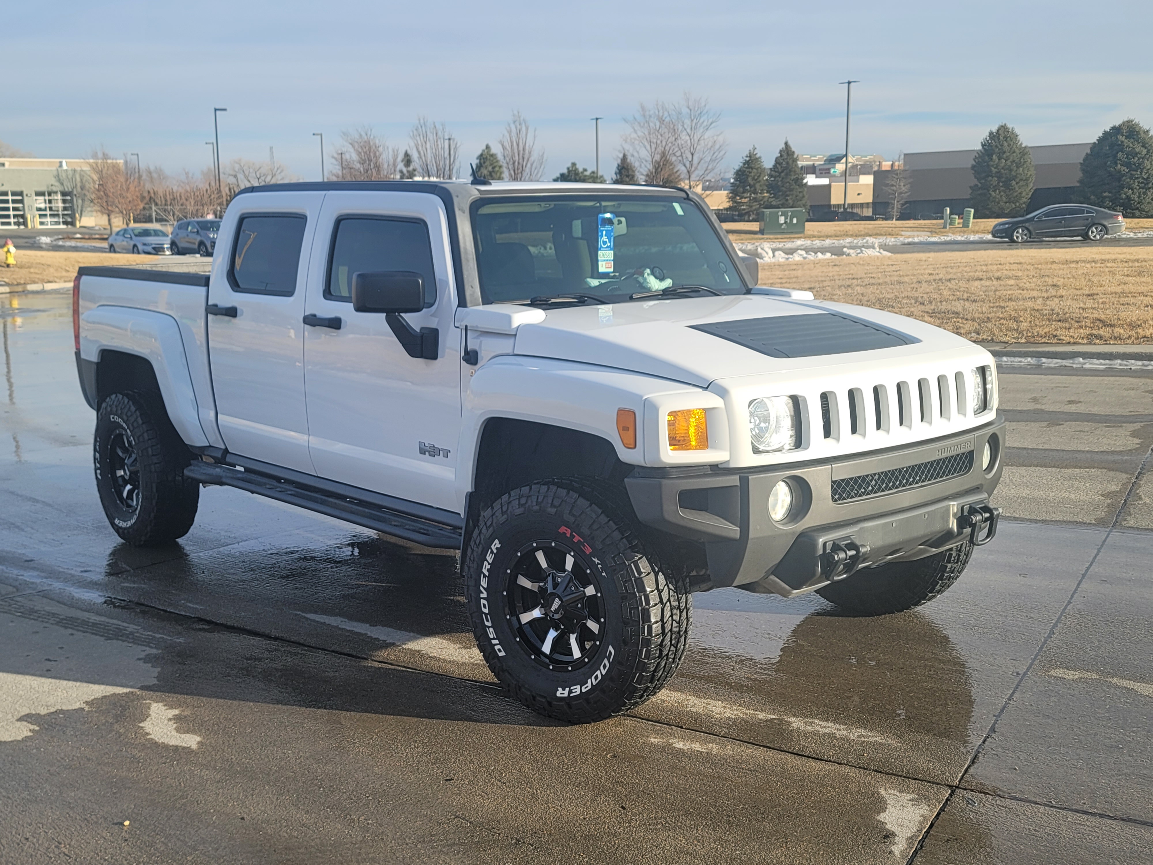

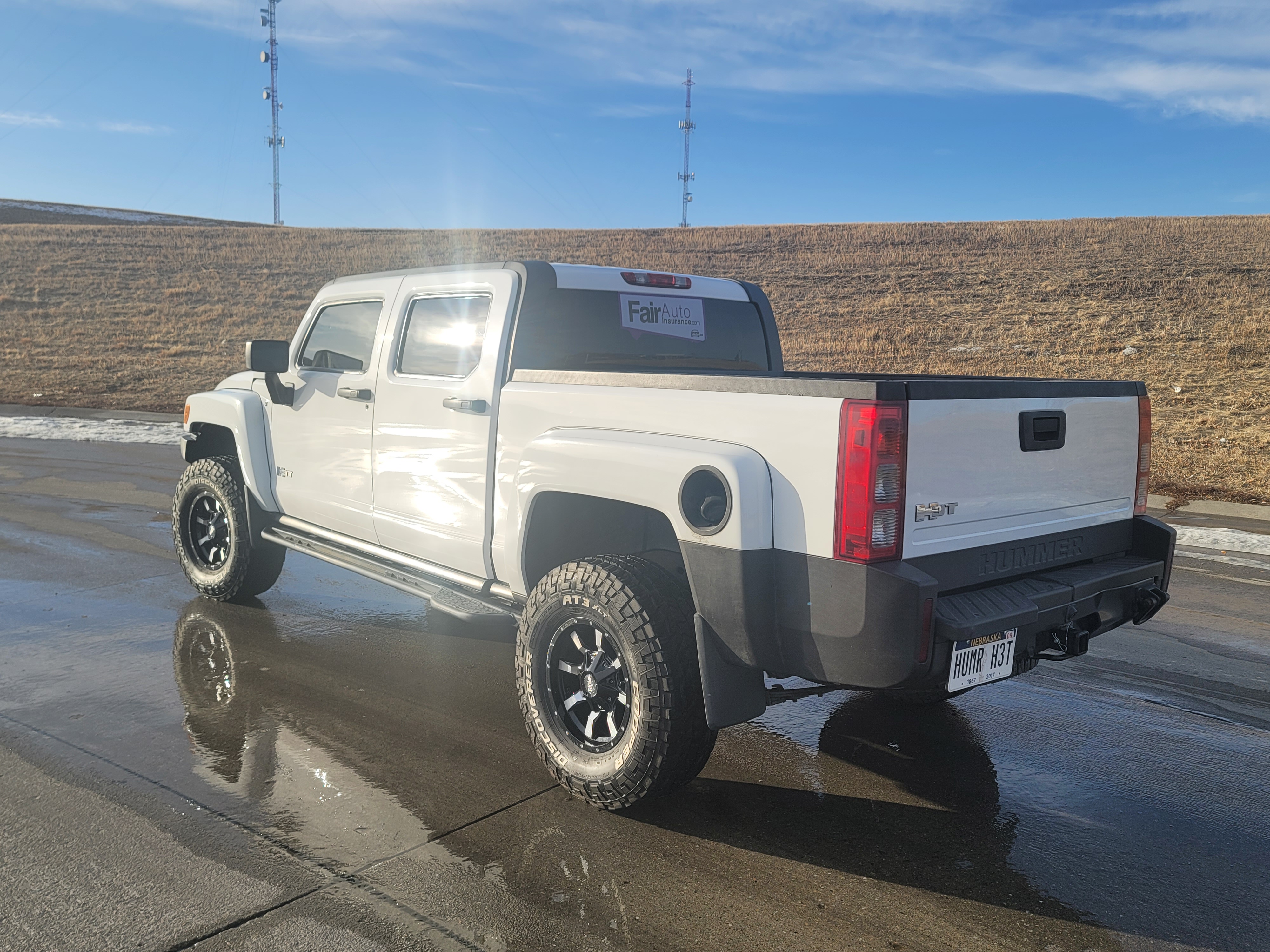

updated the factory OEM Wheels to a set of Moto Metal MO970 16X9 took my Coopers (white lettering to toe outside
