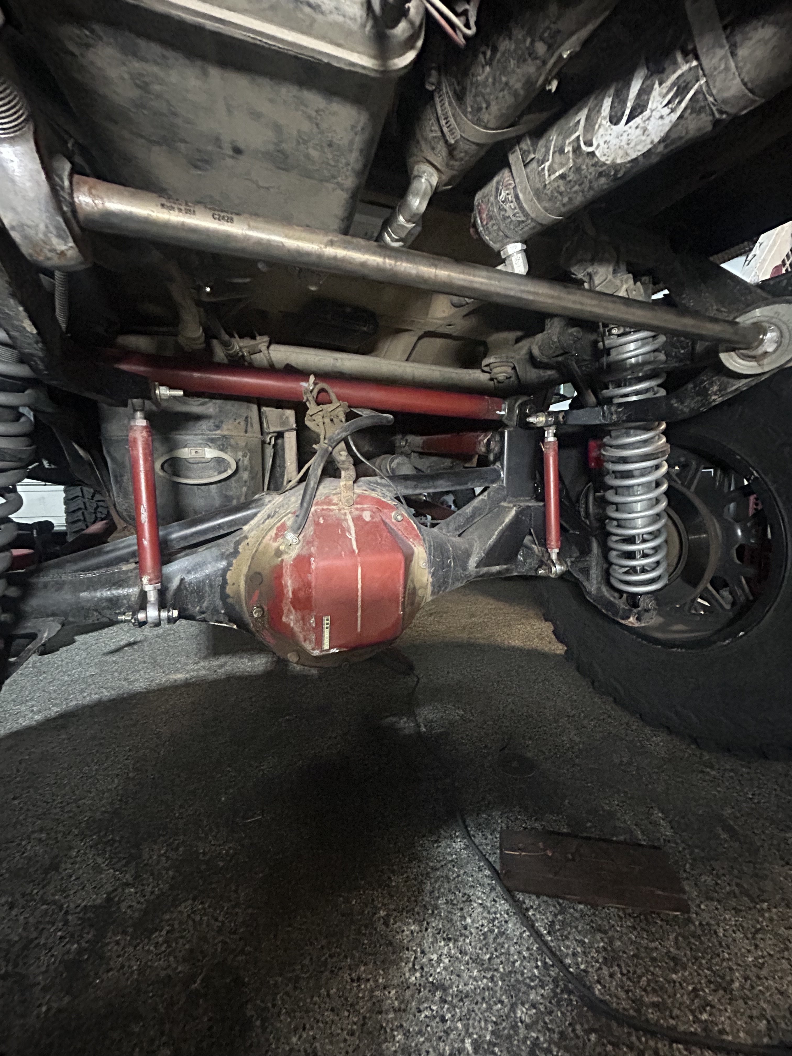

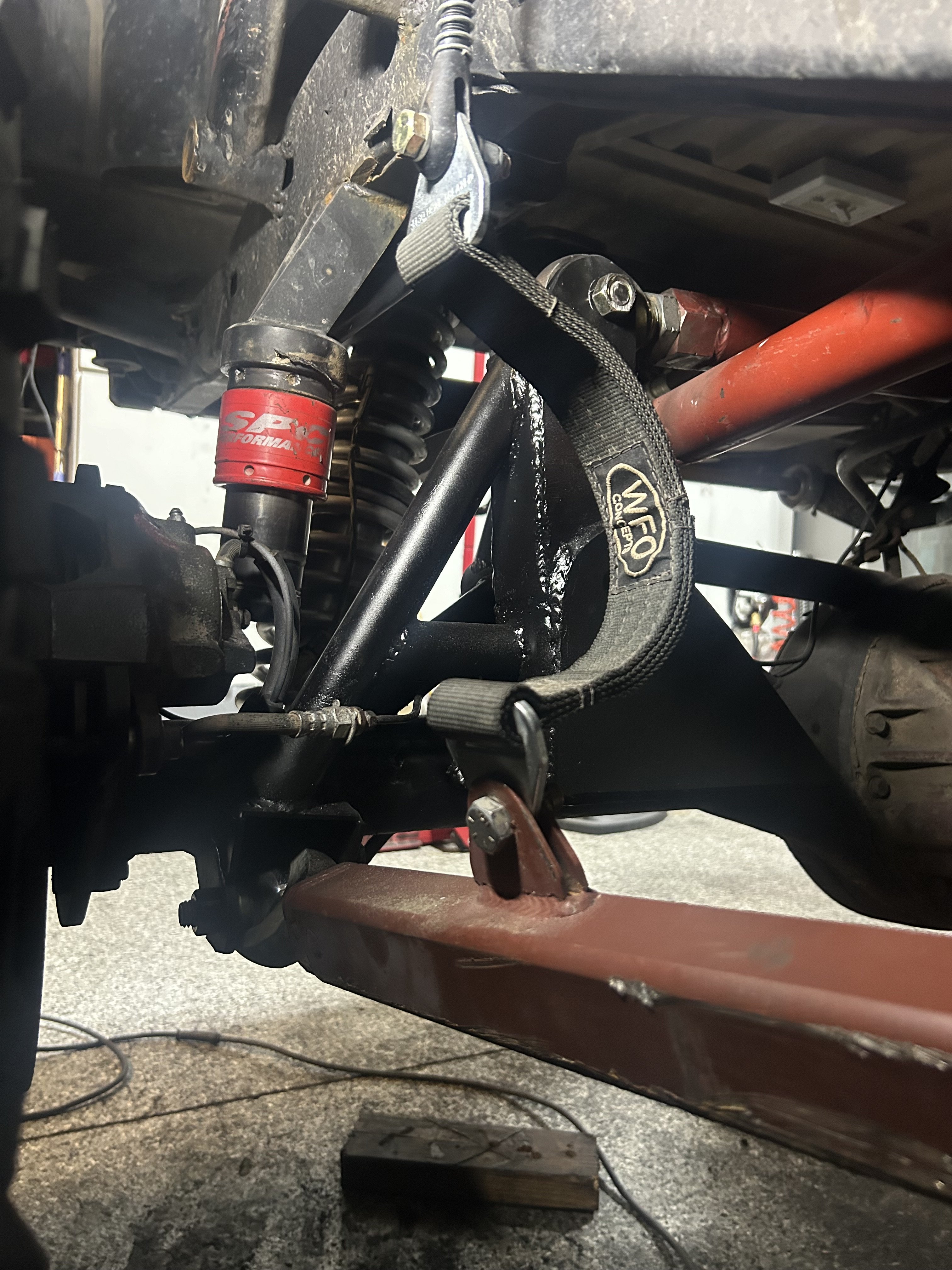

One last mod I did before starting the new job was flattening the track bar.
Roll center went from 28 to 32in
Track bar angle went from 12* at ride height to 2*
Track bar at full droop went from 23* at full droop to 13* at full droop.
It now goes over the upper link instead of below. I can also go back to the old setup if I need to (I doubt it) but I made it so it can still go in the old hole. My only concern is strength. It’s about 7.25in higher than before, lots of leverage!!!! I put 2 braces on it. One from a tube to the top of the mount and the other is a triangle that ties into the lower control arm mount and goes all the way up to the top of the mount.
On off camber stuff it was way sketchier when the driver side was the high side (making the track bar angle steeper) I have read same side track bars aren’t sketchy or jack if the track bar angles are flat. It certainly wasn’t but now it is

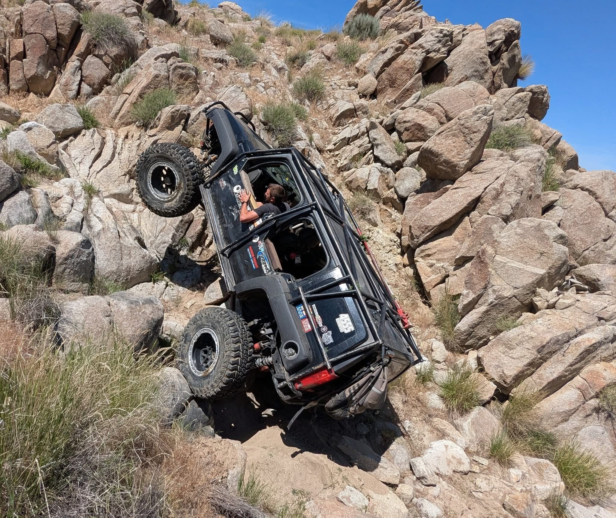

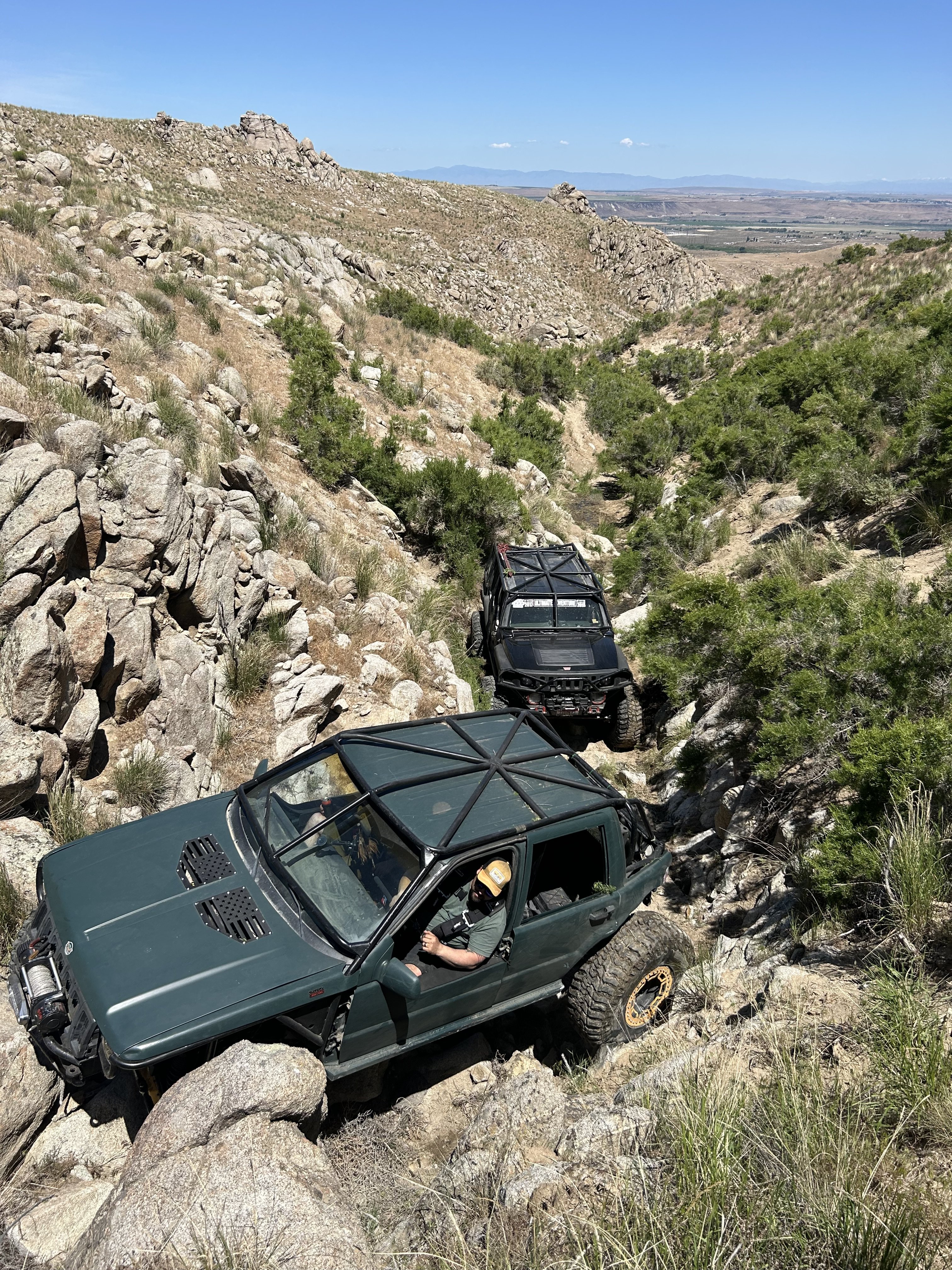

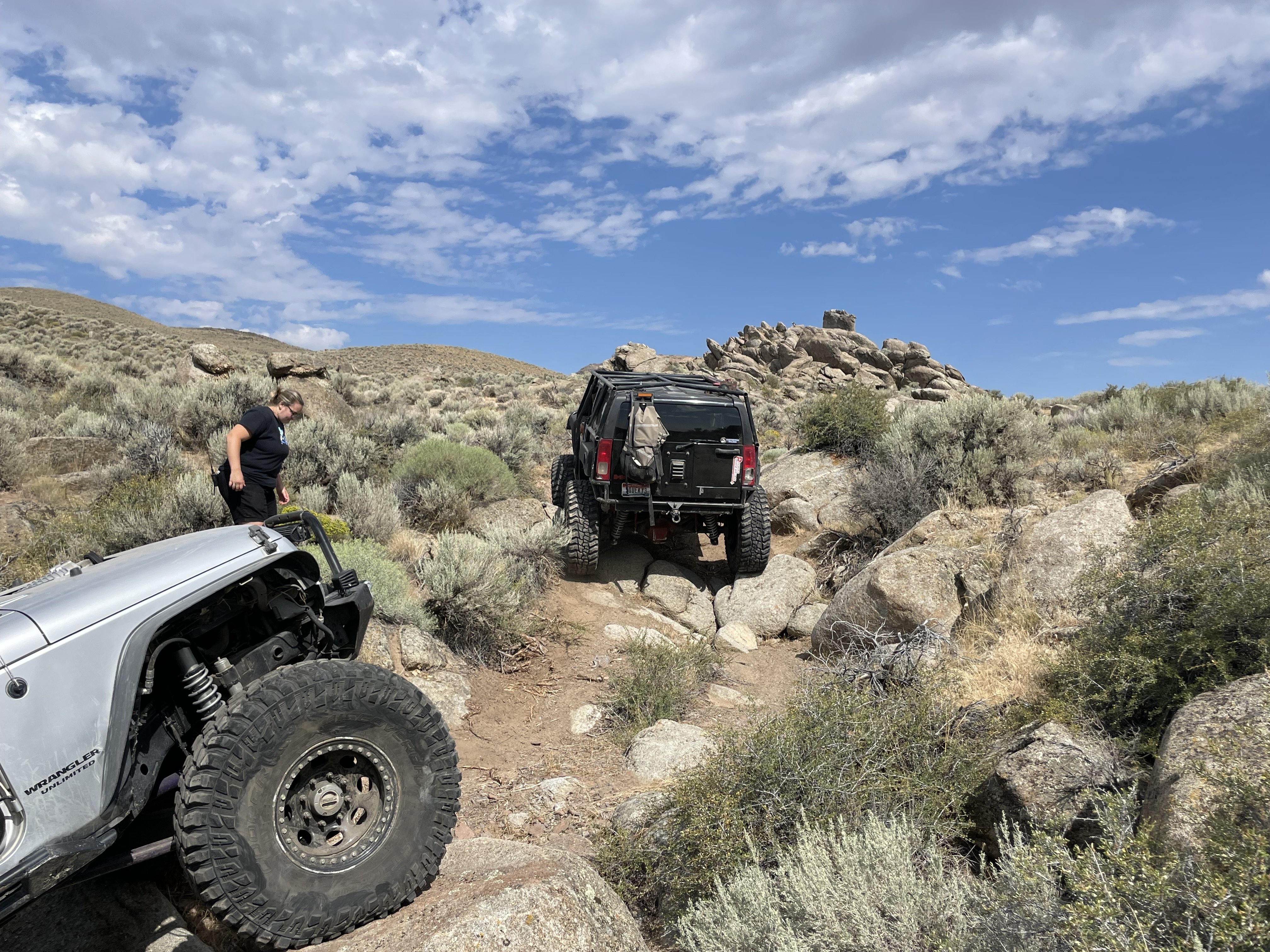

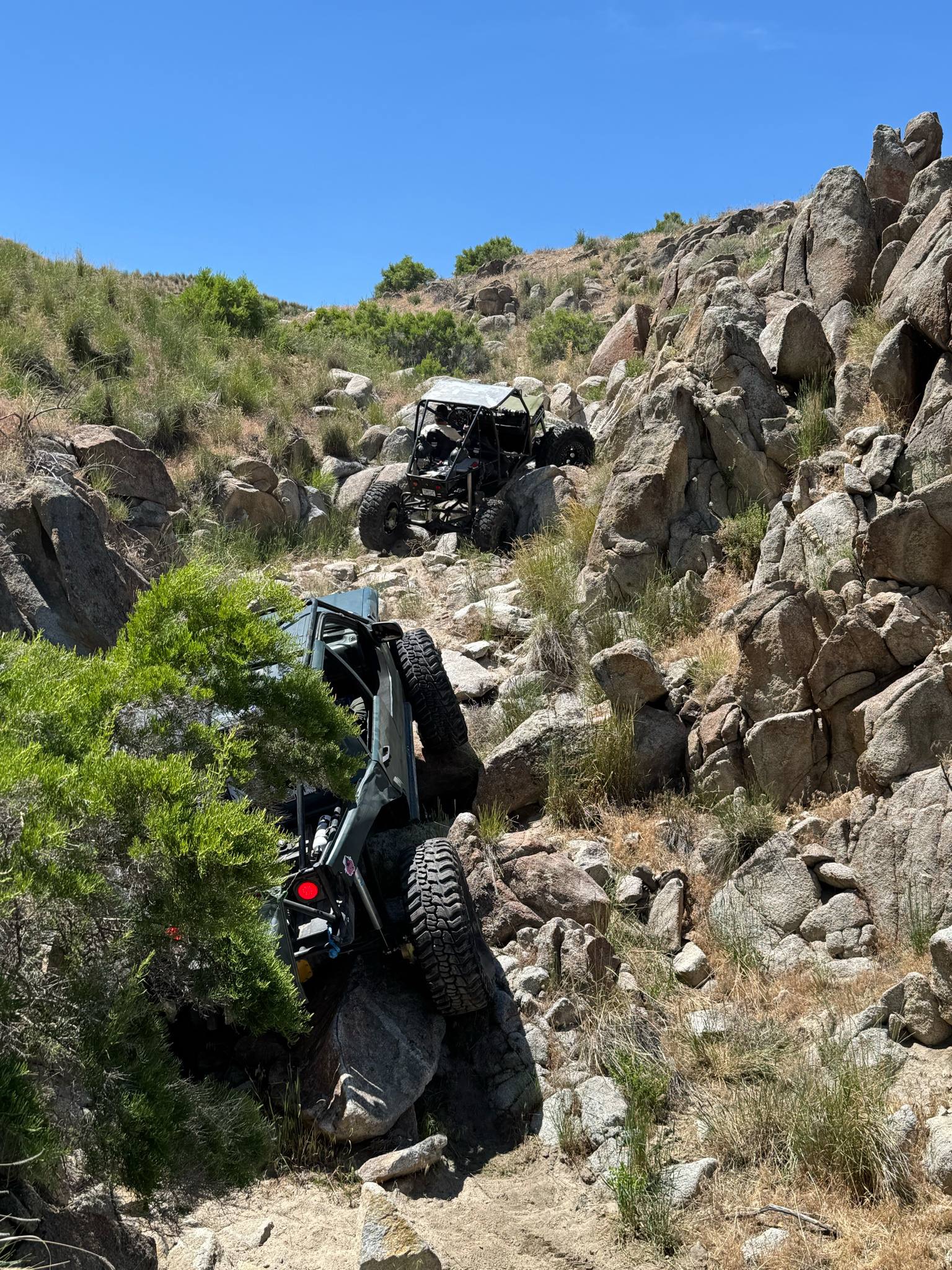

We ran this trail
Machine screw….last time I ran machine screw I didn’t finish it, my buddy in his Toyota on 1 tons and 43in stickies exploded his t case input shaft and we had to get him out on 0 wheel drive.
So, time to finish it. Admittedly, I winched 3 times, and it’s a short trail, so that’s a good ass whooping.

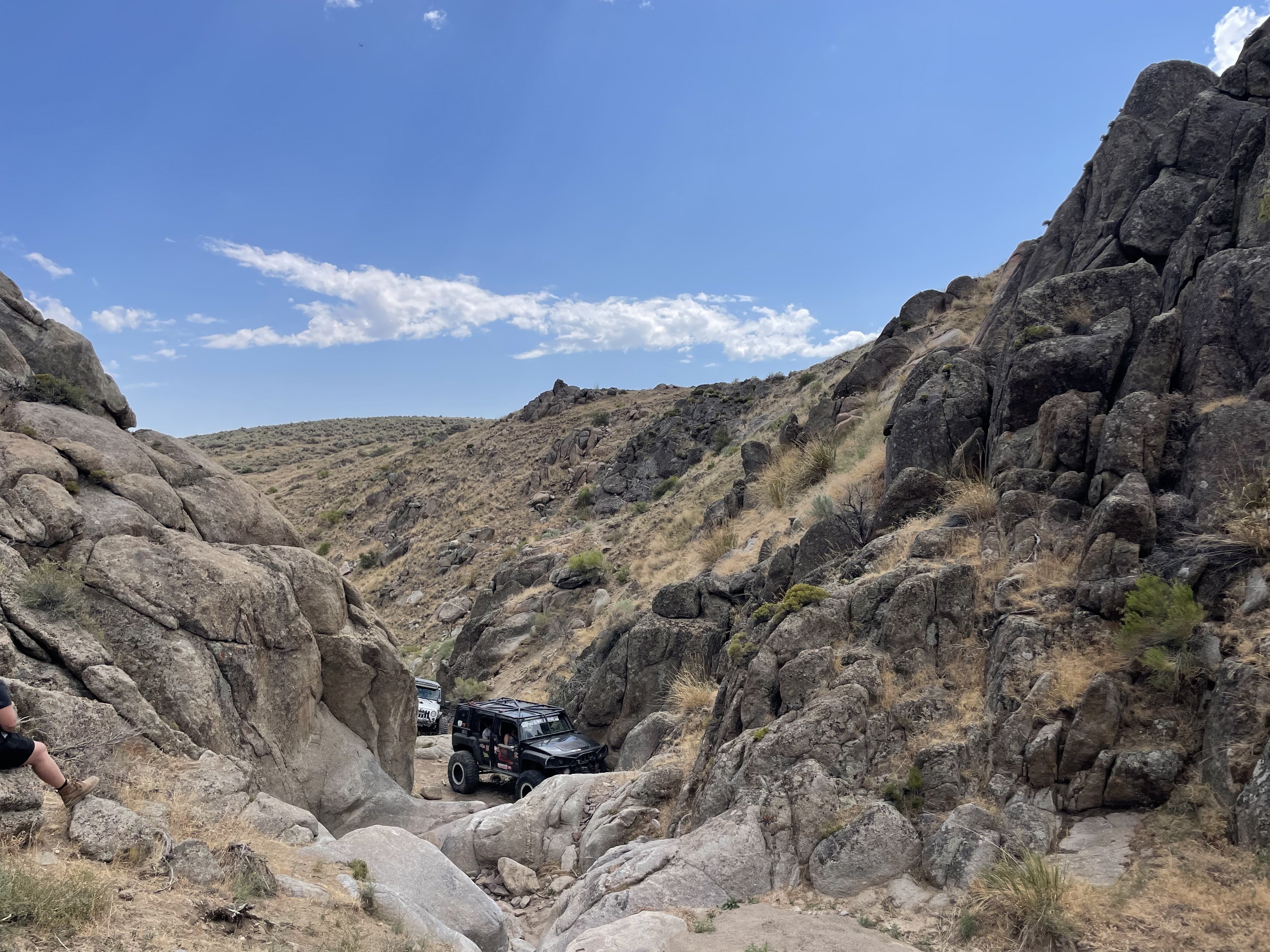

It was 3 rigs, me, a ZJ that’s backhalfed, cut up, pretty light weight for what it is, on 1 tons and 40s, then a Sami buggy that makes everything look easy.

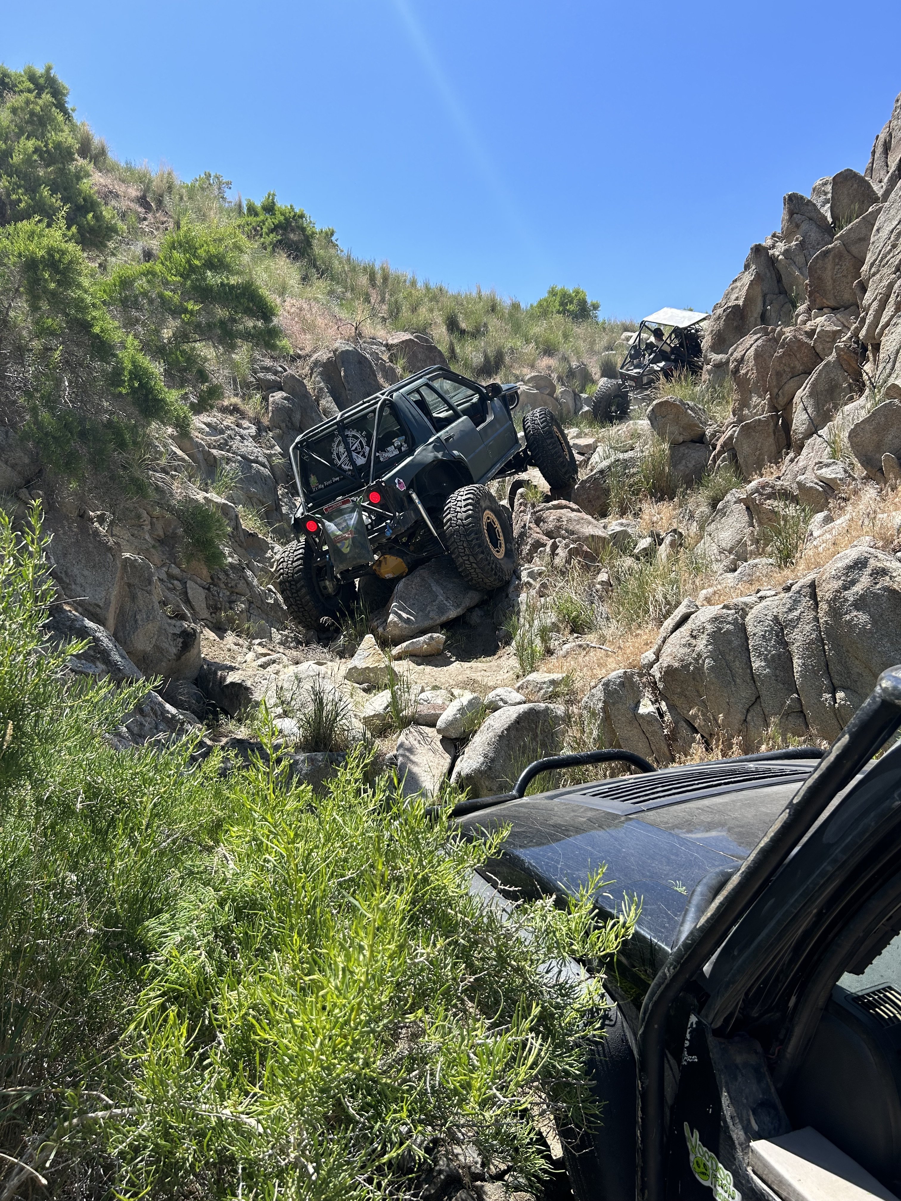

The beginning was all pinchy tight stuff.

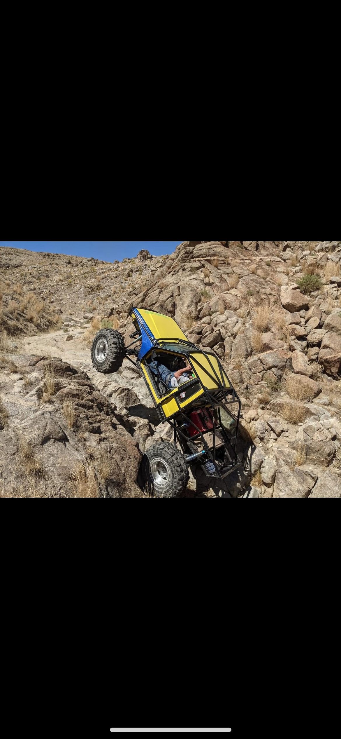

First climb I winch. I wish I had a picture of it from yesterday but here is the last time I ran it and where the Toyota broke
Anyways, the ZJ and Sami buggy have suck down winches and fully used them, I’m not convinced I would have gotten it with one but it would have definitely helped, for reference the Toyota in the pic has a 120in wheelbase. I need to make a change on my cooling setup. I never overheated with my current radiator setup, and a single trans cooler, but I recently added a 2nd trans cooler and a PS cooler in front of the rad and it’s blocking flow. Working it on that climb I got up to 256 coolant temps by the time I noticed it was knocking, I’d imagine the oil temp was 270-280+. So that poor engine got a beat on. So I will be moving the coolers to open up flow. At speed it’s fine and before the coolers it was fine but PS system get hot. I’ve been told 250-300* isn’t out of the norm….if that’s true I’m sure I’m blocking flow with a cooler that is heat soaking the fuck out of the radiator. Anyways, I was on the winch.
2nd climb (above) the Sami buggy got but had to work at it for a minute. The ZJ didn’t get it, he winched, and I was so damn close to getting it but my front end got light, I think a suck down would have helped here. You can see all 4 were climbing.
This was the 3rd winch spot, ZJ and Sami buggy got it.
I also noticed I was at 13.5psi. That probably didn’t help but I give myself the award “trail tampon of the day”

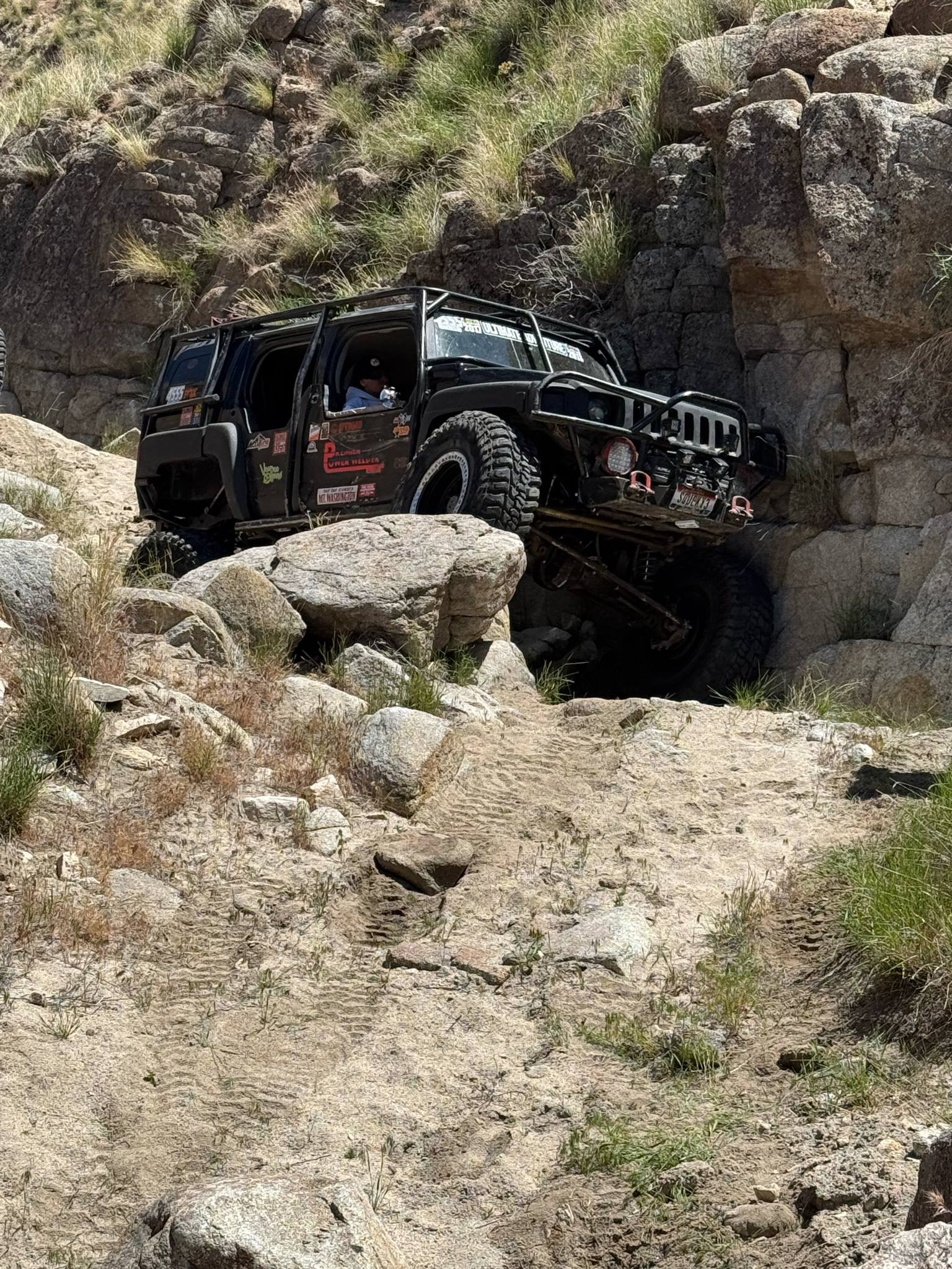

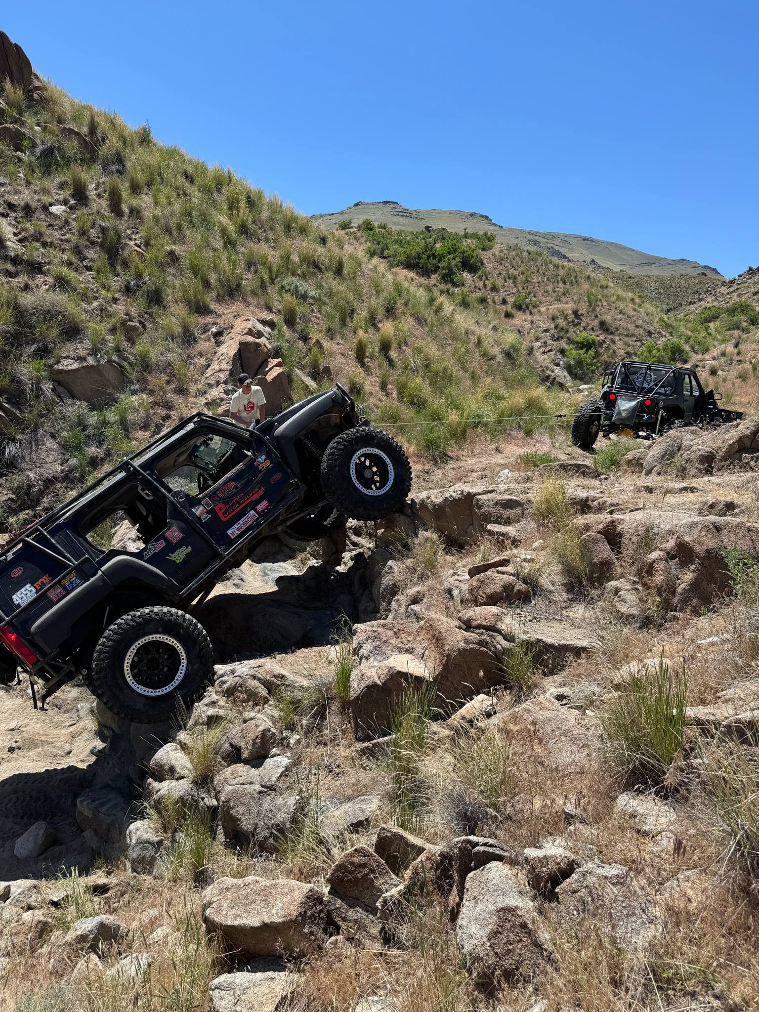

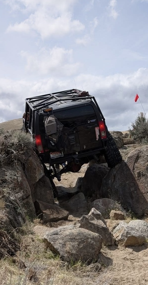

went wheeling with my wife and daughter, easier rock trail and she did great! Then in July I was depressed about my lack of vacation time at the new job had me miss out on the rubicon trip I do annually so I had to get out of the house and stop feeling sorry for myself.
ran death wobble and lone pine. Lone pine I have done like 6 times and every damn time I run it I winch once or twice. I think I’ve gotten all the obstacles on the trail but on any given day, one of the obstacles will have me hook up on the winch so this was the first time I actually ran the entire trail clean. That felt great.

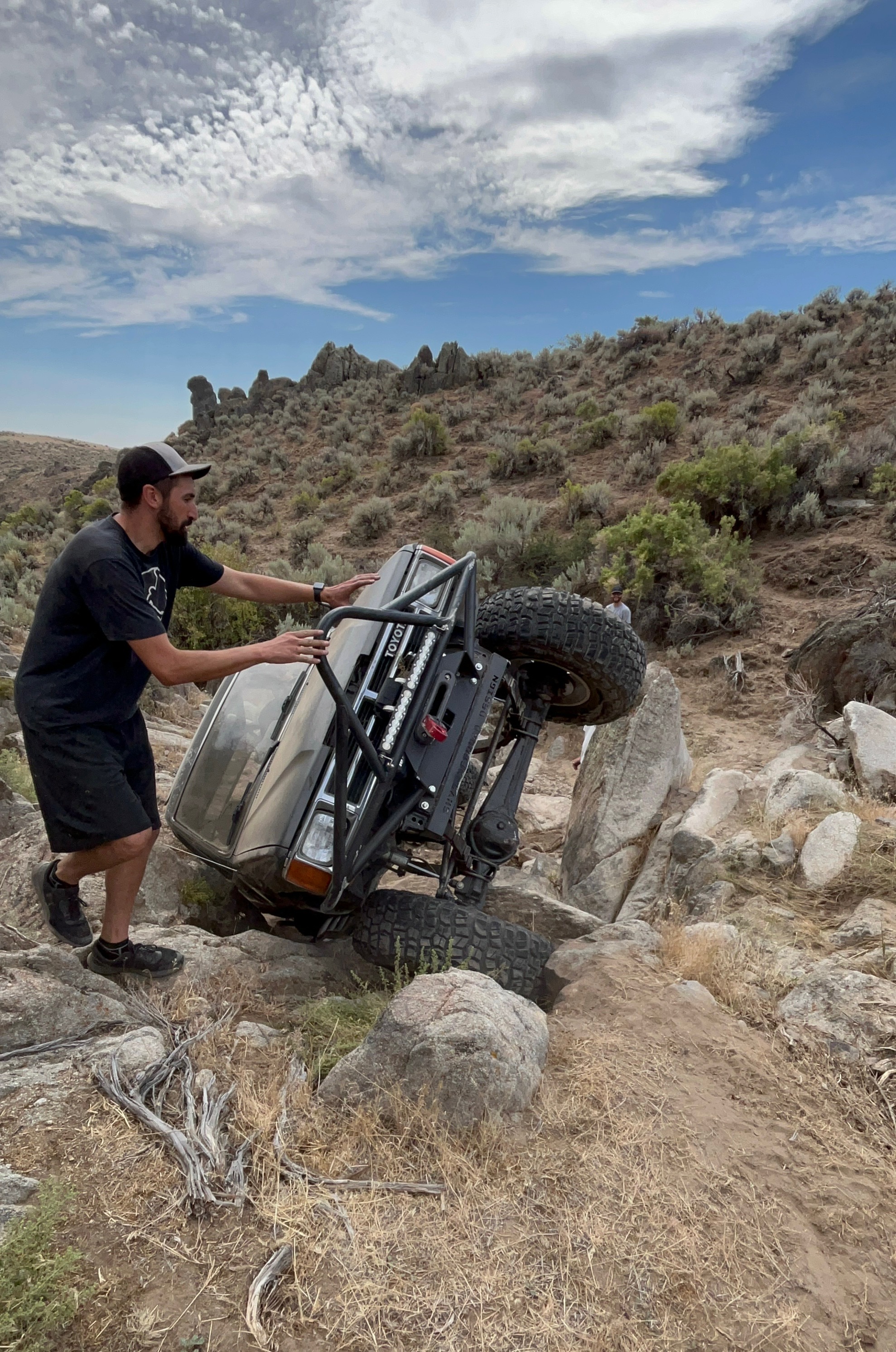

Typical full door to half door shuffle, did it Saturday night, wheeled Sunday, threw the full doors back on Sunday evening and was driving it to the gym in luxury at 5:30am on Monday.
We had lots of flops or near flops. The 2 Toyotas on 37s with us all ended up sideways at some point. This pic wasn’t bad. It was fully over a moment after that.
Random shot of me on the trail. Didn’t get much pics.

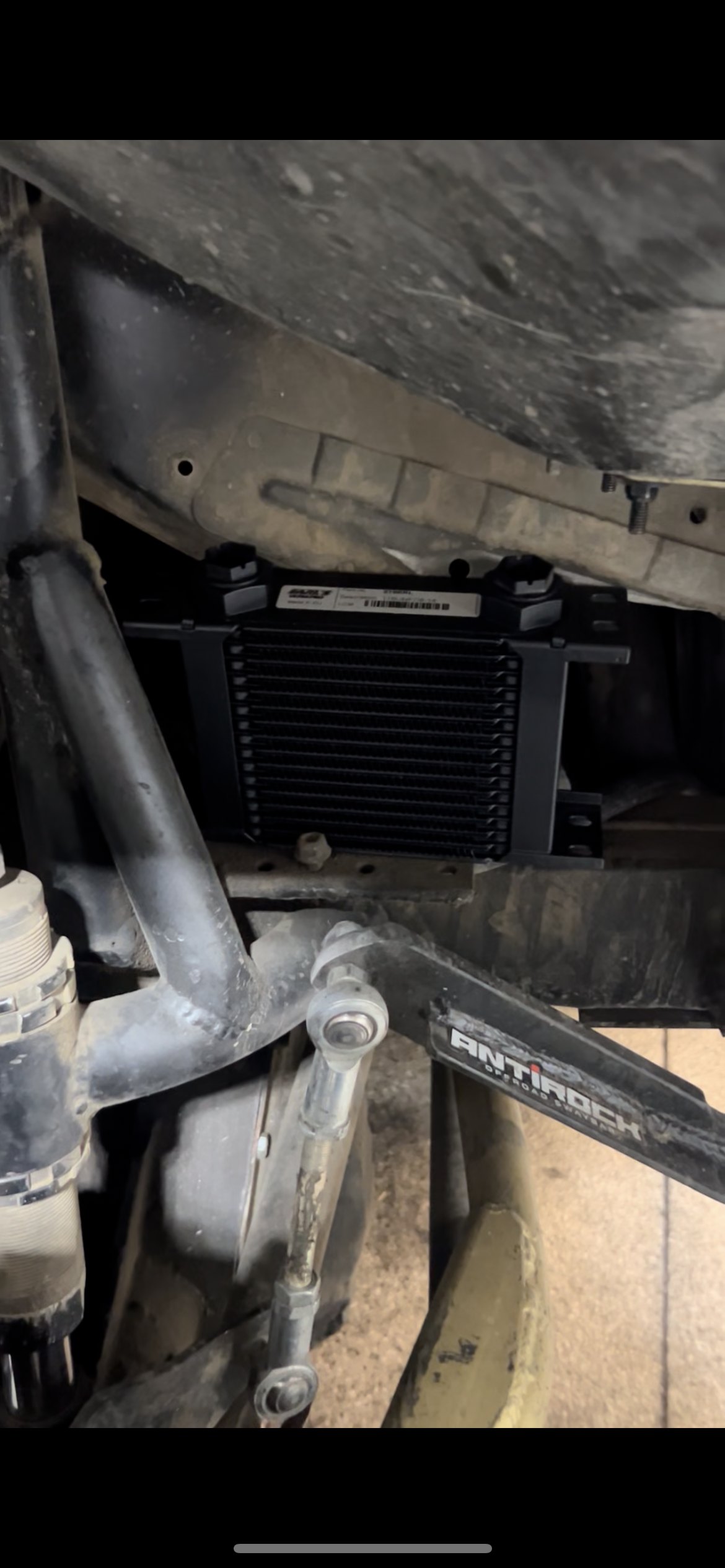

The main change I made is cooling. This thing was a champ at cooling, H3s are notorious for cooling issues, but mine hasn’t been that bad. I did UA 2017 in 115-120* heat and that week had rigs pulling over left and right overheating. I never had to, but a post back I talked about hitting 256 coolant temp. I think the giant PS cooler I added caused big heat soak issues. I removed that and mounted a smaller heat sink style one off the coilover mount. I also moved the dual trans coolers to the rear of the H3. Who knows if it’s enough to get the job done for steering or not. I know the old one was a big plate and fin overkill setup but many run these types.
I also wanted to ditch the trans coolers from heat soaking and mount them by the rear bumper under the rig.
I can confidently say coolant temps are much better now with fresh cool (still 90+ ambient) air. The heat soaking seems to be fixed. I also plan on adding an oil cooler.
An H3T friend said his 5.3 ran 200-220 oil temps and his 6.2 runs 220-240 oil temps.
I checked and sure enough I’ll run 230-240+ all day long on oil temps. I wonder if that hurts coolant temps too.
I’d like to mount the oil cooler there and I have a little 4in fan for it. I have trimming to do and cutting off an old suck down winch mount to drop its height.
Anyways, coolant temps are better. PS temps TBD, trans temps need some help. The fan pushing air on the trans cooler isn’t enough. My old trans setup literally couldn’t get hot. It was kickass, this setup holds its on when the TC is locked but can’t keep up when it’s unlocked. So I solved one issue and made another.

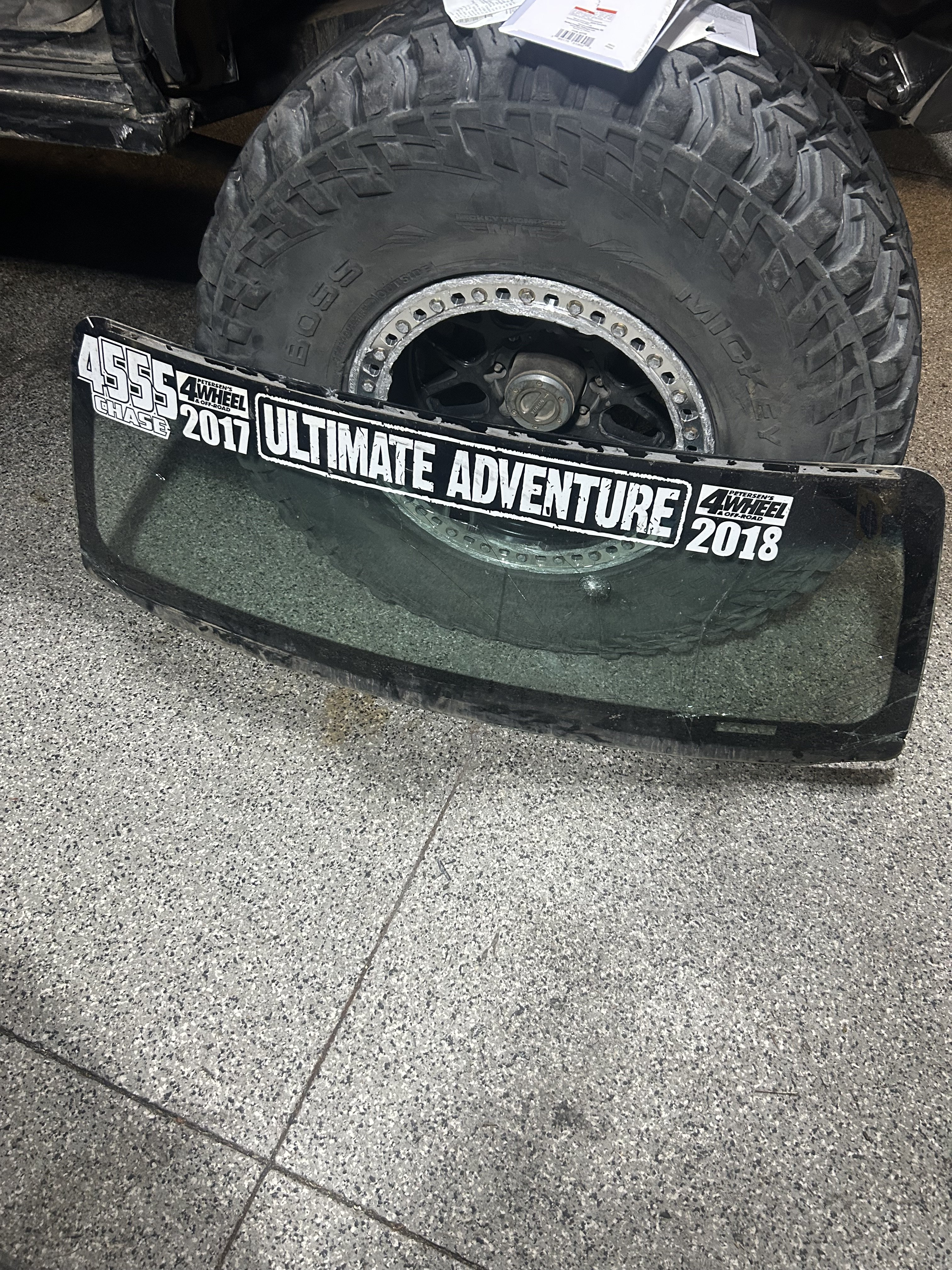

Someone was talking about their windshield with a UA sticker on another forum and I posted on that thread about how it would be catastrophic if my windshield cracked due to my UA sticker....and sure enough, shortly after that, it cracked! Some asshole semi truck driver was barreling around a sweeping corner at 65 mph on a 2 lane road, I had just enough time to say to my passengers, wtf is this guy doing and right when I said that rocks fell off his semi and then 2 hit me at 65 mph coming the other direction 1 hit my windshield and and the other hit my passenger's arm with the half doors on. It cracked the glass so bad a piece of glass hit me in the face. It almost went completely through.
I am having my mom try to create some replica stickers and make them on her cricket (CAD for artsy women?) I asked Christian Hazel but he said he was out of them.

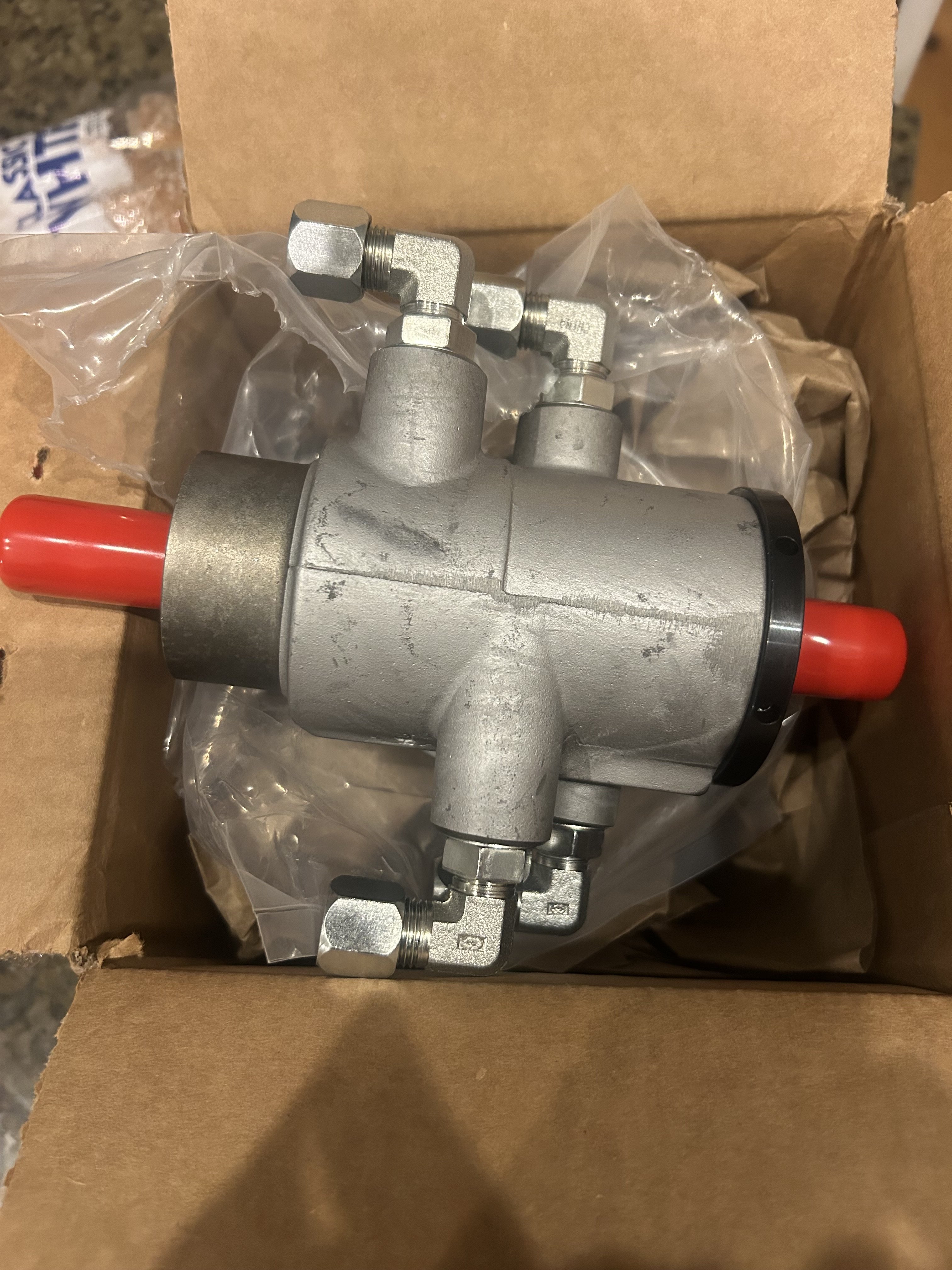

Remote mount servo.
WJ box I picked up from the junkyard.

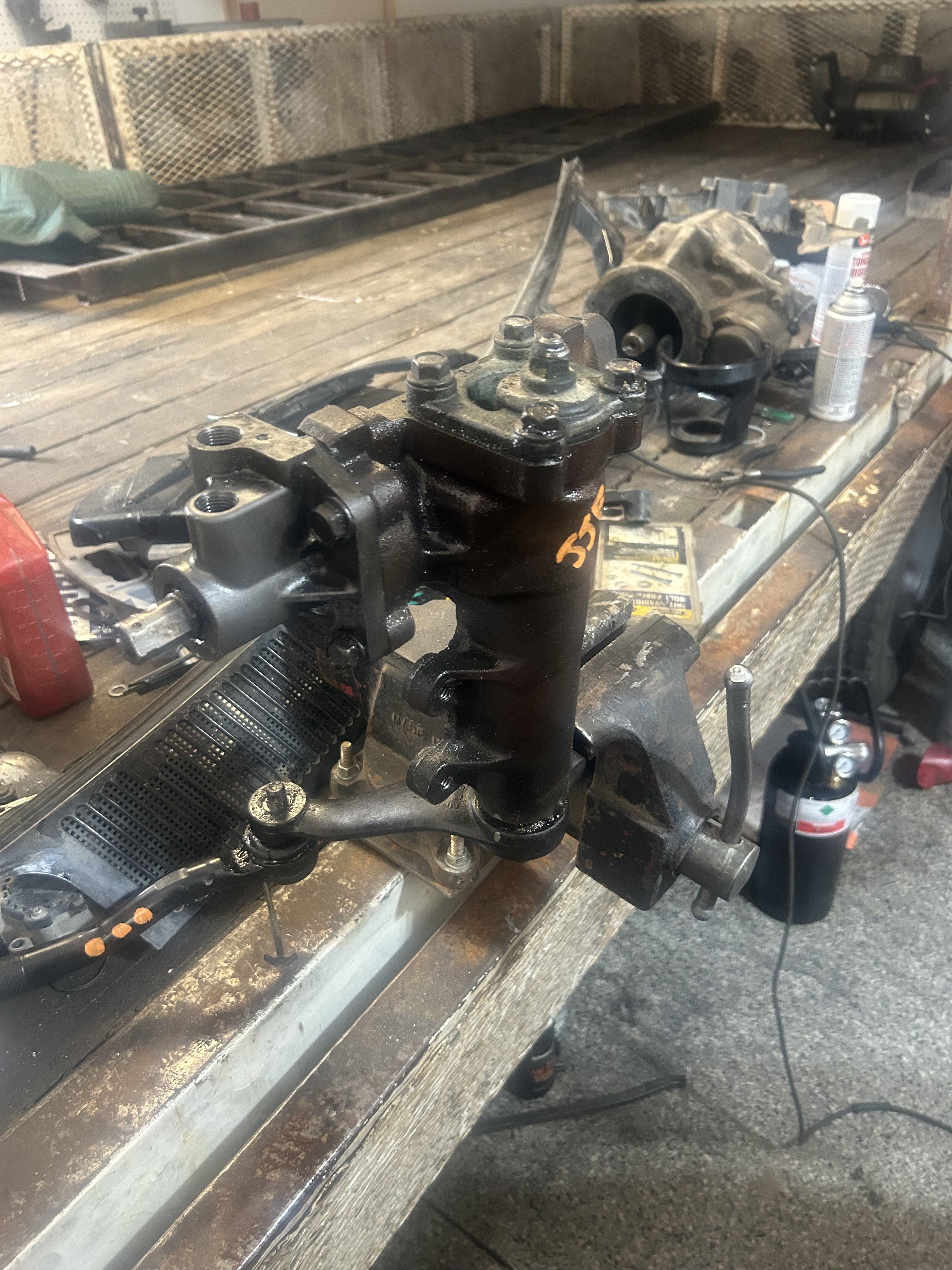

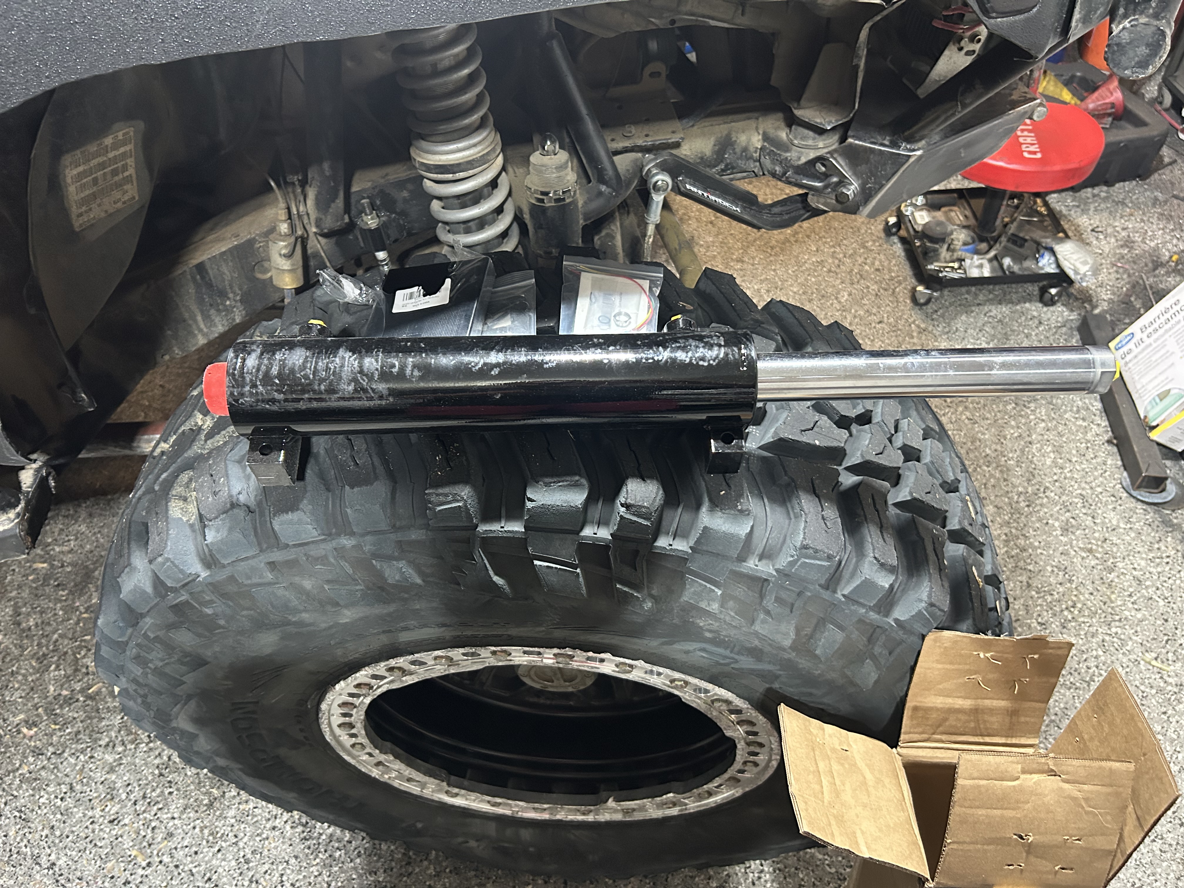

I need to put the fast ratio guts of this box into an extra xterra box I have, then depower/free float the piston.
This is a double ended ram, one side is all the way out, other side all the way in. Not a single ended ram like regular ram assist.
I just need a pump, resi, then get to work! I am trying to do this with minimal downtime as I still have to drive it

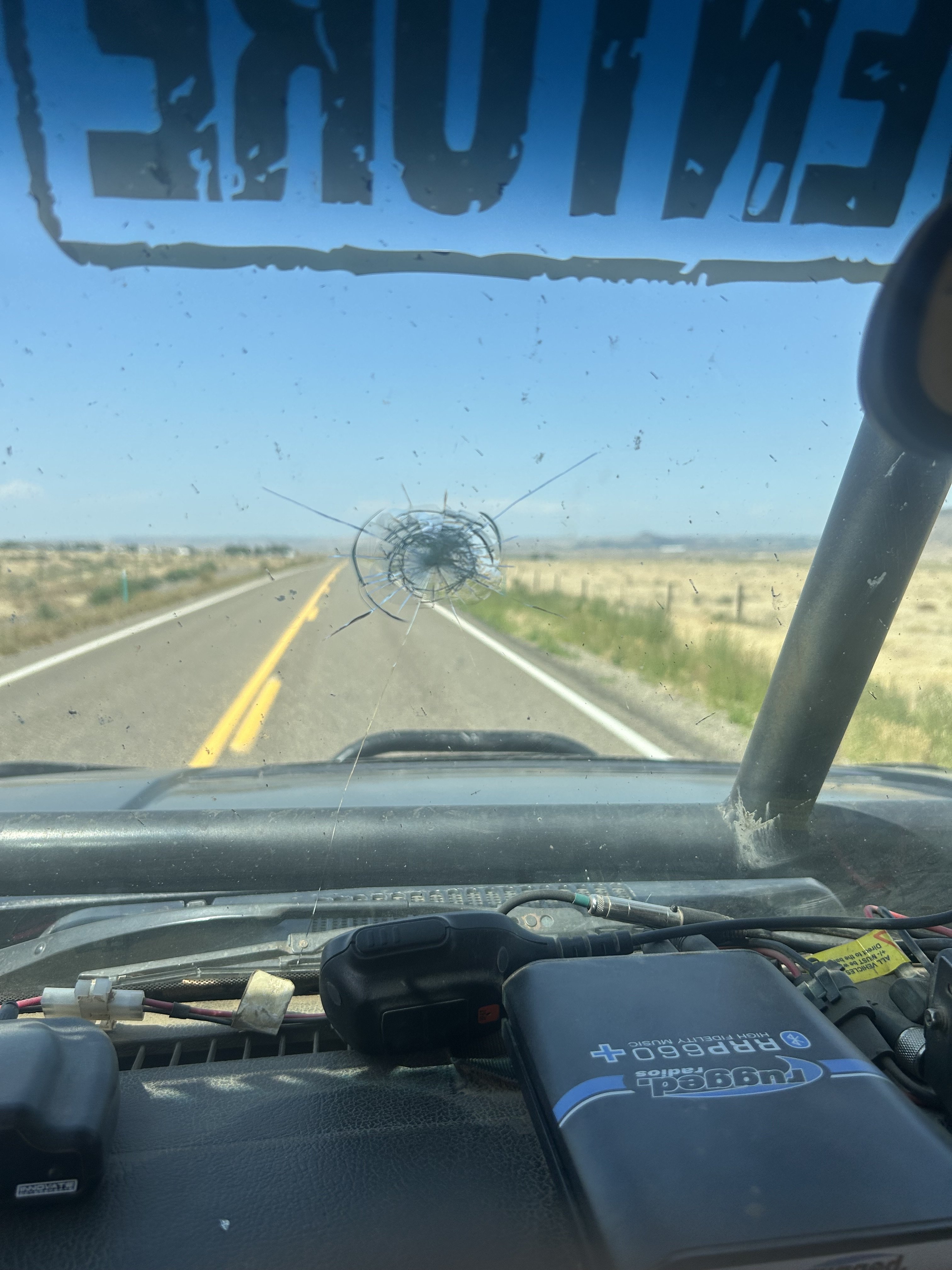

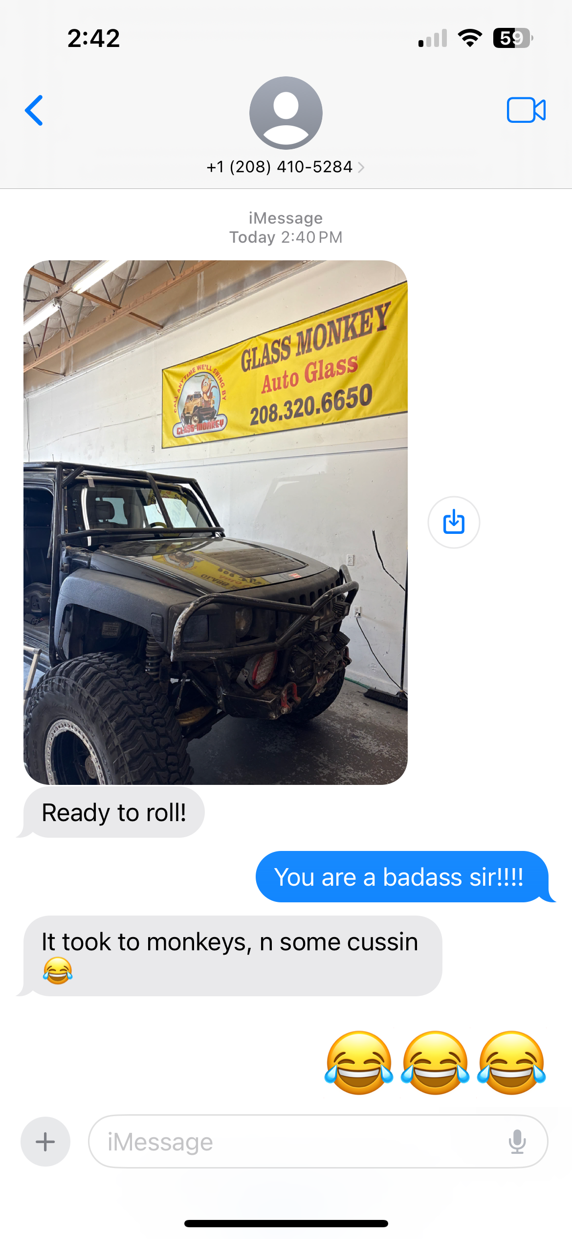

Windshield is replaced….
I pulled it myself to prove it can be done! 4-5 shops said no…I have to pull the whole cage. I got it out, luckily my now favorite windshield shop got it done.

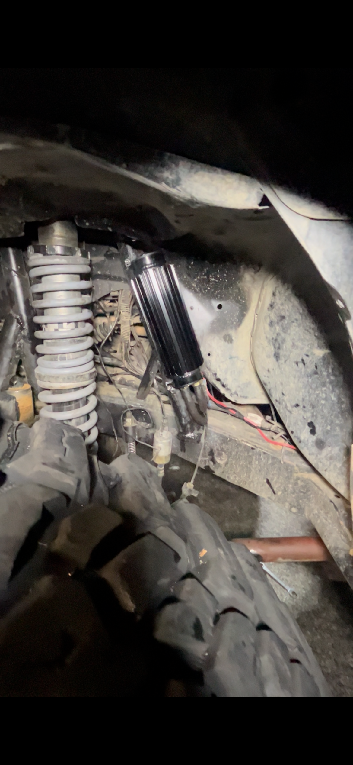

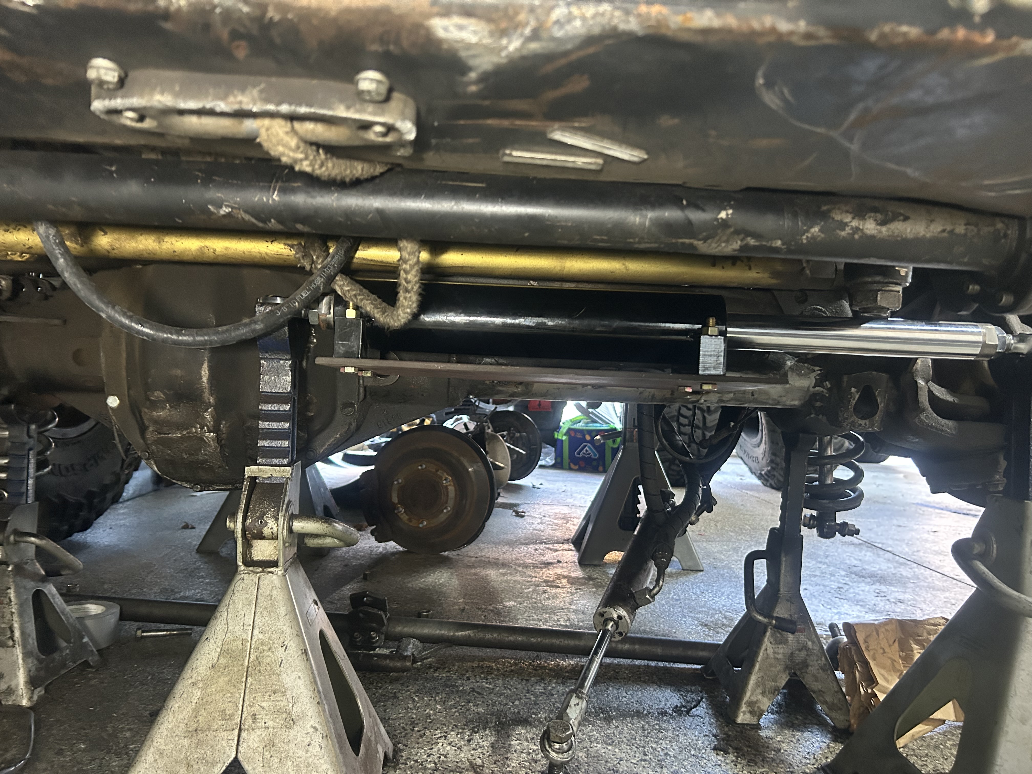

Small update but I need to start thinking about how I want to mount this double ended ram.
9,504
With our newborn and just life in general progress has been slow.
I spent weeks 1 hour here, 1 hour there…but it’s coming along.

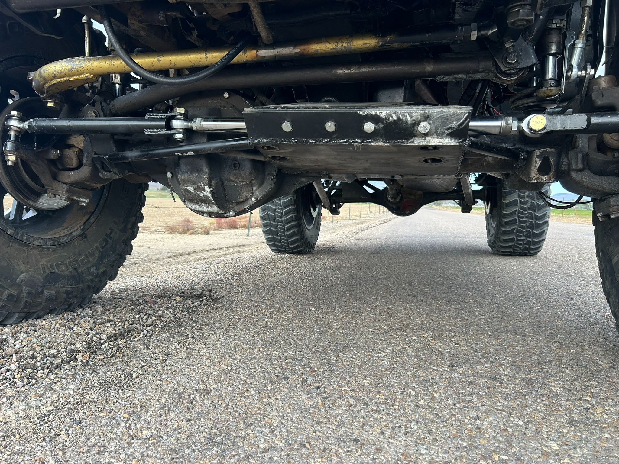

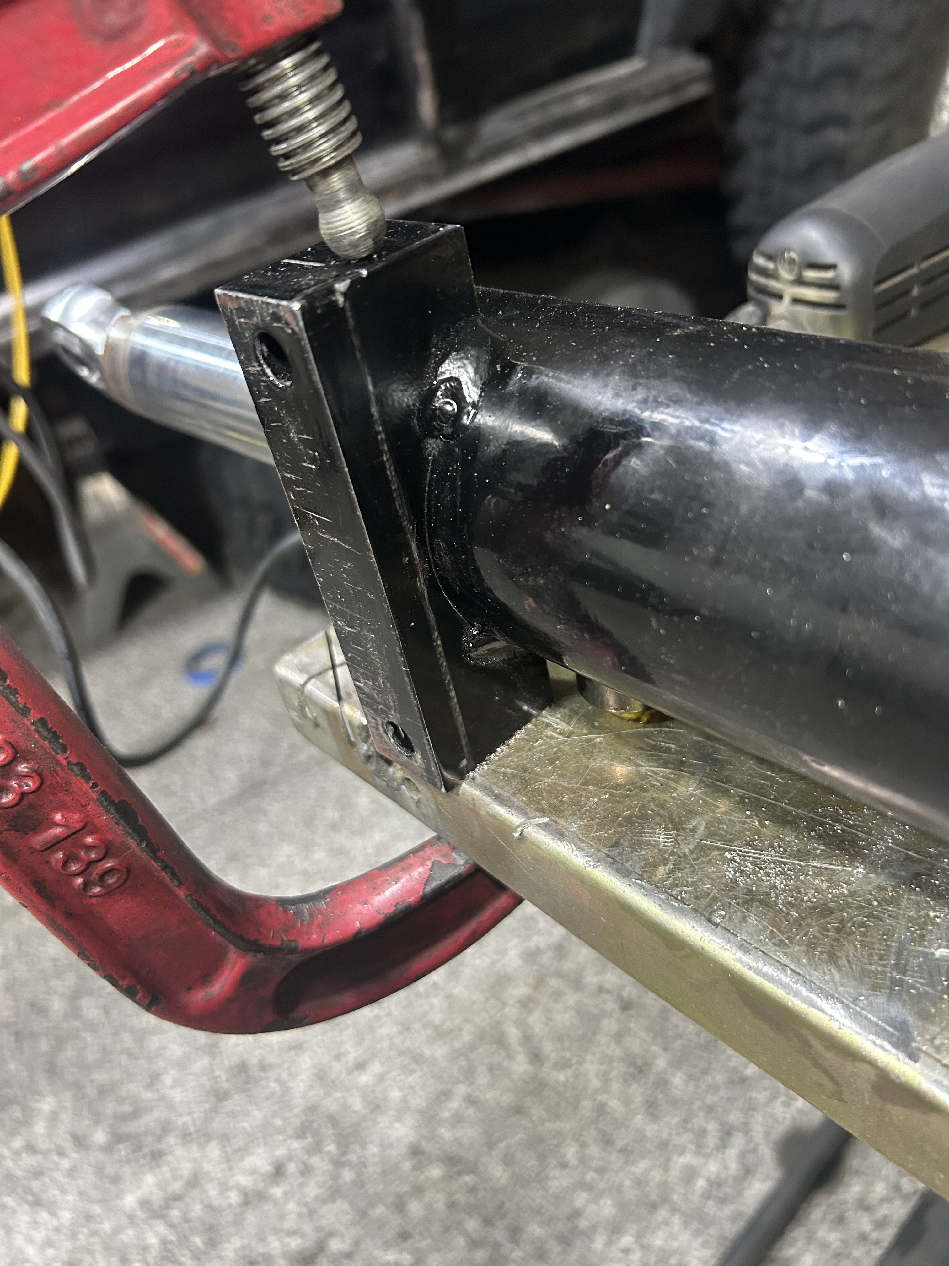

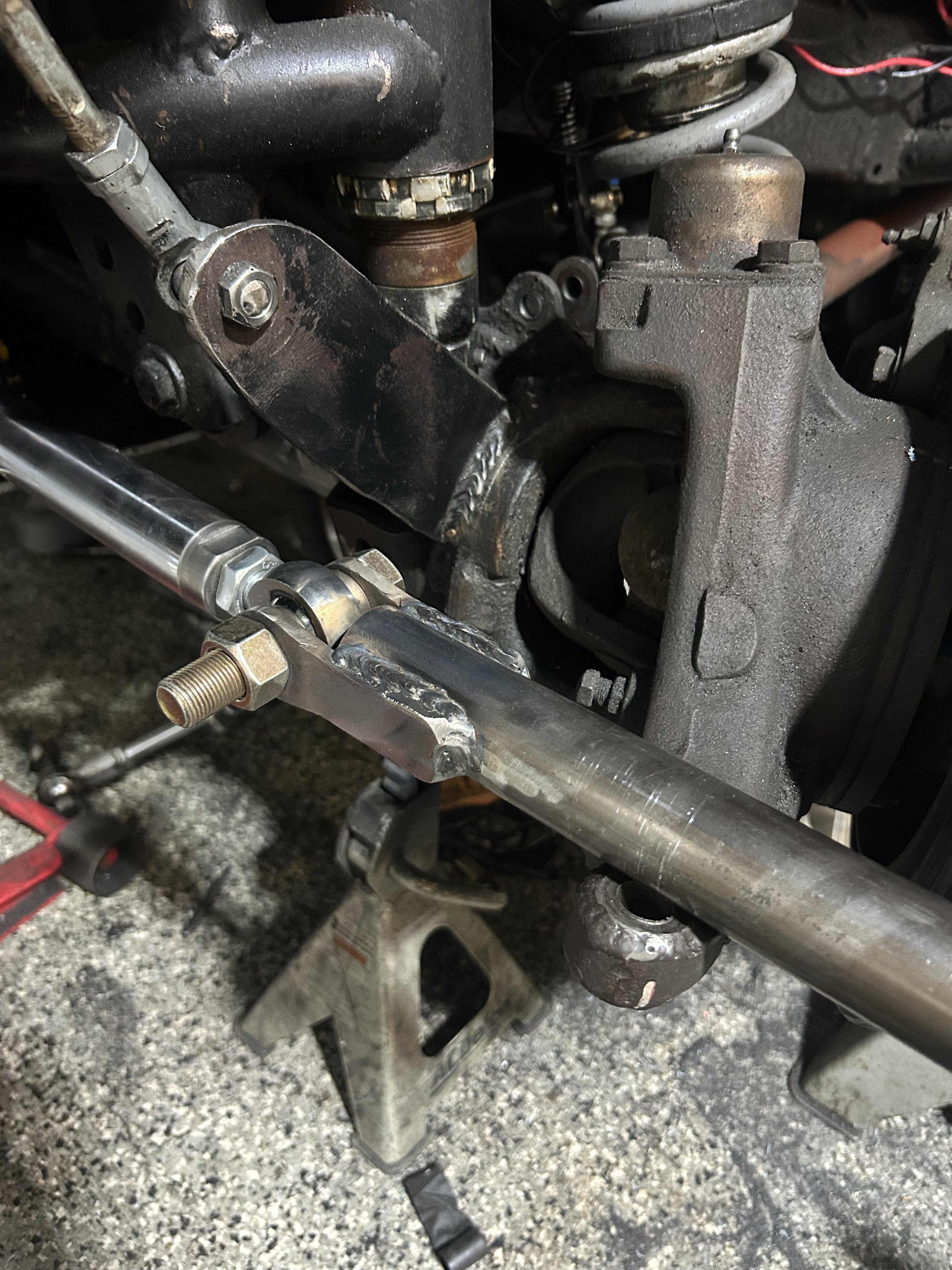

I tried the ram closer to the axle tube, farther away, more offset from center, less offset, etc.
I finally found a home, it’s closer so it should get hit less but still hung low…so let’s make a pitman arm. Luckily the angle stayed the same so no change in bump steer but going heim gained me like 1/4in
Then I wanted more clearance…so I modified the ram mounts and trimmed them up.
Gained another 1/4in
Then the clevis’s most people use have added height to them which I am fighting so I made this to be low profile.
Now it sits higher then in the previous pic and have maximized every thing I could for clearance.
I still have to test fit a few more things then it’s ram mount welding and reinforcement.
9,504

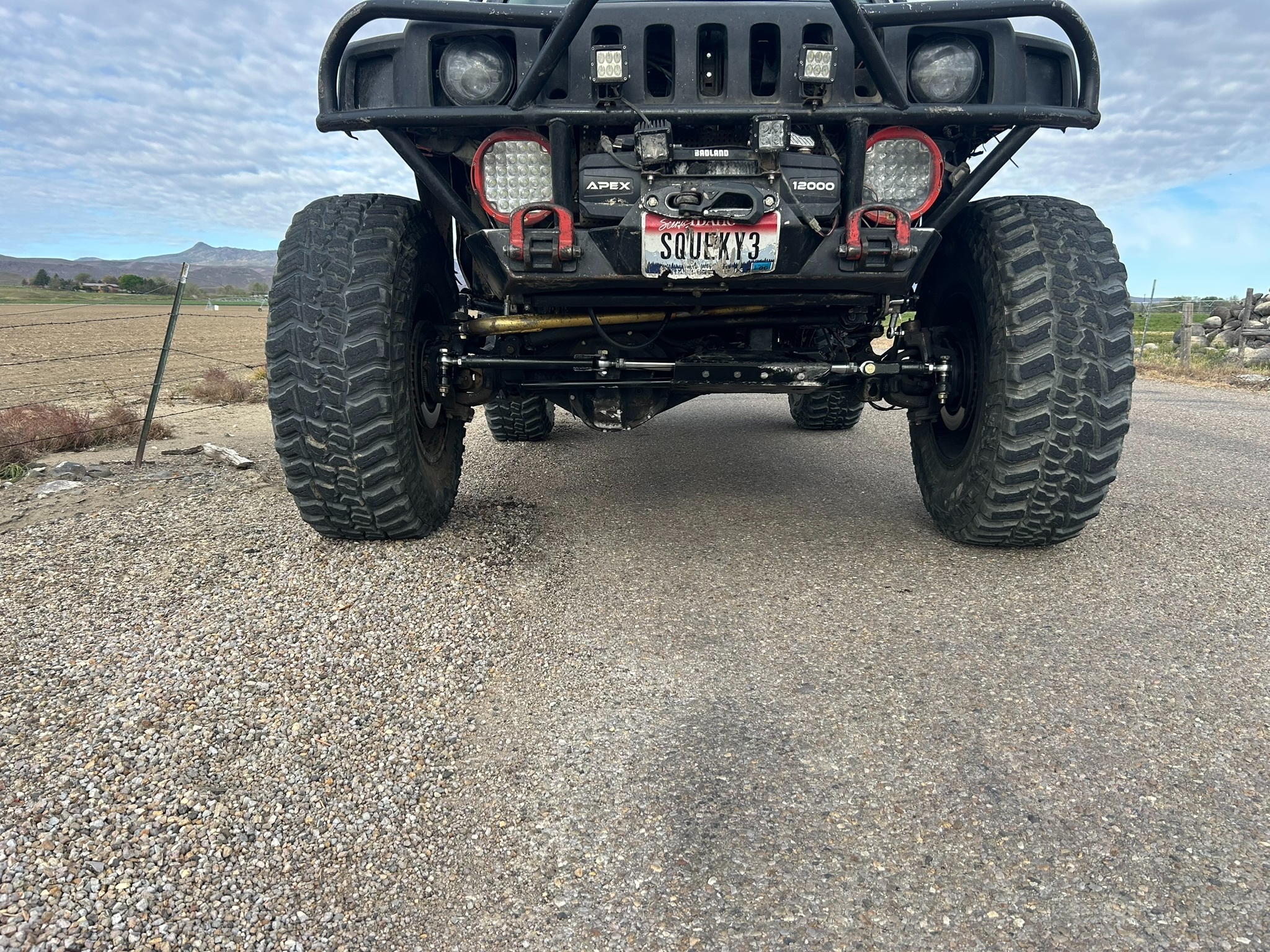

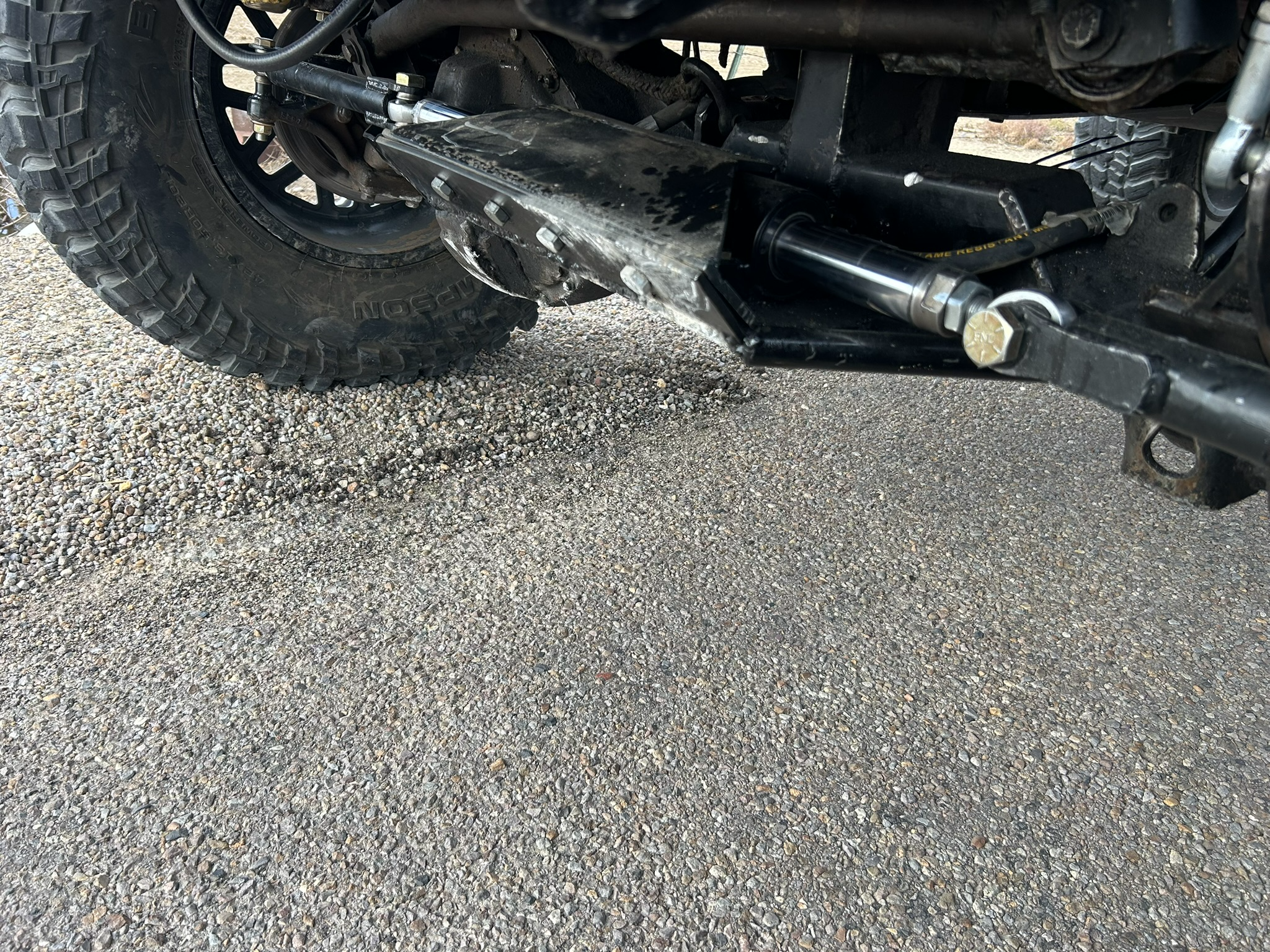

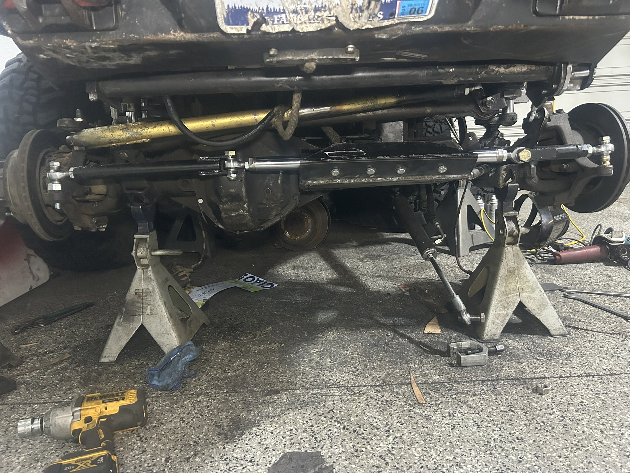

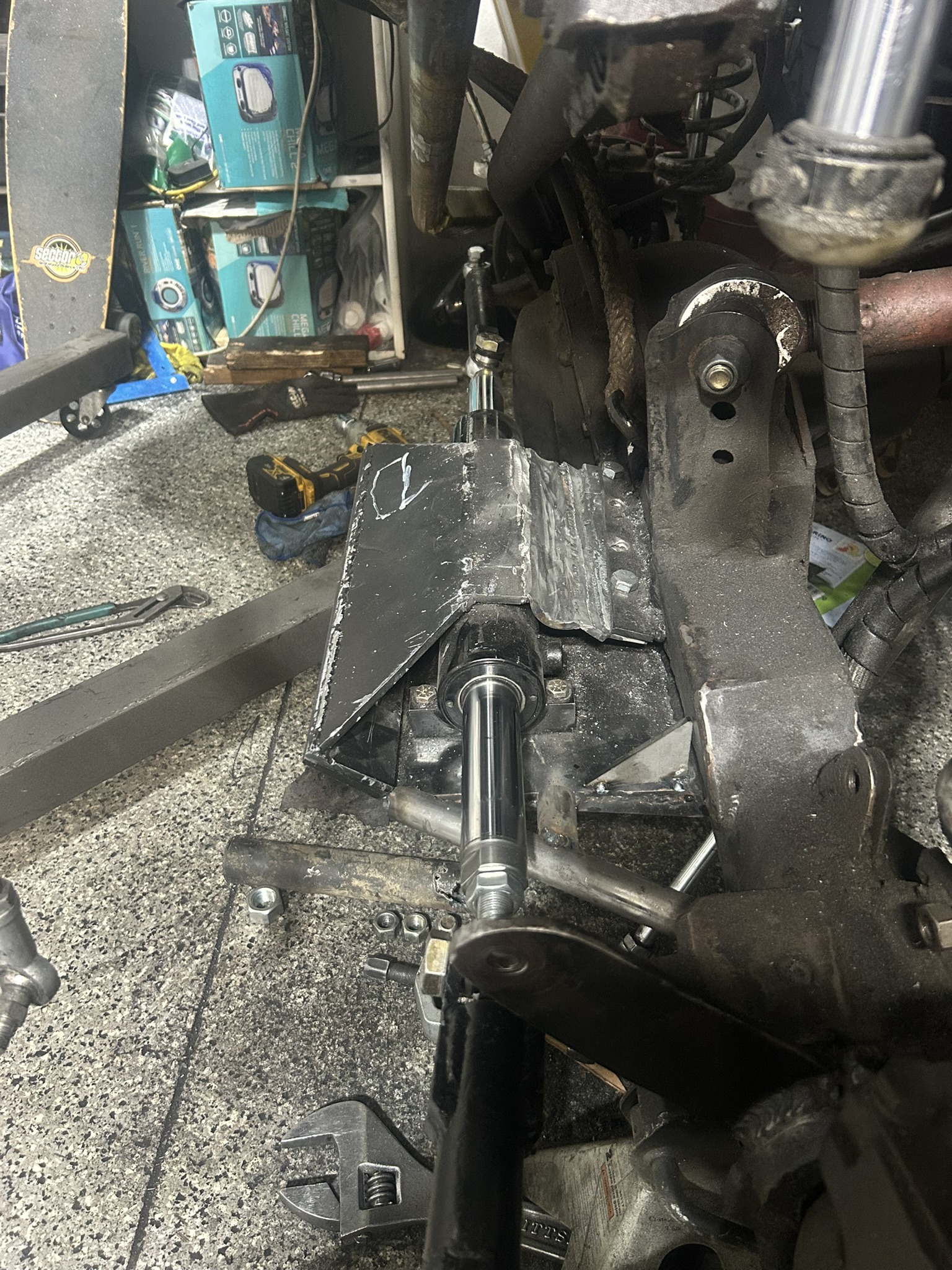

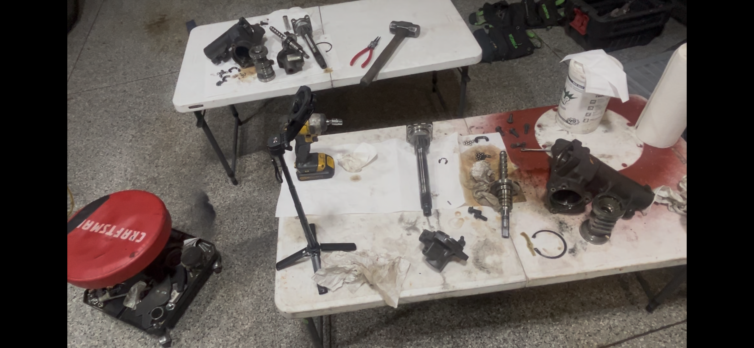

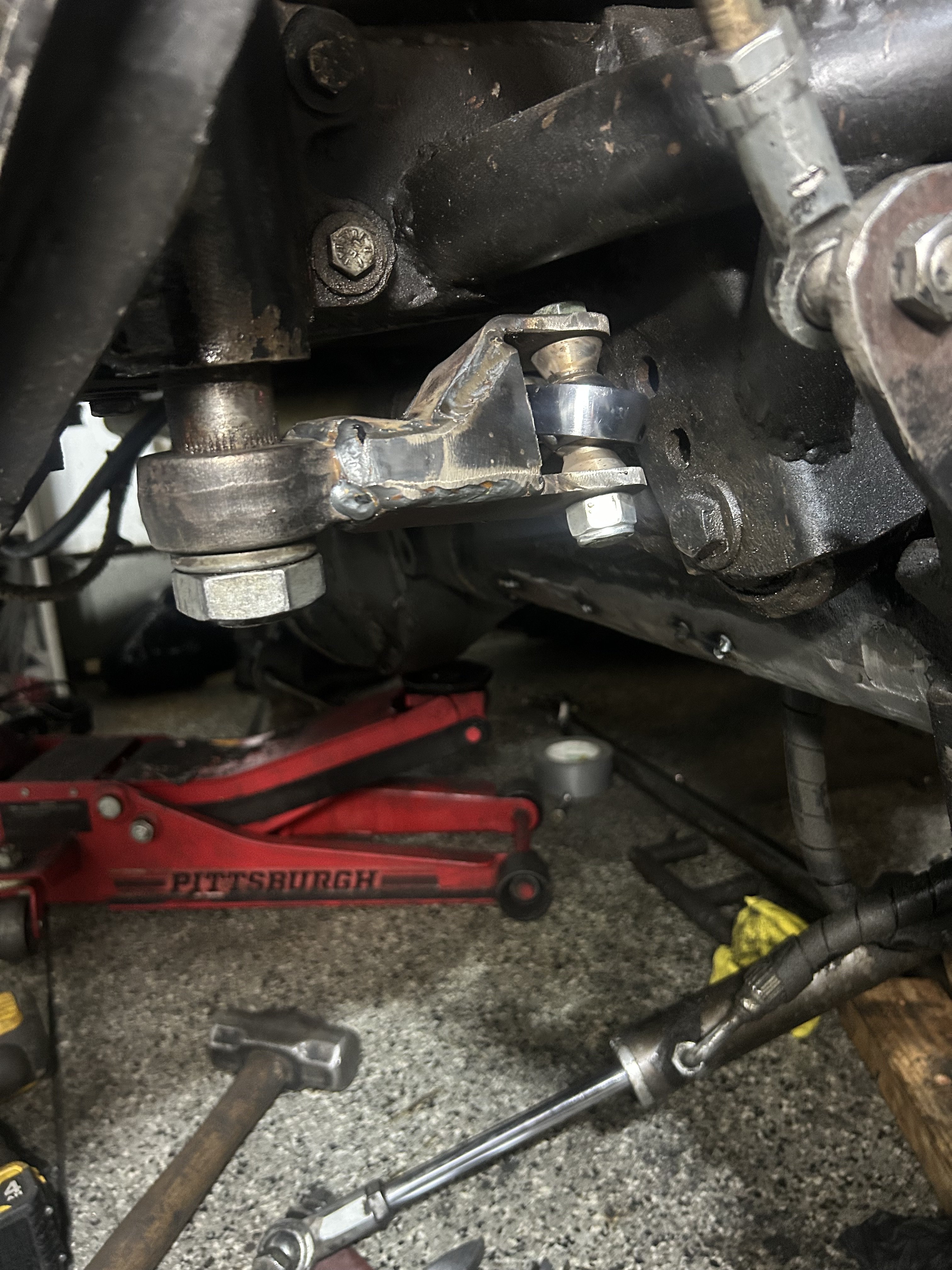

I got the steering mount all done, it has the main plate, then a plate from the bottom of the axle tube to meet at the front of the main plate so it is 1/2in thick there, then the top hat which will transfer a hit to the axle tube vs bending upwards.
Ignore the stacked misalignments and nuts, I need to build spacers for the tie rods.
Then I started tearing into the steering box, what I do not like about the Xterra box is that it is slow steering (about 3.75 turns lock to lock where a stock H3 rack is about 3) I think the SAS is better in every way but the one critique would be the steering. I took WJ box internals (2.75 turn) and put it in the Xterra box, depowered the piston by welding the torsion bar to the input. The box is back together, now I just have to mount the servo and install the pump/resi.

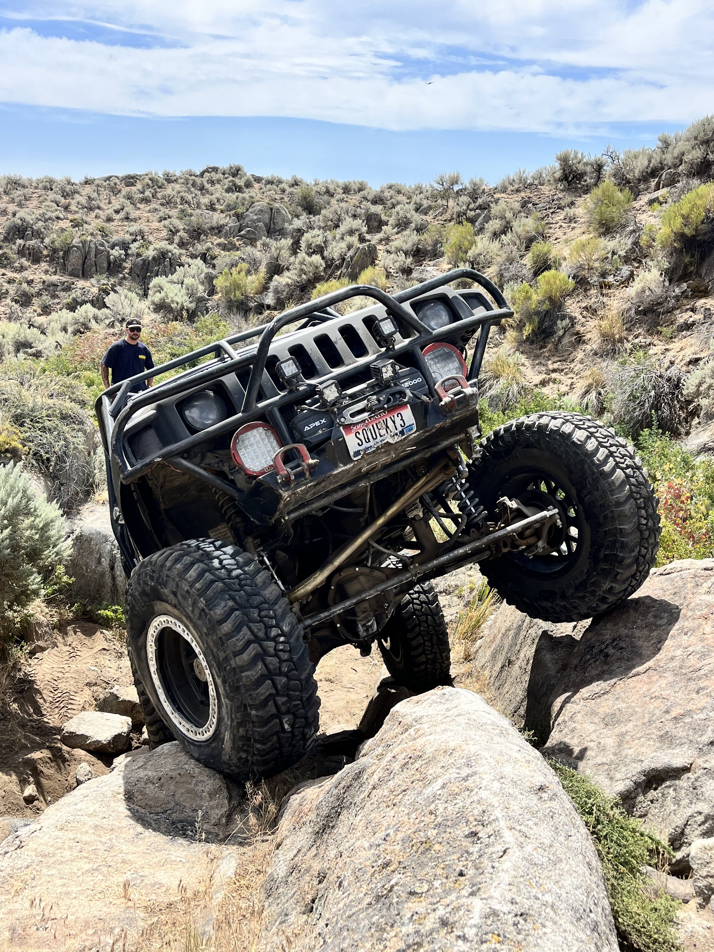

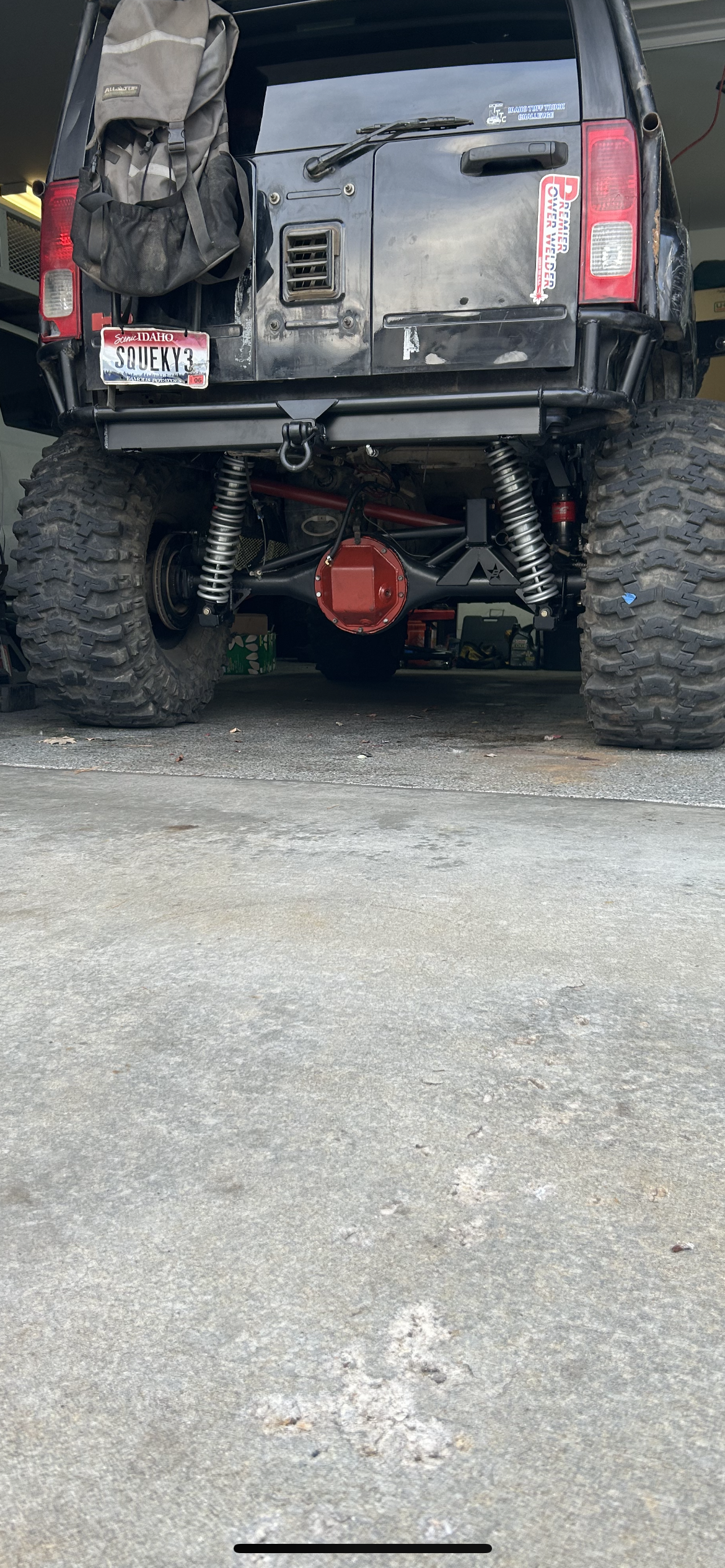

Alright, I got the Hummer running and on the road. The pros, it will run down the highway at 70 mph and not kill anyone. The cons, it does have the shakes at slow speeds/sitting still. This steering setup (depowered box/remote servo) has been known to give the steering wheel the shakes if the mechanical side of things don't match up perfectly with the hydraulic side of things.
A lot has happened since the original post, not all on this thread and ill kind of start from the beginning. When I did a solid axle swap to my H3 back in 2014, I did not consider what I would be doing in 2026. Rightfully so, in 2014 I was blowing up ifs diffs, and I needed to stop blowing up diffs, so steering was an overlooked part. I saw someone use an Xterra box, it fit the frame rail well and I ran with it.
Pros, its outside frame rail to give you a longer drag link. Cons, its rearward facing pitman arm, which causes fitment constraints. While I love the SAS, and think its 1000x better than the factory stuff, if there is one thing I would say is better on the ifs, is the steering angle it pulls.

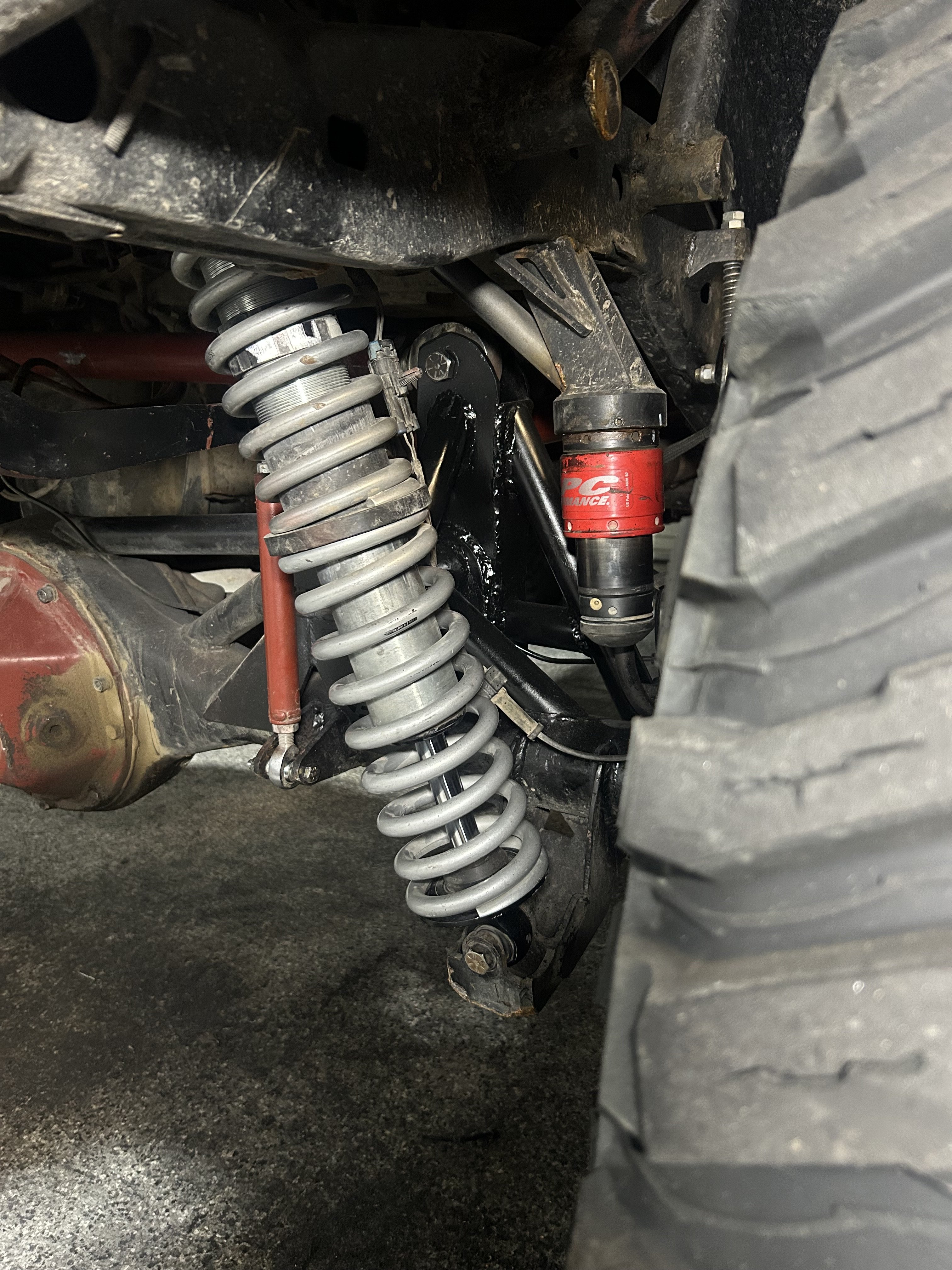

Over the years I went from coil springs to coilovers, longer track bar, added a sway bar, added air bumps, etc. I added a ton of things that just fit around the box, and to start over with a different box would have had me redoing a **** ton of things. To the point that I probably should cut the front frame off to maximize everything more. At this point I have a 100% stock frame, it isn't even notched in places, and with the restraints of the stock frame it is pretty much maximized.
My last iteration before this one, I ended up with a redhead xterra box that felt tight, and had ram assist for a 1.5in ram. I needed offset heims to not hit the diff cover, which added a dead spot in the steering as it would like to "flop." I could bend a 1.5in .25wall tie rod like a pretzel and probably went through 6-7 of them over the years, I would usually get a year or two out of them but really, I'd get a fresh one, bend it the first trip out and limp it along for a year or two before it was almost unusable and I would have to build another. Finally, I got tired of those tie rods and had one made out of stressproof material because I needed a better material, going up in size would cause fitment issues at full bump. I ran an aluminum tie rod and with the offset ends it actually would deflect driving down the road and cause death wobble! Anyways, so stressproof....I must say that held up SUBSTAINALLY better, in the end it had a slight bow in it but that would last for many many years compared to the regular old DOM one. The cons, it isnt weldable so the ram clamp had to be bolt on and would sometimes want to spin and just be a pain in the ass. Steering effort was never an issue. Just steering angle and steering speed. When I went to 43's I lost even more angle due to the width. Around that time I started to value steering angle and speed more and more. As I ran harder trails, I started to value things I didnt used to care about. While those tires were kickass, at 18in wide, they didnt like to turn far before hitting links, body parts, etc. Going back to a normal width 42, I put an emphasis on steering angle and speed. The con was travel in the box with the OEM pitman arm length. It wasn't pulling much more angle than what I had with the 43s. To solve this, I could make a longer pitman arm, but I couldnt even get 1/2in more length out of the pitman arm before hitting the track bar mount since it was rearward facing and the box is up against the body mount. From what I understand, a longer pitman arm gives more throw/angle and quicker steering. I know a shorter arm on the knuckle does the same. Another con to the xterra box was 3.75 turn steering lock to lock, the steering was slow. It wasnt an issue back in 2014, or on road but the faster I went on tight trails, I couldnt steer fast enough. I know for force, a shorter arm on the knuckle reduces the steering force being put into the tire, I believe the same goes for a longer pitman arm. So I had a long steering arm at the knuckle and a short pitman arm, with ram assist I had plenty of power but it was slow and it limited angle. So I moved the arm in on the knuckle. Speed did pick up but not enough...but I lost a ton of power, I would say more than the speed I picked up. The 1.5in ram wasnt sufficient anymore, and I barely could fit the 1.5in ram yet alone a bigger one, plus my other issues I was tired of. This went on for about 2 years. I was out wheeling a lot, having fun, but I will always remember the thing I struggled with, not what went great. I was just about over it when it came to lack of steering force and speed, then last August, I hurt my steering box just trying to manhandle it. That was the first time I had a catastrophic steering failure on the trail.
It was time for significant change. I was tired of the lack of power, the dead spot from the offset heims, and the ram spinning with the bracket. I need full hydro power, without full hydro. Can full hydro kick ass on road? Yes, it can. It seems most can't get it to work nice on road, but I know it is possible, I have talked to people who say it feels nice on the freeway at 70 but they are few and far between from what I have seen. There is one issue with full hydro you cant overcome, and that is keeping the clock spring happy, the steering wheel can float and drift, which would kill the clockspring and then I would lose the horn, cruise control and a centered wheel. I didnt want that.
So it was time to go down the 4500 steering rabbit hole. Depower the box so it is like a manual box, all it does is handle the mechanical side of steering, the remote mounted servo has less flow constraints of a regular box and handles the hydraulic side of things. I understand that there are a lot of variables and it was best to just follow the recipe known to work but a new box would cause a lot more work, and in the end the same box required a lot more work too, but I didnt find that out until later.
So the plan, sweet servo (not howe modified) because it has worked for trail rigs, an xterra box, with WJ 2.75 turn internals because they are both a part of the delphi 600 platform that can interchange parts, a 2.5in double ended ram like a full hydro setup.. (I ended up using JK 3 turn internals, mechanically advantaged to be 2.75 turn in a Xterra box which consumed a ton of time when the WJ parts didnt end up working out.)
Well the ram would hang down super low due to the drag link and pitman arm combo, if I could get rid of the drag link like full hydro Id have so much room but since I’m keeping it, the trade off I made was a new pitman arm to get the mount to be within a 1/4in of the old tie rod height, and I am a little farther out then the tie rod, the old tie rod was 7 7/8 off the axle tube, to the end of the flat plate I am 8in off the axle tube and the angled part, a tad more.
So, will it work better? I don’t know. Is the power better? I dont know....I assume a 2.5in DE ram with a 1750 psi pump has more power then a 1.5in SE ram, and a box.
Will the clearance be worse? Idk, I mean I hit the **** out of the tie rod for over a decade, now the 2 tie rods for the ram is higher, but the ram mount is ever so slightly lower and I’m not sure if it’s more slippery or not.
The 2.75ish turn box is much better and quicker.
The shakes suck, but I’ll work on that. The .220 bar is stiff as hell, but I can change that too.

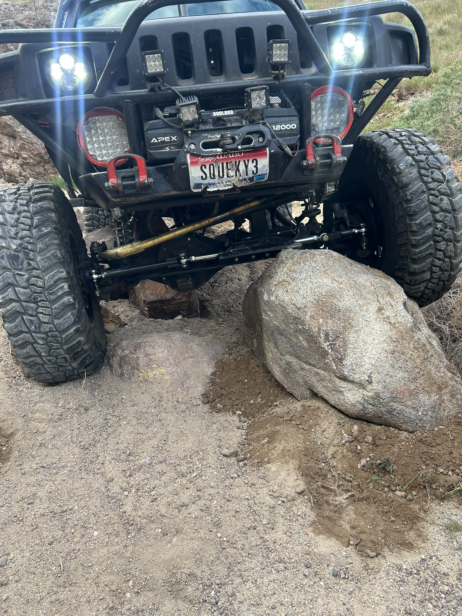

Driving into a lone rock, to make sure it doesnt fall off....or bend.
