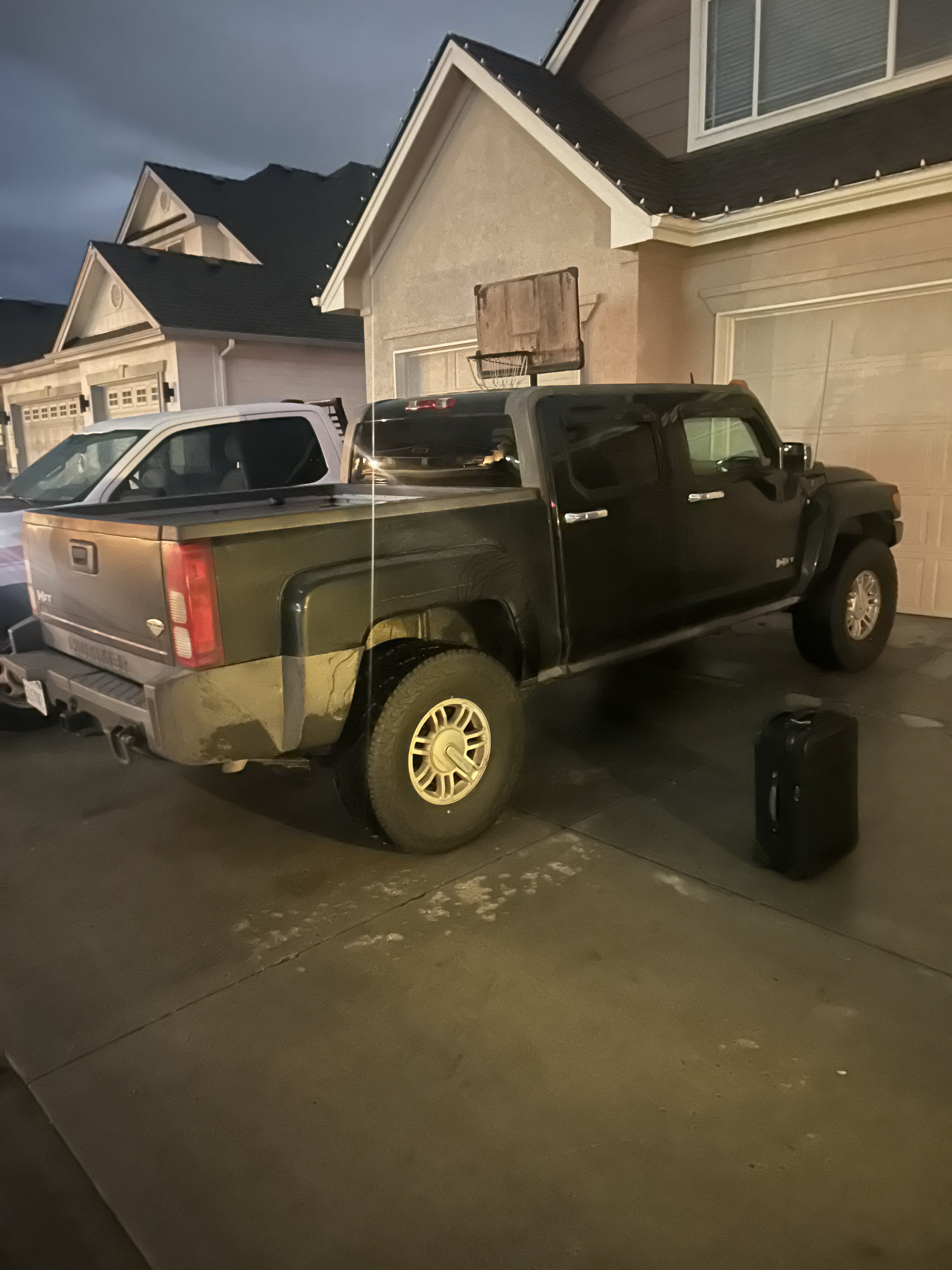

So I’m about a week out from flying into socal.
I already have a steering rack clamp/bushing kit at my buddy’s place, thanks @alrock I have lower ball joints, and upper control arms en route. The front lower control arm bushings are discontinued/MIA everywhere but Siberian bushing but they are out of stock. Rearward frame side LCA bushings are in stock but I don’t want do 1 and not the other. They are bigger bushings so I’ll gamble that they are ok and deal with that at home.
I have a BCM arriving to my house this week, I have a clone tech 2 also arriving. I’ll bring my laptop to act as a pass through for the tech 2 so I can program a BCM. On my laptop I have HP tuners so I can disable pass lock if I have issues.
My buddy said the CV boots are torn. The local junkyard has 2 H3s in there now. I’ll go see if they have decent CVs. I don’t want to spend money on some aftermarket crappy ones, I’d rather use some oem ones from the junkyard.
I guess I could order tie rods? He said there’s some play in the steering but I’d assume with 135k miles it’s the bushings/clamp more so then the tie rod ends but maybe I should quickly order those too.
I also forgot I have an AAM11.5 rear axle he’s been storing for me for over a year so I’ll bring that home with my empty truck bed. :)

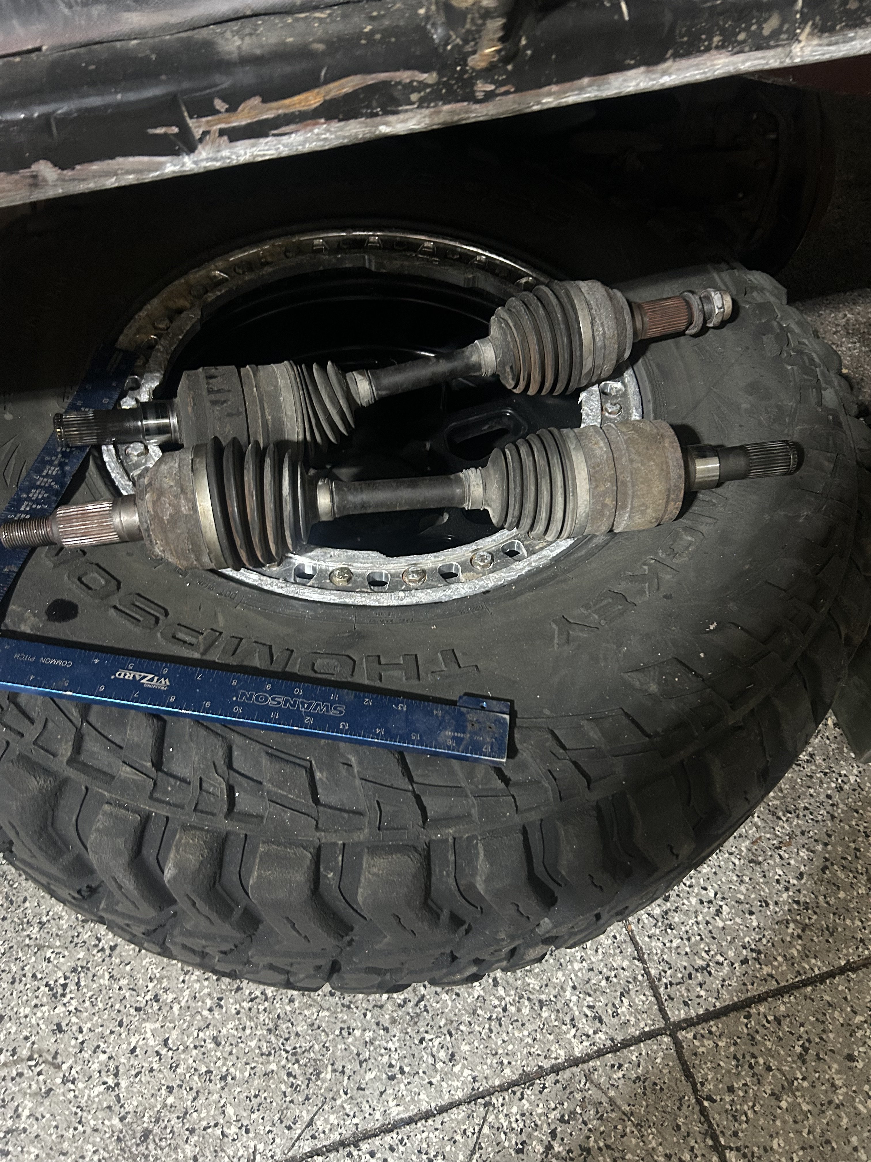

My wife and daughters were all tired last night and so I spent my new years pulling the CVs off the front frame half because the ones in the T have bad boots.
These aren’t oem from what I can tell. I forgot how to tell if they are oem. I think they lack the ridges on the inner part.

Yeah, that's not the shape of the axle shafts of OEM CVs.

Upper control arms, lower ball joints, CVs, all fluids, t bar crank are done! Off at the tire shop for 35s and an alignment now. Didn’t get the steering rack clamp done yet. I needed to get to the shop. I don’t think I need an alignment after the clamp but who knows…I mean tie rod length isn’t changing and position of the rack shouldn’t be changing.
The CVs were HAMMERED. They literally didn’t have boots on them. :oops:

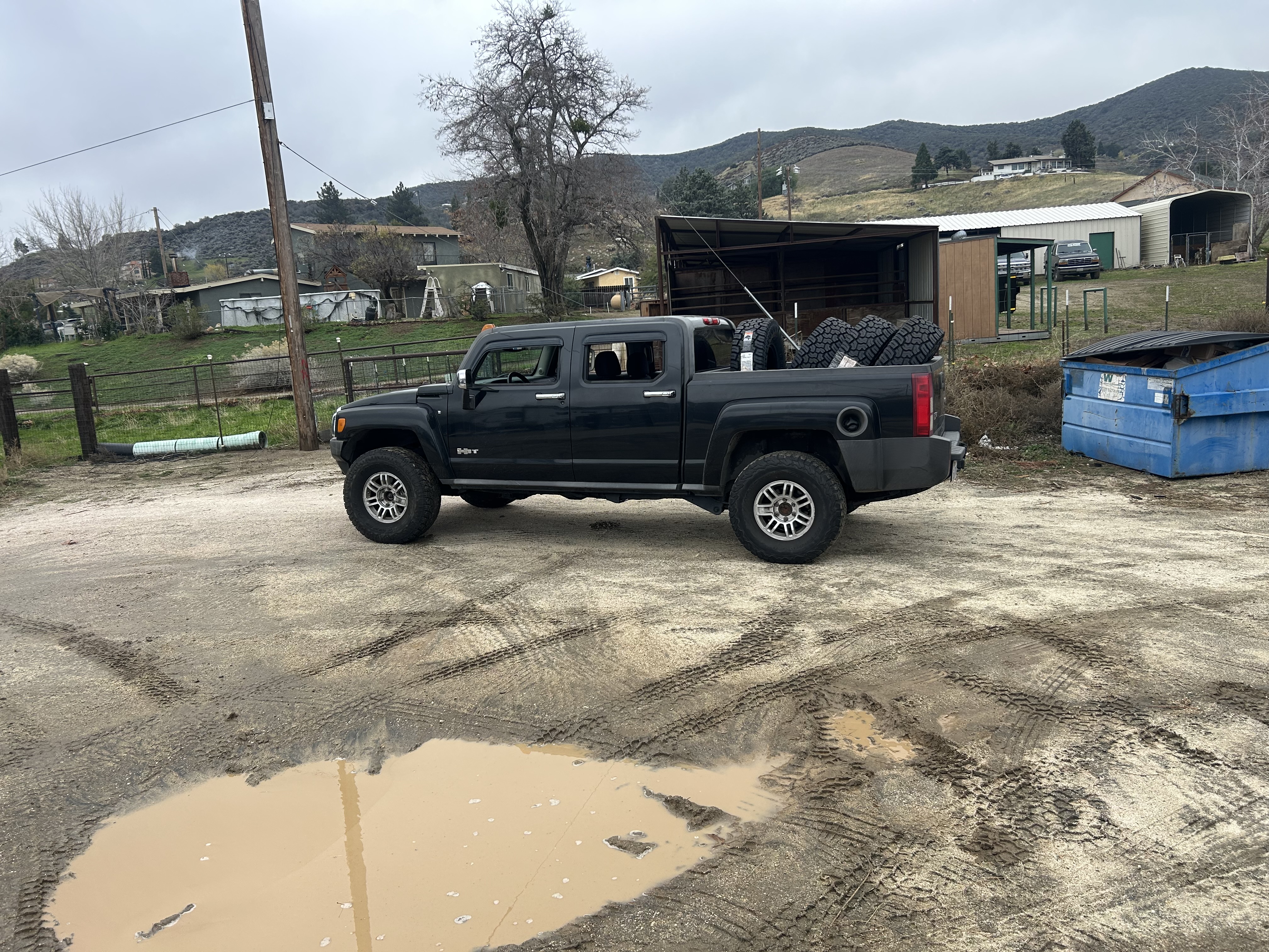

Here was Friday nights camp near el mirage.
POS duralasts….was using them to get home before doing bilsteins but they didn’t even make it 5 miles of dirt roading….time for a SAS! JK.
Saturday morning hit the 395, followed my buddies through Randsburg
Dimensions are so similar. Both on 35s.
We said our goodbyes, they all continued on to Death Valley and I hit the road, I got home around 11pm last night.
