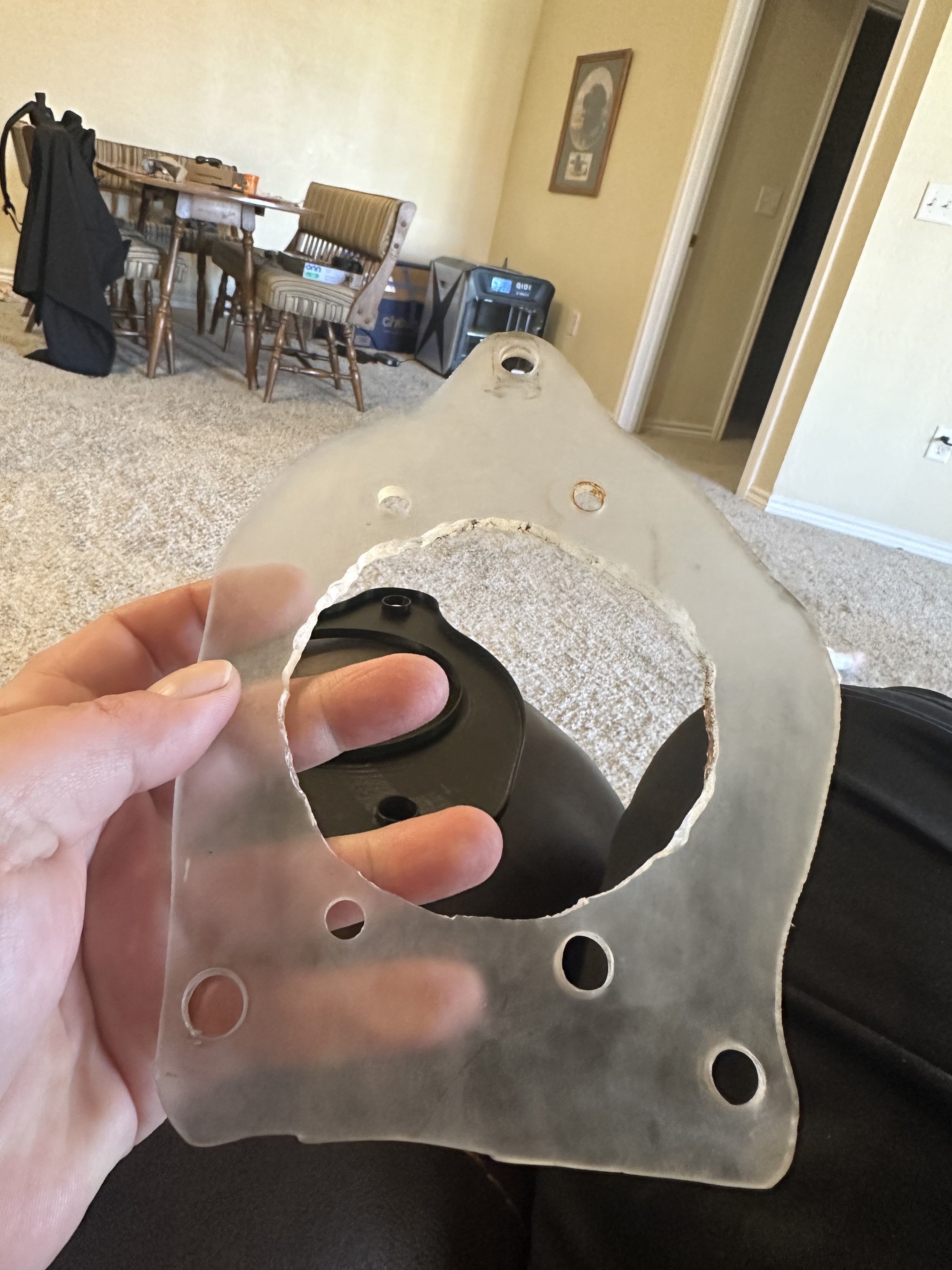

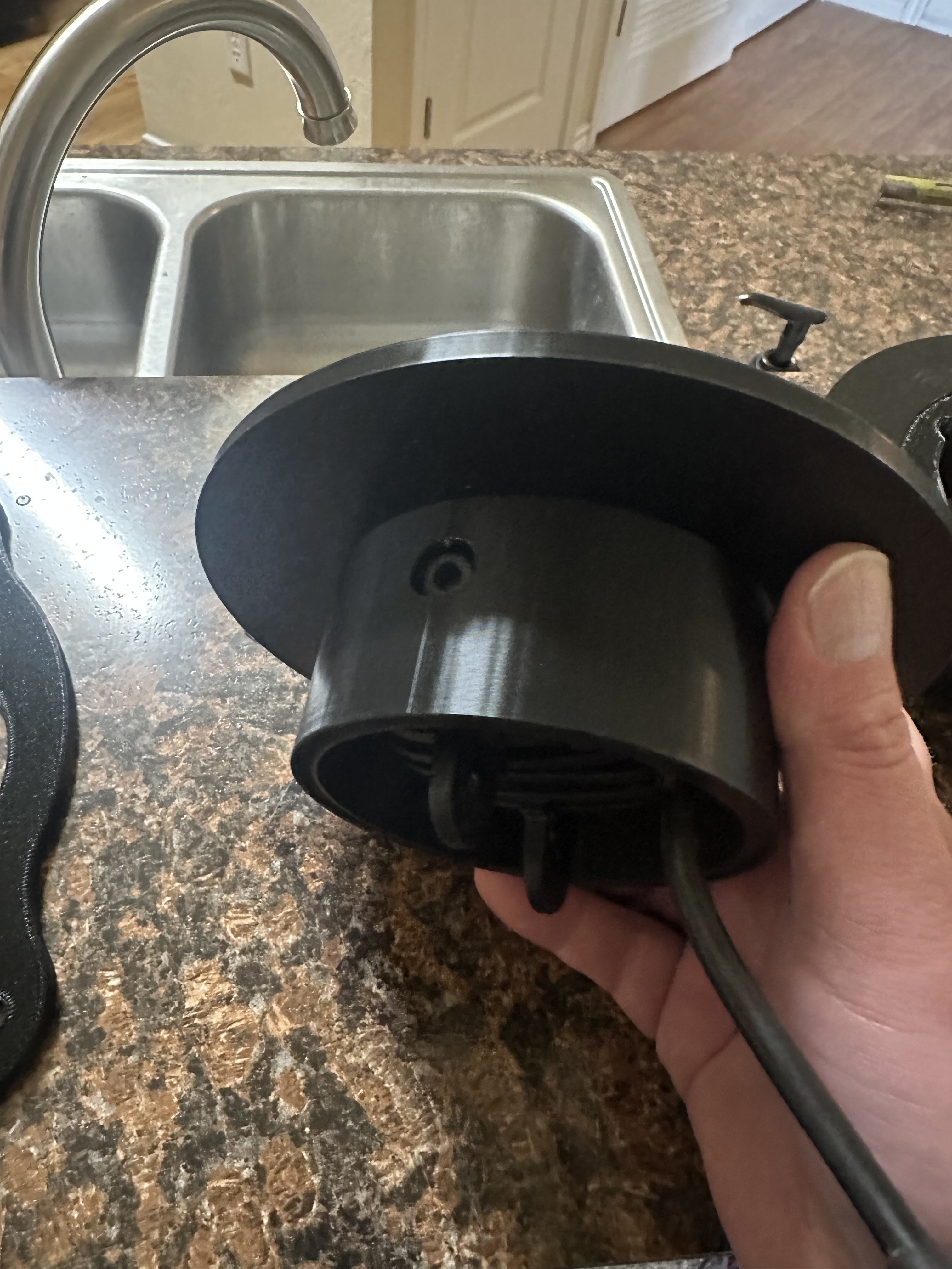

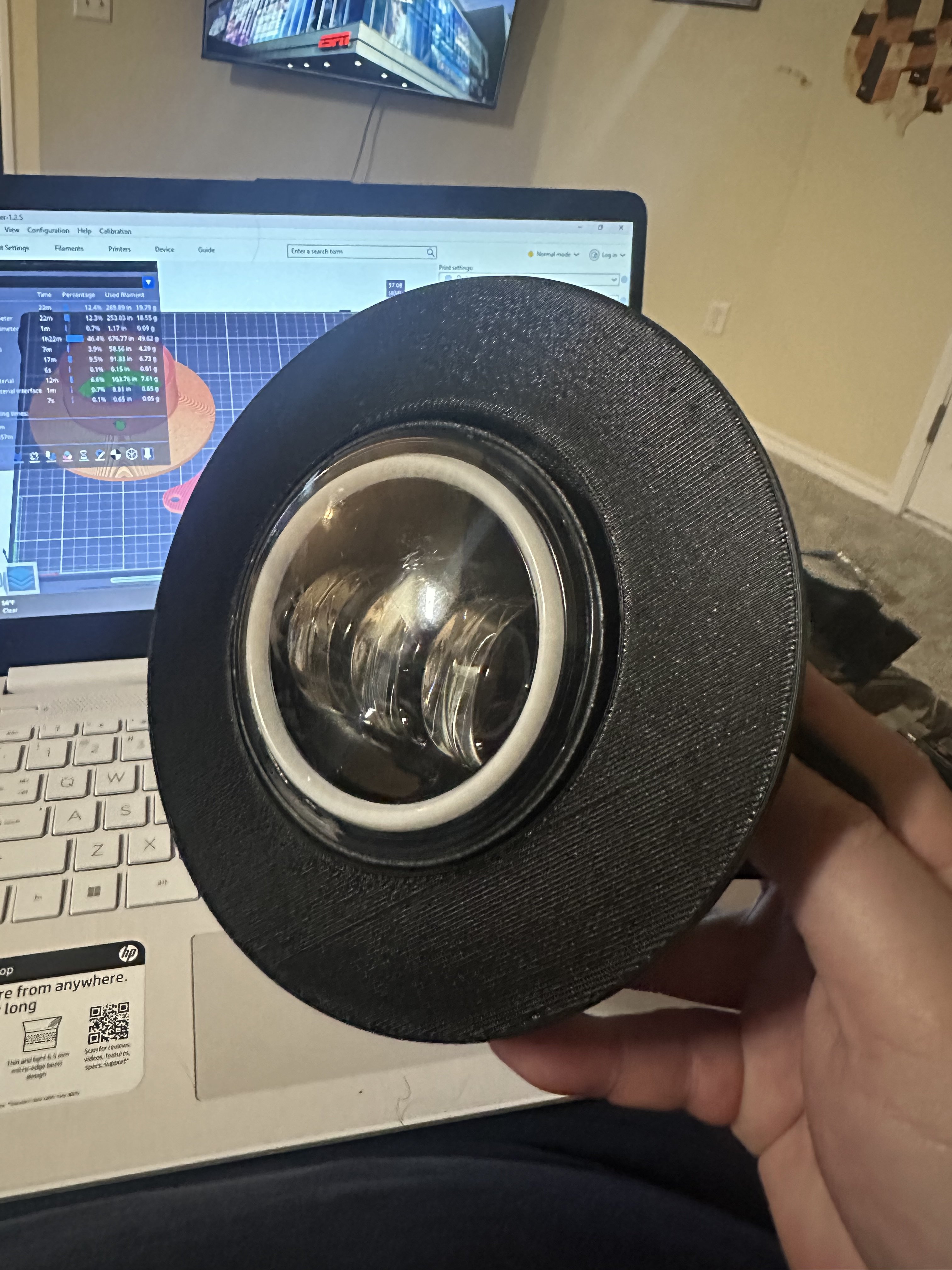

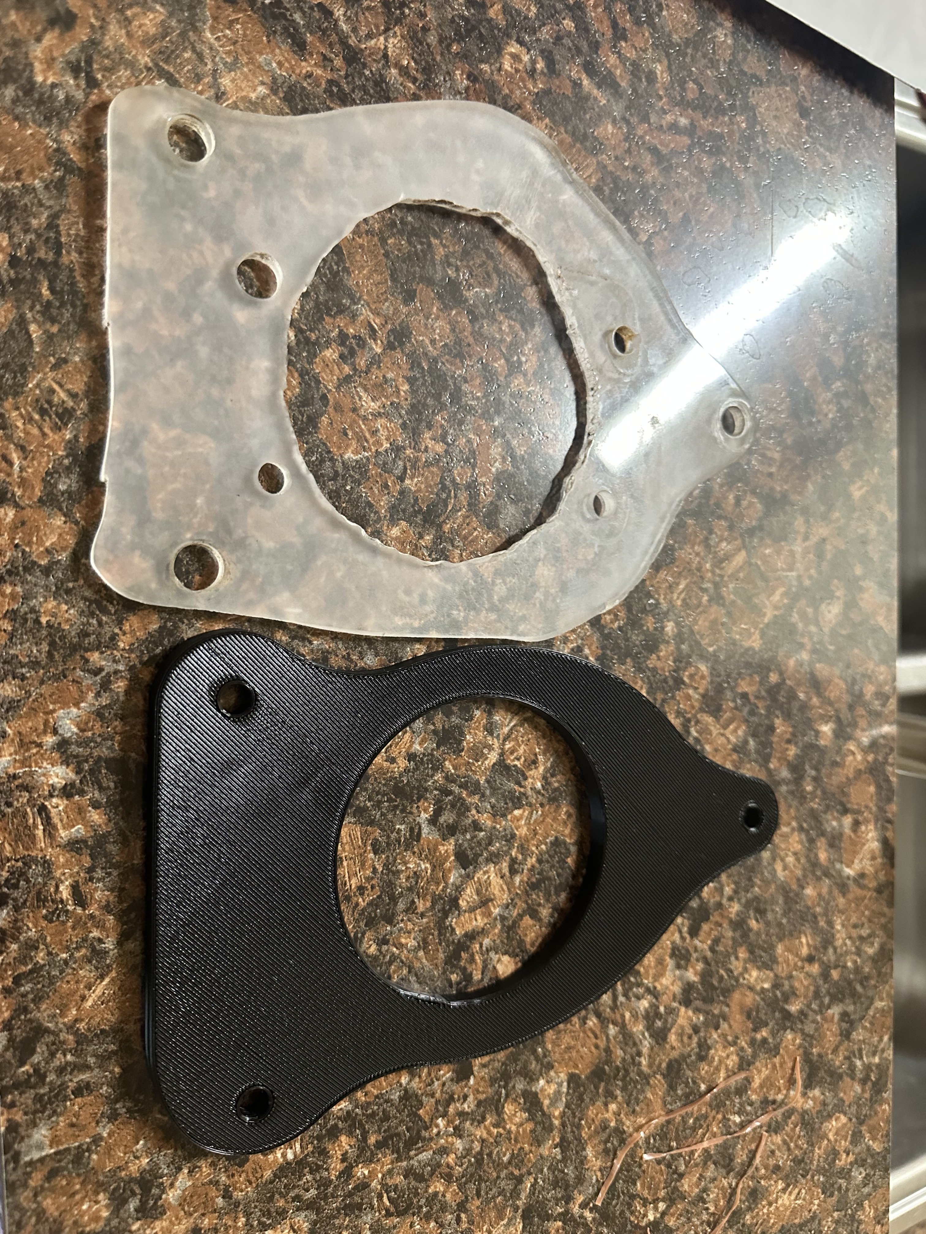

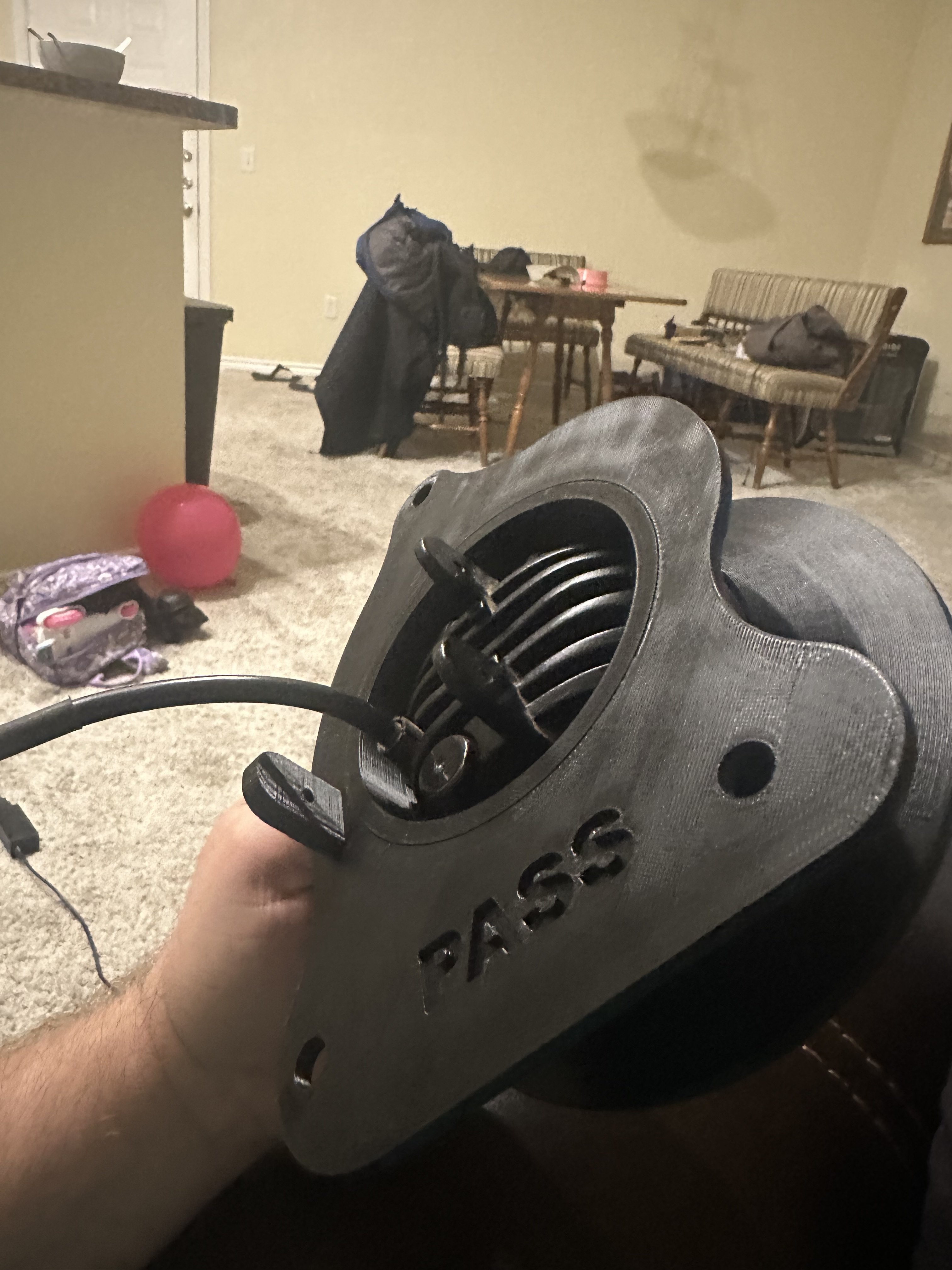

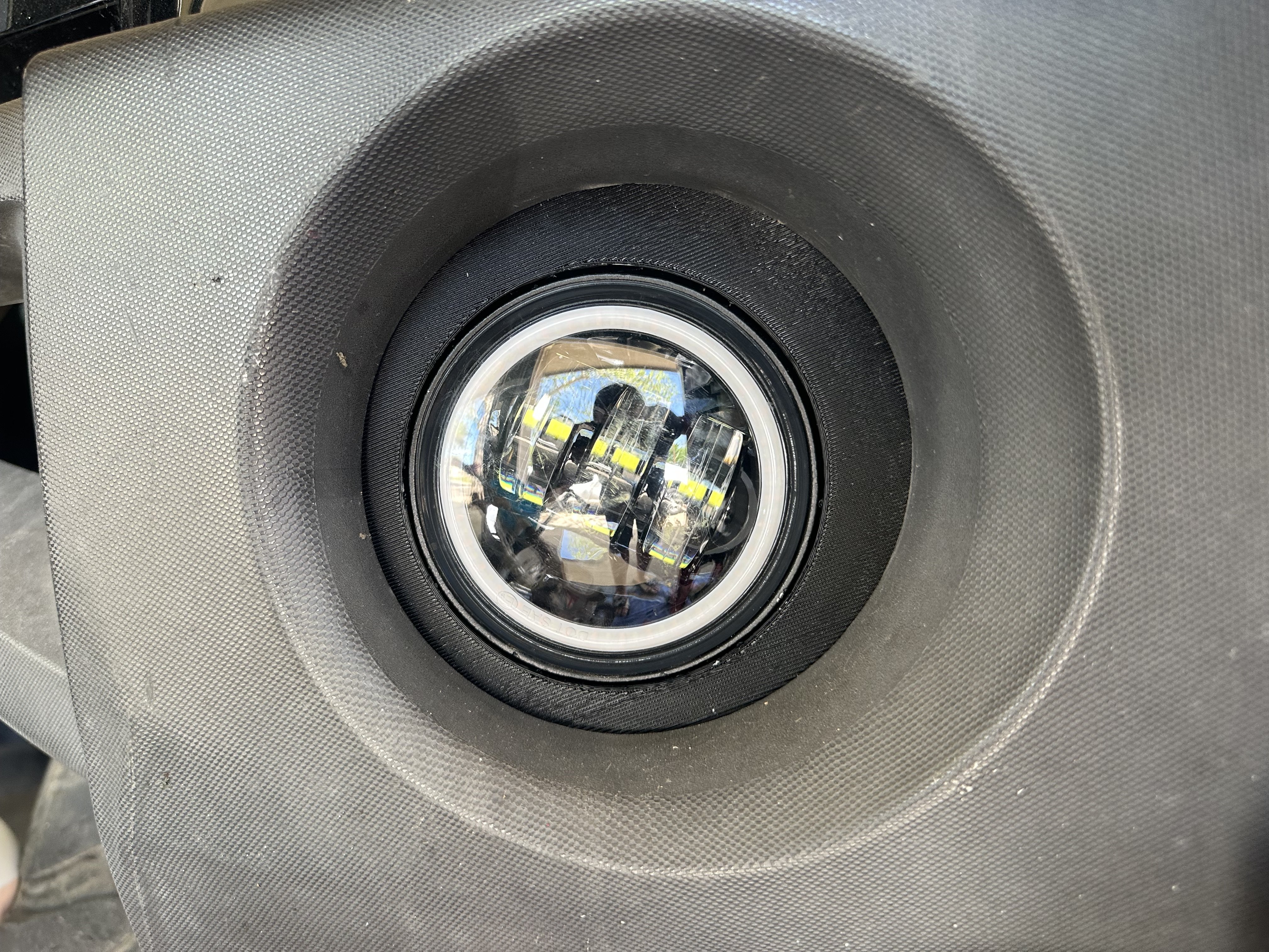

Yesterday I pulled out my half ass fog light bracket and got to work redesigning it to better suit my OCD and hopefully fill up the bumper gaps a bit better.
This was my first version just to get them mounted and useable last year or maybe the year before. From there I modified the design on my 3d printer to come up with…
After re-measuring the holes and some additional modification I came up with
Print is done with very little attention to detail as far as the print quality goes but all the holes line up with my previous version. From there I worked on moving the fog light itself forward with a trim ring to cover the gap
After the print I found I had a couple missed measurements and I didn’t like how the trim ring and insert were two different pieces. After some more modification I came up with my final or pre-final prototype, again using a very low quality print
I may make some more small modifications but the fog light clicks into the assembly with some moderate pressure and holds tight. Still need to look into more adjustability with it for the beam direction but very happy with the current outcome. From here I need to bolt it into my h3 and make sure everything aligns correctly in the opening before making a final print with ABS.

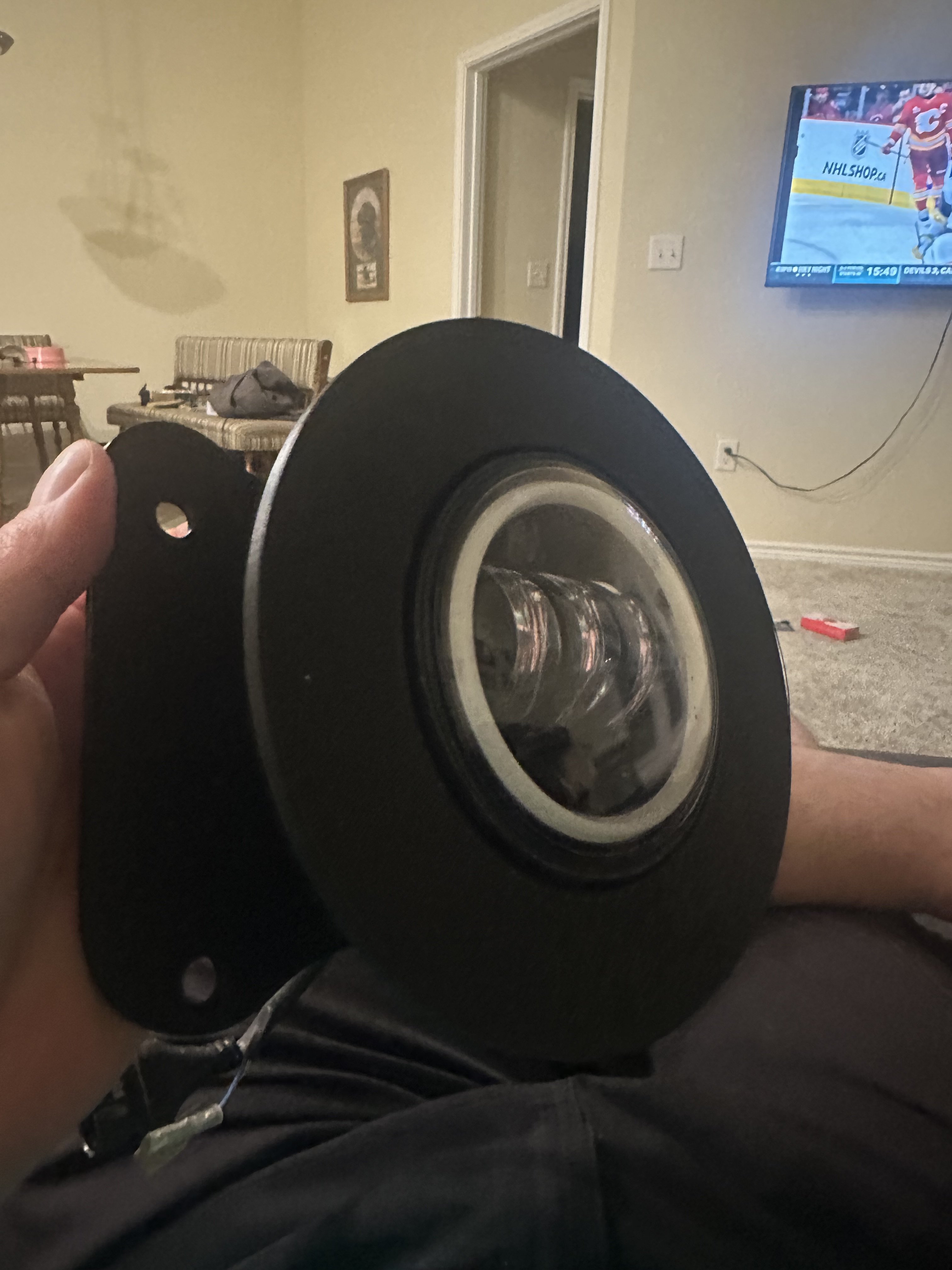

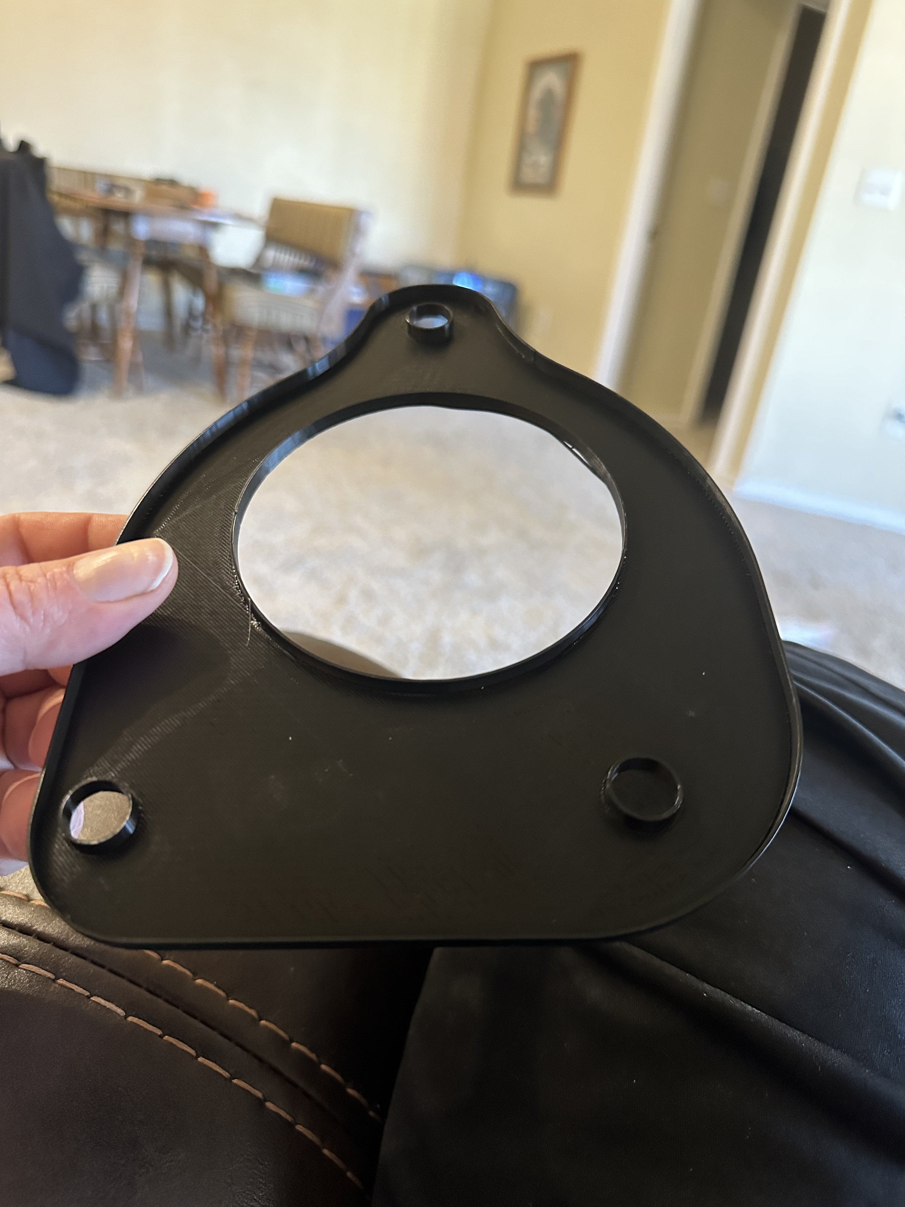

Well, couple other changes to the bracket. Found out I missed some of my measurements so things were a bit askew once it was bolted in. Pay no attention to the fog light being angled in the bracket. It was just thrown in for measurement purposes.
Made some changes to the bracket to better center the the light, made an alignment pin to prevent the light being installed crooked like in the picture, recessed the light itself (my OCD didn’t like how it stuck beyond the trim), and modified the lamp mounting hole to allow more adjustment for beam alignment.
I have what I believe to be my final test version running in the printer currently. Added a tab to the base to attach the alignment screw and spring (not shown), which will also hold everything together (in addition to some CA glue).

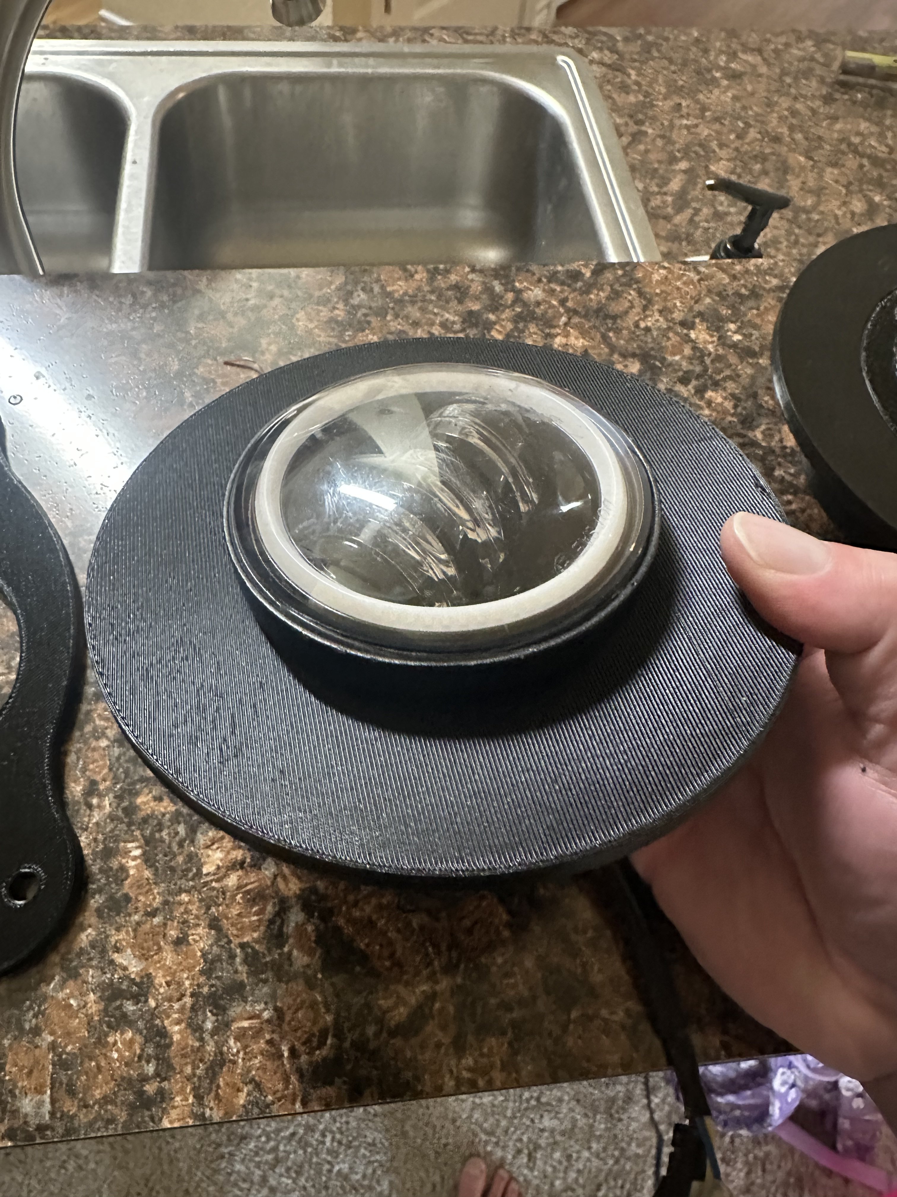

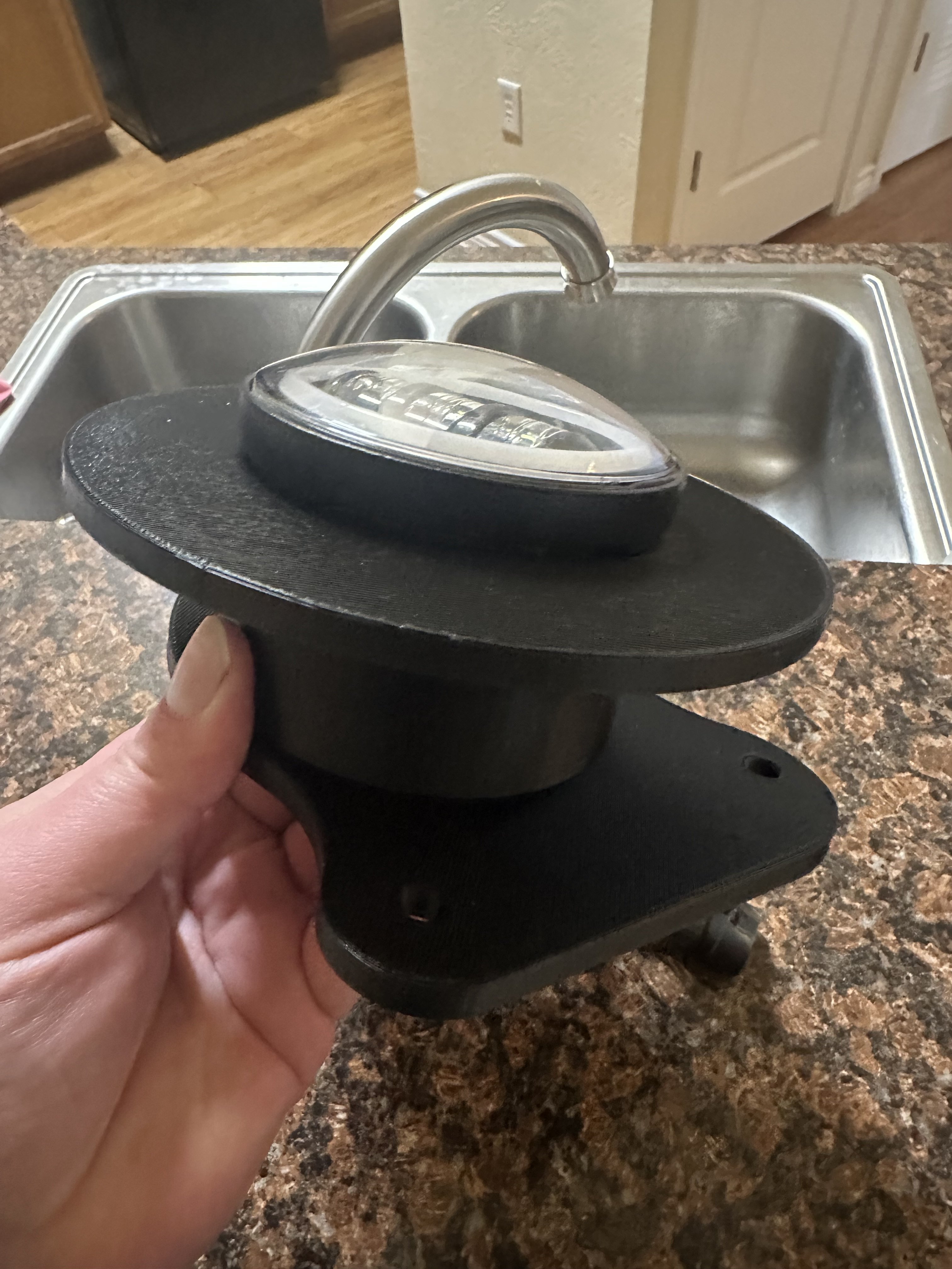

Final fog light bracket revision completed! Fog light clicks in with some moderate pressure but still allows up and down movement for beam adjustment, and the foglight is better centered in the bumper opening without those ugly gaps.
Lower bracket allows the original screw and spring (from the aftermarket fog lights) to be inserted for adjustment for a factory like install.
Will be printing them in ABS sometime this week when I have a nice day outside and can vent out one of the rooms since ABS puts out some serious fumes.

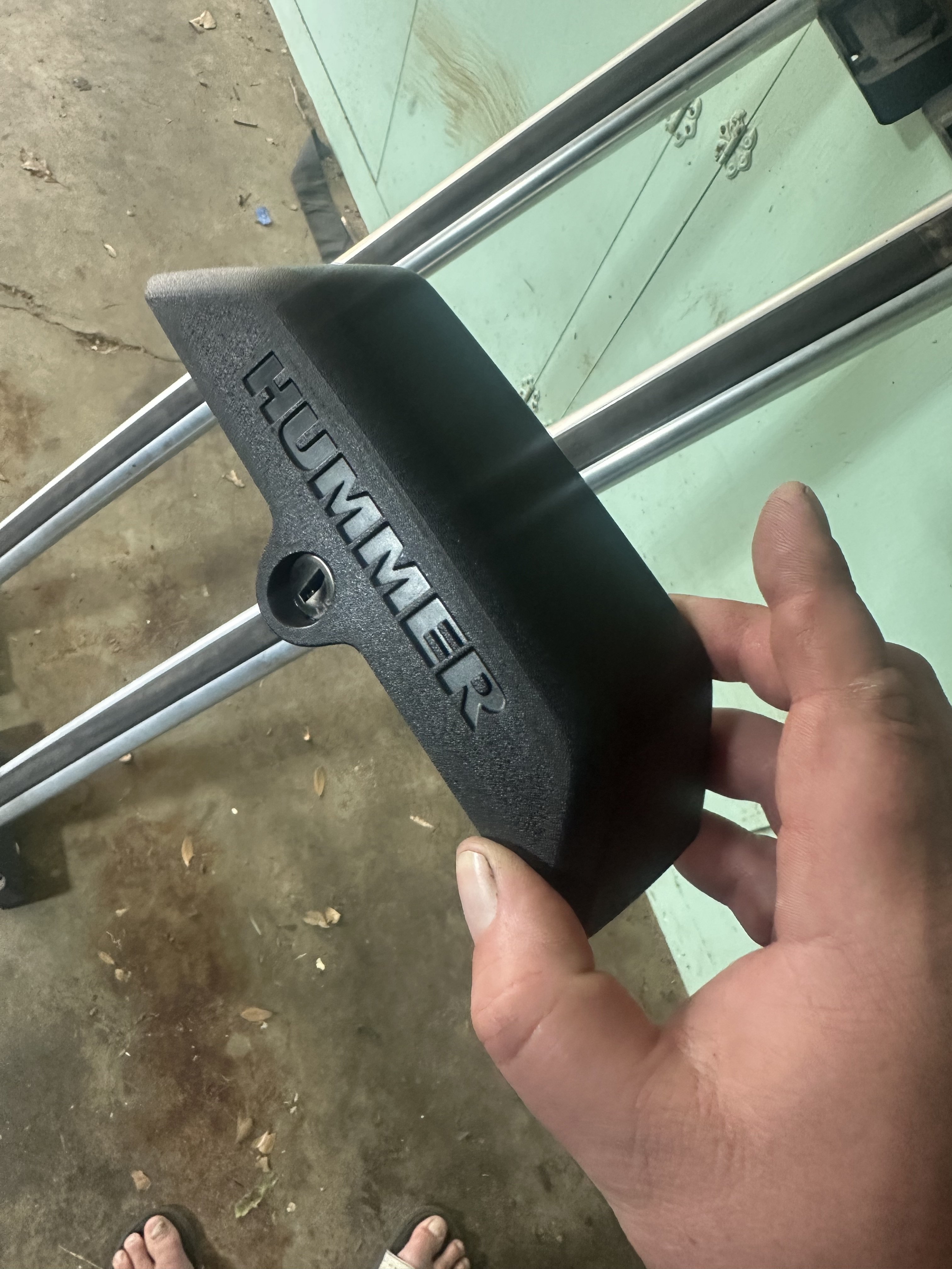

While I was at the house I pulled the a-pillar trim as well. Will be working on creating a factory looking a-pillar with dual gauge pod for oil pressure & transmission temperature gauges to be installed after my V8 swap.

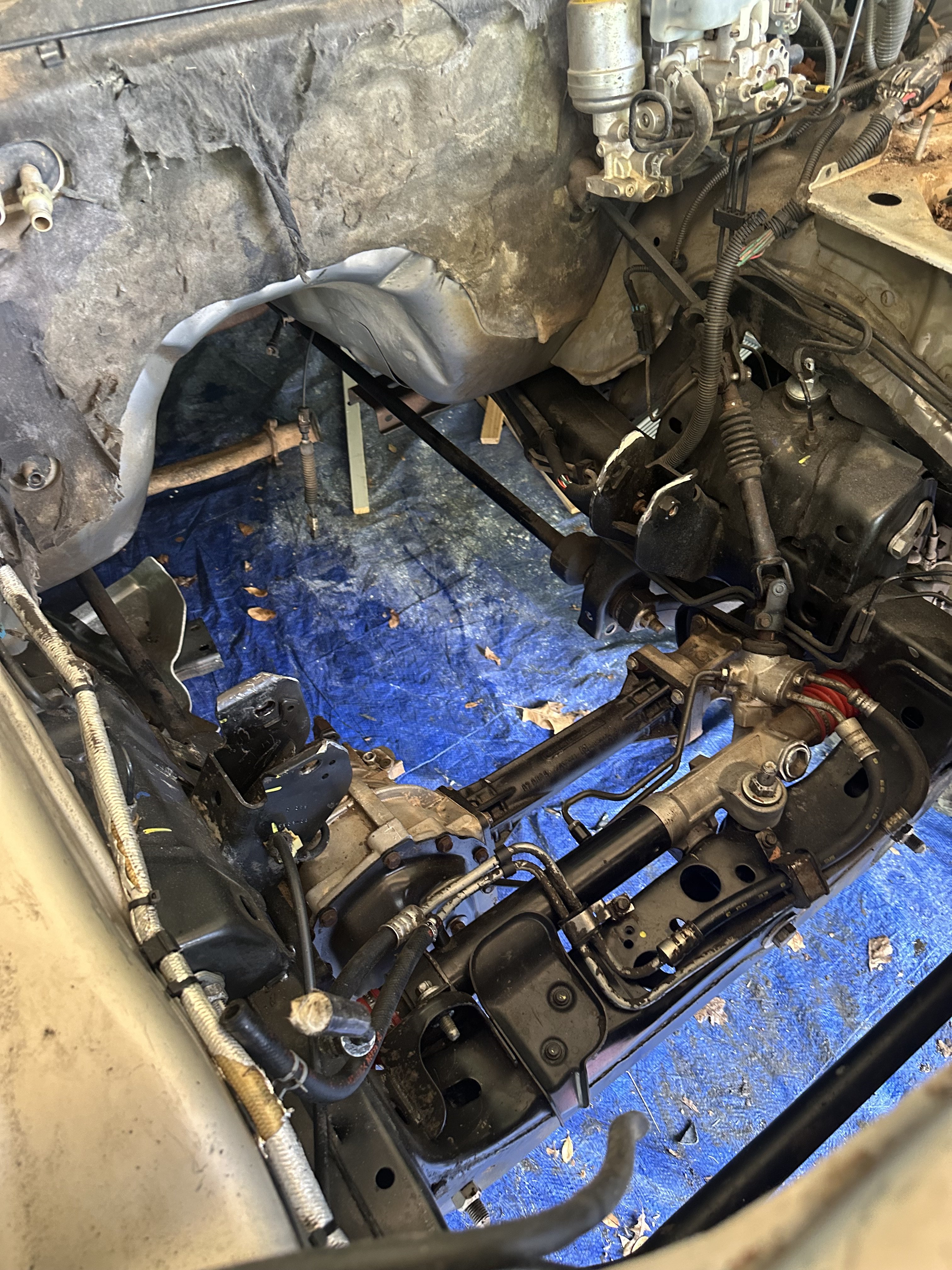

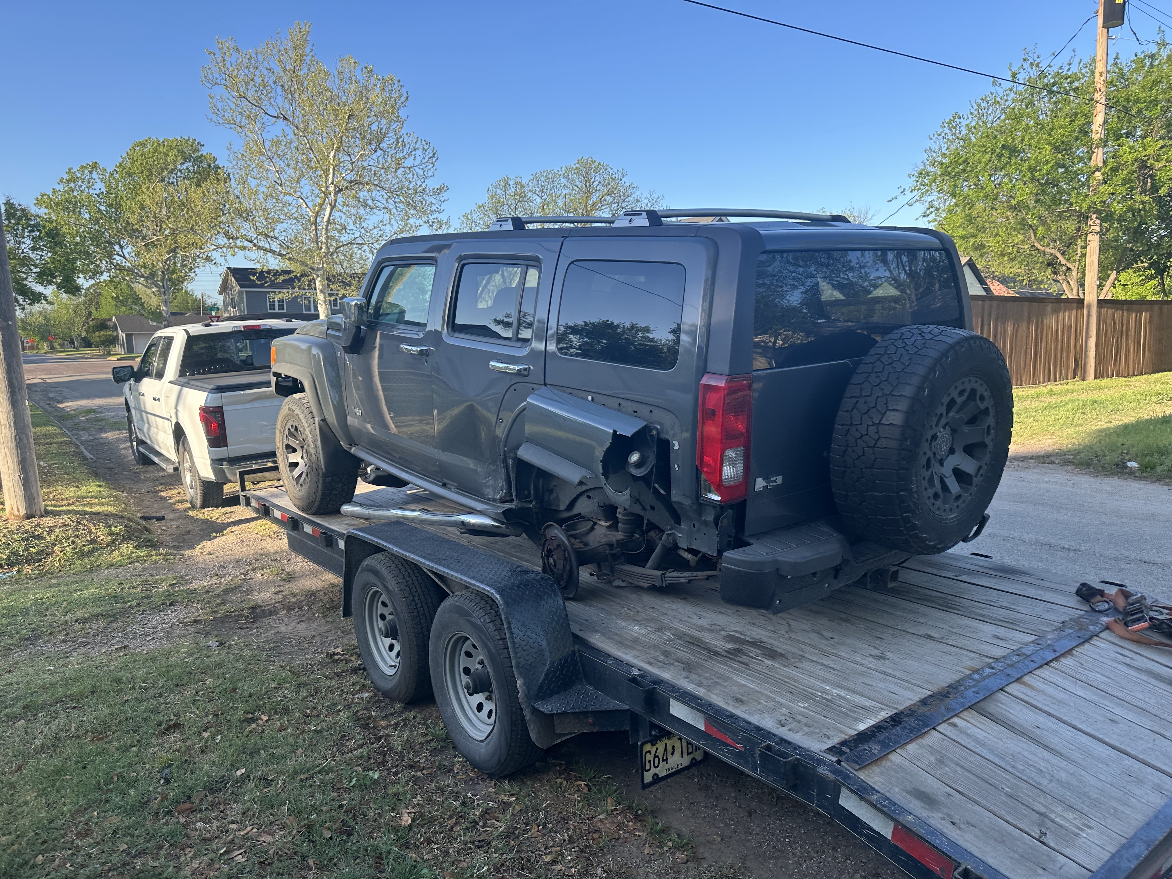

FINALLY PROGRESS!!!!

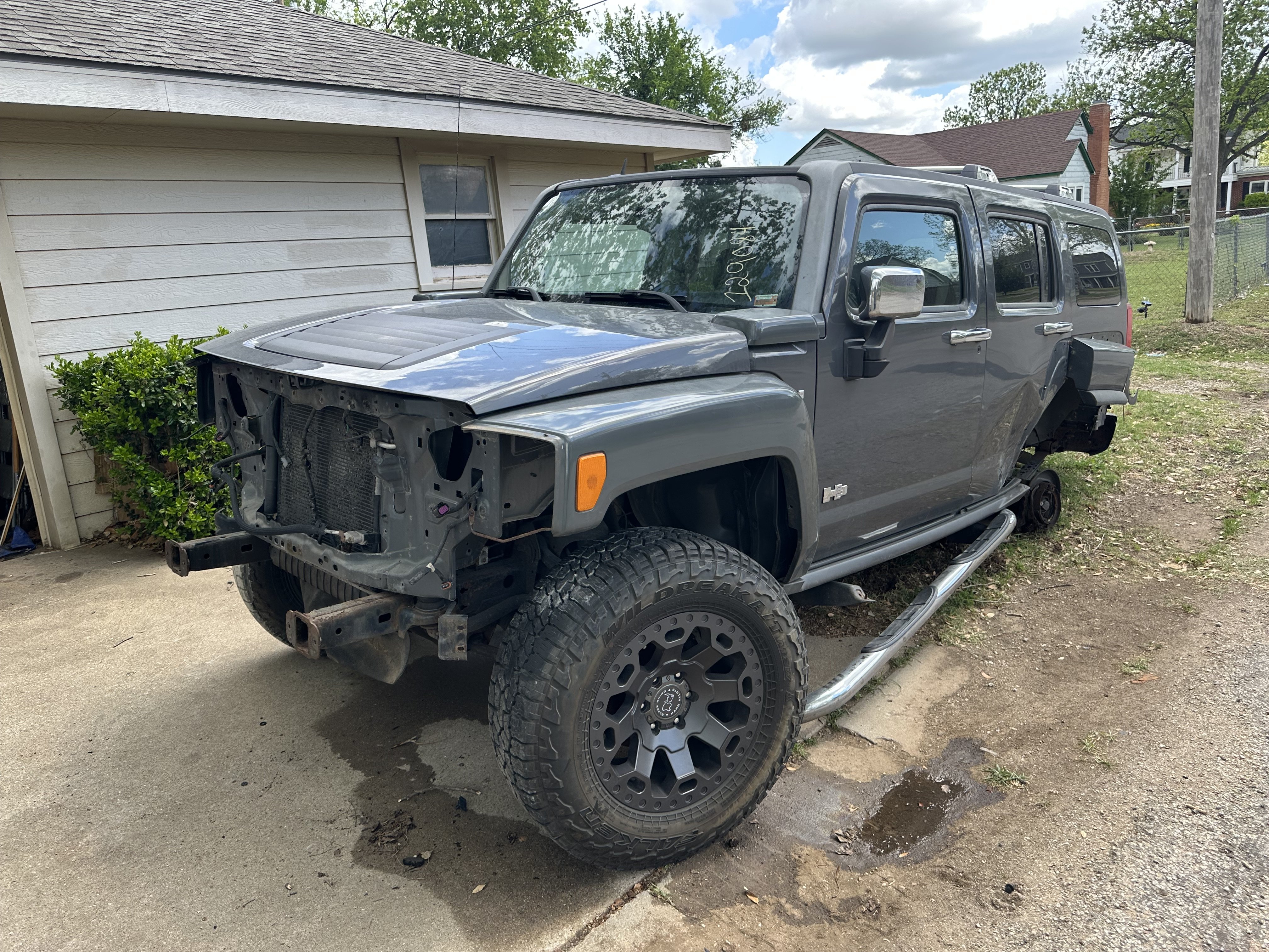

Alpha got delivered today after waiting almost 5 weeks for delivery and boy the auction pictures didn’t do her justice! Interior is in amazing condition and the body isn’t awful either…..minus the driver rear corner.

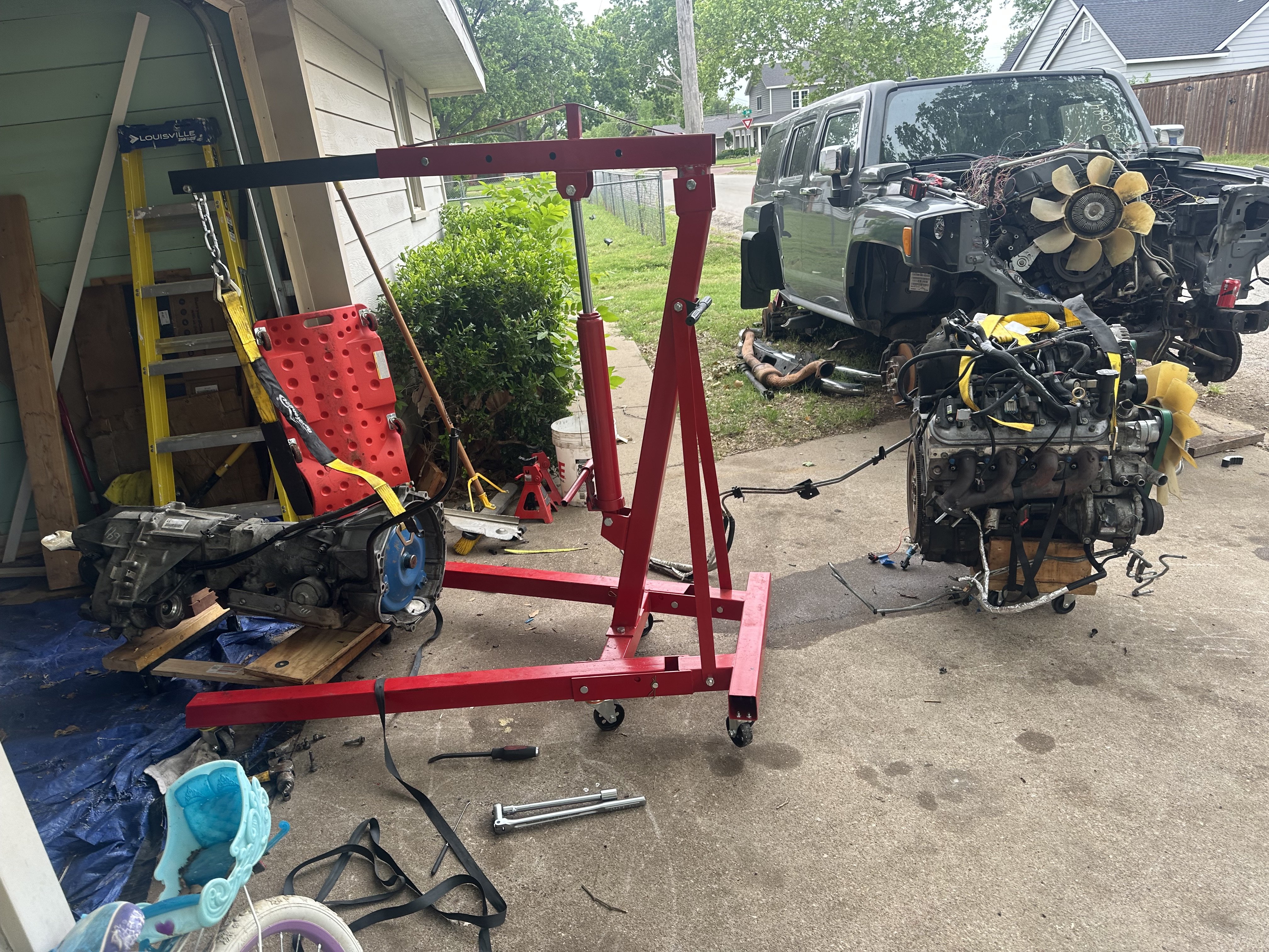

First thing I did was check to make sure it had oil and fluids in it then after a quick daisy chain with another battery and some jumper cables did a dry crank over (no fuel) to get the oil moving. After that I threw the relay back in and she fired right up! Let it run for a little bit while the dashboard was screaming codes for ABS, BRAKE, traction control, and almost every other light possible EXCEPT for the check engine light. Threw a scanner on it after shutting it off and found zero codes in the power train. Obviously there were lots of codes for the brake, traction, and other misc modules associated with the rear end. Started it up again just to make sure there wasn’t some pending CEL that needed two cycles to display but was pleasantly surprised to see the CEL stayed off after another 5 minutes of it running
Once I drooled over it for half an hour I decided it was time to get rolling with the work at hand. I have a few people coming by tomorrow to buy unneeded body parts from it so I can start recouping some of my purchase price, so I needed to get rolling getting those parts removed.
After roughly 45 minutes the front end was nearly completely disassembled and parts ready for pickup.
Then came time for the whole reason I purchased this truck. Time to work on getting the motor ready to come out. After another hour or so of taking extreme care to label every harness and remove them without damage the wiring is all but disconnected from the chassis. I could probably do without labeling every harness but since I will be splicing and modifying the harness to work in the 06 I figured it was worth while. Still need to pull the plugs to the PCM/TCM but that will be a very simple process for tomorrow.

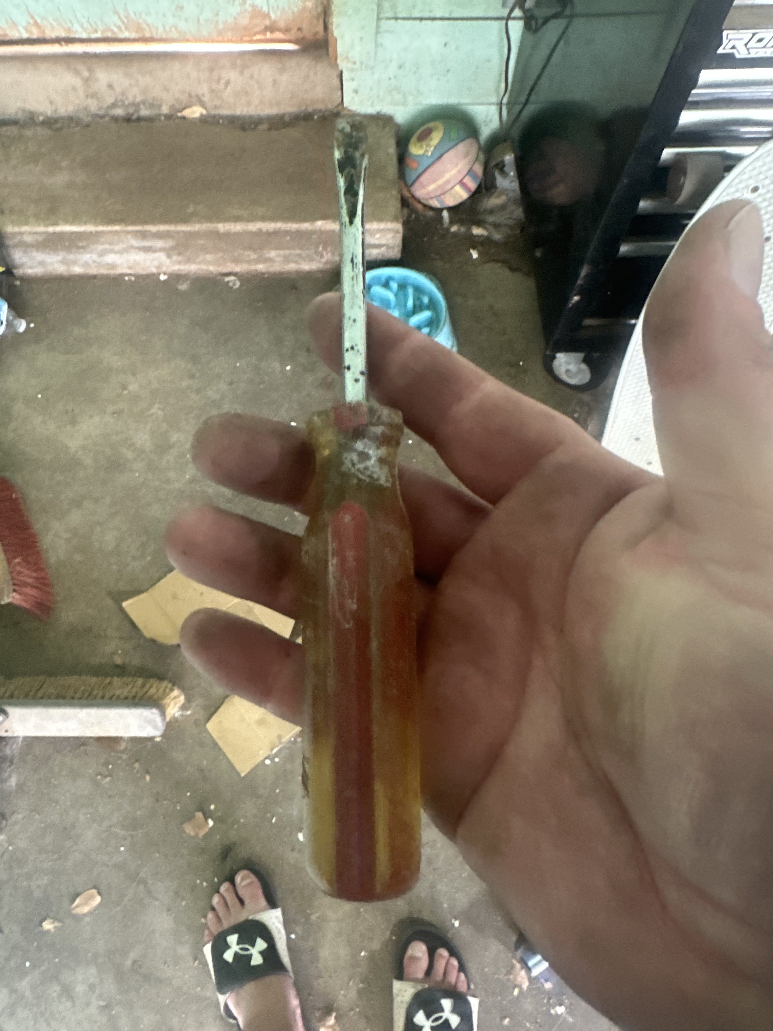

Also scored an extra custom screw driver during the tear down lol if you don’t enjoy getting “free” tools you shouldn’t be working on cars.
Tomorrow I will finish disconnecting the harness, pull the cross members, remove the rad & condenser, and with any luck pull the entire swap in one go. I plan on chopping a nice large hole in the upper rad support to assist in the removal ease since I’m sure that’s not going to be a part to “fly off the shelf” so to speak, nor am I going to drill out every single spot weld for it.

I am very interested in the A pillar pod you come up with. I've had a couple over the years, and a one off sitting on my shelf right now, but none have that clean OEM look.
That’s my issue with the aftermarket versions. Just looks like an after thought, rather than something that could have come factory.
To be clear, that’s a bit on the back burner now that I have the motor on hand. But, once I get it done I’d be happy to reach out to you about it (maybe by Christmas?)

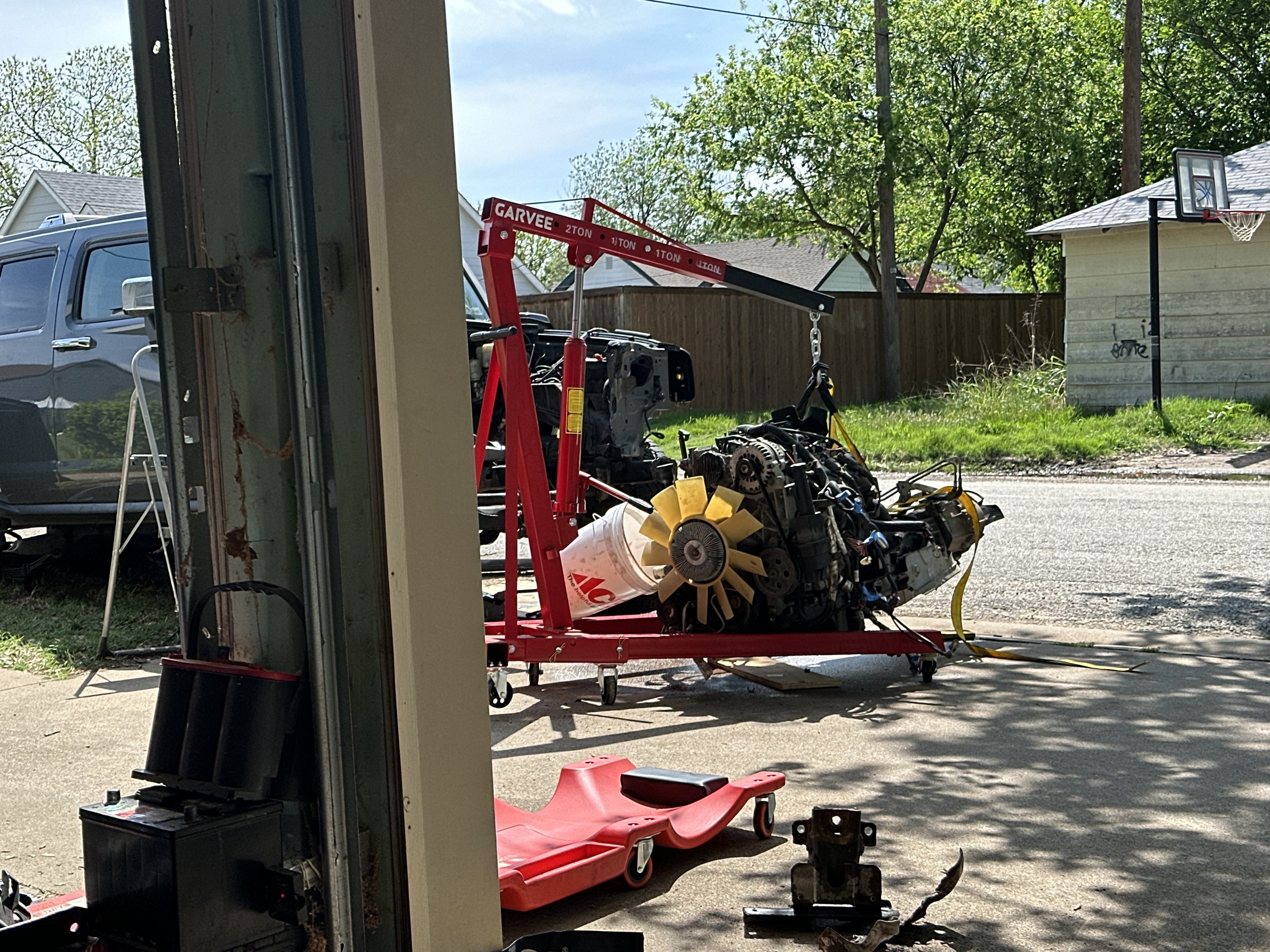

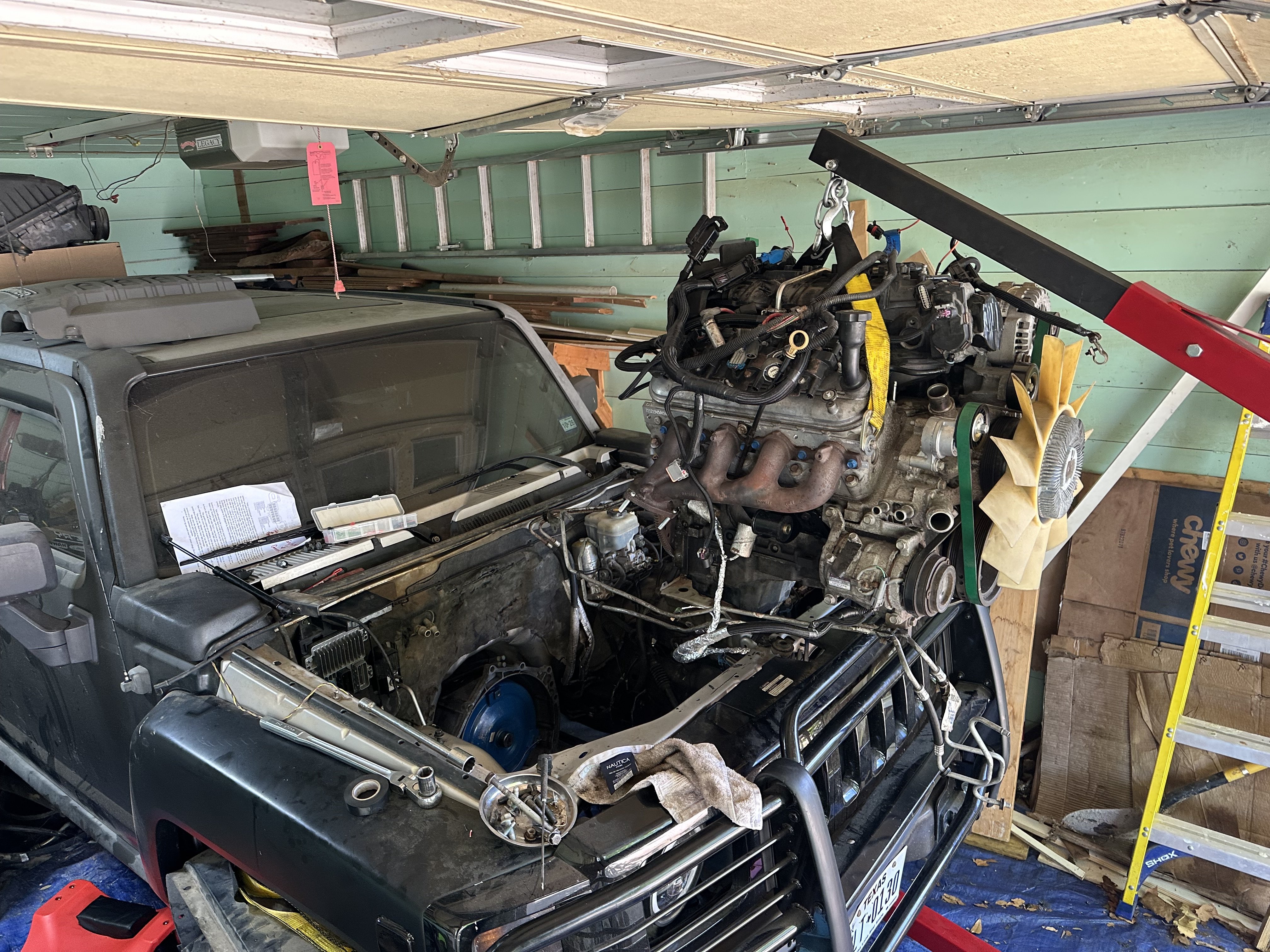

Now we’re cookin with butter!

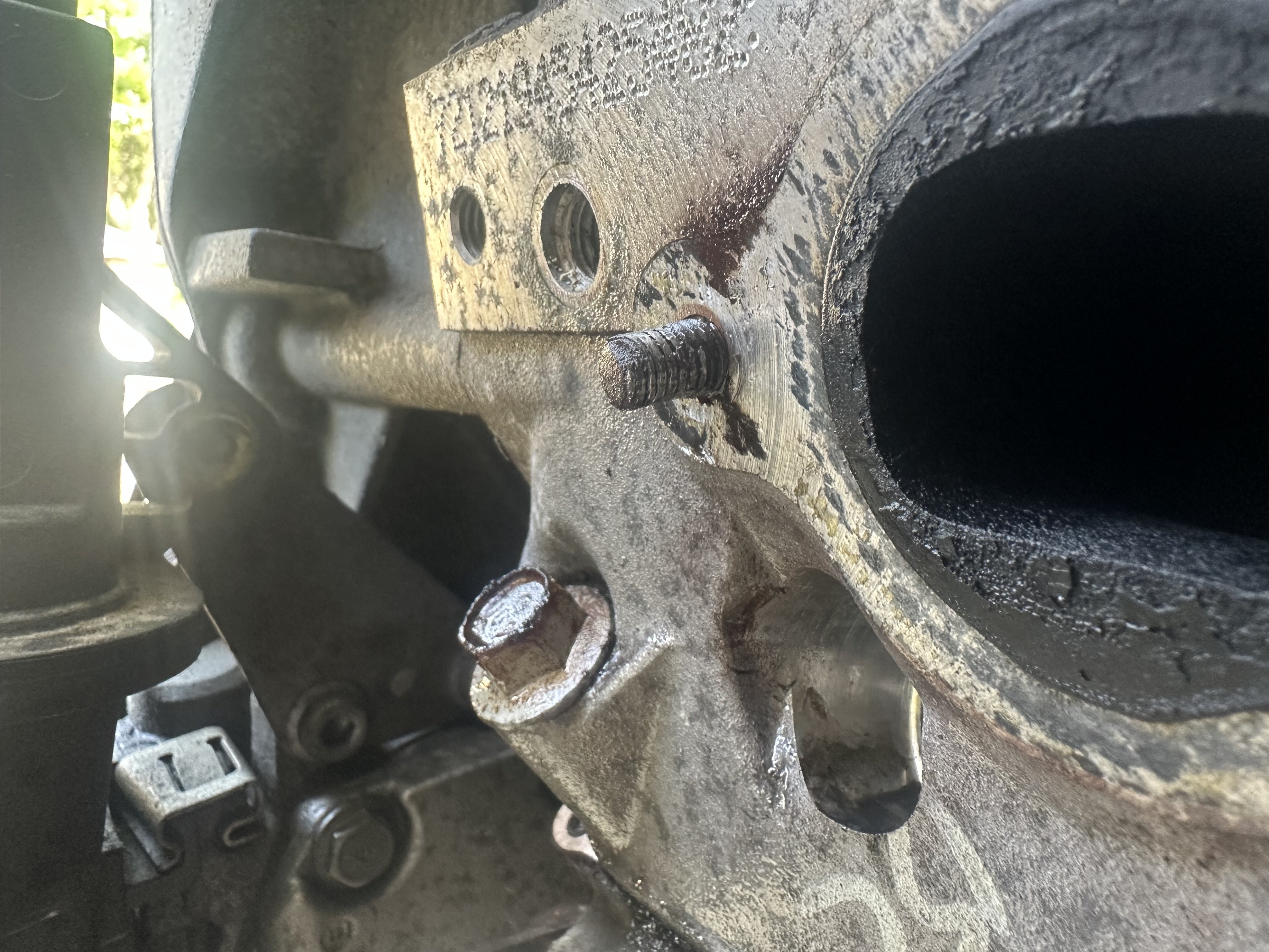

Went 4 for 6 on breaking off the exhaust bolts. Didn’t matter if I used heat, penetrating oil, or impacts, nothing was going to save them. Even tried the crayon trick on a last chance whim with zero success.
But!!!!! The motor is out!

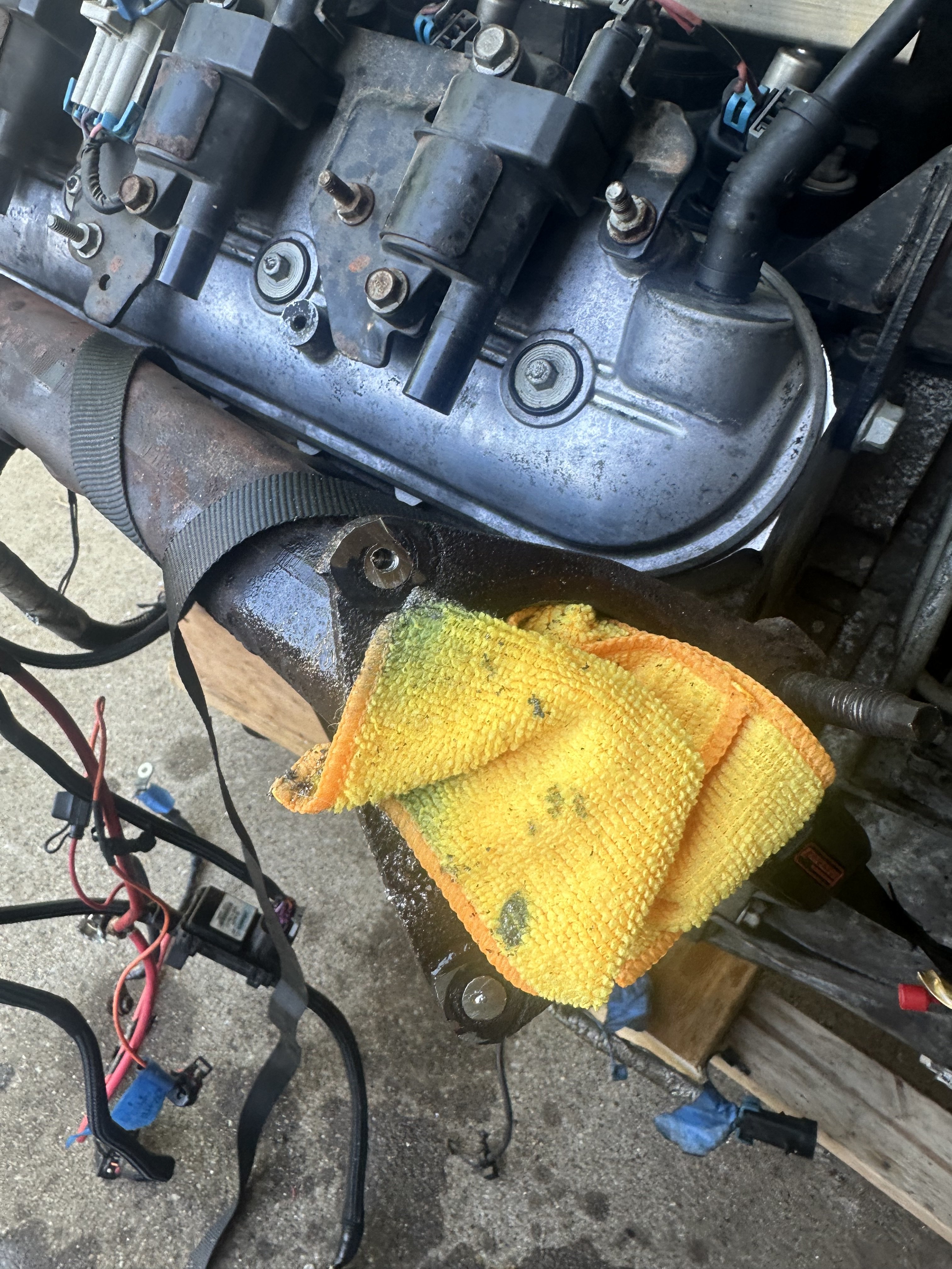

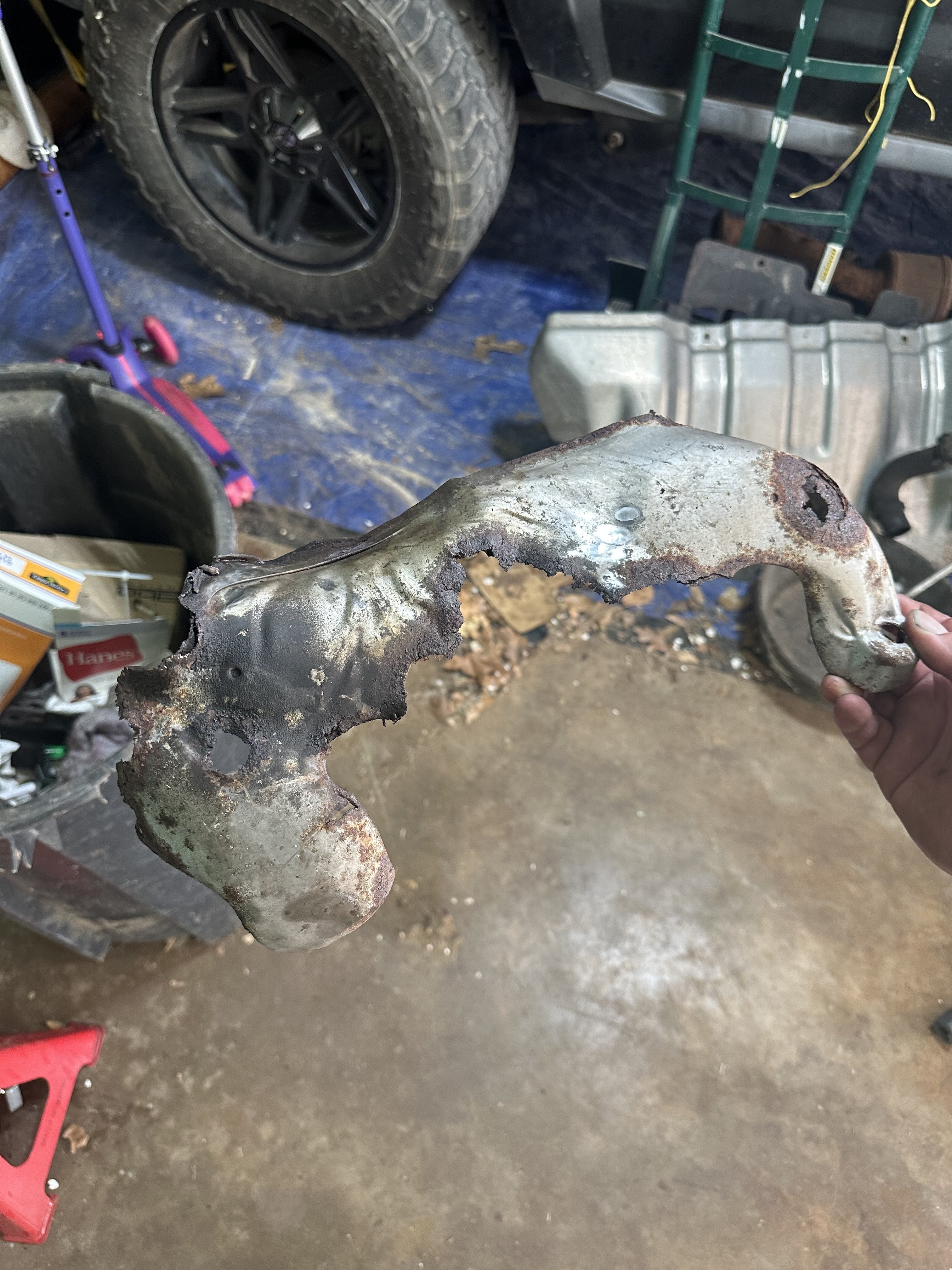

Figured out where the oil leak has been coming from, looks like the cooler bypass block off plate has had a consistent little drip coming from it which has coated the underside of the powertrain. Sorry for the blurry pic, this was roughly 5 minutes after I sprayed the area down with brake cleaner, you can see a little trail on the oil filter - I was originally thinking it was coming from the rear main seal but I popped open the viewing window and the back of the block is nice and clean.
Lastly, what are people using for exhaust heat shields on the manifolds? Pretty sure it’s not supposed to look like this…..this was the one that actually had some of it left. The driver side was missing roughly 70% of the shield
All buttoned up for the evening ready for the wiring to be started on tomorrow, as well as a deeper cleaning of the assembly with my low budget power washer from a few years back. I’ll end up building some kind of base out of 2x6’s to better support the motor and trans while I’m working on the wiring.

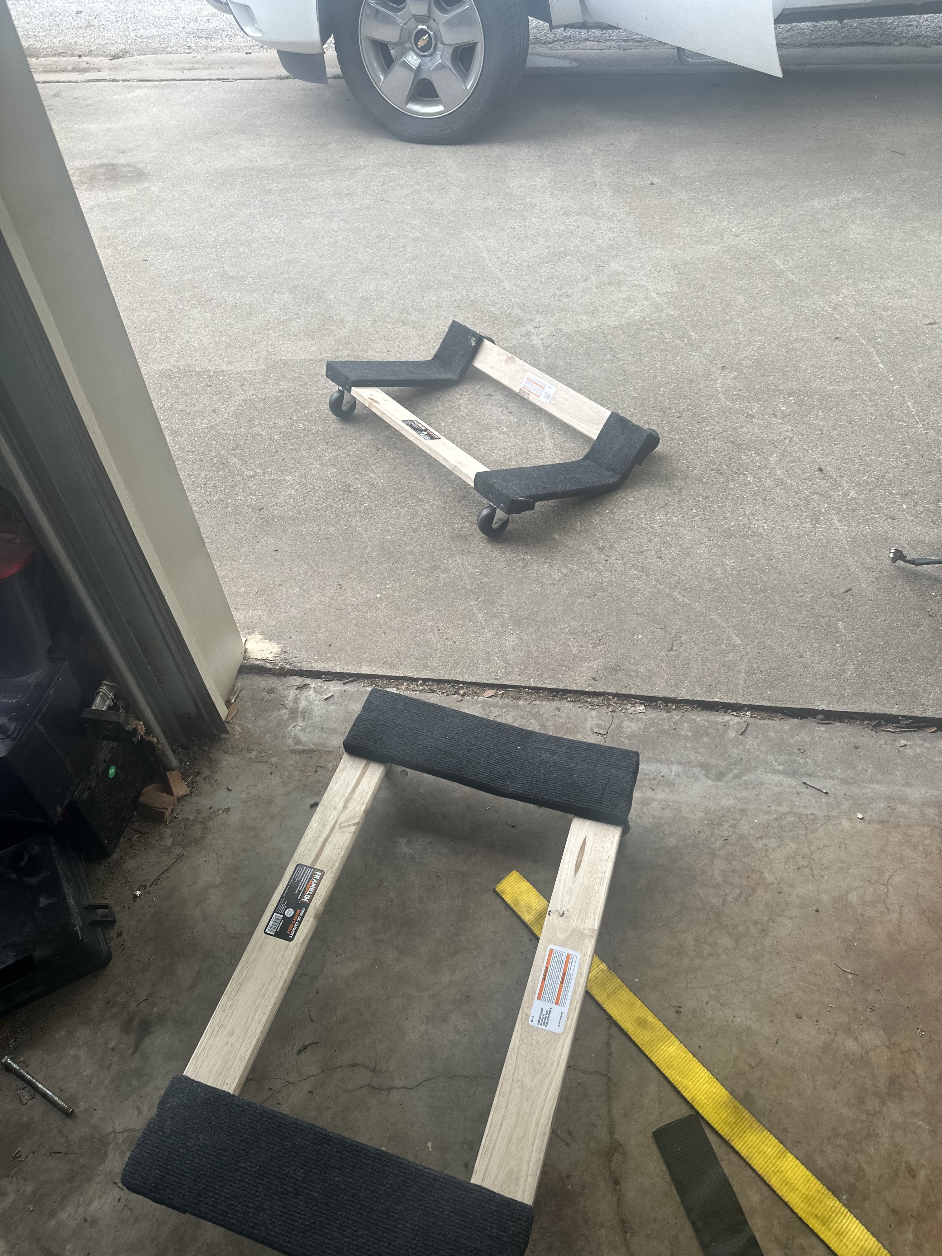

Went by harbor freight this morning and bought a couple “1000 lbs” roller dollys. 5 seconds after lowering the engine on them (not even full weight of the motor) they both broke…decided to use the wheels and made some dollys out of a spare 2x6 I had laying around which worked perfect.

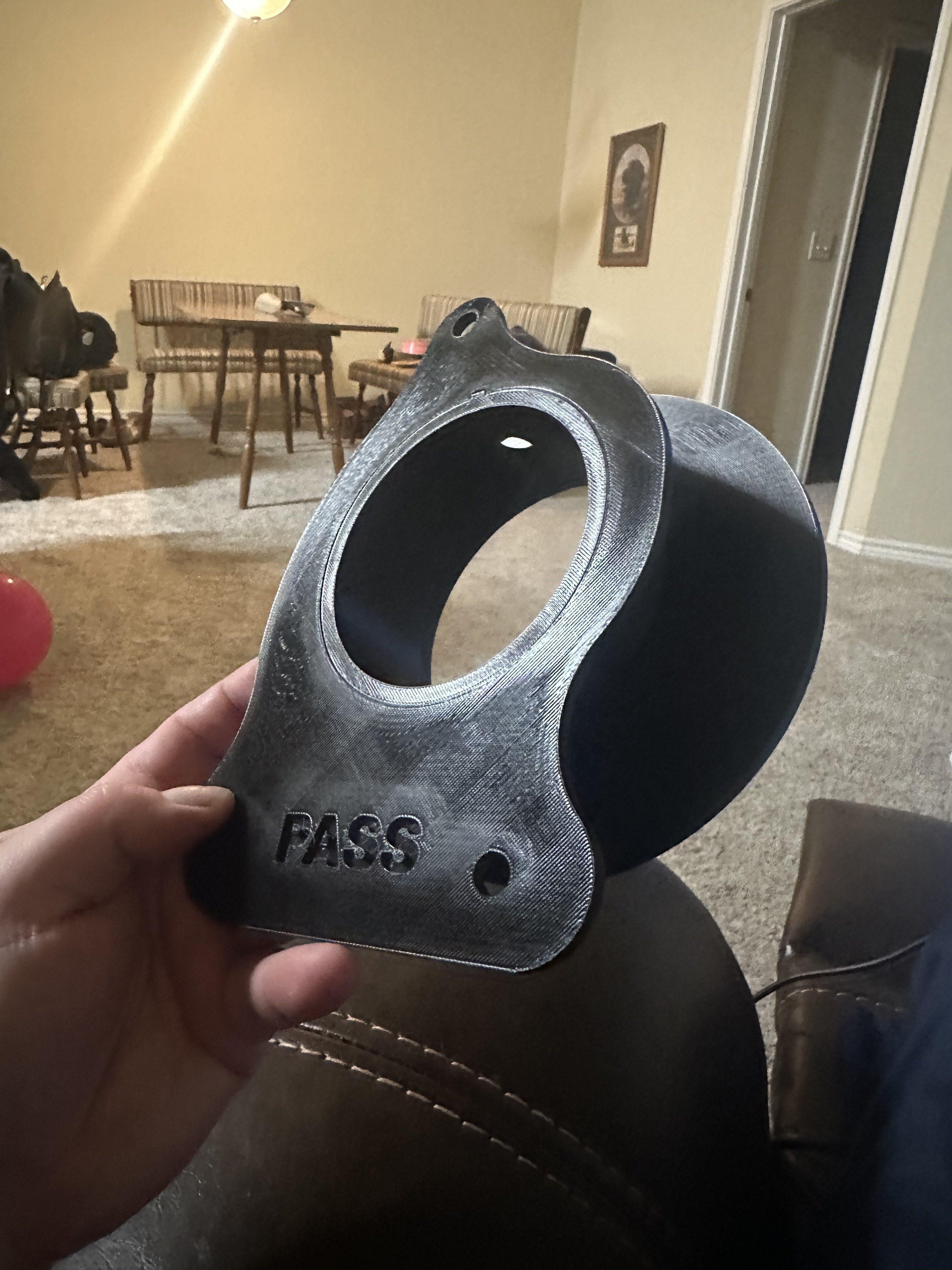

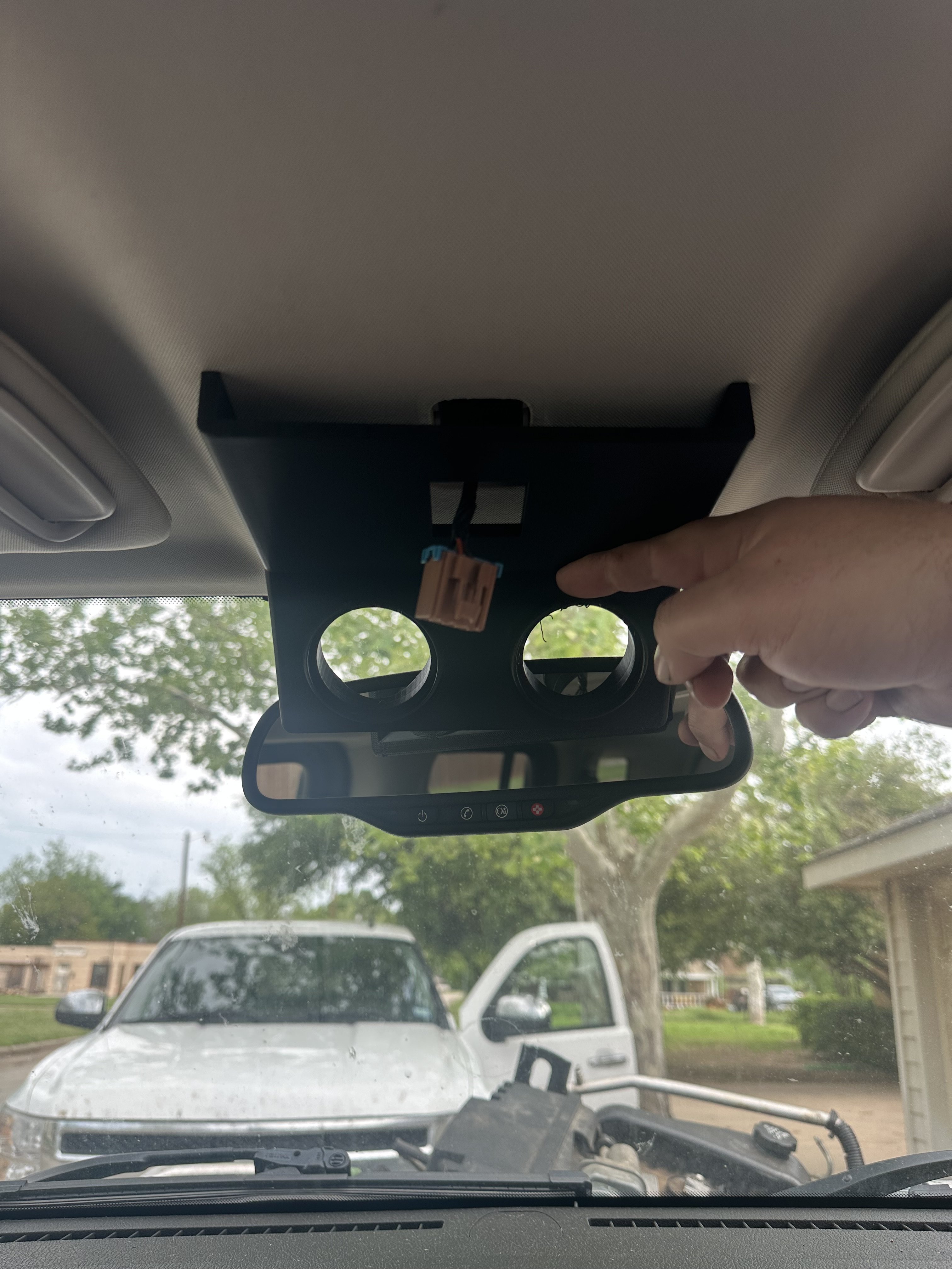

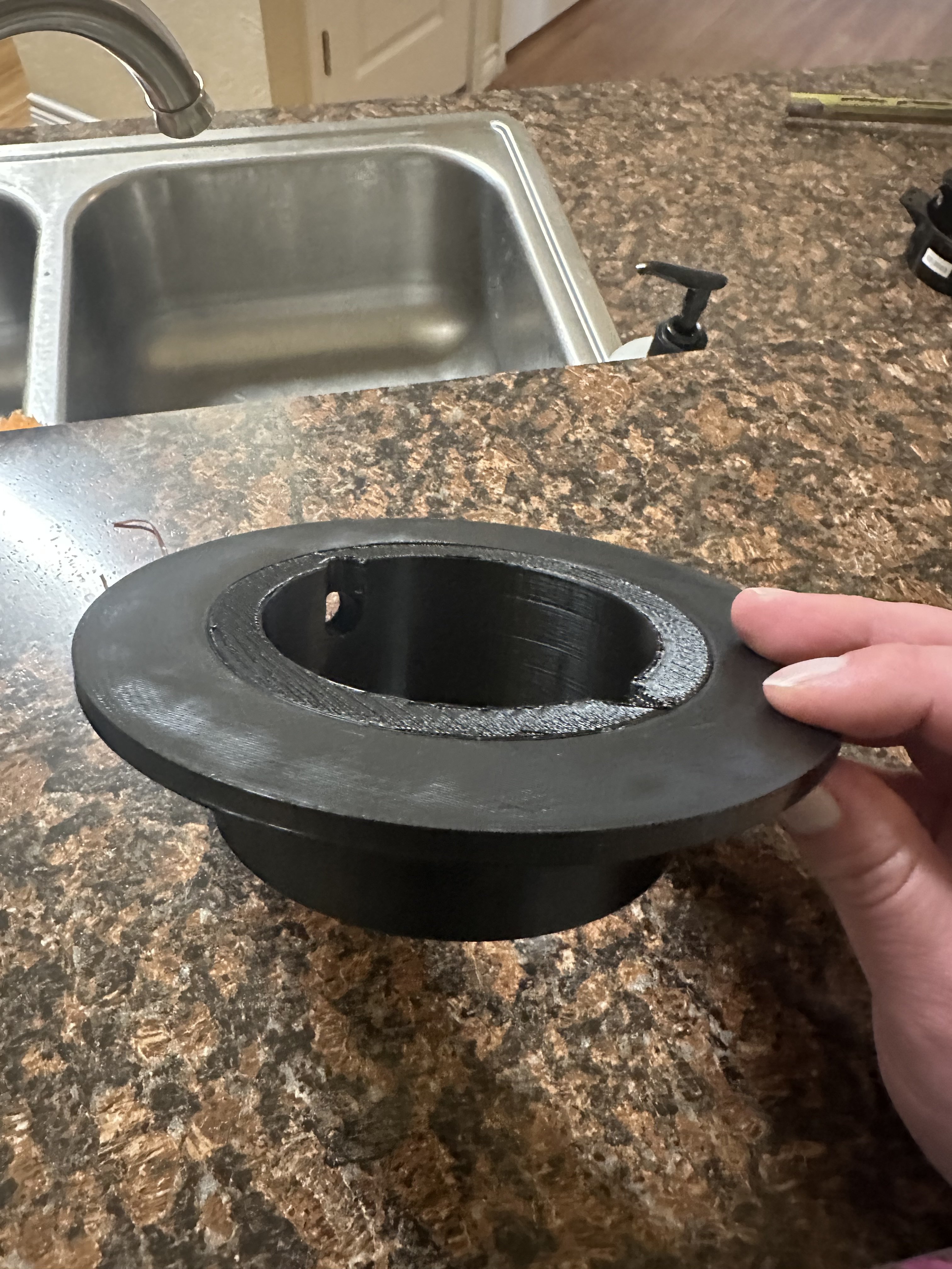

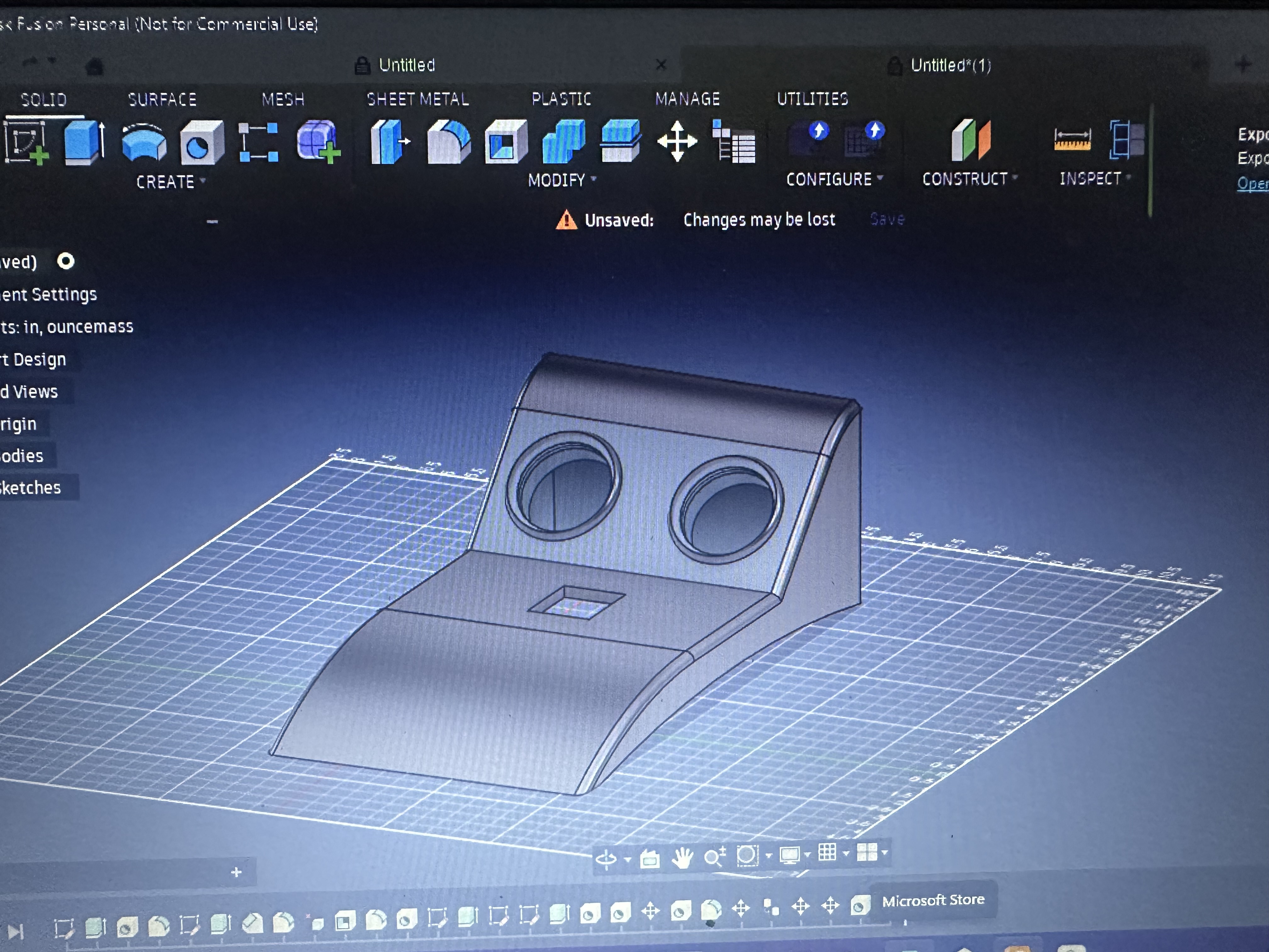

Once I shut everything down for the evening I decided to do some tinkering on the computer. I’ve been working off and on on the pillar gauge pod idea but while I was looking over the interior of the alpha today I realized it would be much better if there was an overhead console to not only provide front lighting but also house things like the sunroof switch or aux switches for light bars and what not, still baffles me there’s no front lighting on these things.

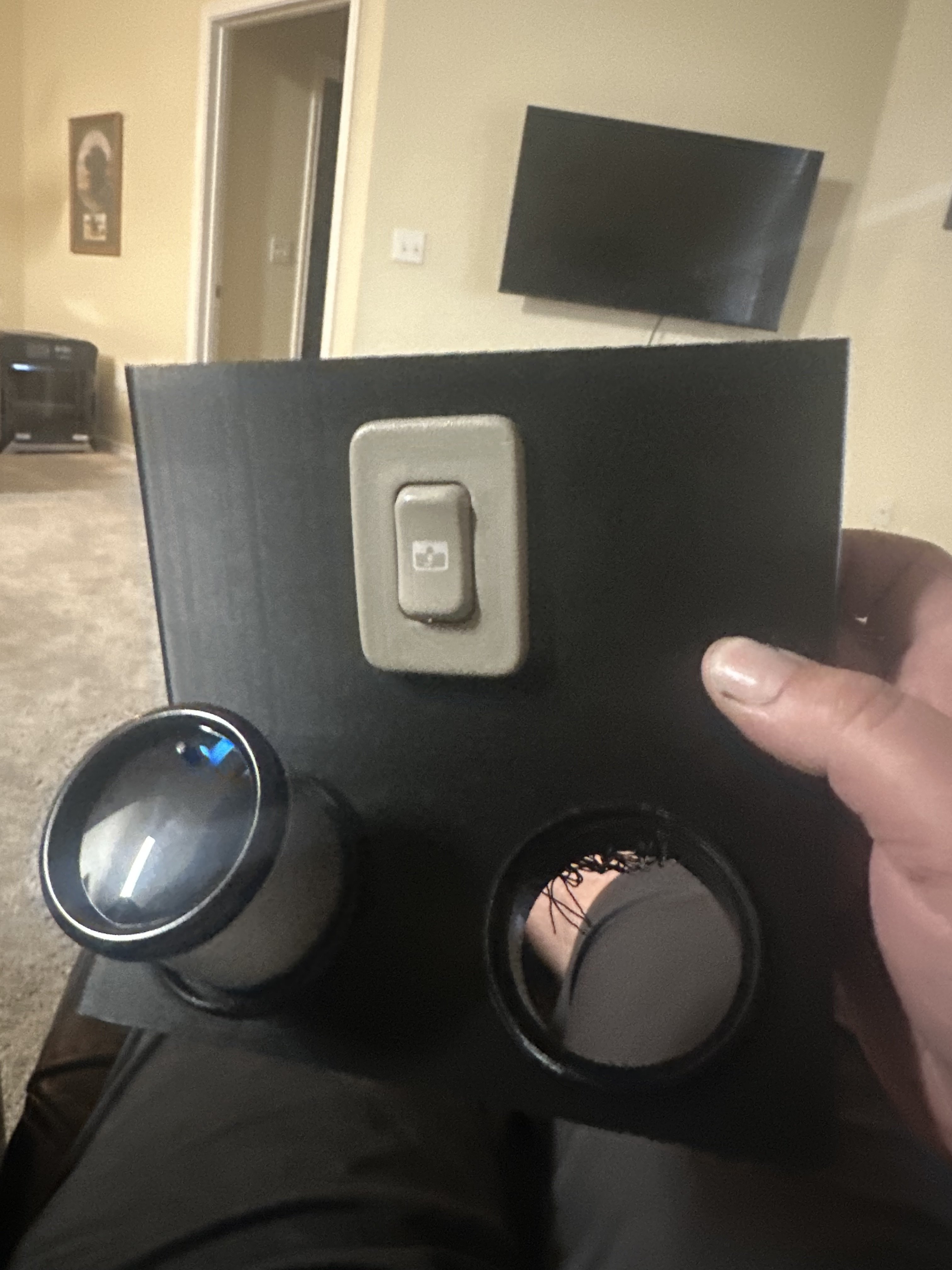

So I threw together a quick idea using some measurements I took off the alpha earlier and came up with this concept.
Obviously there is still some work to be done with it but it could possibly solve my gauge pod issue as well so I threw in a couple spots for pods although I’m not entirely sure they’ll work in that location but for a first draft it’s not awful. While I was looking around the alpha I found there is a brace just in front of the sunroof switch which wouldn’t be terribly difficult to build a bracket to support the overhead console in the front (by the windshield).

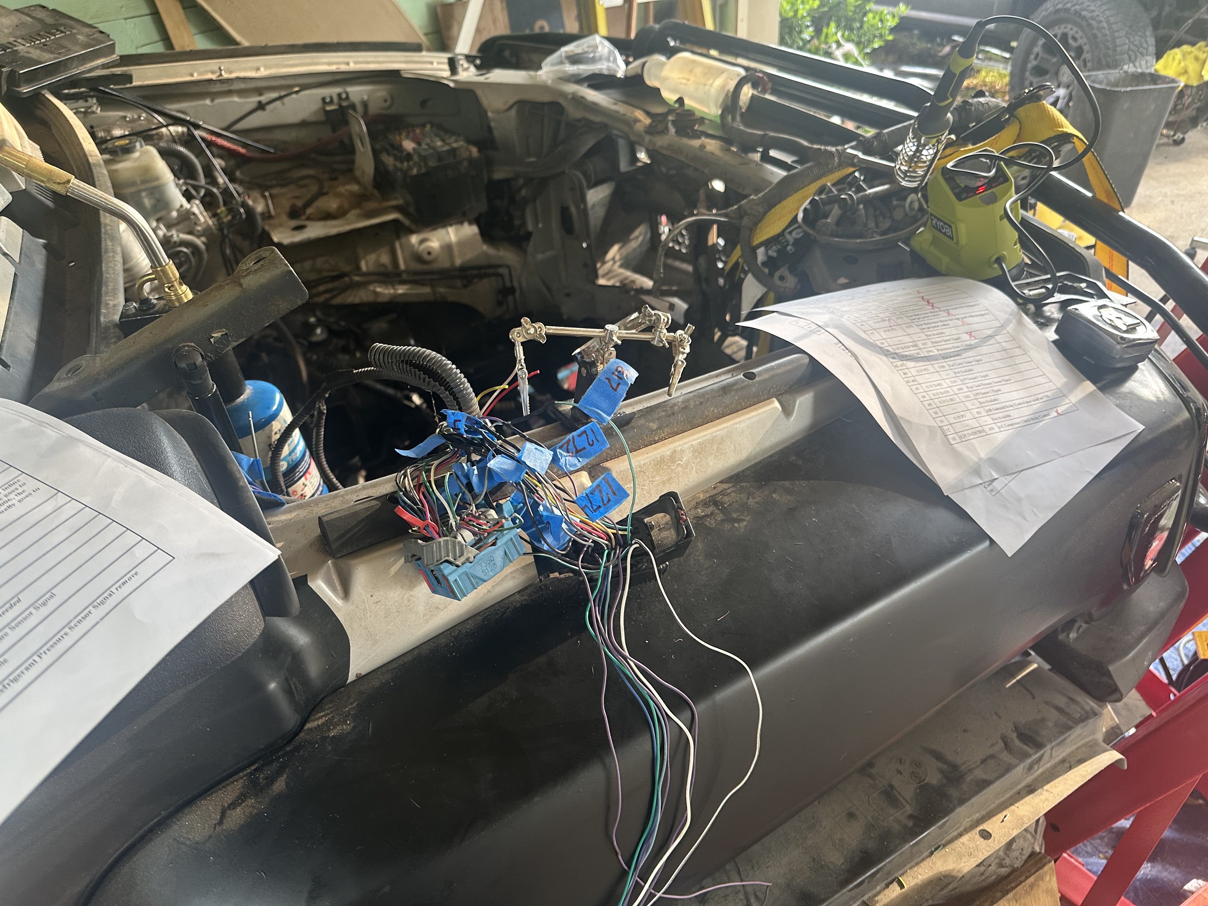

Spent a few hours working on the wiring today. Got through about 90% of the BCM plug before my soldering gun battery died. I think I have 3 or 4 more wires to work before it will be ready to be buttoned up. Jamie’s wiring diagrams come in clutch when going through this. Nice and simple.

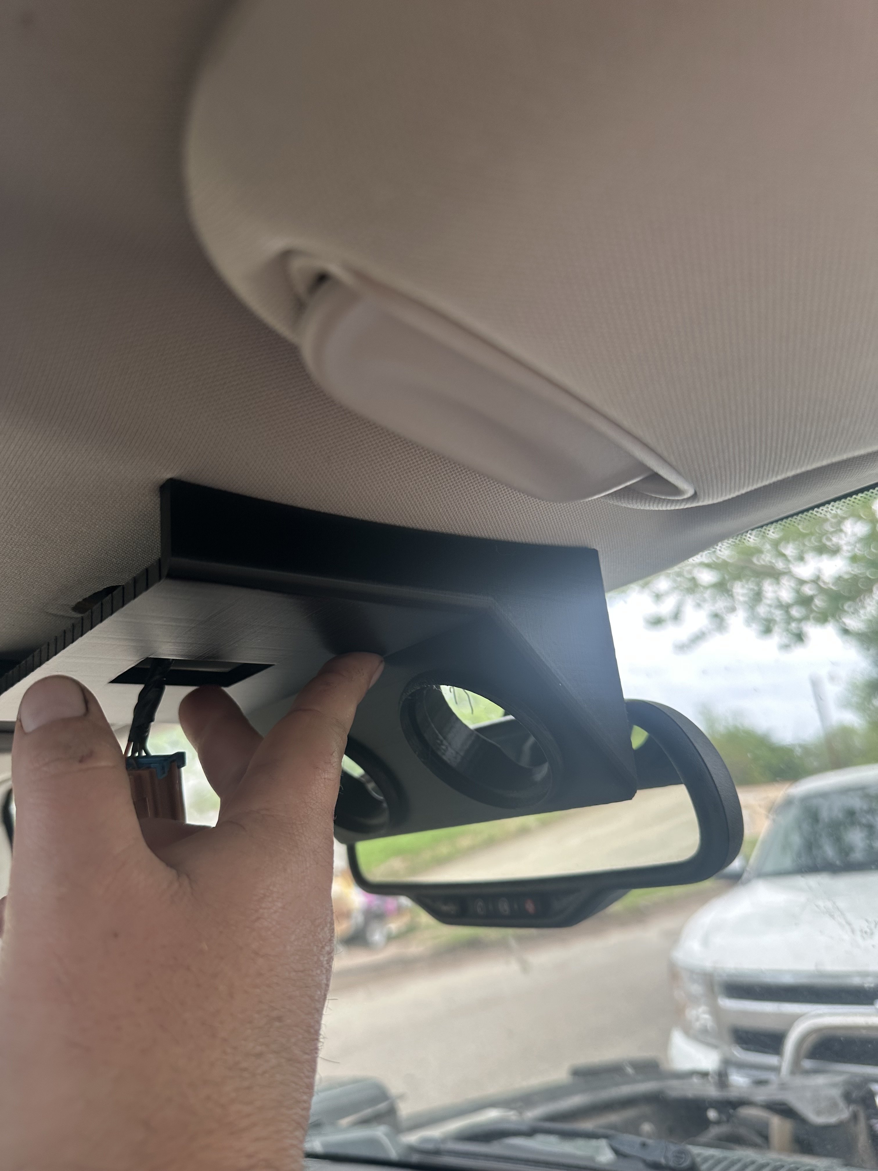

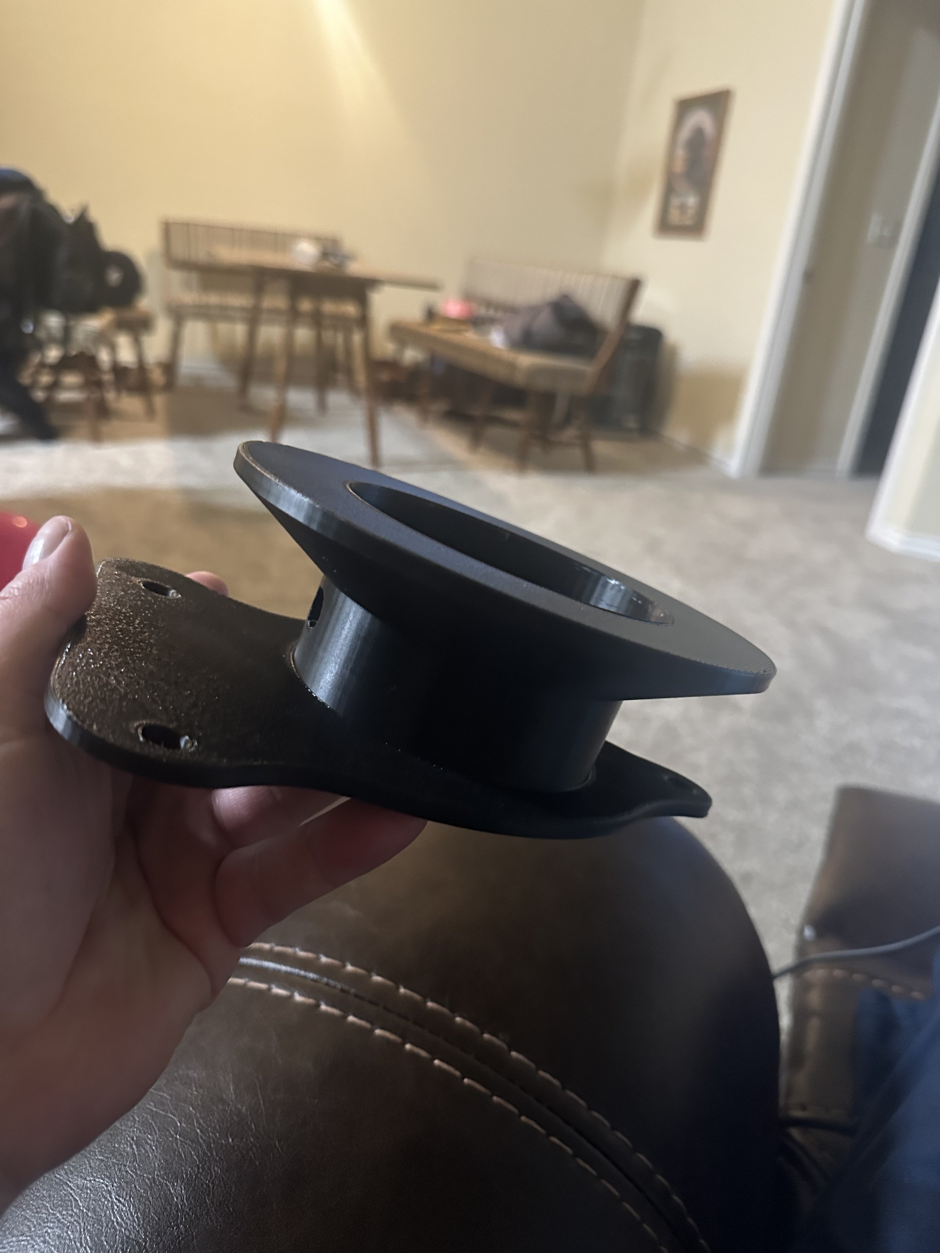

Did a quick test print this morning of the overhead console idea and we will just say more adjustment is needed. The switch fits correctly but my gauge poor needs a little more space to slide in.
More importantly though, the gauge pods won’t clear the rear view mirror.
The gauge pod portion comes down probably another inch beyond where it shows now so back to the drawing board we go. I may look into some type of recessed option since there’s roughly 3” above the headliner before it touches the roof. Even if the pods don’t work out I’ll still end up making a console to work up there. I can’t stand not having lights for the front seat area and I plan to run a couple light bars on the front end eventually so a switch up there would be convenient as well.

What about designing it to sit on the dash where the Daystar tray normally sits? It's kind of useless anyways with the small dividers in it.
I don’t know if I’ve seen the daystar tray, but honestly I’m not a huge fan of stuff on my dash. Just seems cluttered to me, the pillar is manageable for my OCD but the fact it doesn’t match the passenger side irks me a bit already lol my mind is a wonderful place to live sometimes.

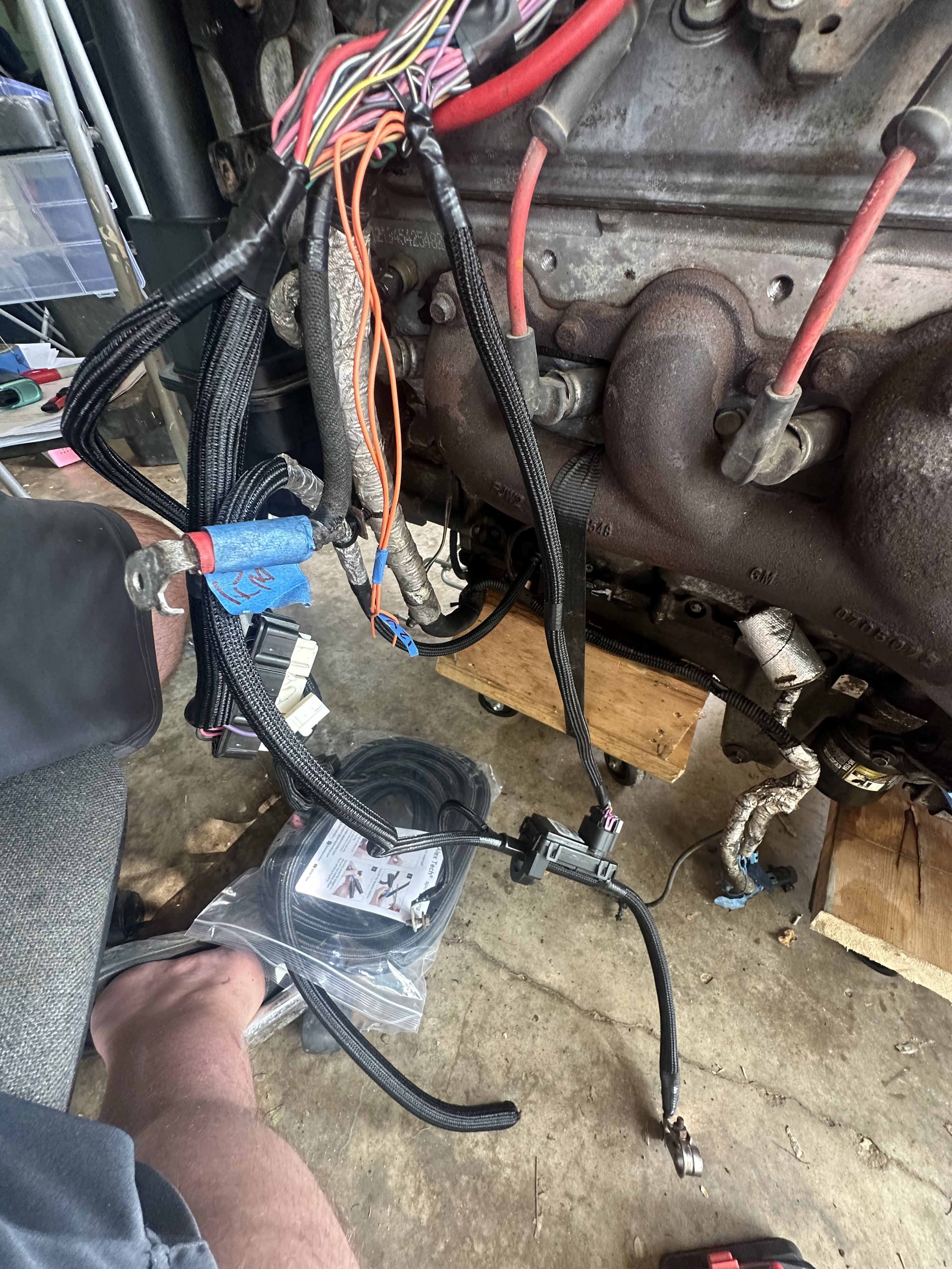

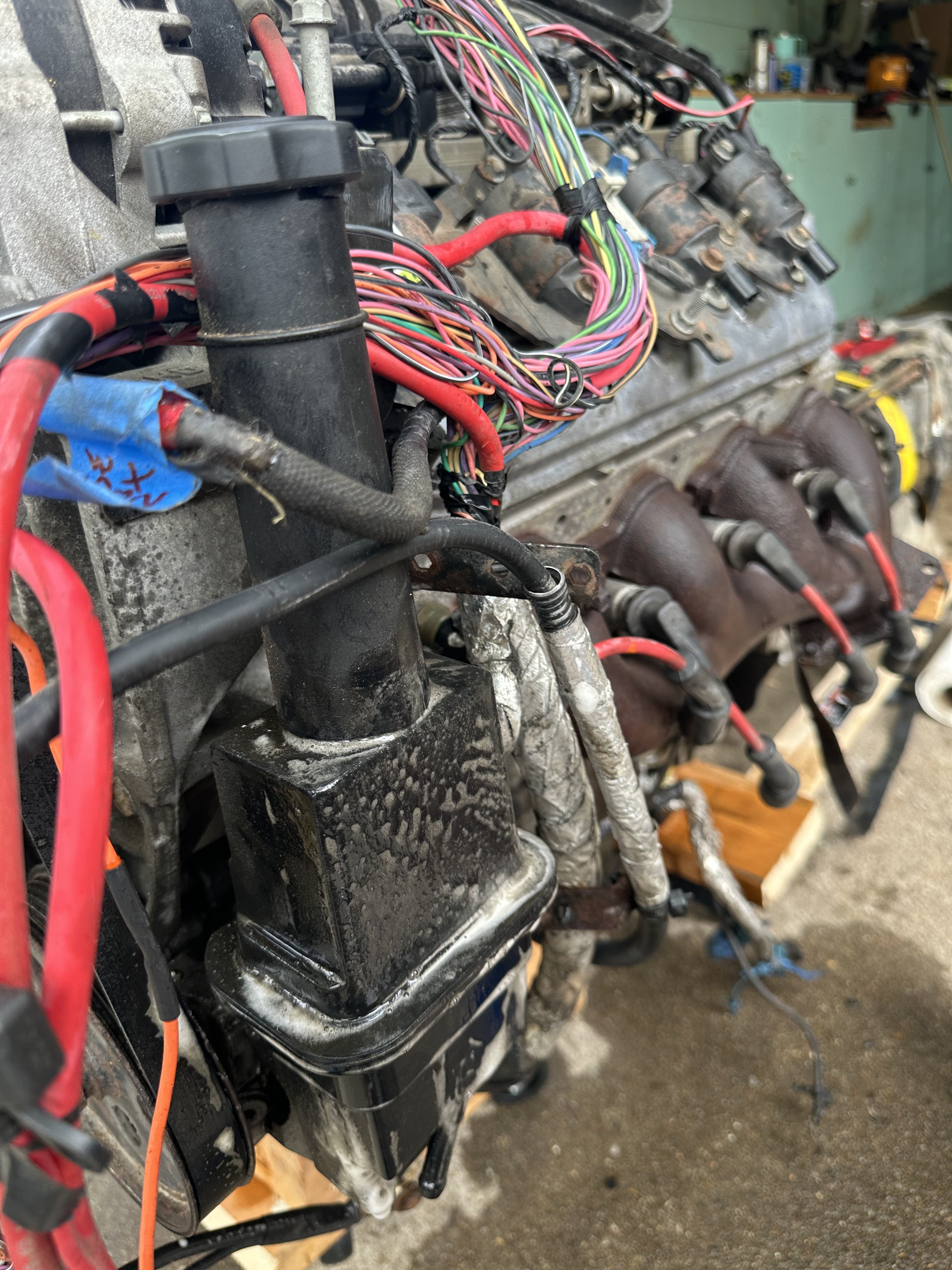

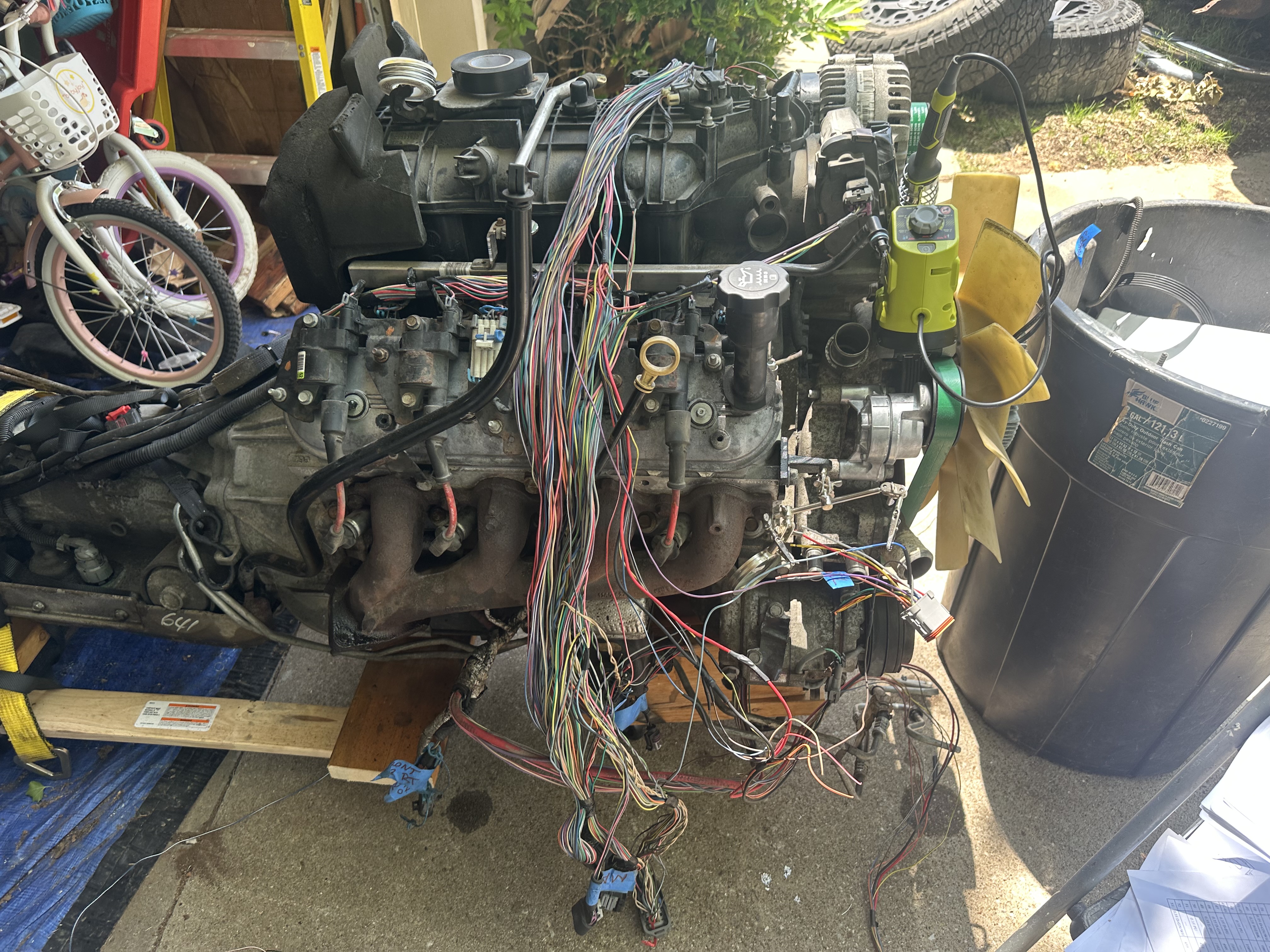

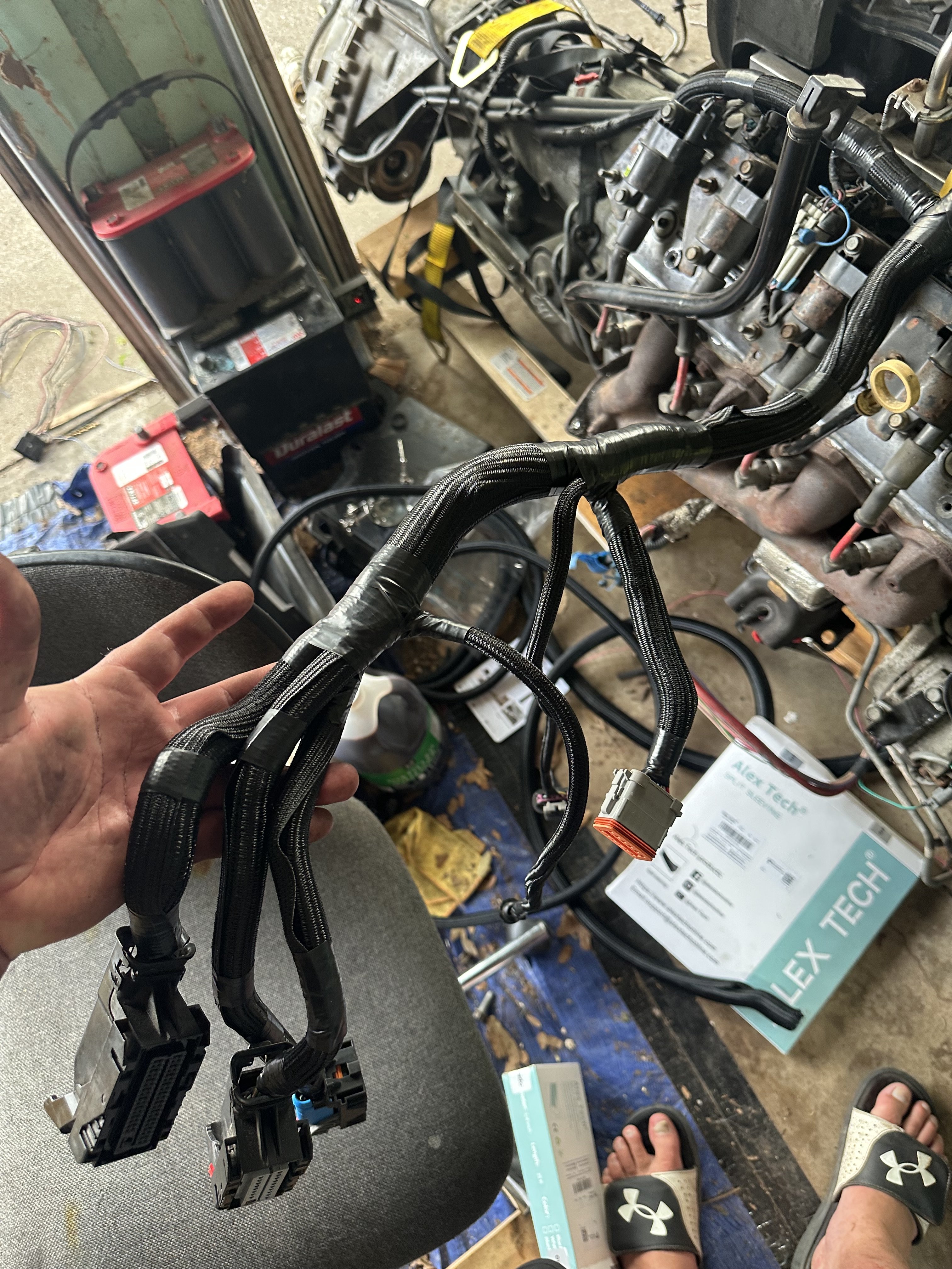

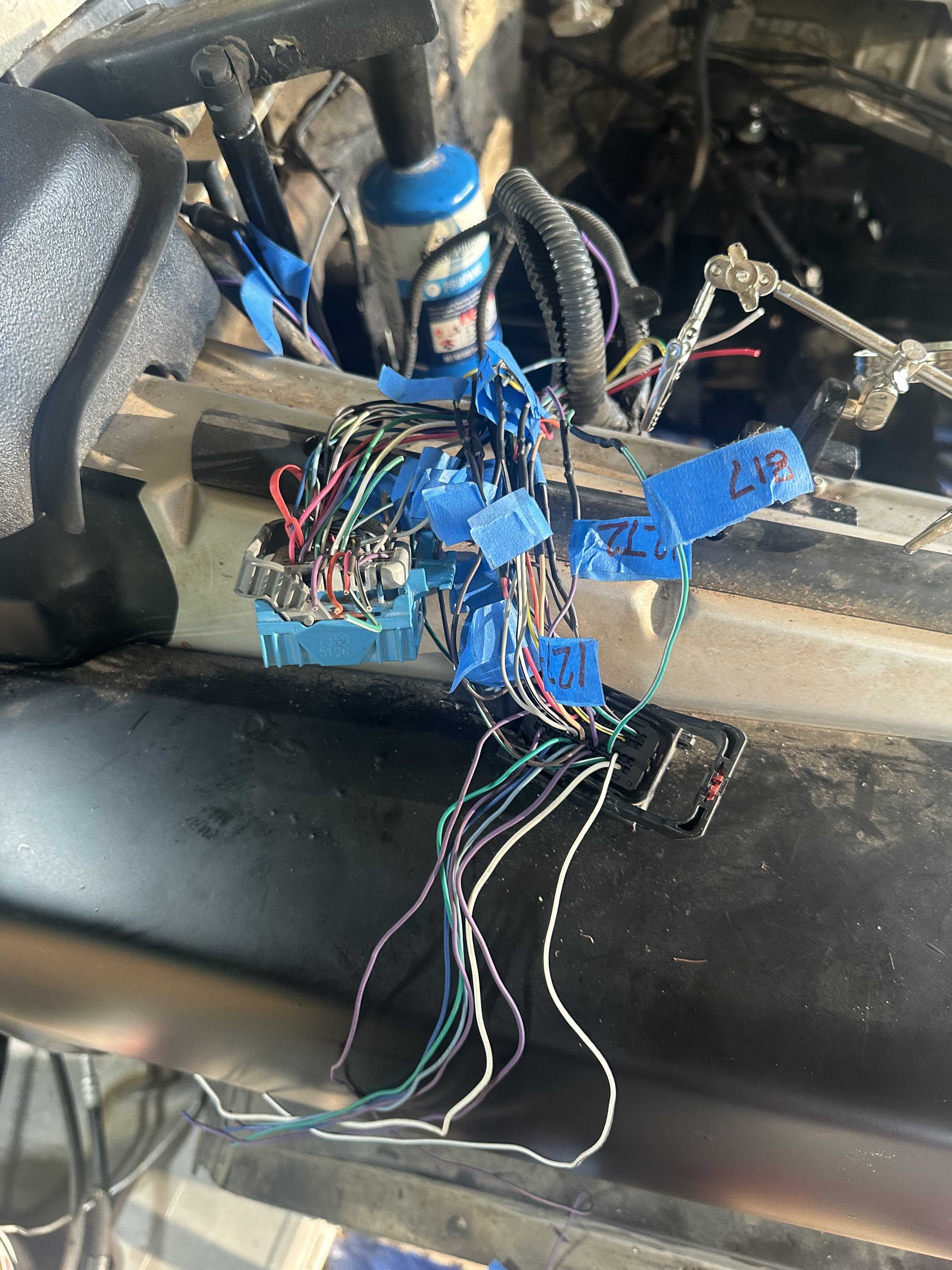

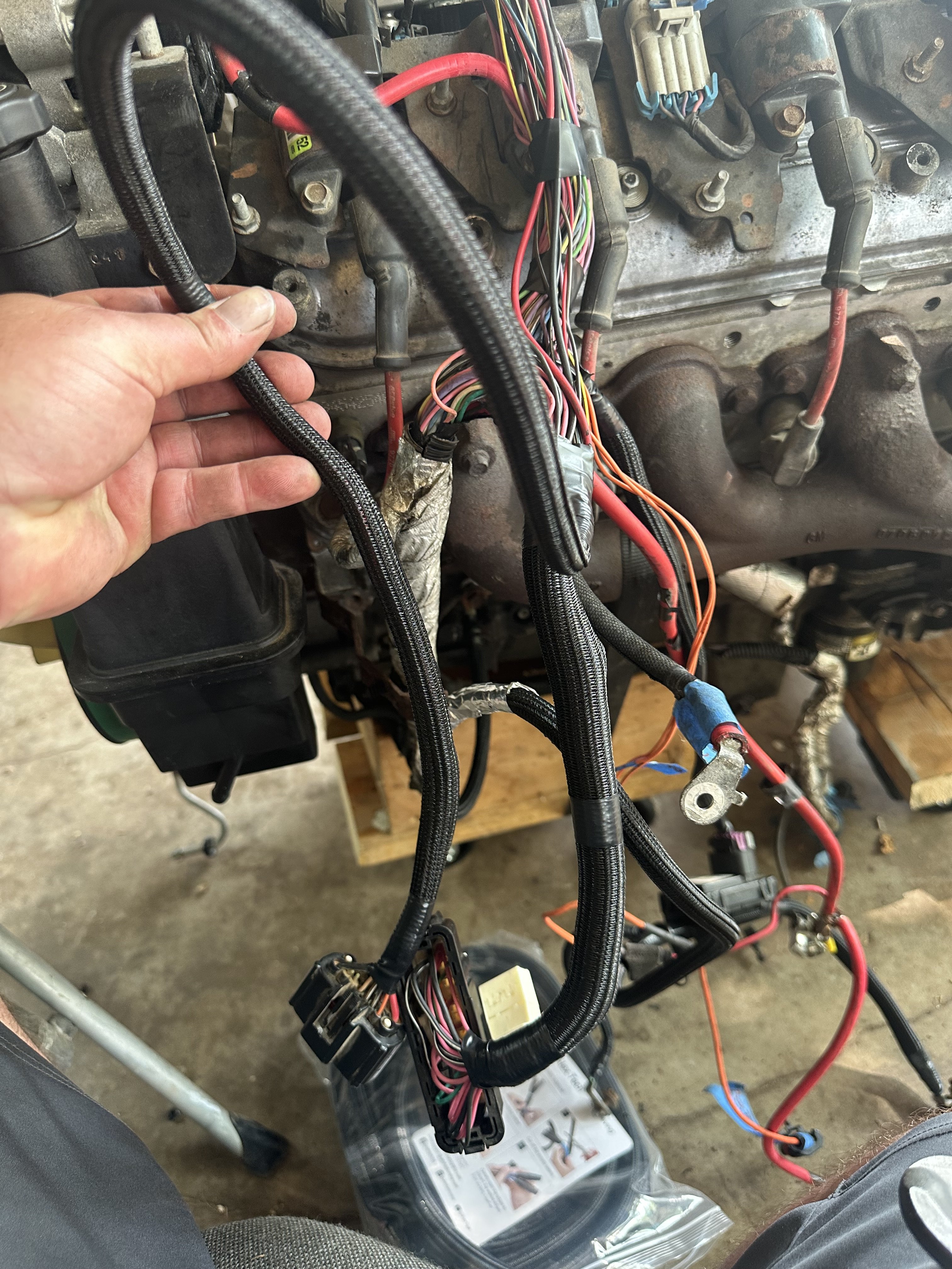

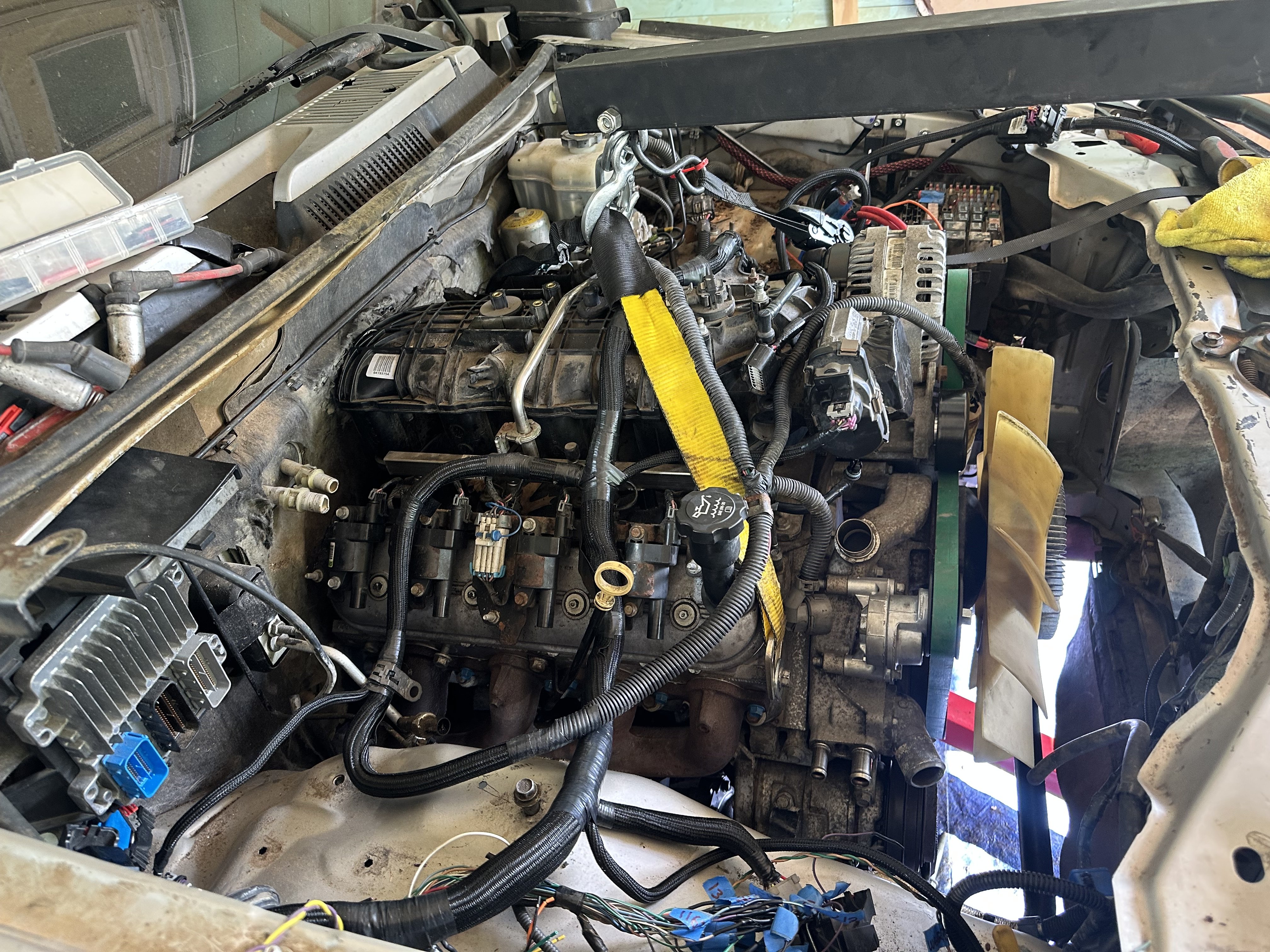

Then I moved onto the wiring (again). I got the plug from the BCM all fixed up and soldered together (I realized I only had one more wire to solder before it was finished)

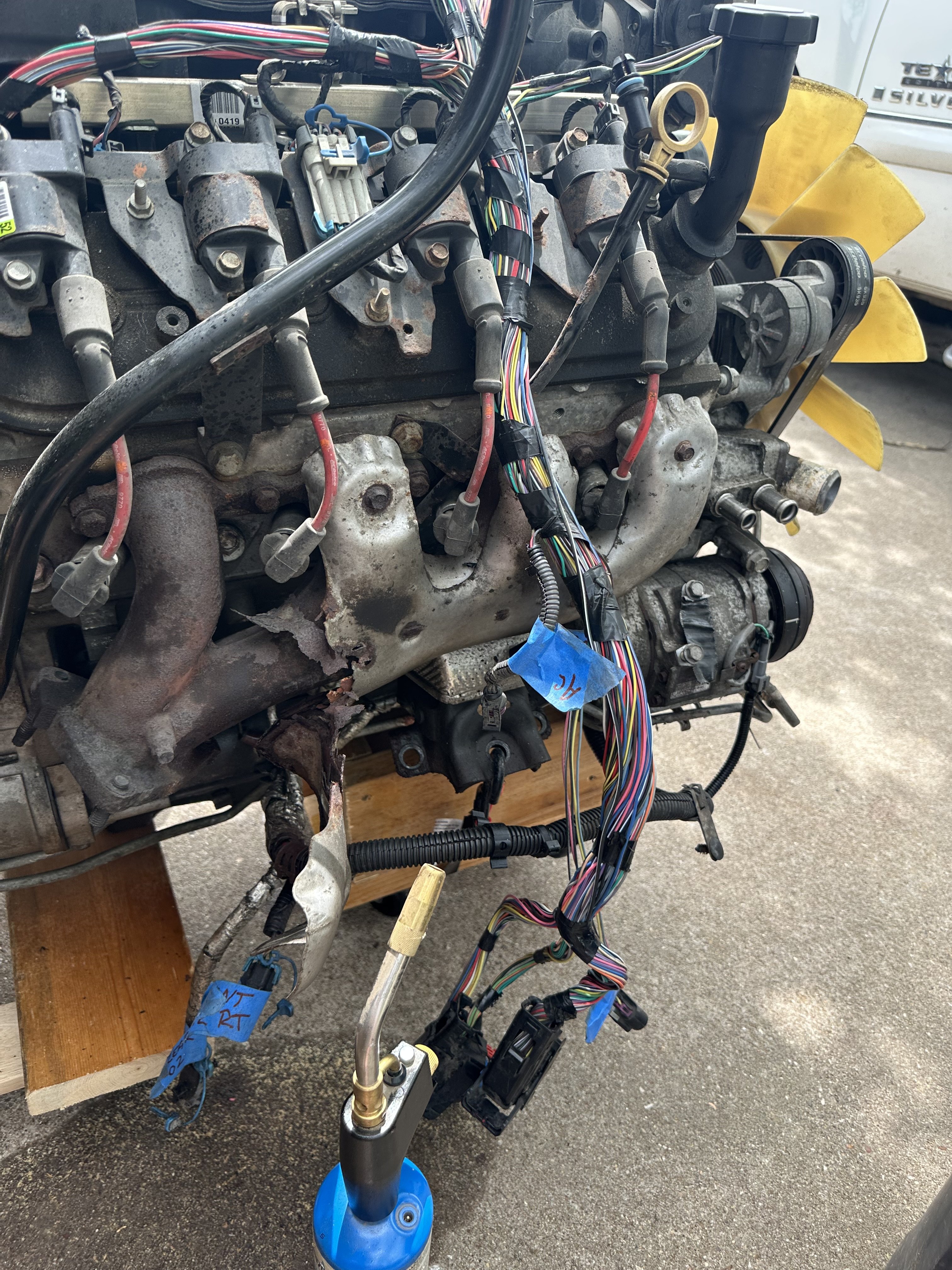

Then I moved onto to the engine wiring. Got the plugs extended, re-pinned, and removed as needed.
Since I was making such great progress I figured I’d take another shot at the exhaust bolts…..then moved back to the wiring shortly after attempting lol

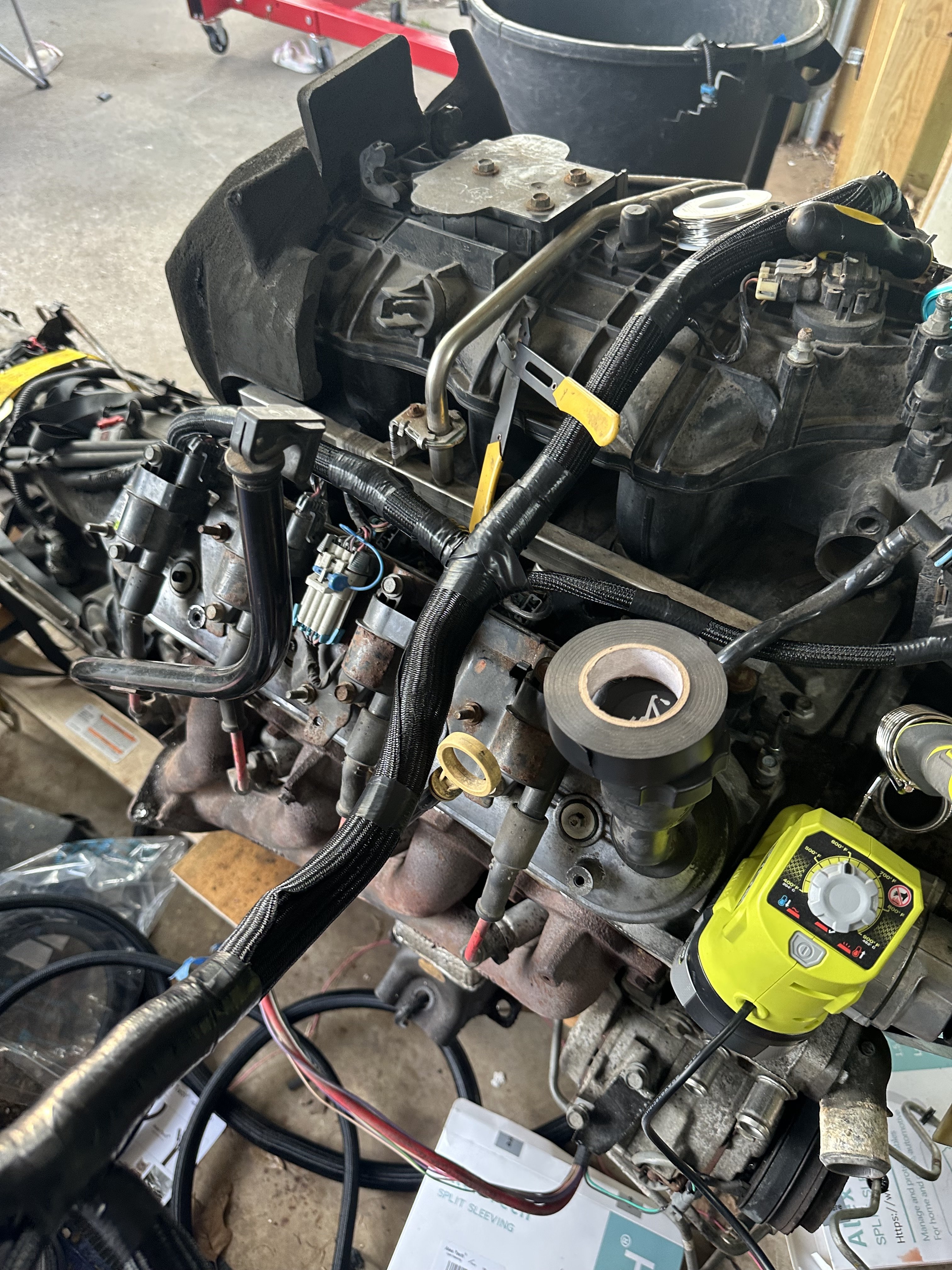

Started working on looming up the harness after checking continuity on all the modified connections.
After a few hours I got almost all of the harness loomed. Still need to do some work with the power cables but otherwise I’m happy with the result. No I did not loom everything.
Overall I’m happy with how the loom came out. Need another hour or so tomorrow to get everything finished up as far as cleaning up the wiring.

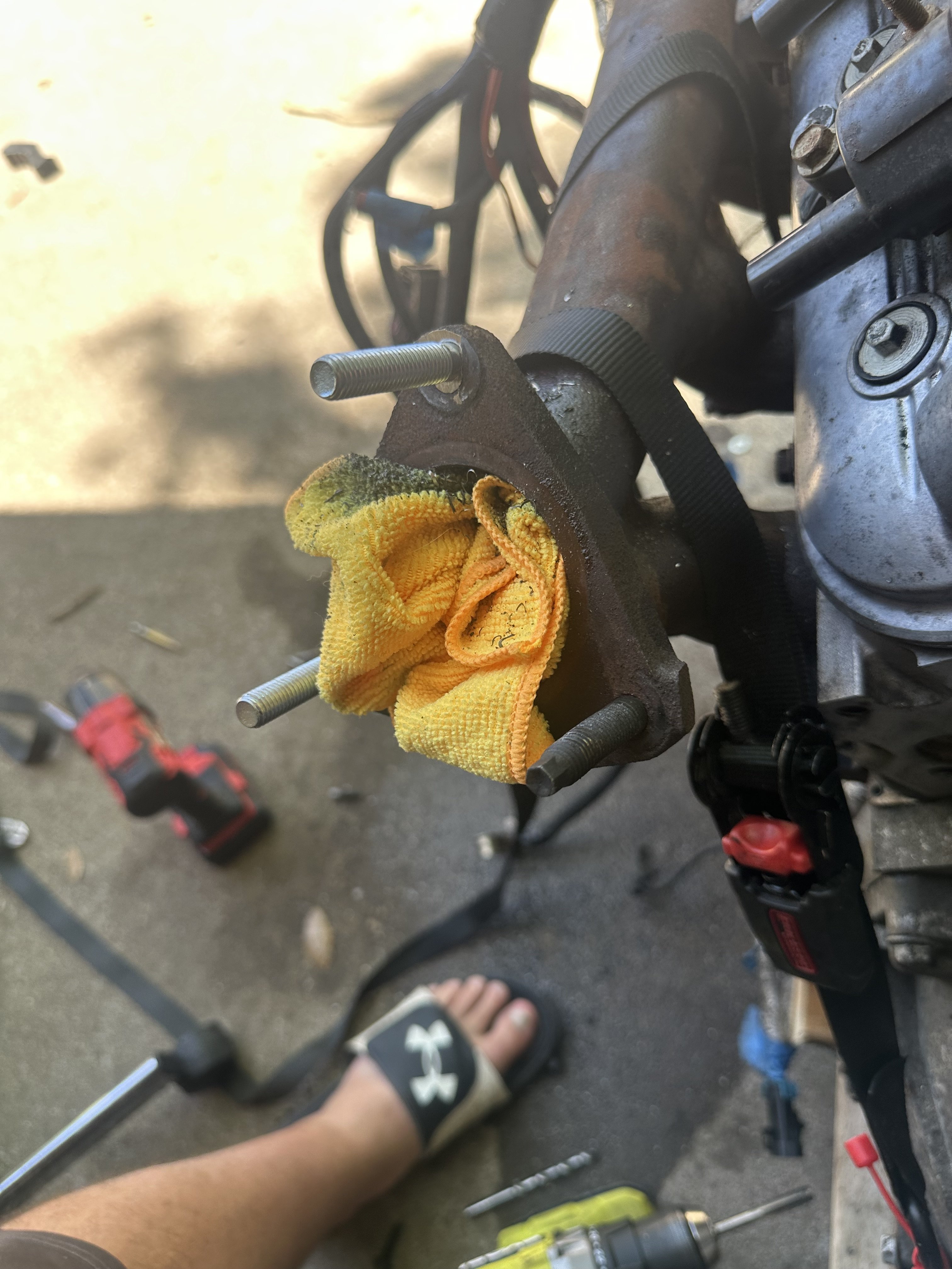

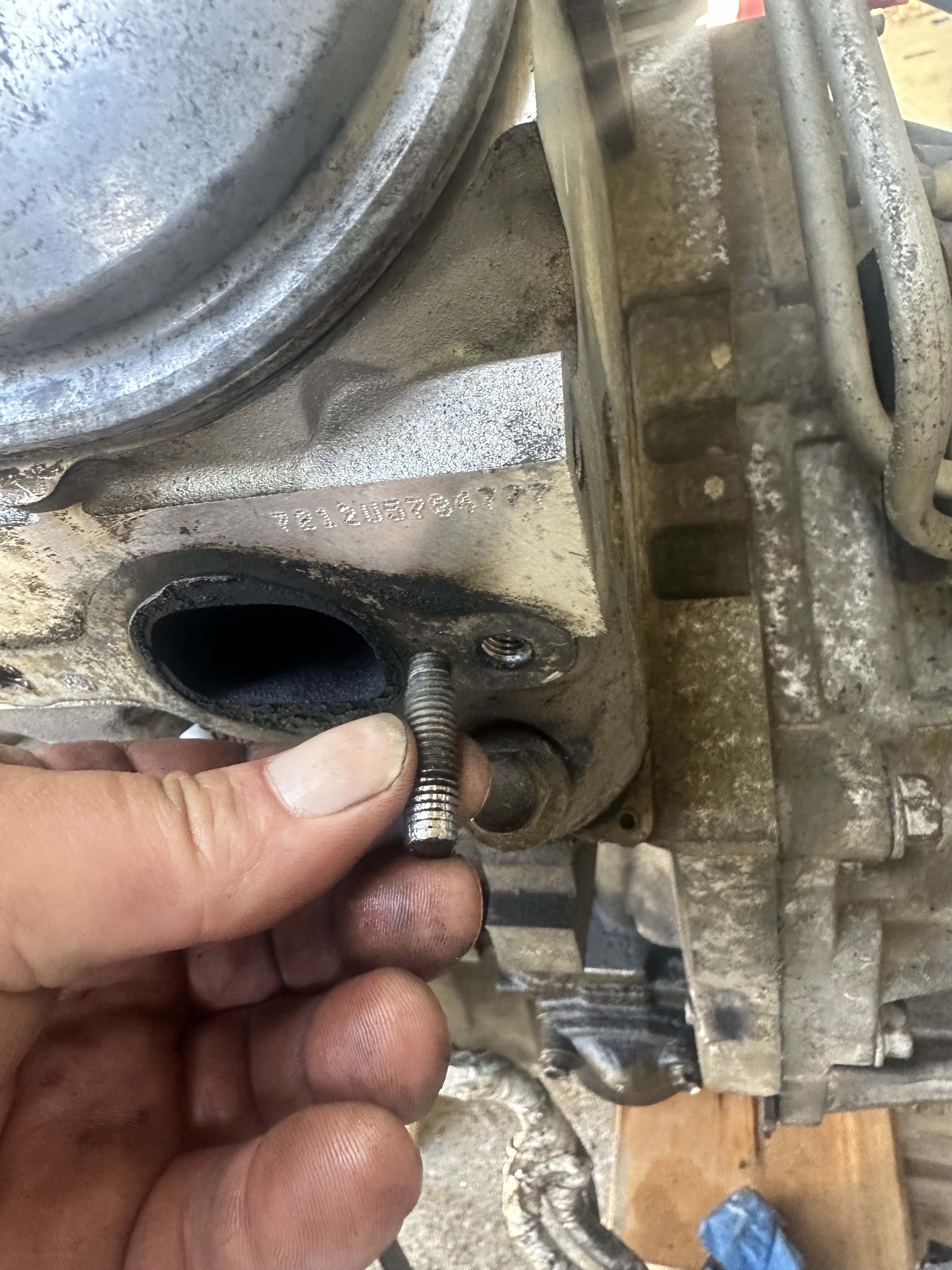

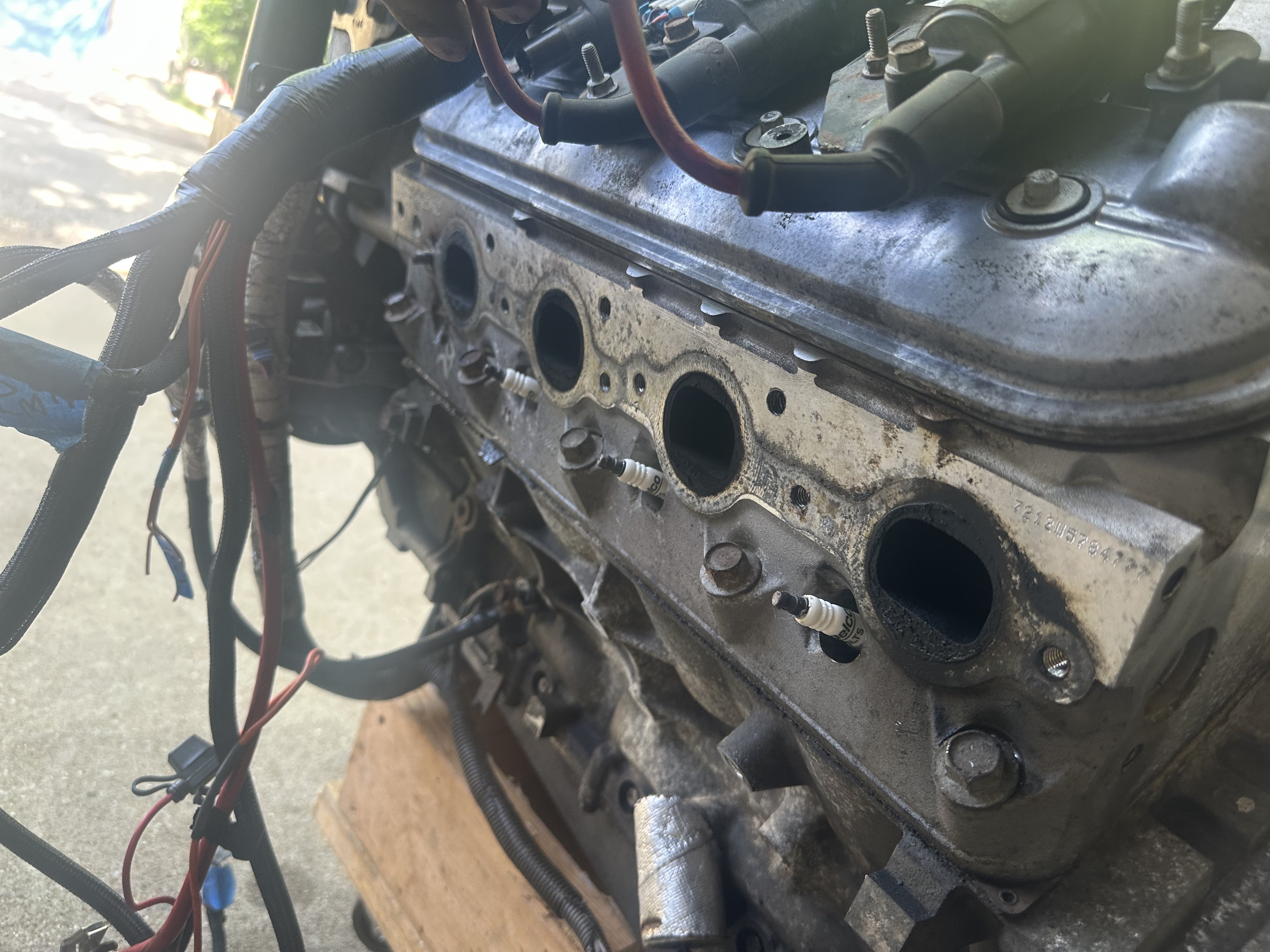

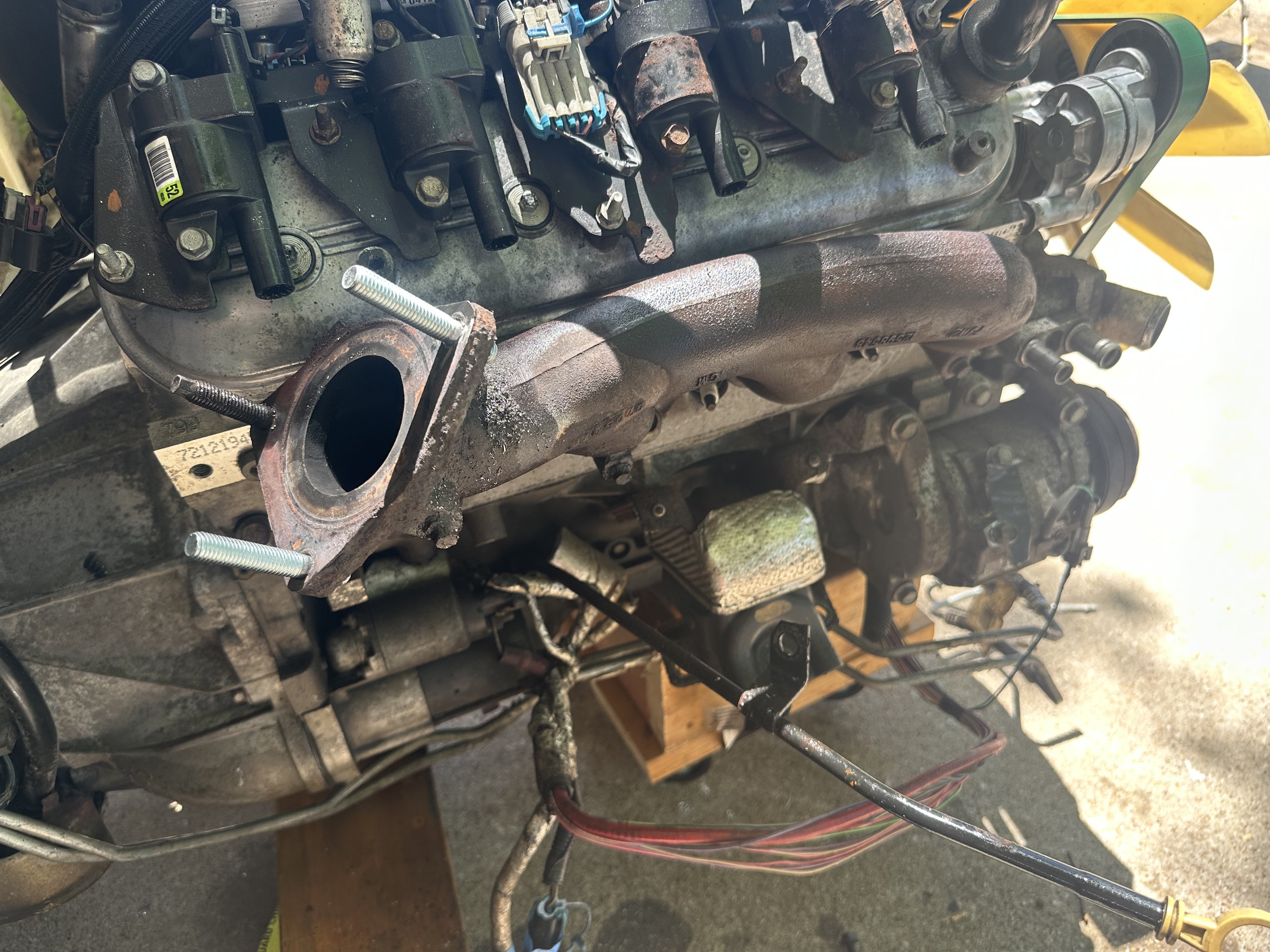

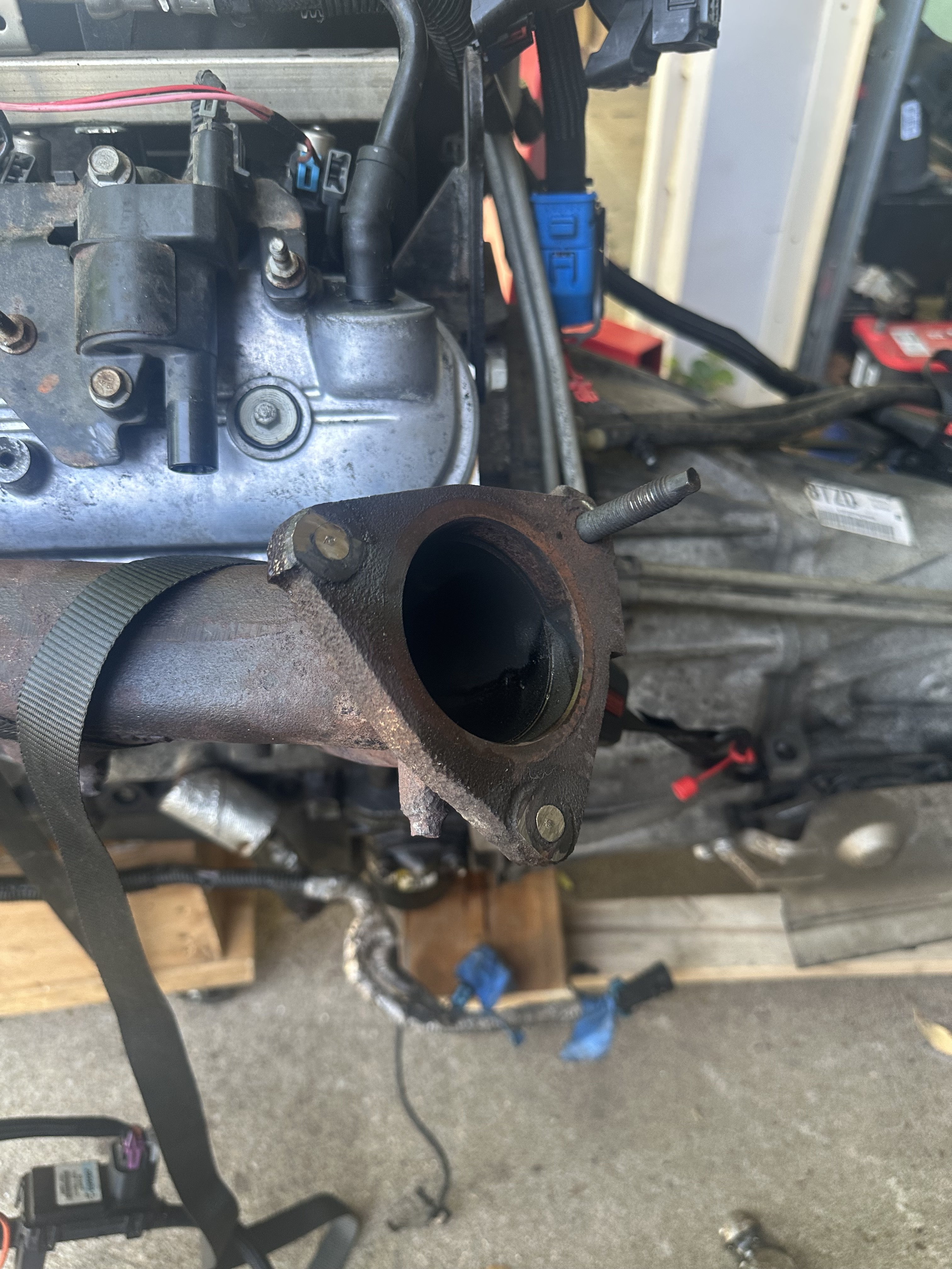

Woke up this morning and decided the broken exhaust studs were coming out one way or another.
Pulled the exhaust manifolds off since drilling out the studs was sitting at a weird angle. While they were off I got the two broken studs out of the head on the drive side extremely easily.
Threw the manifolds back on the engine backwards since one of the few tools I don’t have is a vice and drilling out the studs put me at a very weird angle
Got out my grinder and lapped off the remaining stud to sit flush.
After about 30 minutes of drilling this is what I had accomplished.
So I decided to run down to the local Ace hardware store in search of some more productive drill bits and stumbled upon these
This build isn’t sponsored by #Milwaukee (hint hint) but let me advise you, if you need to drill out a hardened steel anything, do yourself a favor and buy these. I got more accomplished in 30 minutes with these bits then I have over the past few days working with my other tungsten carbide drill bits (most of which I was using were new)
After another hour or so I had all the studs drilled out and tapped, and new studs inserted. The dorman studs I purchased don’t have a big enough shoulder so they will technically thread all the way through. May use an old nut on the backside to make sure they don’t pull out if cinching the downpipes on causes them to pull out.

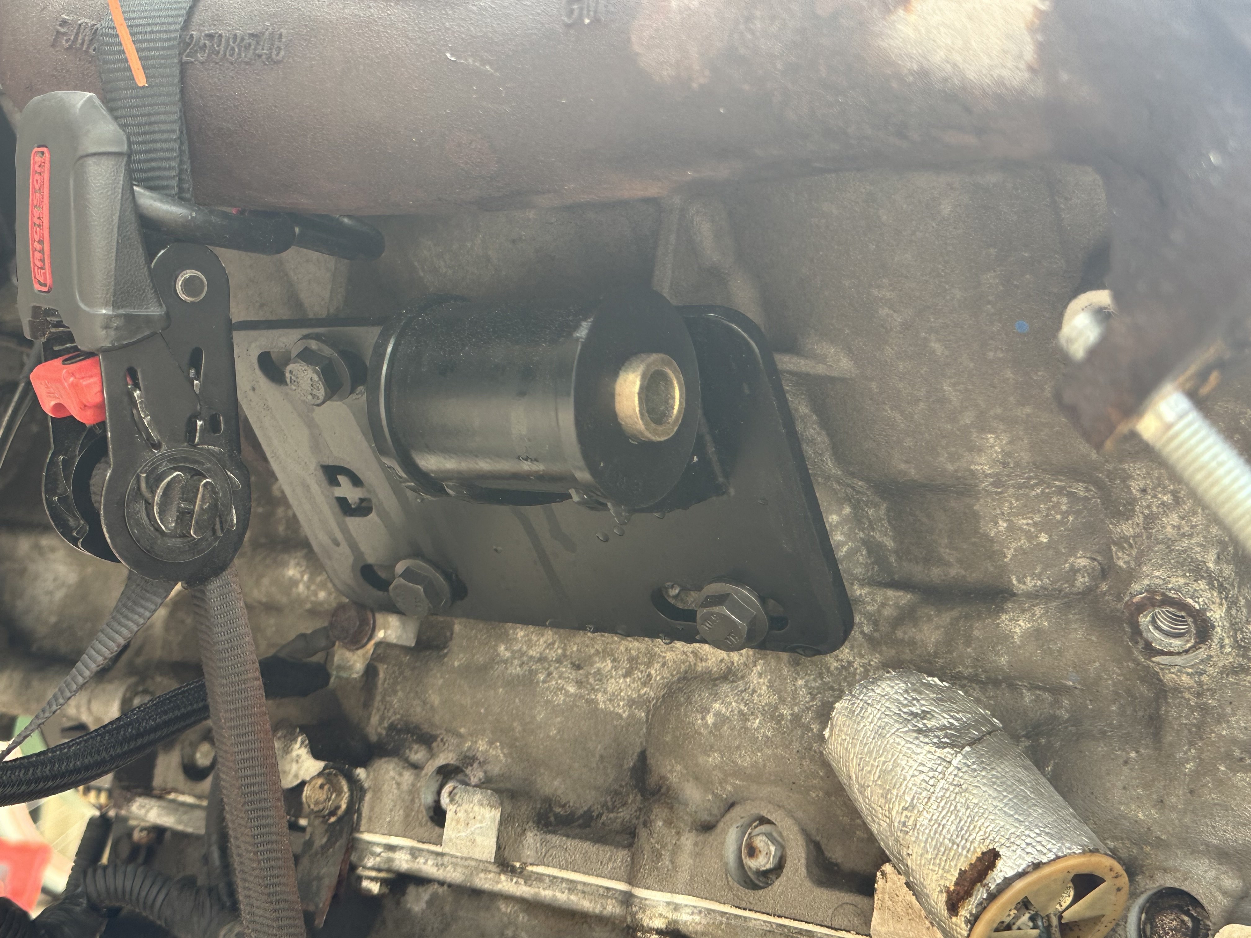

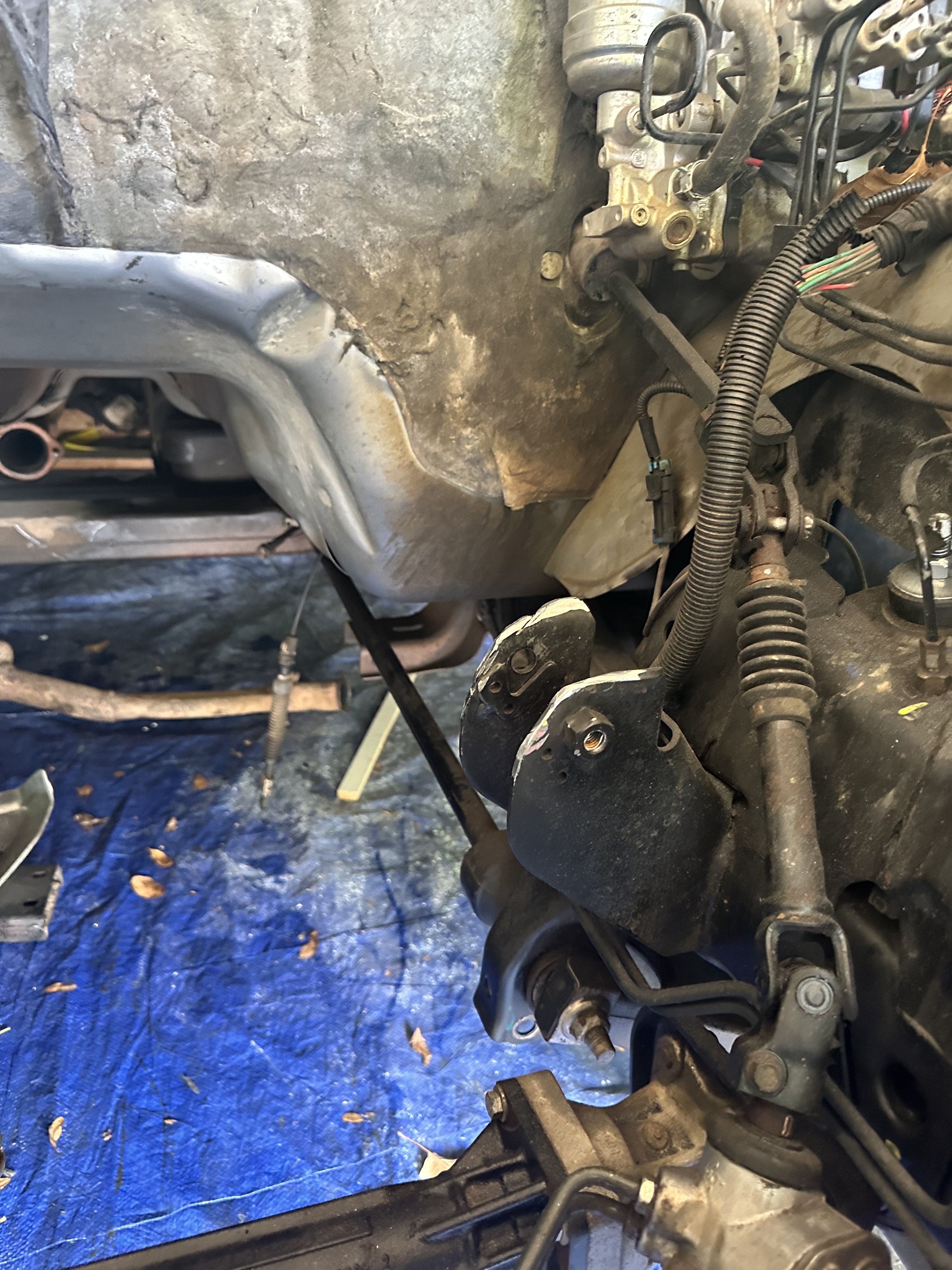

I did however get the frame brackets cut off to accept the swap mounts. Passenger side only required minor modification, where as the driver side required some significant cuts. I may have to cut off a bit more per some of the info from the website but we’ll see once I drop in the motor to see how/if things clear
Also got the mounts bolted on but left them loose to allow for some forward/backward adjustment of the motor once it’s dropped to find a happy medium

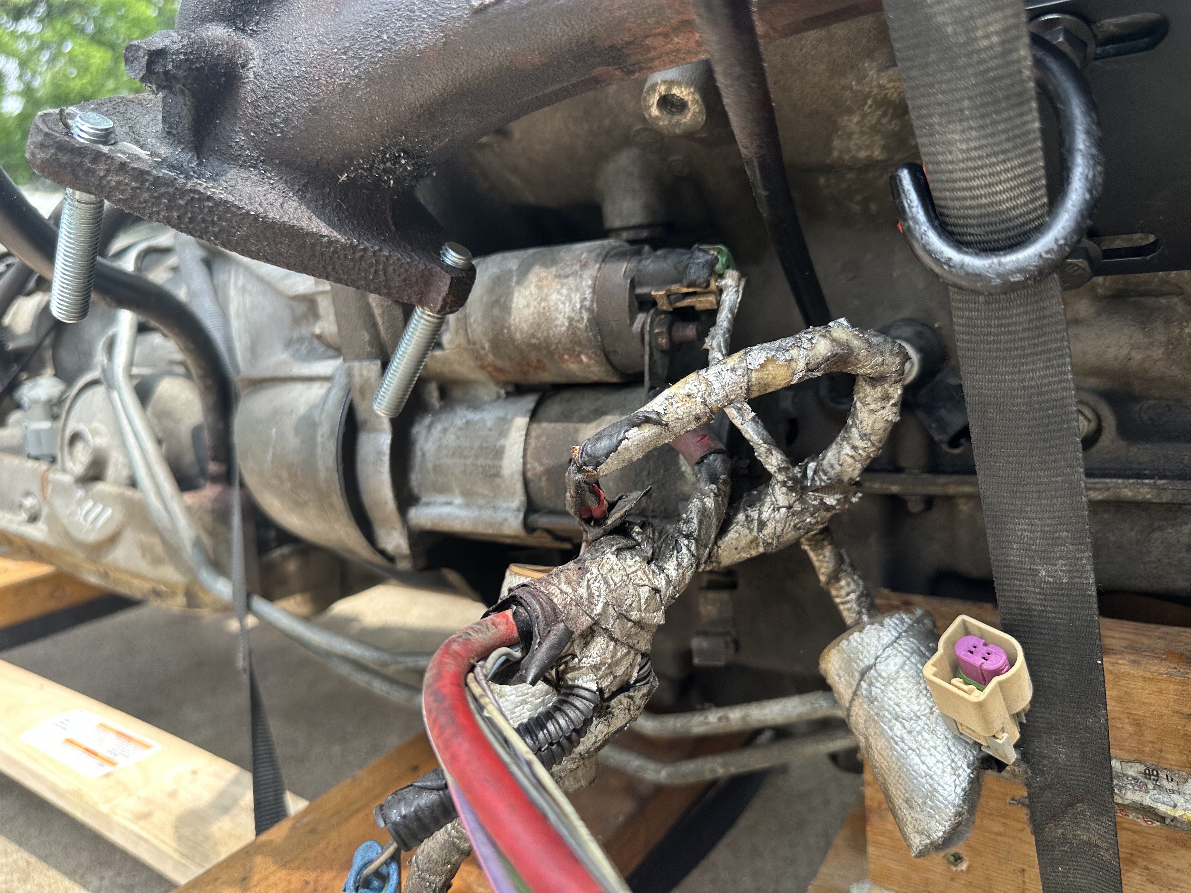

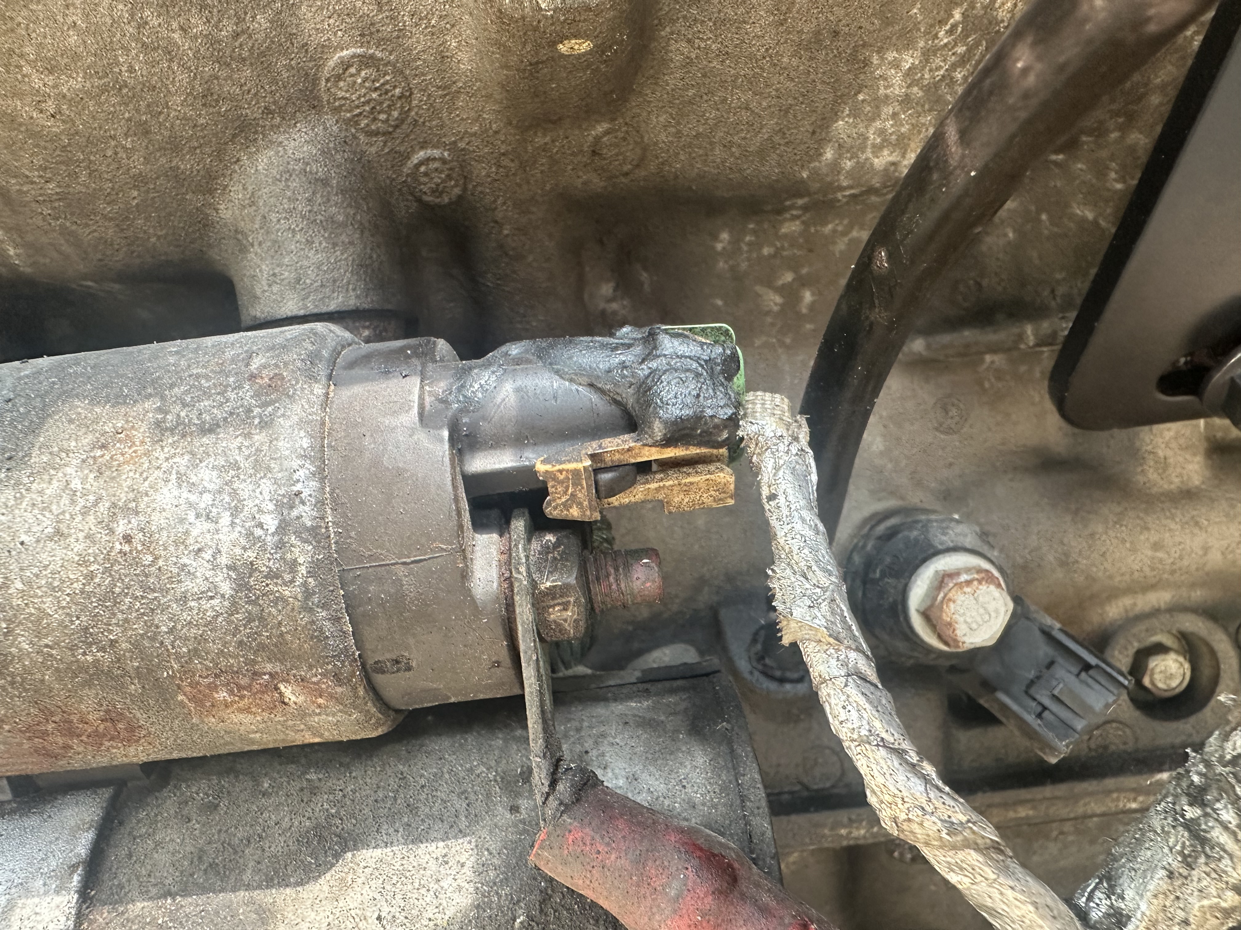

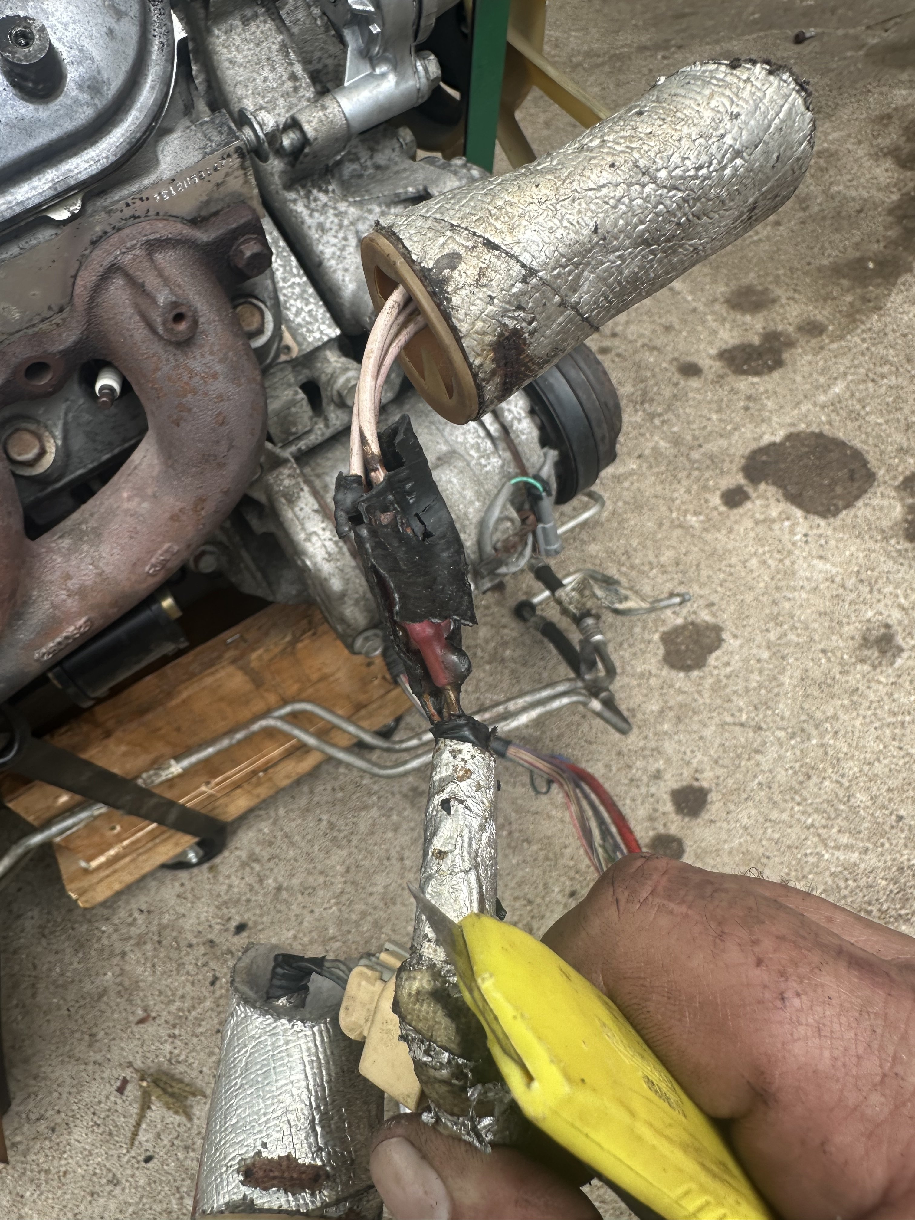

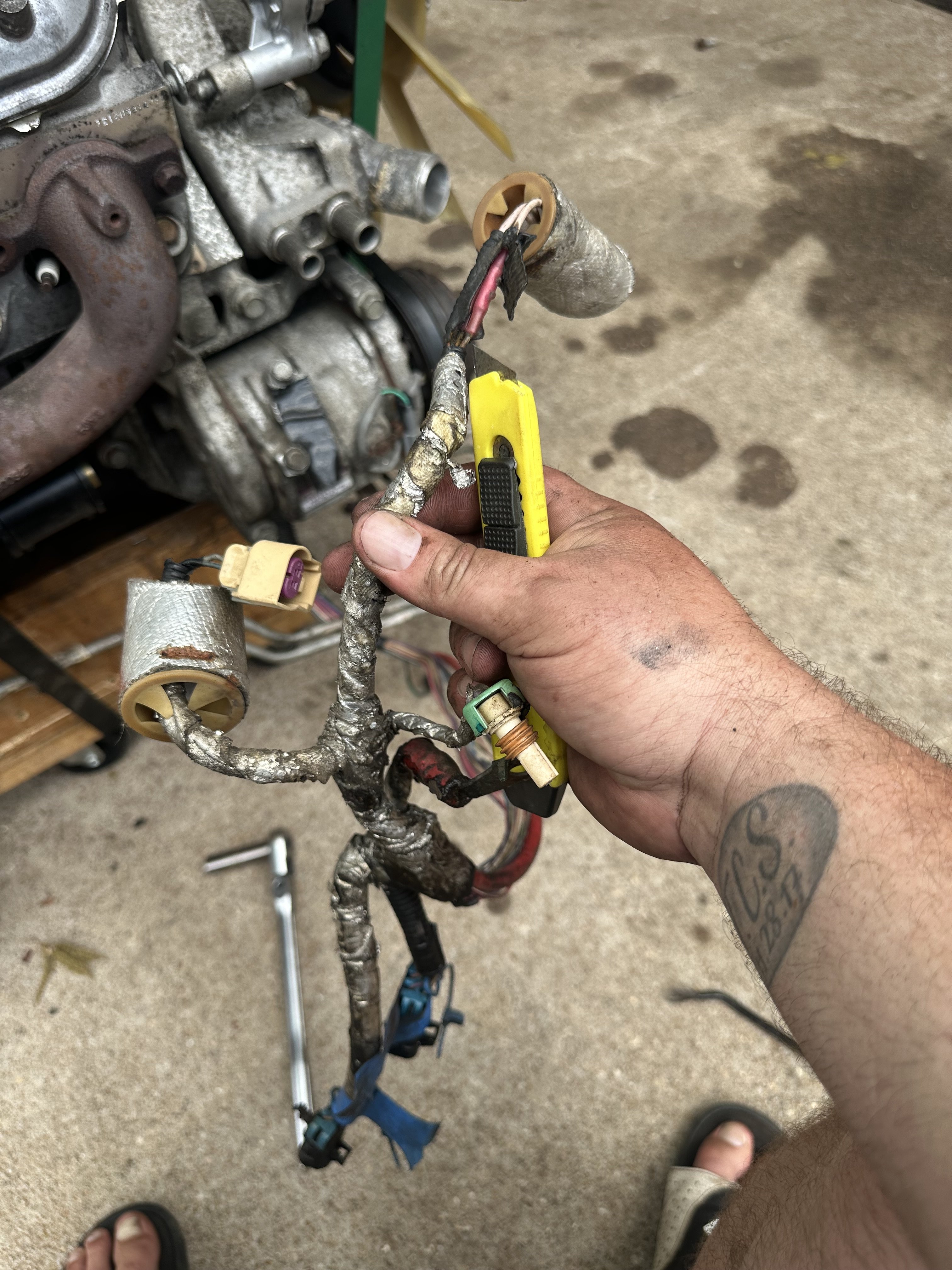

After installing the mount I realized I missed some exposed wiring and I’m glad I addressed it
I found a sensor which had some missing heat wrap and had melted the wires and the loom onto the starter solenoid below it. Snipped and stripped the wires, soldered them back together with some shrink wrap and loomed everything back up with some heat wrap around it to hopefully prevent issues in the future.

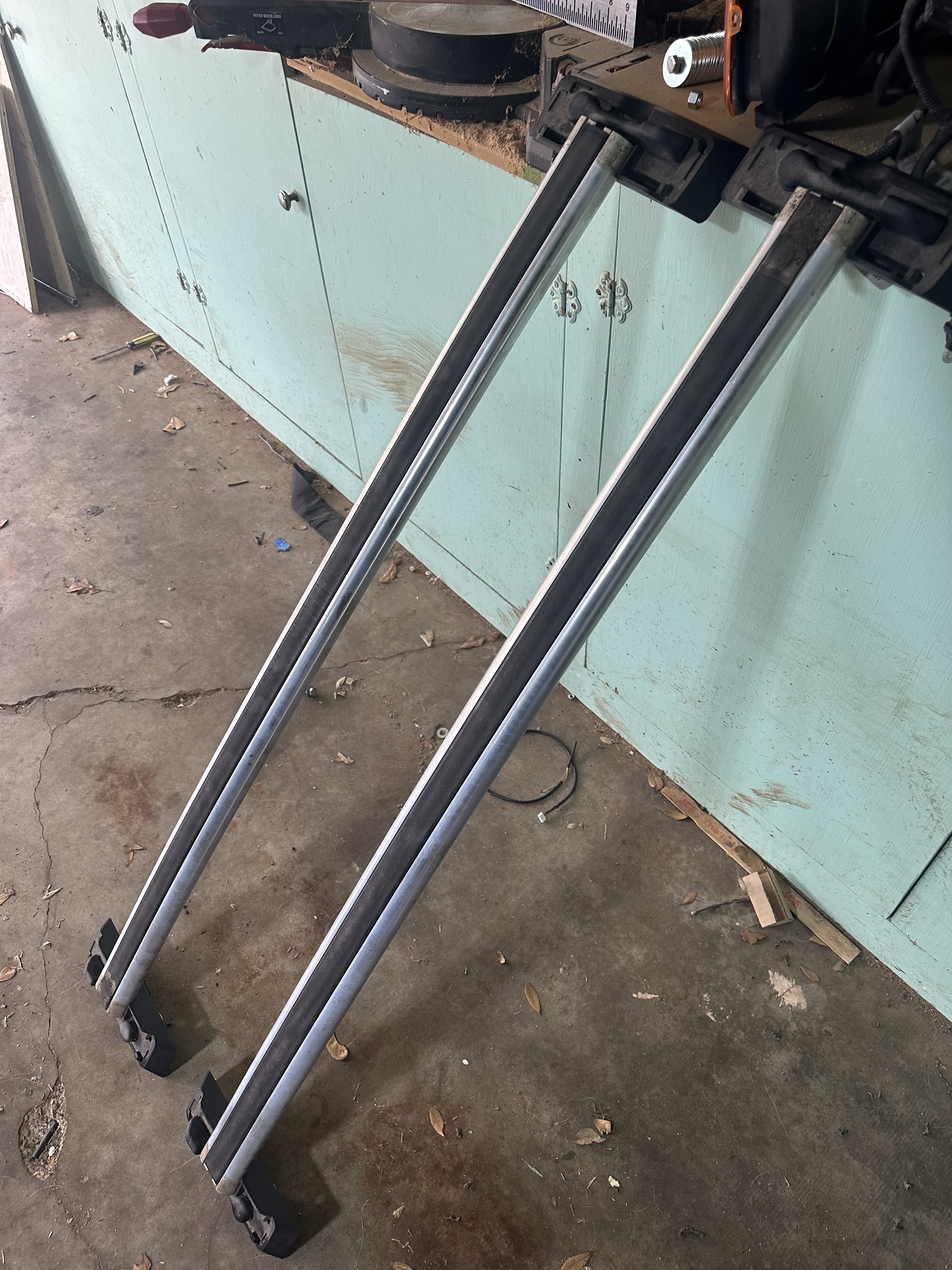

However, with the new key I was able to get the crossbars off and pealed off the ugly chrome trim. Spent roughly 45 minutes getting the adhesive remains off but the bars came out looking much better without the chrome.

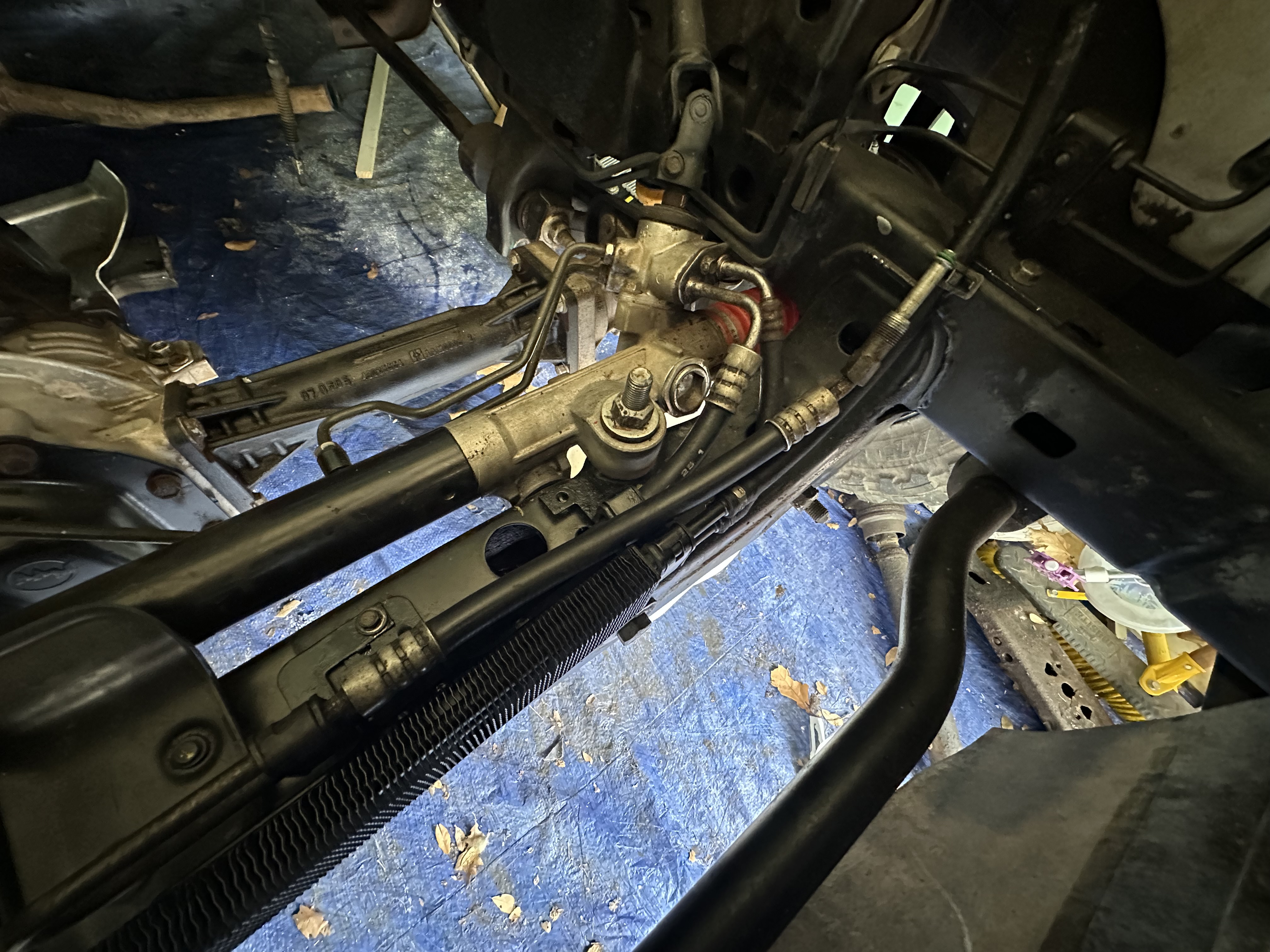

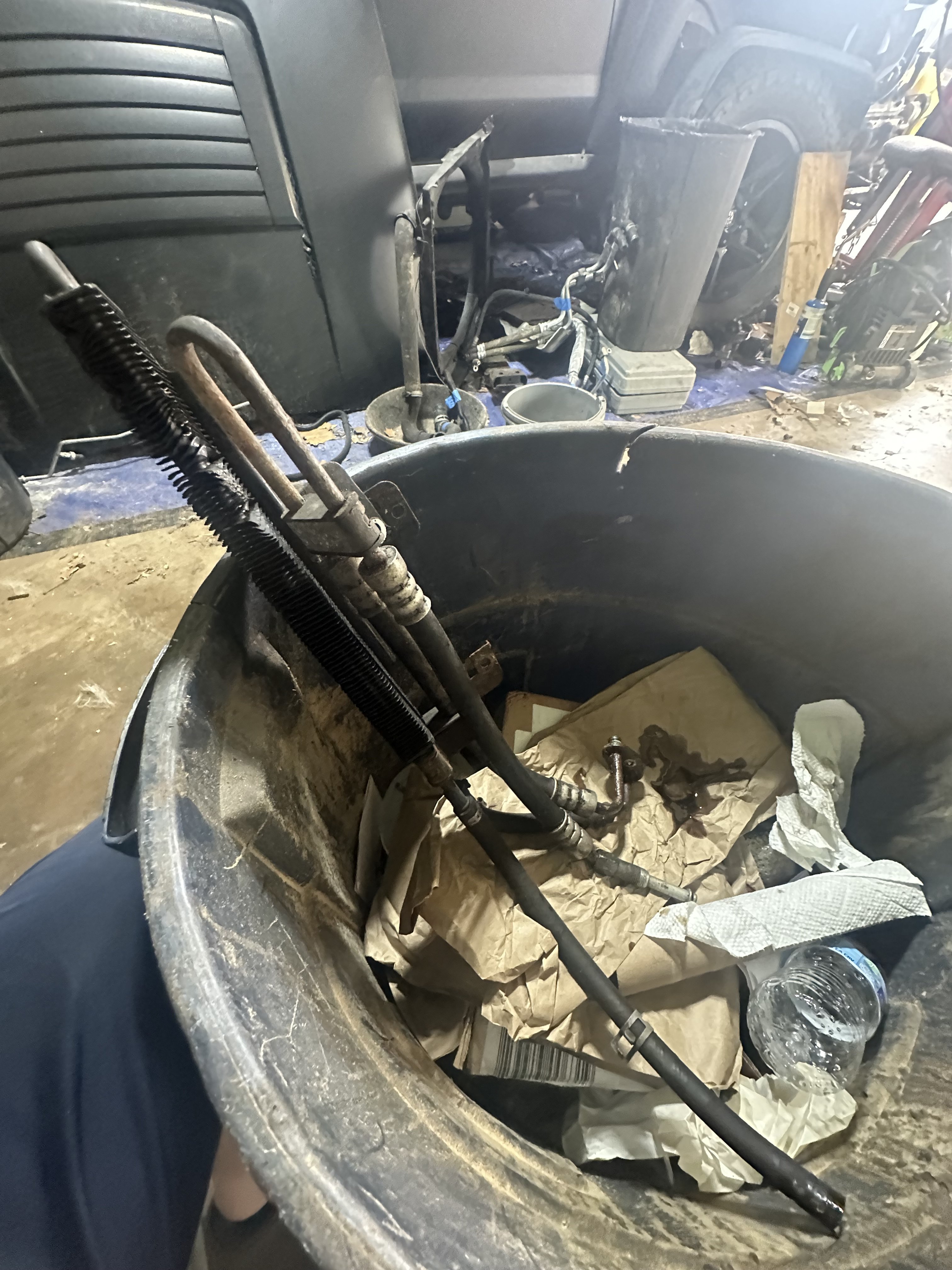

Also got the power steering cooler off, cleaned up the rust and gave it a fresh coat of high temp paint
Lines were extremely rusty so I went at them with a wire wheel and sand paper

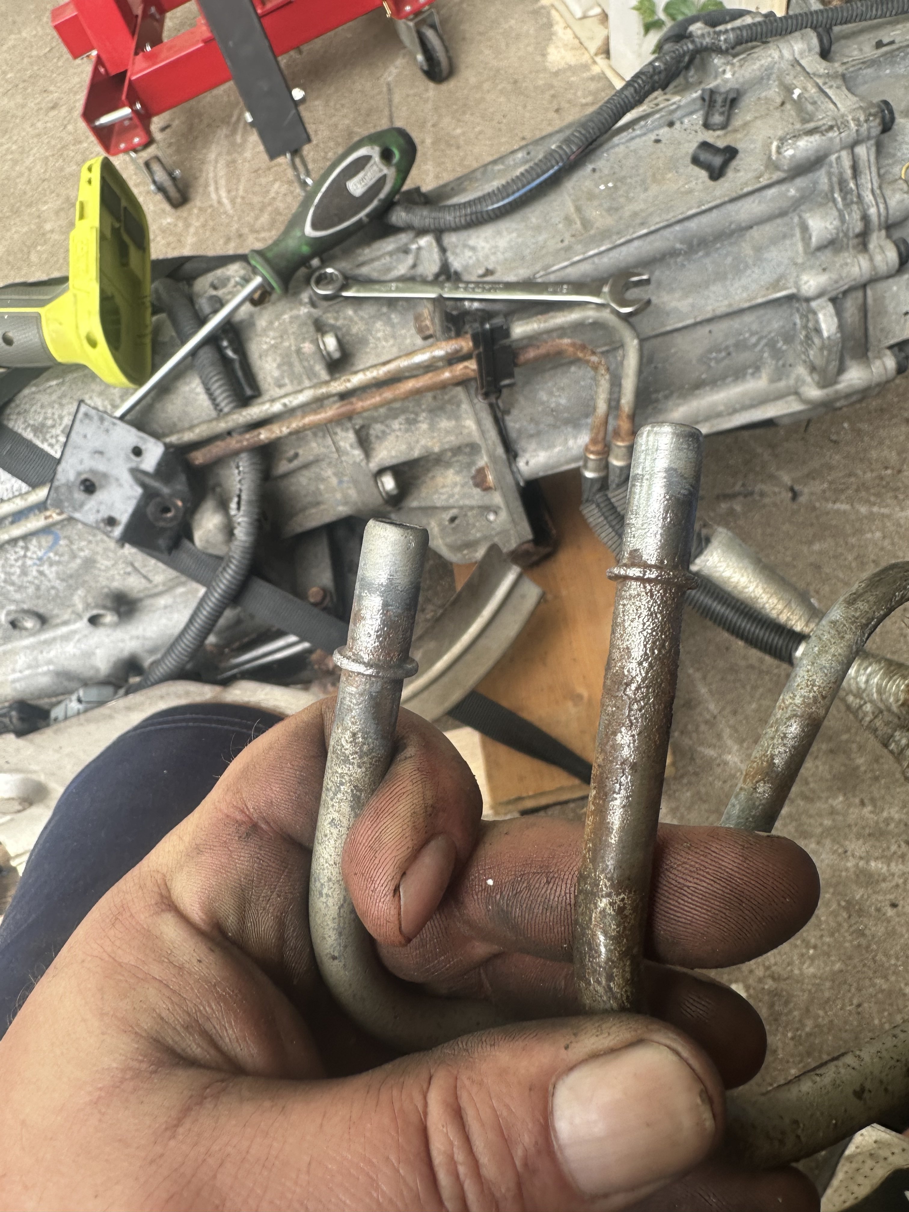

Finally got the gm connector cut off the end of the Alpha fuel lines. Tried my connector removal tool for a while before saying **** it and cut them off with a multi tool. After looking at them there was no chance the connector was ever going to come off in one piece, I even had to use the same multi tool to cut off the rubber seals because they were so stiff and basically glued to the rust.
After cleaning them up with a wire wheel and sand paper. Not perfect by any means, but much better.

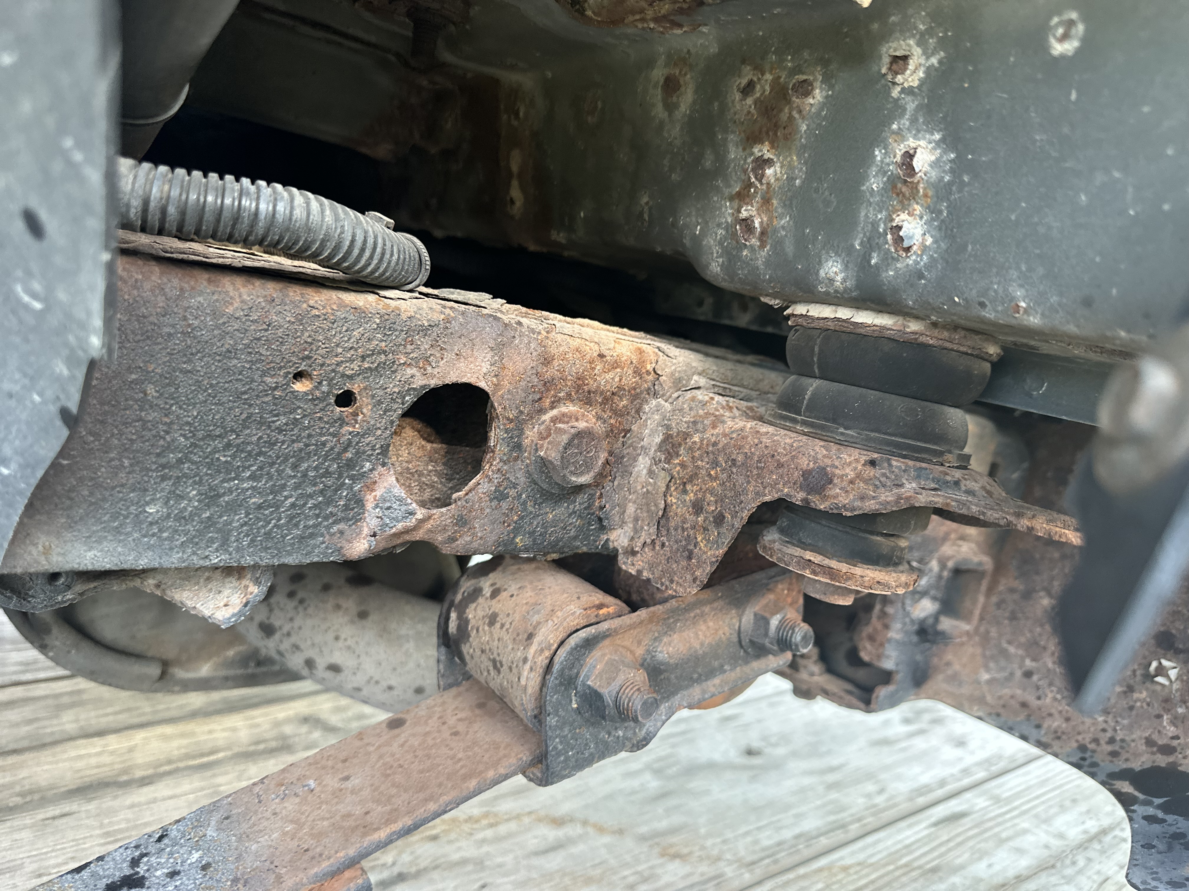

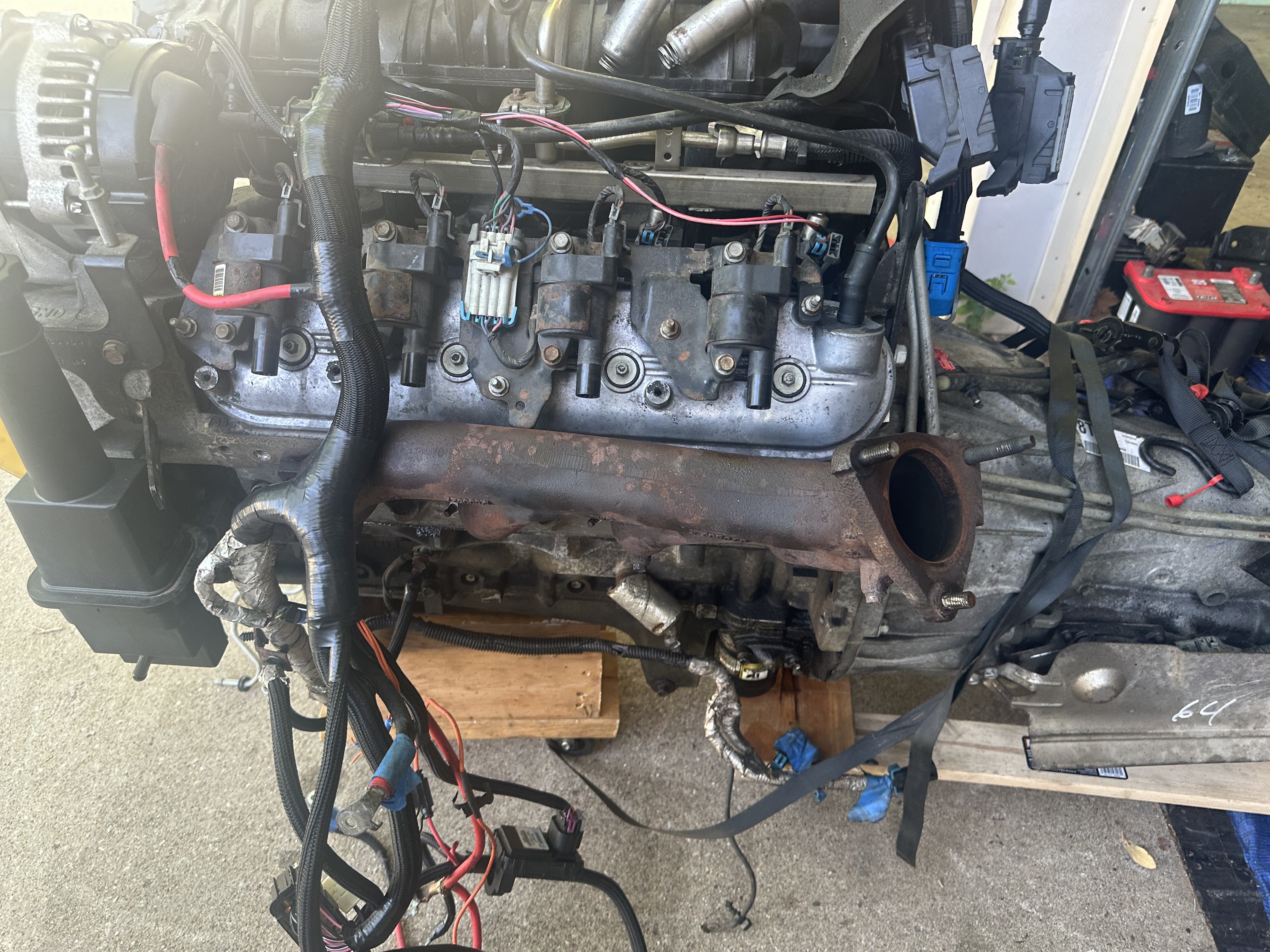

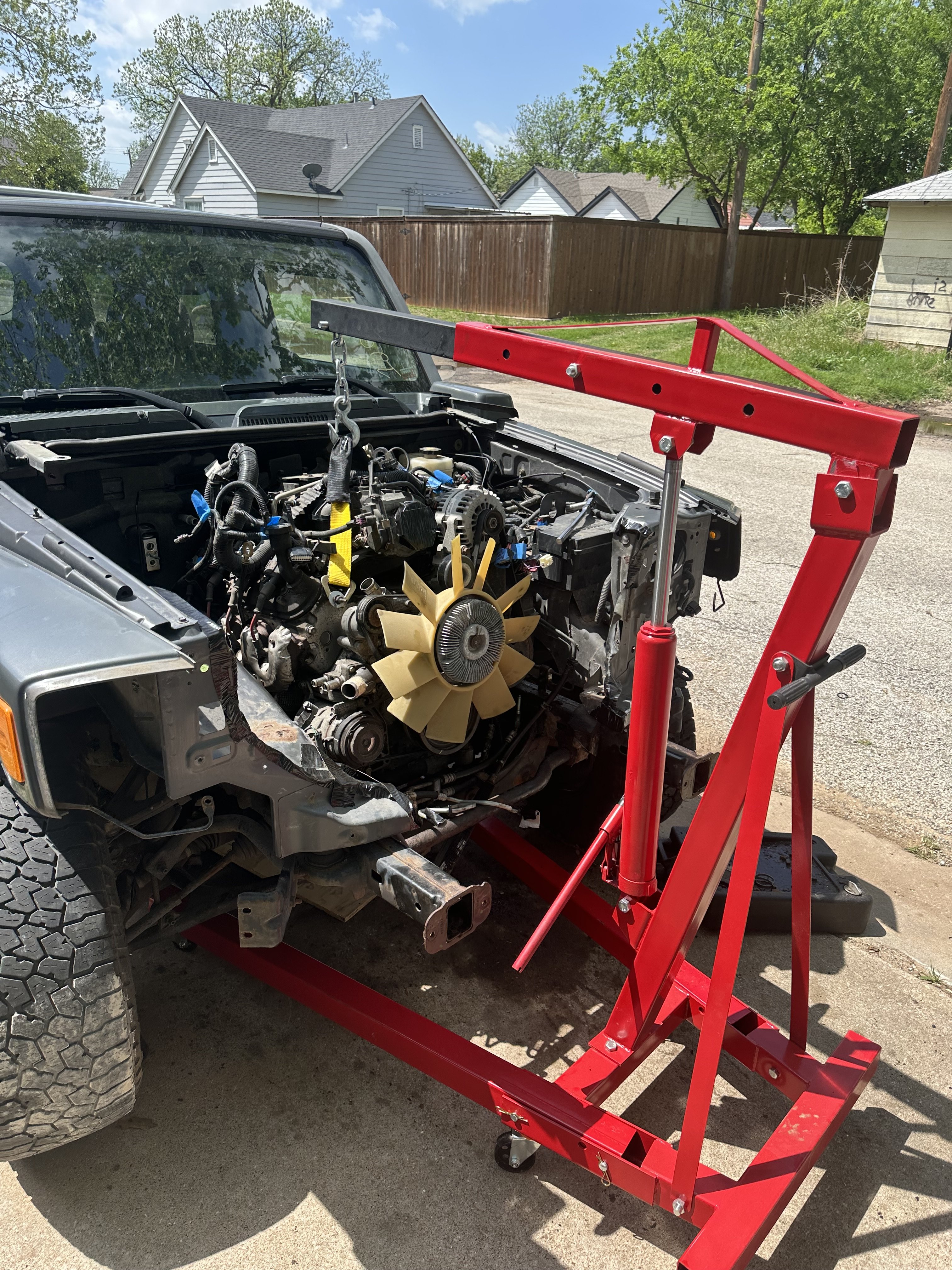

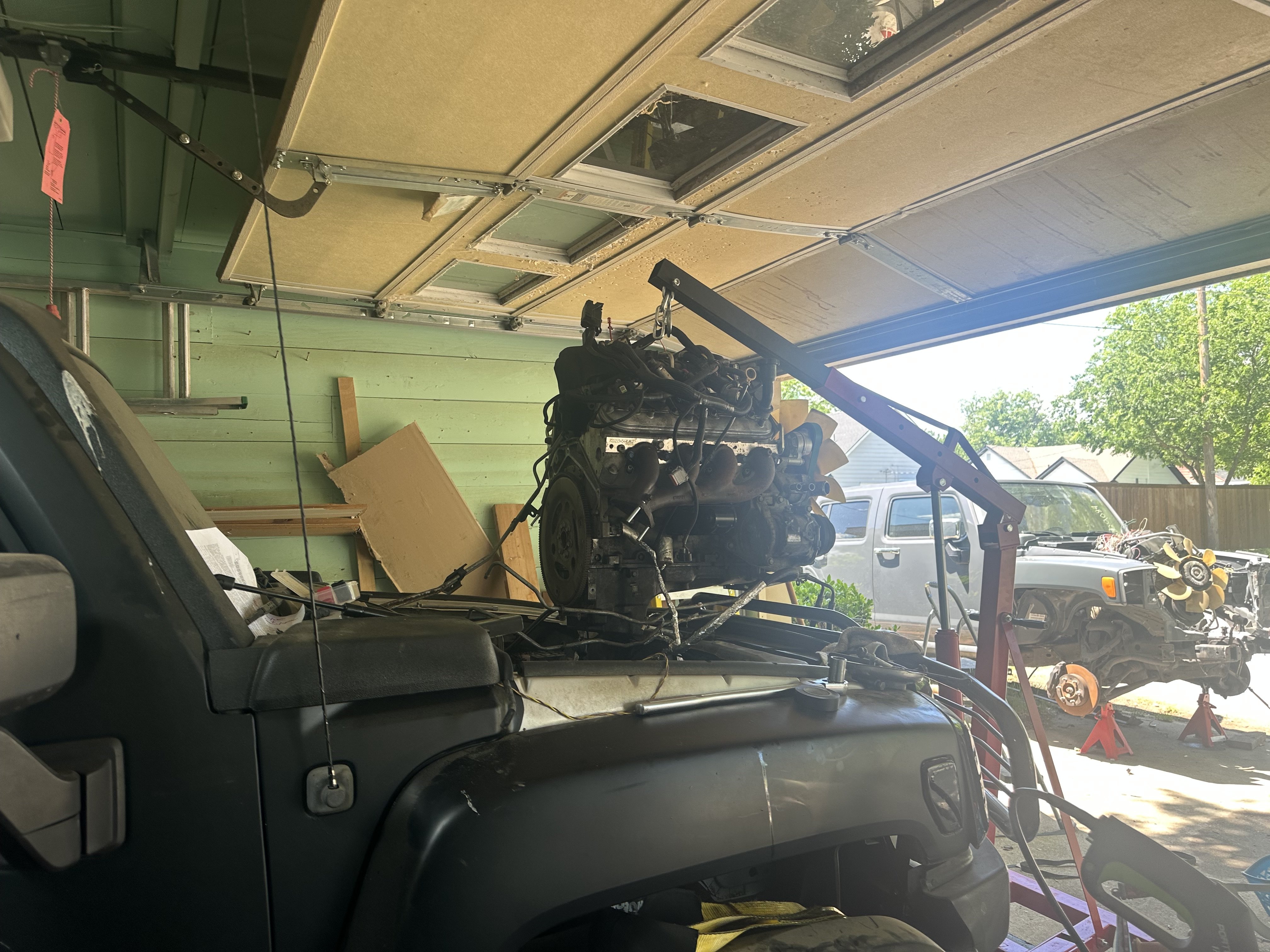

Once the manifold gaskets showed up I did a hurry up to try to get the motor and transmission stabbed. Tried cranking the torsion bars down - too high, tried airing down the tires - too high, pulled the wheels and put the jacks on the LCA’s - STILL too high, dropped it to have the jacks on the front cross member - STILL TOO DAMN HIGH.
The lower ball joint ended up being roughly an inch from the ground and I still can’t get the whole setup up and over the grill (by a solid 5-6”). I think I will end up braking the transmission from the engine and drop them in separately. I just can’t see another option where they go in together and have any kind of drop angle for the transmission like I was hoping for. I’m pretty sure I can jack the whole truck up to allow the transmission to slide in under then drop just the motor from the top with minor persuasion then reconnect them inside the engine bay.
If anyone has advice on another method to stab the unit as an assembly I’ll gladly try anything to keep from separating them.

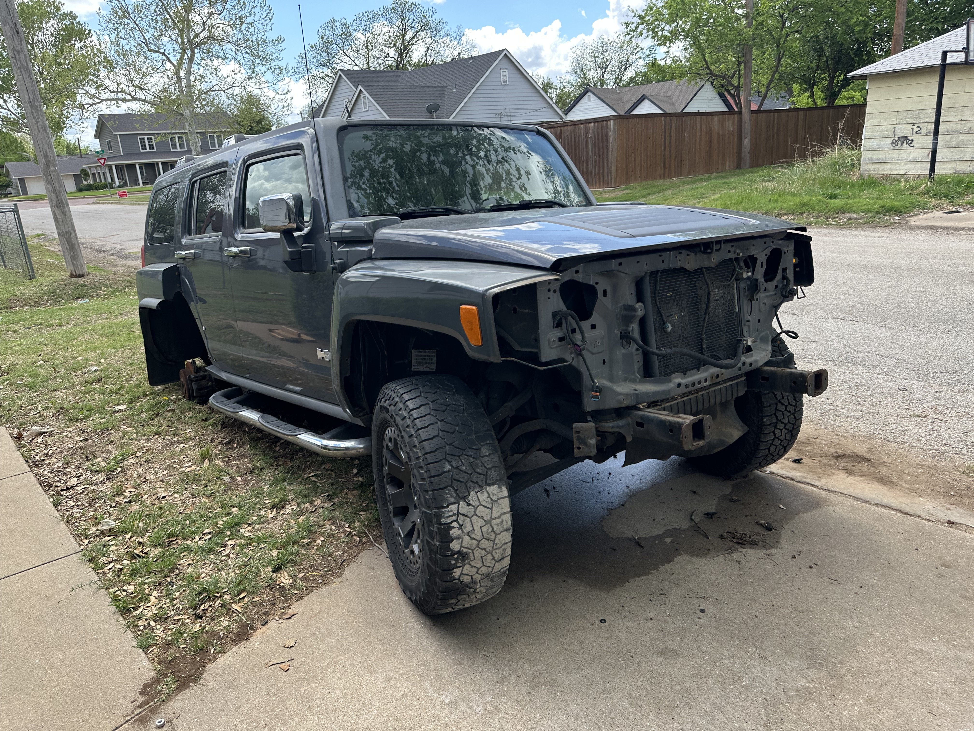

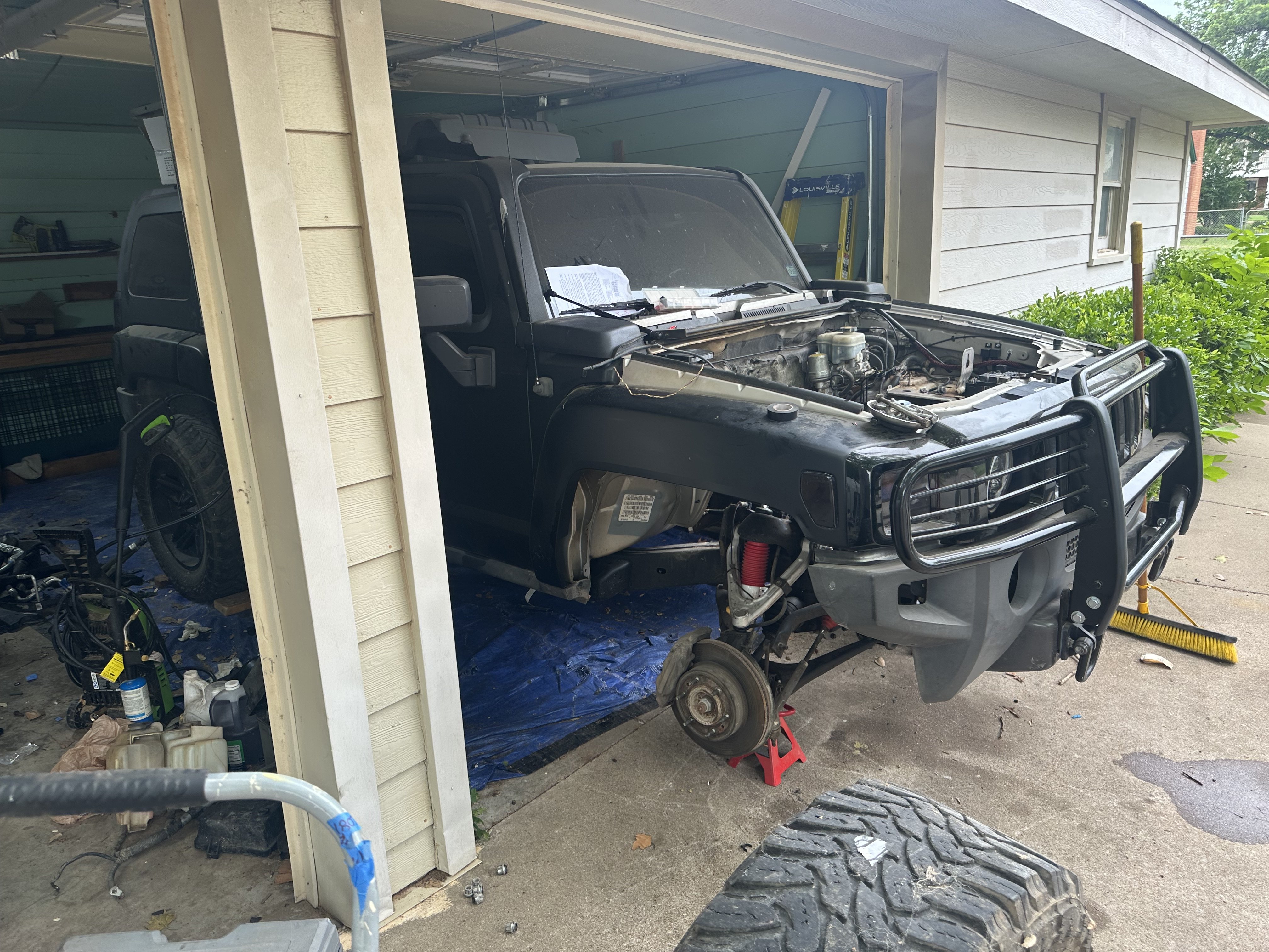

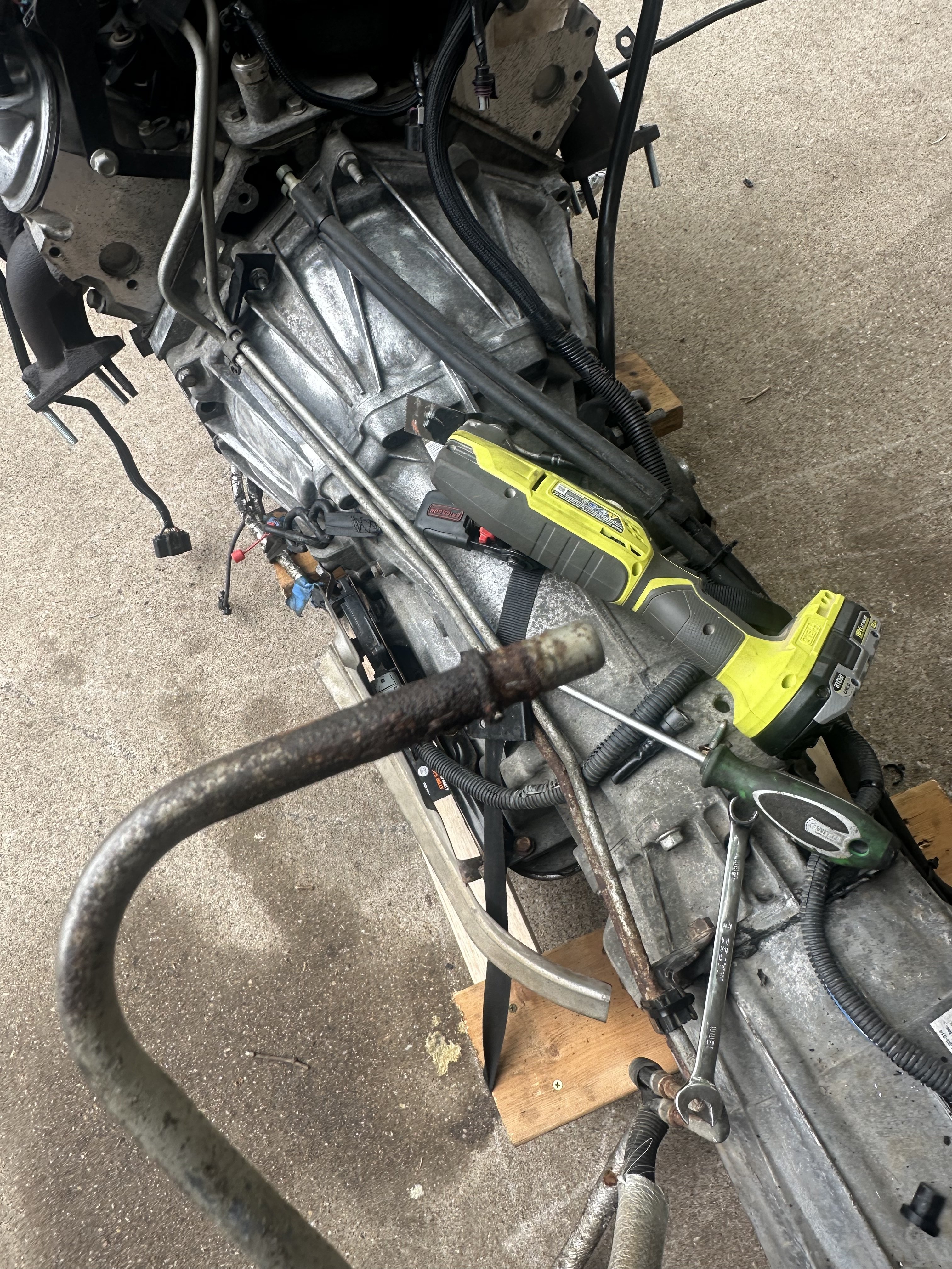

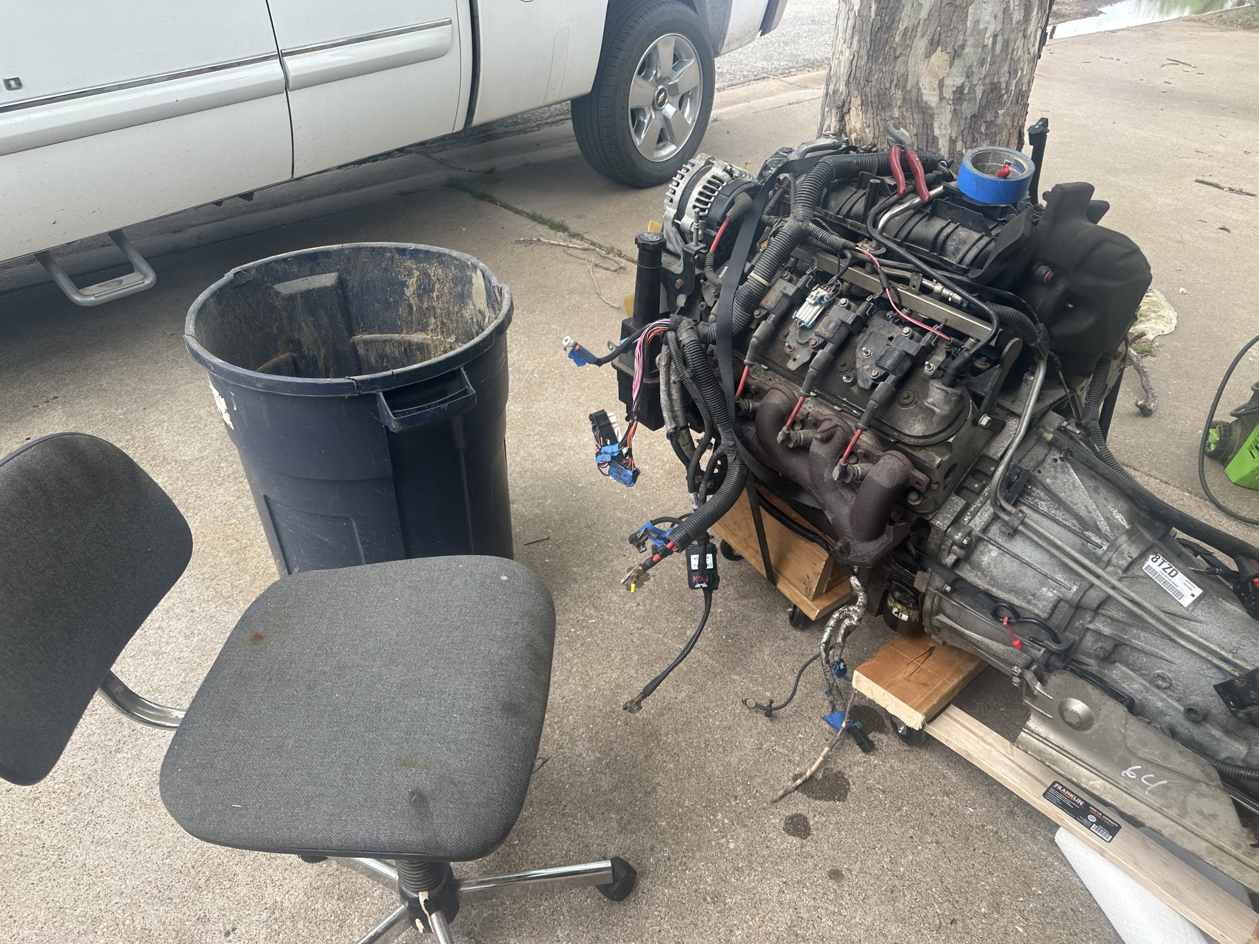

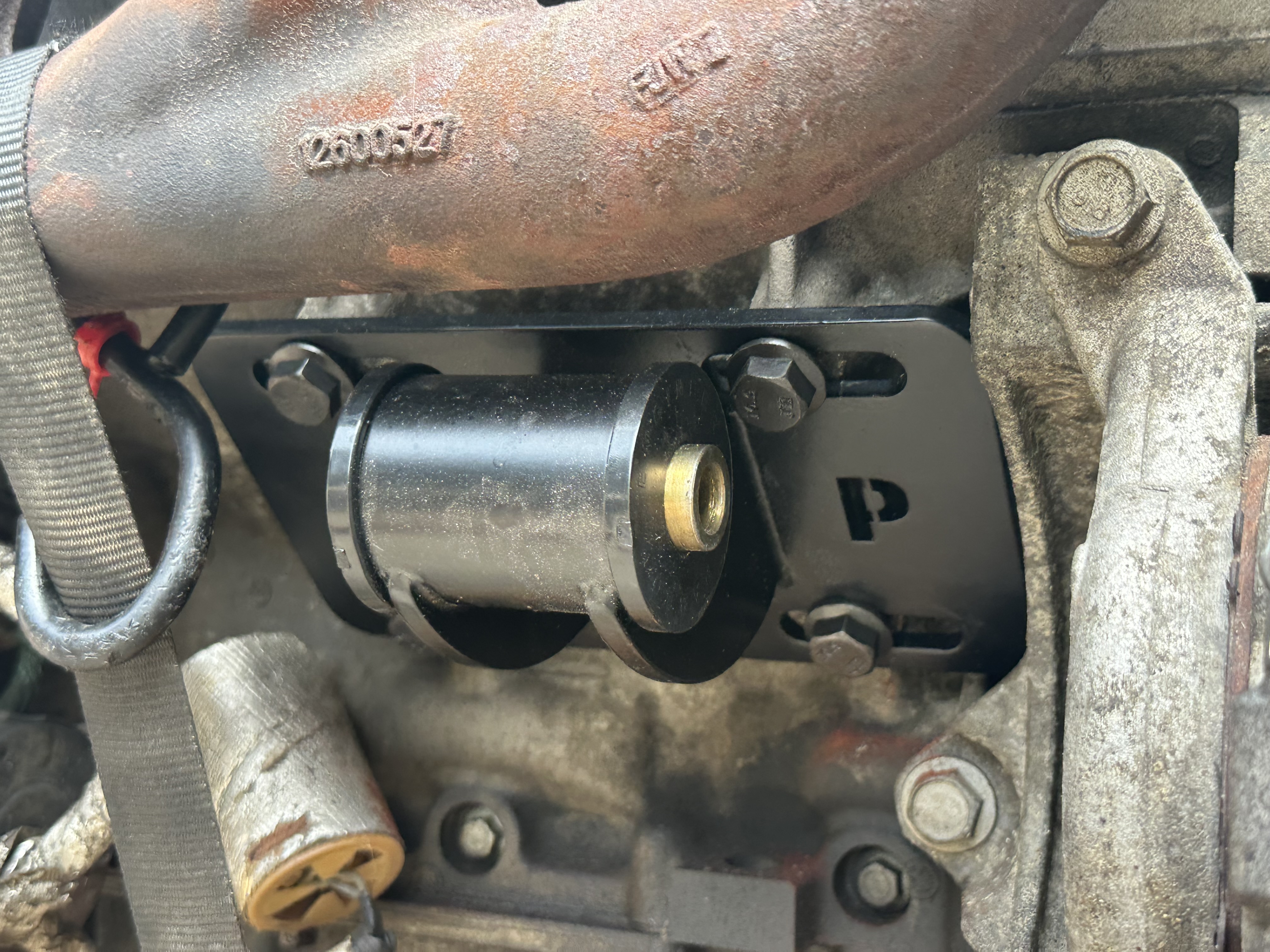

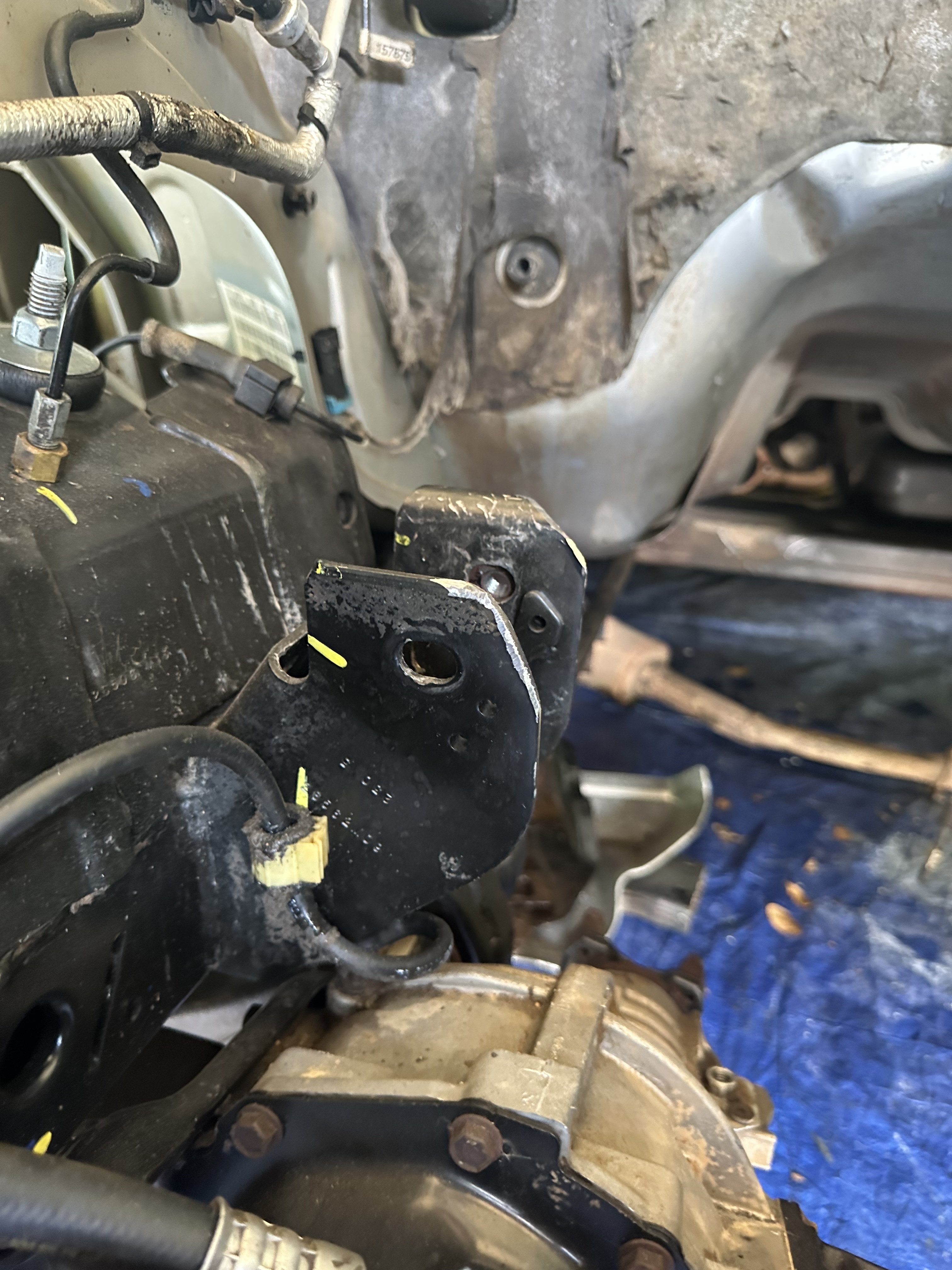

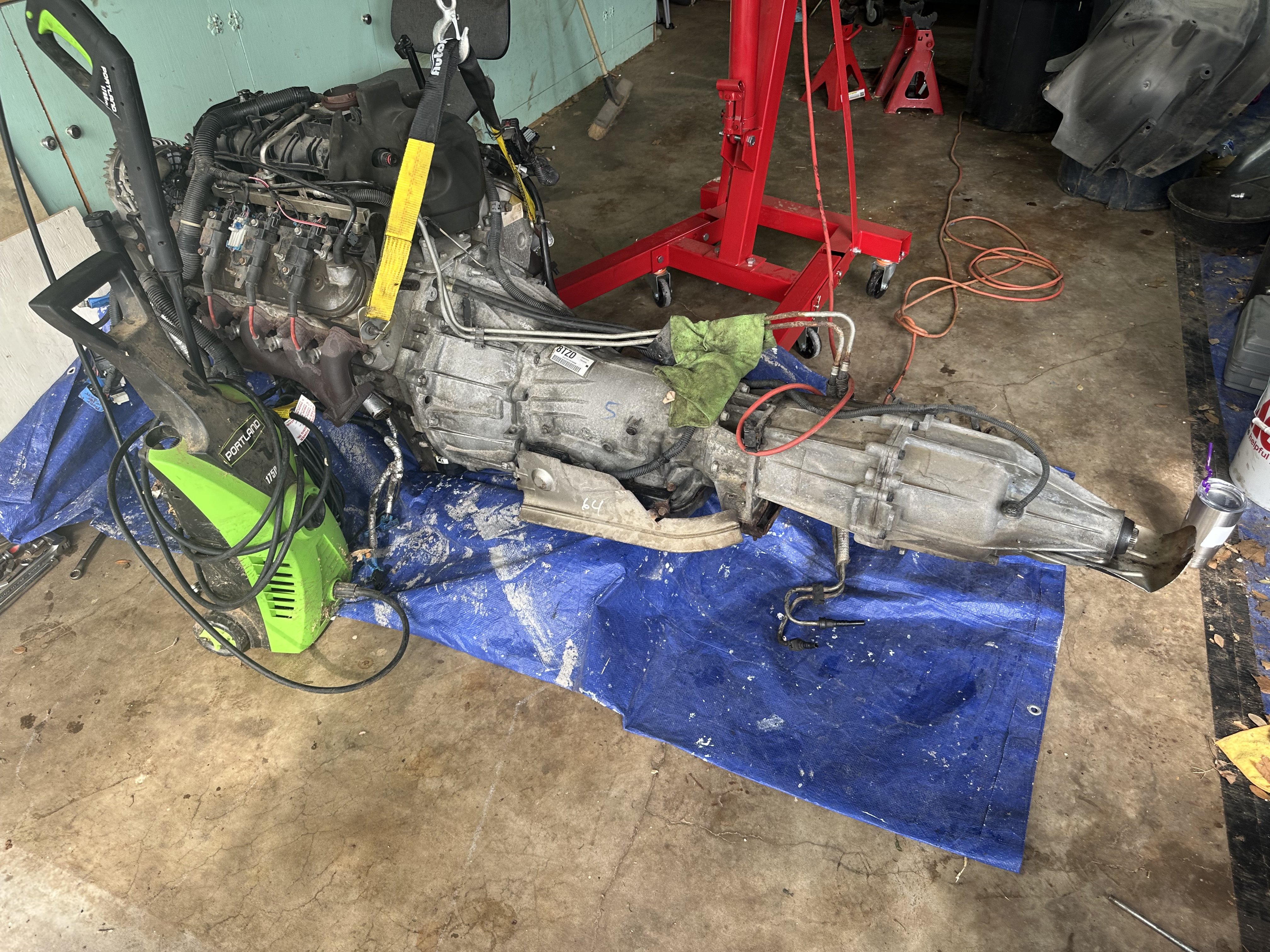

Well after many disagreements and vulgar word usage the motor and trans are mounted.
I ended up disconnecting the trans from the motor to allow some ease in getting everything dropped in. I just couldn’t see another method with the tools I have to get enough “attack” angle with the transmission that it would drop into the tunnel without hitting the throttle body/fan at the front of the motor.
I think I might be a bit too far back currently but once everything is installed I’ll shift it around as needed. Someone else who’s done this swap might have some advice on my mounting location?
I fly out to Minnesota in the morning for work so progress will be halted until the end of May when I get back. But at least I was able to end on a good note!
Some helpful advice for those of you planning on doing this swap.
- If you’re separating the trans from the engine put the trans under the truck but don’t hang it on the rear cross member or install the transmission crossmember. The engine kept contacting the transmission which kept it from being able to drop in on the driver side I fought this for a solid 2 hours before giving up and dropping the transmission out.
- “Finger tight” to mount companies means something totally different. I ended up backing out all the bolts on the mount to motor and left about 3-4 threads holding the mount on in order to move it around enough to get the body bolt in. I kept the motor strapped and suspended while doing this.
- Install the passenger side mount to the body before dropping the motor. The AC compressor interferes with getting the bolt through the mount meaning you either have to remove the compressor or cut the bolt down 3/4”. You’ll see a relief in the back of the compressor for the bolt but it’s not sufficient for the ‘06/07 mounts.

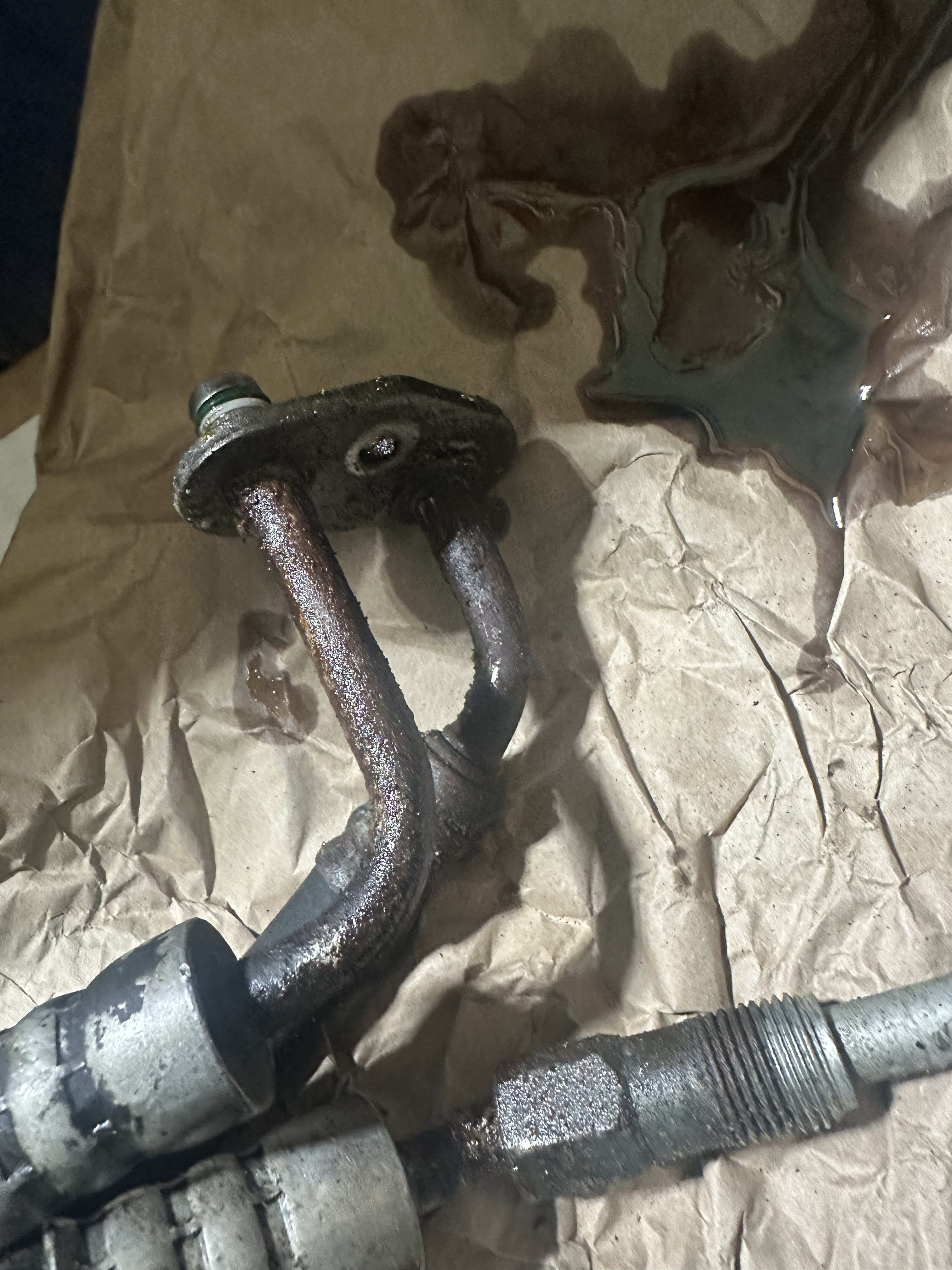

- Watch your HVAC hoses at the firewall. As you can see in the last picture mine took a couple good shots and will need some finessing to get them straight again.
- Have an oil bucket nearby. I took a couple good transmission fluid baths while shifting things around under the truck since it’s easier to have the dipstick out to drop the motor in.
I do plan on servicing the transmission and transfer case along with obviously an engine oil change, but again the setup I have makes it easier to do when it’s installed instead of swaying back and fourth on an engine hoist.
2,833
Why didn't you leave the tranny out completely until after the motor was in? Is there a reason it was in the way? I'll be doing this swap in a couple of months on my 06.
BBYHUMR
93
Texas
I didn’t look close enough during the tear down to see what kind of oil pan clearance there was underneath and I was worried about being able to get the truck up high enough to slide the transmission under the truck and the unit over the rear crossmember the transfercase sits above, while squeezing in between the back end of the motor.
Also I didn’t think it was going to be such a pain in the a** doing it this way.
