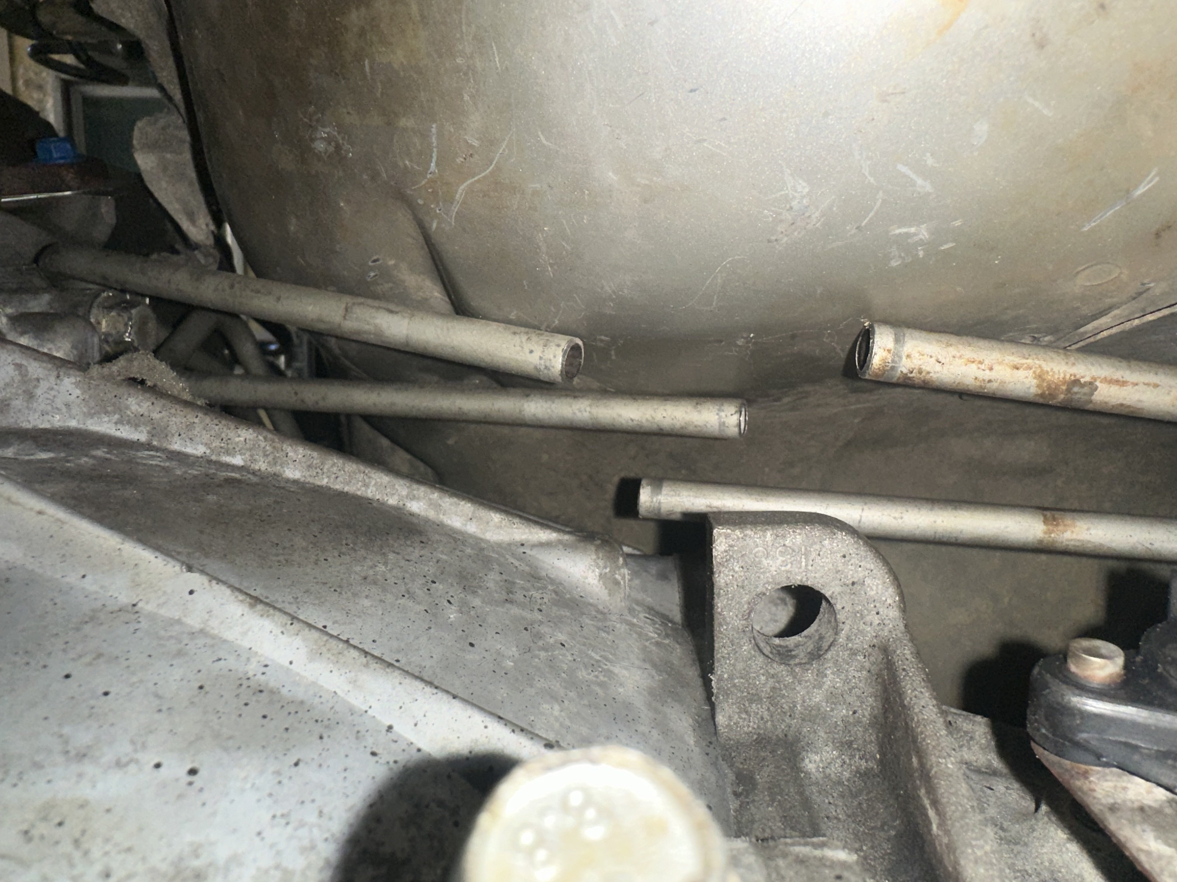

Started running the transmission cooler lines (yes I should have done this while the motor was out) but realized the oil filter drain funnel thing on the front crossmember is in the way since I’m using the Alpha power steering cooler so I need to pop that off. It won’t be used anymore since the V8 filter and drain plug are both at the rear of the engine.

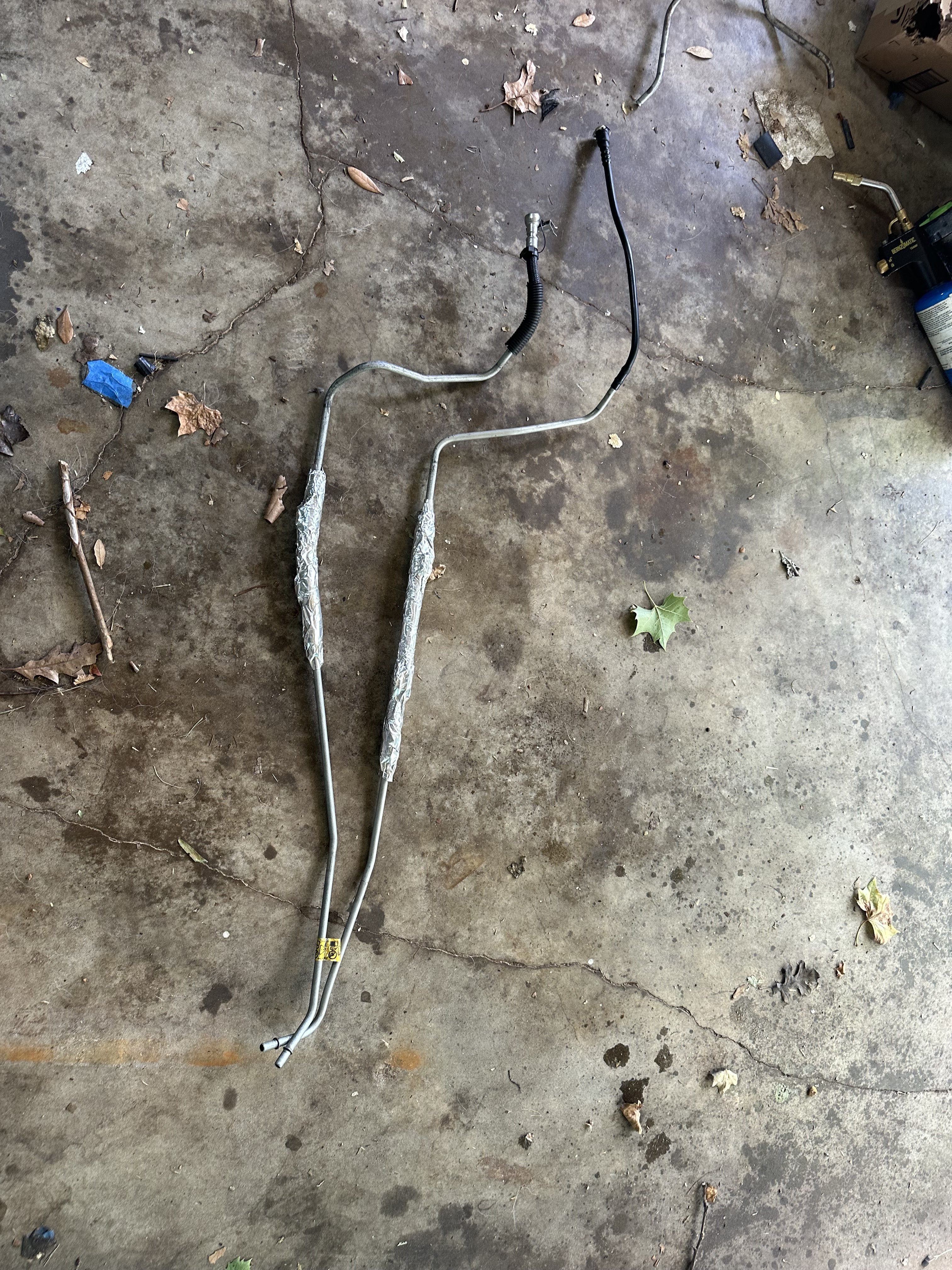

Tackled the fuel lines today.

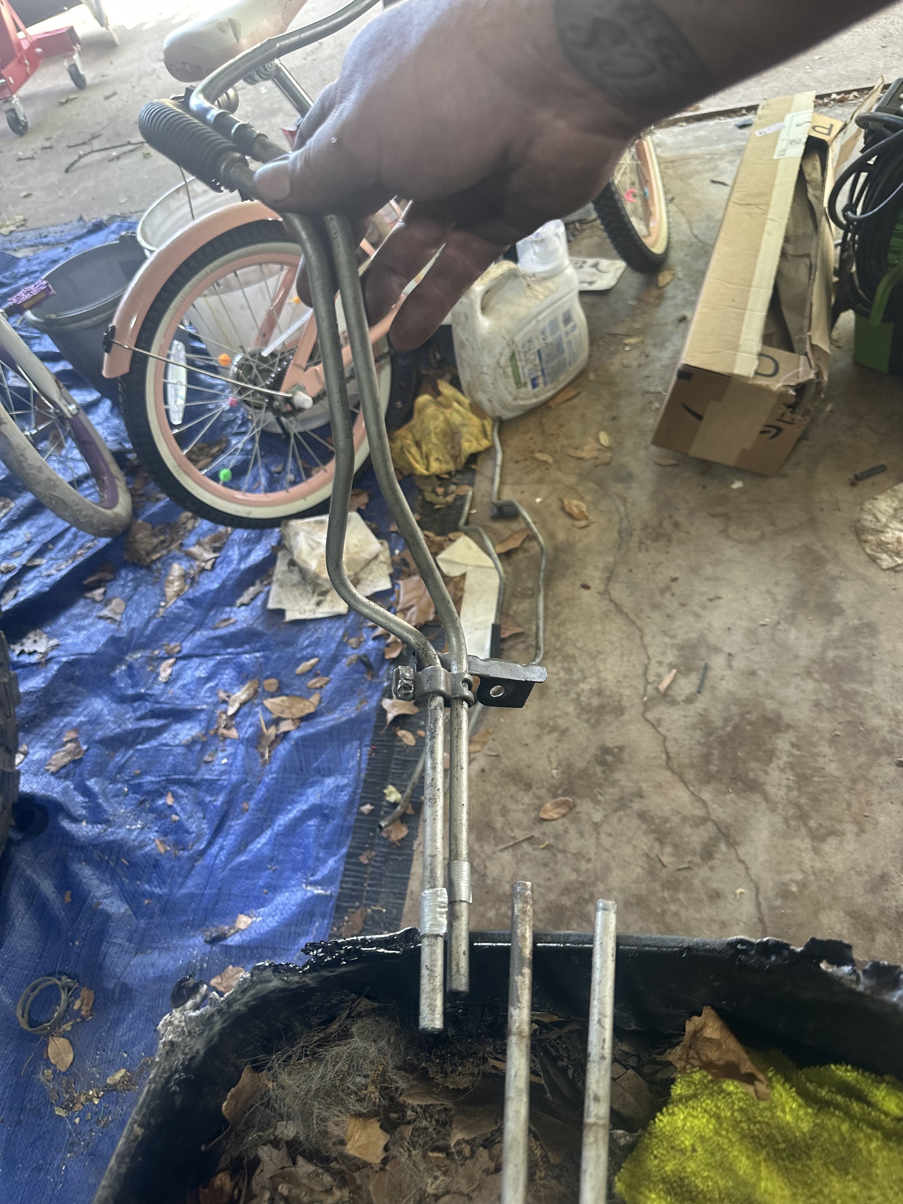

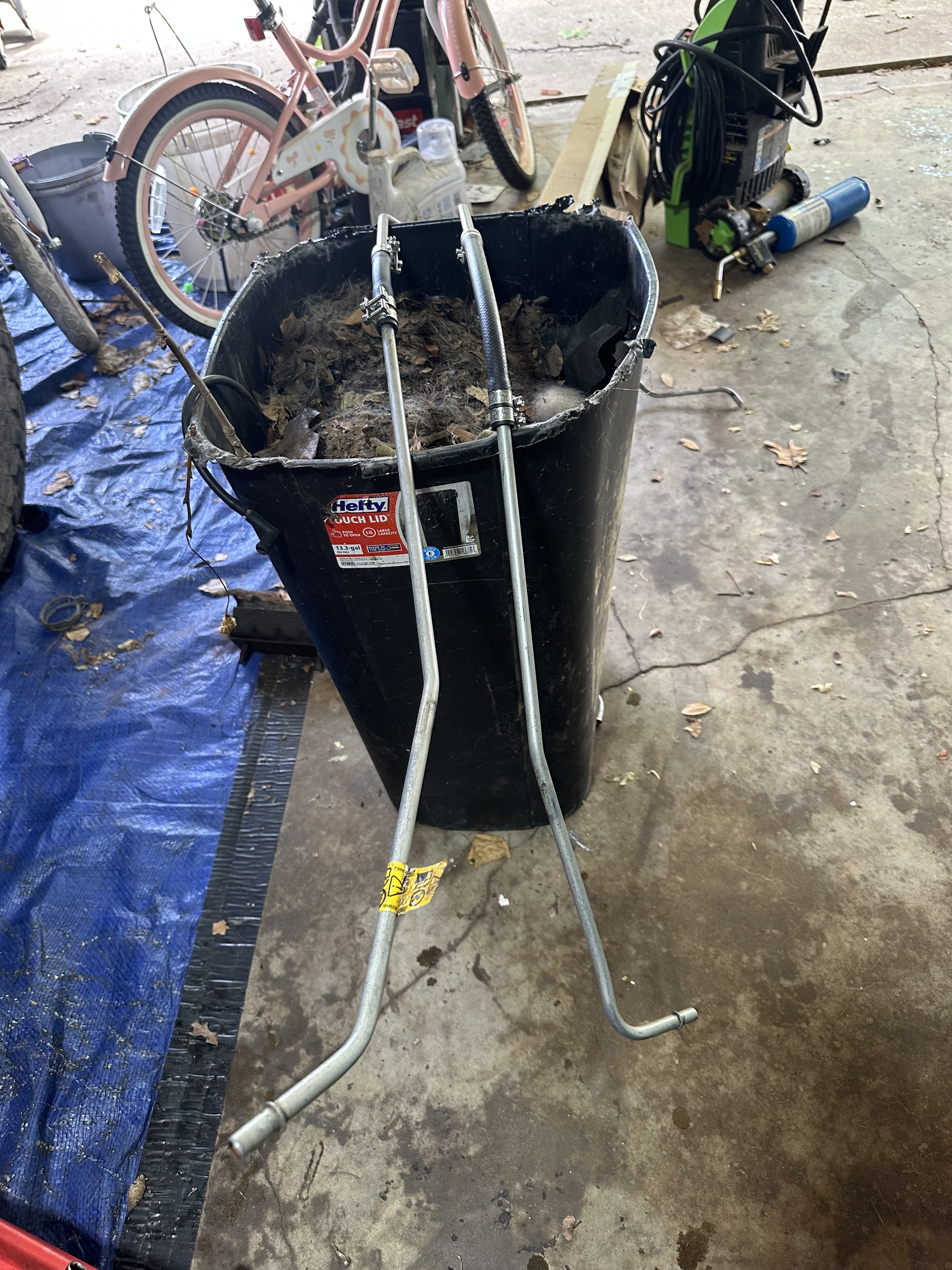

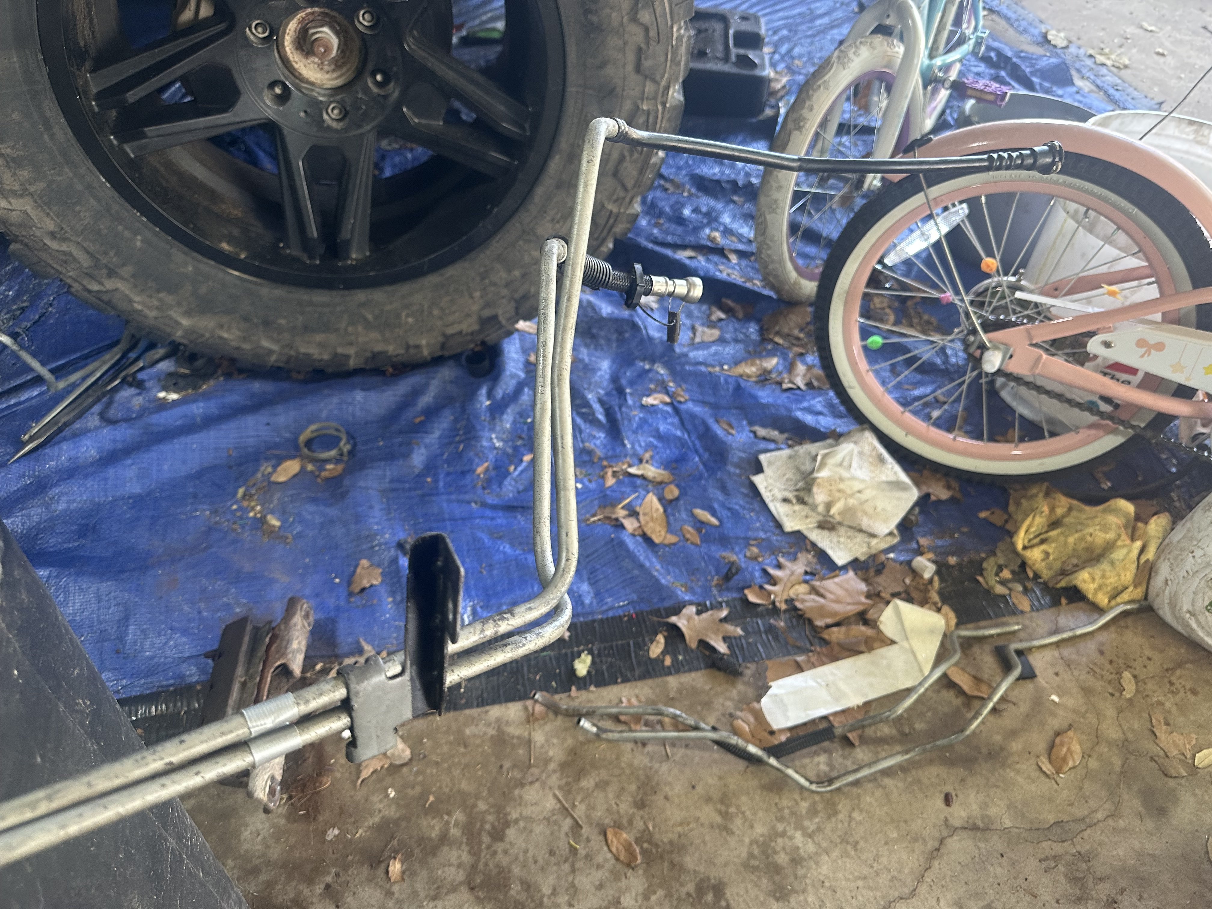

Like my previous post the Alpha fuel lines won’t work without kinking the braided portion. You can kind of see in the picture below the angles of the hard lines when they’re attached to the motor
The body side of the Alpha lines run forward rather than a direct 90* bend at the frame rail.
Luckily I still had my old lines from my i5 so I pulled those off lopped them down to around 20” and laid them up to figure out a way to join the two sets together.
Surprisingly enough my first cut was actually pretty accurate. I probably could have cut them just after the bend but the rubber hose allows the angle necessary to wrap around the body.
I cut the Alpha lines just after the transmission bolt bracket, you can see my tape “guide”
This allowed the pipes to line up pretty closely. I ended up cutting another couple inches away from the i5 vent line to give a bit more of a “sweeping” curve for the rubber rather than a sharp 45*
This morning I had picked up 2 feet of 5/16” FUEL INJECTION hose. Make sure it’s fuel injection hose, otherwise it will split or erode within a month or two. Ran about $10 a foot so it’s certainly not the cheapest stuff. I used a little over a foot of it along with 8 hose clamps and a small flare at each end of the hard line.
Then I wrapped them up with some heat wrap around the rubber portion of the hose and extended the wrap a bit to hopefully help with the exhaust temp.

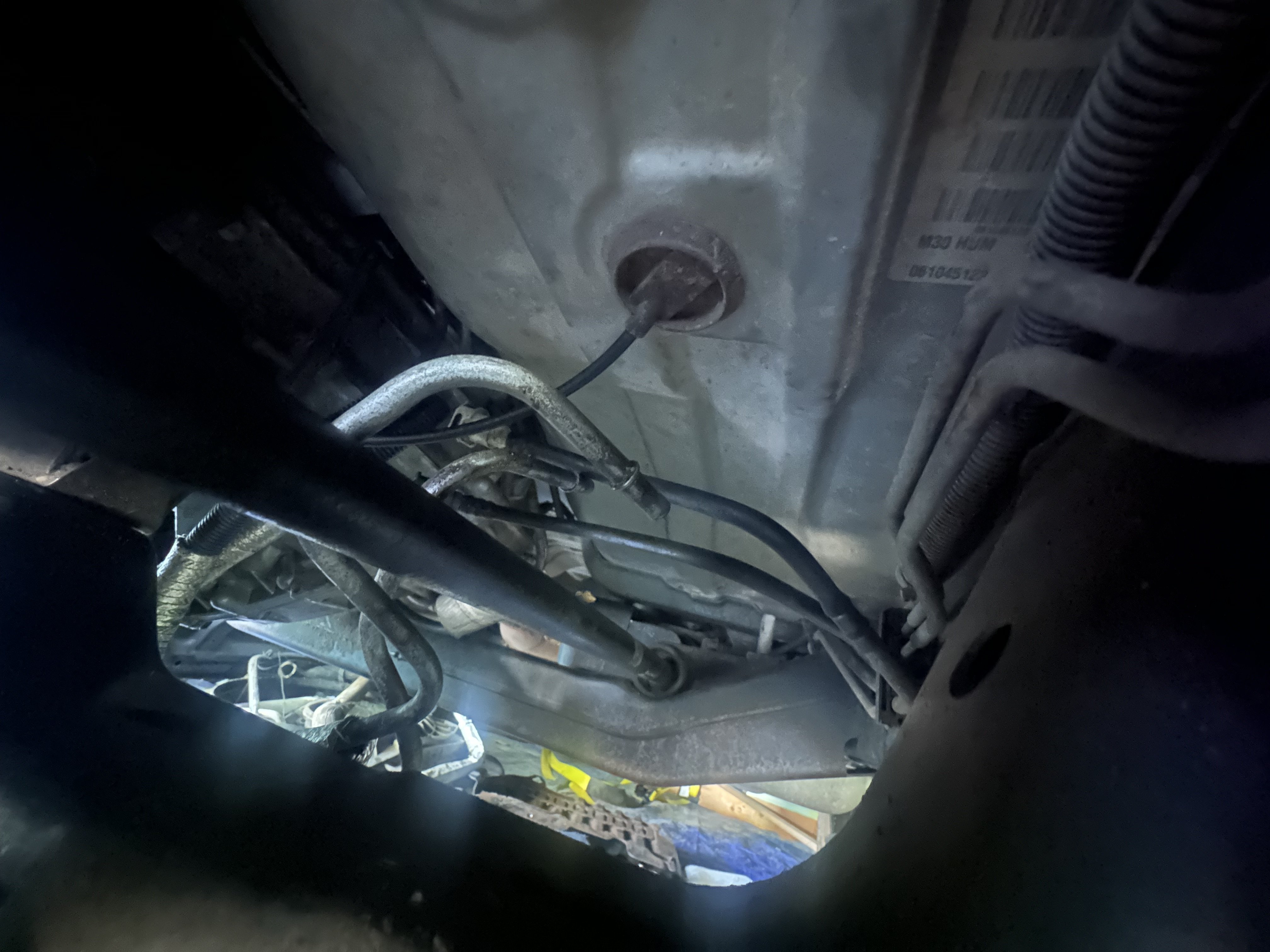

Very difficult to show but the lines run along the top of the transmission similar to how the old lines were run with roughly an extra 4-5” of clearance from the exhaust over the stock routing.

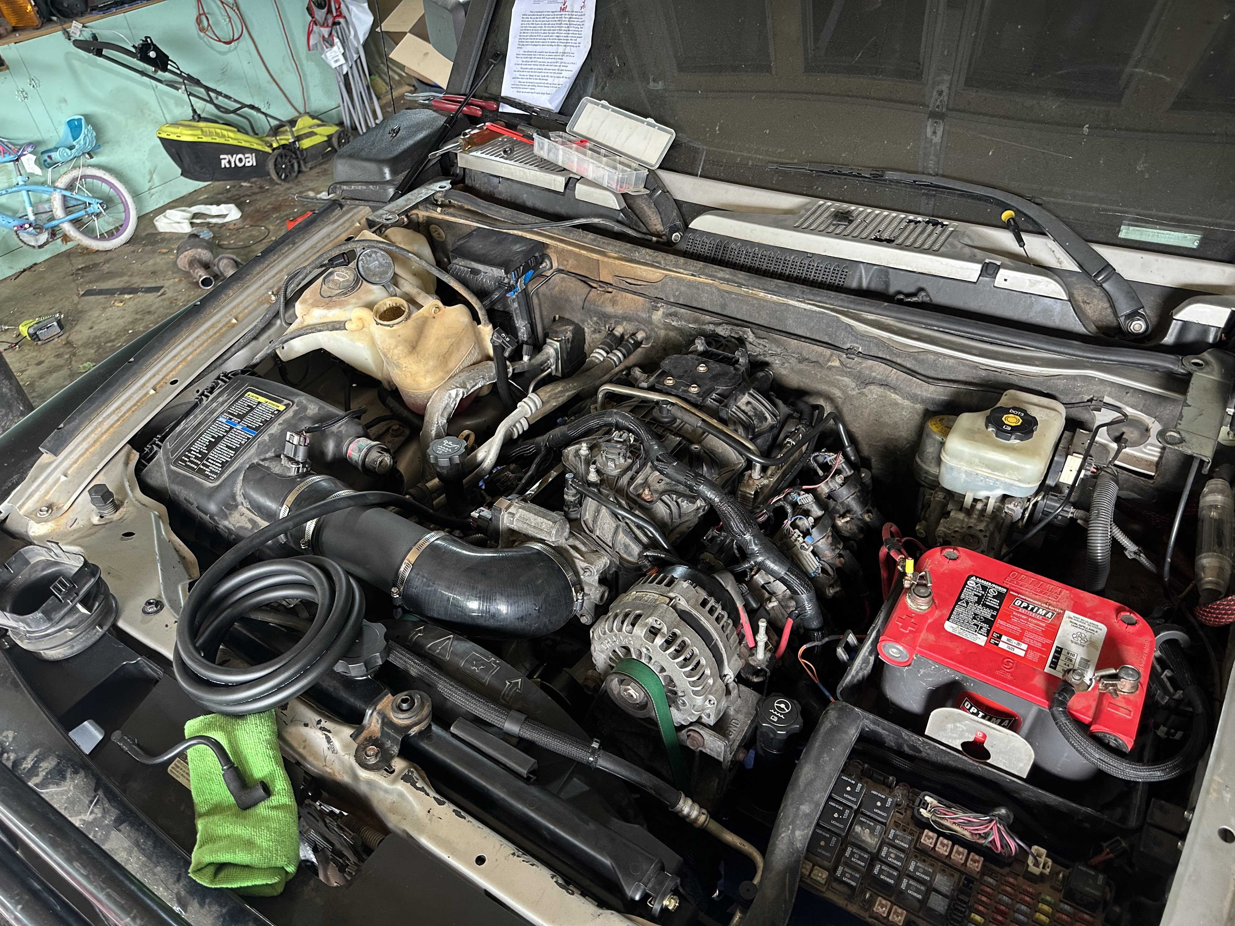

Got the transmission lines run and connected. Found this was easier than I was planning on it being after breaking off the drain funnel thing off the front cross member.
Got the radiator/condenser installed along with the fan shroud.
Got all the AC lines run and connected to their components.
Got coolant hoses all ran and connected.
The only reason I’m okay with connecting all the hoses is because I tested the motor before I pulled it. If there are issues it will be in the wiring which is all pretty easily accessible with the hoses and what not installed.

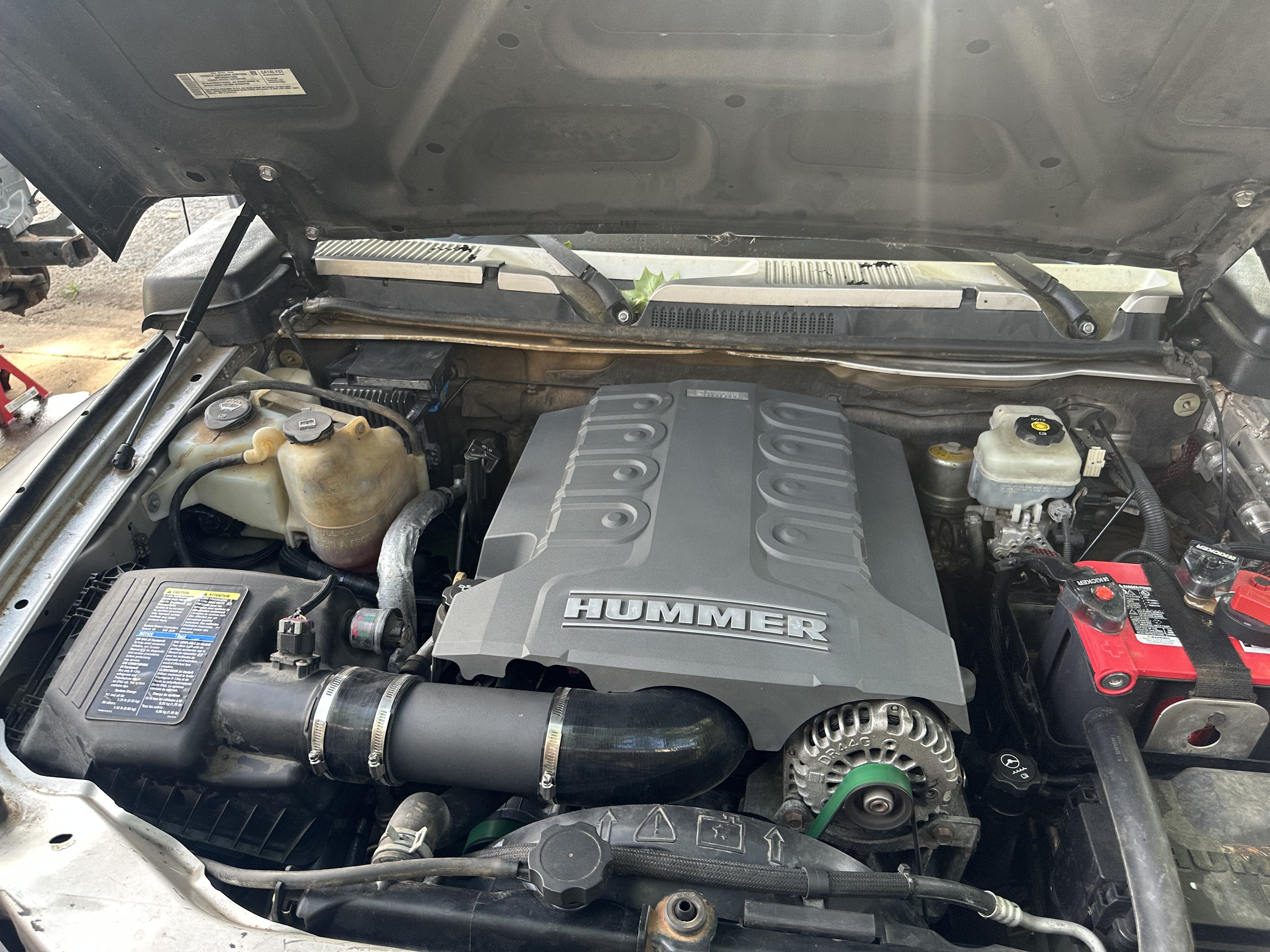

Started working on my intake system but realized I ordered the wrong elbow size so I need to order another elbow. I will need to cut roughly 2” off the aluminum tubing but I had planned on it needing some trimming. I did need to lop off the stud on the passenger fender since the box wouldn’t line up with it (my i5 box was broken) so I’m using the Alpha box. I’m happy to report everything else lines up perfectly and clears the shroud as intended. I will likely eventually drill a hole and throw a stud in the missing location since the box kind of “bounces” in its location.

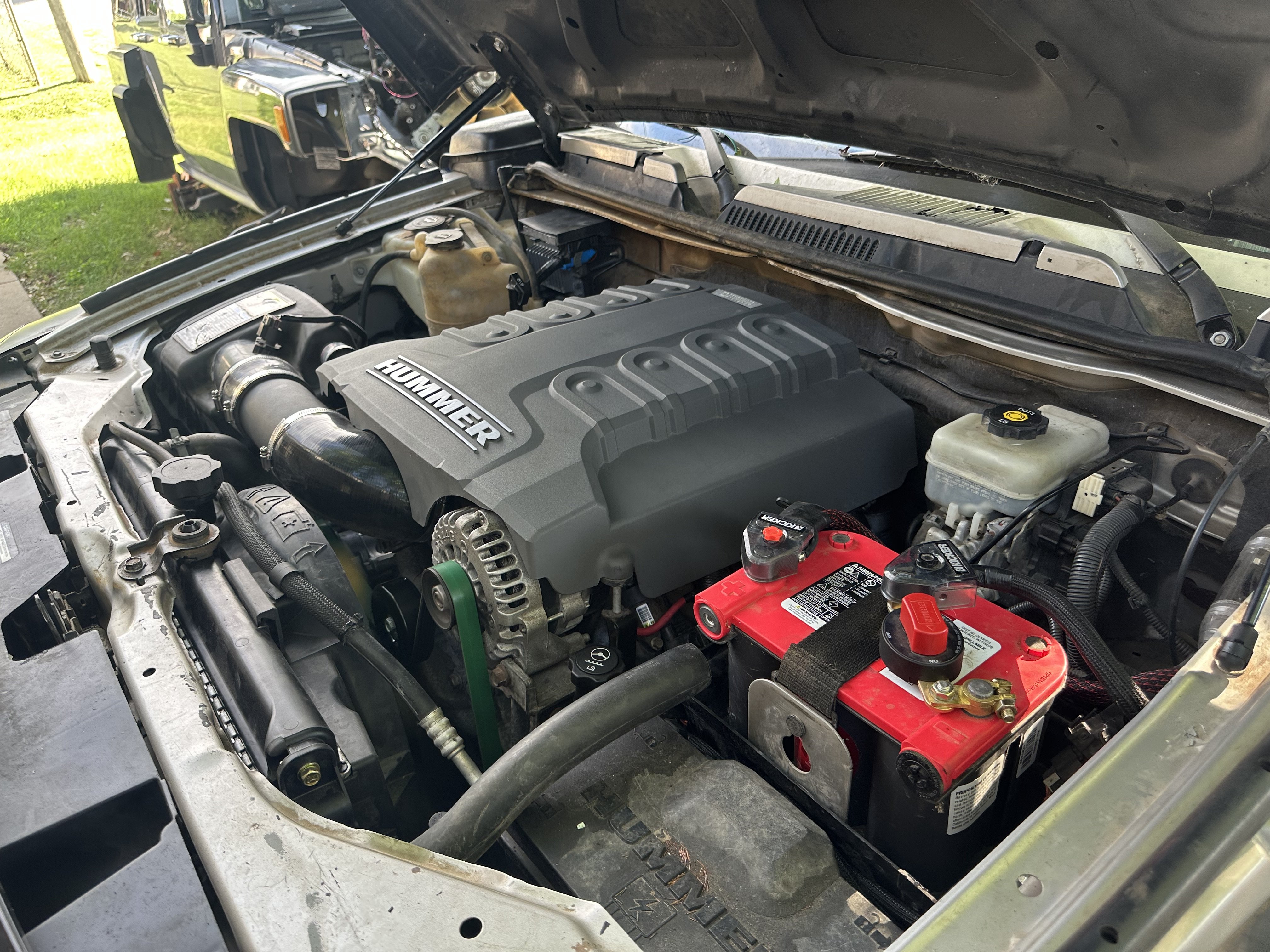

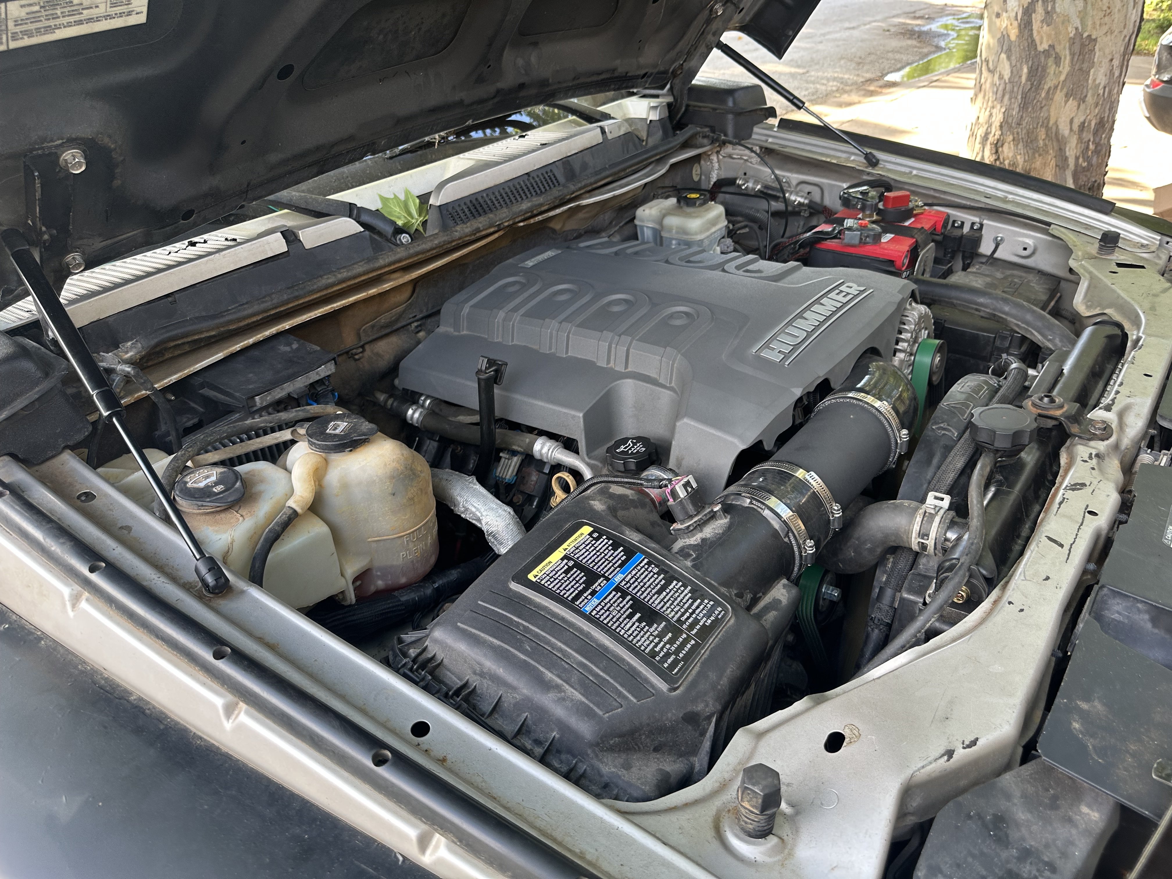

After this I kind of ran out of steam. So I threw on the engine cover and snapped one last picture as a little motivation for myself before shutting the doors for the evening

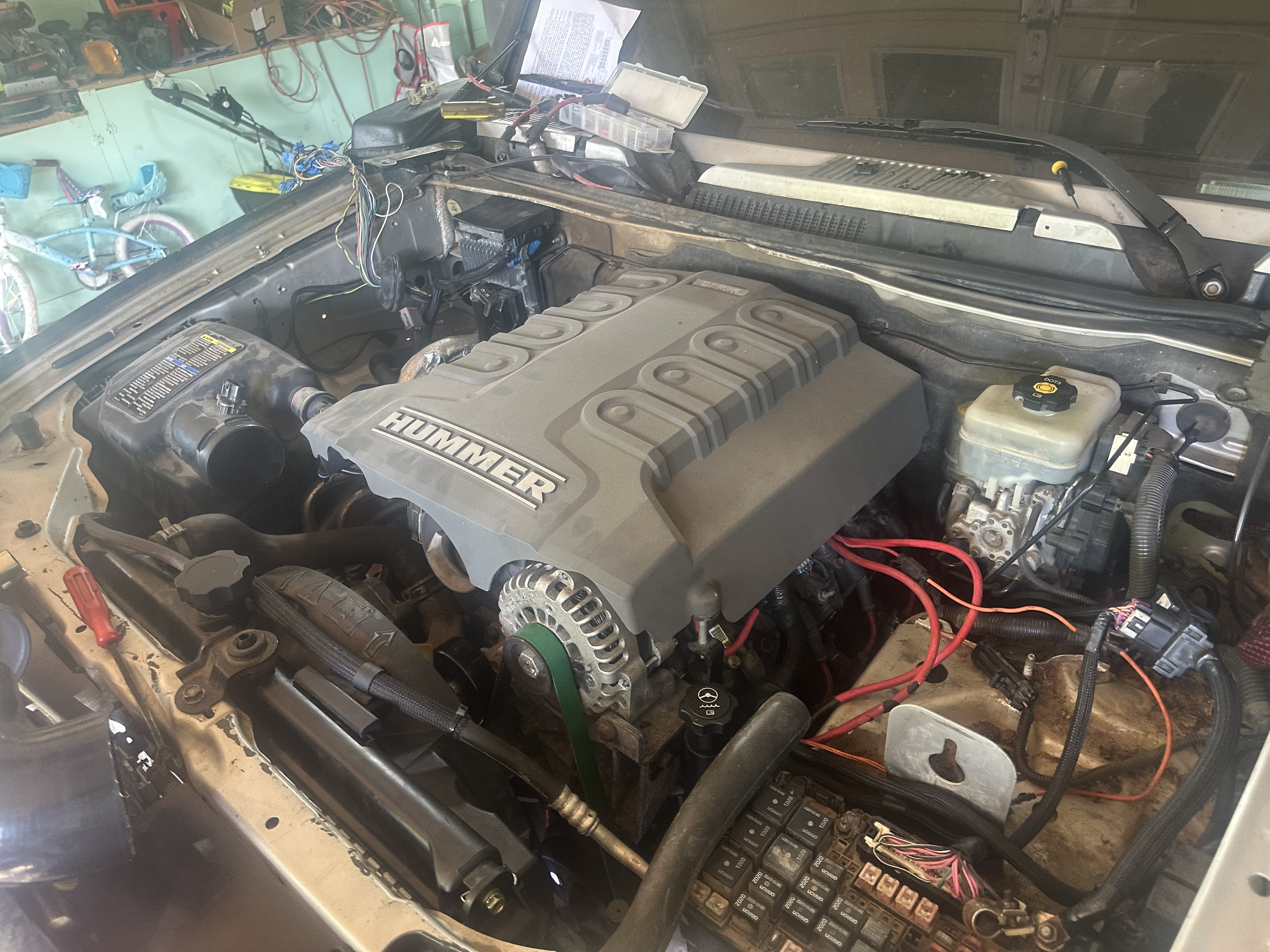

Set myself up to finish the wiring today.
Finished up the BCM plug and loomed everything up. Then I moved over to the driver side to get a couple loose wires tied up over there.
Jumped underneath the truck and tried snaking the exhaust through. After about 15 minutes with zero luck I chopped the exhaust off just in front of the secondary cat. I wasn’t planning on using the secondary cat anyways so no harm no foul. After I got both sides installed I threw the differential crossmember back in place along with the driveshafts.
At this point I was looking everything over to see what else I needed to do before trying a start up and realized the only other thing that needed work was the intake and filling up fluids, so I decided it was time and jumped inside.
Turned the key, and waited for the fuel pump to prime the lines, shut the key off and turned it back on again to re-prime then left the key on while looking underneath to make sure I didn’t see any fuel leaks from my line modification. My big concern was the exhaust is cut just in front of the fuel lines and obviously fire + fuel outside of an engine is no bueno. After about 5 minutes of casually watching and not seeing any fluid I jumped back in and turned the key. The motor cranked for about 2 seconds before firing right up!
I let it sit and idle (poorly) for about 30 seconds before jumping back inside to shut it off. Found some error messages for “reduced power” and “traction control system failed” along with the normal “change engine oil” message. I expected some error messages so this was not of any worry, but what was making me scratch my head was how poorly the engine ran, it had a bad misfire like a dead cylinder. Since I tested the motor before pulling it from the ‘08 I knew it must have been something simple. Spent all of 30 seconds looking things over before I found a plug wire had gotten pulled off the ignition coil on number 3. Plugged it back in, started it back up and ran smooth as silk.
I filled up the radiator with about 1.5 gallons of coolant with the engine running to burp the system. Temp rose to just barely above the half way mark, continued filling up the radiator after the system burped itself and dumped the remaining half gallon or so I had into the overflow tank.
All in all the engine ran for roughly 10-15 minutes while burning the oil off the exhaust manifolds. I sent a message to Jamie regarding the error messages I was getting and he gave me a couple wires to swap so I’ll try that tomorrow.

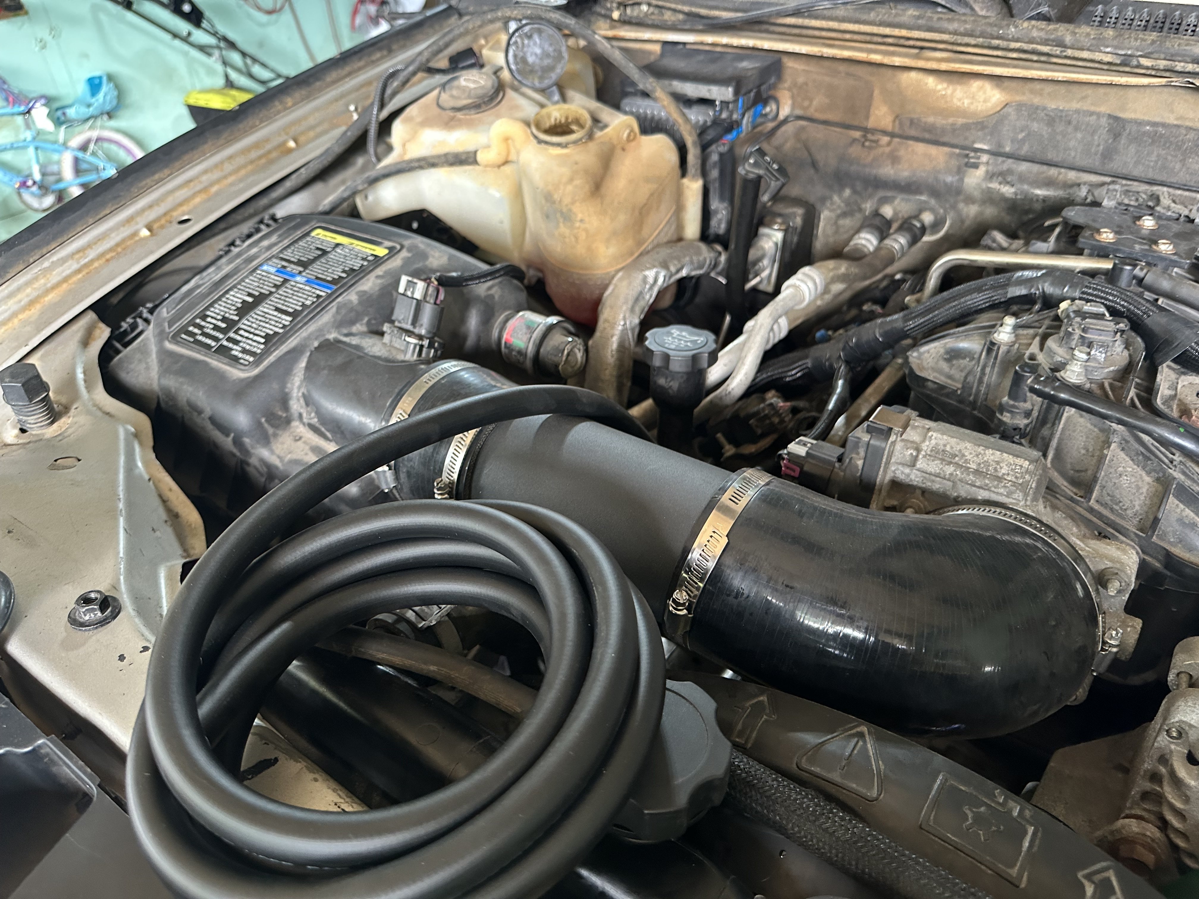

After making sure I had no fluids dripping I spent a bit of time working on my intake system since my new elbow showed up today. Got everything lined up and it clears the radiator fan by about 1/4”
Still need to run the 3/8” tubing for the vent and drill a hole in the pipe to accept the fitting but it looks good and everything clears. I think black hose clamps would have been a better look but oh well, can’t complain for $30 worth of parts from Amazon.

Pulled the intake pipe off and plastic welded the insert in for the PCV and cut the vent hose to length.

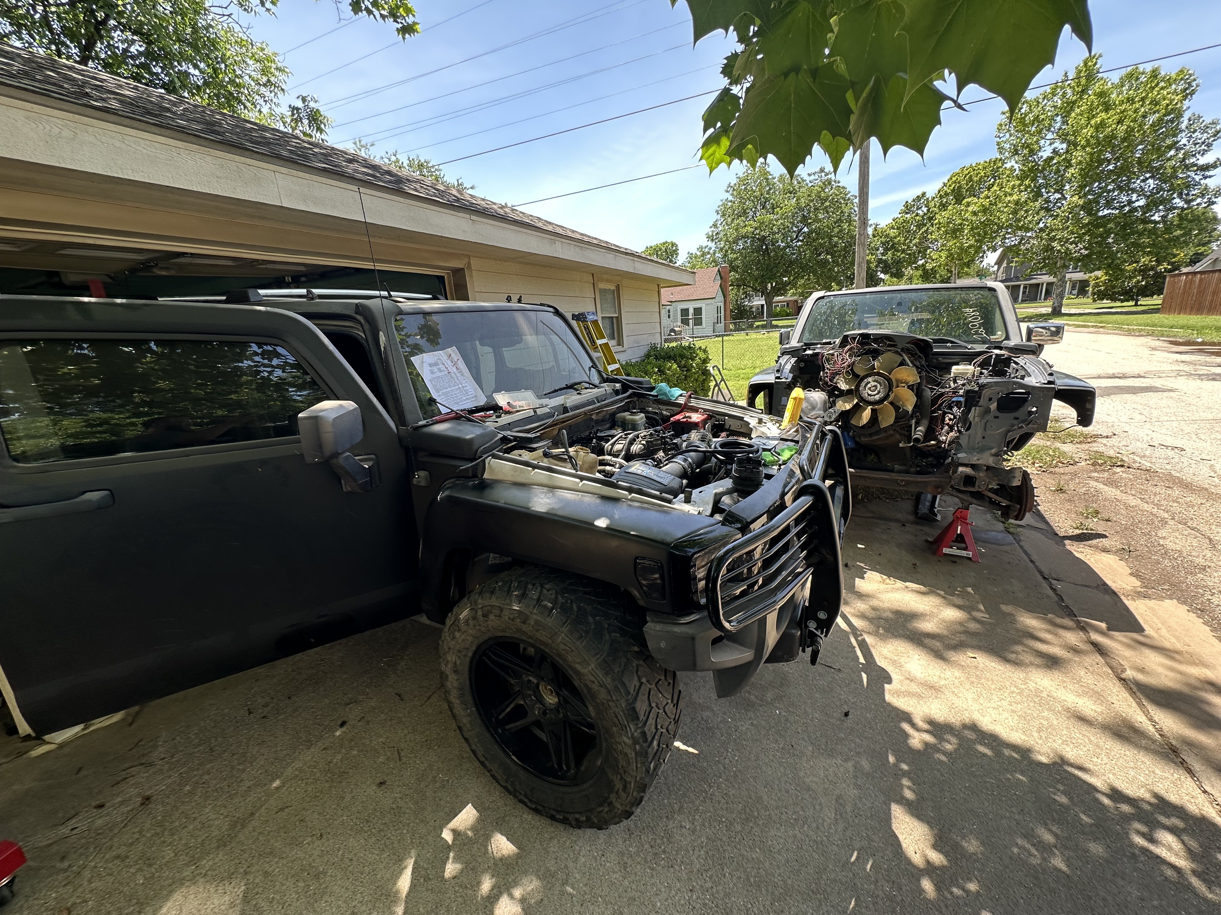

Well, a little behind schedule but the H3 is back at my place now!
Had to wait a few extra days to get a ride from my place to the ex’s where the truck has been sitting (about 45 minutes one way).
Drove great all the way, and boy what a difference with the 3 extra cylinders when trying to get on the highway! Don’t get me wrong, the H3 is still a fat pig, but at least now when you’re trying to get across a 2 way stop you don’t have to worry about making it across an intersection in time!

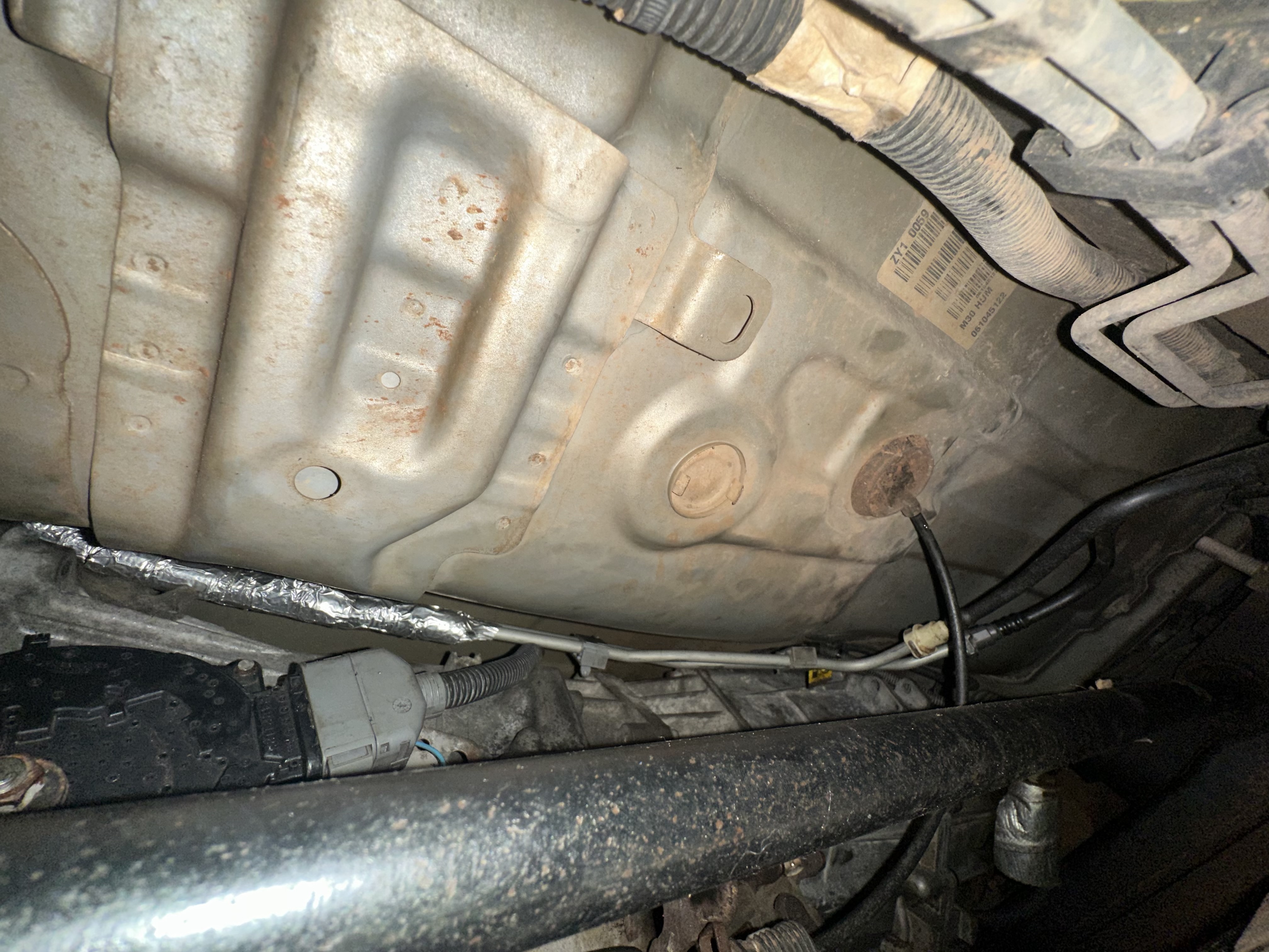

Ended up wrapping the fuel line connector above the exhaust cut off with some heat tape until I can get it over to the exhaust shop to have the duals run, and get some exhaust wrap on the pipe. Might see if I can get it over to the exhaust shop tomorrow to have them knock it out. Going with a Flowmaster 40 series with dual black tips

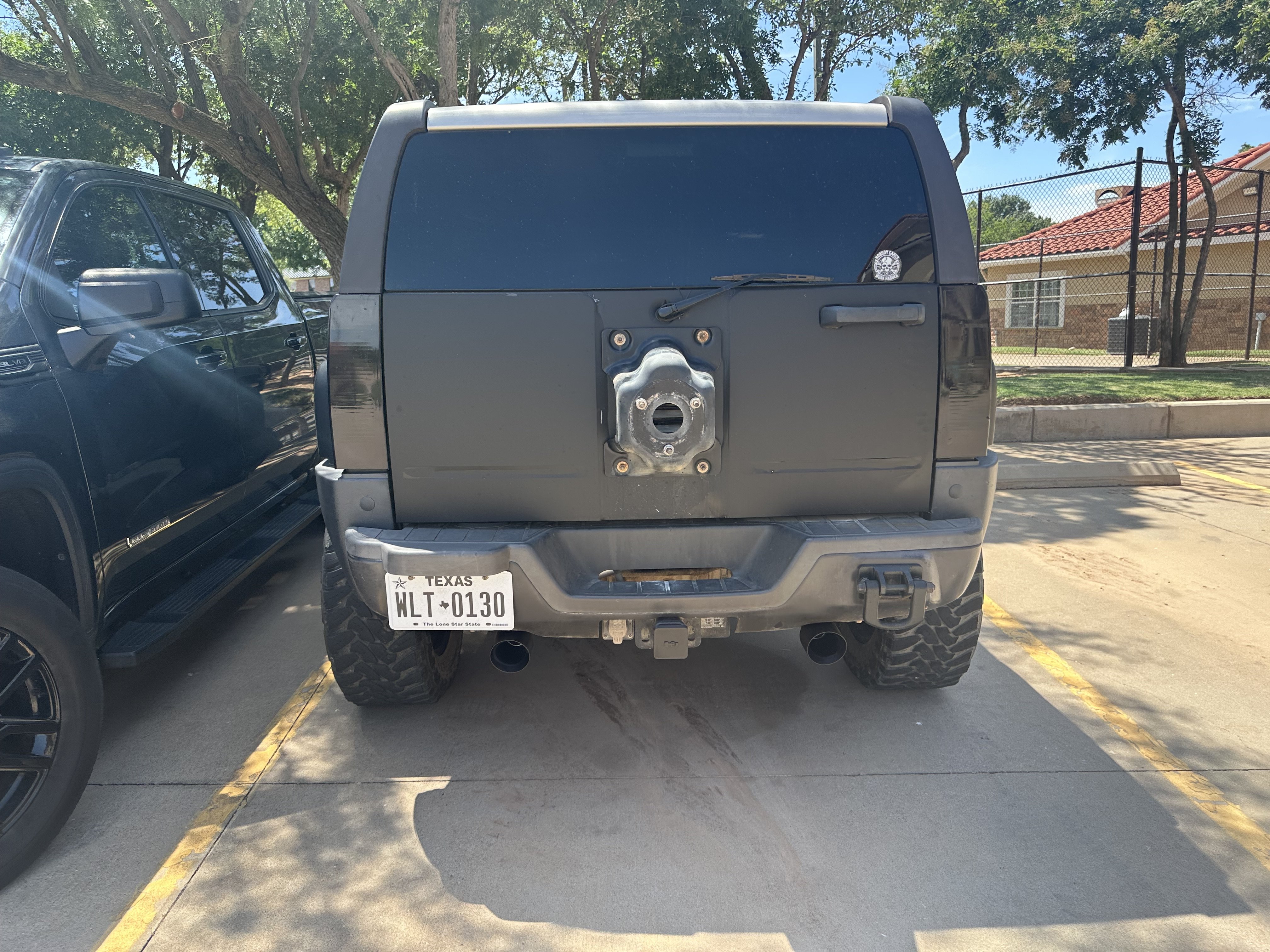

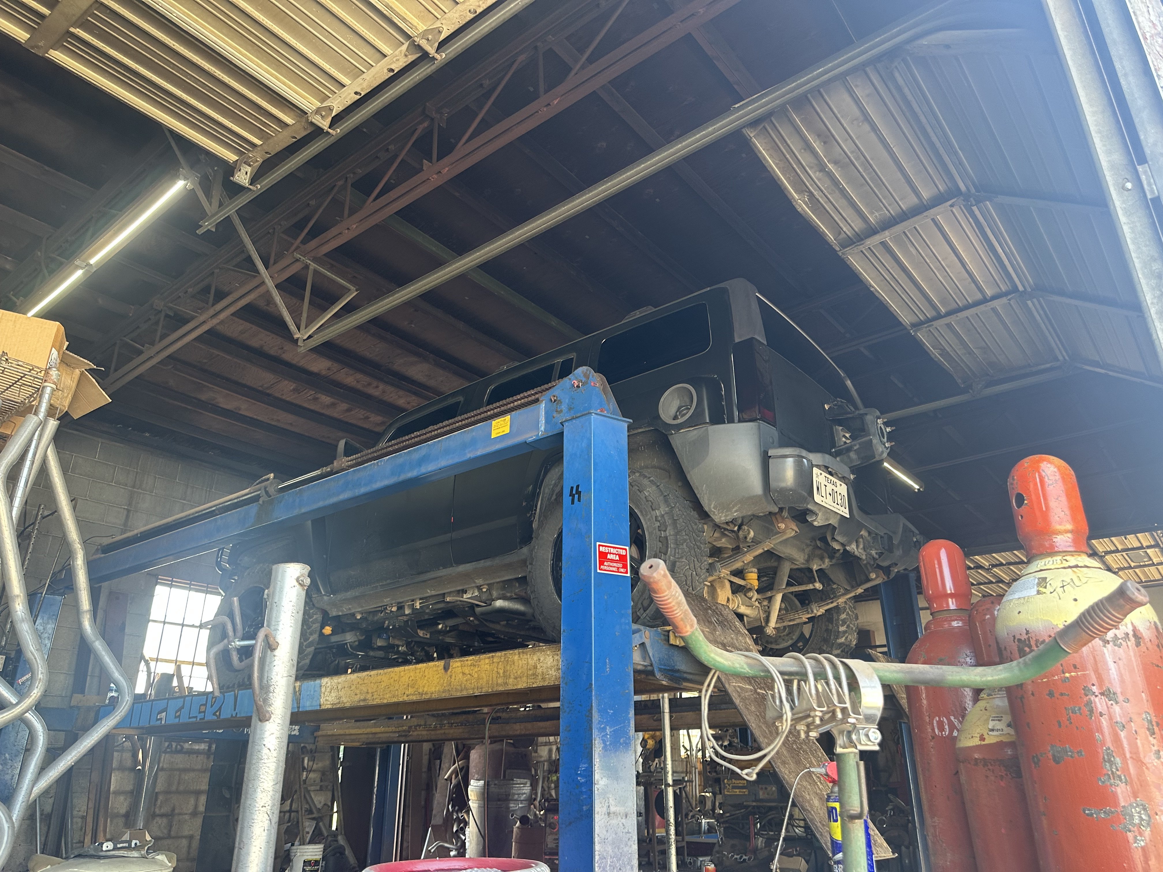

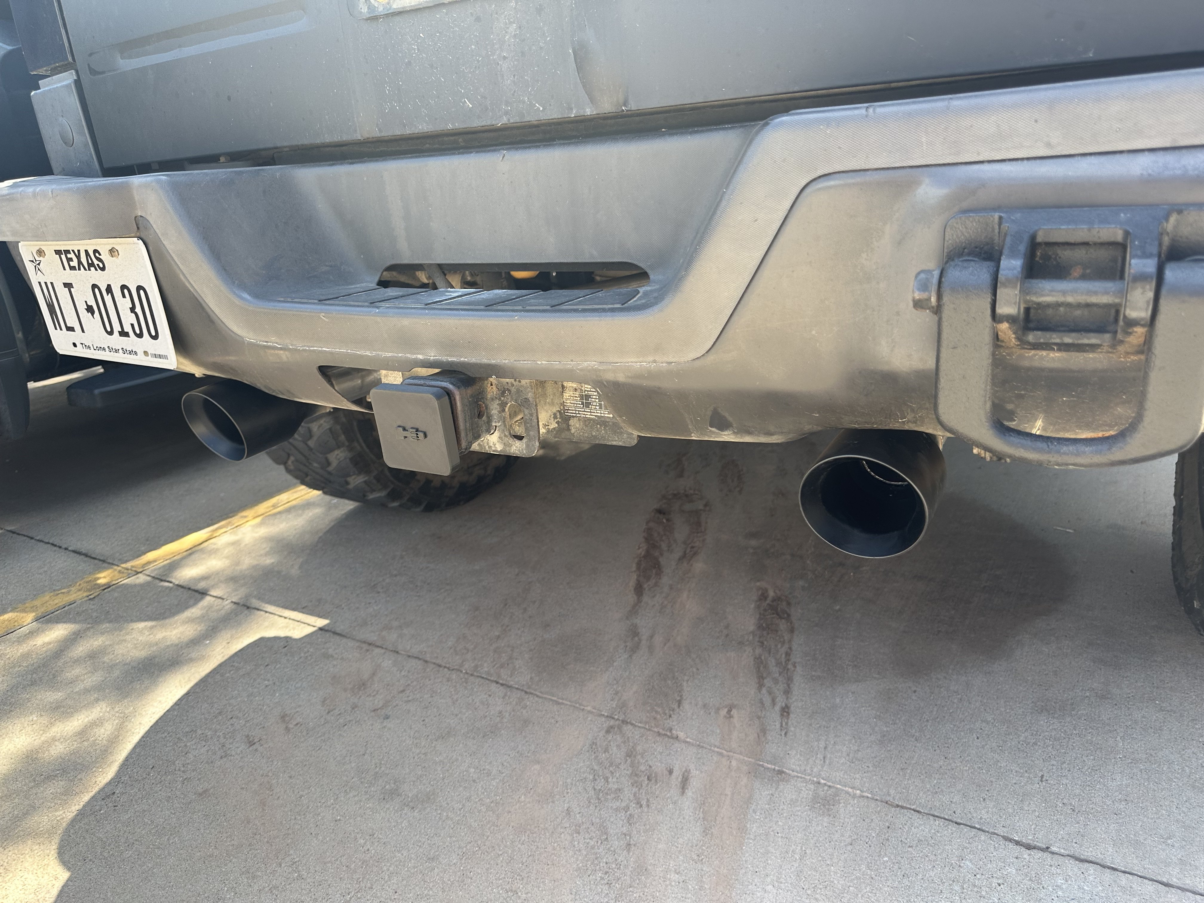

Exhaust is 95% finished. The tips I had the shop order didn’t end up showing up but they ran the piping - dual in into flowmaster 40 series with dual straight out at the bumper. 3.5” black tips will hopefully arrive within the next day or two and I’ll swing back by for them to slap them in. Sound is much more manageable than the essentially open headers it was running before but still has a good growl while driving.

Tips arrived today. Unfortunately they weren’t quite what I wanted ordered but after hanging them up for a test look I actually liked how they look so I had the shop zip them on and call it a day. They look slightly big right now but I think once I get a spare mounted they will look more appropriately sized.

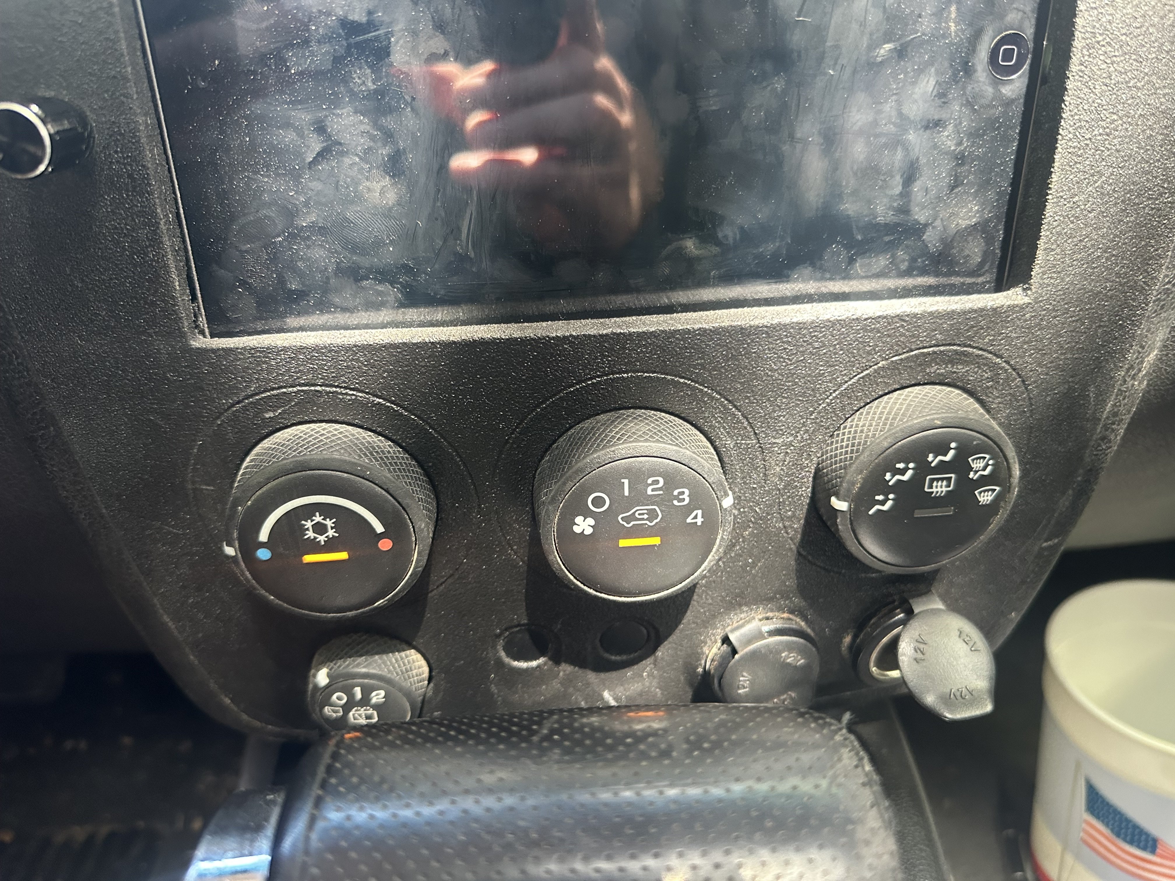

The H3 has never had the 4th fan speed for as long as I’ve had it and I just kind of tolerated it. I tried swapping out the HVAC head unit with one from the Alpha with zero change, next I moved onto swapping the resistor at the fan, again, no fix - however as I was pulling out the old resistor it fell apart in my hand so it was certainly needed. I pulled the jumper harness from the Alpha and plugged everything in and now I have full fan speed again! I checked the jumper harness from the 06 and didn’t see any shorts anywhere, nor did it have the burned terminal at the resistor but there must have been a break somewhere in the wiring.
Problem 2 - possibly resolved after tomorrow
As others have mentioned and is well documented I also have no temperature control with the switch. It’s either full A/C or full heat, nothing between. Tried to swap the head unit (did this during resolution of problem 1) and no change even after recalibration so I ordered a 50 pack of resistors - I miss radio shack where you could buy a single resistor - resistors will be here tomorrow and will hopefully resolve that issue.

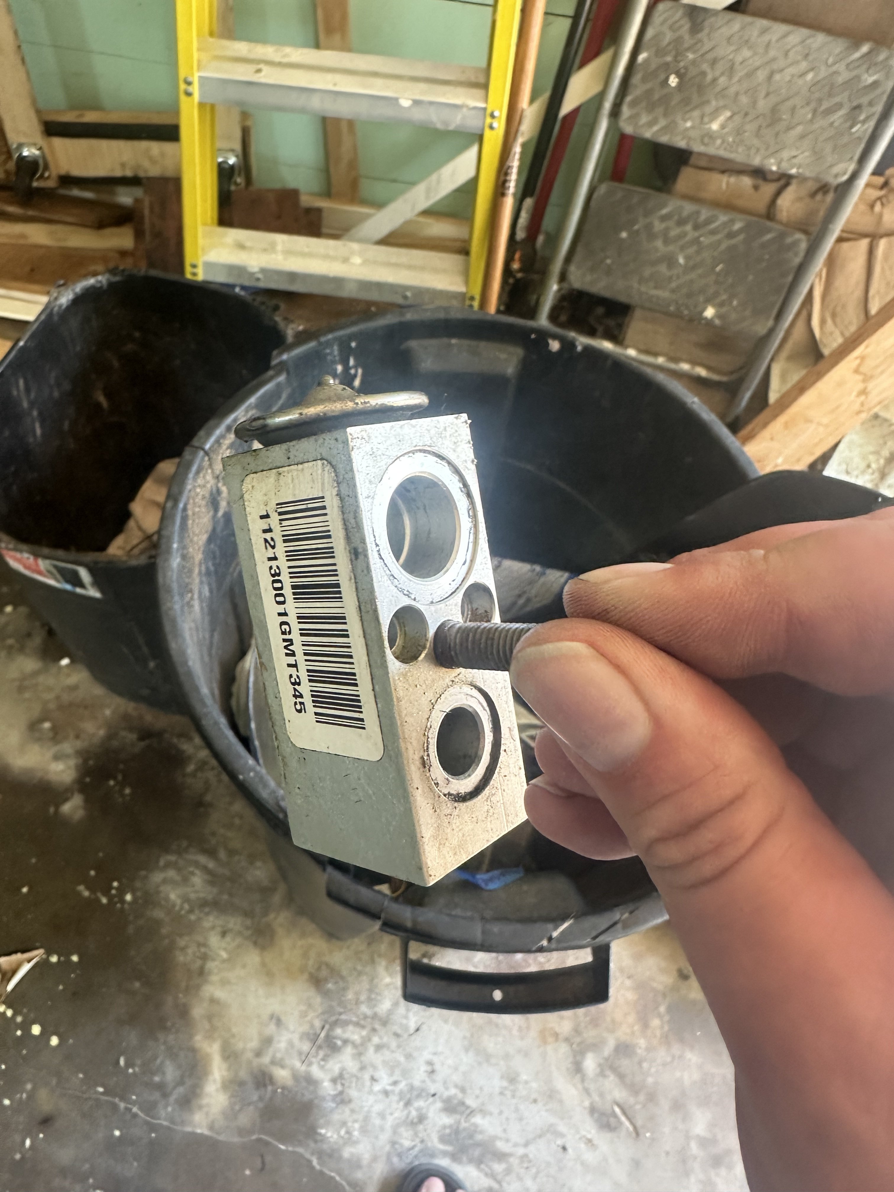

I had previously charged the AC after the swap using an add-a-can system for temporary support but was still getting only cool air, even on max AC. I figured maybe a little low or high on Freon so I went by my old boss’ shop on Wednesday and had him do an evac & recharge on the new system with the proper amount getting put in. I had this issue previously before the swap and just figured it was from a leak in the condenser during the swap I replaced the condenser and all the line o-rings. After the recharge the inside temp again was cool but not cold (checked this while in the shop with the lines still hooked up). Checked for leaks with dye and black light and found none inside the engine bay. Compressor turns on and off as it’s supposed to, lines get cold and have condensation forming on them but the air is cool at best. On max A/C it’s maybe 10-20* cooler on a good day. I’m thinking maybe expansion valve but I’d rather be sure before loosing all that Freon and needing to do another evac and recharge, even if he didn’t charge me anything for it. Unfortunately there’s not really a way to easily test an expansion valve. If anyone else has any “try this first” ideas I’m all ears.

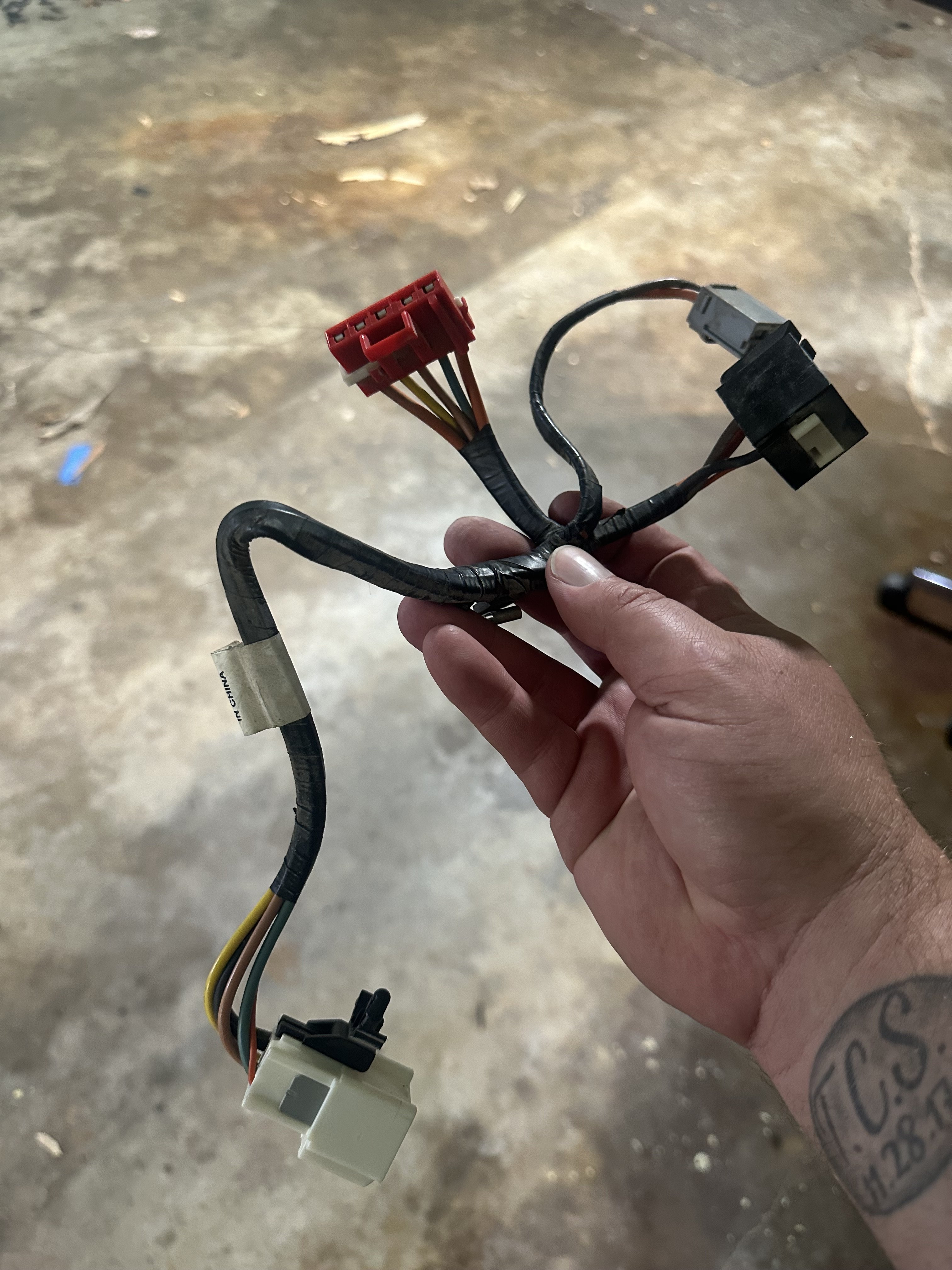

Did the resistor install this morning.
Now the temp adjusts as it should
Problem 2 solved

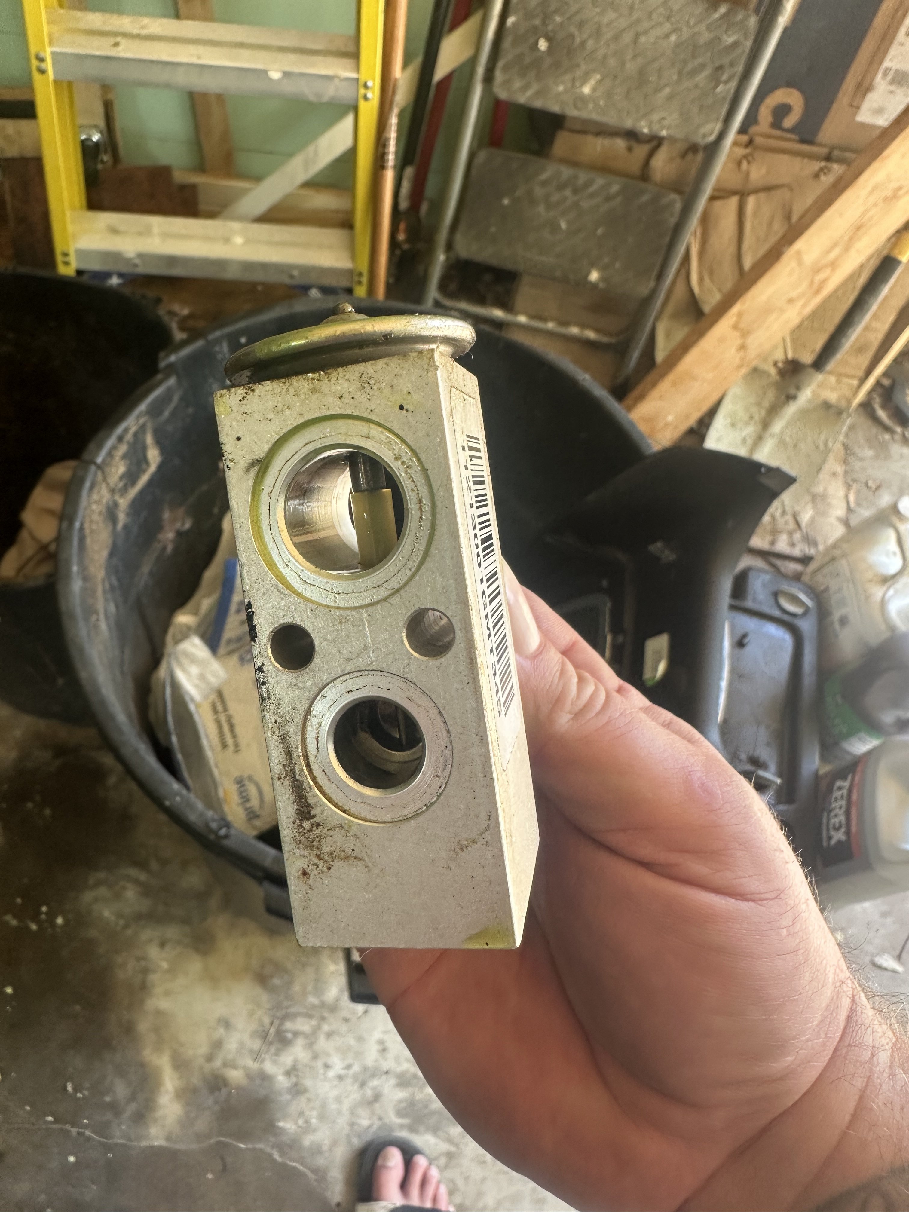

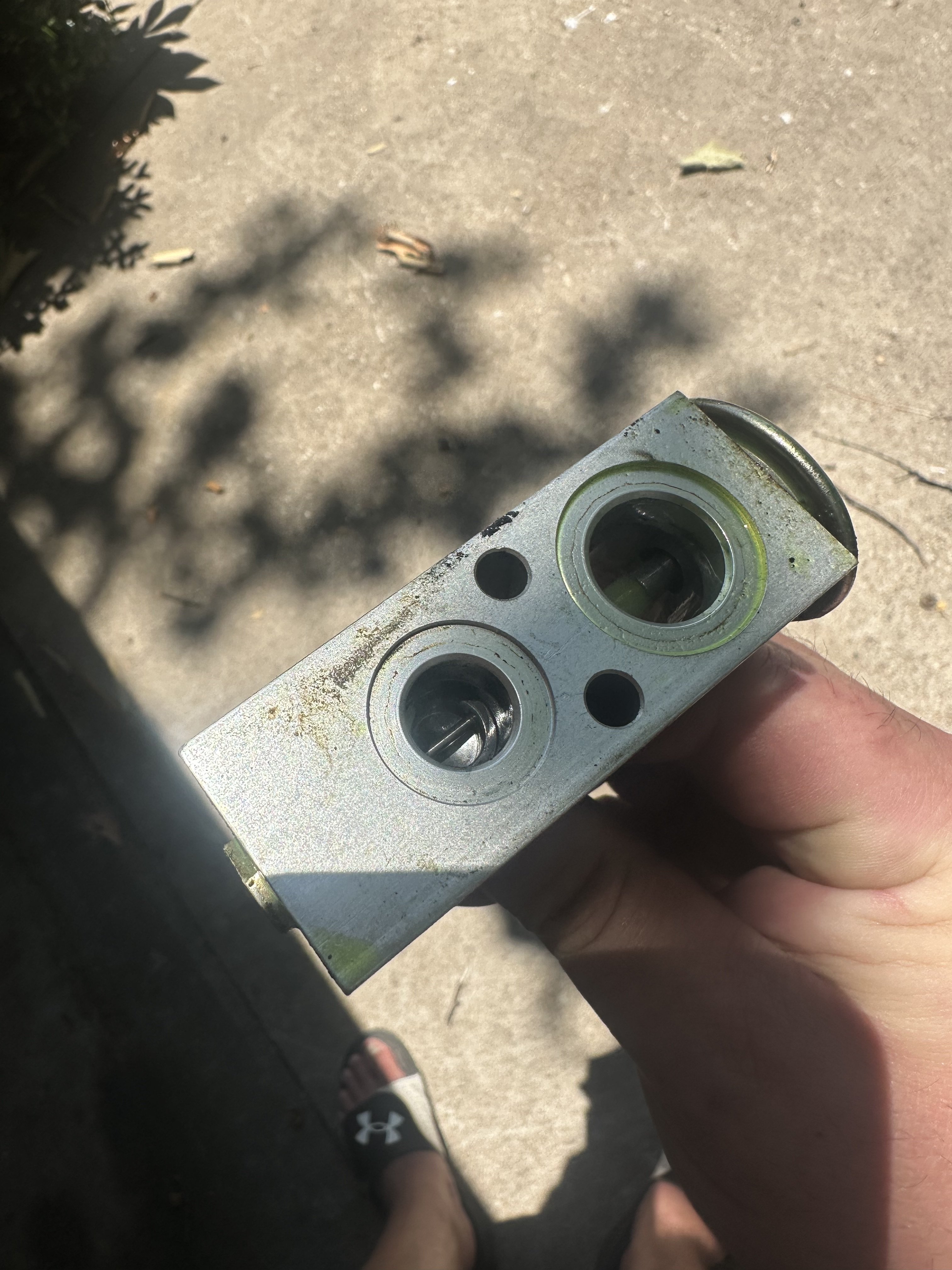

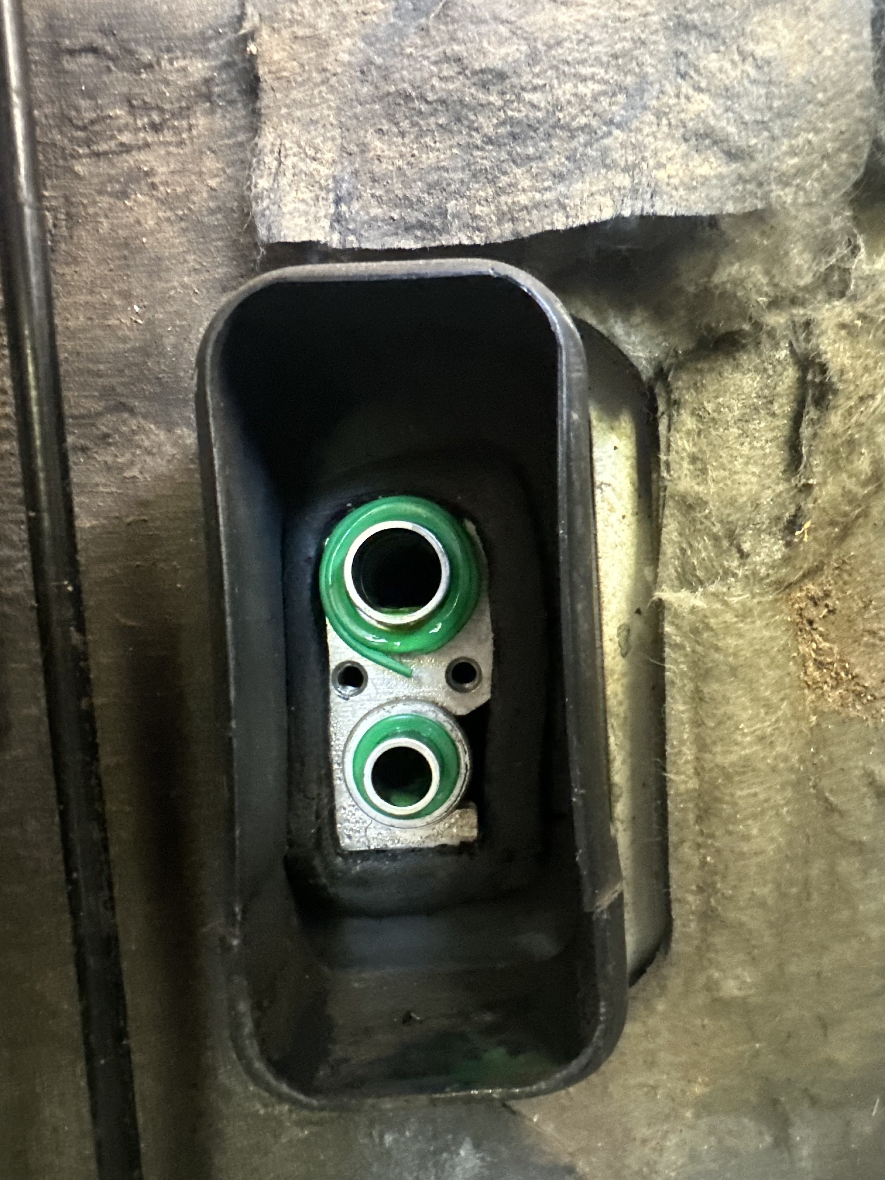

Replaced the expansion valve and used an add a can to check. Can see some grime in the high side port but nothing screaming obvious for reasoning for failure.
AC blows nice and cold now! Still need to take it back to my old boss’ body shop and have the levels corrected.

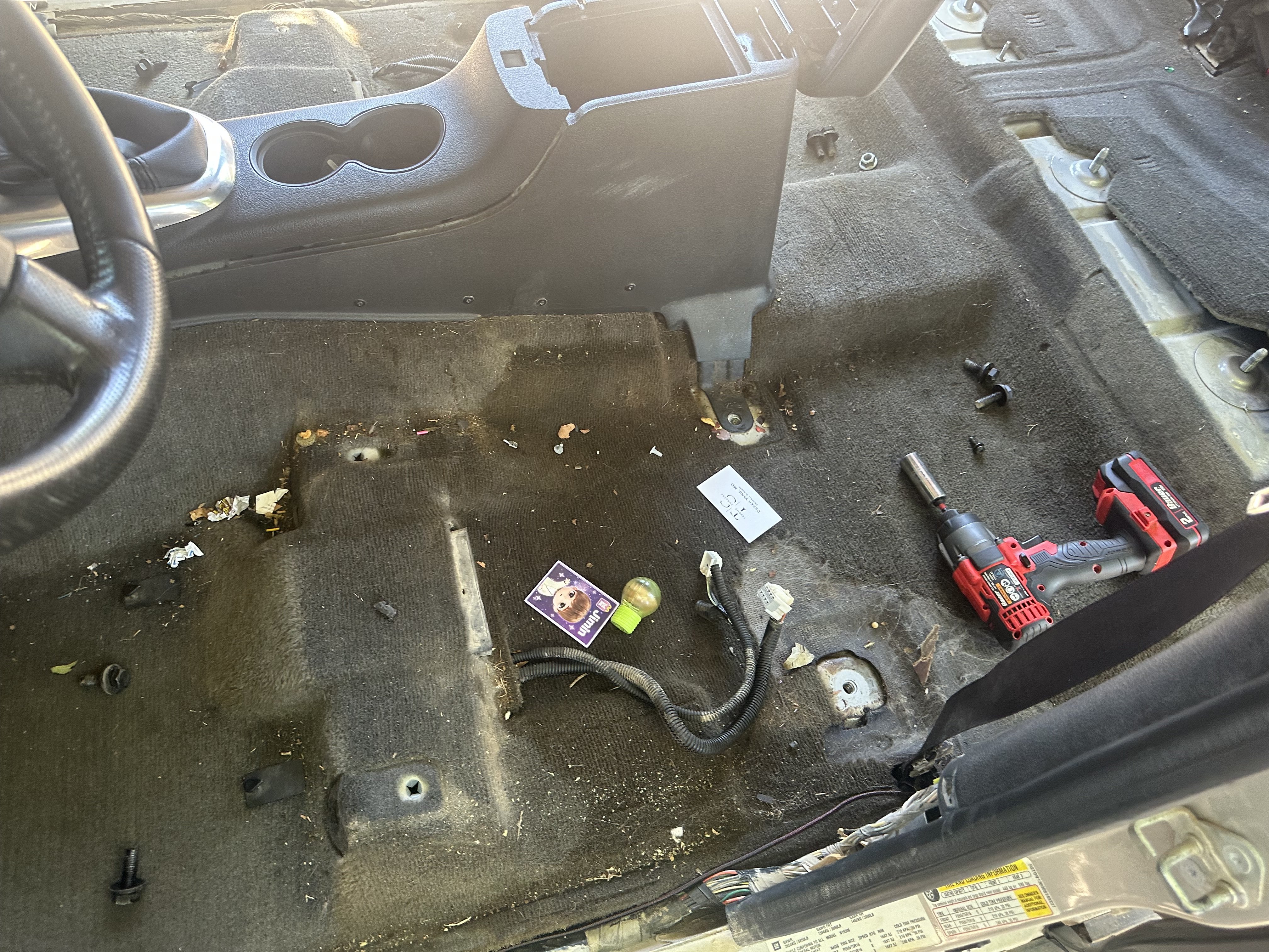

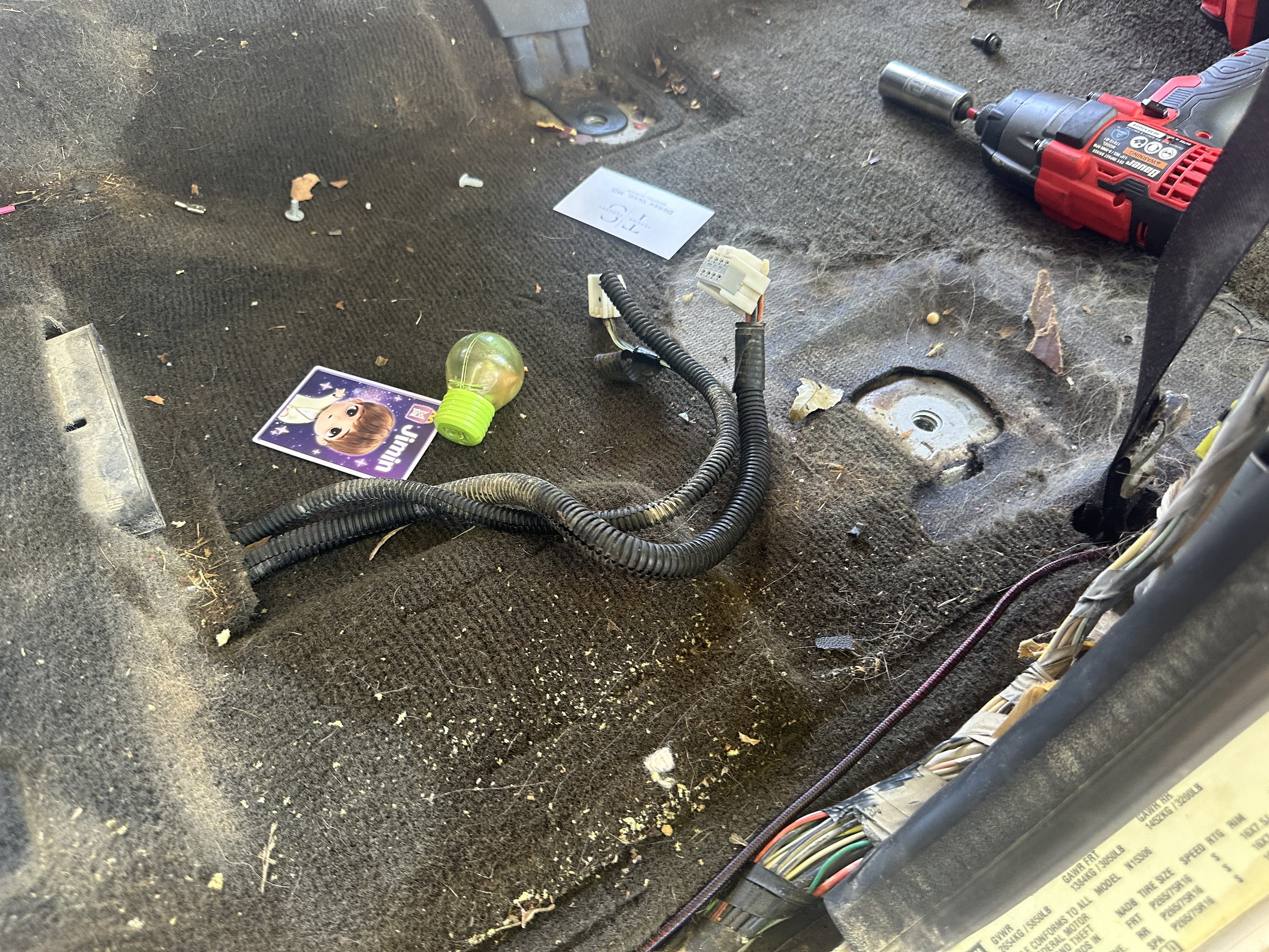

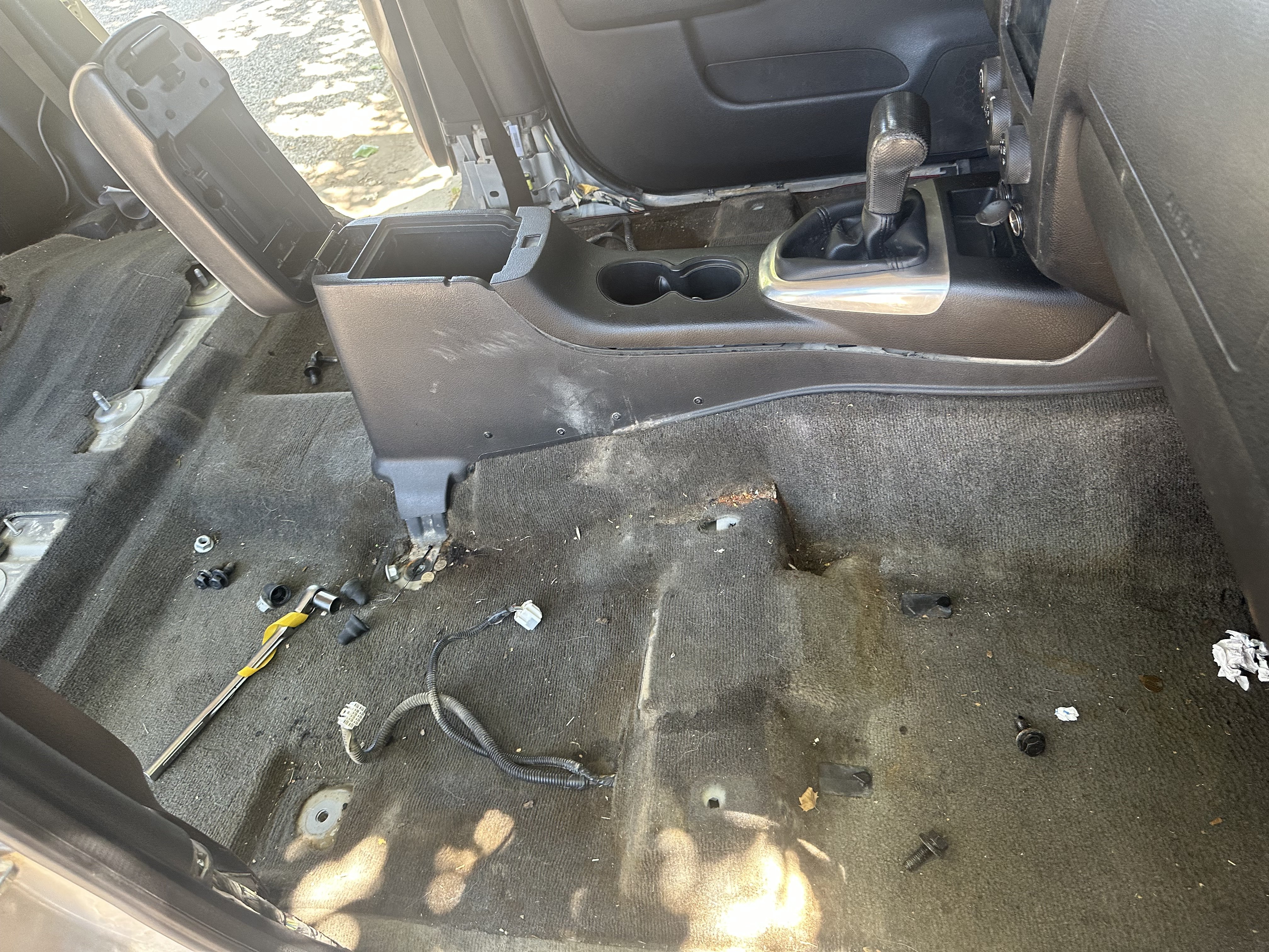

Well today my helper and I got down to work on getting the carpet replaced and some sound deadening laid down.
After getting the seats out it was clear just how bad the old carpet was. Contrary to what the pictures show I do actually try to keep the carpet relatively clean 😂
Lots of staining throughout under the seat locations and on the driver side it looks like someone took a set of clippers and shaved the carpet down for some reason.

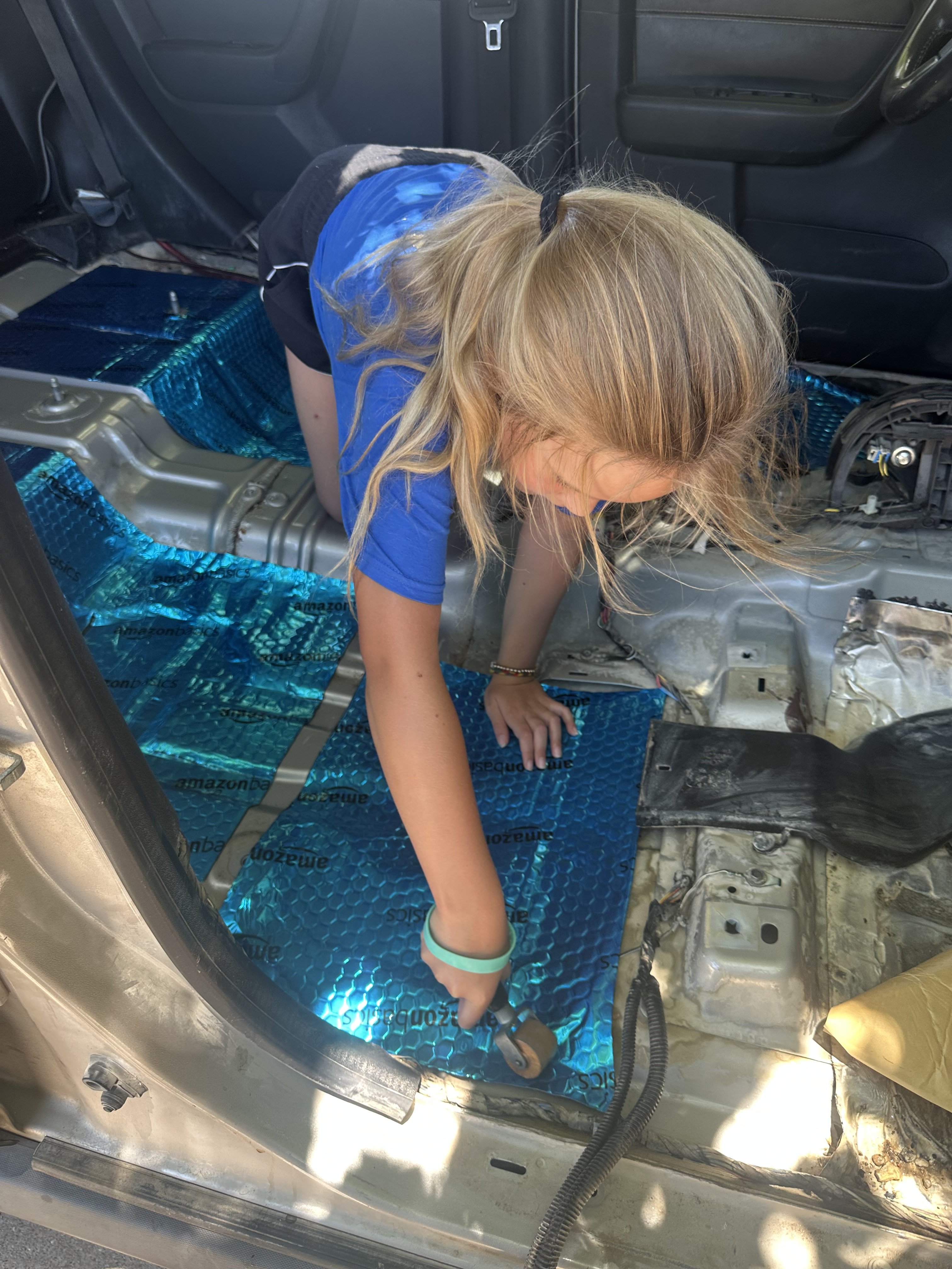

Once the old carpet was out we got to work laying down the sound deadening. Child labor is a huge win!
After we got a moderate layer of sound deadening down we dropped the carpet in and laid back to enjoy our work and listen to some music.

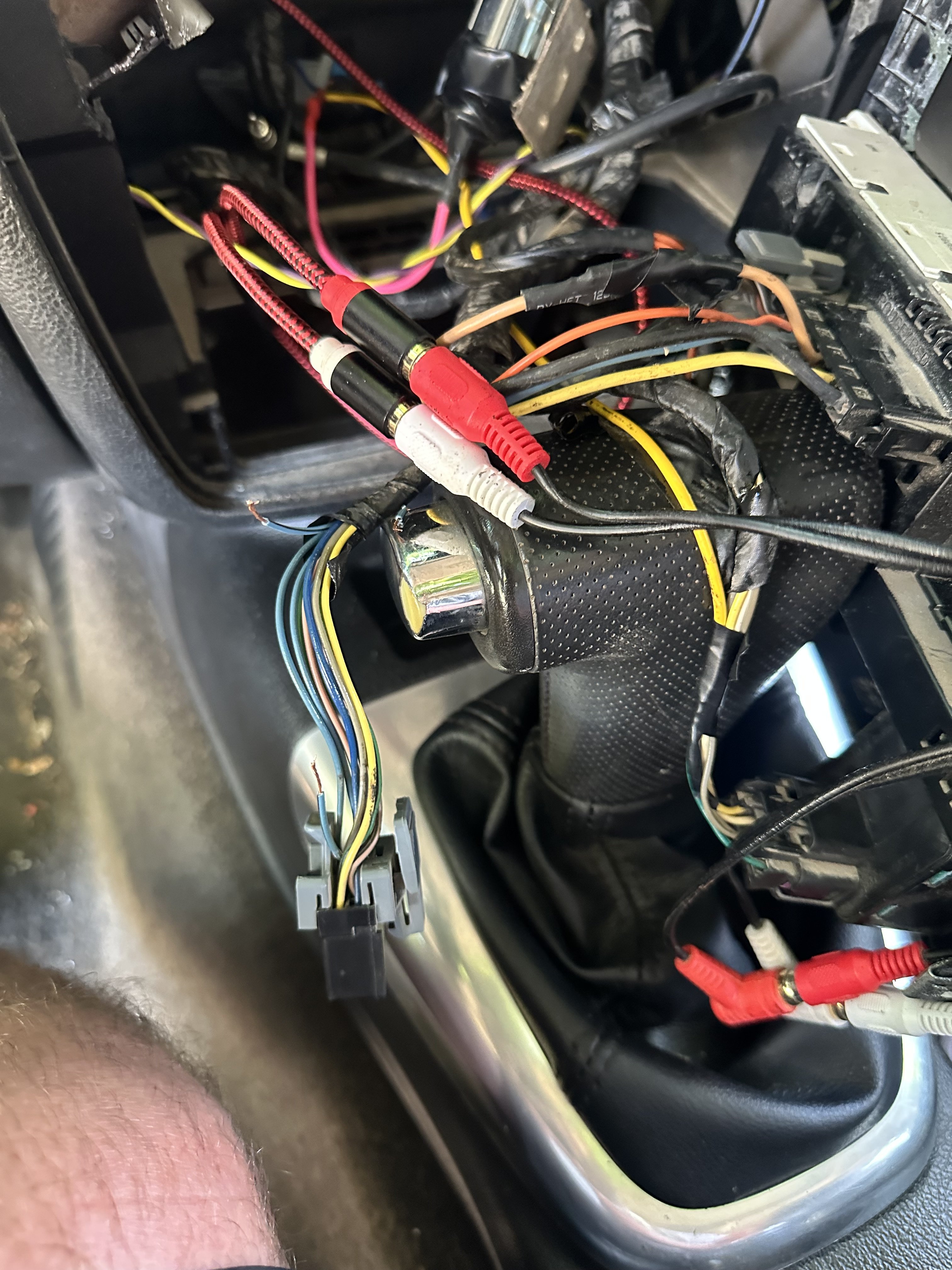

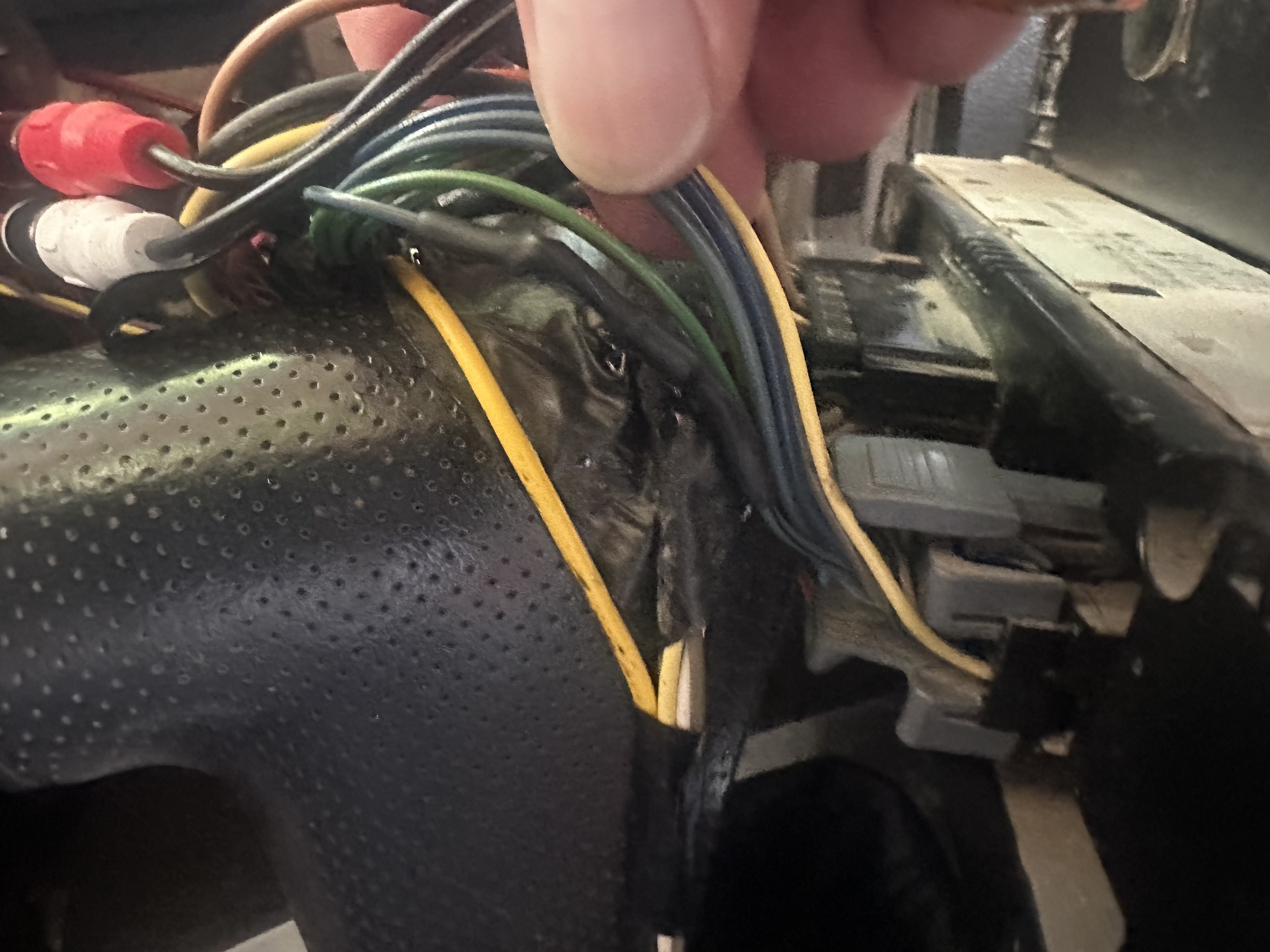

Threw the Alpha seats in and plugged them in just to find that resulted in an airbag light. I knew the Colorado guys had to swap harnesses but I figured H3 seats to H3 would be just a plug and play situation, I was mistaken obviously. Ended up throwing the 06 seats back in for the day since we were again dealing with 100*+ weather and regroup with another plan.
I’d really prefer to not rip out and swap the harnesses since I had plans of selling the 06 seats, however if that’s the option then I guess that’s the option and I can try to put the 08 harnesses in the 06 seats, however I’d much prefer to just re-pin a few wires at the connector if possible.

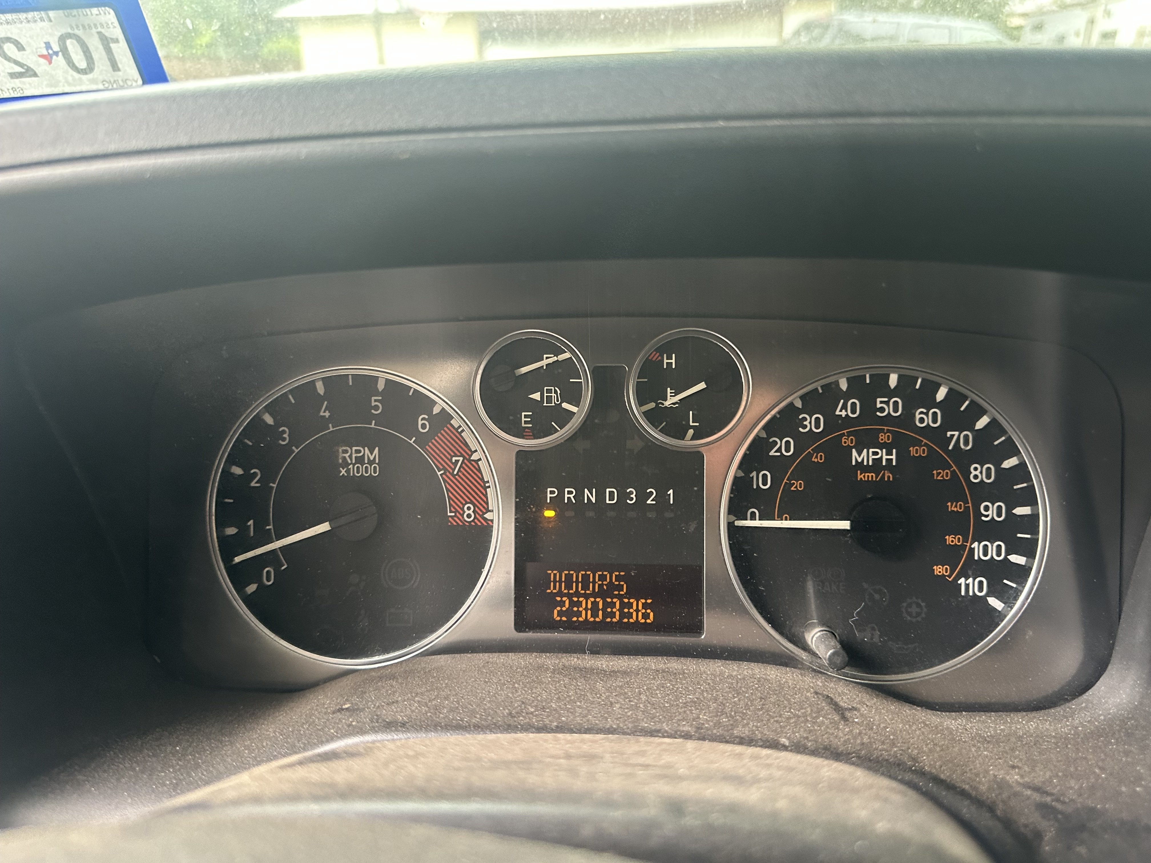

I’ve put roughly 1000 miles on the truck at this point and I’ve noticed my A/C has been getting warmer and warmer. I previously replaced the expansion valve which certainly made it better but after doing some actual diagnostics on it the compressor won’t cycle off. After swapping the relay and checking a few fuses, I hoped it was just the pressure switch so smalls assisted me with swapping that out this morning -

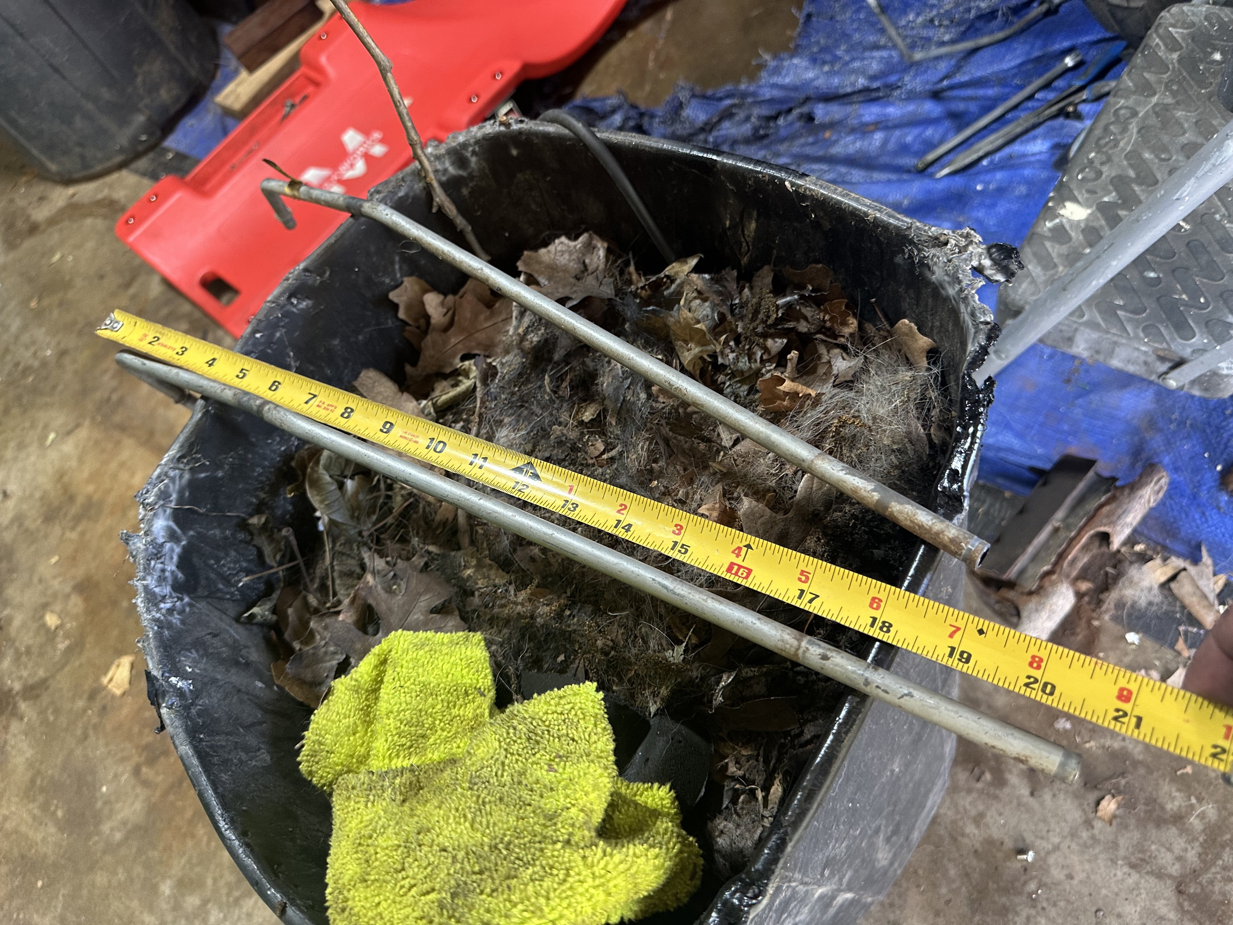

Unfortunately when I pulled the lines I also saw a bunch of trash inside the line implying the compressor is failing. I had figured this was my issue a few weeks ago and ordered a replacement compressor I planned on getting swapped yesterday. After pulling the intake box off and figuring out my process I’m left scratching my head to get the compressor out/in. There really isn’t much room around the compressor and Google is less than helpful with direction of removal. The only thing I could find was for the i5 version which makes sense as they’re more common. I might be able to snake it around the coolant lines going to the firewall but it looks like it’s going to be a very tight fit if that’s the case. If anyone else has done this it would be nice to confirm if that’s the correct path prior to opening up my coolant system. The only other way I can see it working is by pulling the radiator/condenser.
