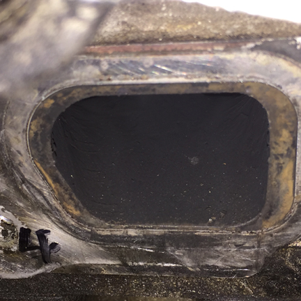

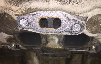

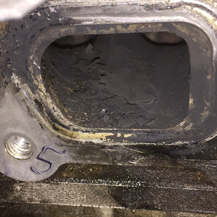

Well here I am back. Finally got the two broken exhaust manifold bolts out (very front one and the very rear one) that the last guy decided he would just say the heck with it and put on TWO gaskets.
I am attaching a couple of photos of the 5 cylinders and the "vacuum something or another" in hopes someone can tell me what is going on with #5 (rear of engine next to firewall).
Have not attached the Magnaflow header with cat yet but did install ZenonPro.com's Bi-Xenon HID kit. Haven't had a chance yet to turn them on as the battery is completely out of my H3T. I did take a lot of photos so will post those along with some narrative when I get the beast running again.
As can be seen, there is a lot of "crap" in the #5 cylinder. I am hoping someone can tell me what is going on there. Also in the "vacuum something or another" there is some more gunk. Explanation from anyone as to what that is would also be appreciated.
Thanks in advance for any help.

Ex Cylinder 1.JPGEx Cylinder 2.JPGEx Cylinder 3.JPGEx Cylinder 4.jpgEx Cylinder 5.jpgVacuum Something.jpg

Those ports look perfectly normal for 117k miles. Grab a shop-vac and a cordless drill. Hit the ports with small wire wheels and/or cones and try to clean them up...but honestly that all looks good to me. I'de go easy using a gasket scraper since you're dealing with aluminum...a wire wheel works better and you won't be prone to gouging the gasket surfaces. That #5 exhaust port definitely has some more build-up on it but, I'm not sure that is cause for concern just yet. That could be any number of minor things...valve seal/guide wear, piston ring wear, or valve seat wear. If you are concerned, you can do a compression test and compare the #5 cylinder to the others, to arrive at a "percentage difference" for that cylinder. Everybody has a different opinion of what percentage validates a tear-down but, I would say leave it alone unless #5 is more than 20% off the other four cylinders.
You can also pull the valve cover to get a better look. Often times a valve seal/guide issue will be real obvious because the valve spring on that cylinder will have a similar "sooty" appearance from the exhaust gases escaping past the guide/seal. I have a tool that allows you to change valve seals with the head in place. It uses an air compressor fitting that threads into the spark-plug hole, and the air pressure holds the valve tight against the seat so you can remove the rocker arm, spring, and retainer...without the valve dropping down into the cylinder. You can then inspect the seal and you can also grab the valve stem and give it a "feel" to see if the guide is excessively worn. A new seal can be installed this way but, unfortunately a new guide means pulling the head. That's a lot of work, and that's where I come up with the "20% rule". Unless its knocking, ticking, or fouling the plug within 500 miles...I say leave it alone. I've seen motors run another 100k with ports worse than that.

I sure do appreciate your response 4speedfunk. I am doing all this work myself but that does NOT mean I'm a wrench. I simply couldn't afford $2,000 - $2,500 to have my local GM dealer do it nor the foreign car specialist (they actually do all vehicles but specialize in the foreign stuff) so with the help of YouTube, this forum and google, I'm getting it done - slowly for sure but I am getting it done. (The $2,000 - $2,500 would have been replacing the manifold with OEM replacement parts. Was quoted $1,450 for the manifold alone at the GM dealer )-:
I was concerned about installing the header without some knowledge of what was going on with #5. Obviously I'd brush it good and suck everything out that I could but wanted someone with a lot more knowledge than I to give some advice/feedback. Also, thanks for the advice on cleaning with a gasket scraper. That's exactly what I was going to do so now will use a brush instead and do already have a drill and wire brush wheels.

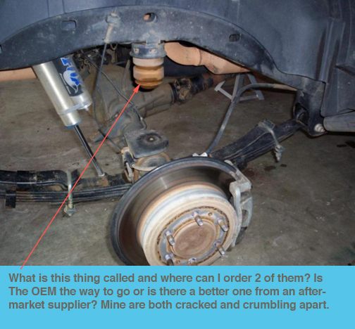

I know this is a ? suspension item ? but my phone is dead and I don't have my password to start a new thread. I've searched but didn't find anything close to what I need, so just point me to a thread and I'll go running to it but in the mean time will someone help me out please:
Both of mine are crumbling bad. I just pulled on one (gently) and a piece just broke off.

I replaced the "bump stops" but just with the original OEM's.
As stated previously, it was a very easy install. A "curved screw driver" forced the old one out (one literally fell apart it was so bad), the other one actually came out in 2 pieces. Getting the new ones in were a cinch as well. I apologize for not getting a video but had a few other things to worry about at the time - getting the headers on and everything back to normal.
