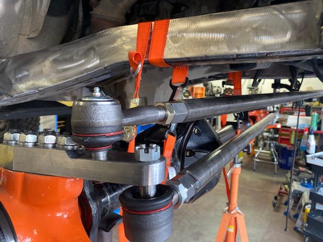

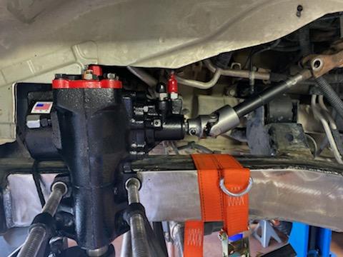

Stupid me, started this and forgot to update. Lots of pictures to upload. SAS install is moving right along. I'm 350 miles away but it looks and sounds like it is going great. Only head scratcher was if we should go with high steer top mount, under mount or use the Reid knuckle mounts.
High mount would be very close to hitting the pitman arm on compression, under mount would drop it a couple of inches but wound need to mount it in the forward holes. Reid standard mounts are 3/4" higher than a stock D44 mount so that's the route we decided.
I originally was going with Yukon Hardcore locking hubs but neither Yukon or RCV would warranty if used together because they have not been tested together. Apparently the specific cut, pressure angle cut, of the cogs is different and would create high pressure points and prematurely fail. So I went with my original plan and went with slugs. No 2WD for me.
All other aspects are pretty straight forward installs.

I think you’ll be fine with using the Reid knuckle mounts for the tie rod and the steering arm for the drag link. That’s how everyone has been doing it without issue.
I know in the case of mine, I had to do it that way because of clearance issues
