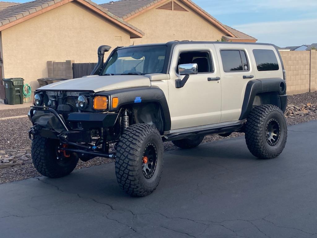

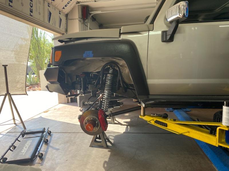

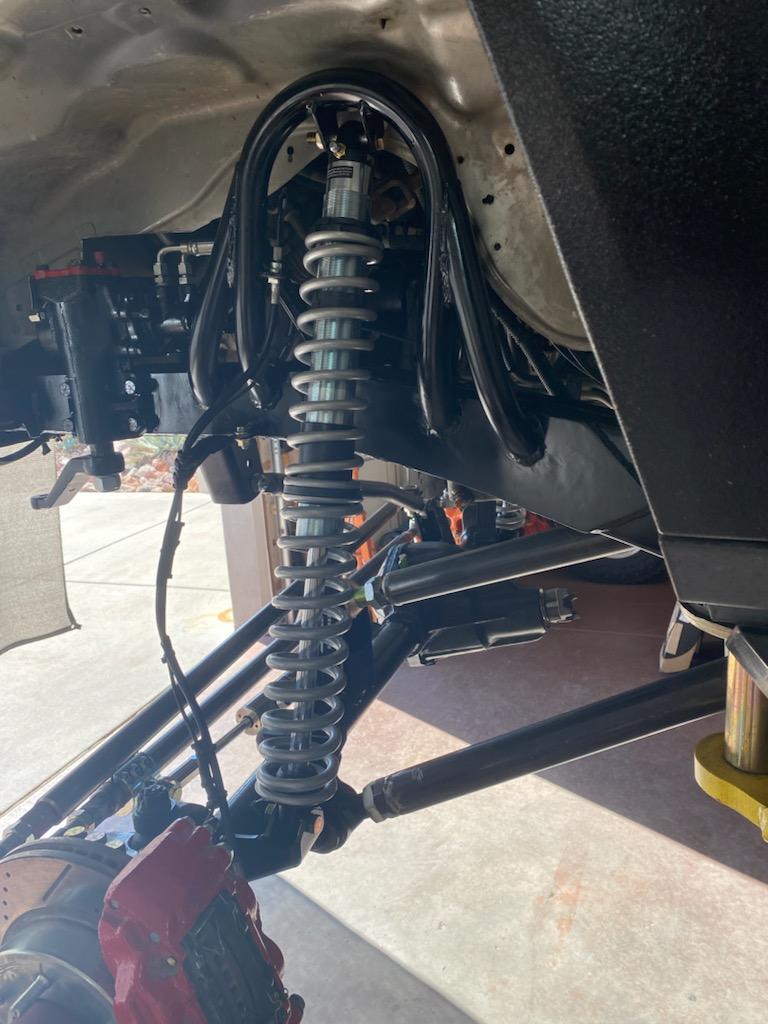

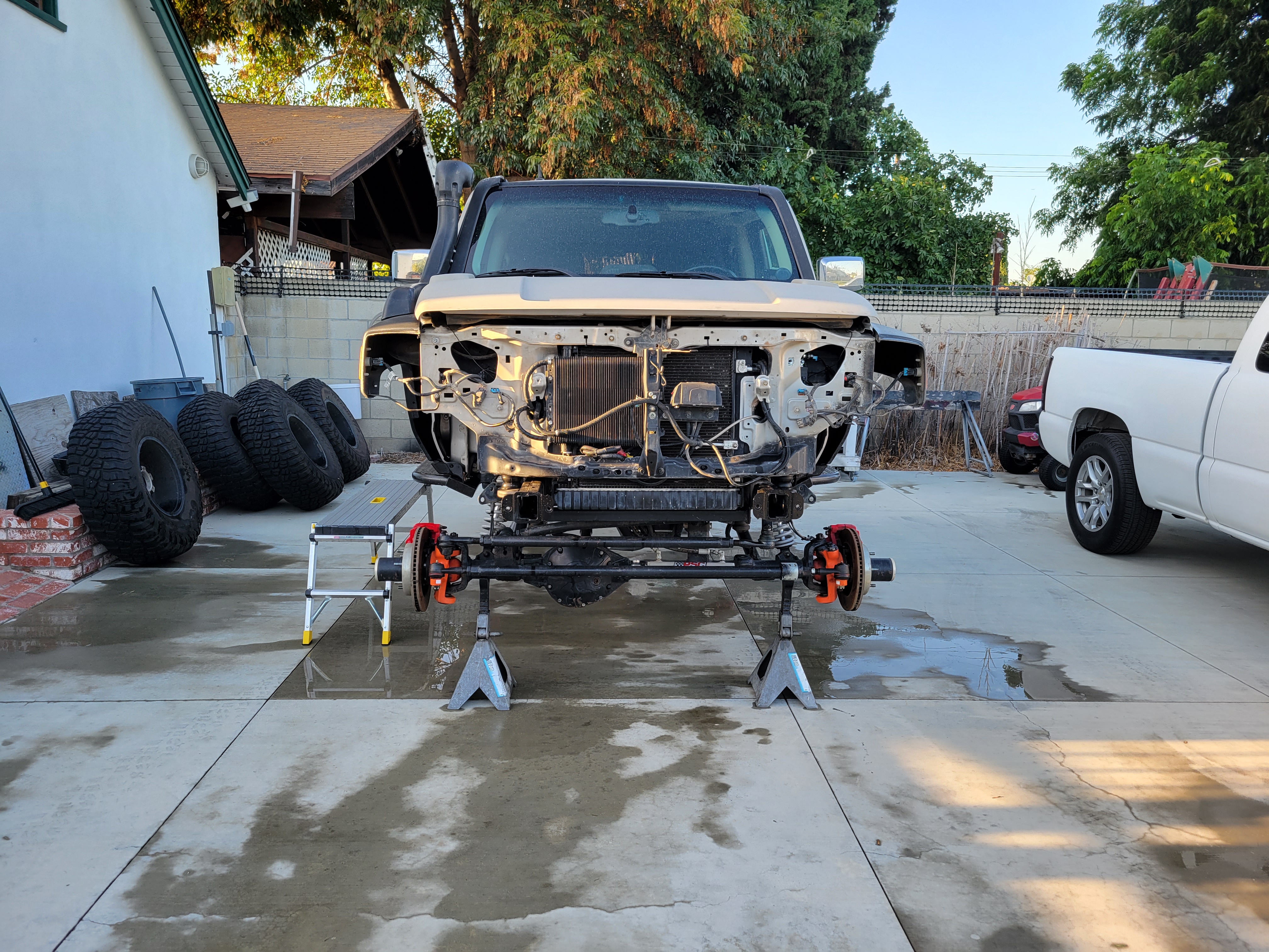

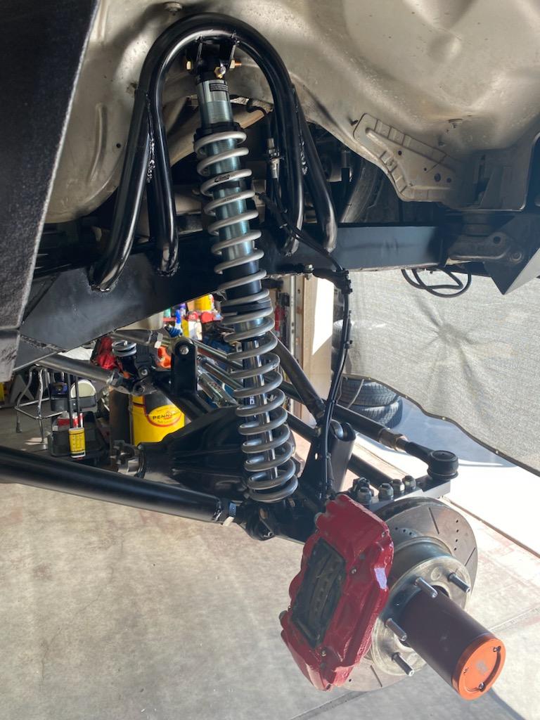

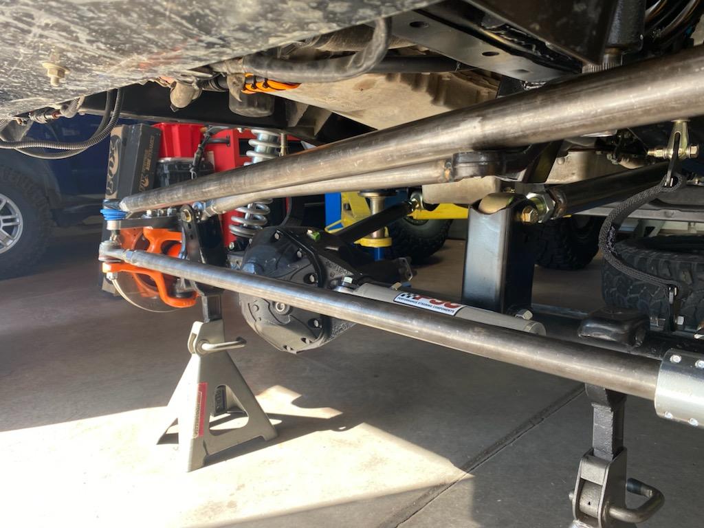

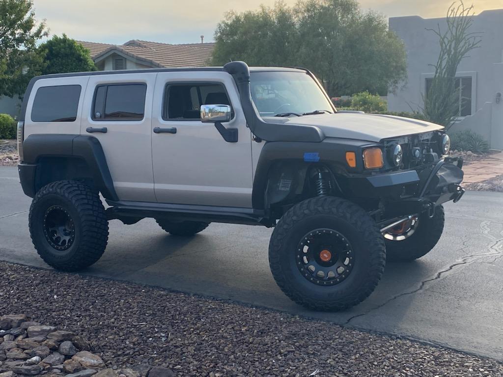

Build is almost done. Down on all 4 and rolling. Fine tuning then some miles to prove it out. Can't wait to get it dirty.

Anyway you could post some pics of how he has run thre ram assist lines? I want to re run mine and need some inspiration lol

It's coming together nicely. Looks like you're ending up with quite a bit of lift.
Surprisingly, no. Rear is the same as in Moab. Front needs to have the springs settle before final adjustment. I am also running 37's so that does add an additional 1".

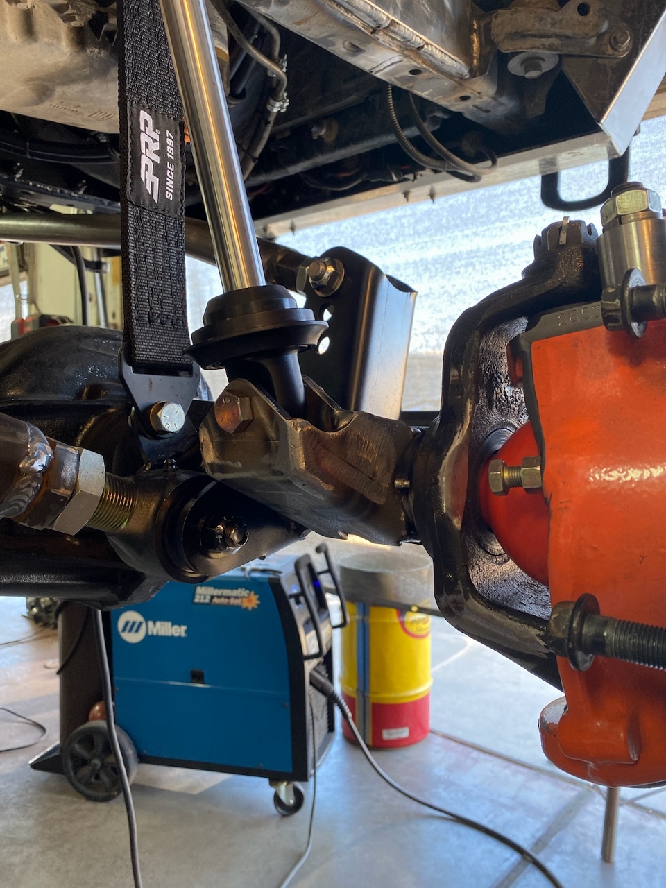

@reloader awesome job!
I see you had to grind the knuckle a bit for the RCVs. Those things are a pain in the ass to install! The benefit is that you shouldn’t have to take them in and out much since they don’t break!

Yes, he said grinding was needed but the Reid knuckles are way over built anyways so no harm. I am hoping that because it is overbuilt I will not have to touch it again for a long time.

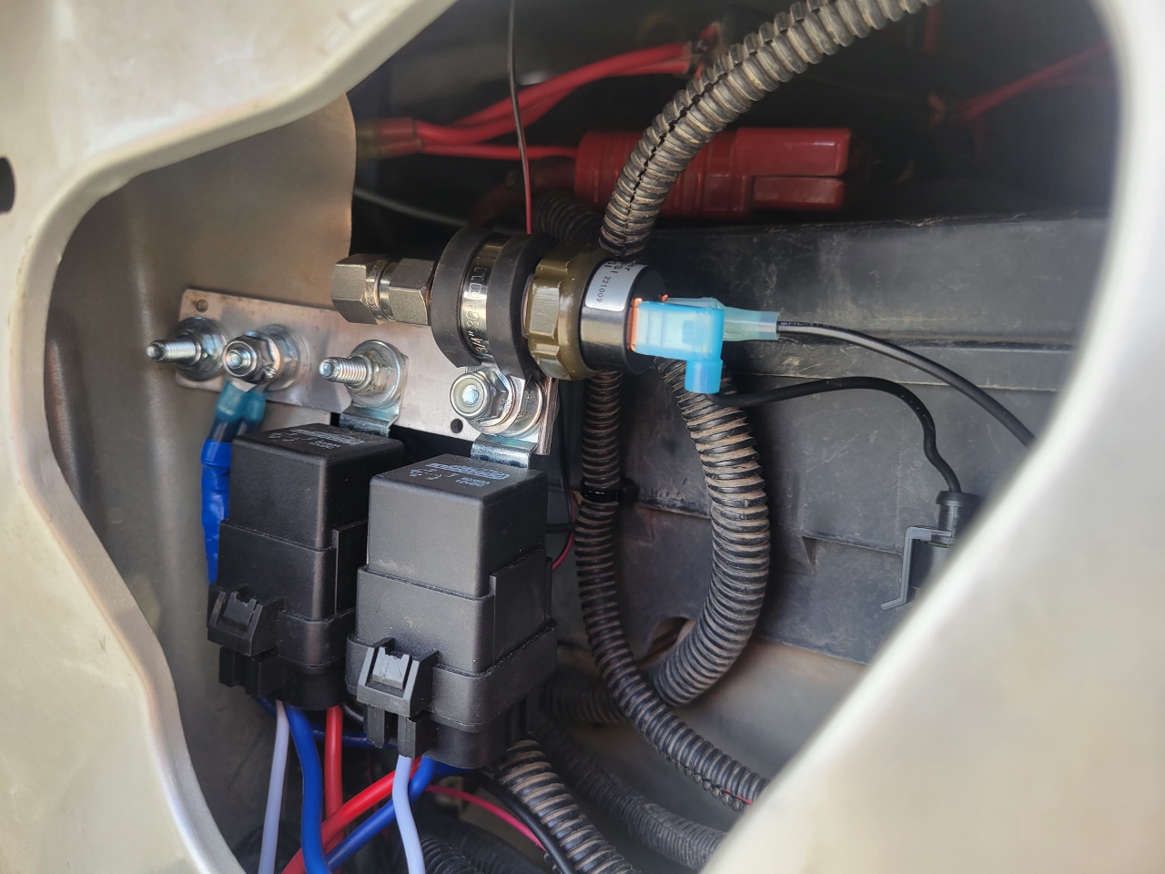

Upgraded the ARB air compressor wiring. Located the new relays and pressure switch behind the driver side head light. Nice protected pocket.
