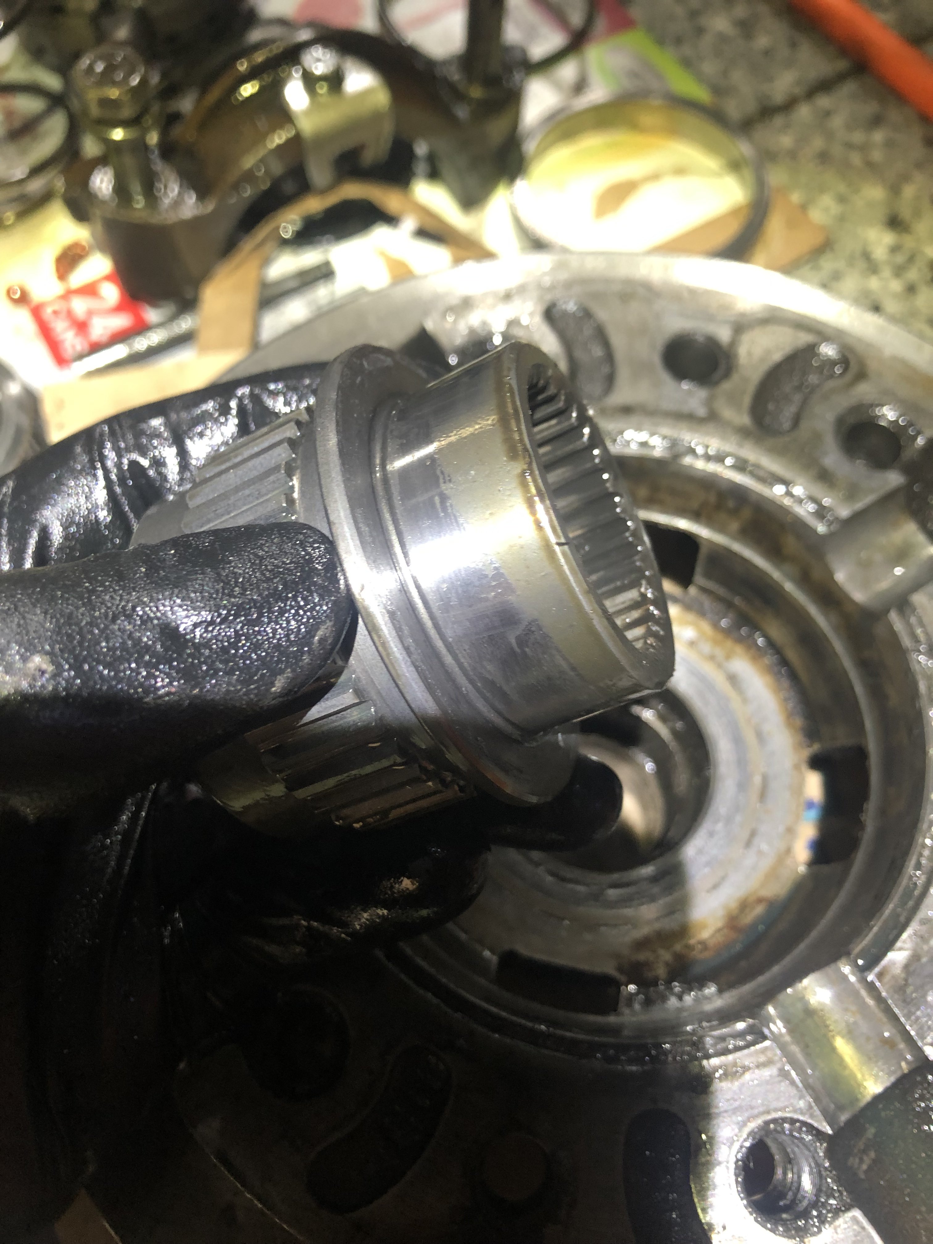

Some 14 bolt lockers need some machine work to work in an eaton diff and naturally mine did.
After measurements, I found out that I need .004 of material taken off each side gear.
This gear needed the machine work done.
I had .004 taken off each side gear at the local machine shop and put the diff back together. Technically it did work. They did disengage but the tolerances were so tight that it made crazy breaking axle shaft sounding noises when it would unlock around corners.
So I took it apart again….ughhh!!!
I had another .004 take off each side gear for a total of .008 taken off each side gear. Slapped it back together and now it works perfect! No more noise, locks nicely and now the testing can begin.

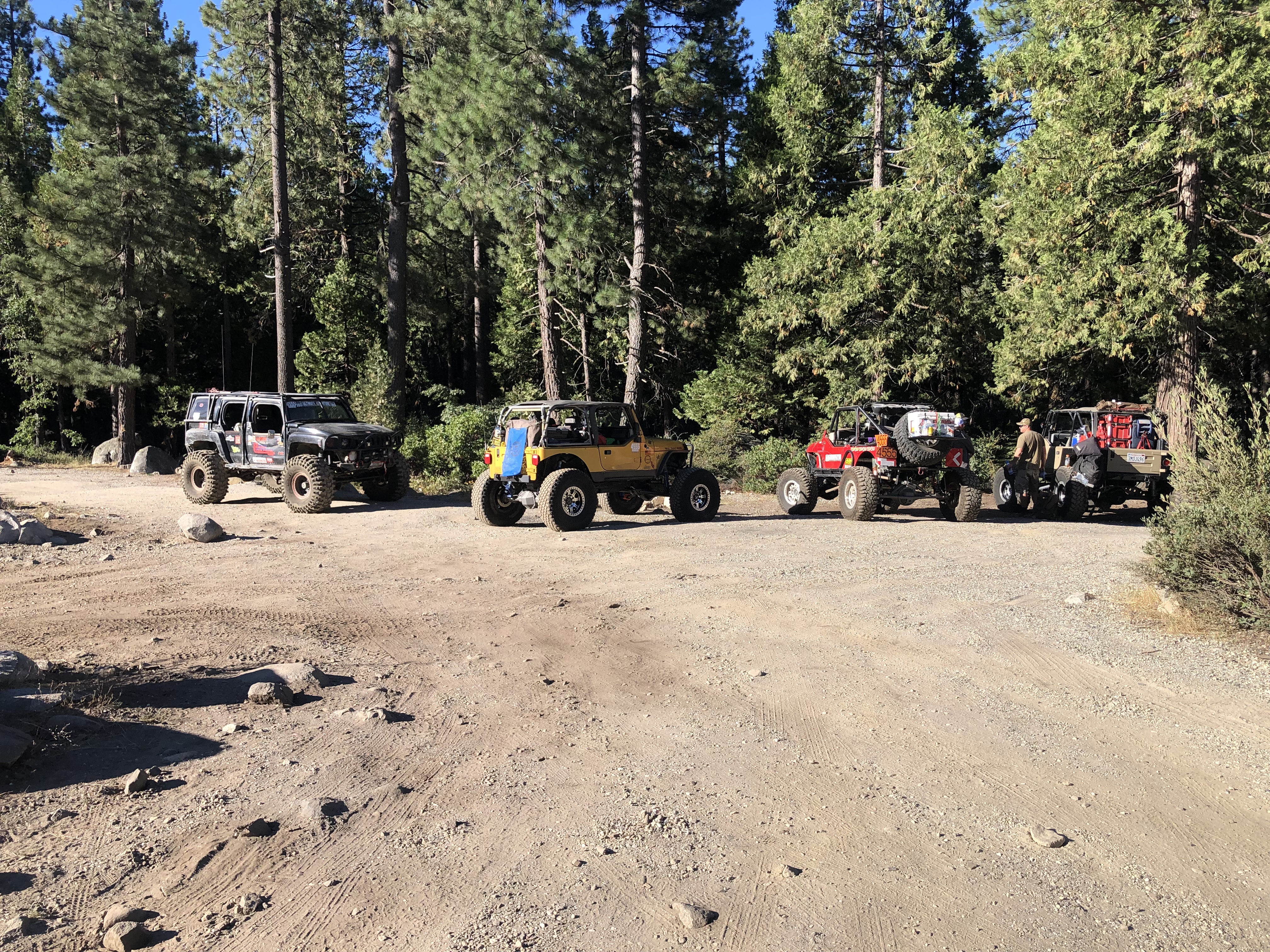

Ok, time for an update on the rubicon trip. I had a blast! This was probably one of the more relaxing trips I have had in the past couple years.
Some trips are non stop wrenching or bad weather or whatever else a trip throws at you but this was the perfect amount of camping, wrenching, mcgyvering, and wheeling.
It was Me in the H3, my sister in my brothers JK on 1 tons and 40s, my buddy in his 4500 TJ, his dad in his TJ on 1 tons and 40s, a buddy in his YJ on 1 tons and 40s, our buddy’s grandpa in his wildcat UTV and our friend in a Willy’s on 35s. We also had a friend come out for a day in his Toyota on 37s.
I only have so many pics because the week after the rubicon I got my phone wet in a river and didn’t have my phone backed up
:mad3:
Here’s the group minus the Toyota and Willy’s.
Our buddy in the Willy’s unfortunately was plagued with issues at the gatekeeper. We had a lot of fresh builds on this trip so it was a shakedown run for some. The Willy’s went to the rubicon in 2020 and broke a front and rear axle shaft in the granite bowls last time, he went all out with linking it front and rear and doing a ford 8.8 and Dana 44. Well the 44 he bought had a broken locker and wasn’t running right. So he parked it and he rode along.
The gatekeeper was kind of a shit show
Broken unimog with stripped out bolt holes for the knuckle, they were there for over a day. I learned from our friend that you can cut two slits in the bolt and it acts like a tap. A rollover and a PS line issue in the gold TJ. Luckily I had a spare high pressure line that worked and got him moving again.

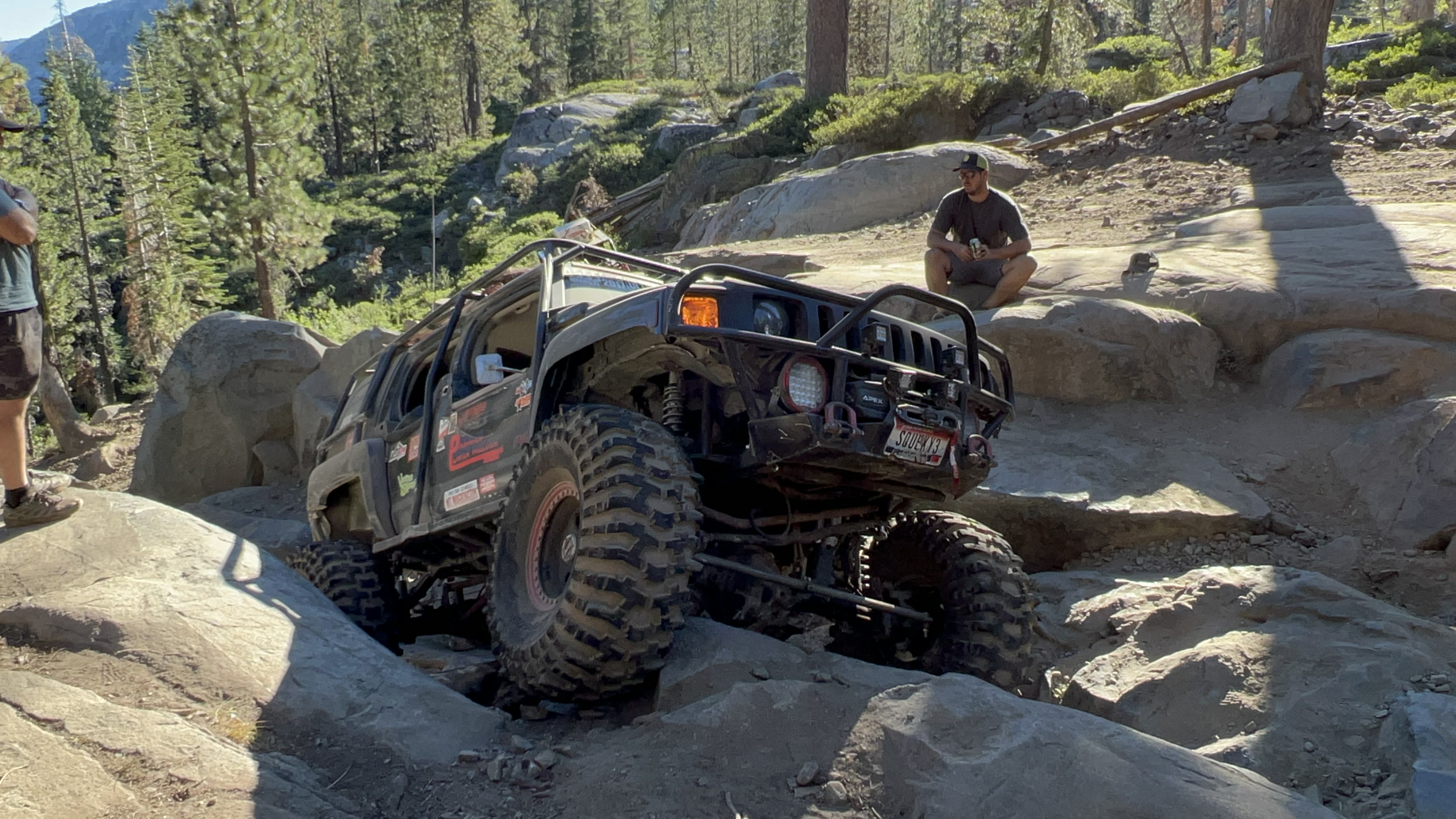

Here’s my sister on soup bowl. First time driving the rubicon but she wasn’t afraid. I wish she had some more fear

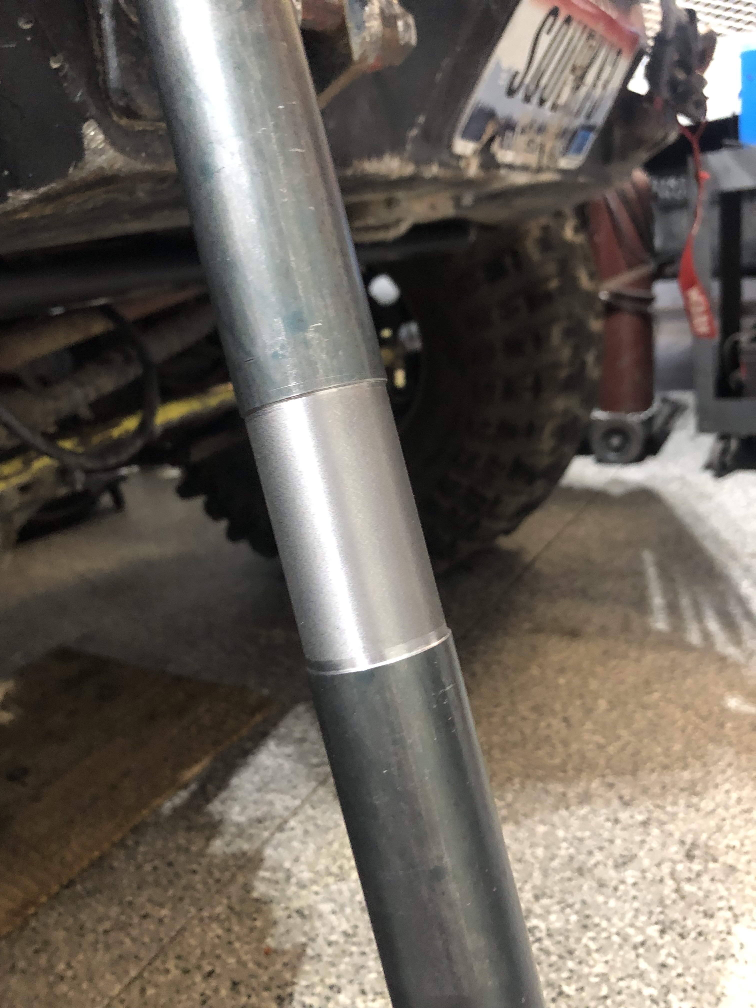

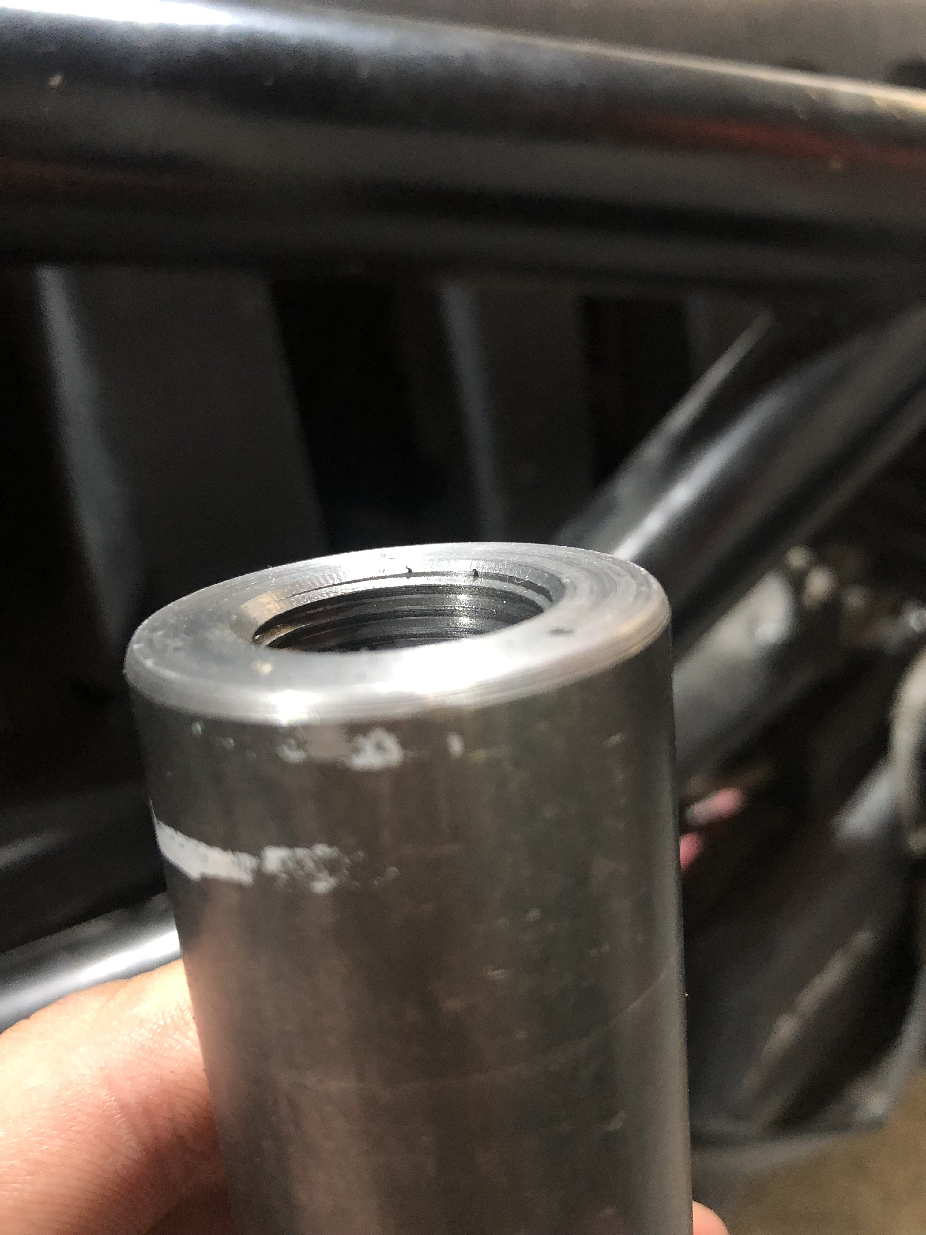

I have bent about 5 or 6 1.5in .25 wall tie rods. These are kind of “standard” heavy duty tie rods for solid axle setups. I keep bending them. So I have contemplated many options and I went with “stressproof” material. It’s 1.5in solid bar. Another guy on a forum kept bending the same tie rods and said this solved his issues so I finally got the stress proof tie rod done! Thanks to a local irate user for the recommendation. He sent me to a friend, he couldn’t do it but his neighbor has a lathe big enough to do the job. Both guys were super cool and even let me use the lathe….I want one now. They are cool lol
Just gotta build a tie rod clamp now.
So, will this work perfect? Bend? Crack? Break a knuckle? Time will tell!
I machined the center down to prevent ram assist clamps from sliding

Right after driveline hill our buddy in the Gold TJ had an orbital or PS pump issue so he parked it and rode with me.

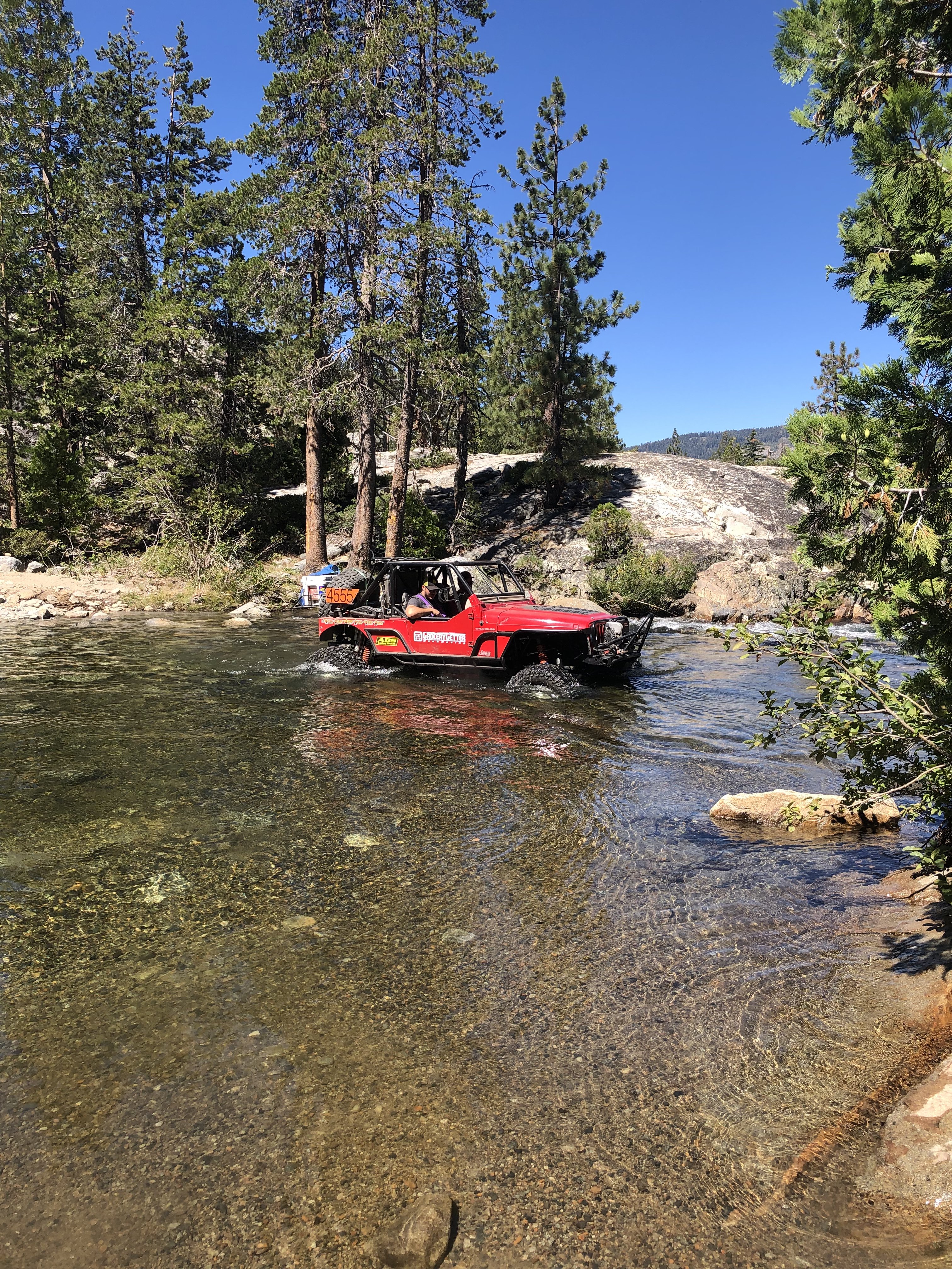

The water crossings had us worried but at 85-90 CFS it wasn’t too bad. Almost swallowing up a 37in tire.

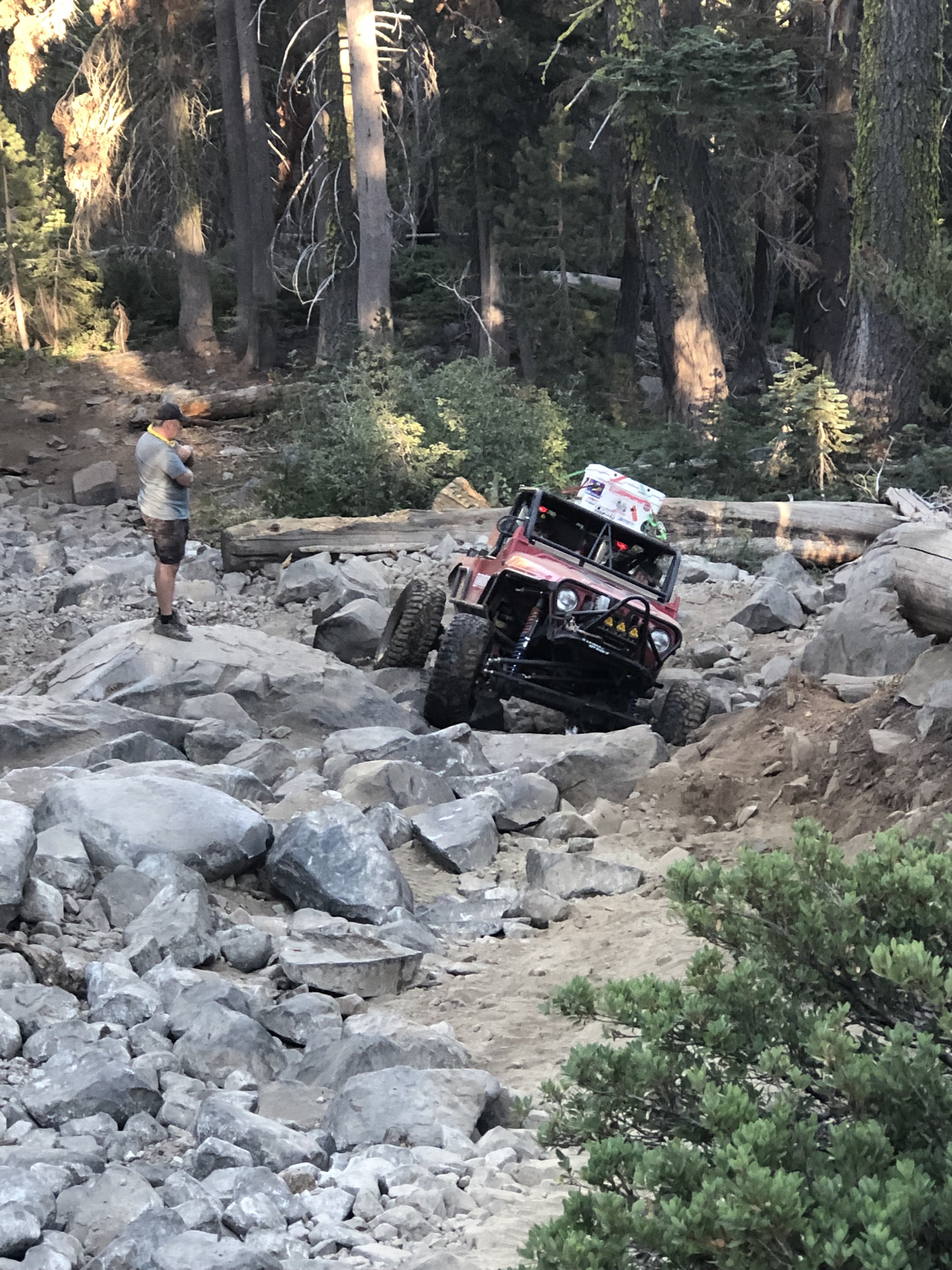

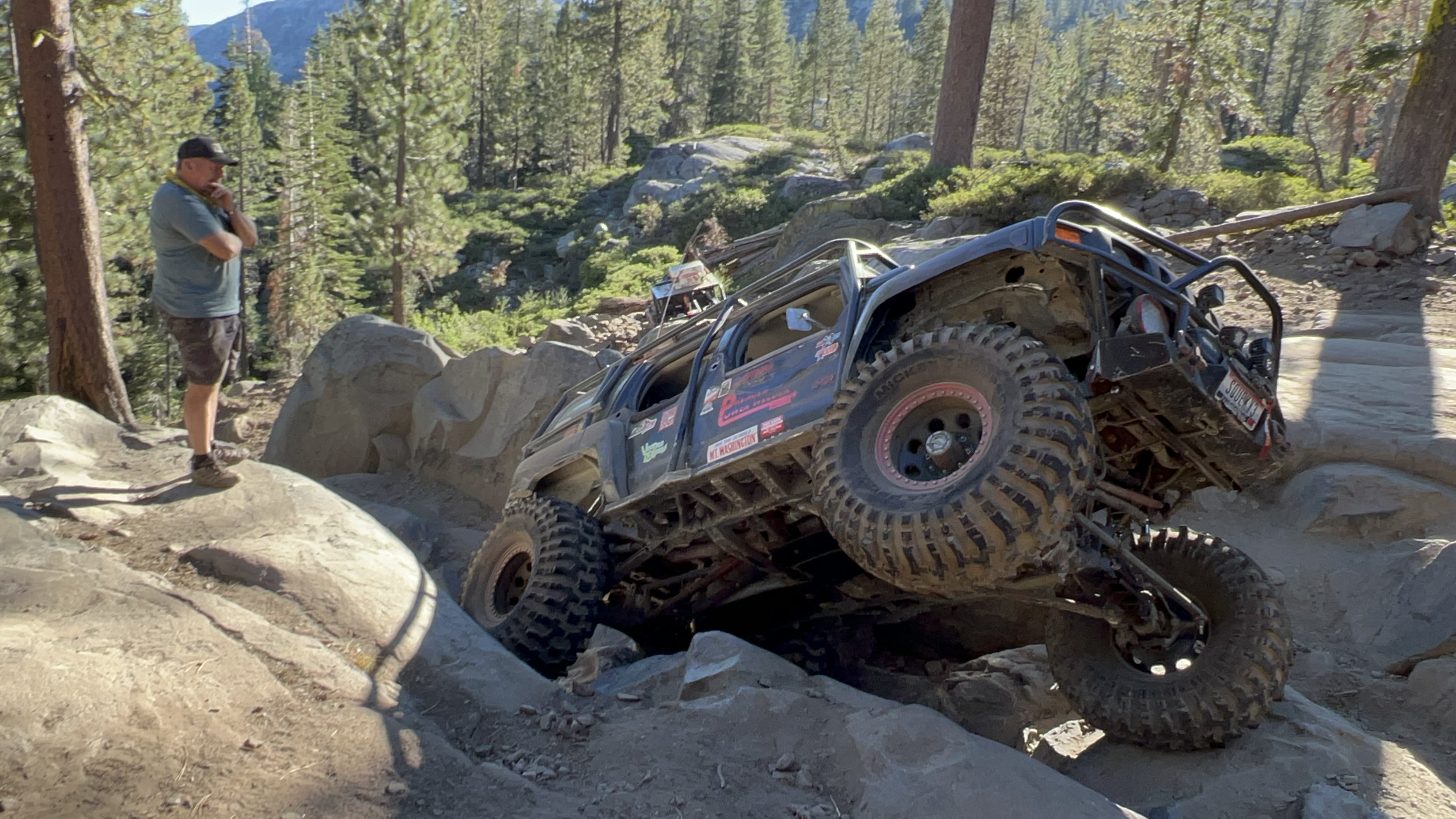

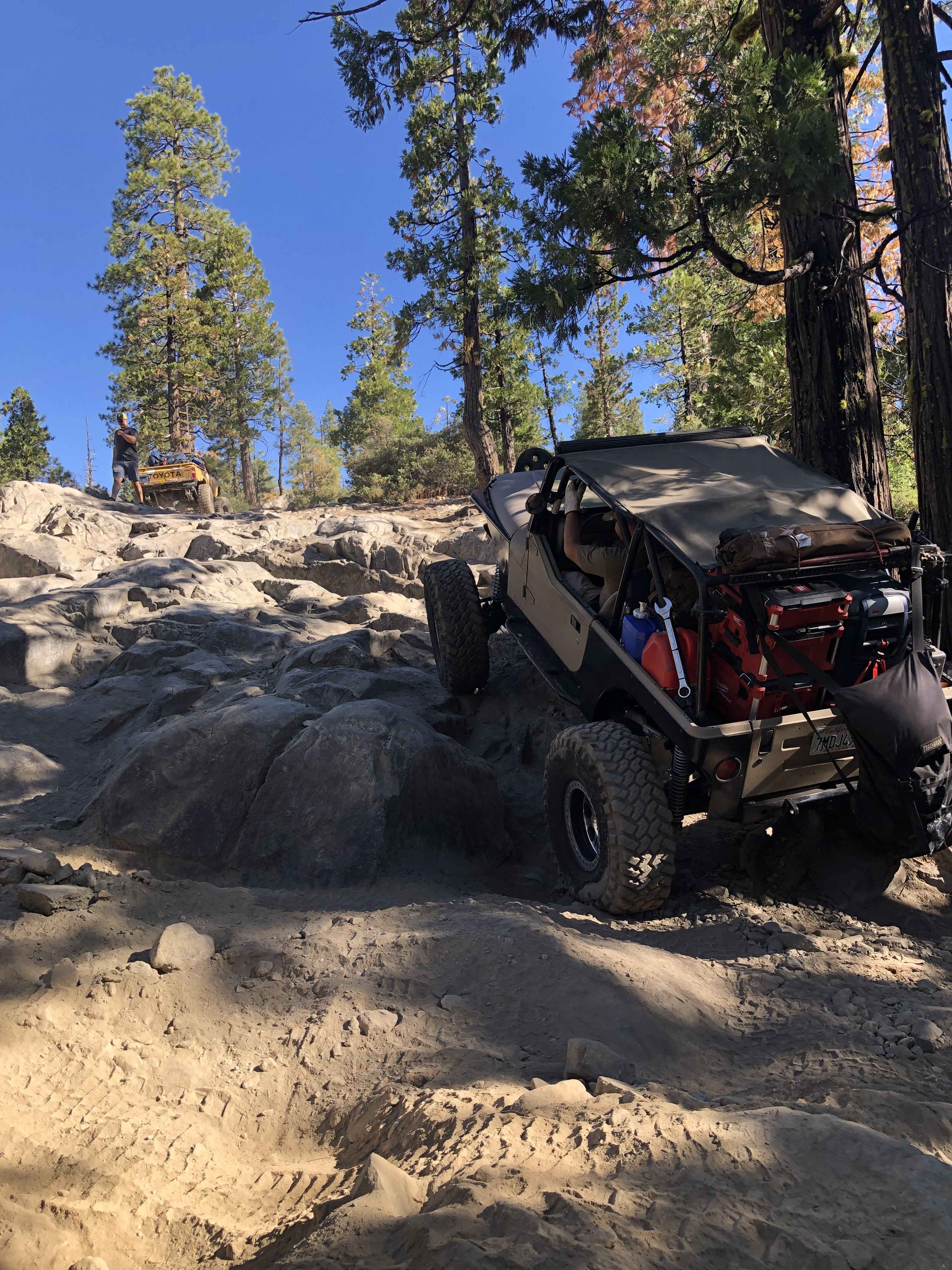

We pressed on to winch hill 1,2 and 3. Winch hill 3 was exciting! I did the squeeze line (on the right if your looking at it from the bottom)
I was stoked to have made it! This obstacle has messed up some rigs!
