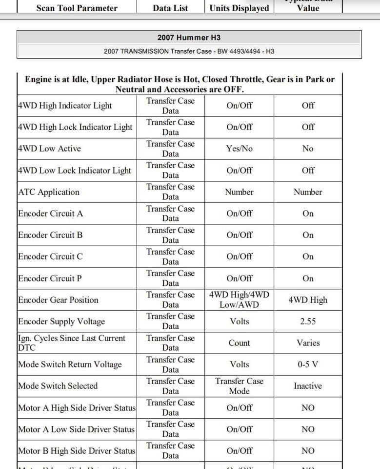

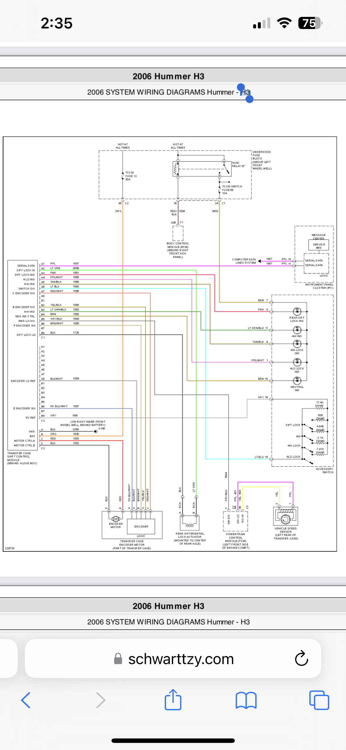

So, in the effort of transparency I will say we have wins and more struggles! I drove the H3 with the new tap shift strategy and it kicks ass!!! I’m super stoked with it and it will start in 1-2 or 3!

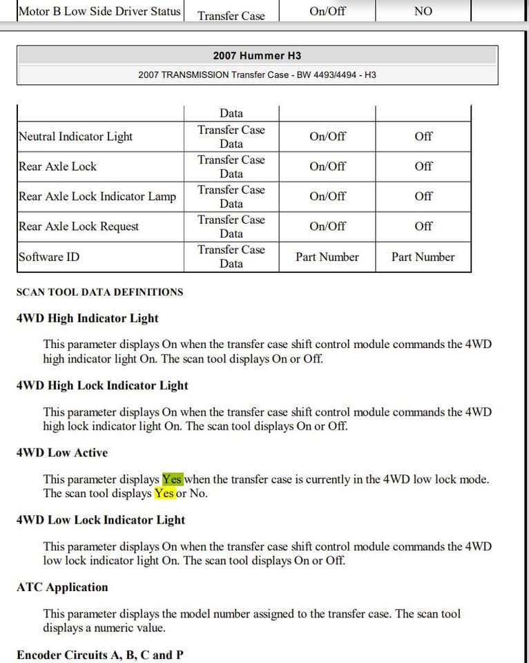

My struggle is that the speedo is still wayyy off in 4Low. I have 2 methods to notify the computer I’m in low. 1 is the encoder motor, I push the button and it goes into low like a factory t case. 2 is a toggle switch that grounds out the 4Low wire to the pcm and tells the pcm “I’m in low range” I usually use the switch. My factory 4wd buttons sometimes stick, they can be a pain, etc.
So, whether the computer recognizes I’m in High or low it’s way off and says I’m doing like 55 mph at 2500 rpm when I’m doing 10-15. It leads me to believe the pcm is not acknowledging I’m in low even though I tell it I am in low.
My VSS is now in the trans, not the back of the t case anymore.
So you can see in this video it is getting 4Low active but not “selected” is that necessary to acknowledge 4Low? Idk, so I went to HPtuners tech support and they were absolutely 100% useless. I asked what each parameter means. After 11 emails I was told one means it’s active and one means it’s selected. Wtf! I was hoping for more intel.
I am leaning towards it matters on a 6l80e but not on a 4l60e because 1 switch from the toggle and it worked. I figured I’d look at some schematics and find out what’s the difference.
So I’ll try the encoder motor route but I’m not seeing that the encoder triggers anything else 4Low related. Maybe it does in a round about way?
I see the light blue wire that says “switch sig” that may be switching or selecting to 4Low?
But here in diagnostics it only states 4Low active, not selected.
But it’s running and driving, it works, but the speedo irritates me when it’s off in low range. This will be solved, just takes time.
It seems the few that did a 6l80 swap running a factory t case don’t have this issue.

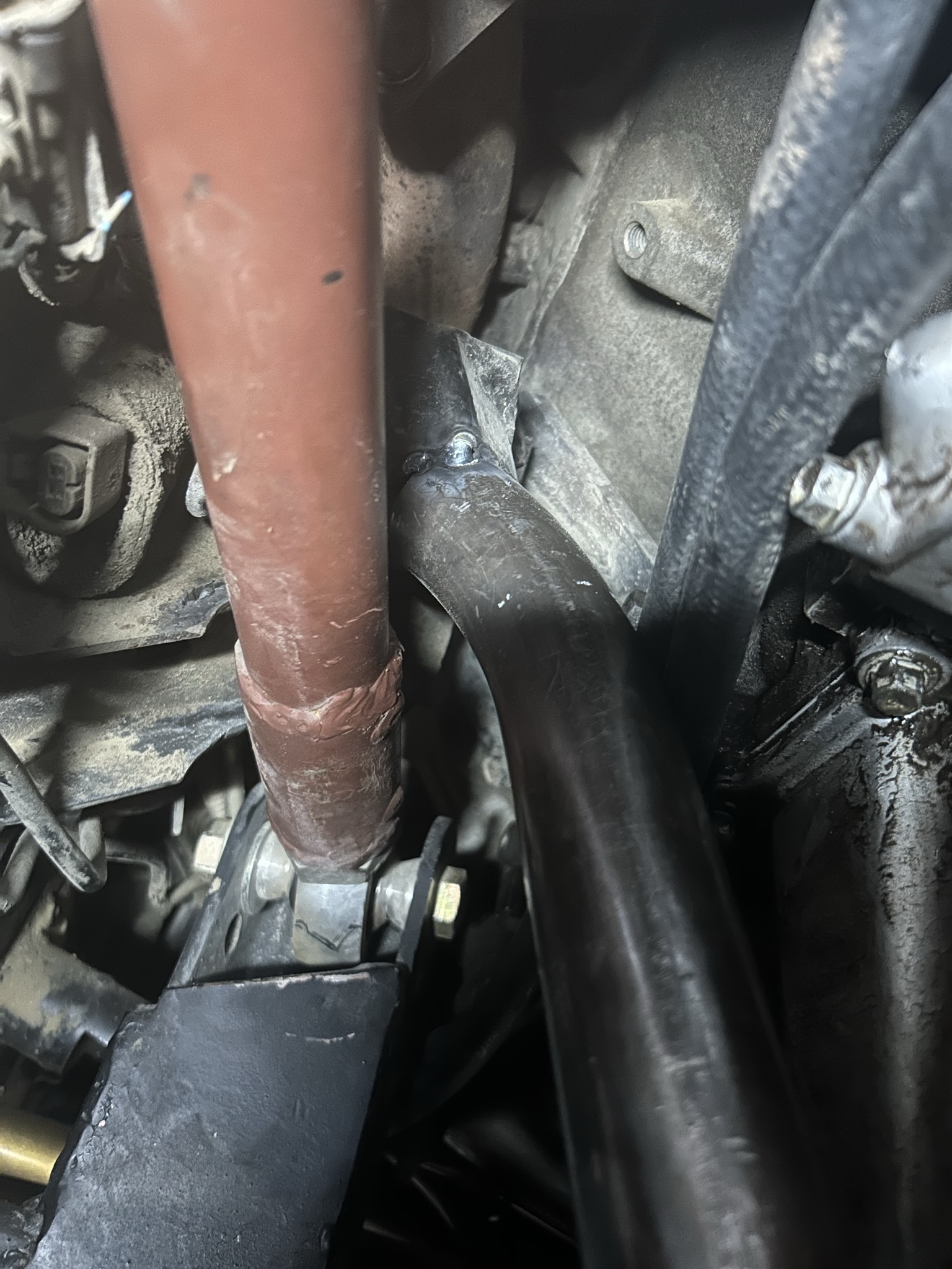

I had weird issues this trip, loose rear axle shaft flange bolts, an inner axle leak which probably happened when I messed up when I broke the u joint on the shakedown (been 6 years on those inner axle seals) and a loose wheel bearing. So just weird maintenance related issues.
The anti-wrap bar breaking is 100% design flaw, I shouldn't have an anti-wrap bar attached to a 1/8 plate truss but that leads me to the next topic. Linking the rear. I want to link the rear before the baby comes. After a trip like this I question why I would even link it? It did so well!! I was left grinning ear to ear but I also want to improve performance and make it better, even with an anti wrap bar I still struggle with anti wrap if the tires arent squared up on an obstacle. I also hope it makes me better at moab or sand hollow. I feel that my H3 was built around rock gardens like the hammers or the rubicon and linking the rear can improve moab/sand hollow type places.

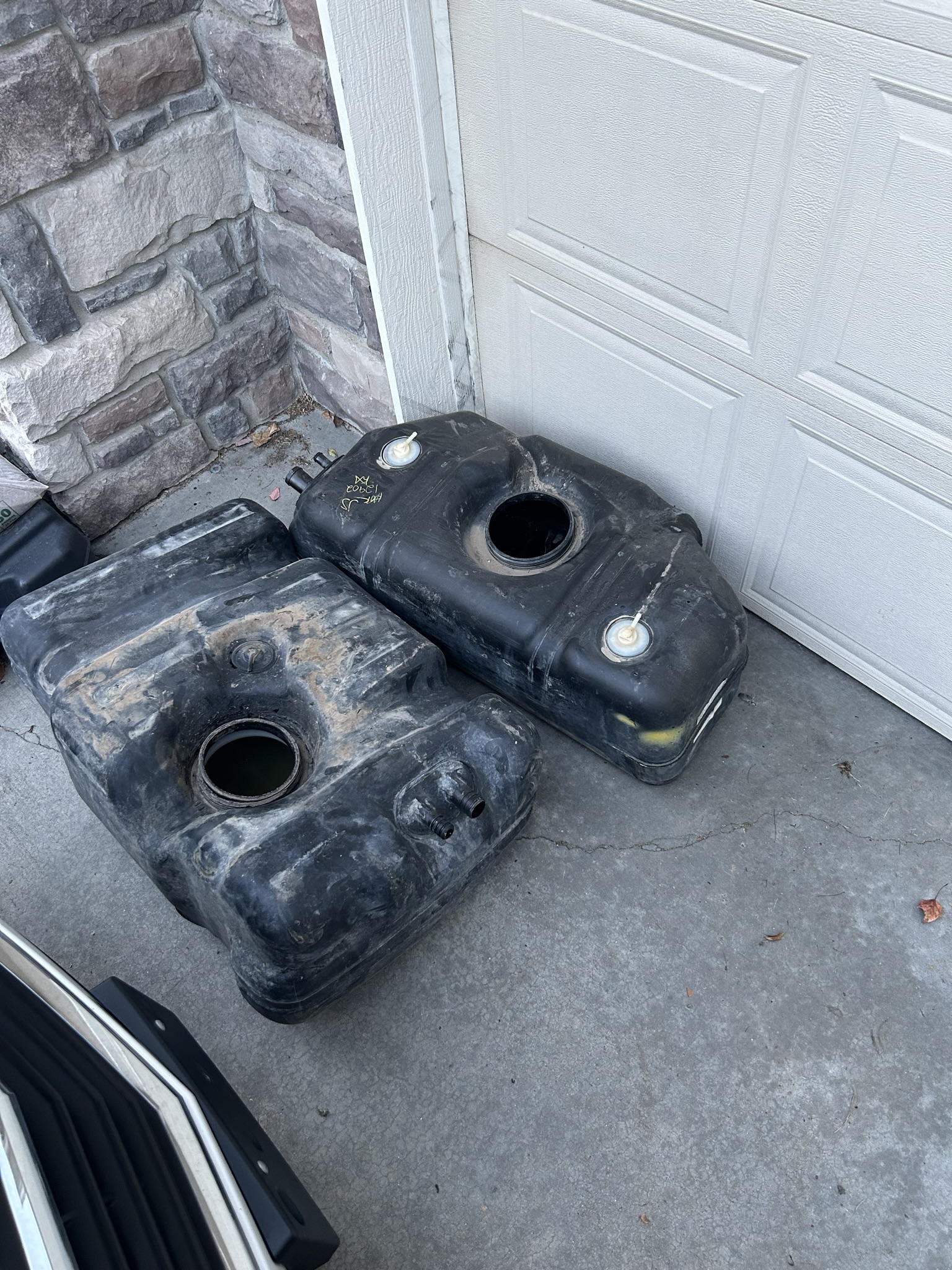

I know of 1 triangulated 4 link H3 and he used a TJ Genright tank. I am not spending 1600 bucks on a fuel tank.
So here we go...
TJ and ZJ tank. We will see which one fits better. 19 gallon and 23 gallon and go behind the rear axle.

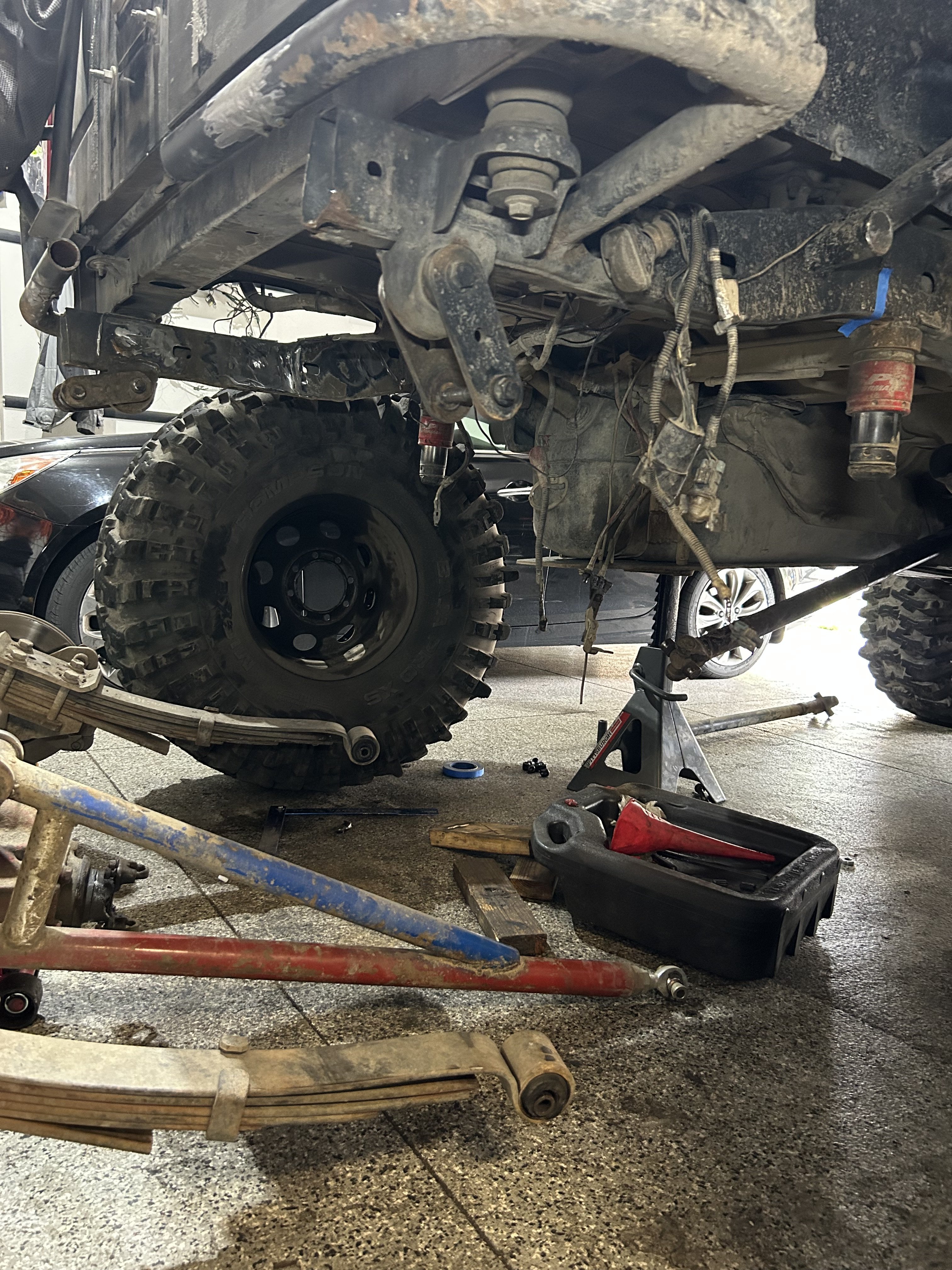

Since I don't always run a spare anymore I will be cutting all this crap out, it hangs out far and in front of it is a lot of 1/8in plating from the factory that housed factory sway bar mounts, factory muffler, evap stuff, shock mounts, etc. That will allow me to move the gas tank up as high as I possibly can.
I will cap the frame and do rec. tubing between the frame rails for a gas tank mount, hitch receiver, and tow points. I will have the hitch receiver mounted low enough for times that I do run a spare I can use a hitch extension to protect the tire.
My hope is that I can fit a ZJ tank in there. its 23 gallons and the factory H3 tank is 23 gallons. I am confident the 19-gallon TJ tank will fit as a backup if the ZJ tank doesnt work out. Dana 60 H3 said that the genright tank he said that the height of a TJ tank is the same as an H3 and the fuel gauge reads accurately. I will be remounting the evap crap I remove and mounting it along the frame rail. As always, keeping it operating like factory is important.

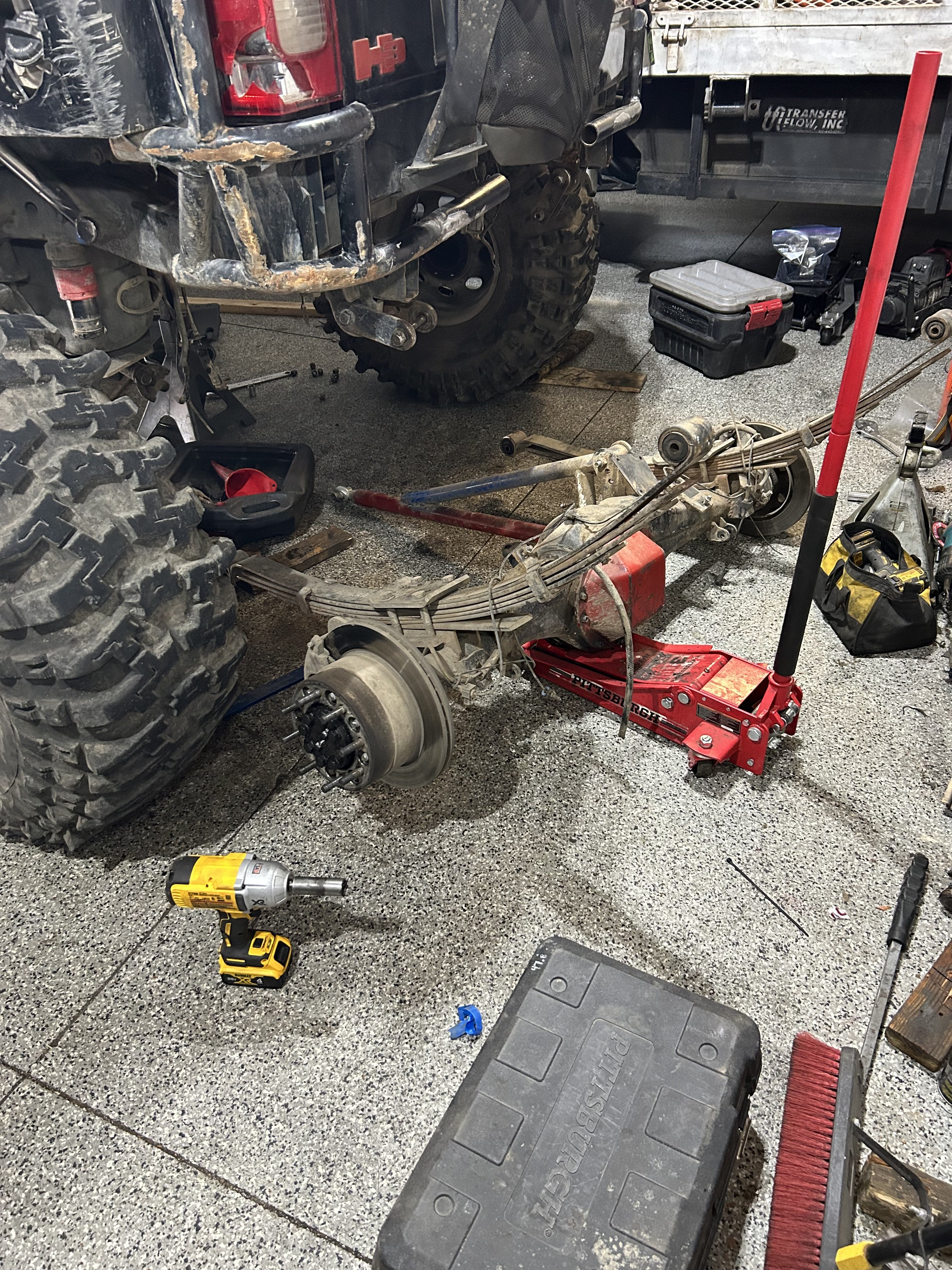

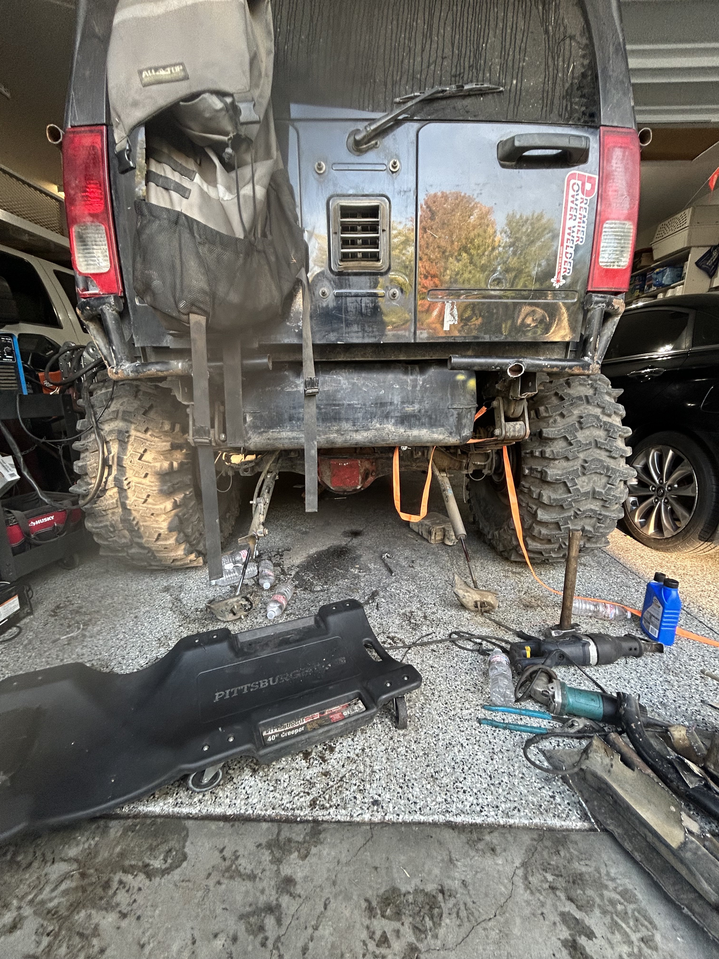

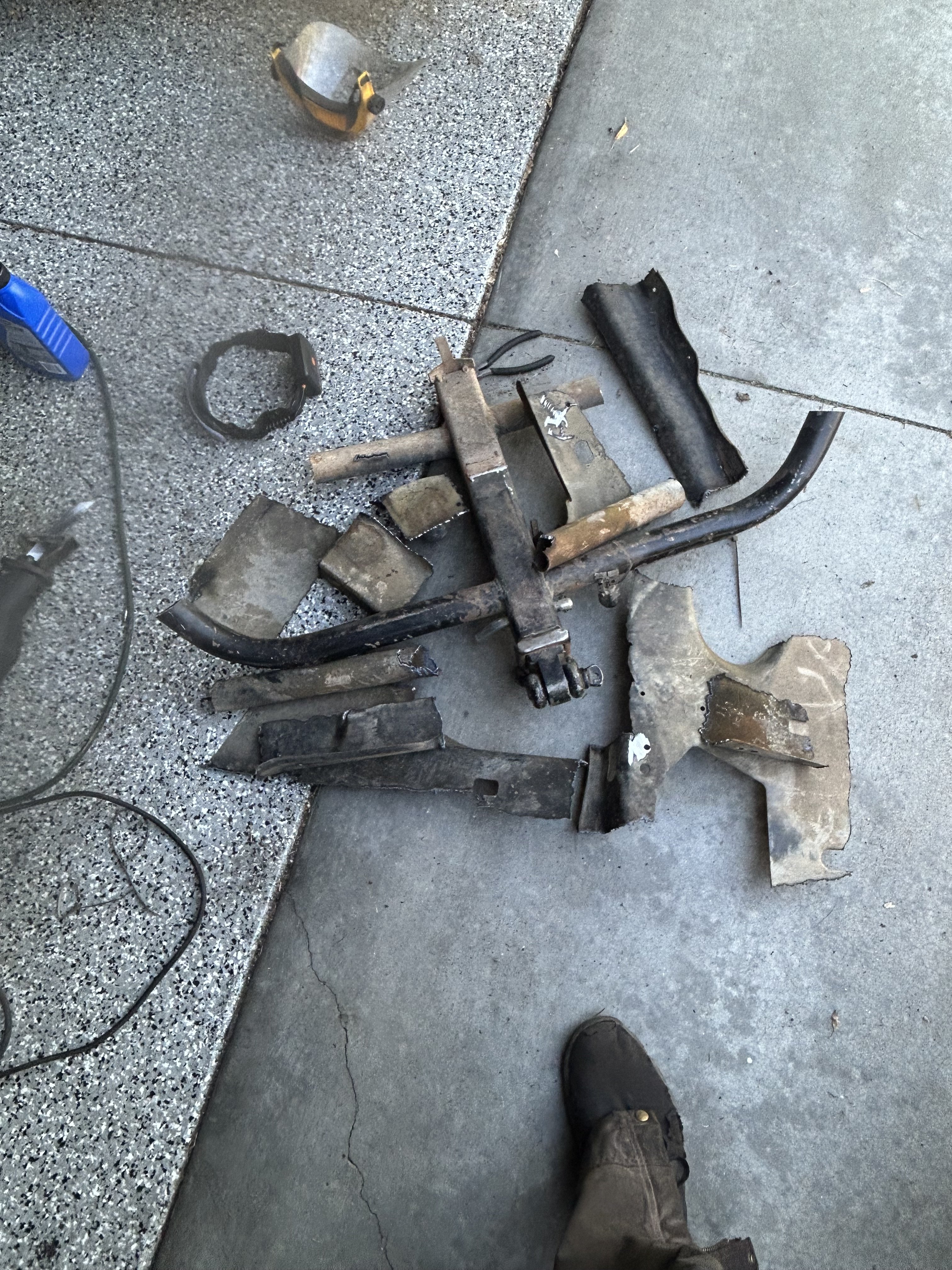

Things escalated quickly this weekend lol there’s plenty more metal I cut out since that pic. Anyways, cut out all the old crap. Mocked up the TJ tank. I don’t like how low it sits. It’s about 25.5 to the lowest point before a skid is there. I was about 32 to the lowest point before. It still sits higher than the stock fuel tank currently but it definitely hurts departure angle. I knew I’d lose clearance but hoped it wouldn’t be that much. There’s a nice lip I could cut out in the body to give me and extra inch or two. There’s also dead space that’s being wasted. It’s to be expected when using a random off the shelf tank. I need to ponder my next steps. This may be a 2 step process. Build the 4 link, throw a tank in for the time being and then come back and do a tank. I like Brennans approach. I don’t have Brennans skills. I am confident I could take the foam board and make the shape but would have to farm out the actual cutting, bending, and welding of the tank.
So I continued the next day to just cut more crap out, I have more stuff to do before decision time.
Nice leaf spring bushing….that one was wasted the worst.
I thought I was gonna tear up a little. Those leaf springs have put in work for 18 years. Thank you for your time, now you can rest easy in retirement on my sideyard.

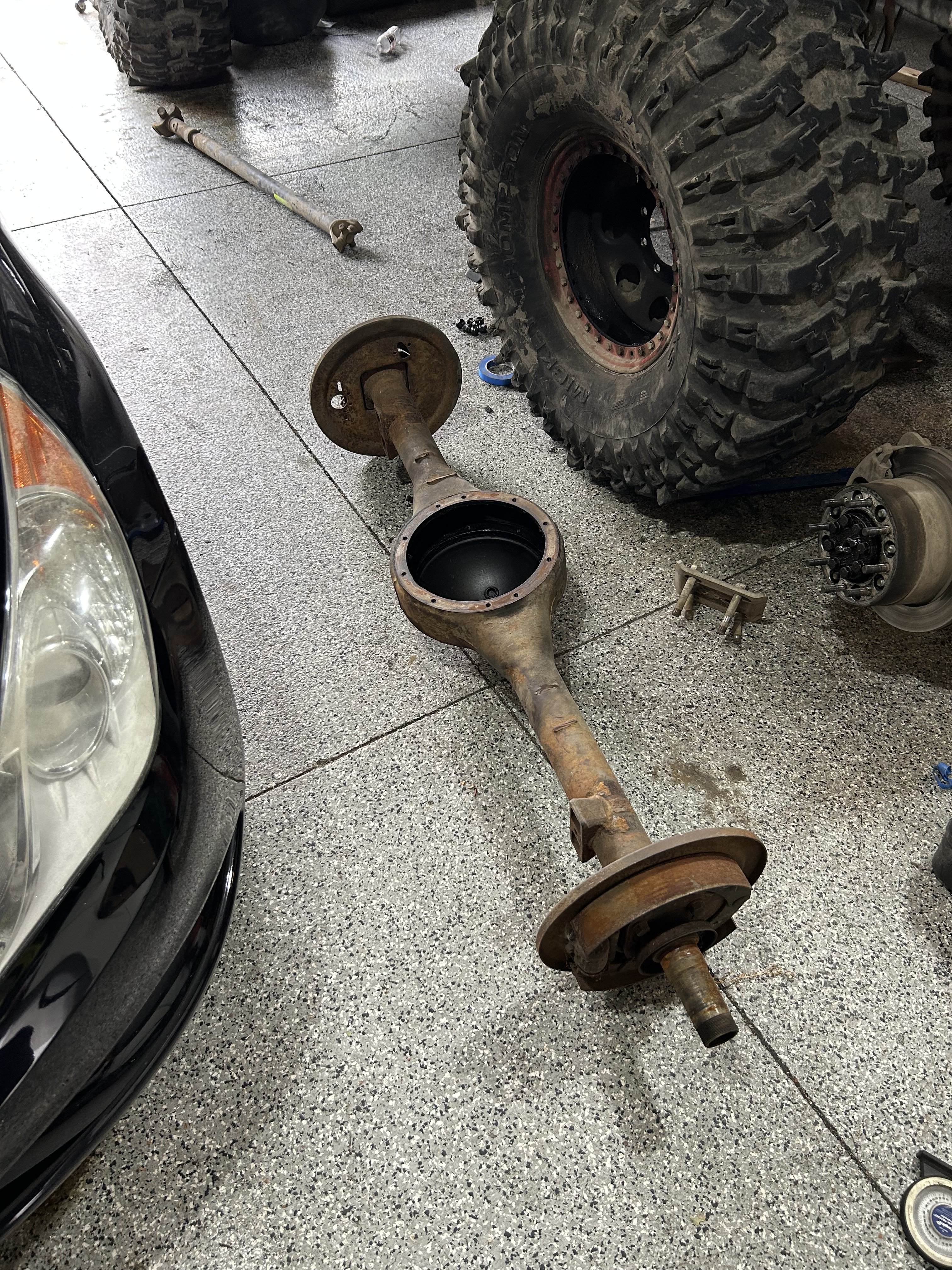

Here’s a fresh Eaton housing. My current one is fine, but it’s easier to just start with that then cut all the old shit off. I’ll cut it off eventually and use it in future projects but for times sake, I have 3 housings so might as well start fresh. I’ll swap my 3rd, shafts, brakes, hubs, and all the crap over.
So I’m out of town the next 3 weekends. I won’t be able to work on it again until the weeknights of Oct 16th. My buddy is flying out the weekend of Nov. 4th and that’s the time to really get this shit done.
We have been talking about a game plan. I will continue to research more tanks and options and we are reconsidering the 3 link. Like I mentioned earlier, I can get the same anti squat numbers I need. Roll axis is a little worse but a sway bar can help with that. Then gusset, gusset and more gussets, and tie in to as many things as possible TBD
