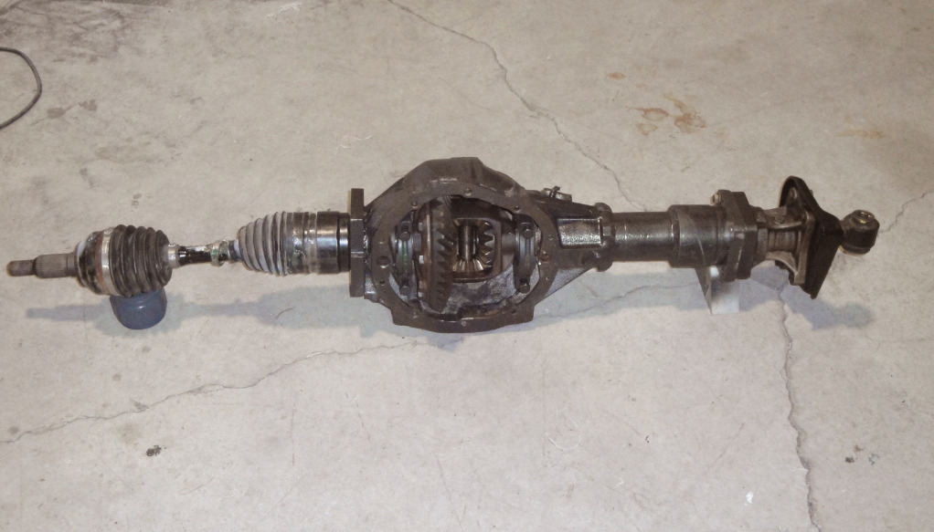

Starting this thread up...After I repair and install squeakys new to me 4:1 transfer case it would be time to tackle the front end. Some may disagree with me as I am "polishing a turd" but I think this will suite me the best. If it all fails and sucks then I can look into a low buck SA deal.
So my thoughts and concerns are these:
First off, I know this is not a big D60 that can handle extreme abuse but I think this can handle the 37-38s with ease. The ring gear is about an inch bigger but will this require any modifications to the rear end of the rancho crossmember? I would prefer to not make any modifications to it. Lets say this axle does fail and I am away from home I want to be able to throw a stocker back in.
Can we put a different yoke in the back of the diff so we can use the same H3 driveshaft (stock or 4speeds double cardan shaft.)
Will the use of colorado mounts get rid of the need for a rear bushing?
Seeing this is still a 3 piece design will a truss like http://www.hummer4x4offroad.com/forum/showthread.php?3333-Front-axle-beef-up this help?
Will the #2 axle shaft in the diagram have to be custom or can it be reused seeing they have the same spline count and length would be the same? I have heard of these failing. Can be cryo treated or custom made with chromoly...
I also plan on doing an E locker or ARB locker and RCVs, I wonder why the RCVs only are the outer end not the inner part of the shaft.
http://www.rcvperformance.com/product-details.aspx?sku=CVJ3906
Ill think of more but I wanna start getting the ball rolling on theories, problems and usability. While I am at it I wanna max out on flex. I did some measurements and found this interesting, our CVs when measured like this
Are netting near similar travel of this H2 shaft. Now we gotta use it. I gotta remeasure and double check but I think this can be a viable solution!
Post up questions thoughts concerns and whatever else.
