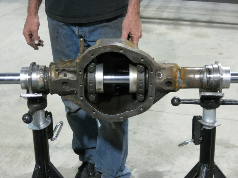

Here is my Diff
Notice the Pass side is as short as can be. If you started with a Drivers side drop - you may in theory get it closer, BUT, your stub shaft would be tiny.
Here is what it looks like from the front

would it matter if the shaft is tiny? Tiny as in short, not overall diameter.

By cutting the housing you can make it much shorter than that. Also by internally retaining the axle shafts aka snap rings or c clips like the stock axle you can go even shorter without running a bearing retainer.
No - however, the vendor who splined the short side said that it pretty much limited out his machine. It was short enough to the point he couldn't do his signature star spline pattern.

Our vendor that cuts our shafts is having the same problem with our HP 30 build for the s10 diff. The spline cutter can only cut so close to the flange and bearing surface
So I guess it does matter how short the PS Shaft is....well, if you want it splined. :) Do you use Dean at Performance Cryogenics?
